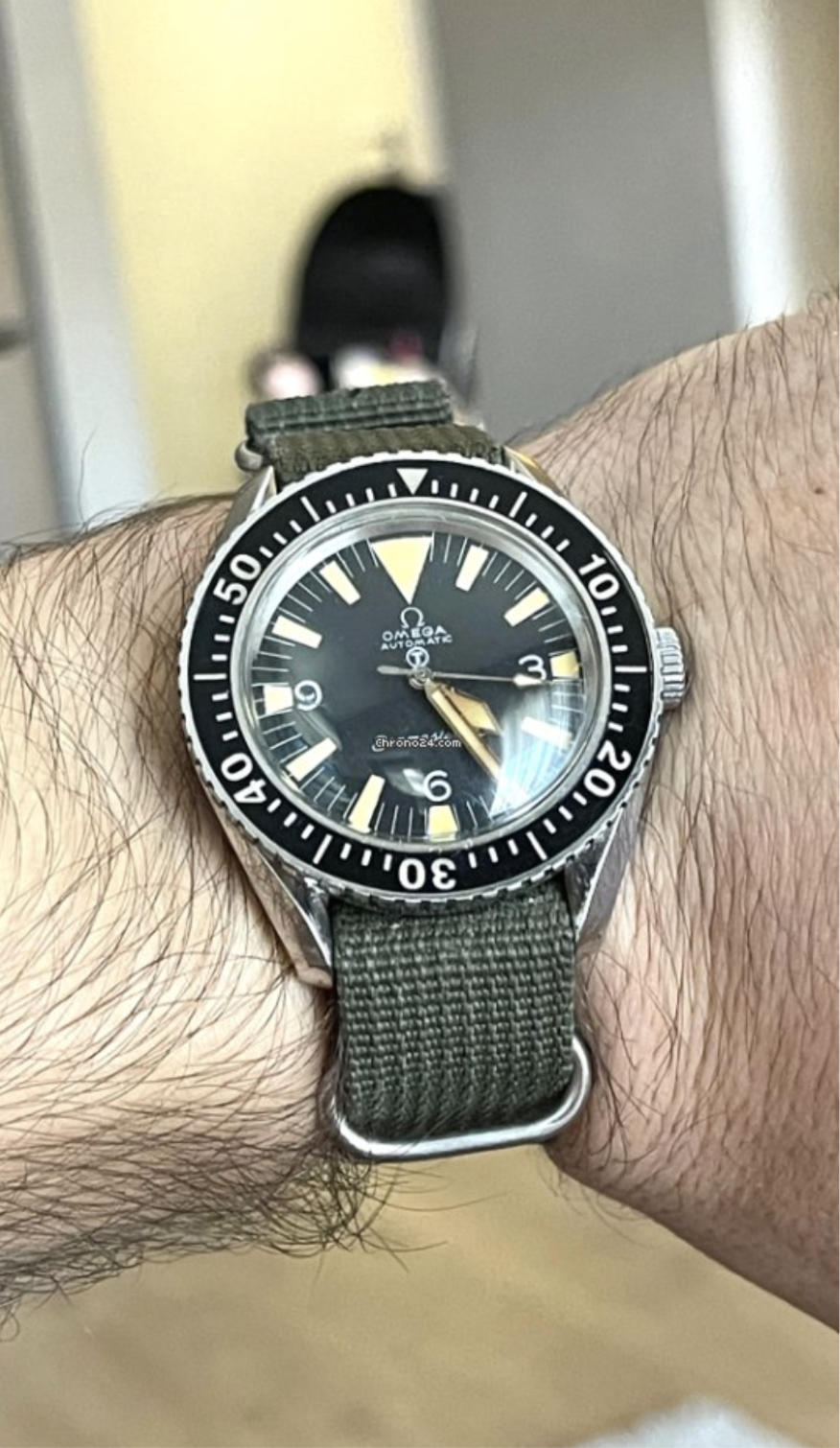

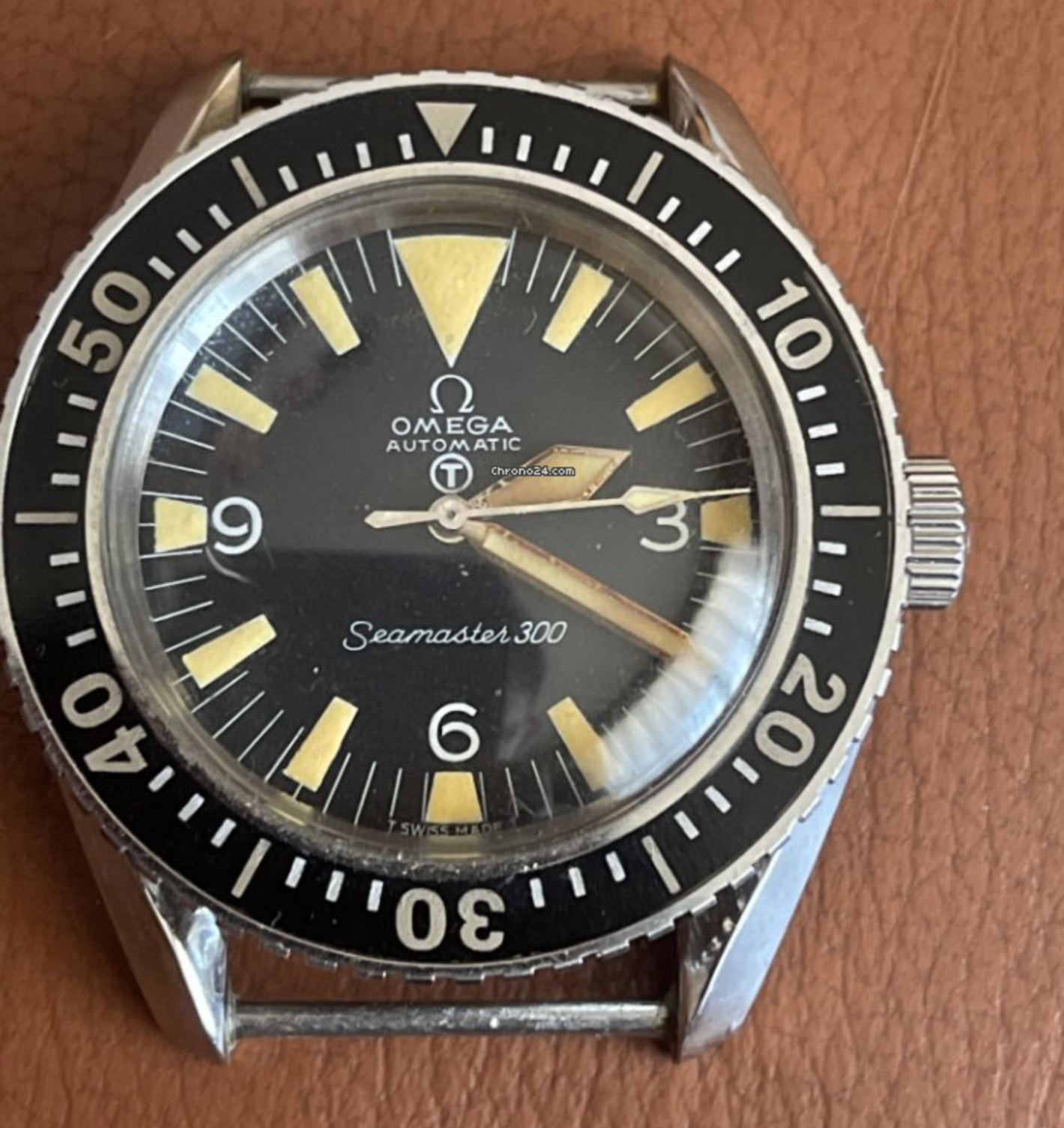

Big Triangle thoughts? Franken or not?

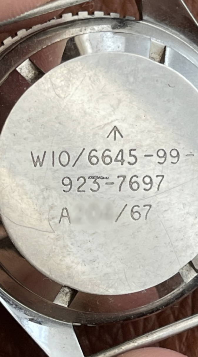

[EDITED]: Well, we see a new type of counterfeited caseback here! Enough said about the dial and movement. But what's really new, are the faked military markings. Usualy we see stubbies with the issue number A/254/67, but this copies the A204/67 from the december 2018 Phillips auction, linked below. And it seems to be mechanically engraved (or at least mechanically reworked), not just the pure laser engraving as usual.

Wow, we see a new level of counterfeited caseback here! Enough said about the dial and movement. But what is really new, is the faked military markings. Usualy we see a stubbies with the issue number 254/67 laser engraved. But this copies the A204/67 from the december 2018 Phillips auction linked below. And it is obviously well done and mechanical engraved, not by laser. If these idiots took another number close by and a real dial and matching movement number... well you get my point.

Yes I stumbled across the Phillips auction last week and that was the clincher for me that this was not just a watch in need of work with a refinished dial that would never be super valuable. I didn't think for am moment the watch I paid NZD$8k for might be worth $125K. Happy to name and shame the seller but I don't like to bad mouth people without all the facts and my "omega certified" watch repairer said it was genuine and was happy to service it and fix the issues for $1,000. To me a working, serviced old watch was all I was looking for.

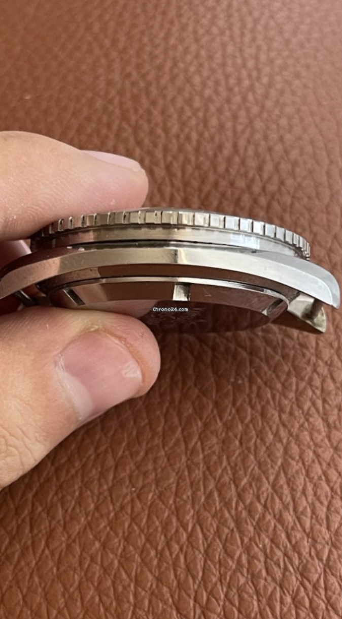

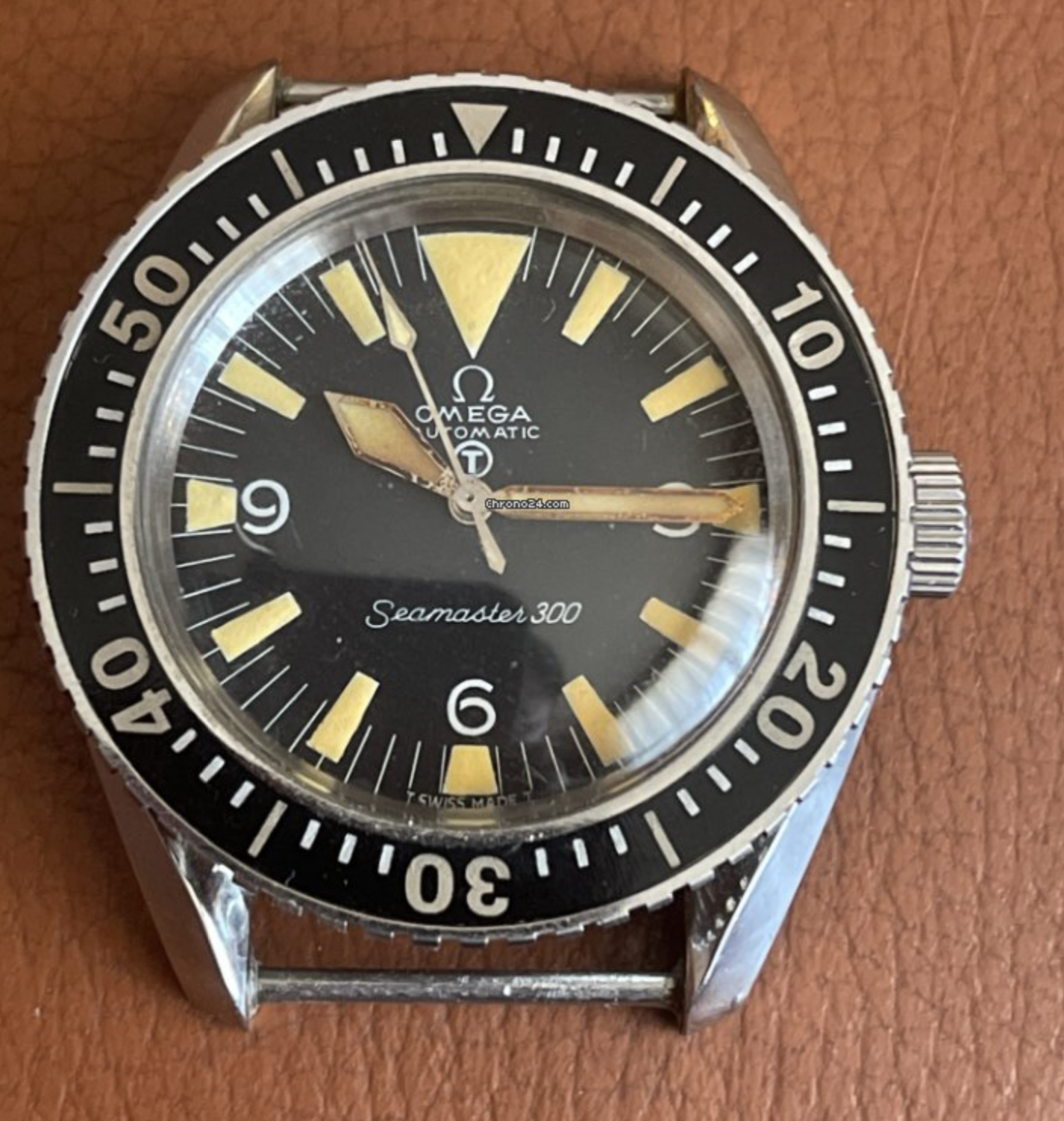

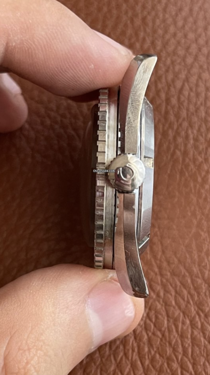

I'll post the original Chrono24 photos (yeah yeah stubbies I see them now!. The seller has gone strangely silent to my messages despite being active on instagram. Quelle surprise!

Your last pictures show clearly, that the mil. Numbers are laser engraved. That was not done in the 70's. So, clearly a fake. Next step: report to NZ police for internet fraud. Get a police report number and claim your money from PayPal/ credit card company. Inform the factory in about the police investigation with the mvmt. Number and pictures. The EU had internet fraud reporting facilities too. Do what you can and go all avenues.

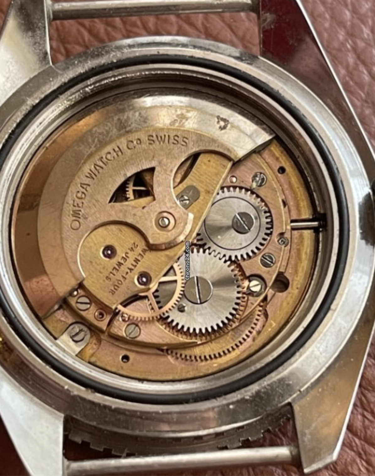

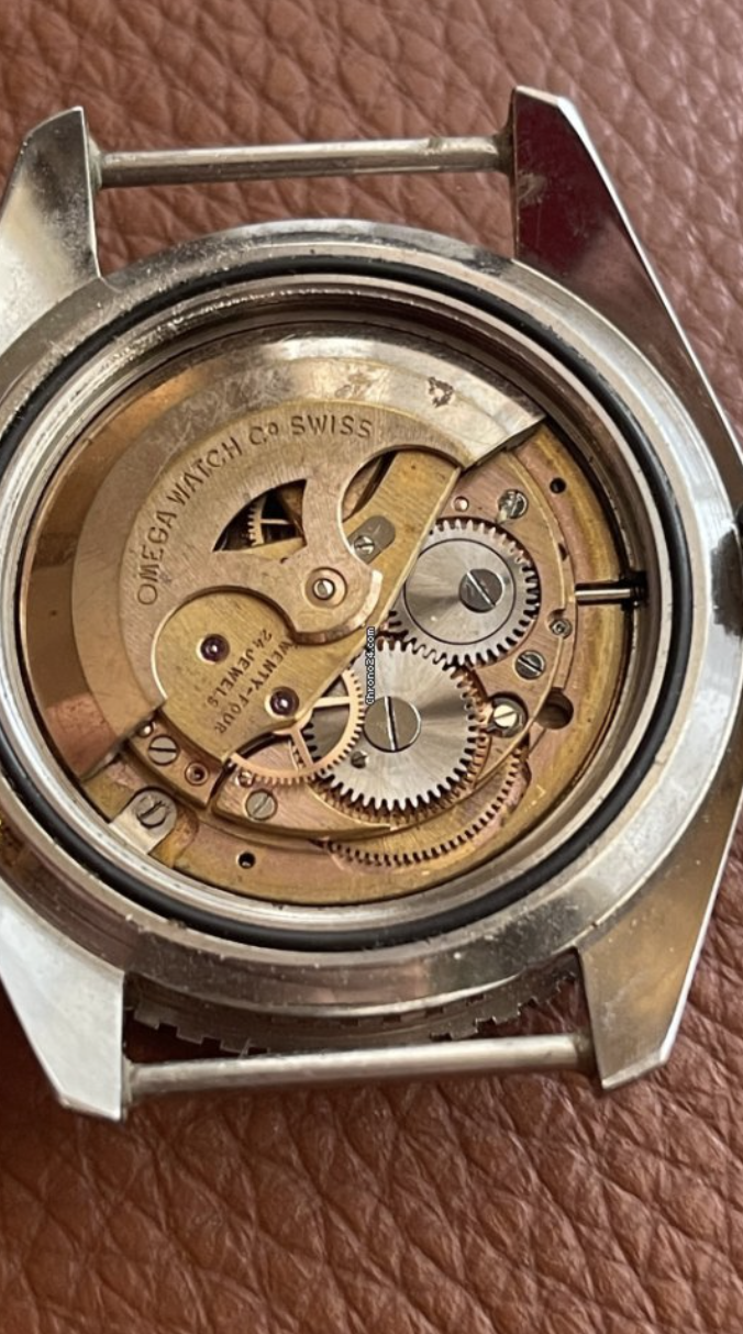

In conducting the most basic pre purchase due diligence, how is it possible that the OP (or his advisors) did not notice that this watch contains a caliber 562 movement. This movement is not only incorrect BUT contains a date wheel?????

Your last pictures show clearly, that the mil. Numbers are laser engraved. That was not done in the 70's. ...
I had to correct my previous post about the engraving is well done. It seems so at the 1st caseback picture, but the 2nd clearly indicates it as a fake. Though I am not sure if it is laser engraved, looks at least mechanically reworked or etched afterwords. However, it is rather bad made.

After re-reading all the OPs posts, I also have the impression that something is fishy about that whole story.
In the initial post he states he made his homework prior buying... that most of the watch was clearly authentic... and he just likes to know how much work is needed to get the watch in the correct condition.
Then he said he stumbled over the Phillips auction after I mentioned it and that he felt something was not right... but he did not say a word about that in his 1st post.
He said the stubbies were not visible at the pictures he received, but even a mole could spot them at the chrono24 pictures.
Finally, the mil engraving looks somehow different at the pictures from his "certified Omega watchmaker" compared to that from chrono24. Could be the light or angle, but all that does not match up.

Thanks to your expertise I now see how stupidly obvious this is (including the date wheel). But I didn’t pay attention to that.
