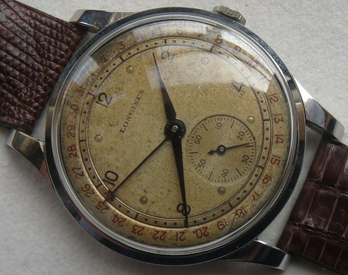

Agreed, it is a replacement. The original might look like one of the examples below.
Thanks, agree, the first watch should have the same case with downturned lugs from ca. 1945, I suppose, saw it some times in the forum. The second one has a typical military crown, so I believe the crown on the first one could be more correct to the watch. But nevermind, think the crown looks quite good in case of a replacement. I could live with that.

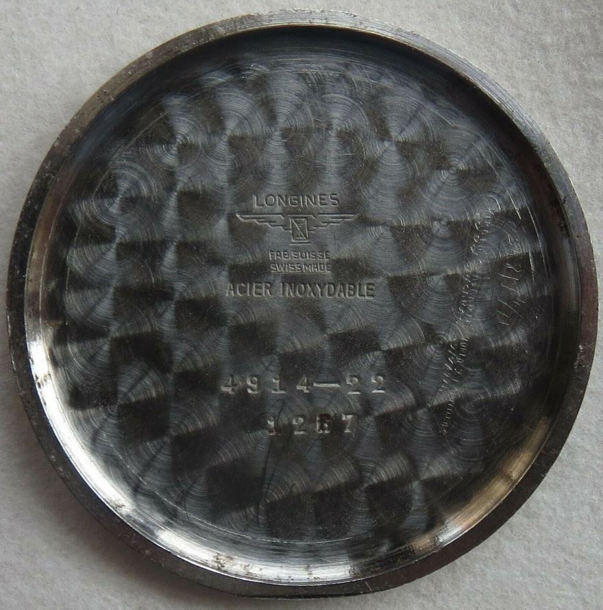

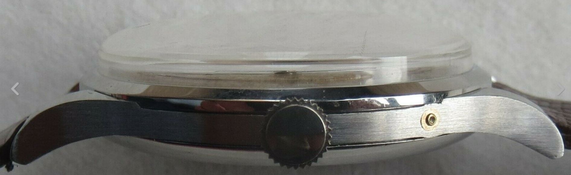

This one looks problematic as the number on the inside of the case back doesn’t appear to match that on the underside of the lug. Also quite over polished.

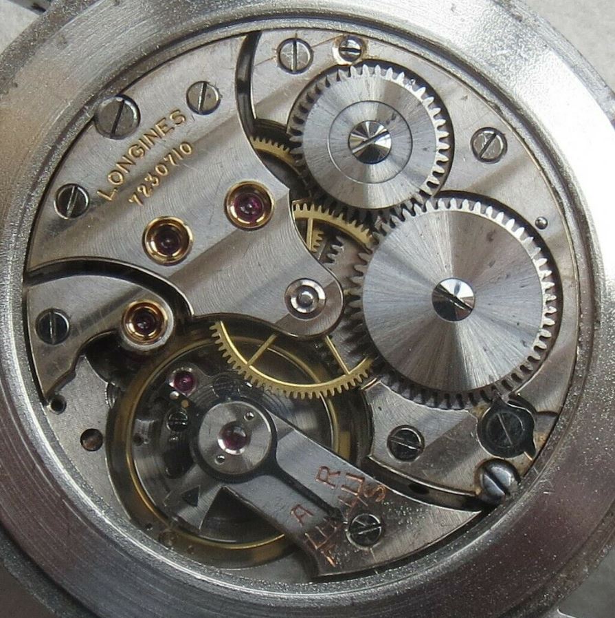

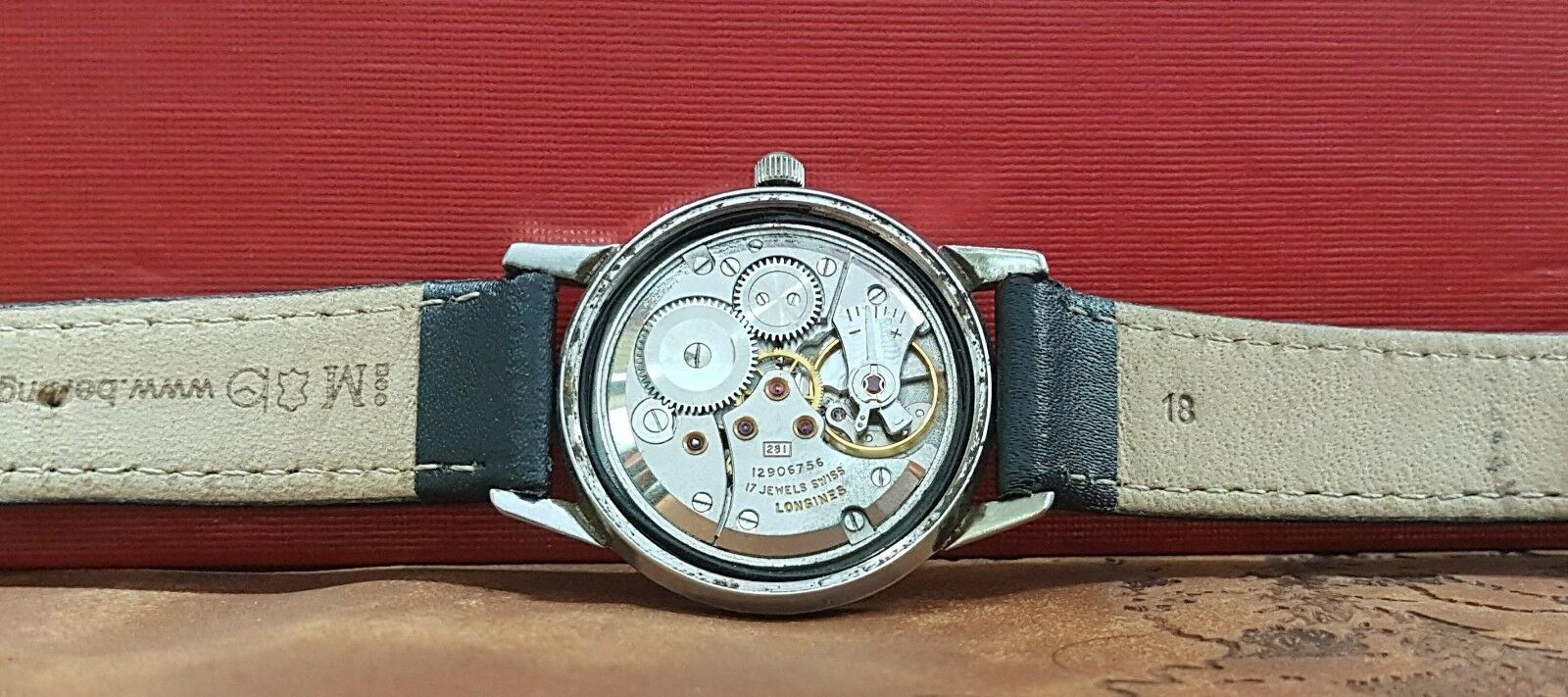

Below are different images of the same watch/movement, with the visible dial foot highlighted. Dial feet are prongs, which are on the back of the dial, that insert into holes in the movement for purposes of situation. Since most Longines of this era had dials that were primarily composed of brass, the dial feet should appear brass-toned. A white dial foot is usually the sign of a redial. However, not all redials present white dial feet.
Thanks for the information on this!

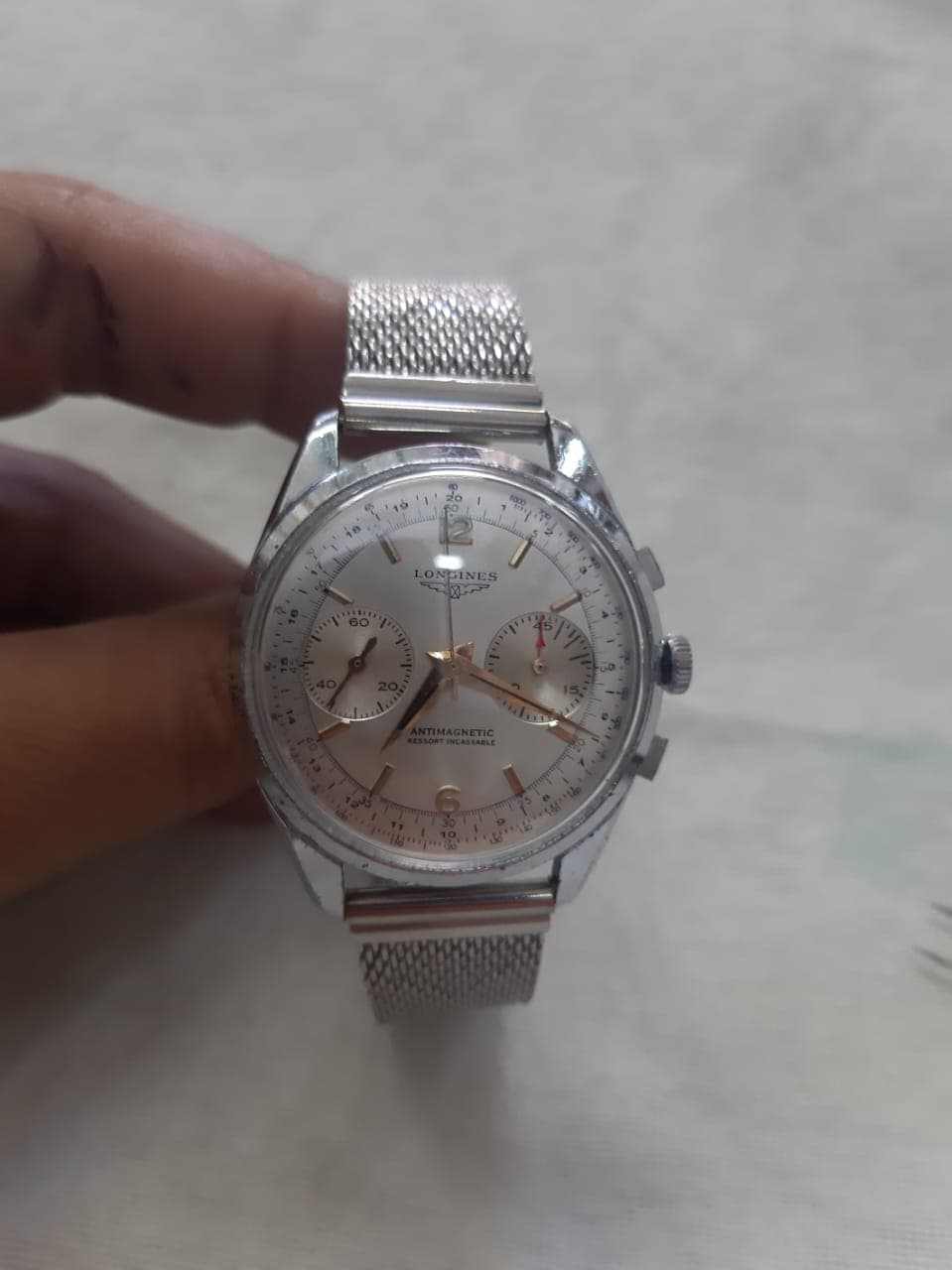

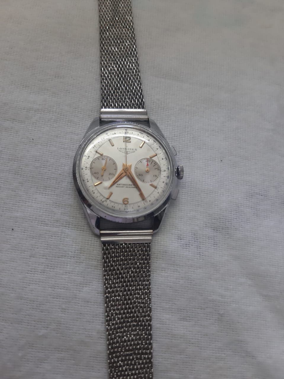

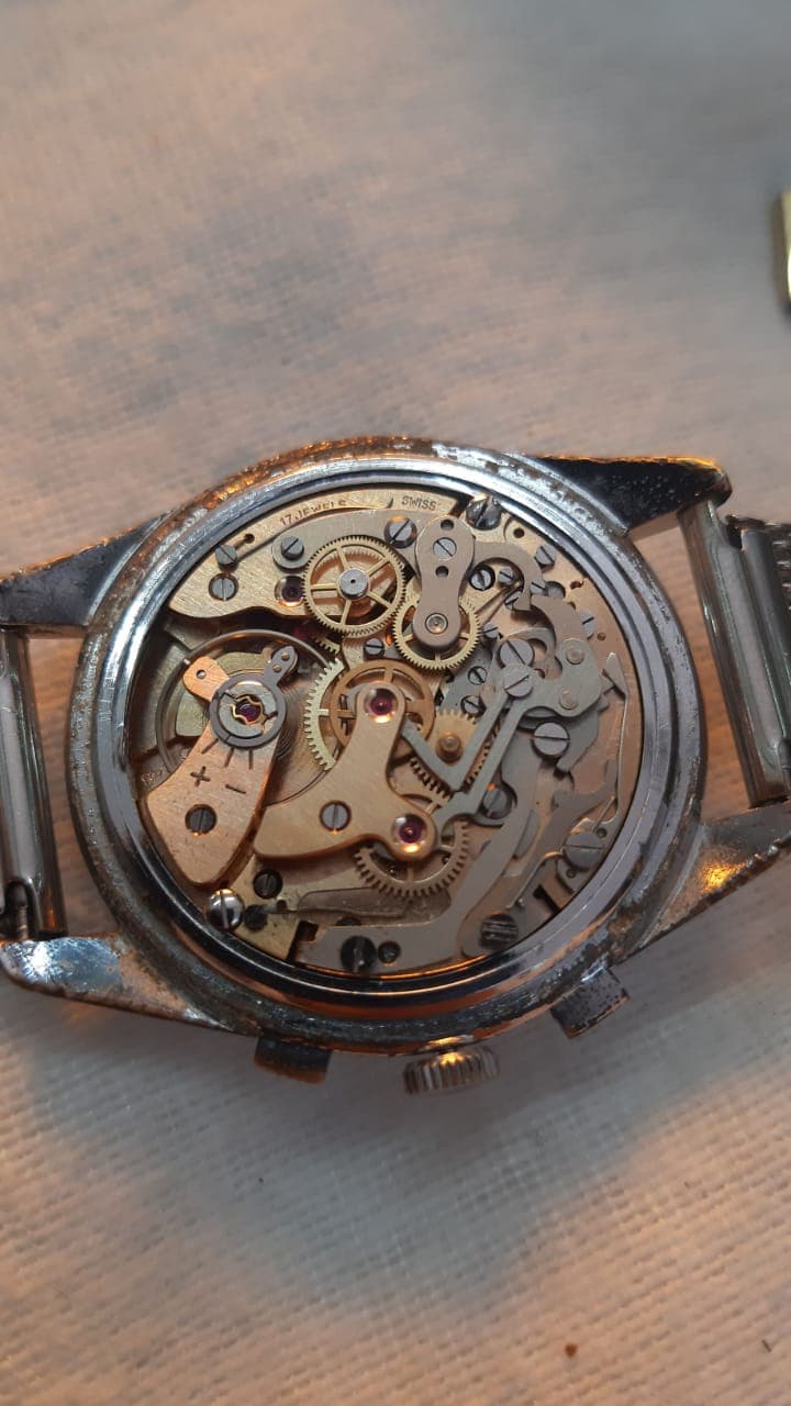

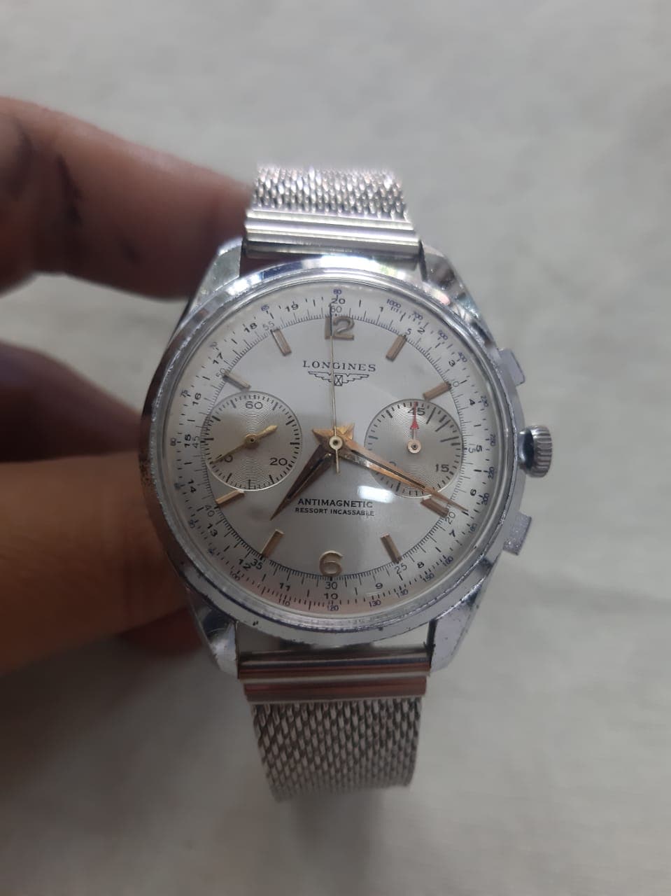

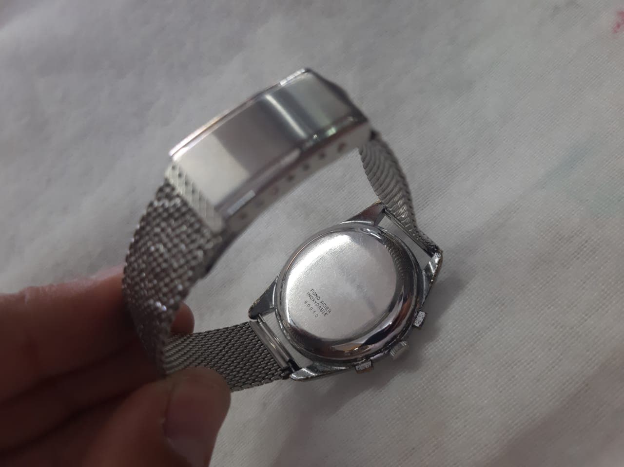

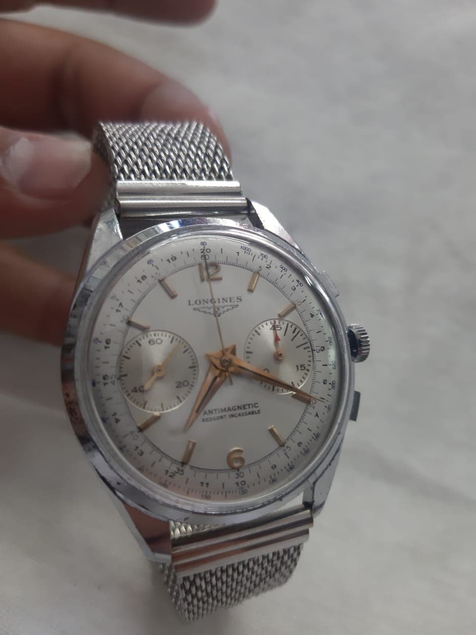

Hi guys, do you think you can help me out?, a friend of mine is selling me this longines at around $600 usd, but im not sure if it is refinished, i could not find any reference online about this pariticular model or the movement, any help will be appreciated. thank you!
2,251
15,687
What a nice "friend" you got!
24,263
54,031
Landeron 148 movement in a Longines? Total fake.
4
Thats what I was thinking, but I couldnt find what the movement was, Thanks

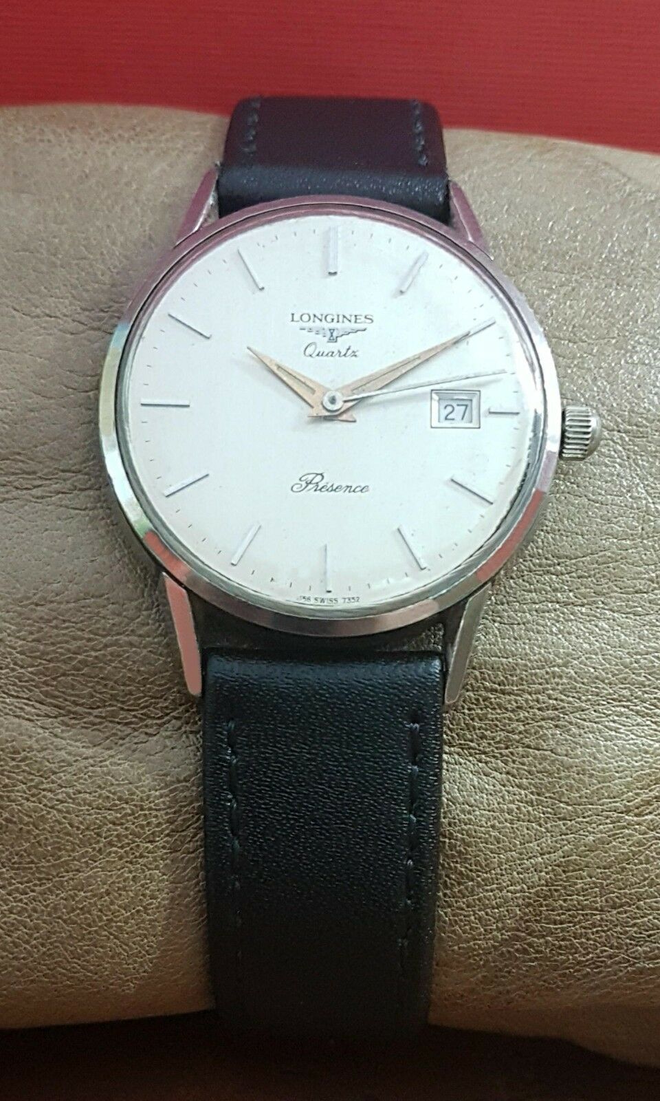

Longines... "Quartz" on the dial and a manual hand-wound movement?
Surely the dial is changed.
1,443
3,810
Looks like a 90s Longines dial with wrong hands for that dial as well
