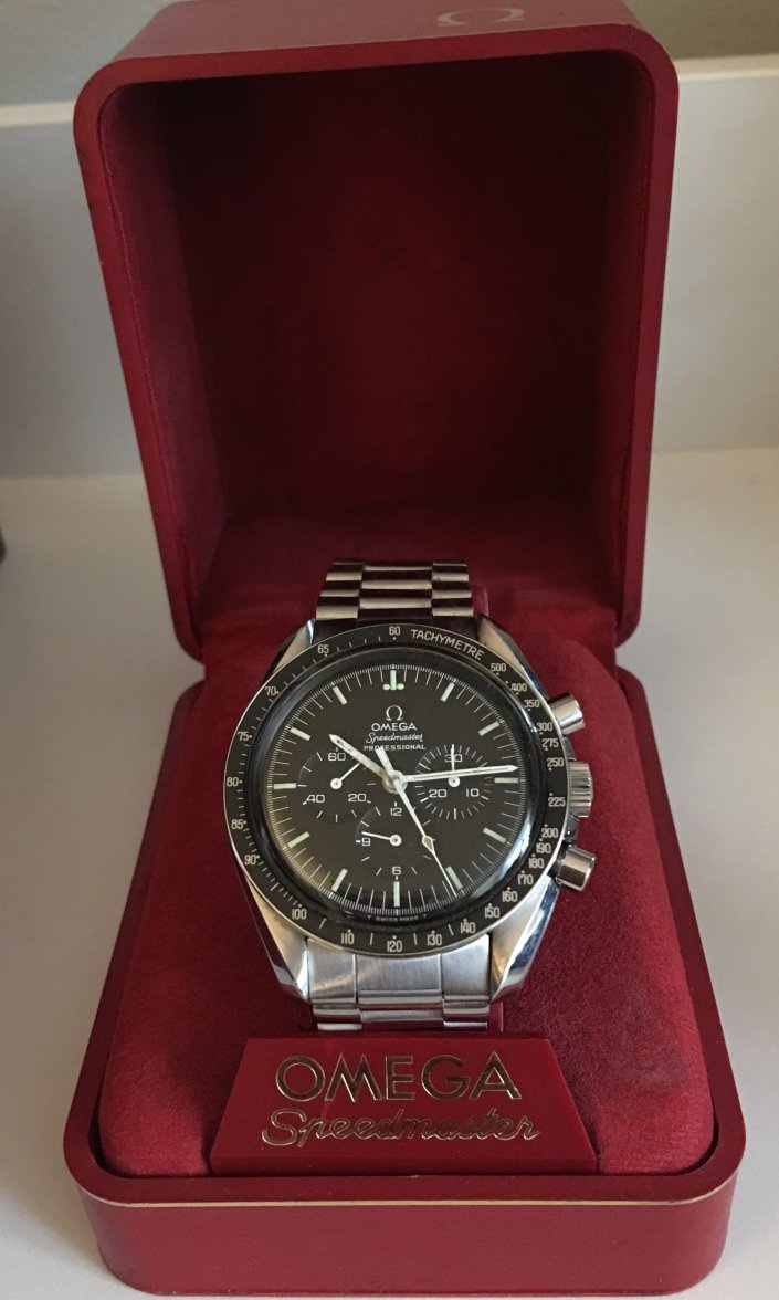

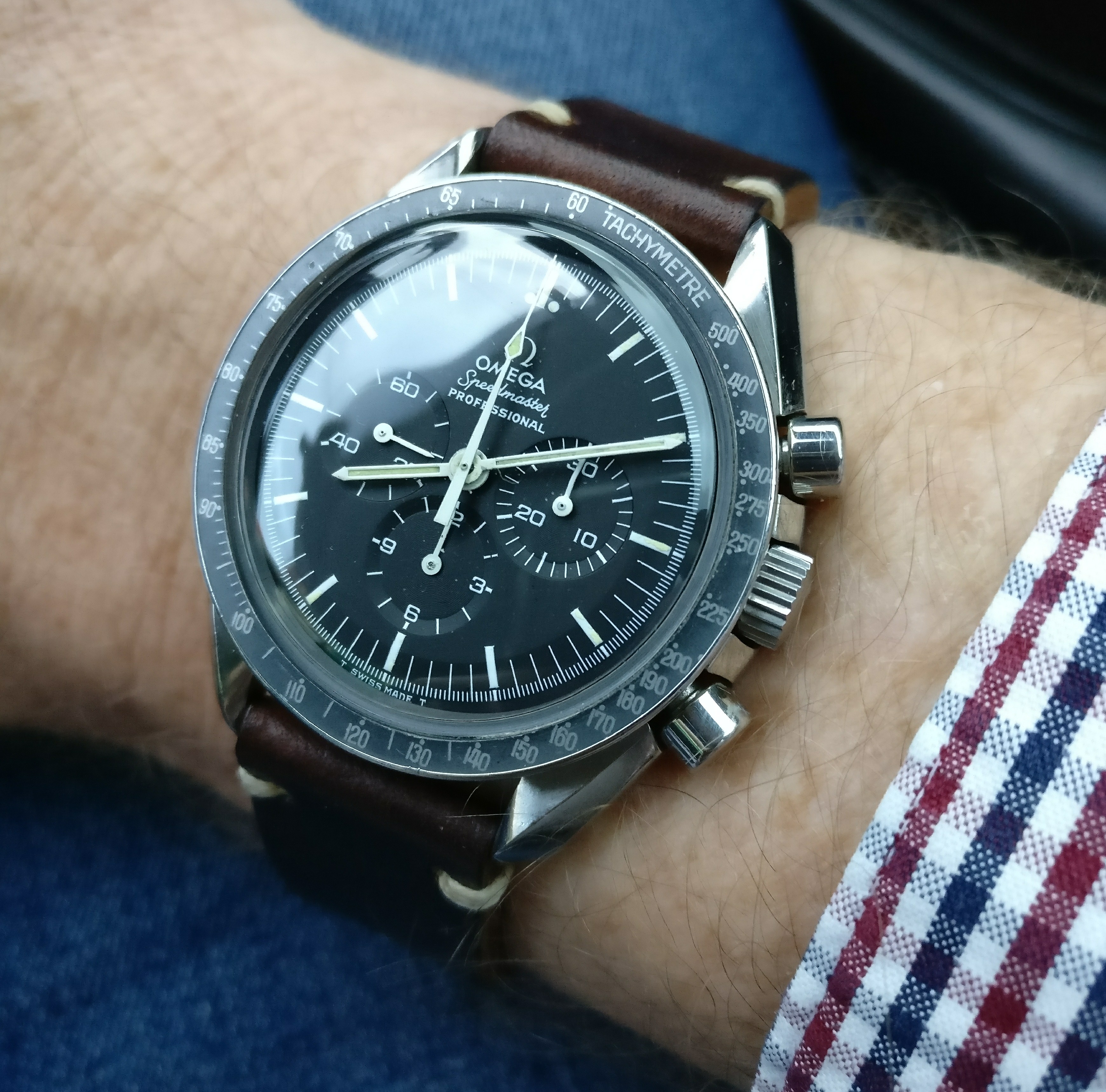

    Here is one I took when I got it...

    Because threads need pictures, here's my 145022-74 which is also in the early 31x range
