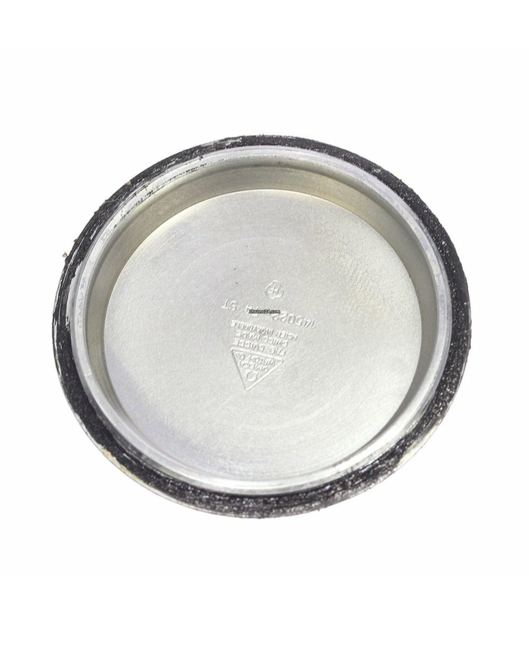

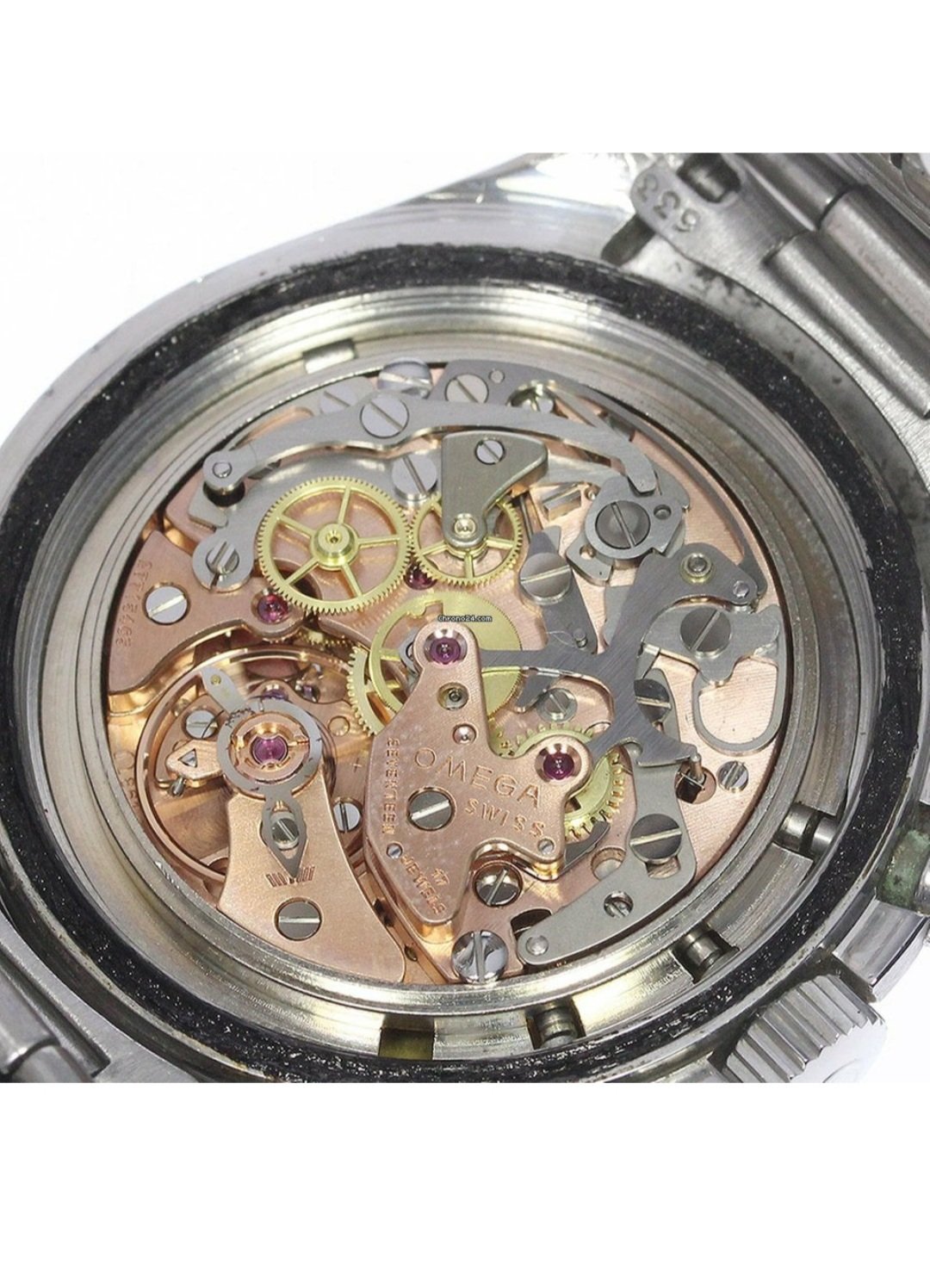

Sure, I'll post them right away.
The photos are not of good quality but they are the only ones I have, taken directly from the seller's advertisement
3
The quality of the photos is bad and the resolution is even worse when I posted them here on the forum, but the serial starts with 277
