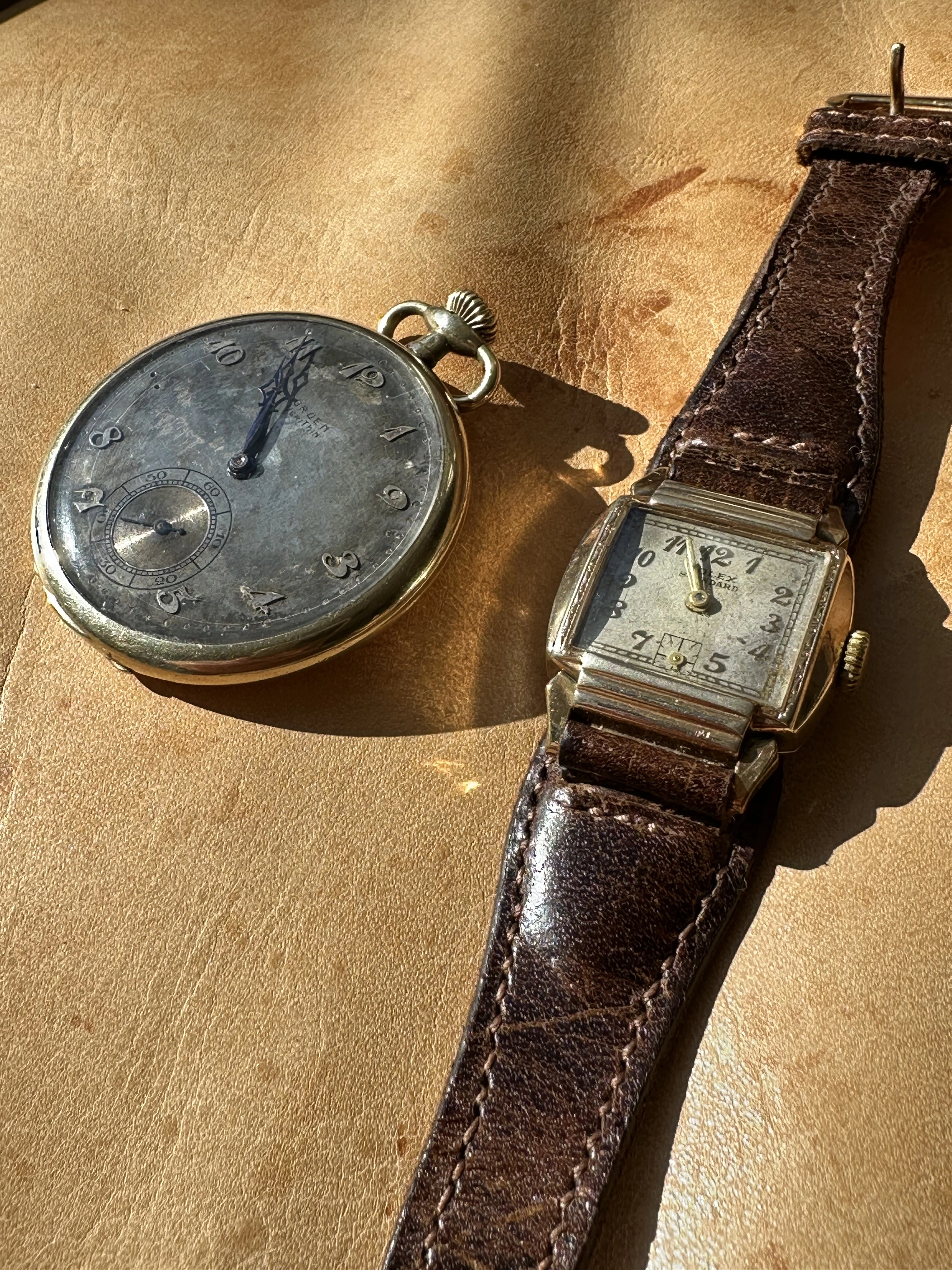

1950s gilt dial Benrus aged to a beautiful chocolate brown on the Kestenmade stretch that it's been on for who knows how long:
