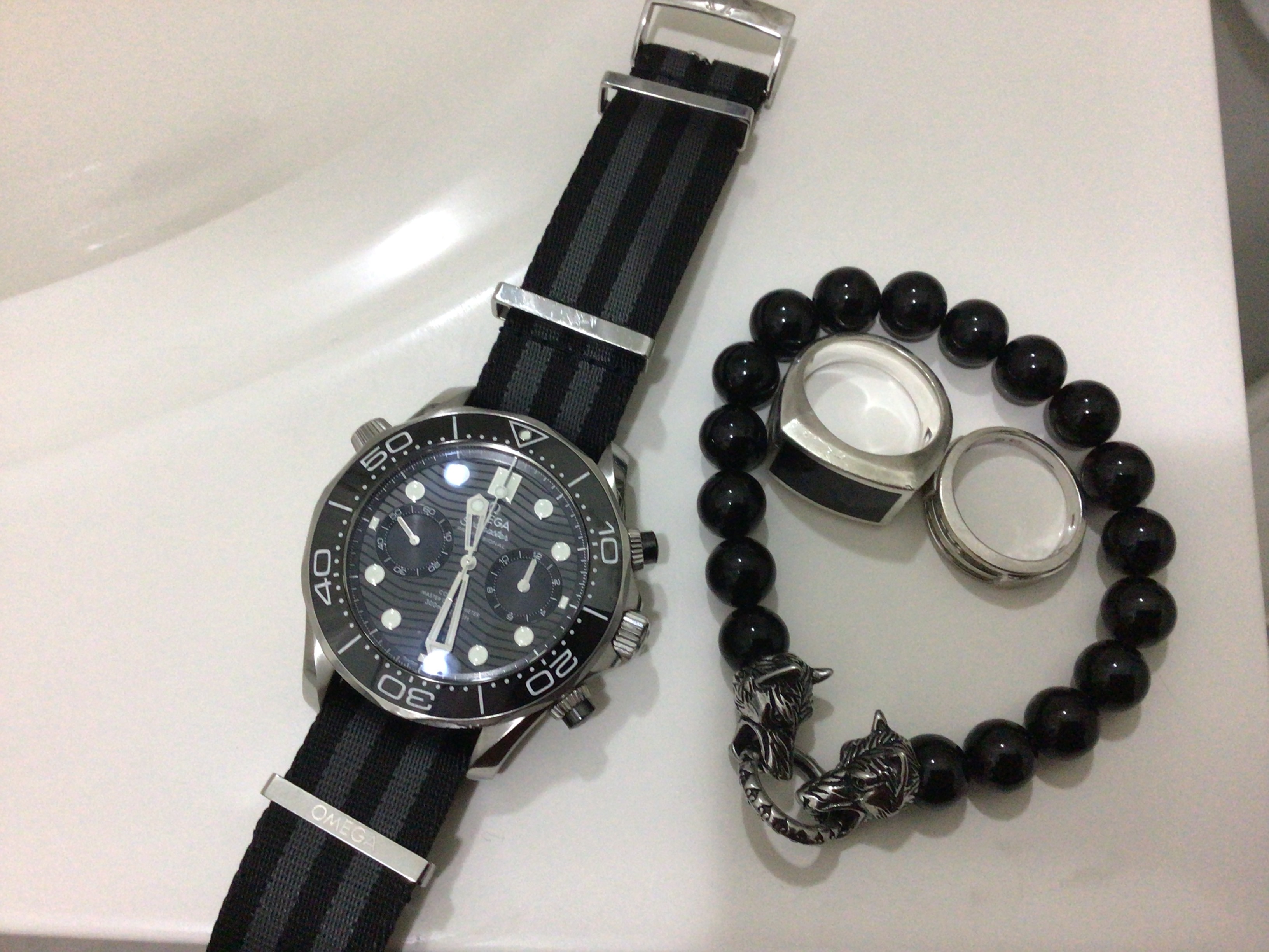

I wear my wedding ring in one hand with my watch and on the other one onyx ring and bracelet to match the black in my seamaster. Do you guys think I took it too far? I recently got the nato strap for the summer months. I felt like I just got a new watch when I exchanged the regular bracelet for the nato.

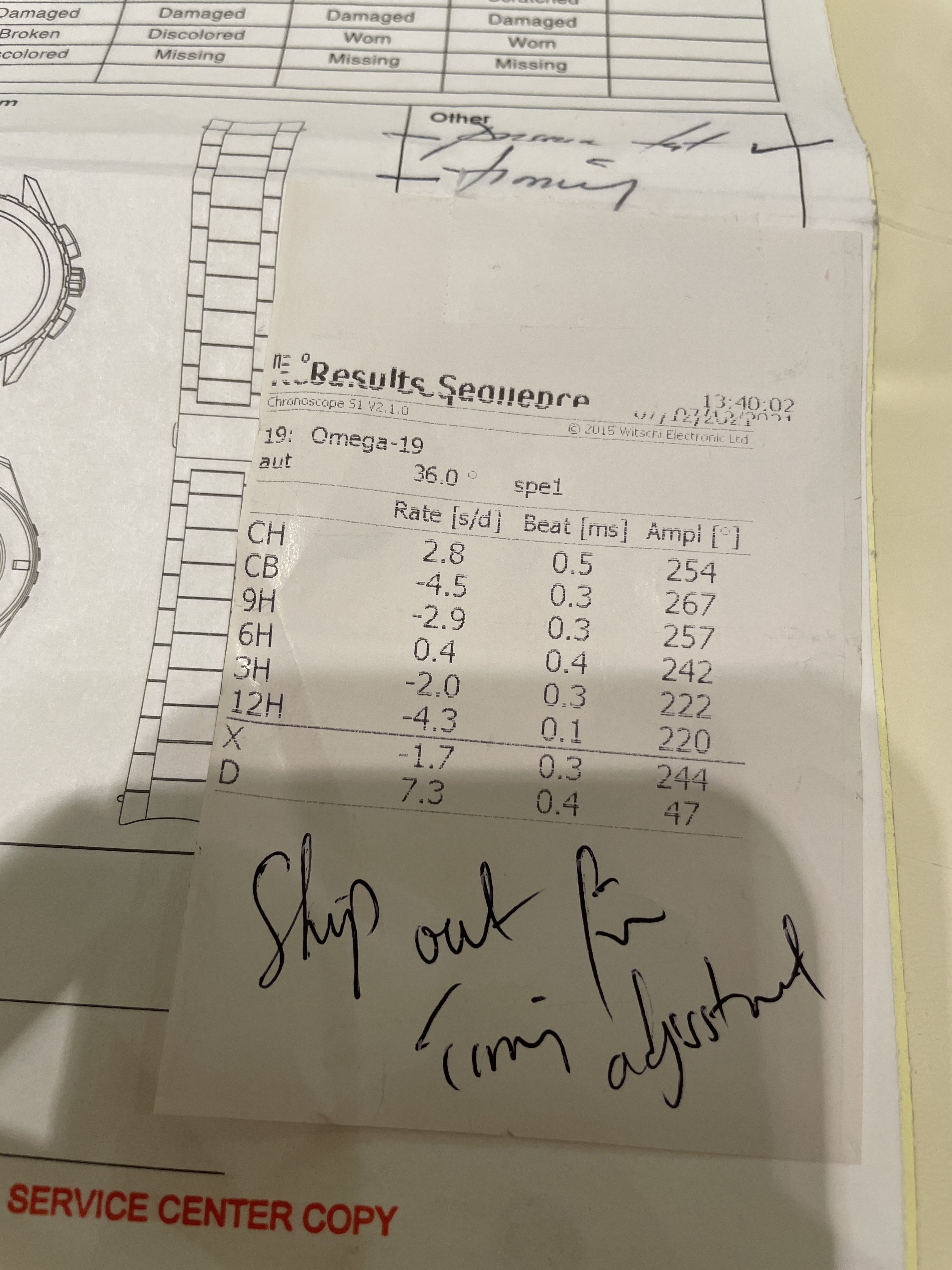

I’ve got one that is suddenly losing time after consistently being +0.5 to 1 sec/day for 10 months. Posted details in link below to thread. Don’t know what would cause it as the watch has not been dropped, hit, or suffered any shock.
https://omegaforums.net/threads/seamaster-diver-caliber-8800-accuracy-issues.134123/
@Archer curious if you could offer any insight as to my above post from July. On Monday, I received watch back from omega boutique after it was sent away for service and watch now appears to run perfectly like when I first got it, +2/day and not losing time overnight. Did not receive any old parts back with watch or any other papers or documentation indicating what they did to watch. Just wondering if the watch gradually slowing down again despite no intervening event/shock/damage is something to expect with this movement again after 8-12 months. Know you’ve commented on tolerances of 8800 not being as tight as those of other omega movements. Thanks in advance!

For warranty repairs, parts are not always returned.
No real reason why it should slow down.
