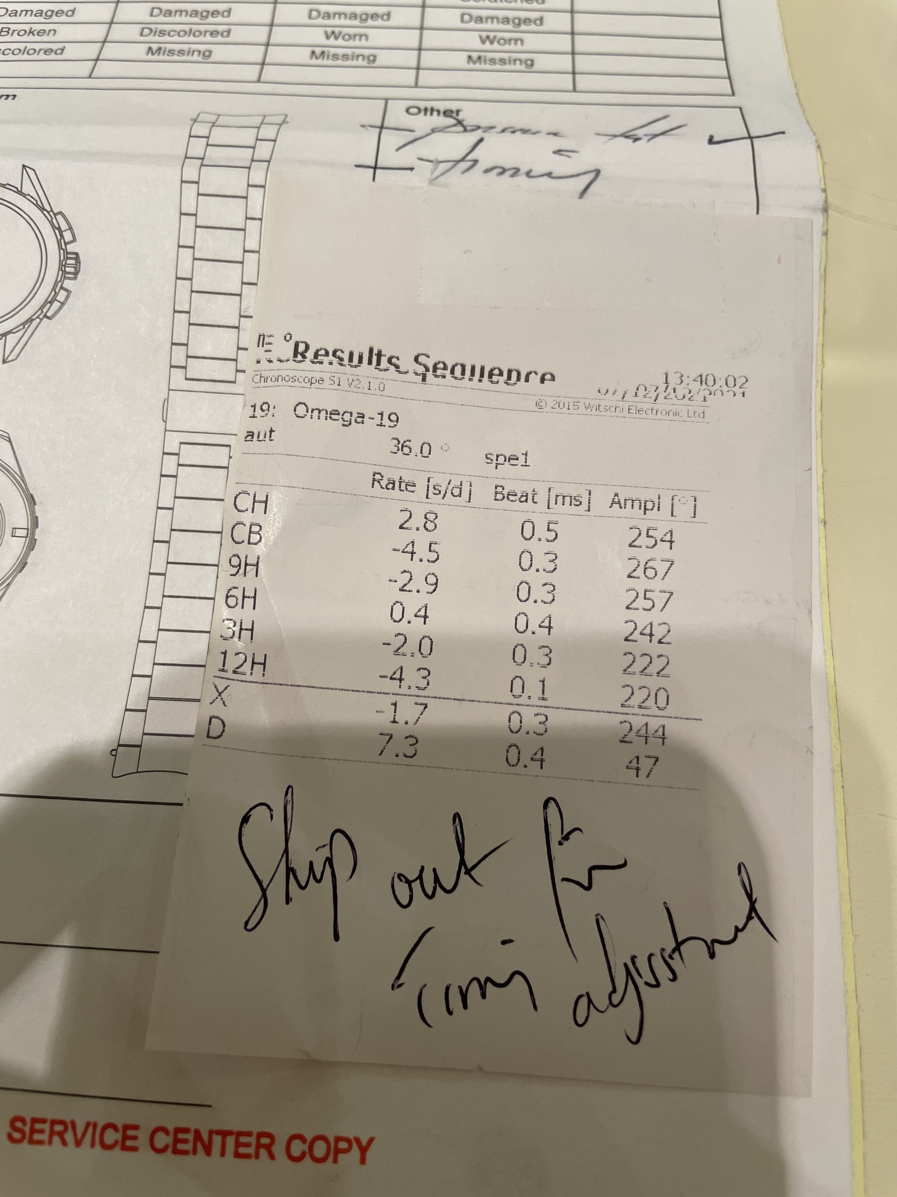

I had an issue with my omega seamaster cal 8800 and was hoping people here could shed some light for me since they’re more knowledgeable on the topic.
I attached a copy of omega boutique’s timegrapher results from yesterday. Appears to be averaging -1.7 sec. I got the watch August 2020 and it performed well until May of this year, when it started suddenly losing time (-4 to -5 sec/day. Before May and under the same usage conditions, it was gaining 0.5 to 1 sec/day, resting dial up overnight. I had no drops, sudden shocks or any other damaging events that preceded the sudden accuracy change. I took it to omega last week after a month of seeing that the loss was consistent. Yesterday they called and told me the tech said to send it away for a full service after putting it on the timegrapher.
Is there any information people can glean from the timegrapher results? Any insight as to what could possibly cause a sudden swing in accuracy without any drop or impact? I will add it started performing this way in May during a trip to Cancun when I used the watch in water for first time. Crown was always screwed down and I never noticed any sign of water intrusion. Took it through airport security and I know watch is antimagnetic up to 15000 gauss. Didn’t think either of these things should have any effect.
Omega employee told me he didn’t know what the timegrapher results meant and I never spoke to the tech. I’d appreciate any knowledge people here could share.

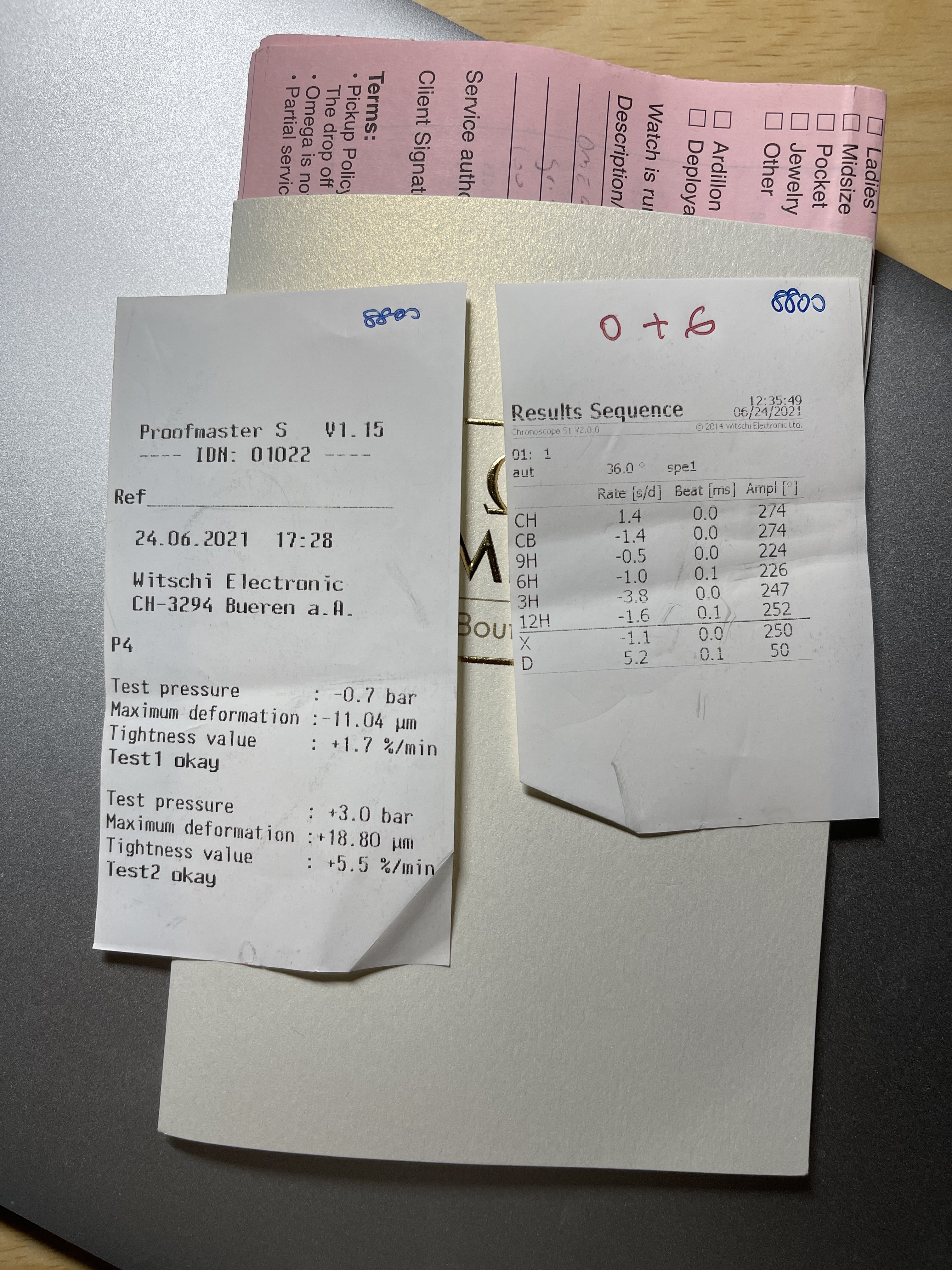

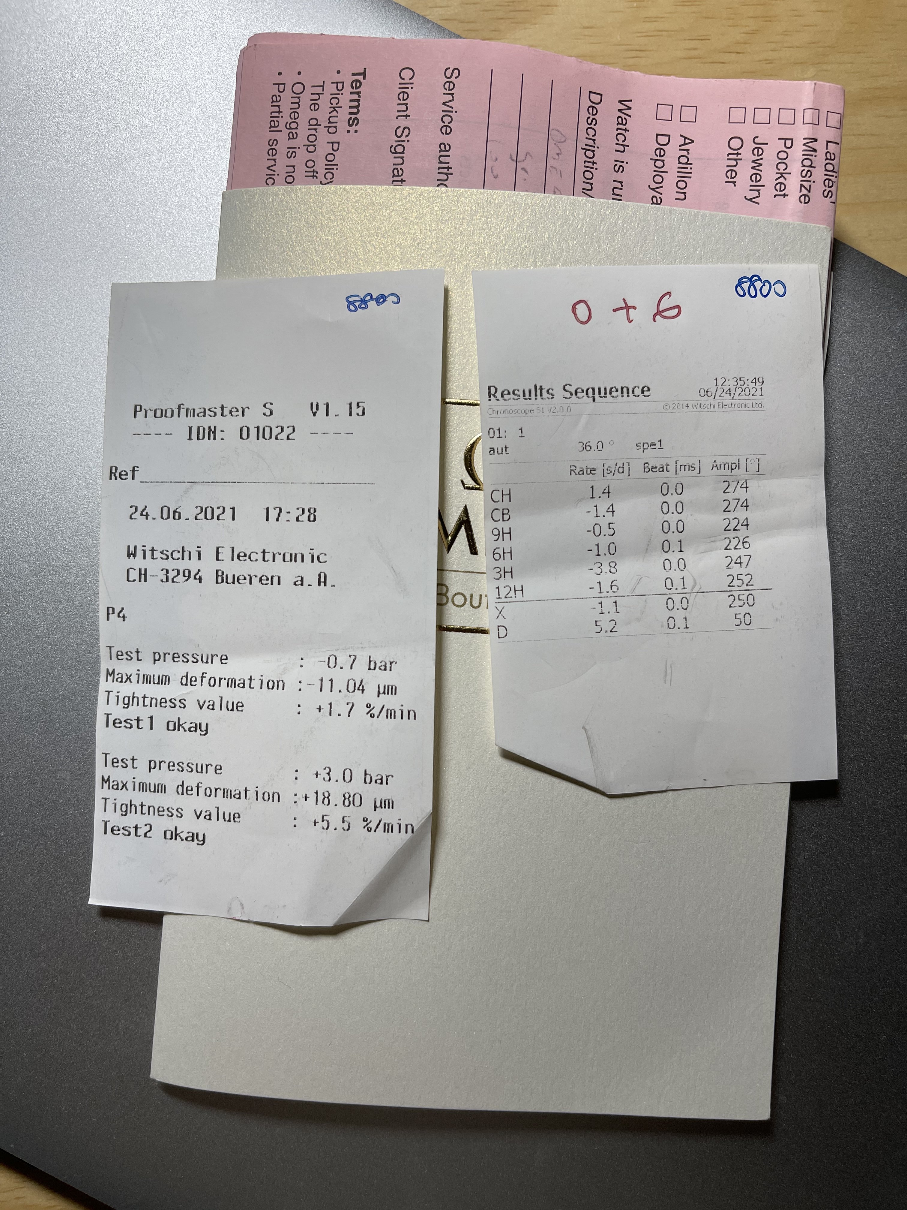

Here are my results - I actually forgot what the tech told me but I’m sure there are members here that can interpret the numbers well.

It seems odd that in both watches two of the vertical positions (9H and 6H for the second one, 3H and 12H for the first one) have significantly lower amplitude. Or maybe that's normal for this movement; no idea.
Your guess is as good as mine and now, I’m very curious.
