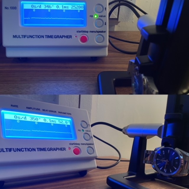

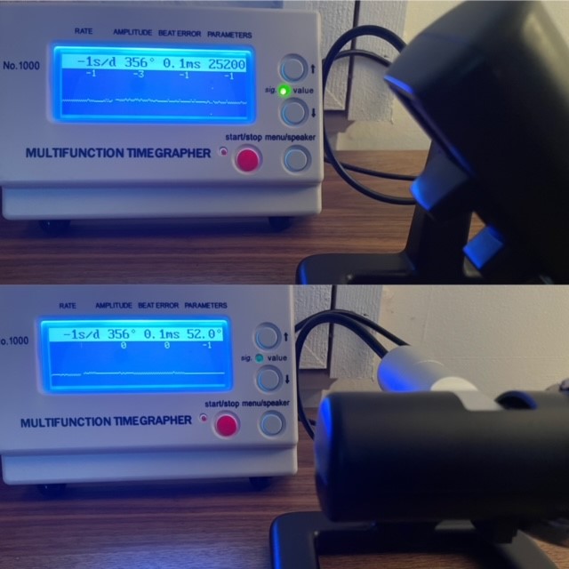

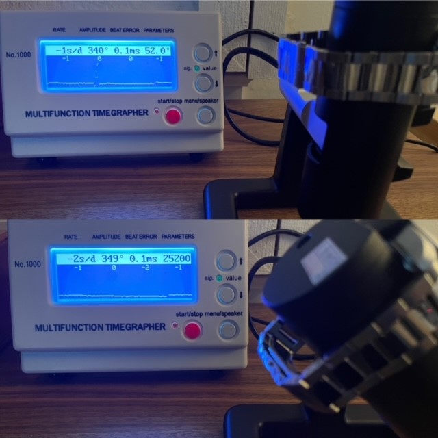

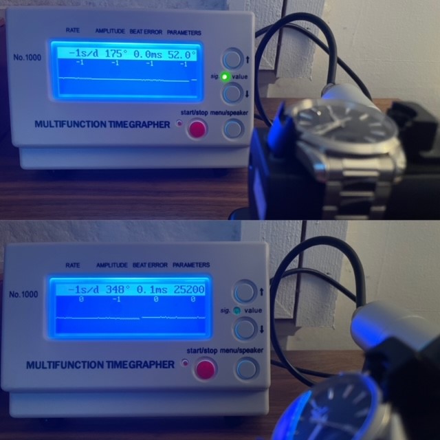

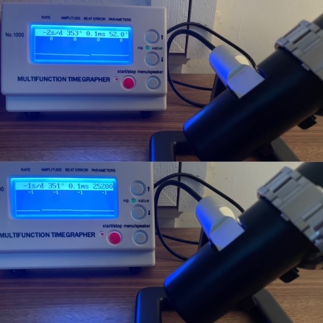

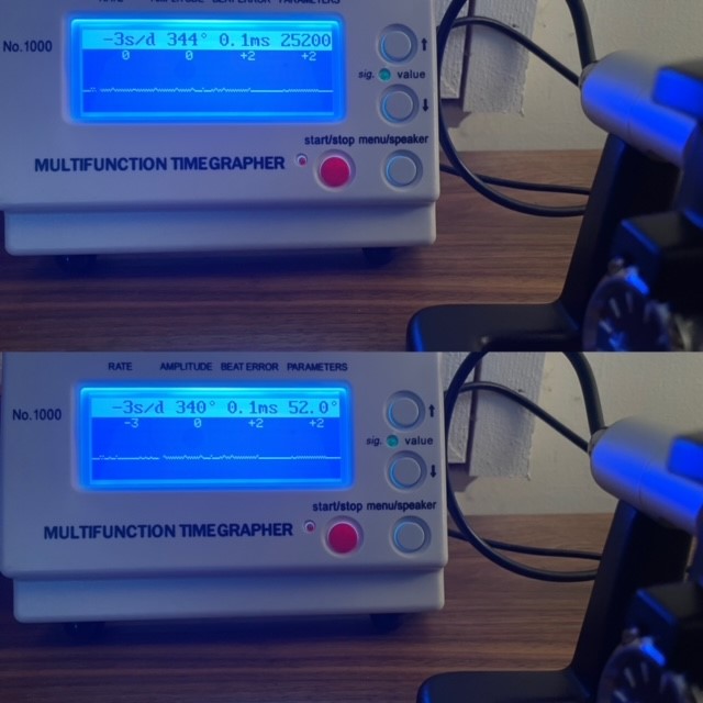

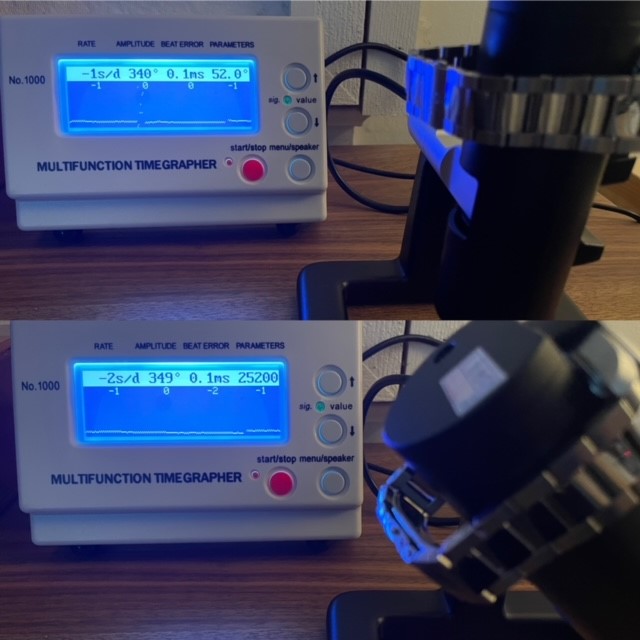

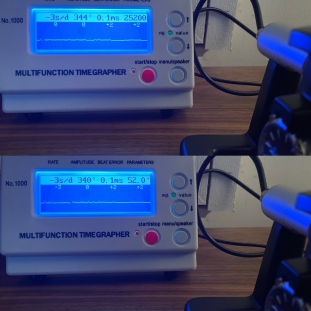

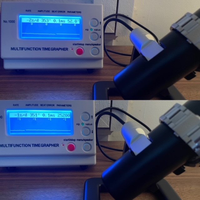

My new (December 2022) Aqua Terra 38mm with the 8800 loses about 1 to 3 seconds per day. I've confirmed it with a timegrapher. I have a Speedmaster 38 with a 3330 movement that's "only" COSC spec and it gains no more than 1 - 2 seconds per day, which is easier to live with. The Aqua Terra is supposed to be more accurate, but it's actually less. It's a gorgeous watch, and I realize 1-3 seconds per day isn't a lot, but it's disappointing to buy something that's marketed on its supposed accuracy, only to discover that it's not. At least not out of the box. Hopefully the watch can be regulated to err on the side of slight gains rather than regular slight losses.

Please post timing over 6 positions at full wind...

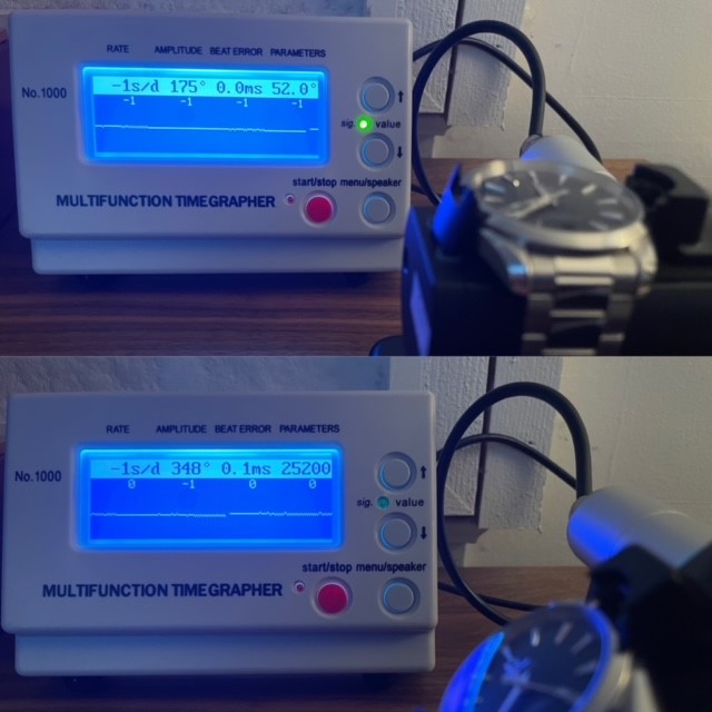

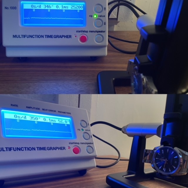

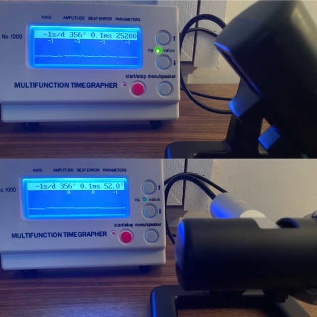

You can see in the last position, crown=up, the watch loses no seconds in this test. I wear my watch on the left arm, so even if I rest the watch crown=up at night, it doesn't spend enough time during the day to keep from losing time.

Although some of the positions you show this in are not standard positions that are checked, it does appear the average is likely a bit slow - should be ale to get this regulated a bit faster.
