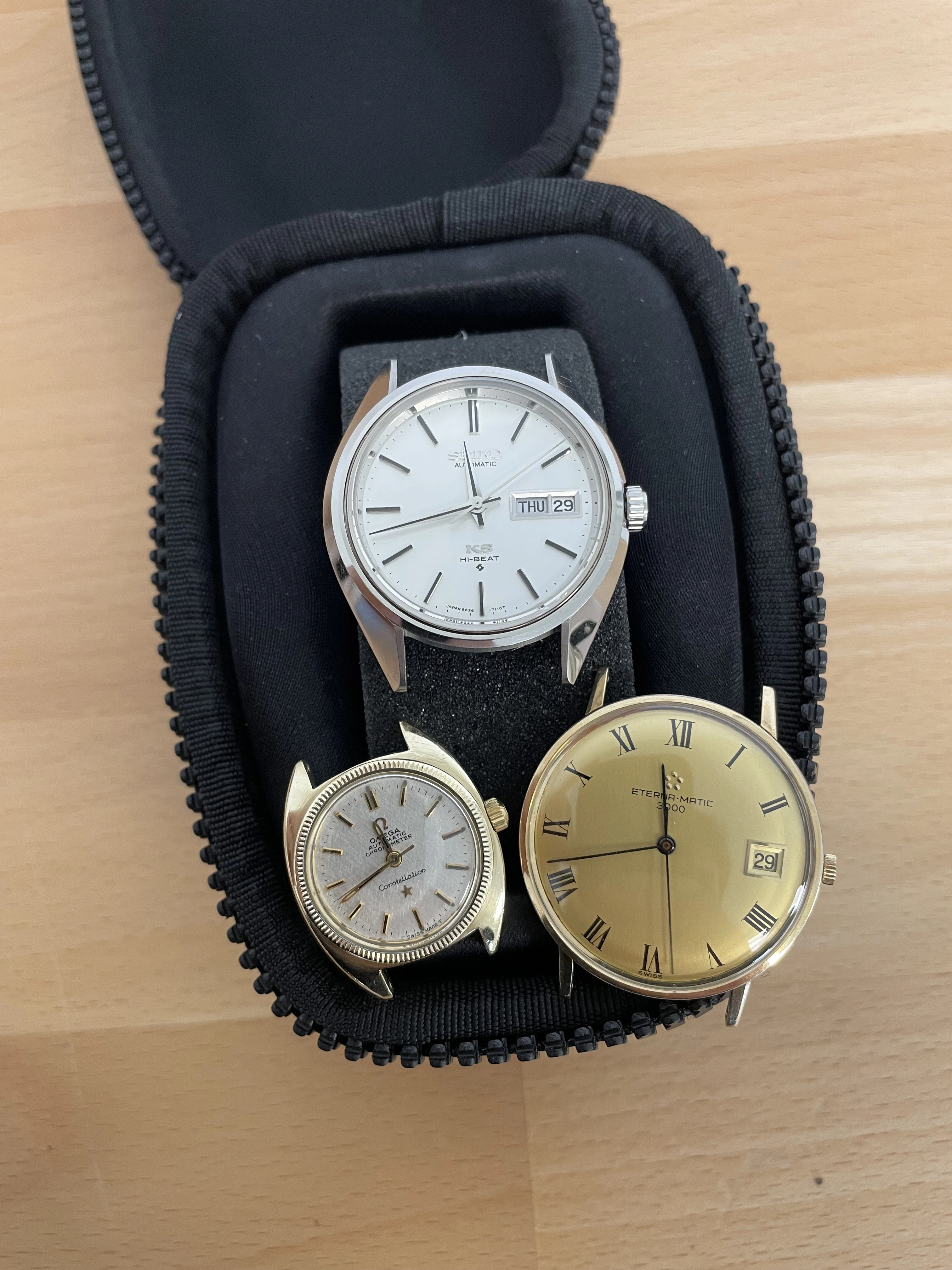

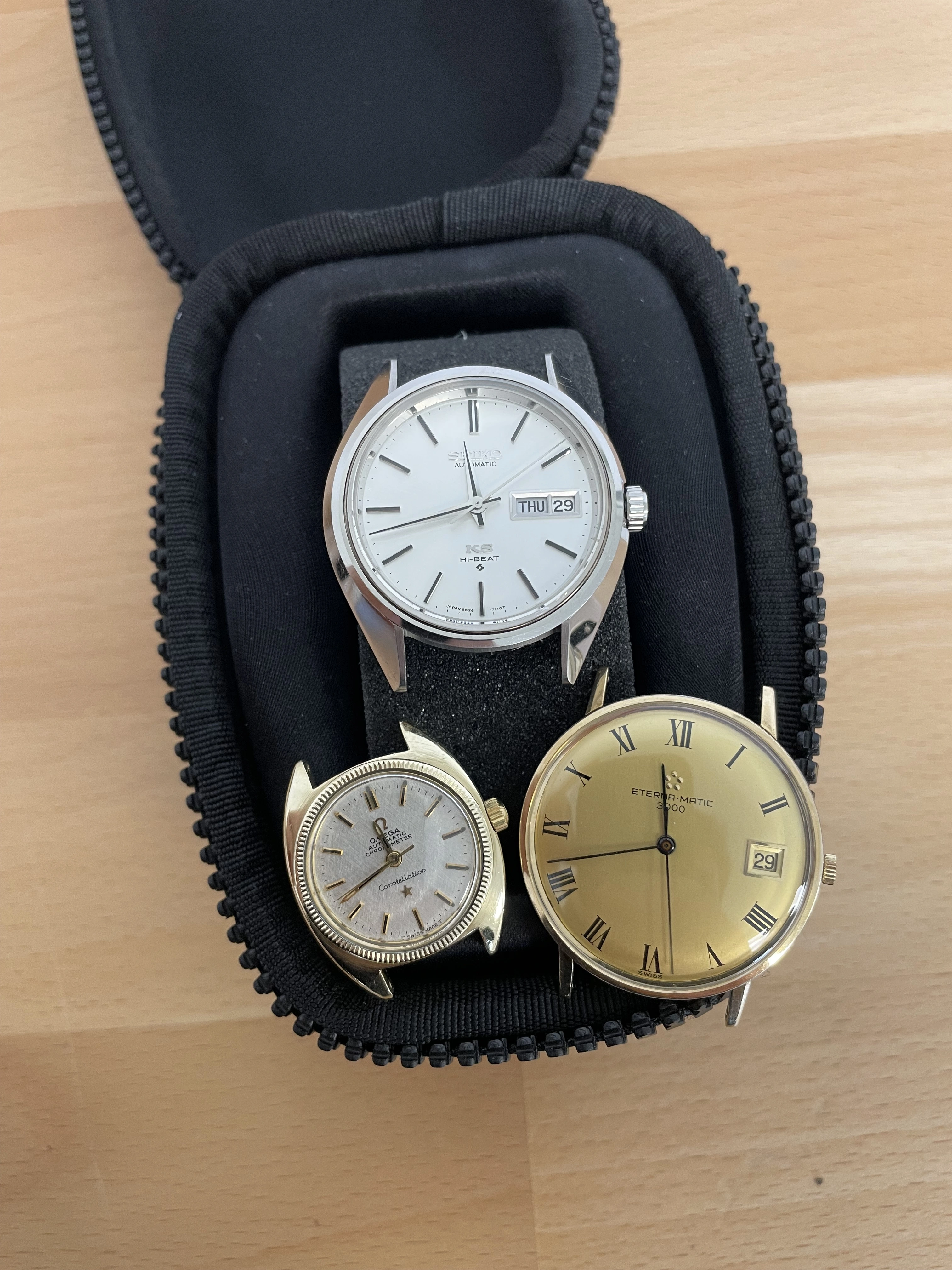

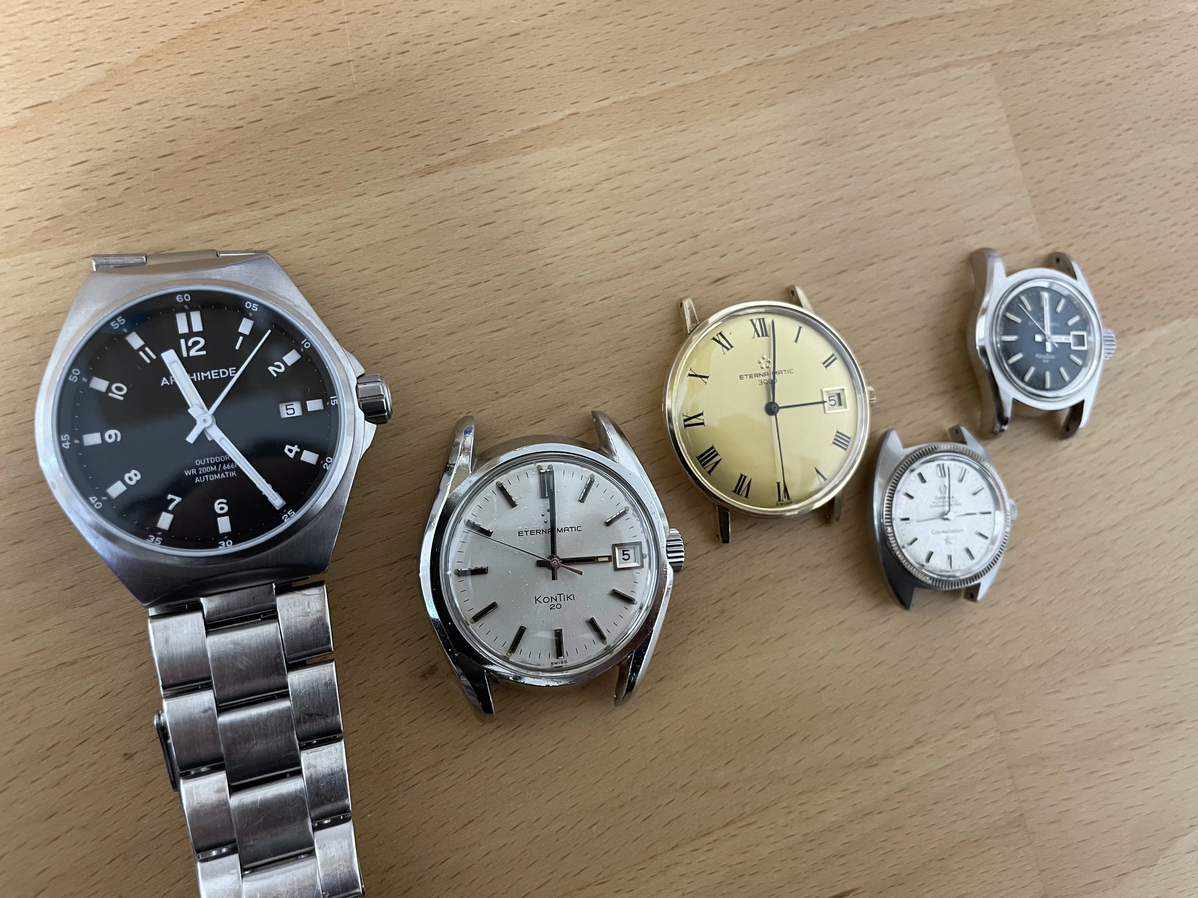

3 being tested after a service.

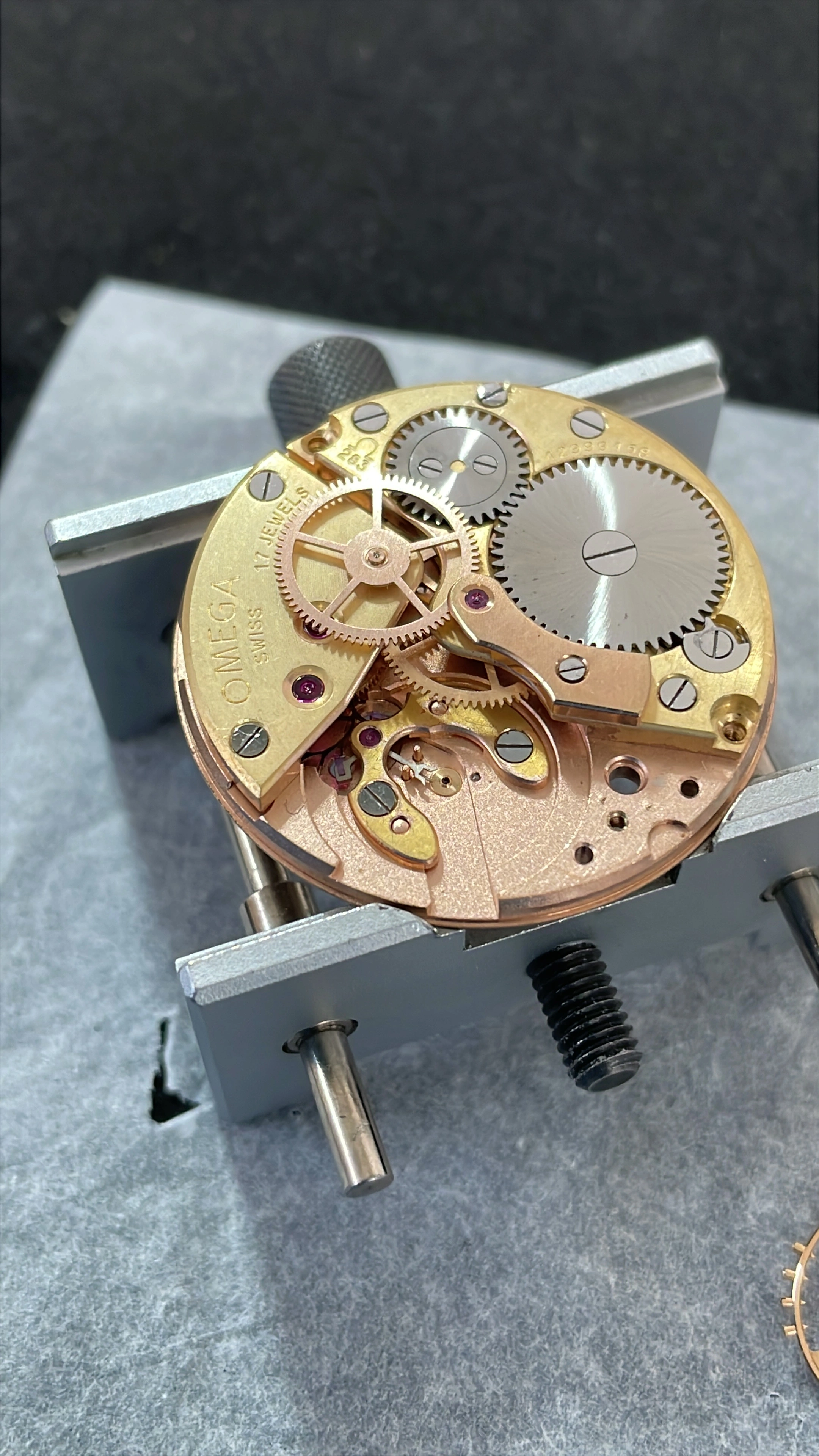

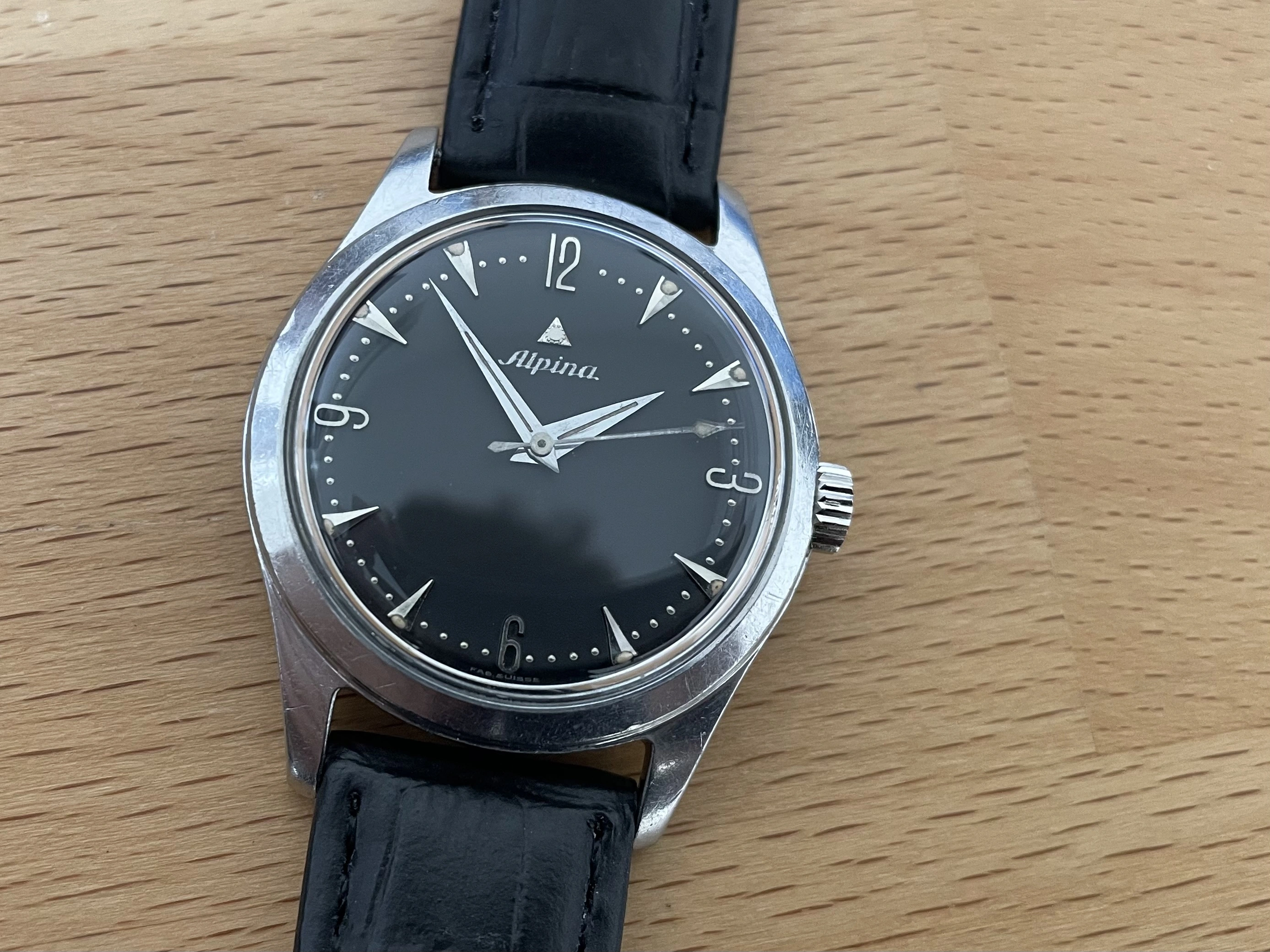

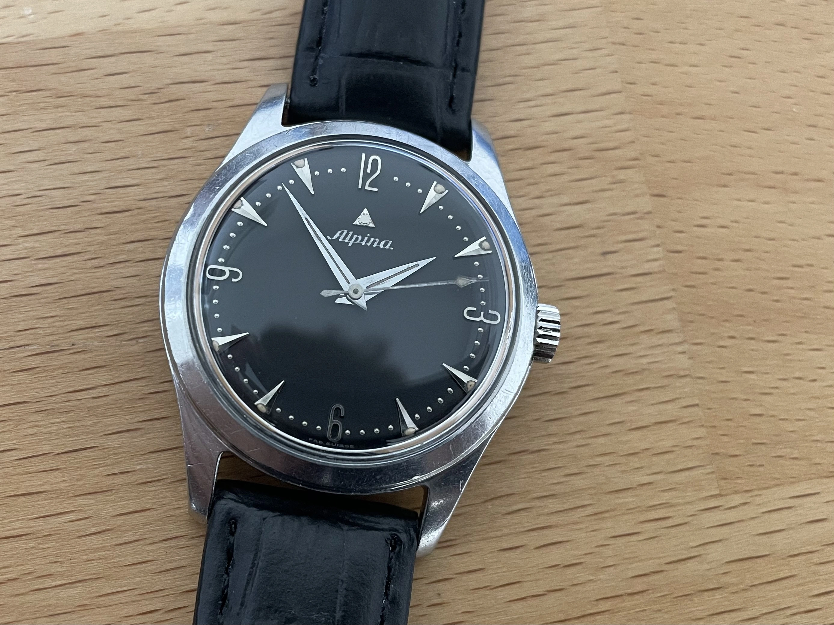

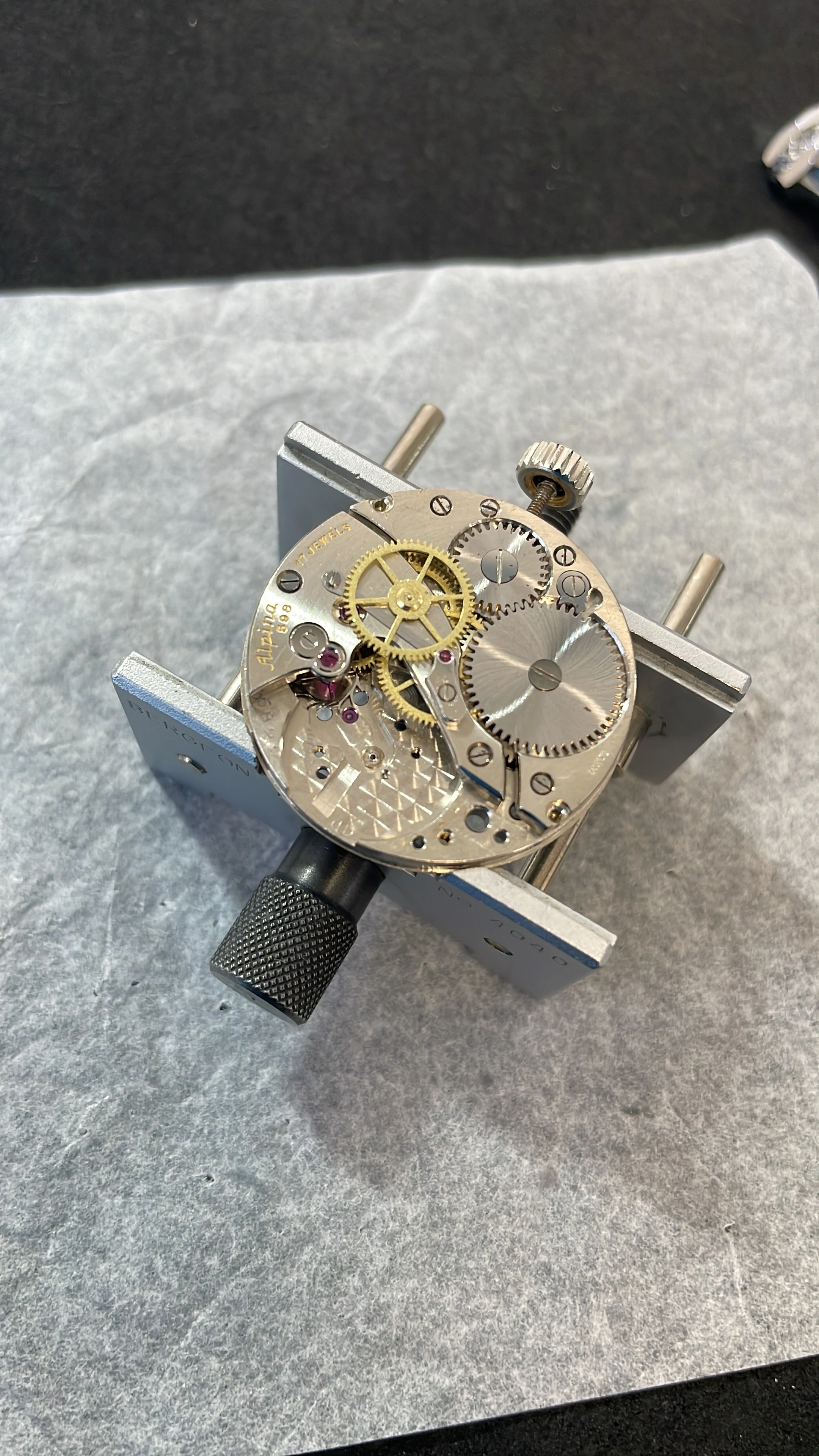

Little extra work on a Alpina 598 new barrel bushing and balance staff, but what a lovely watch.

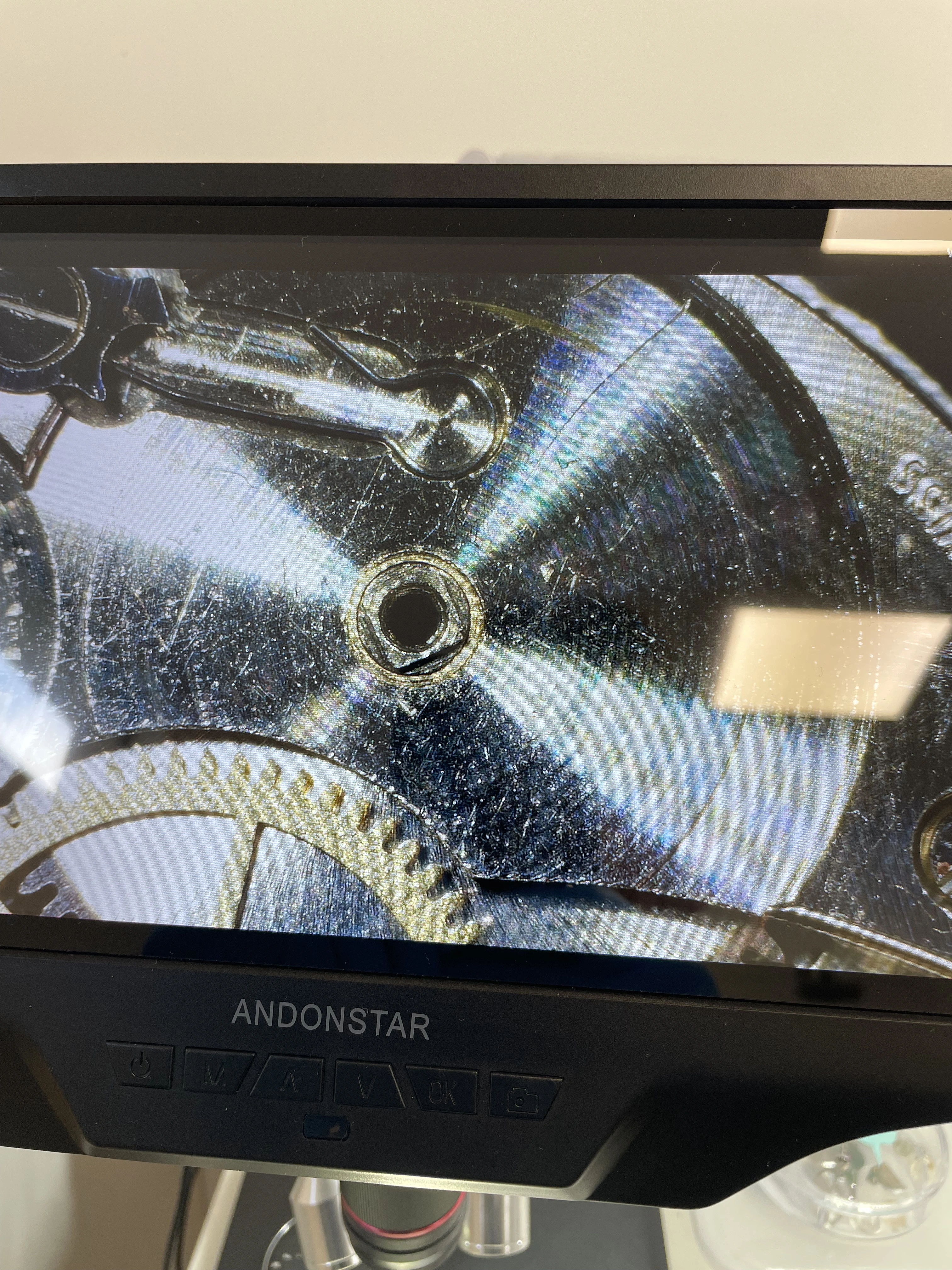

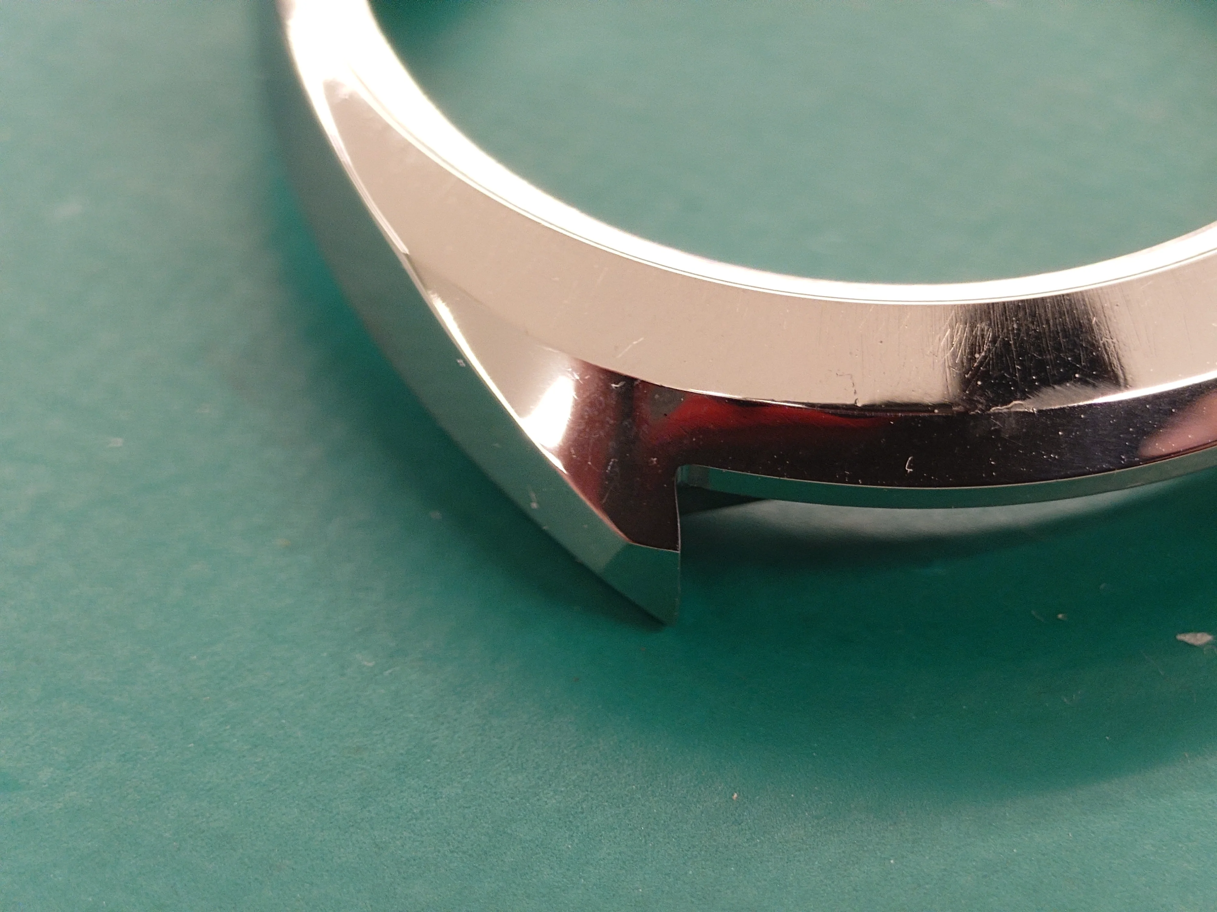

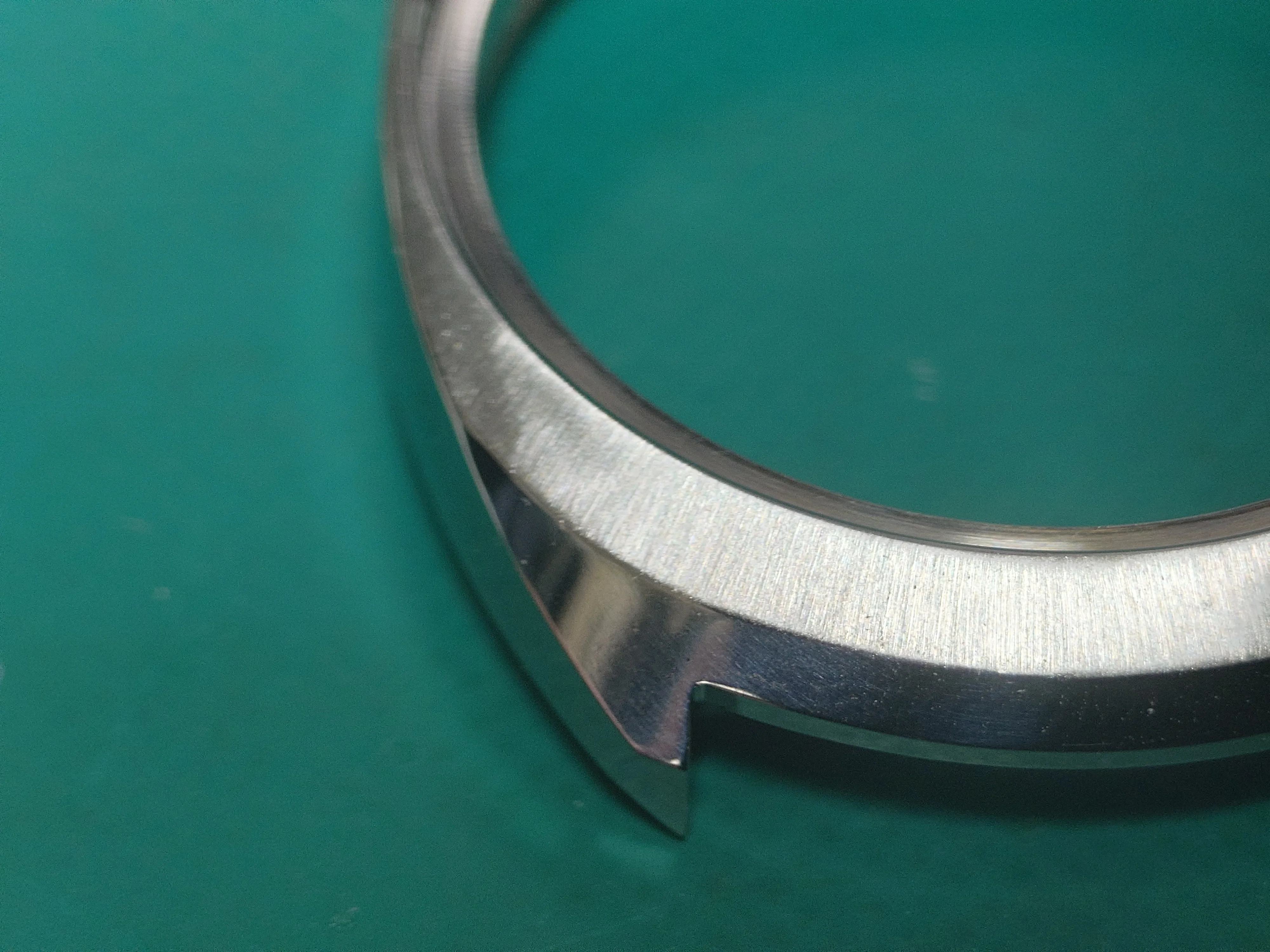

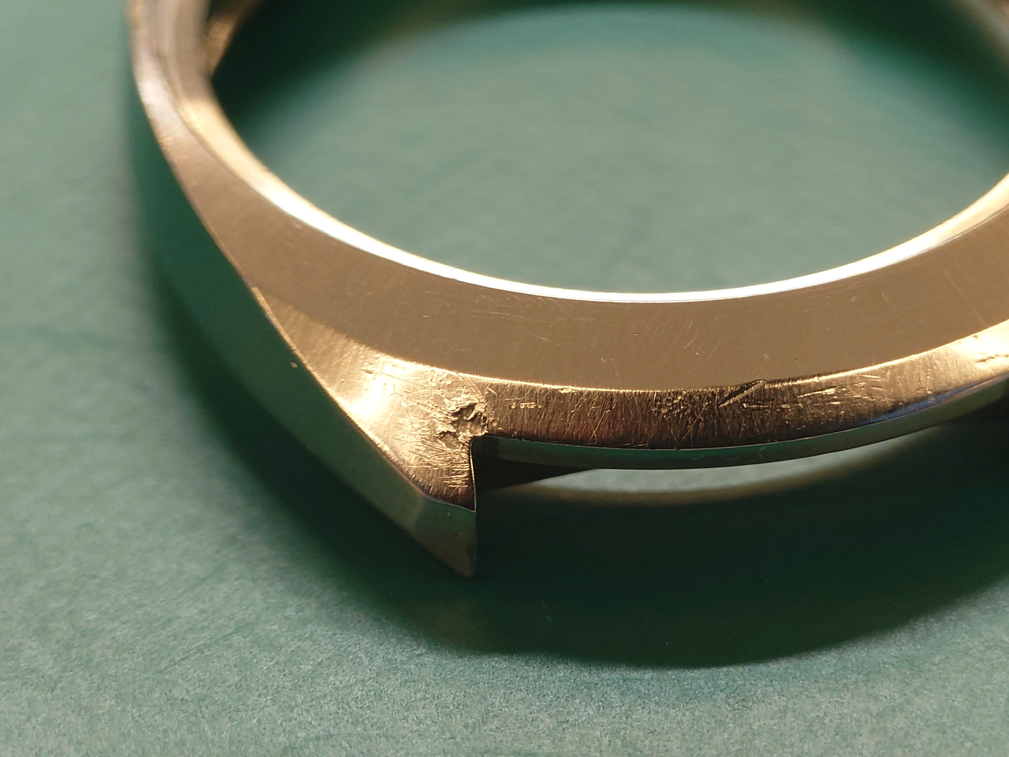

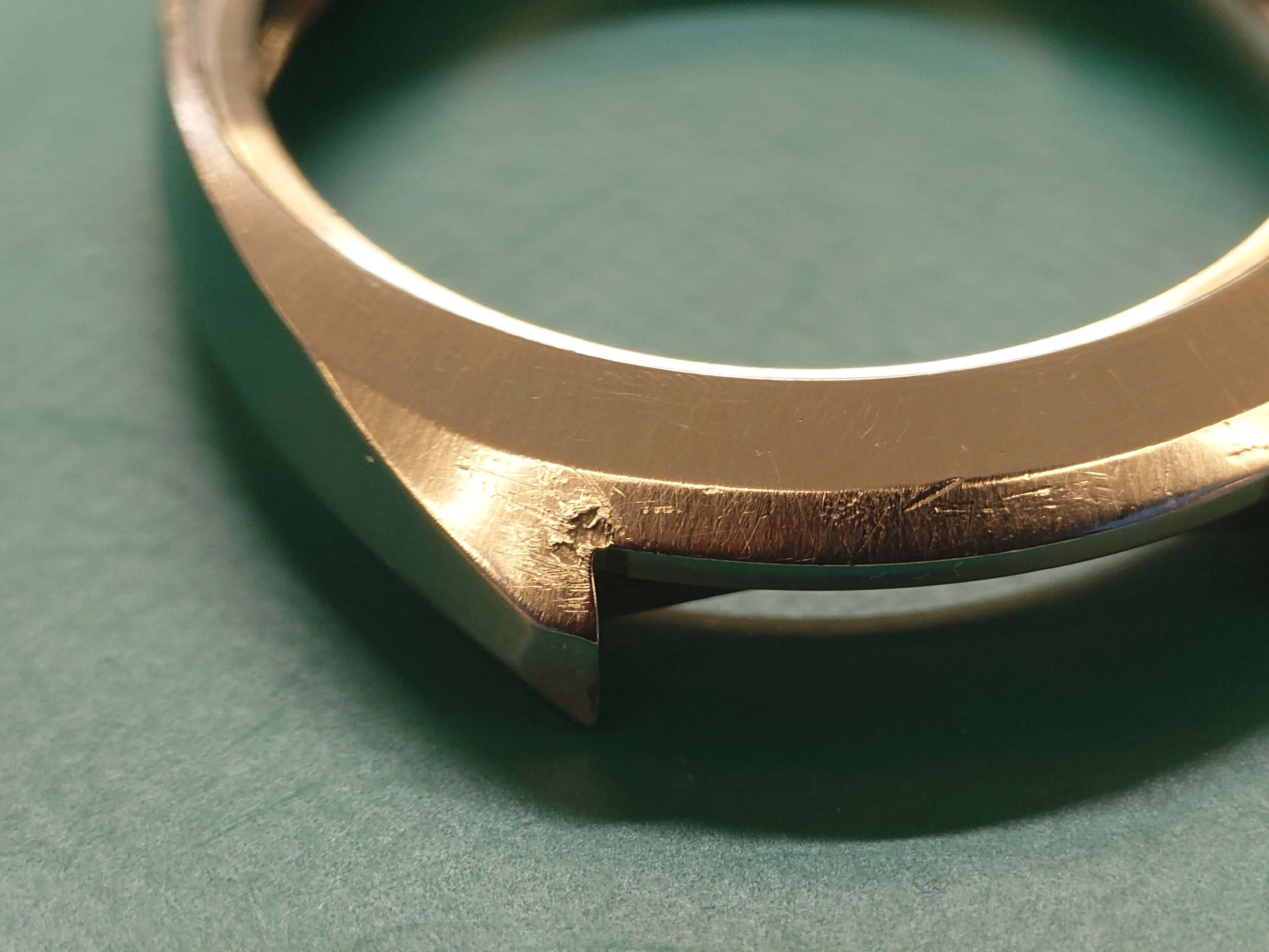

a bit of refinishing today, the same chronostop from before.

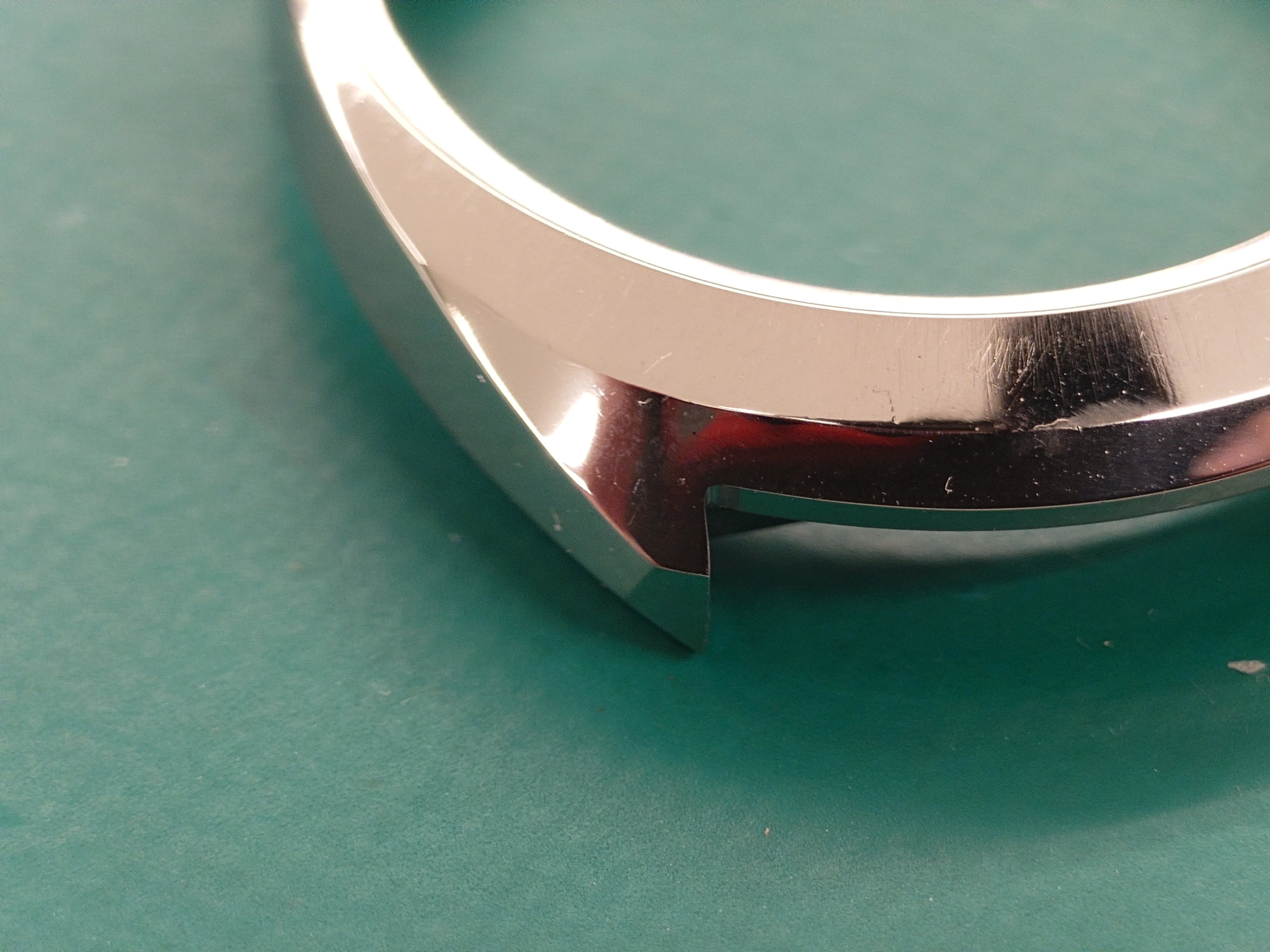

laser welded the bigger dings and tried my hand at lapping the case, not perfect but not bad for a first try before
after
I still need to put the sunray finish back into the upper surface.

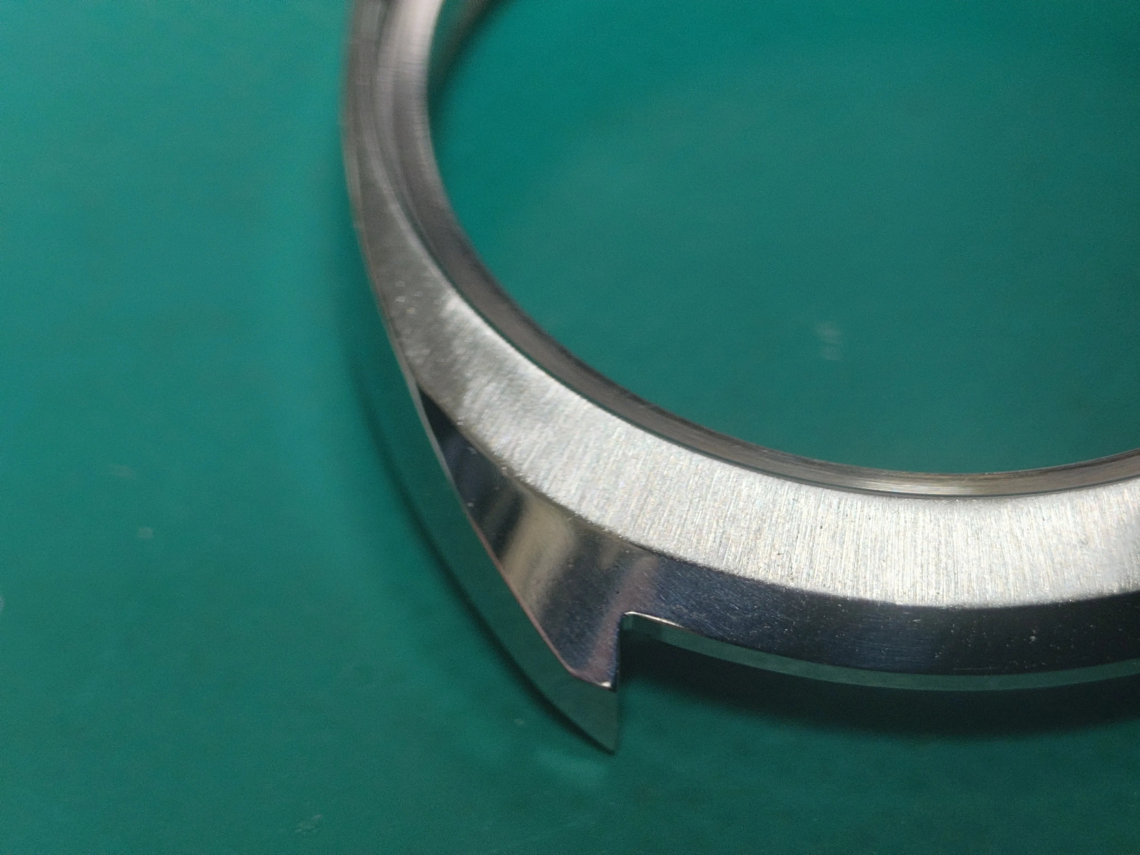

before
after

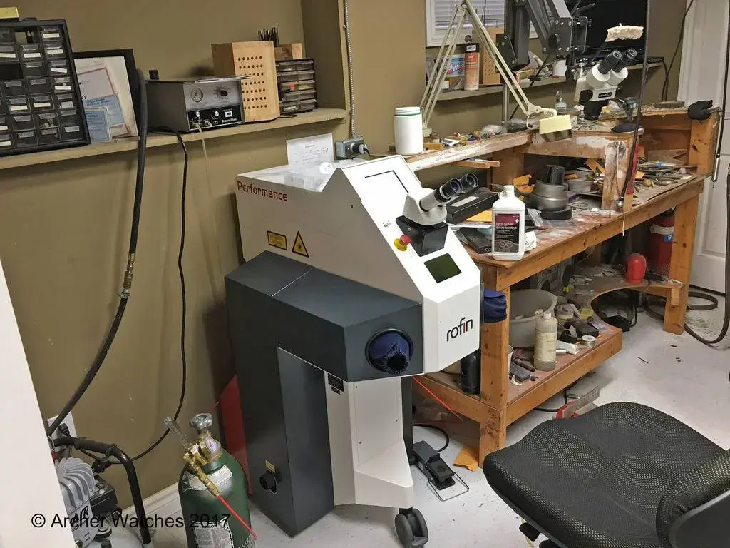

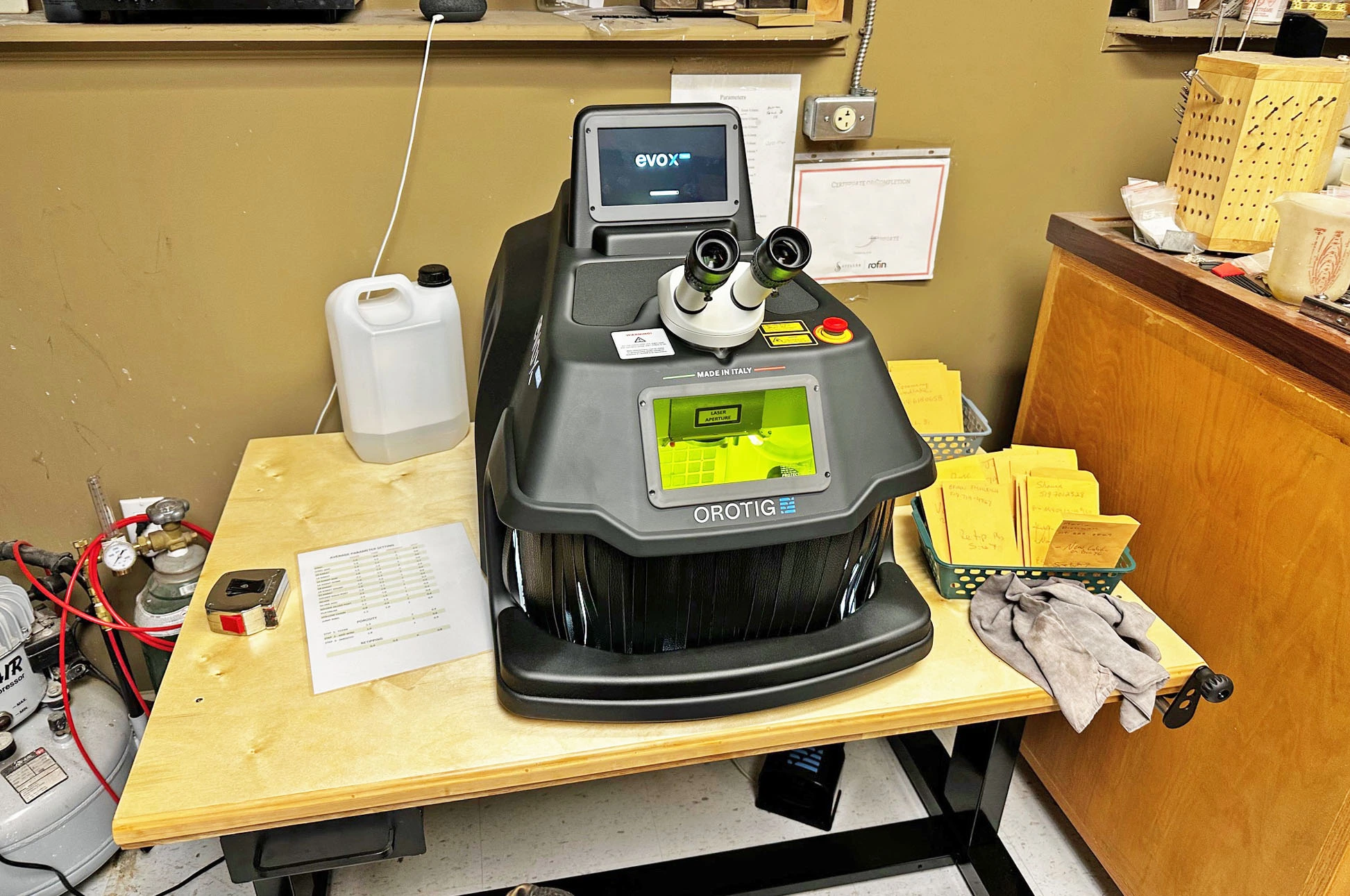

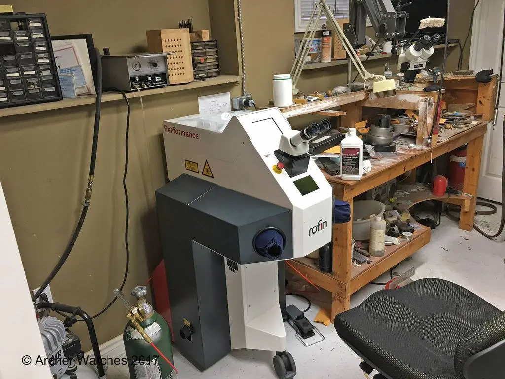

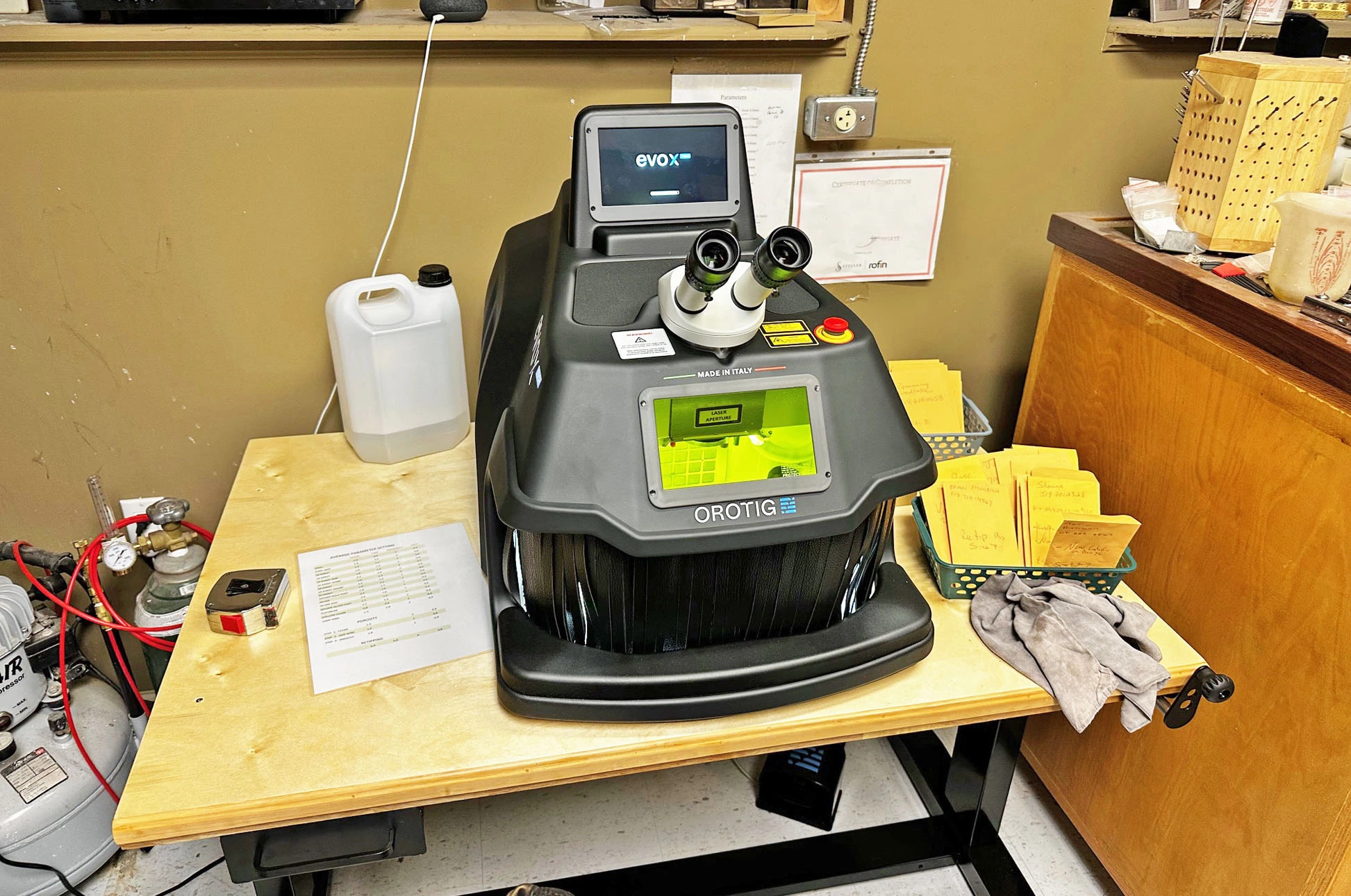

My friend who is a goldsmith just bought a new welder - nice little table top machine with lots of power...
His old machine, which is one that sits on the floor, needed repairs and he offered to sell it to me for $8k once it as fixed. If I was 10 years earlier in my career as a watchmaker I would have jumped on it, but I wouldn't get my money back out of it now. Would be a cool toy though! This is the old one:

I'm really hoping laser welders get cheaper in the near future. I'd love to have a sub-$1000 one to play with, but even the chinese versions of that floor-mount model start at ~$6k. "Higher" powered machines (for laser welding at a larger scale) end up being actually pretty reasonable, so hopefully this is something that can shrink enough so the rest of us can play with it 😀

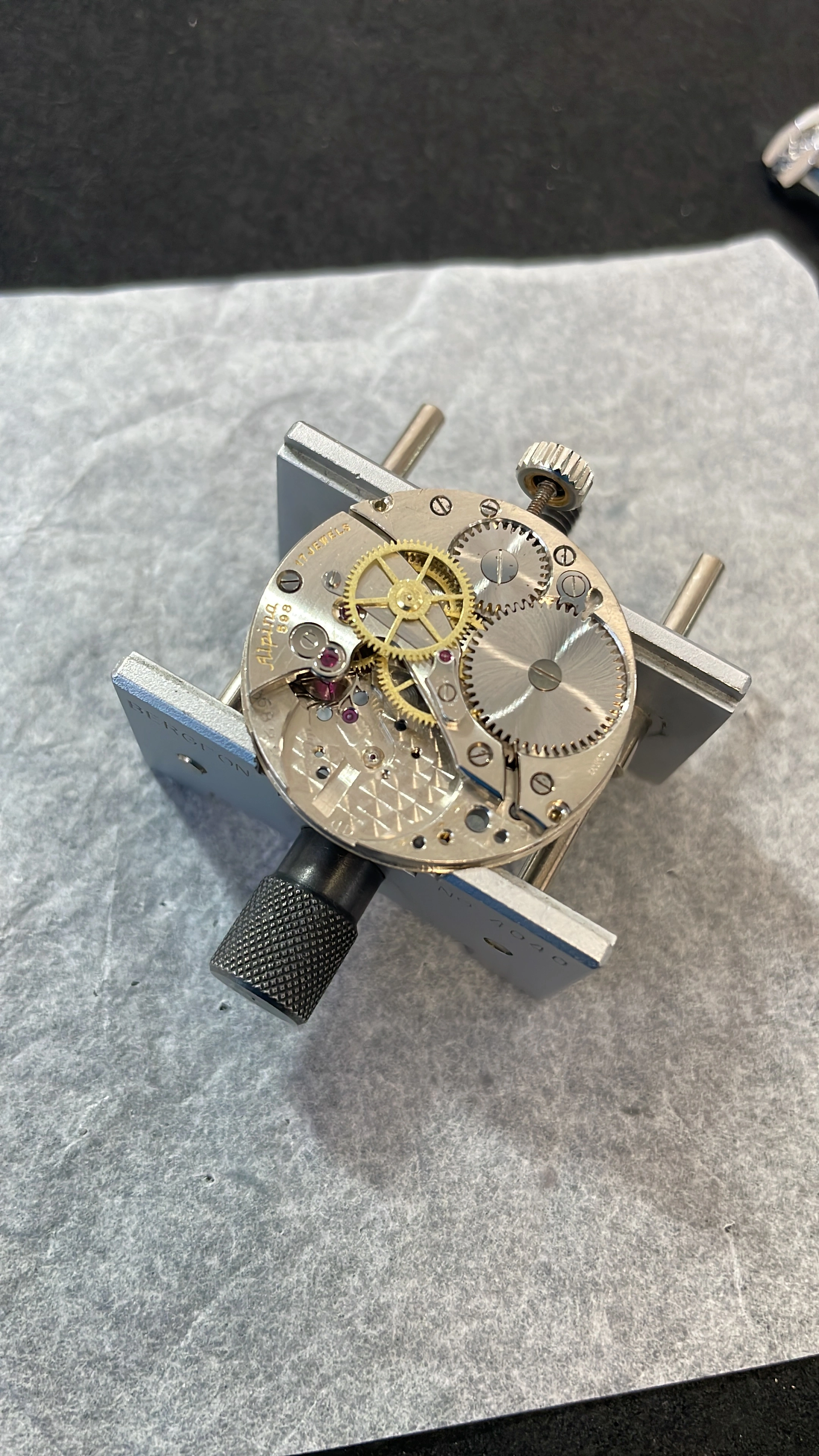

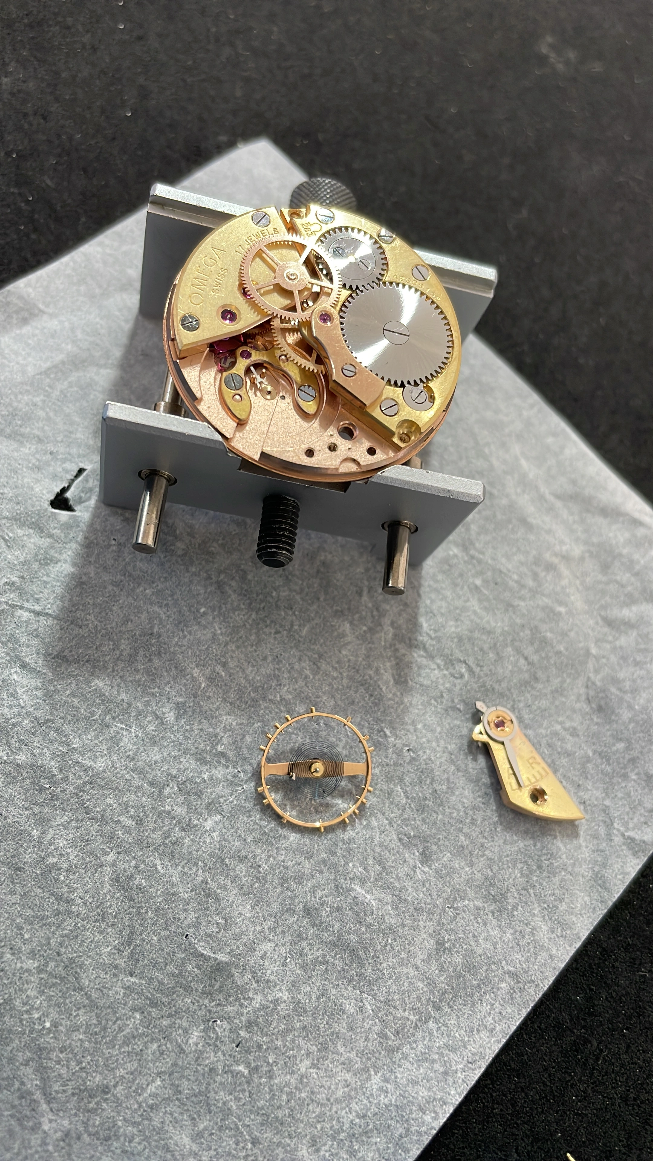

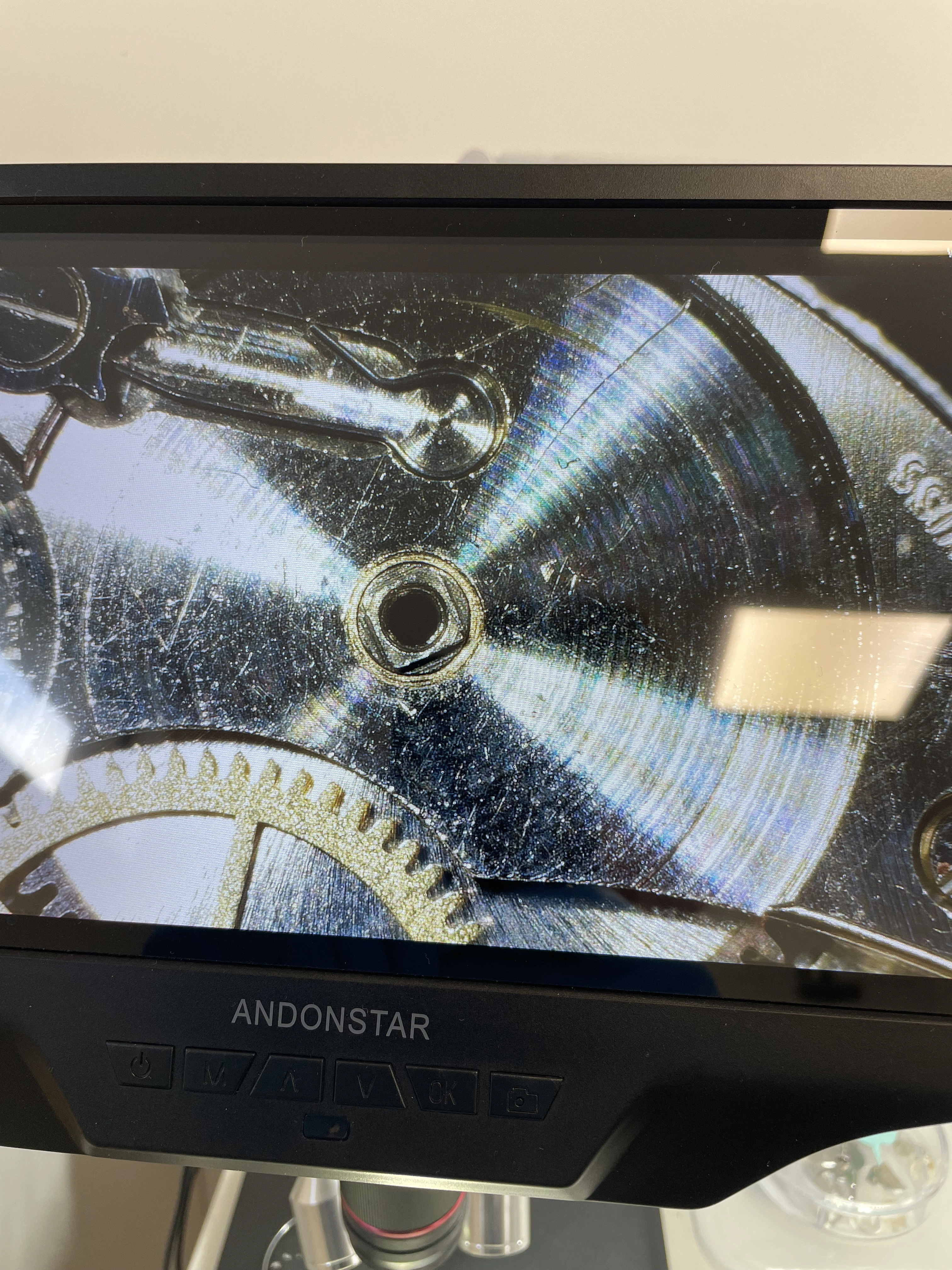

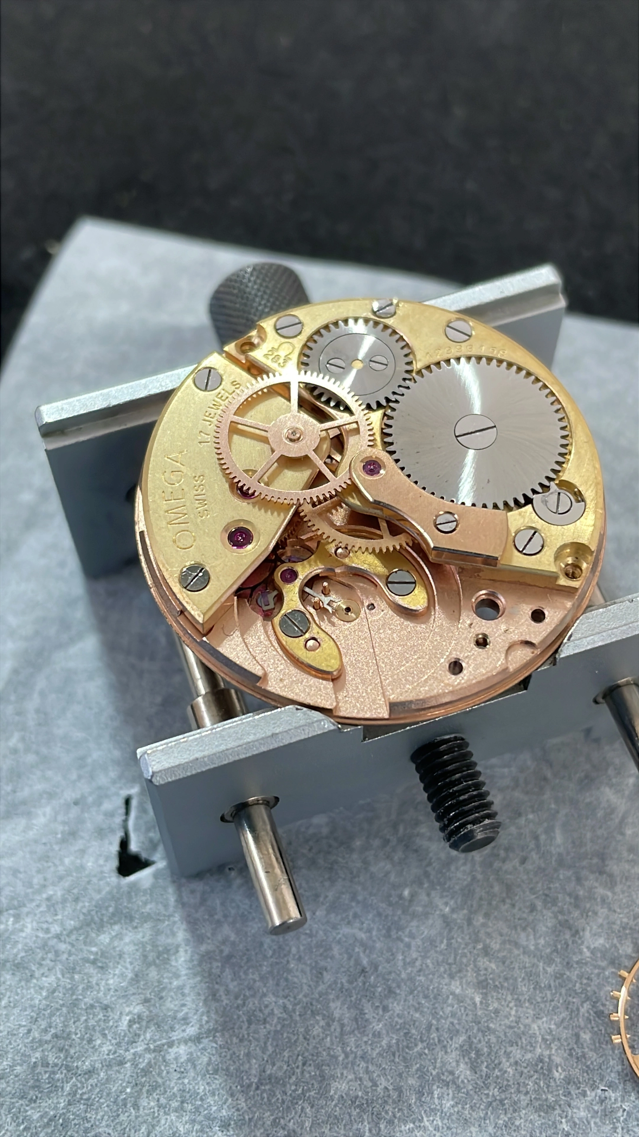

Here the hairspring was a little deformed, so I spent some time getting that in the right position. I kept getting some erratic spots on timegrapher dial up. It ended up being pallet bridge jewel being out of back. That adjusted it was finally running as it should. Where one issue is masked by a he other 😬

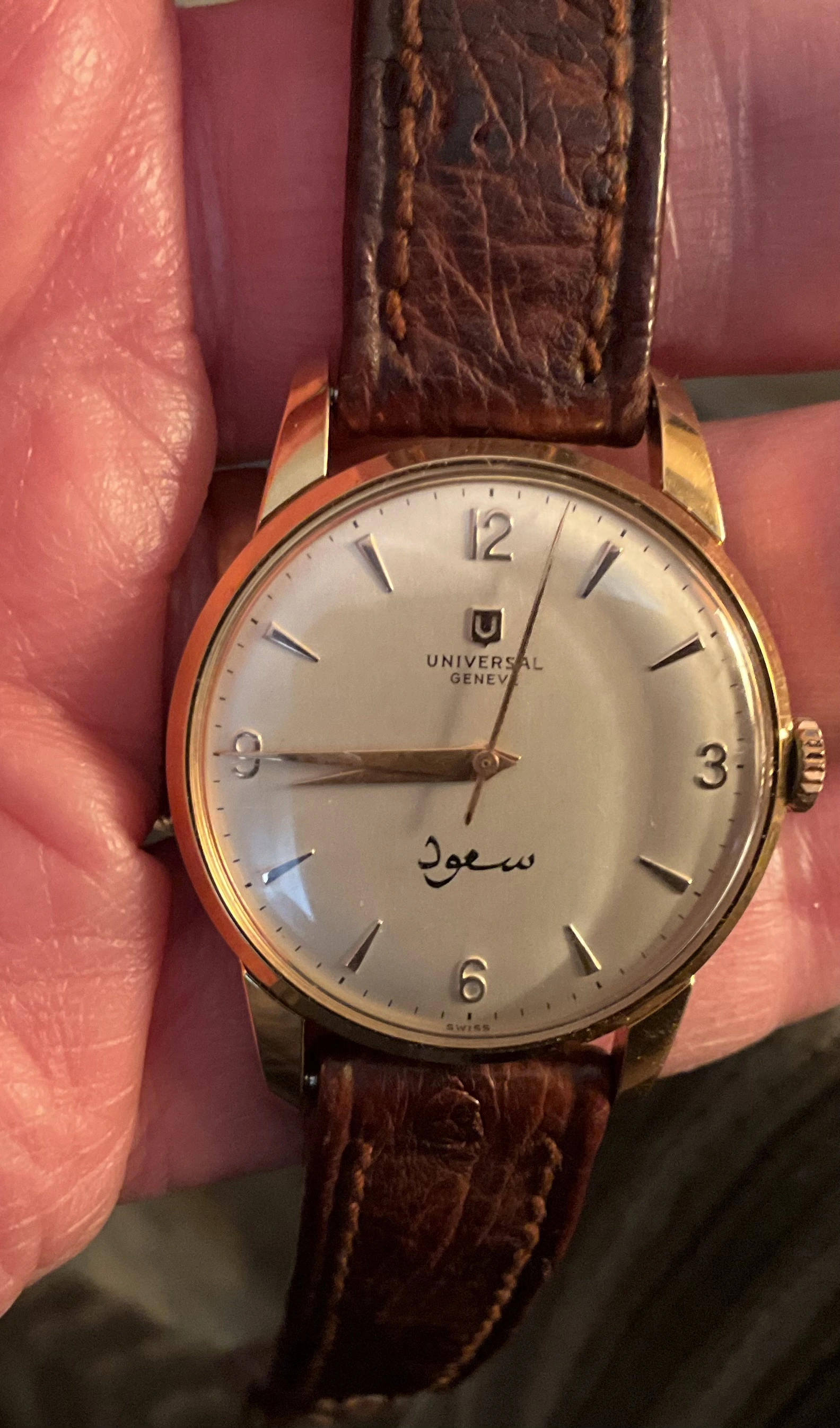

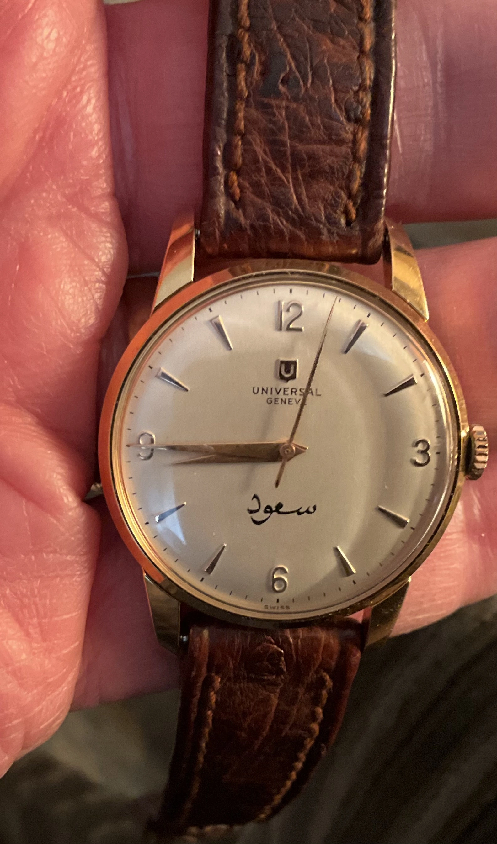

Not on my bench today, but yesterday. Universal Geneva manual winder. Came to me after what might have been a fall or a bad blow. Bent dial feel, bent stem, broken balance staff (Incabloc shock protected, go figure), and needing complete service. I have no idea the meaning of the logo on the dial. Watch likely originated in the Middle East, somewhere. Sweet,

For what it's worth, via ChatGPT:
The word at the bottom of the watch dial is written in Arabic: سعود.
It is transliterated as Saud, which is a common Arabic male name. On watches, it often indicates that the watch was either a custom order or a gift for someone named Saud.

Thank you very much for that. The present owner of the watch doesn’t have a name that would indicate his ethnic origin might be from the Middle East. Possibly an inheritance.

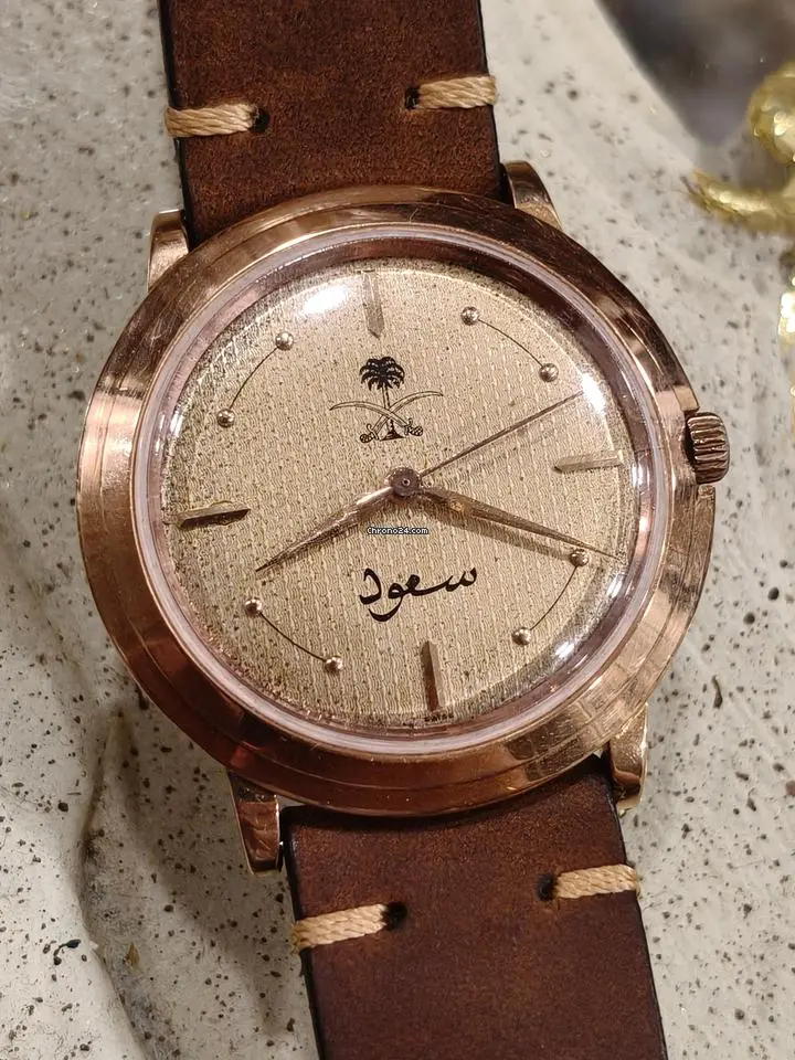

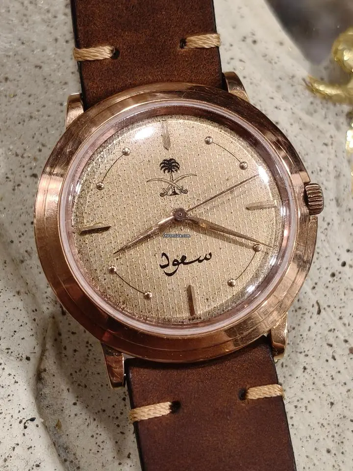

In my opinion this watch was commissioned by King Saud bin Abdulaziz Al Saud, second monarch of Saudi Arabia.
This is another UG , made for the Saudi Arabia royal forces
They were often given as gifts to dignitaries and officials.
