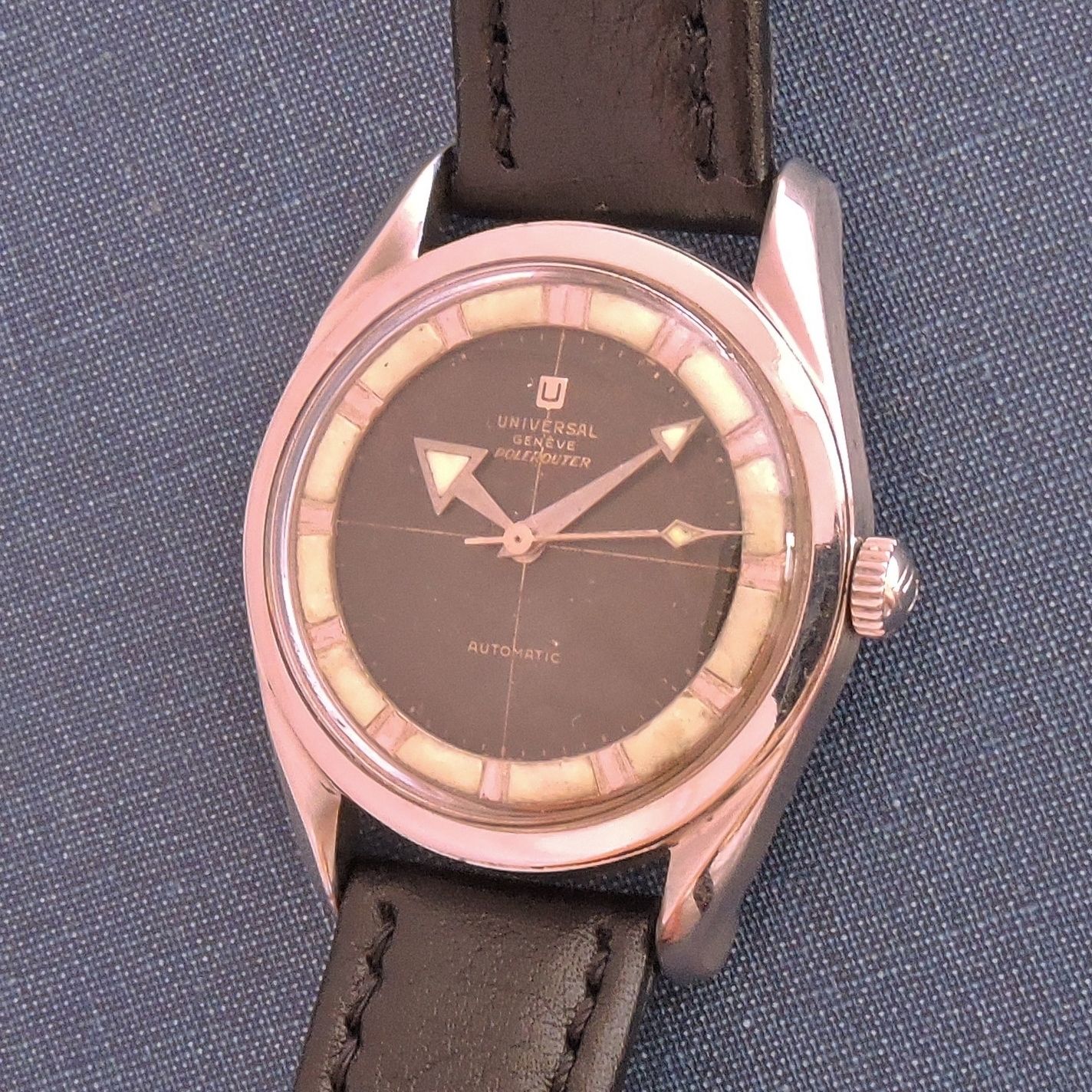

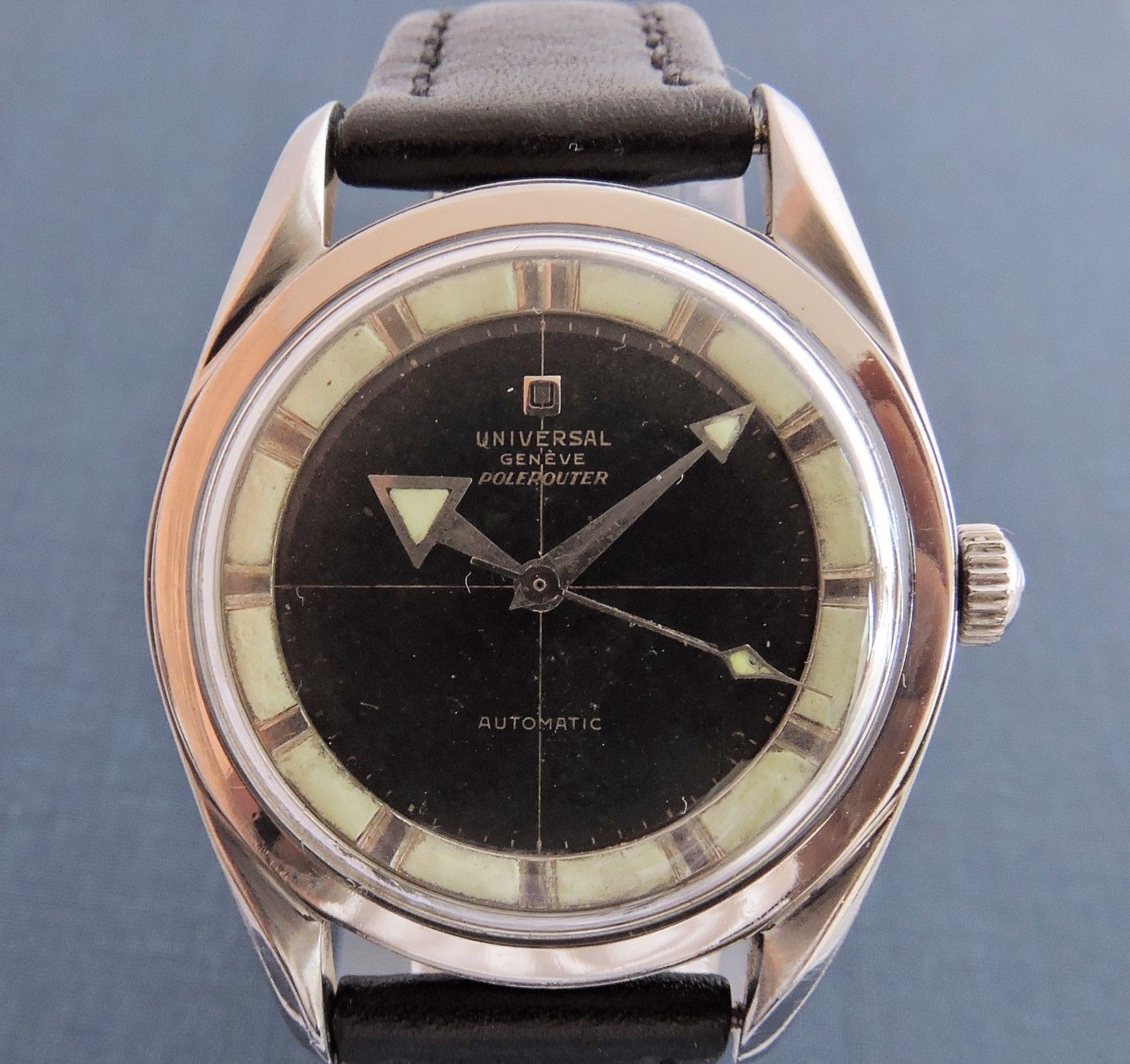

Is this a correct watch, including the seconds hand? I've seen these with the lume turned brown and others with the lume turned green.

Horribly and copiously relumed, with a sweep seconds that looks like it came off an Omega (incorrect). Avoid.

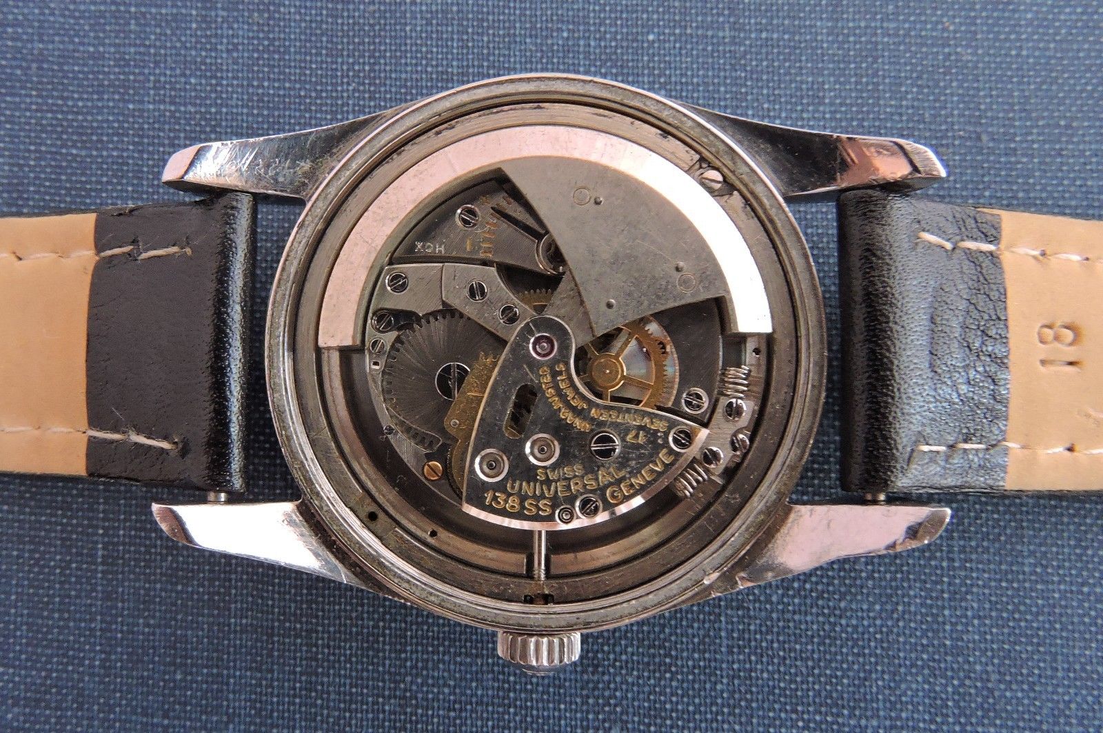

Dial's original. Movement looks fine. The biggest detractor is the gold filled case, which is by far the least attractive variation to collectors.

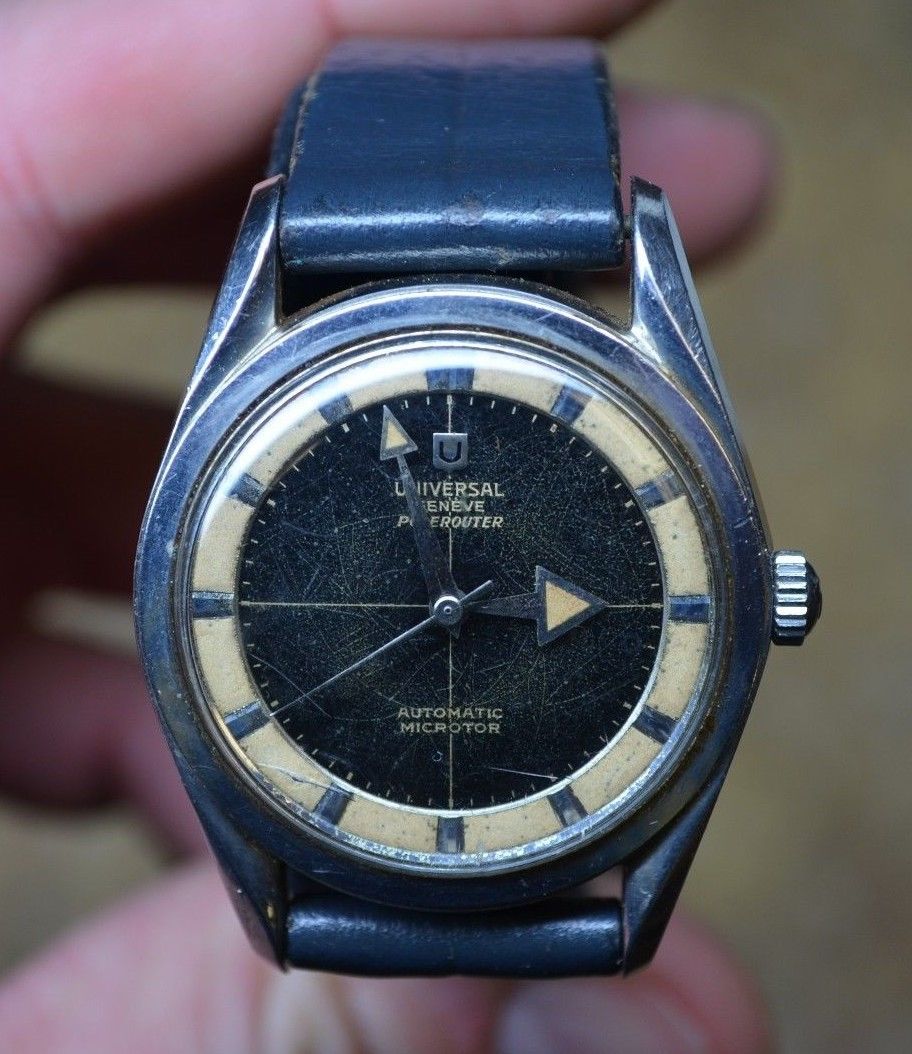

Hello,
How could this Polerouter have Broad Arrows hands with a microtor movement ?
Those early models should have a bumper movement (138SS).
This one already reach 655$ on eBay (371269179131) ?!?!!
Any thoughts ?

This whole luming-the-bezel thing is catching on I see.
