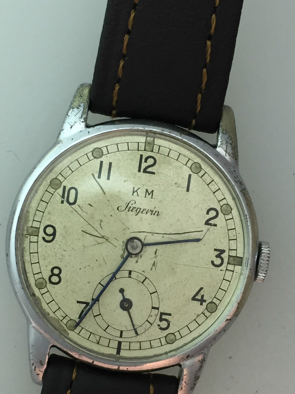

The hilarity is the case. Do you think many Kriegsmarine 'Victory' watches were cased in England? 😗
I had noticed that. Would the German navy refuse to buy watches because the cases were made in England?

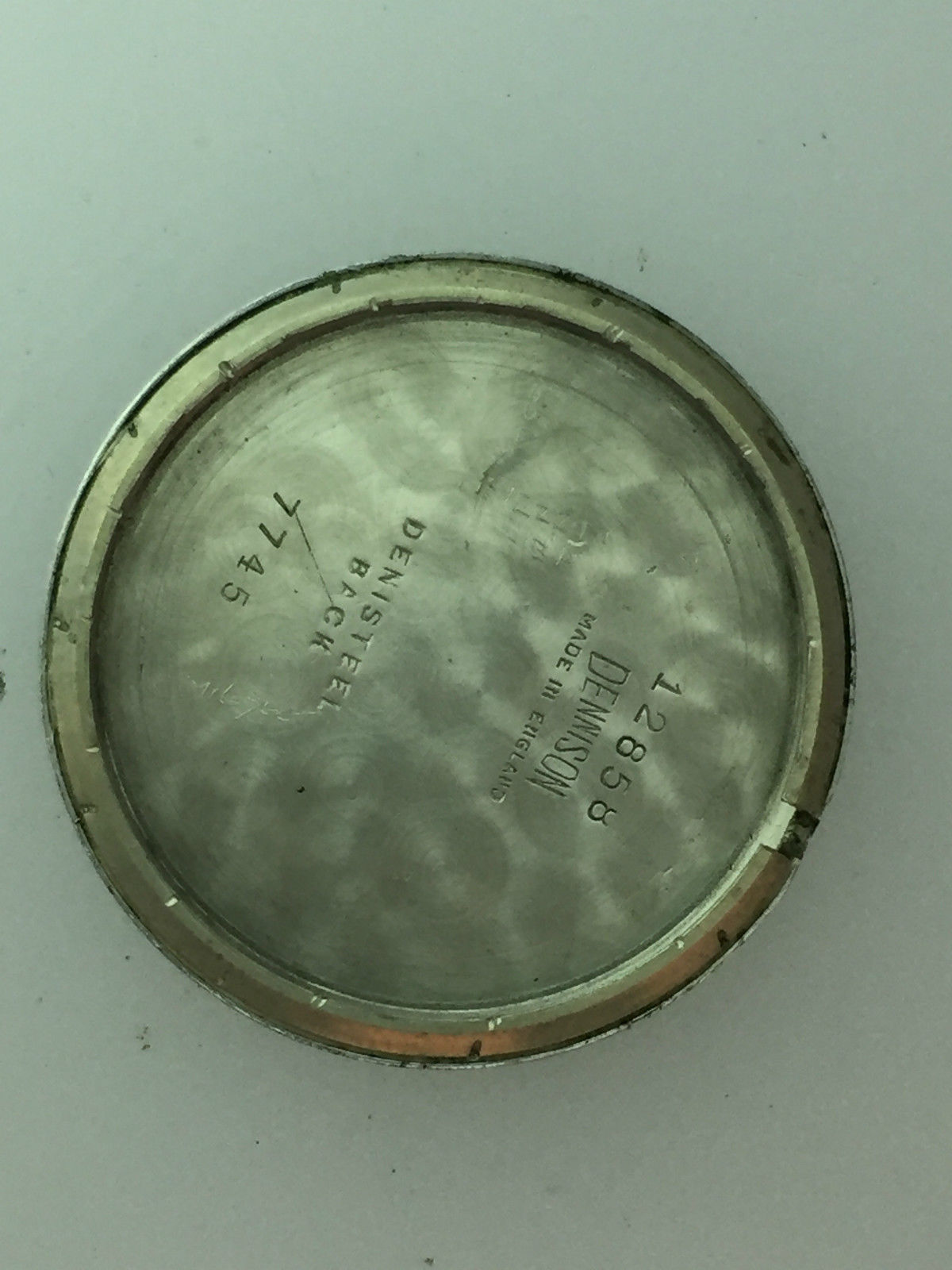

Would English case makers be allowed to sell to the Kriegsmarine?
257
155
Wouldn't Dennison's be selling their cases to the watchmaker not the Kriegsmarine?

Yes, but the KM would only have bought from a German company with tight supervision.
But really a academic argument since this watch seems to be fake.

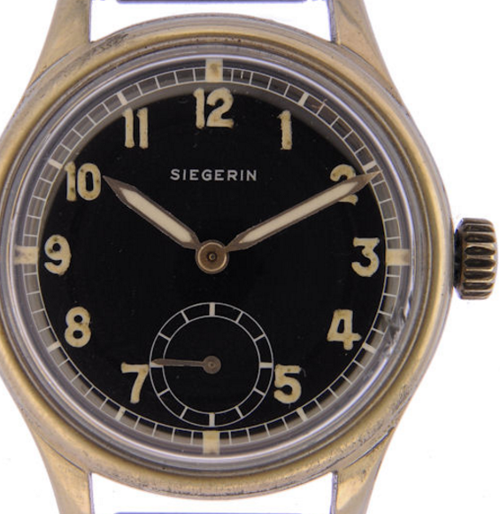

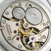

The watch in question does not look right. Dial and movement are correct but that is as far as it goes. I cant see any sense in having a dial with lume and plain hands, so first point is that hands are incorrect. The movement looks like an alpina as mentioned in a previous post and i concur. It seems to be well matched to case. However, i cant see the kreigsmarine purchasing a quantity of watches for use at sea that did not have any sort of waterproofing qualities (pop back case) ...

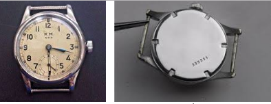

A quick search on the world wide brain shows the case below which is what I would expect and ties in with that movement. Note military serial number os back ...
The above looks more credible but may have undergone some sort of restoration. so although nice and quite a rare dial and movement, i don't think it is as the kreigsmarine intended and is a bit of a franken.
As far as the UG connection goes .... nah, movement bear no resemblance to the UG 262

I would suggest that the UG inference has been deduced by the seller from a casual reference to the Ranfft archive; specifically this reference to the Alpina 595 (Universal 262).
http://www.ranfft.de/cgi-bin/bidfun-db.cgi?10&ranfft&a&2uswk&Alpina_595

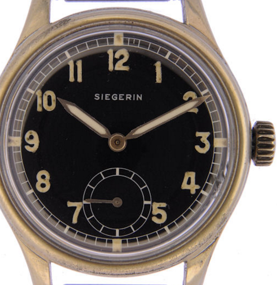

Looking at Knirim there is an Alpina Kriegsmarine however it is listed with a calibre 586 but Mikrolisk does list Siegerin as an Alpina registered trademark.
http://www.mikrolisk.de/show.php?si...hMode=exact&searchWhere=trademark#sucheMarker
Maybe an Alpina 595 is the same movement as a Siegerin 595 but I'd suggest there's some doubt about Ranfft's 262 attribution. If I have a moment I might drop him a note.

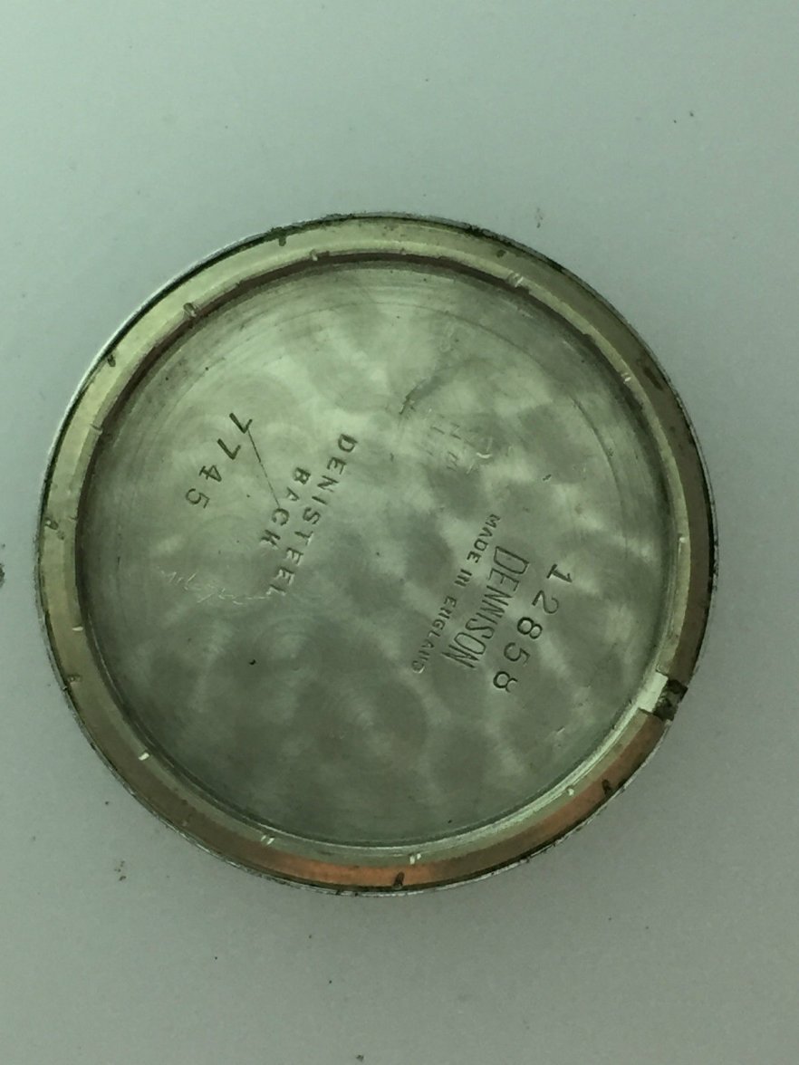

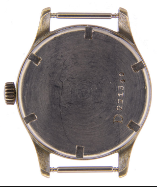

As already pointed out the non-lumed hands and the Dennison caseback (Knirim shows casebacks only from the outside unfortunately - incidentally none of the KM wristwatch models have D----H on the caseback but most do have a number however I have no idea if these are manufacturer's serial numbers of issue marks) clearly points to this as a franken; something all too common everywhere these days but especially with military watches. As to whether the seller is simply deluded, uninformed or is the architect of the piece, I have no idea but their other stuff suggests that they might be innocent of intent.
Knirim is contactable but the idea of Dennison supplying the Kriegmarine is so farcical I'll leave that task to somebody else. Labouring the point, in my view, can only take us to here:

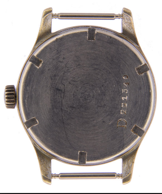

They wouldn't. KM=Navy, DH=Army

Case back on the ones i have seen are stamped 330094. I wonder what that stands for.
always learning !

The examples in Knirim (a relatively small sample) seem to indicate different number ranges from different manufacturers (e.g. 3***** for Alpina, 5***** for Zentra). It suggests to me that they are manufacturer's serial numbers rather than any marked by the Kriegsmarine though I note that Knirim does not make this direct inference. Interestingly there is one black-dialled Zentra with Dienstuhr (D---- rather than D----H). Also Knirim states that the Siegerin brand belonged to Marc Favre Biel which seems to contradict the Mikrolisk entry I mentioned earlier (my money is still on Mikrolisk).

These might be contract or requisition numbers. Every manufacture would have their own code. ?
