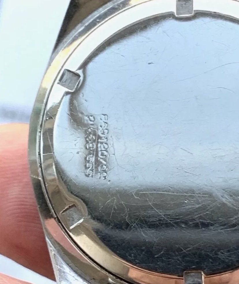

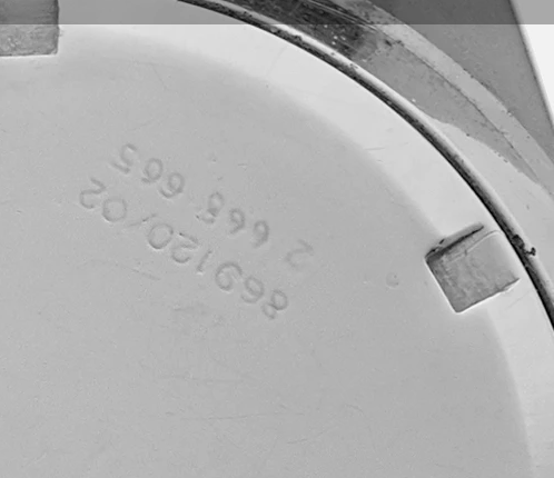

There is also the issue of the serial number ... It does not look right at all ... and reference looks a bit weird as well !
479
1,552
Super Weird, no two "6"'s are the same. Definitely hand done.

I wonder if someone tried to restore those engraved numbers by hand to make them legible after overpolishing the back to remove deep scratches. Just speculation, of course, and no way to verify it unless the owner has knowledge of it.

If they did try to make them legible their efforts seem to have failed miserably, either with Hodinkee or with me. From the photo of the case back I am reading 2 668 665. Here's what Hodinkee have written:

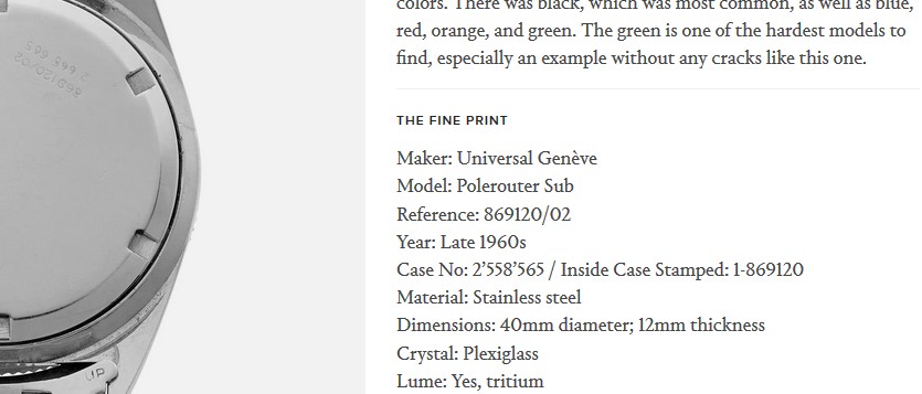

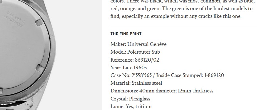

So we have a Polerouter Sub which is an expensive watch, being sold by a very reputable dealer with the following issues that were missed ...
1. Reference number inconsistent on case back (inside and outside)
2. Serial number inconsistent
3. End links wrong
I would be concerned that there could be other issues that have not been declared.
However, the million dollar question. Is it likely that the above mentioned Issues that were missed by the experts ? Possibly, which means that the onus is on the buyer to question and complete a thorough due diligence before parting with any cash !

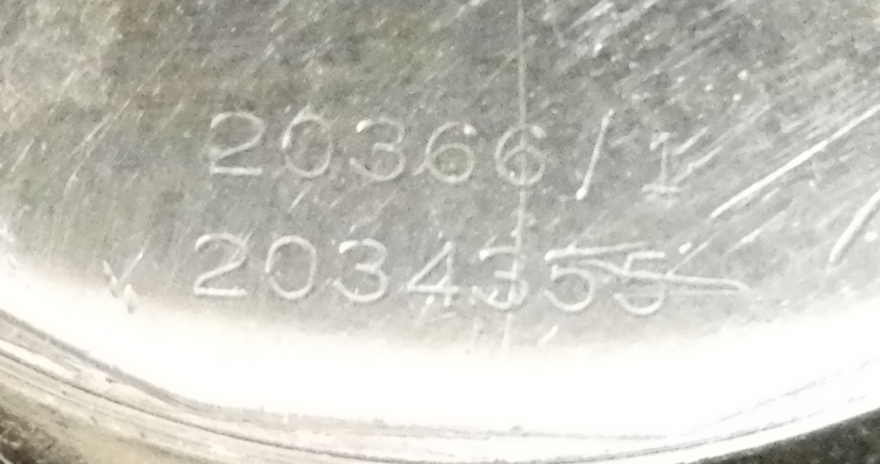

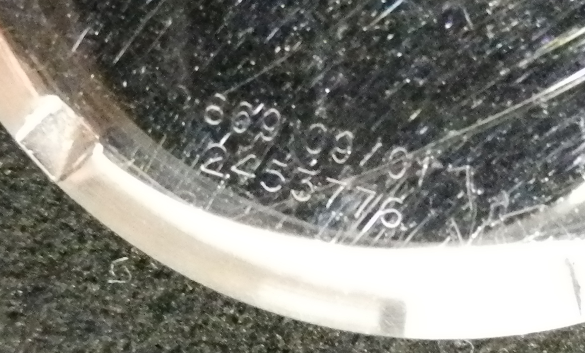

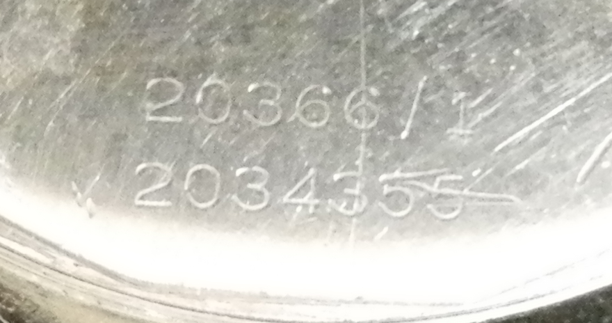

I dont have an 869120/02 but here are two others. The font or style did not change in the 60's so it gives us an idea of what it should look like. Pretty clean and well aligned without the mixed space and other irregularities we see on the hodinkee sub!
869109/01
A very rare 20366/1
BTW, i could not give a donut who the seller is and I am not questioning reputations or bitching about a seller. I merely state the facts ... I would not be considering a watch like that. I am pretty strict about what is acceptable (to me) and what is not. If asked for an opinion, i stick to my bar which is set pretty high.

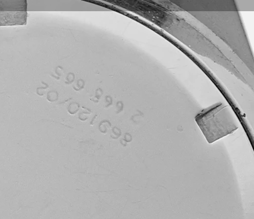

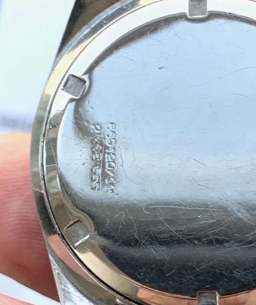

Is it just me, or do the serial and reference numbers appear even more obscured / jacked up in the eBay listing than they did in the Hodinkee photos? Could also be a product of camera quality, but honestly with the eBay image it is hard to even read the numbers.
409
1,074
I have a feeling the numbers are actually OK - just a heavily worn and polished caseback.
Whatever HEAVY editing hodinkee did on their photos made them look wonky due to the unevenness of the lines on the caseback.

most probably overexposure in the white box with zero reflections...watches always look worst in those than in reality imho.

Agreed- sometimes a “document” is not as attractive as a well composed and well lit “photograph”...very different purposes.
