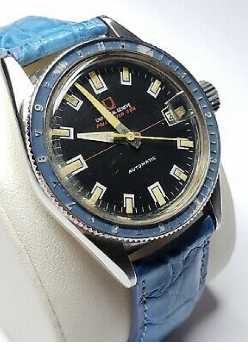

So I'm considering getting this. Hands look beaten up but dial patina looks sweet.
Date wheel looks patina-ed/dirty. Hows the case? Also is the bracelet and end links correct to the watch?
Appreciate any feedback! 1835-UG-A_1024x1024.jpg 1835-UG-Crown_1024x1024.jpg 1835-UG-Bracelet_1024x1024.jpg 1835-UG-caseback_1024x1024.jpg 1835-UG-movement_1024x1024.jpg

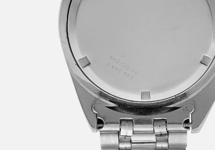

Bracelet is wrong. End links are incorrect for that case. Curvature and size is incompatible with case. Distance between links on bracelet is different hence bracelet sits kind of wonky. that would be enough to put me off. Head looks OK but nothing to write home about. I would a little concerned that case back looks heavily polished but seems to have retained serial and reference. I would want to carefully inspect it before making any assessment or decision ...

I agree re bracelet - see my comment above.
You may have a point regarding the serial and reference numbers.
Here they are, up the right way and magnified and they don't look very convincing to be honest.
I wonder whether someone has tried to make them clearer because they had been partially removed due to polishing.
On seeing the magnified image, the serial number doesn't look right at all . I am at odds with the whole thing now. It is very weird. I would hazard at saying that it has been added. Space between sets of numbers are too big and never in my life have I seen a font like that one !
Surprised hodinkee has put his name on this one as he is a reputable voice and authority on horological matters and would expect him to have eyes like an hawk ...

Yes, I've been aware of this one for some time too.
I suspect the damaged bezel and slightly scruffy dial/hands have held it back. It's also been polished and lost the brushed finish in places. The marks inside the case back would also be a slight concern for me.
Still a great watch and looks well priced compared with the Hodinkee example I agree, particularly in light of the case back concerns.
