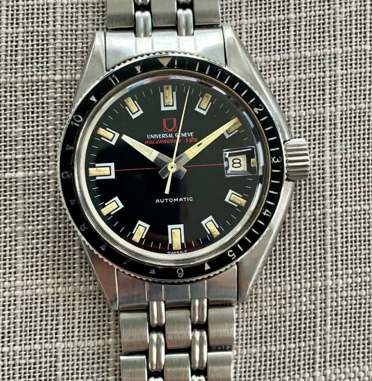

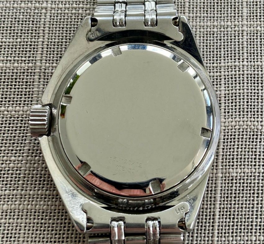

Another one just popped up on eBay with UP endlinks and what looks to be a JB Champion bracelet - but the bracelet doesn't seem to be nearly as misaligned / jammed into the endlinks as the previous example:
The seller says the watch was purchased from the original owner and is untouched. What are people's thoughts on this bracelet and the UP endlinks? Still incorrect for a Sub?

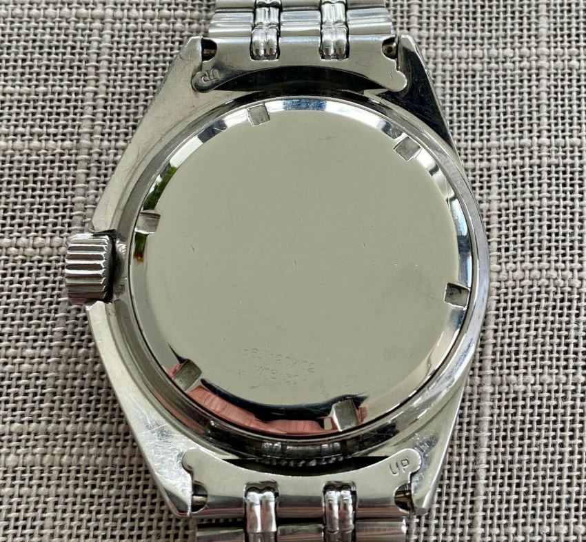

The reason it looks better is because it's a Gay Freres bracelet and the Gay Freres end links therefore fit the bracelet properly (although note that the seller states that the clasp is not signed).
The UP end links still do not fit perfectly because they are designed for a Polerouter Super. The Sub needs UM end links ideally. Although UP and UM are both 20mm wide, the curvature is different.

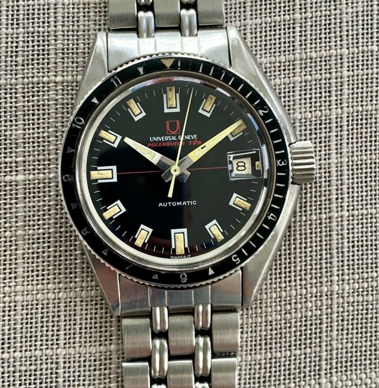

I was looking at this on the bay. Black bakelite is probably not as sought after; but still its bakelite. Bracelet endlinks are incorrect as @Mazoue has pointed out.
But the dial looks good, and for the price; i thought it isnt that bad a deal. if you could lower it for under 10-15% less; i think it might be a good price.
I had the same thought, but knowing that the endlinks are incorrect I now question the description that this watch is “untouched” and purchased from the original order. I’m now wondering if anything else was done to the watch...probably not but if it was truly untouched then it should have the proper endlinks, right?

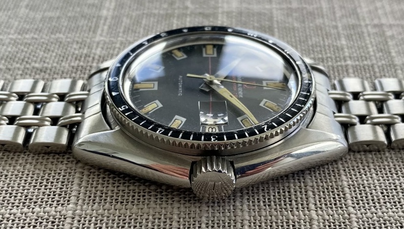

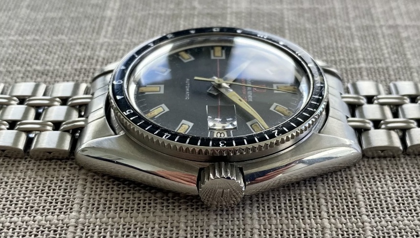

I’d prefer the minute hand to have retained that vibrant orange color, but the bezel looks nice, the lume has aged to a nice color, and the case looks sharp.
Is that fat U crown correct? I’ve only ever seen the very thin U crown before.

This has been for sale for over a year. I asked the seller about it in January 2020. His response to me was:
“I’ve seen these fat U crowns much less than the thin ones on UGs of the era through research. My believe is that these were changed after service for the more modern thin U crowns (just as Omega replaced crowns with different logos.)
UP links are correct for this reference, currently the Hodinkee Shop is offering a Polerouter (with unattractive patina) which also has UP links for reference.”
that crown looks wrong AF. Reminds me of the UG sonic ones.
1,523
3,150
It is a later crown ...

"untouched"... considering the endlinks, clasp, the aftermarket plexi, and later crown, looks like someones told a few fibs somewhere along the line...

sure, I get that, but the description in the listing is trying to pass this off as essentially a barnfind piece that has survived looking just as it did when the first owner purchased it:
“On offer is an untouched UG Polerouter Sub model 869120/02. If condition and originality is your thing, this watch ticks all the boxes. The watch was bought from the owner who had kept it in storage for many years and the condition shows.”
“A beautiful survivor in amazing condition and originality which was worn sparingly during its life.”
And if the crown is a later replacement one as @CafeRacer says, then this statement is misleading:
“the original, and rare fat U, which were mostly changed during service to the thin U crowns”
