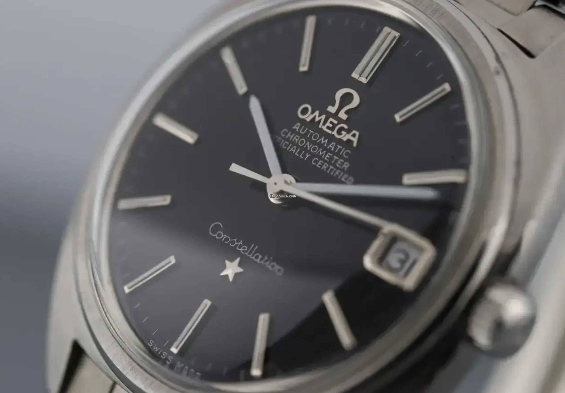

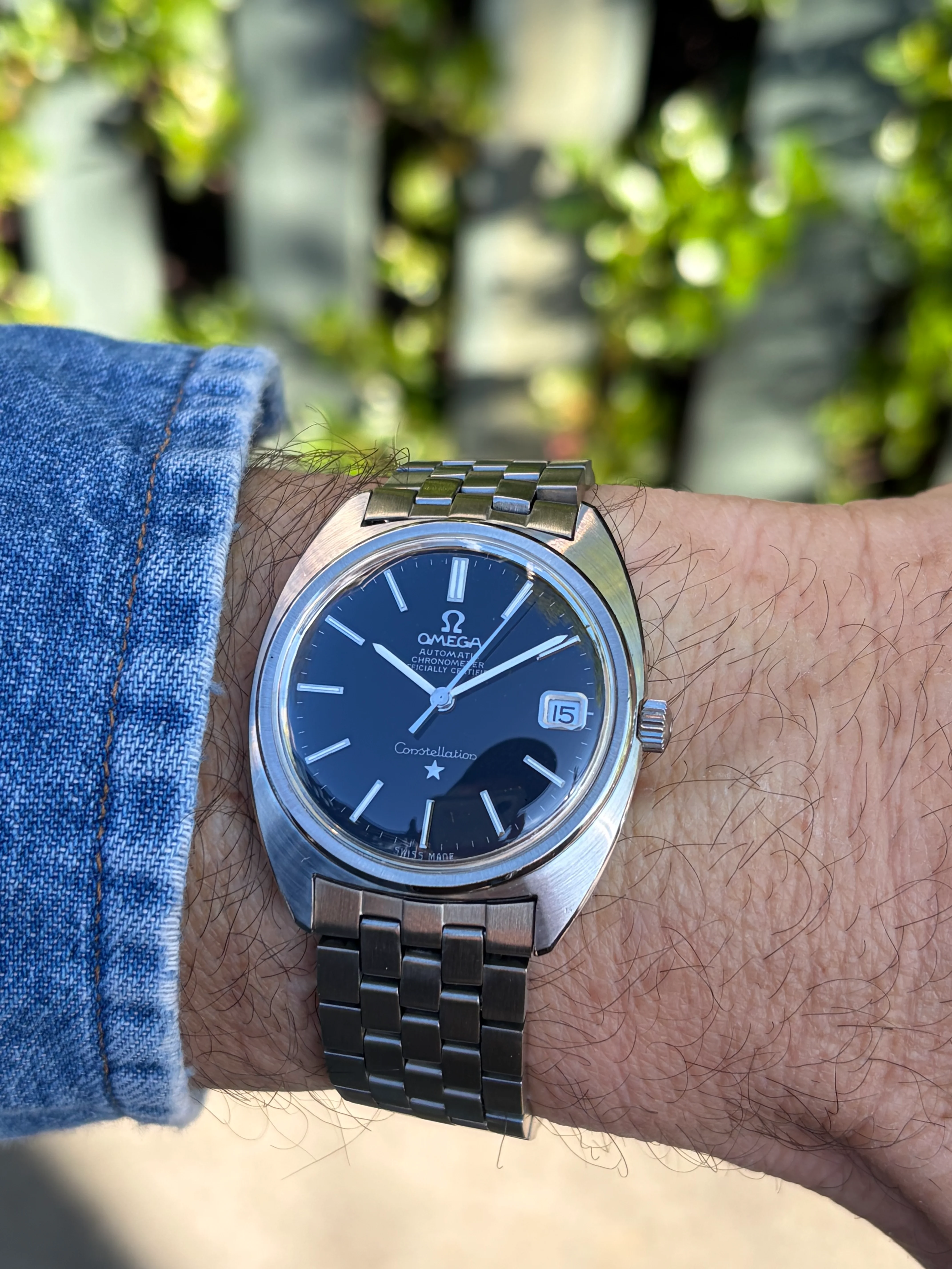

Ok, I鈥檝e been through a bit more than half of of the posts in this thread. It seems the dial on this 168017 is quite uncommon! Glossy silver gilt. I鈥檒l let you know when I have it in hand next week.

That is %99+ a redial - but if it's not, it would be legendary. You can easily notice the white paint on indices that normally have a black coating. I can't 100% tell from the photo, but you can tell with a loupe when it's in your hands, just concentrate on indices

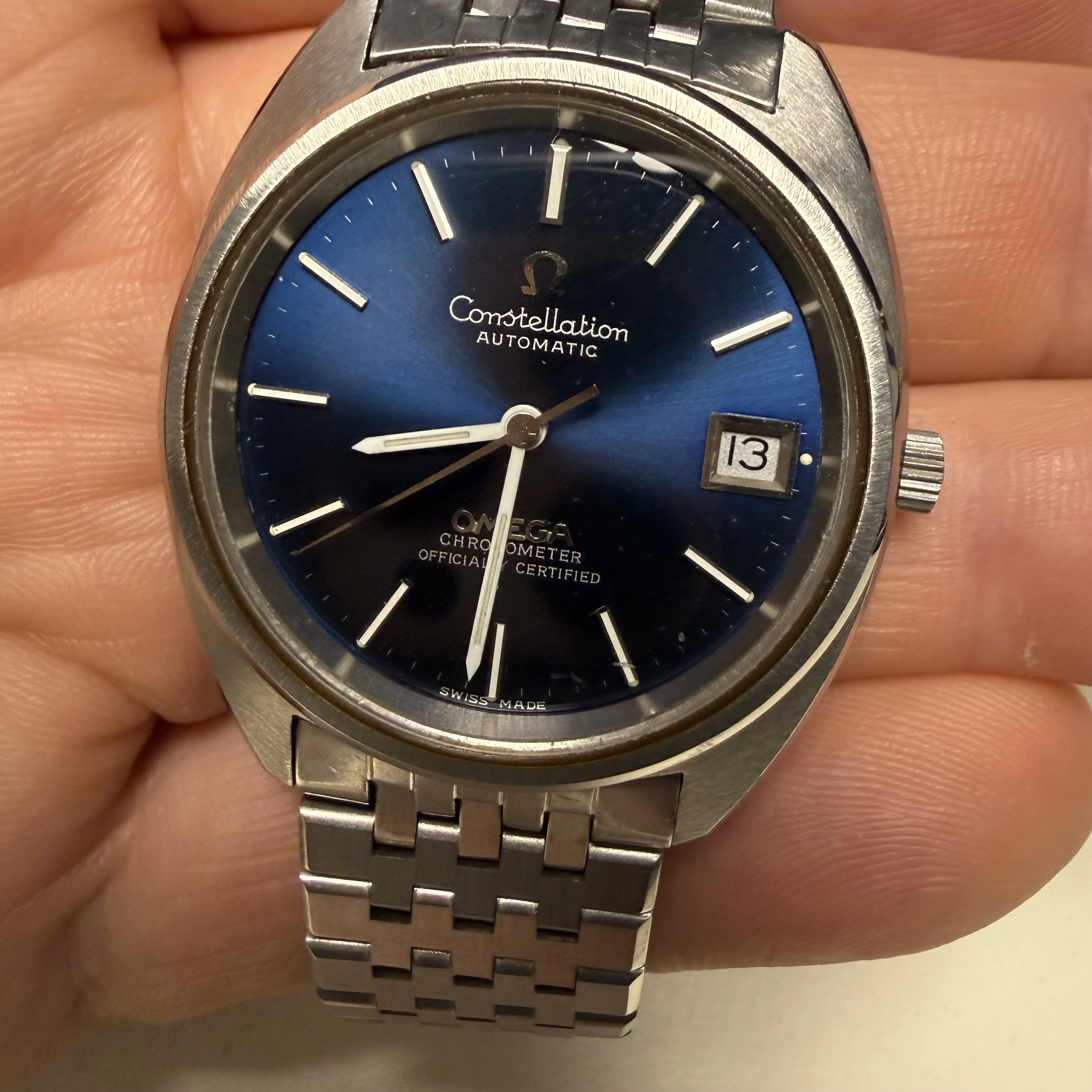

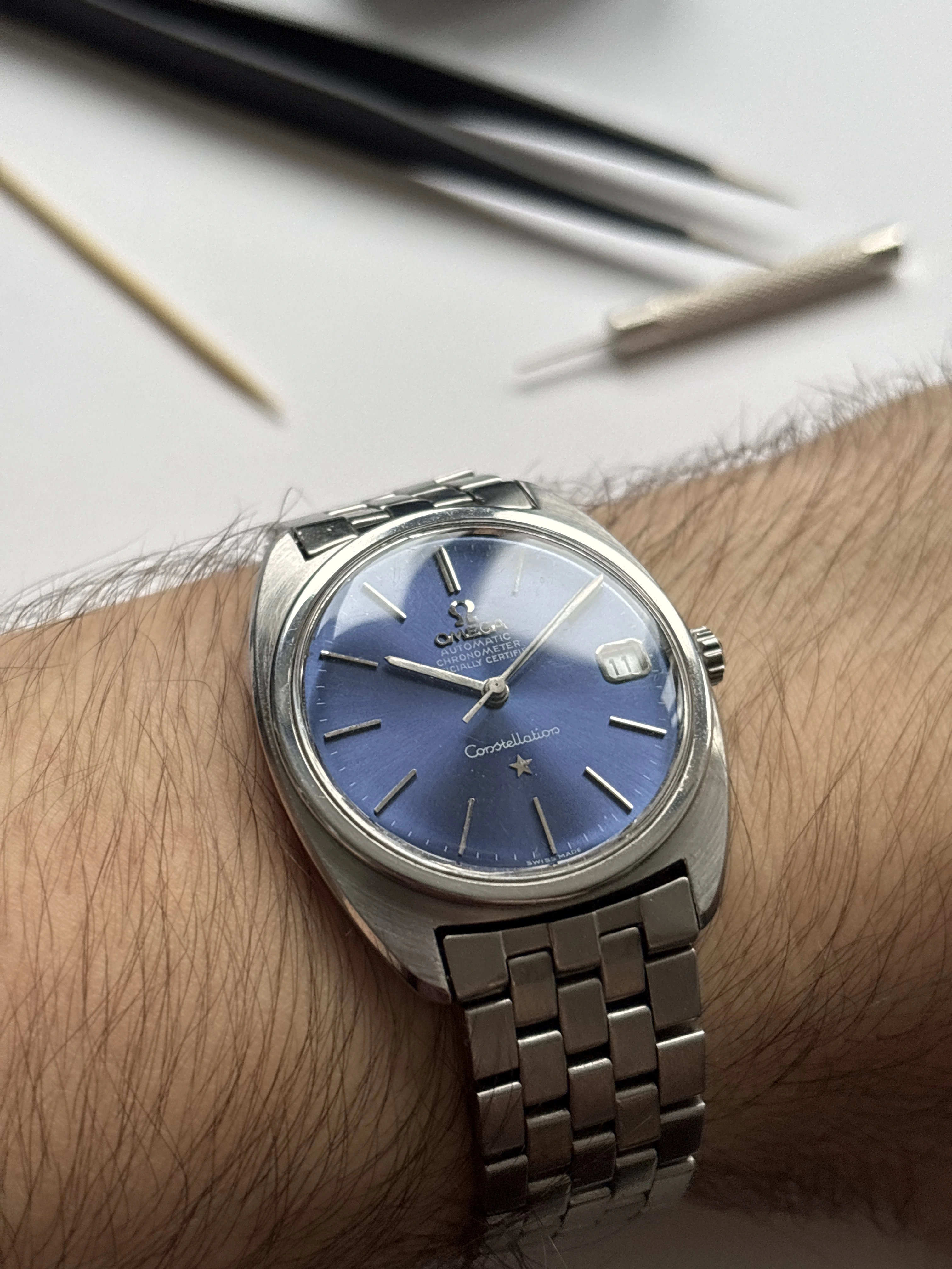

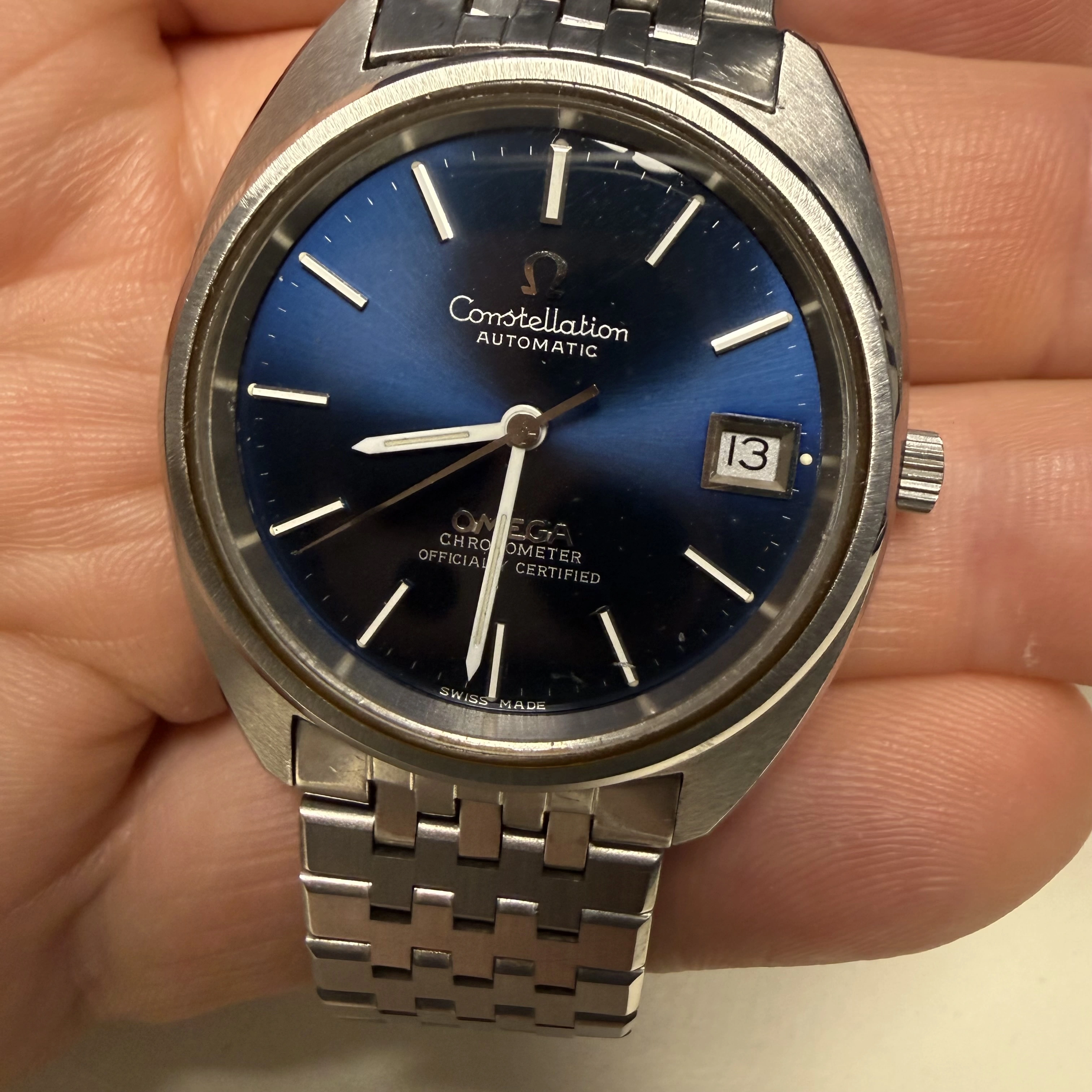

Apparently a special one... Have you ever come across another one?

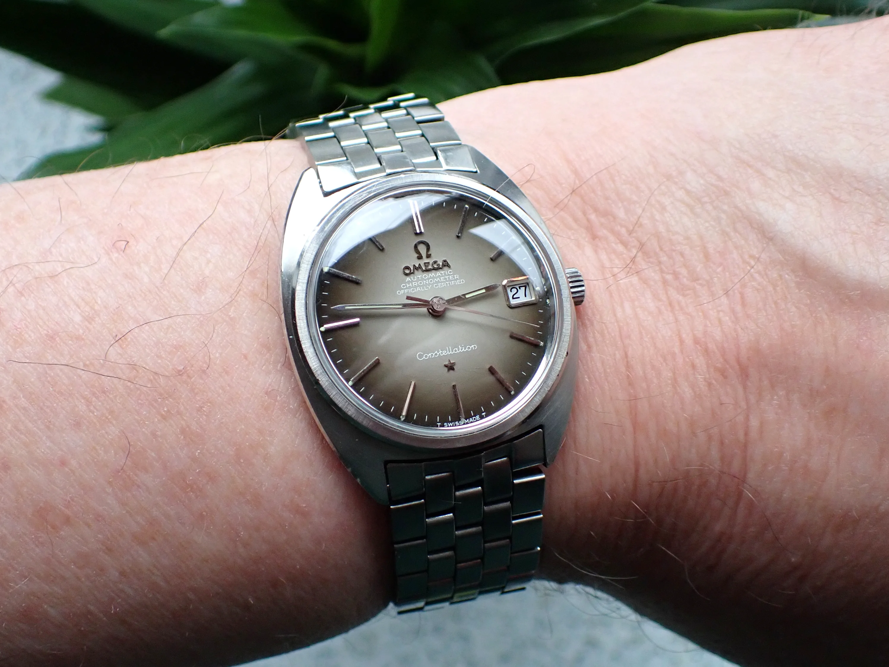

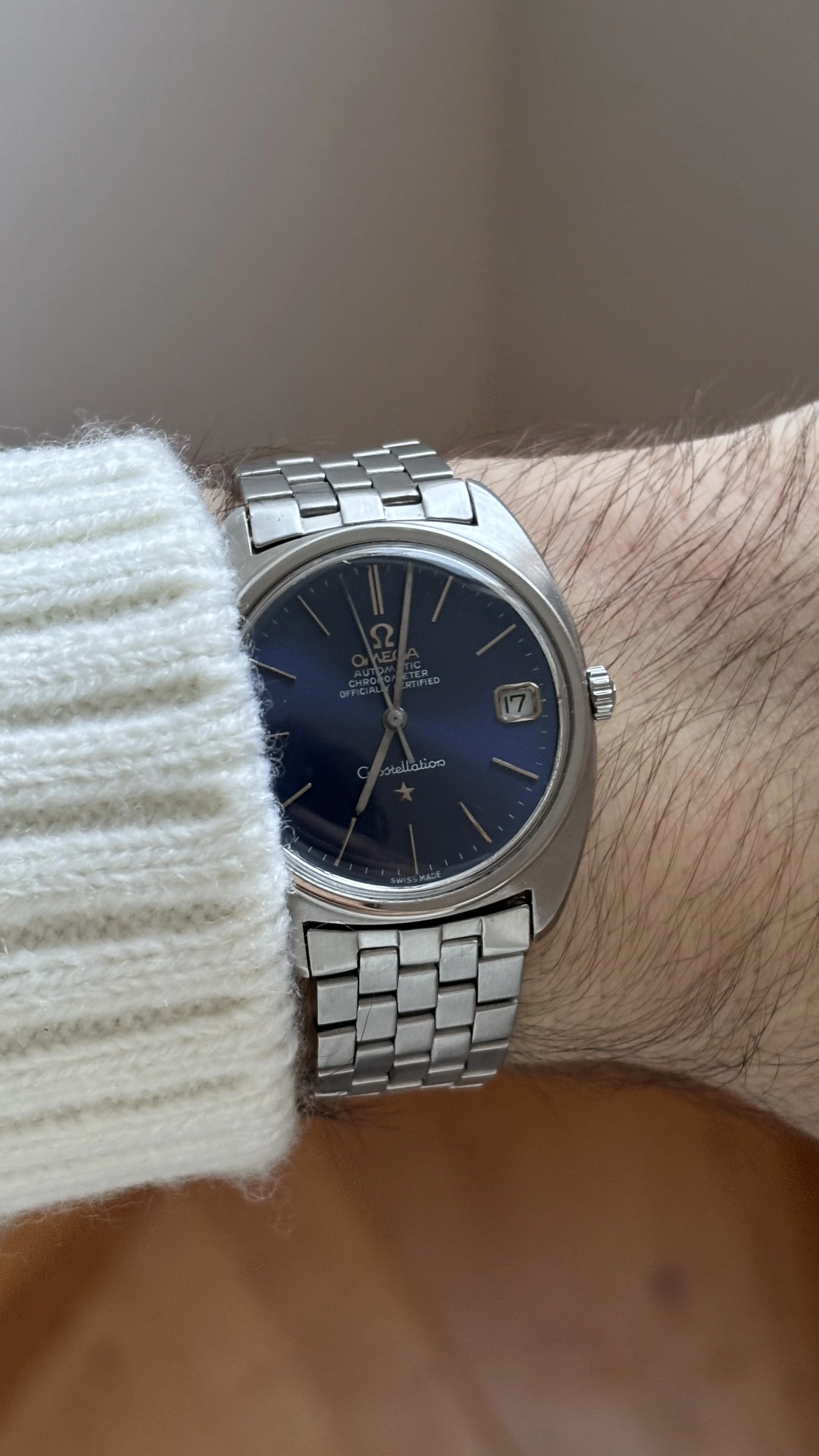

Coincidentally today I had this returned after lending it to a colleague who was considering buying their first vintage Omega. Subsequent generation 168.0056 with a 1011 motor, seventies chic rather than classic cool, but the dial colour makes it work imho.

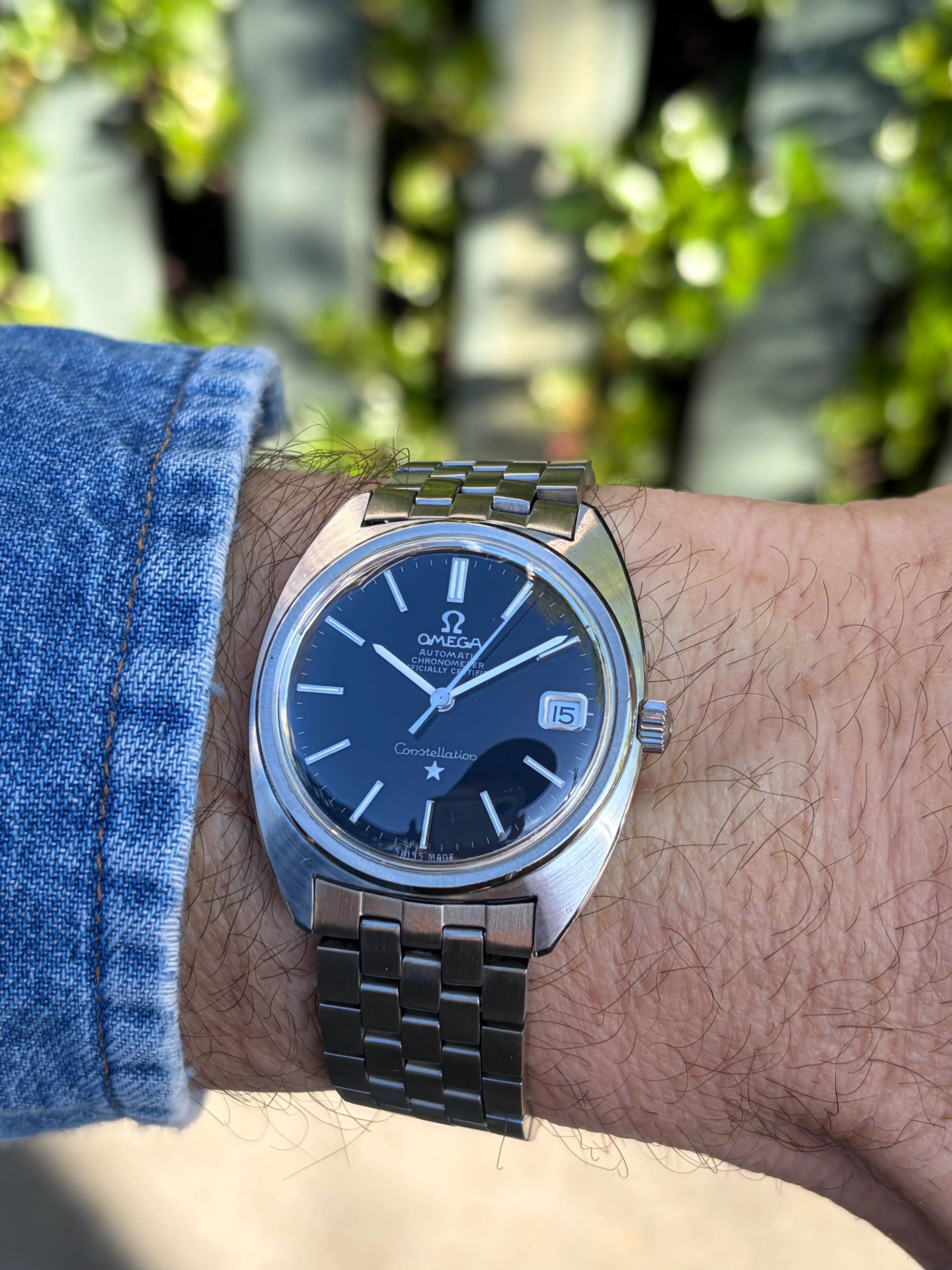

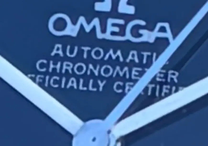

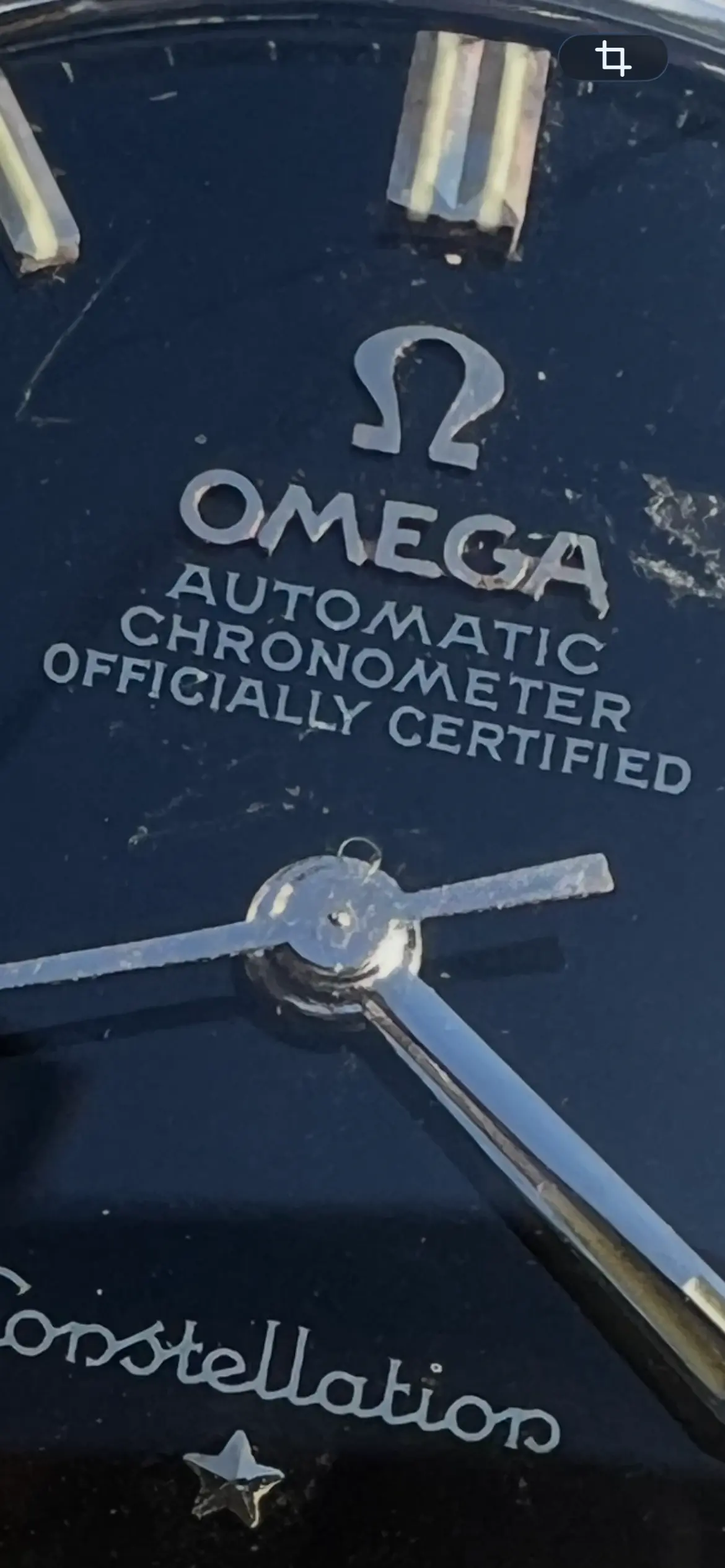

OK, I have this baby in hand and it is a unicorn for sure. It is a gloss silver gilt dial in incredible condition. The text is printed in relief. The H+M hands and tops of the indices have gloss white paint. Ver cool with the white paint because it really increases the legibility. I paid probably double what a 168017 goes for, but still, a screaming deal at about $2500 and it's been serviced.

Nice looking watch for sure, but not the original dial painting. If you post a macro shot of that 12'o clock indice that would 100% tell for sure. You can tell from the photo that the left stripe's top section is thinner than the right stripe. If you were assured an original / non-redial watch I'd explore options

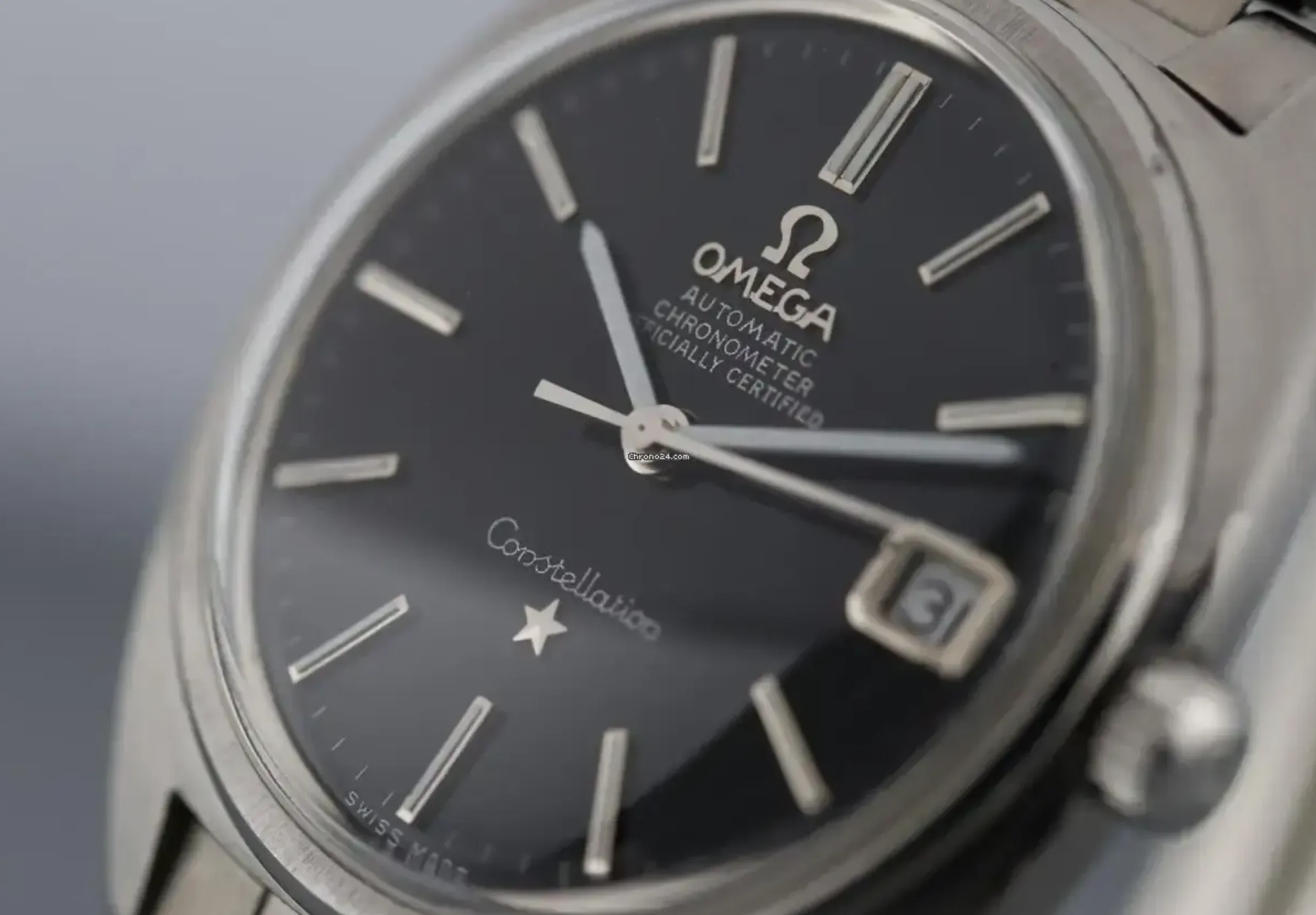

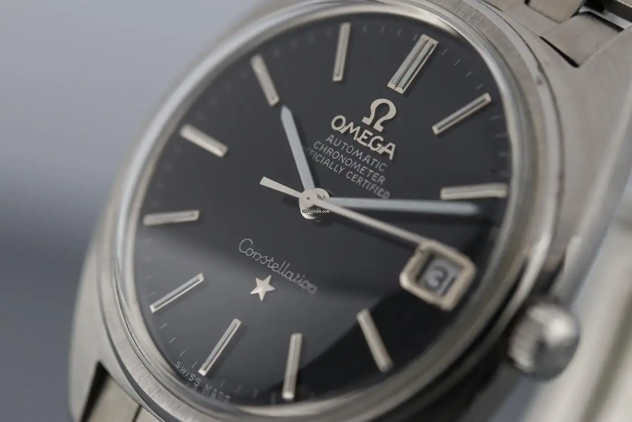

If you want I can refer you to an original gilt watch that has been on the market for almost 5 years now and it's around $1500

Please send, will research more. I have examined it quite closely ith a stereo microscope and the markers at 12 are the same width and along a facet. Would there really be the possibility of a redial done with the galvanic gilt process? I'll work on getting macros.

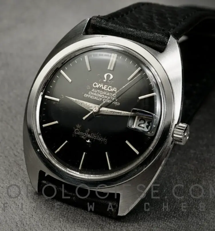

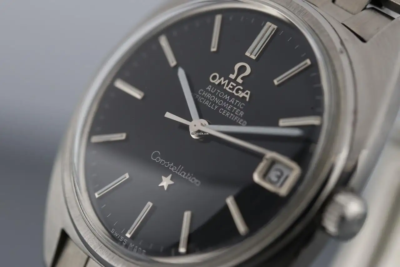

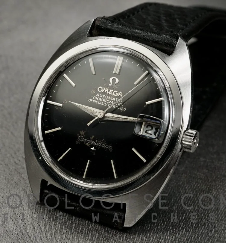

Yes that one was the one I was going to suggest and it is 100% correct - observe the indices that have lume inside them - what you see on that original watch isn't paint, there are grooves in indices that lume goes
Meanwhile your watch has no prior example, and every indication that it's a repainted regular sunburst dial. Indices are the main giveaway.
That watch from lorologiese is one of the rarest of C-Case's, matte black dials are already rare, gilt ones are even rarer, I think for every 10 matte black C-Case there must be 1 gilt variant or less - but for some reason nobody else appreciates its rarity 馃榿 They also bumped up the price, otherwise I had almost convinced a friend to go for it
For a gilt dial - the text is also not printed, it's a layer below the black, there is like a reverse print situation going on - the text being the base material and the black being the paint

Yes I know what a gilt dial is and I know the text is not printed and I know that the watch I have is a gilt dial. I also know that my watch and the one from lorologiese have the exact same typography. Mine is clearly a non-lume version (coming from Japan), if the one on lorologiese has lume on the indices, you know what? Lume is paint. I am primarily a Rolex and iwc collector and understand how important typography is to determine the originality of a dial. Ii also know that galvanic gilt dials are not the method people use for doing a redial. Itotally disagree with your assessment of mine. You seem very hung up on the paint that is on the indices, but the paint is fine. These dials are so uncommon that you can鈥檛 possibly know everything.

Not the same typography - yours is much thinner and from this side shot - they don't have the mirror effect that they should've
I've seen the recent redials from Japan and I also don't recall them being $2500 - you sound like someone who's trying to scam someone off forum and trying to force a validation of your redial watch. My theory is you also realised it's a redial and want to remedy your mistake this way
If you really want to validate your dial - you can just post 10-15 photos using 0.5x lens - or a macro lens, in different lighting conditions. Gilt dials have very low contrast, very easy to show the mirror effect - your video doesn't show it
With these said, I am all for it being original, it's just doesn't seem likely as the case is also clearly repolished etc. All signs of a decent restorers work

I too am not sure that the script matches the cited authentic example shown above.
The original has very heavily serifed text and from your pics, the Ms in the first two lines don't appear to match on your watch.
It would be useful to post some clear straight on images of your watch with hands clear of the text.

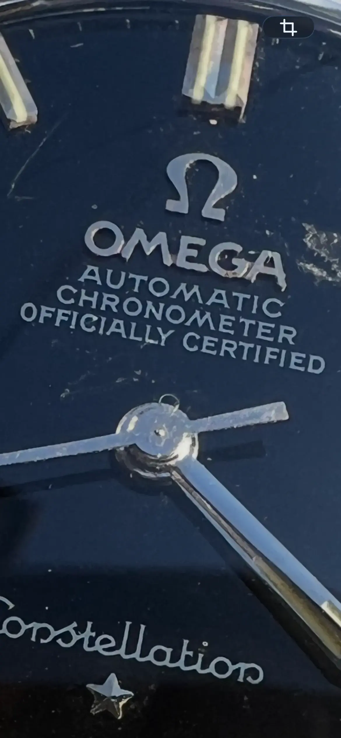

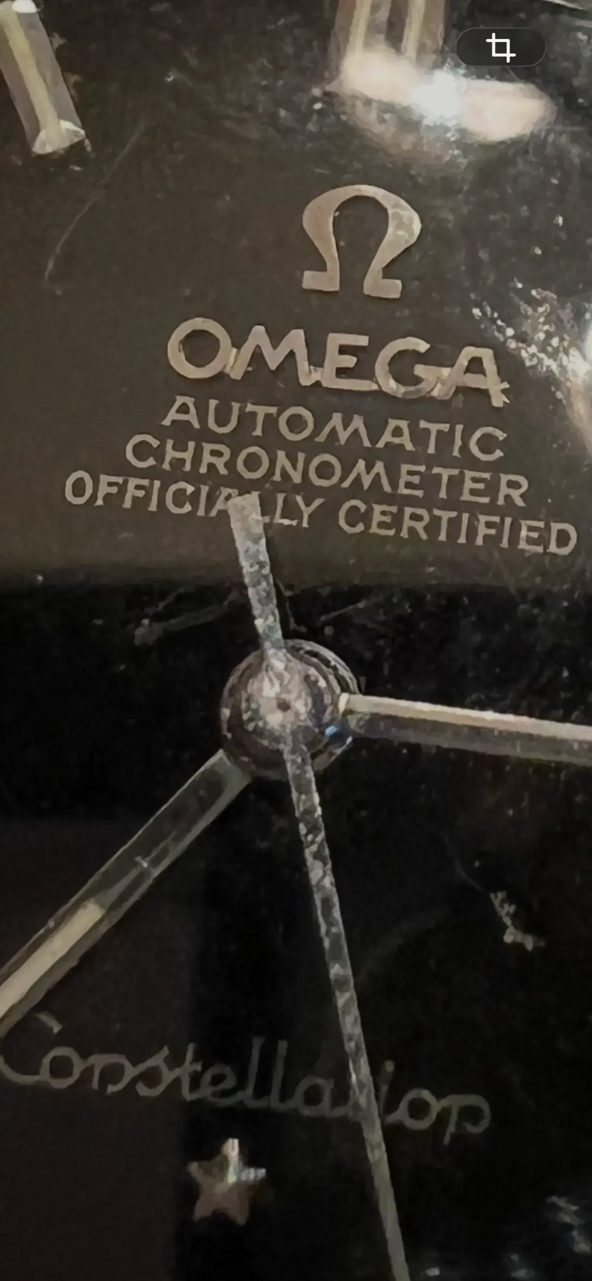

Here is a similar black gilt dial on a 168.010 with similar dial furniture to compare text- note serifs are quite prominent
It has some typical lacquer degradation common to these dials
While it is not C case the black gilt dial features should be similar it seems

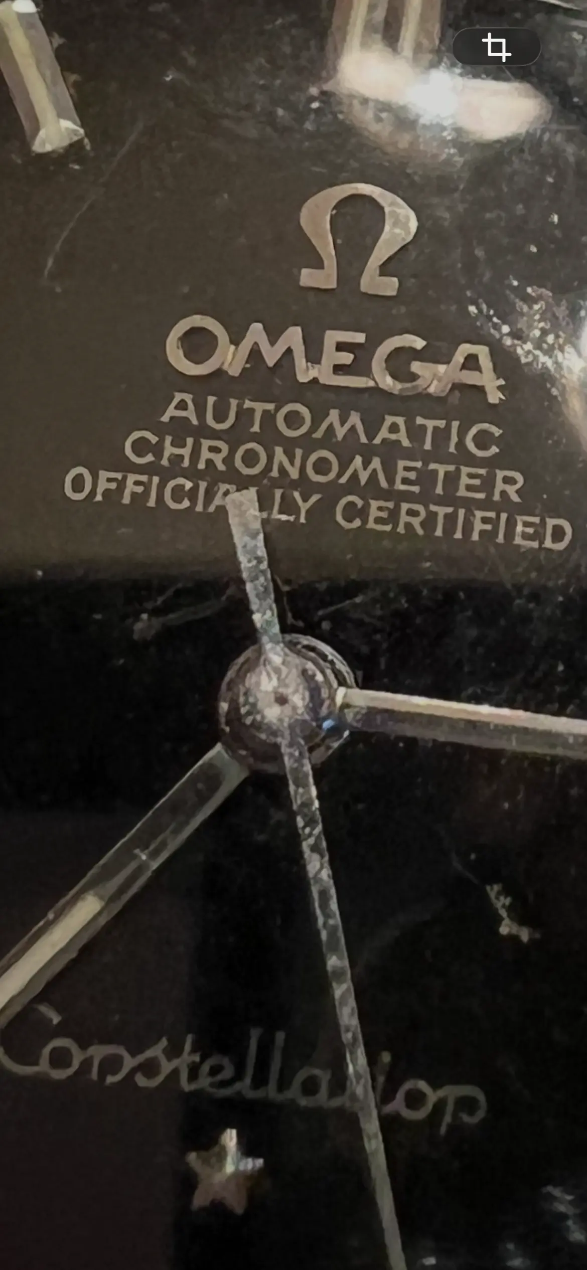

My dail has heavy serifs as well, as I said that typography is an exact match. Also, (again) it鈥檚 galvanic gilt and I highly doubt anybody is re-dialing with that method.. I will see if I can get some macros this week. How I long for a royal decree from the king of the C Case ha ha.
6,852
10,538
My primary concern is the M in 'chronometer' appears to have a narrower stance and less pronounced shoulders than the M in 'automatic'.
However, it may simply be an artifact of the photo - better images would help.
Looking forward to seeing them.
