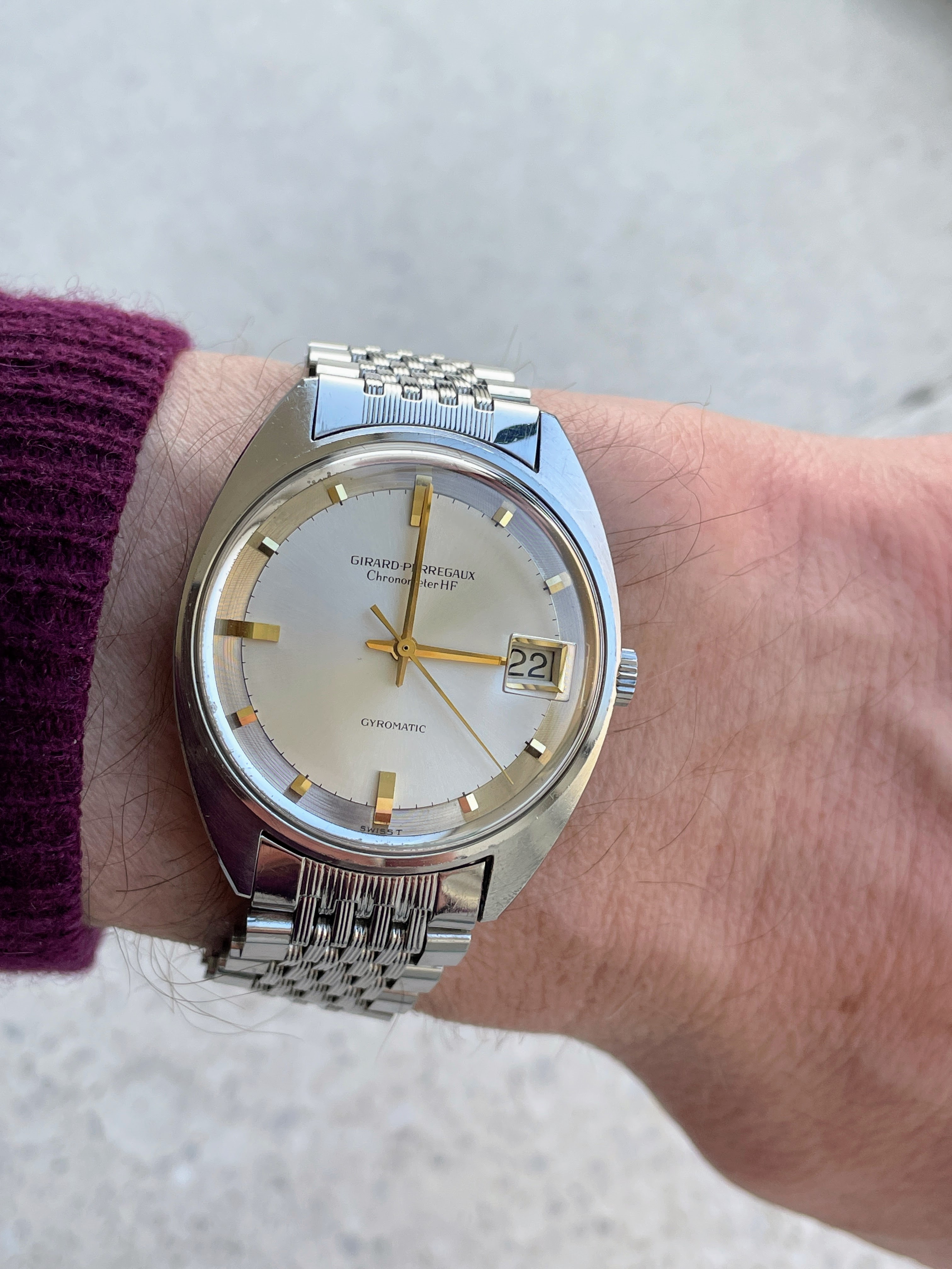

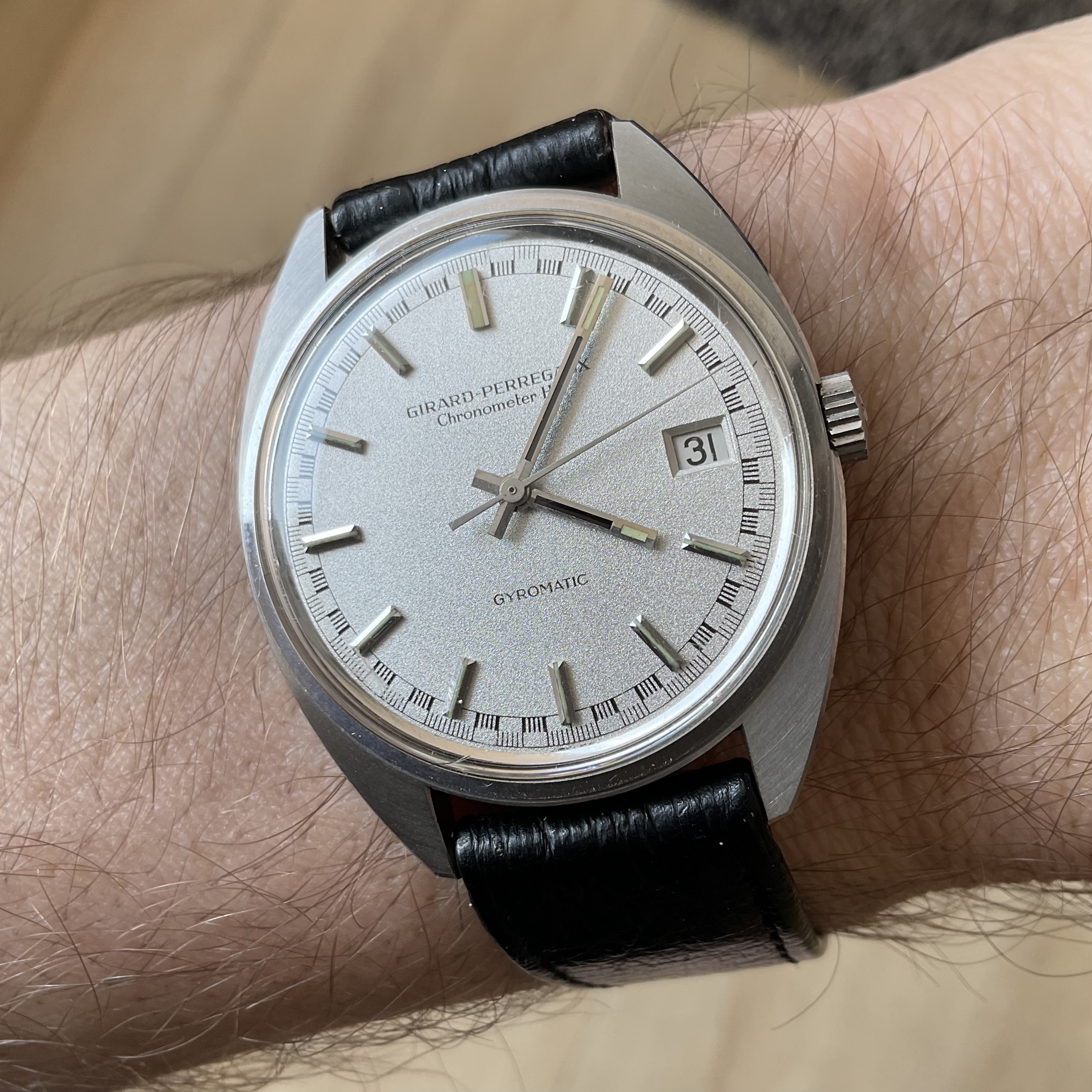

Here are my two (steel 8795 with original bracelet, and 18K 9086):

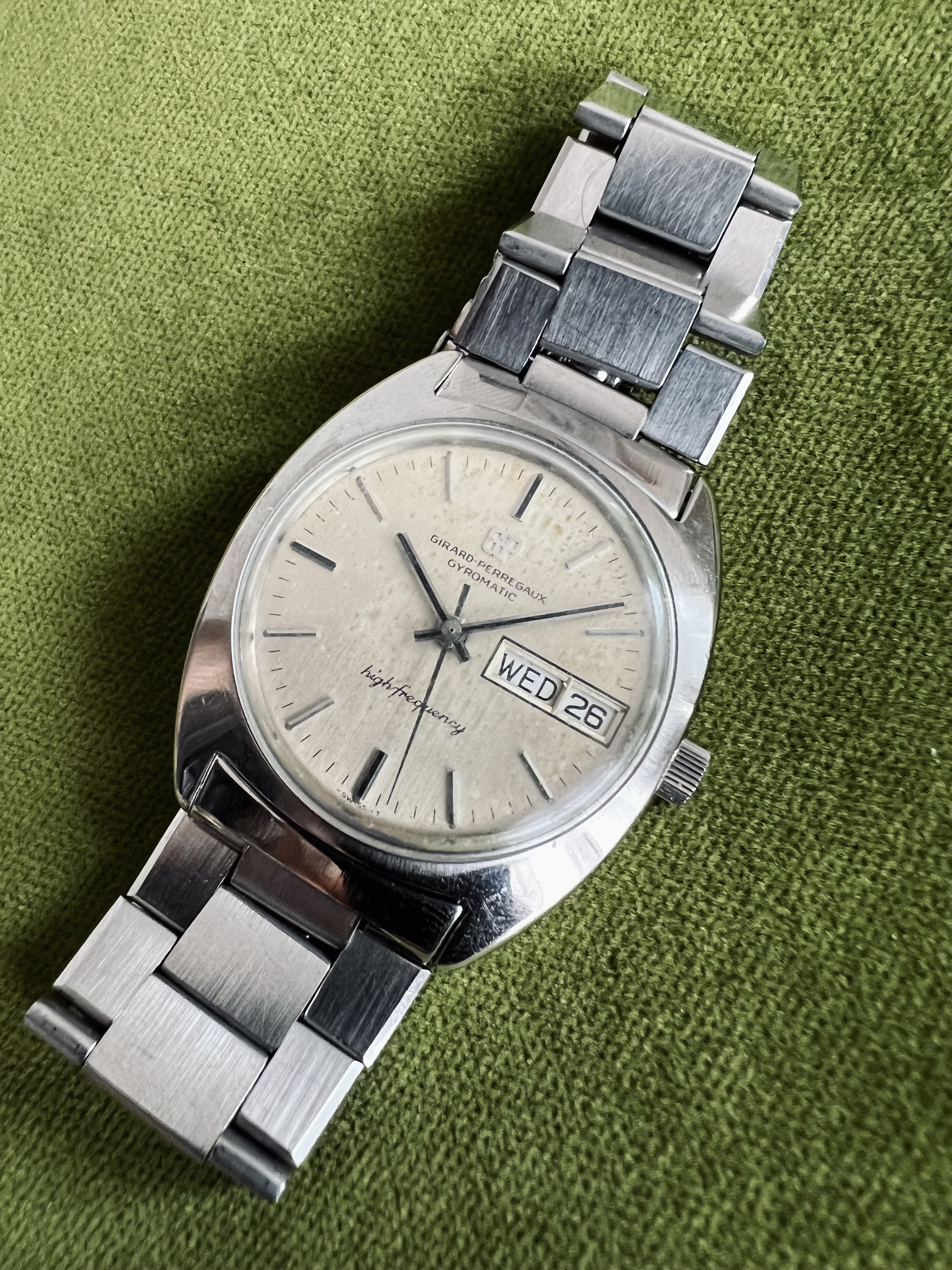

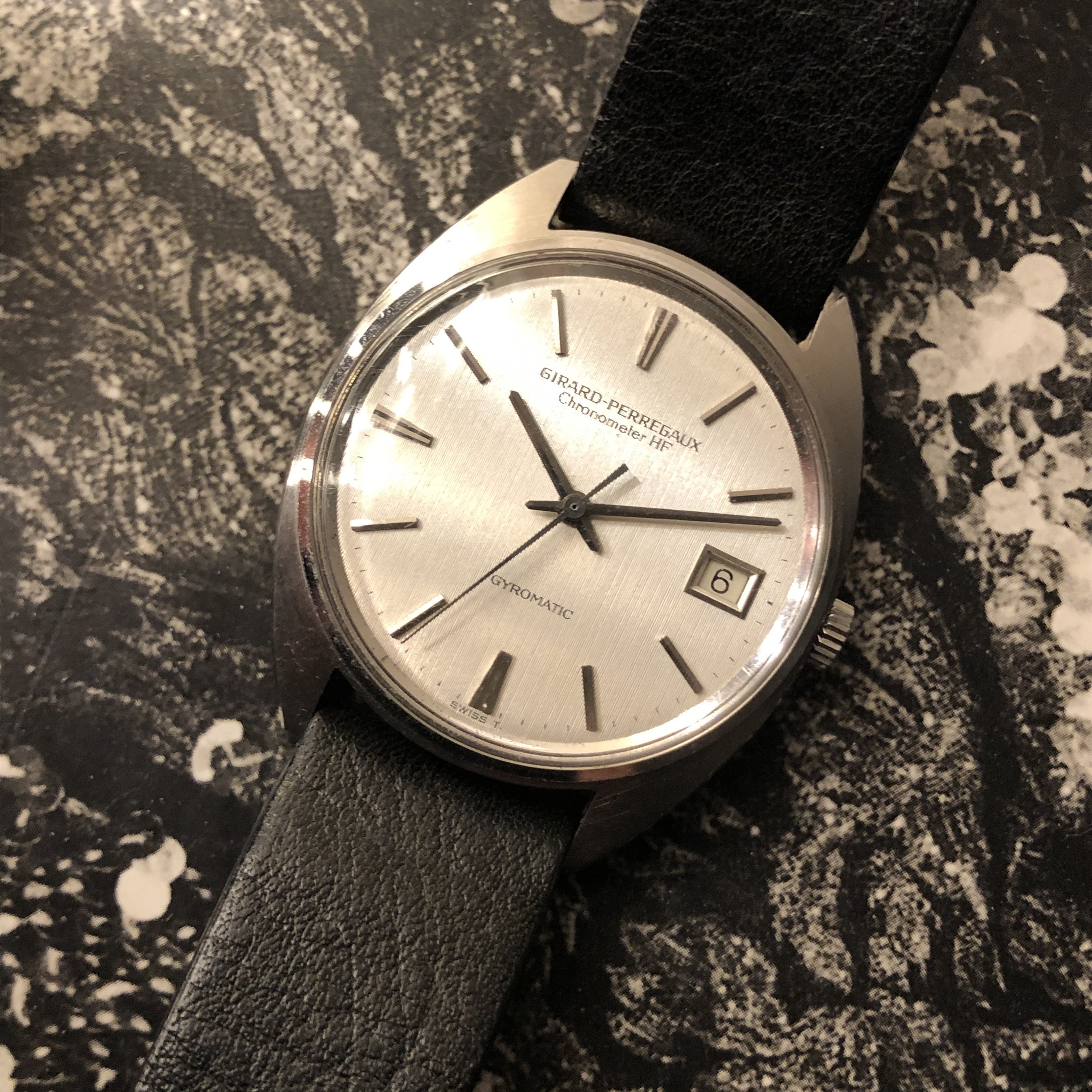

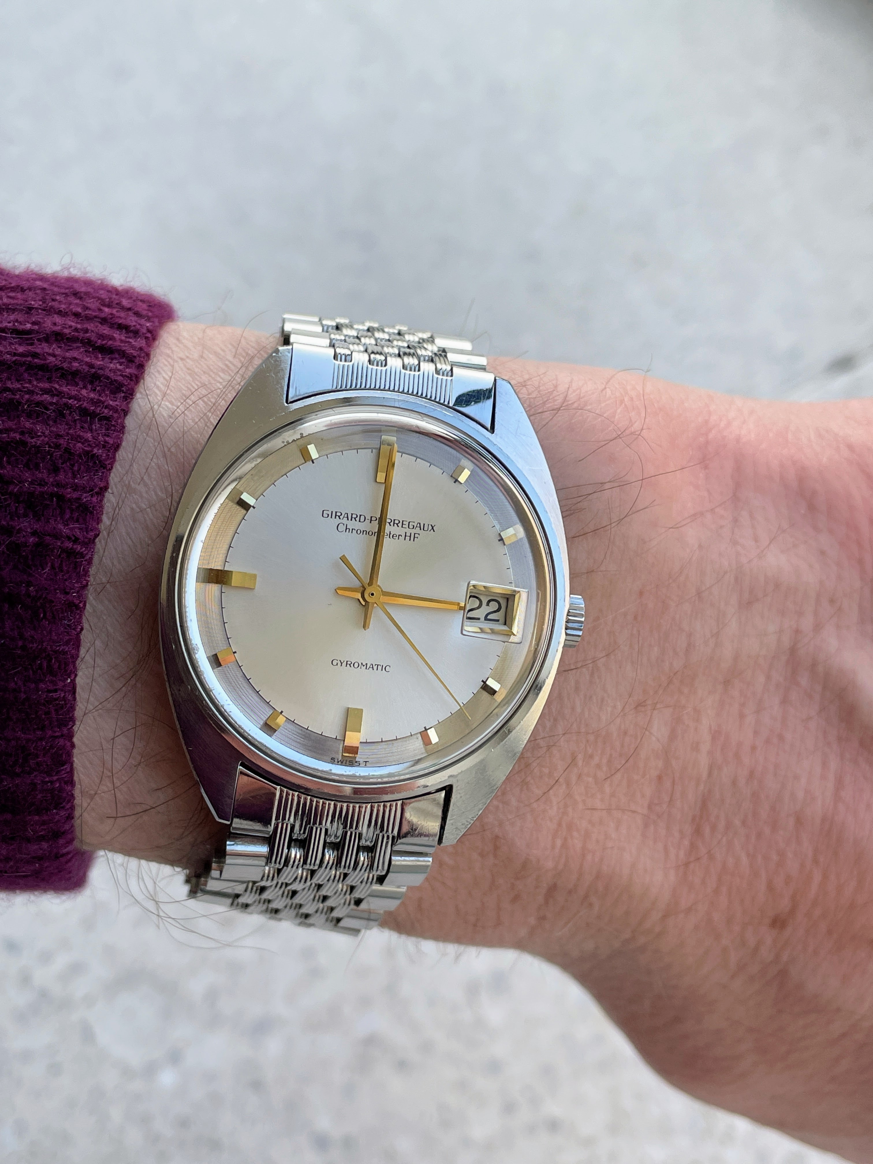

My somewhat blotchy version. I agree they are lovely watches. Thanks for making a home for them!

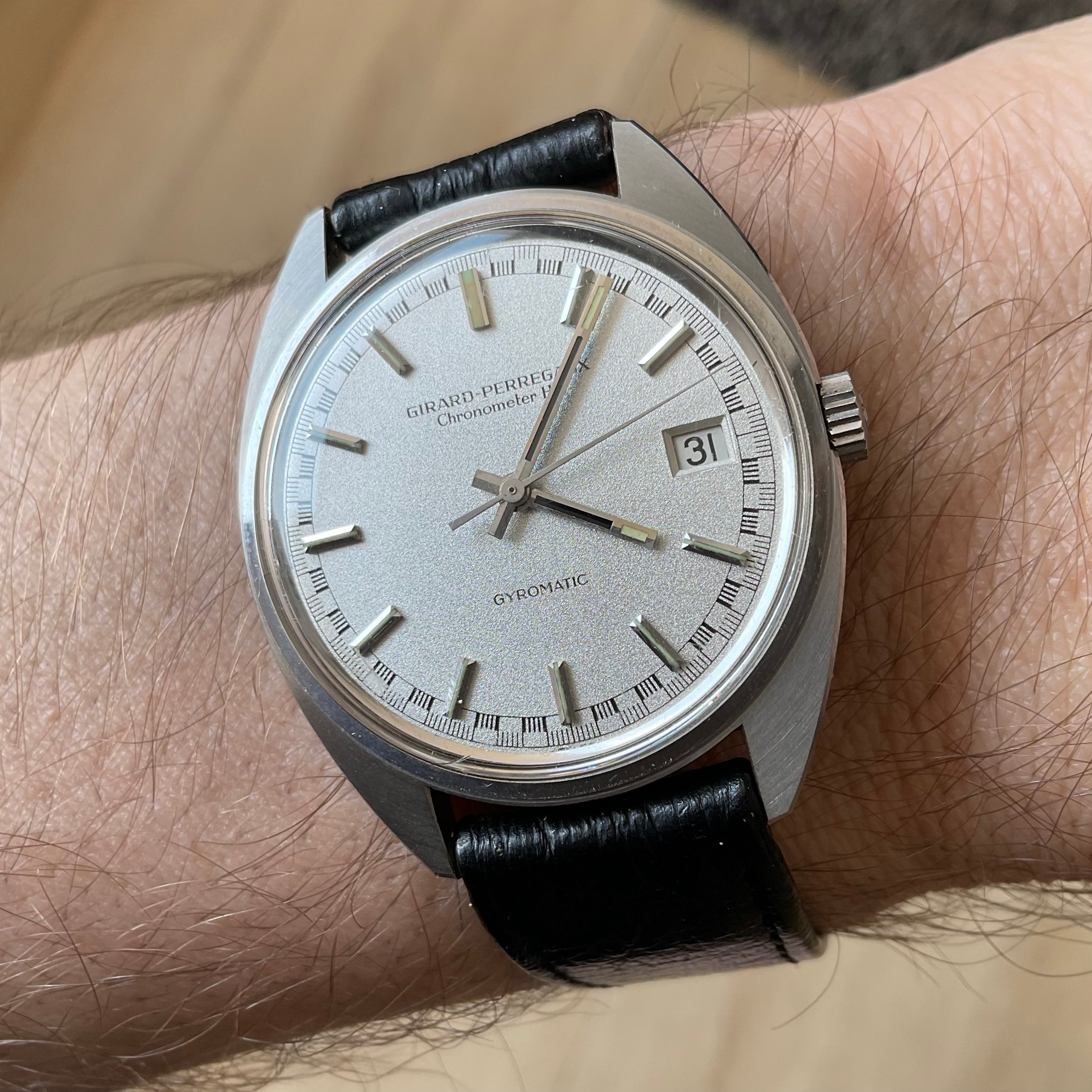

Both of mine are astoundingly accurate and stable across different positions. Which is more than I can say for my Longines 431 36,000 bph, which is a little temperamental. Small sample size though!

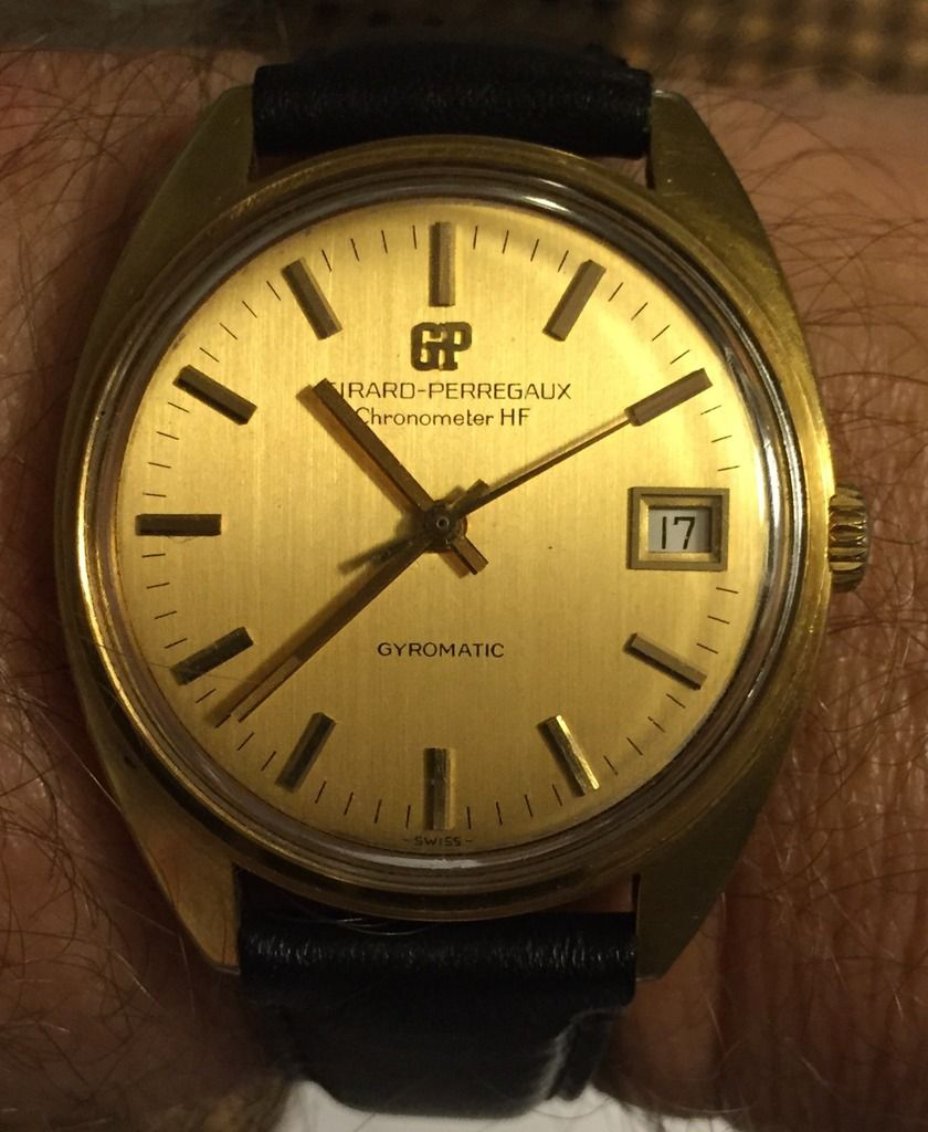

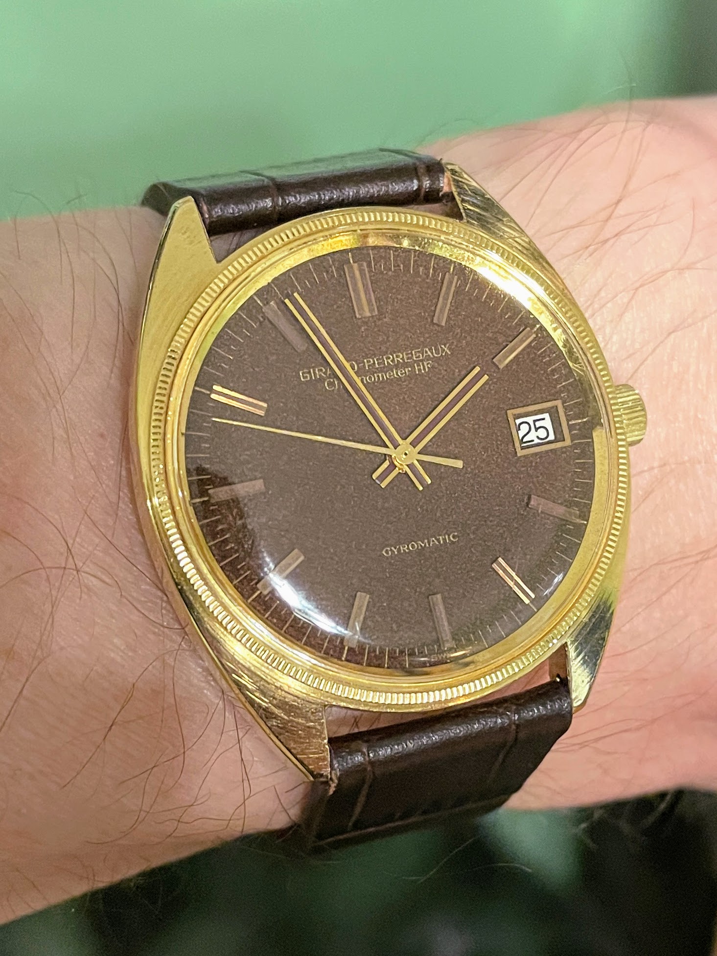

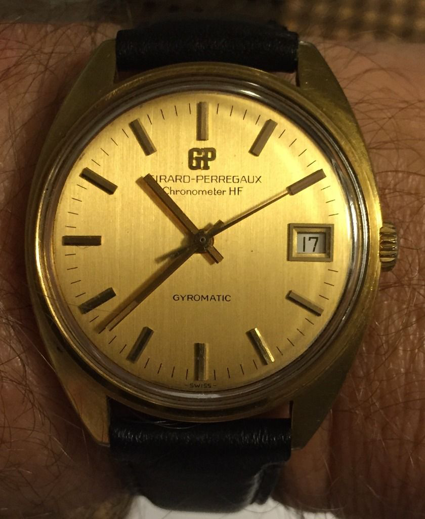

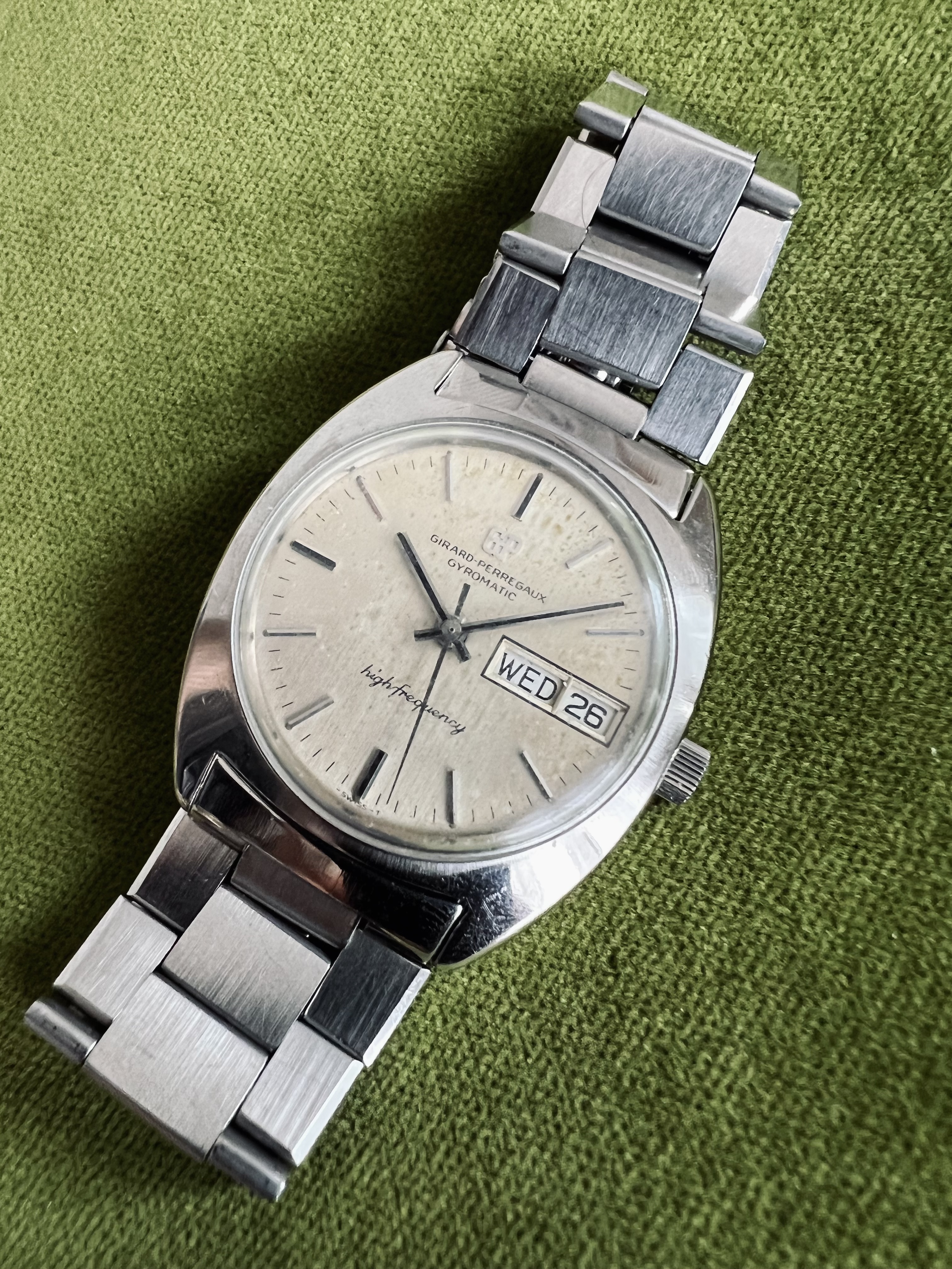

Here’s my gold plated version, Ref. 9086.

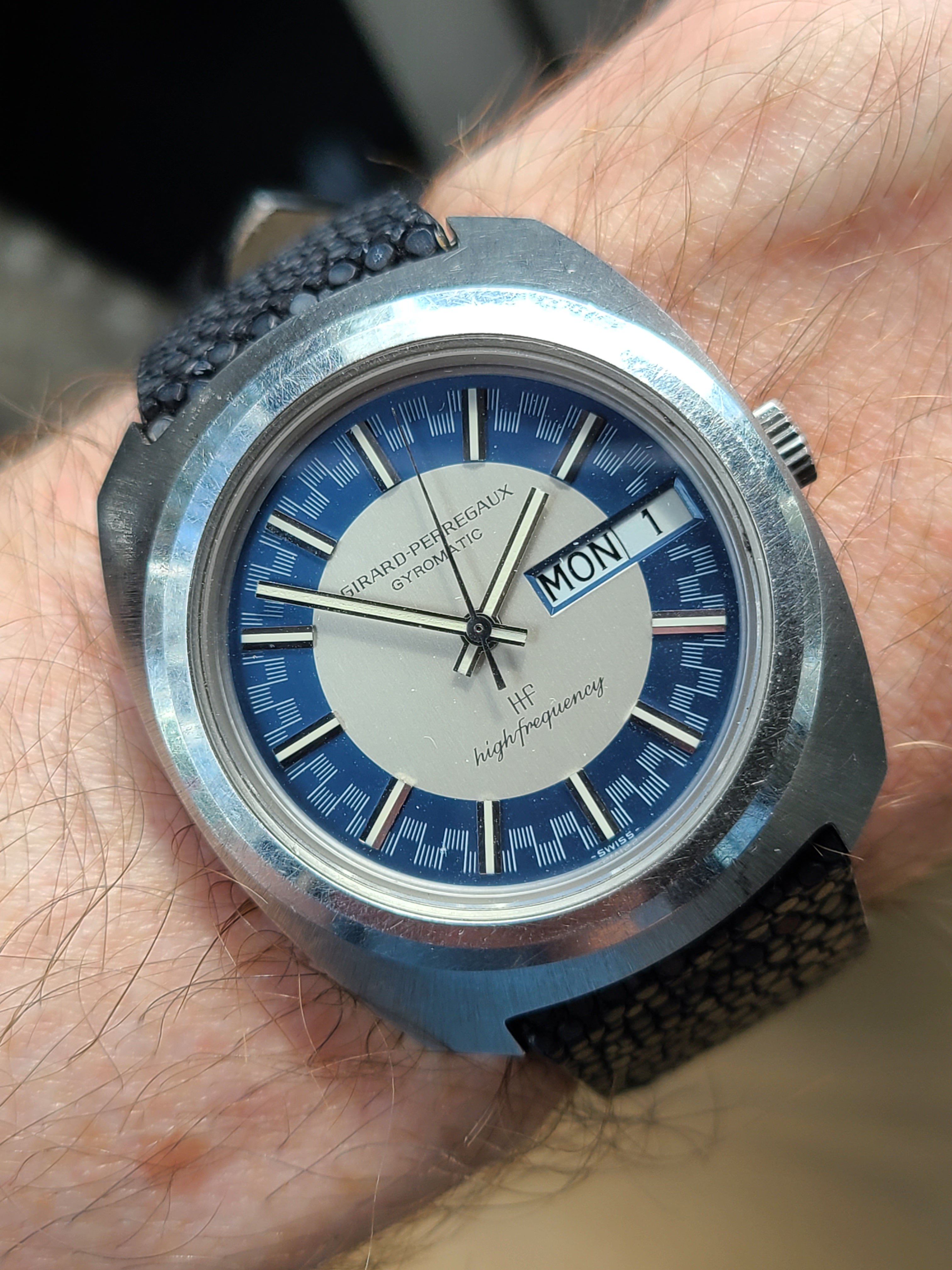

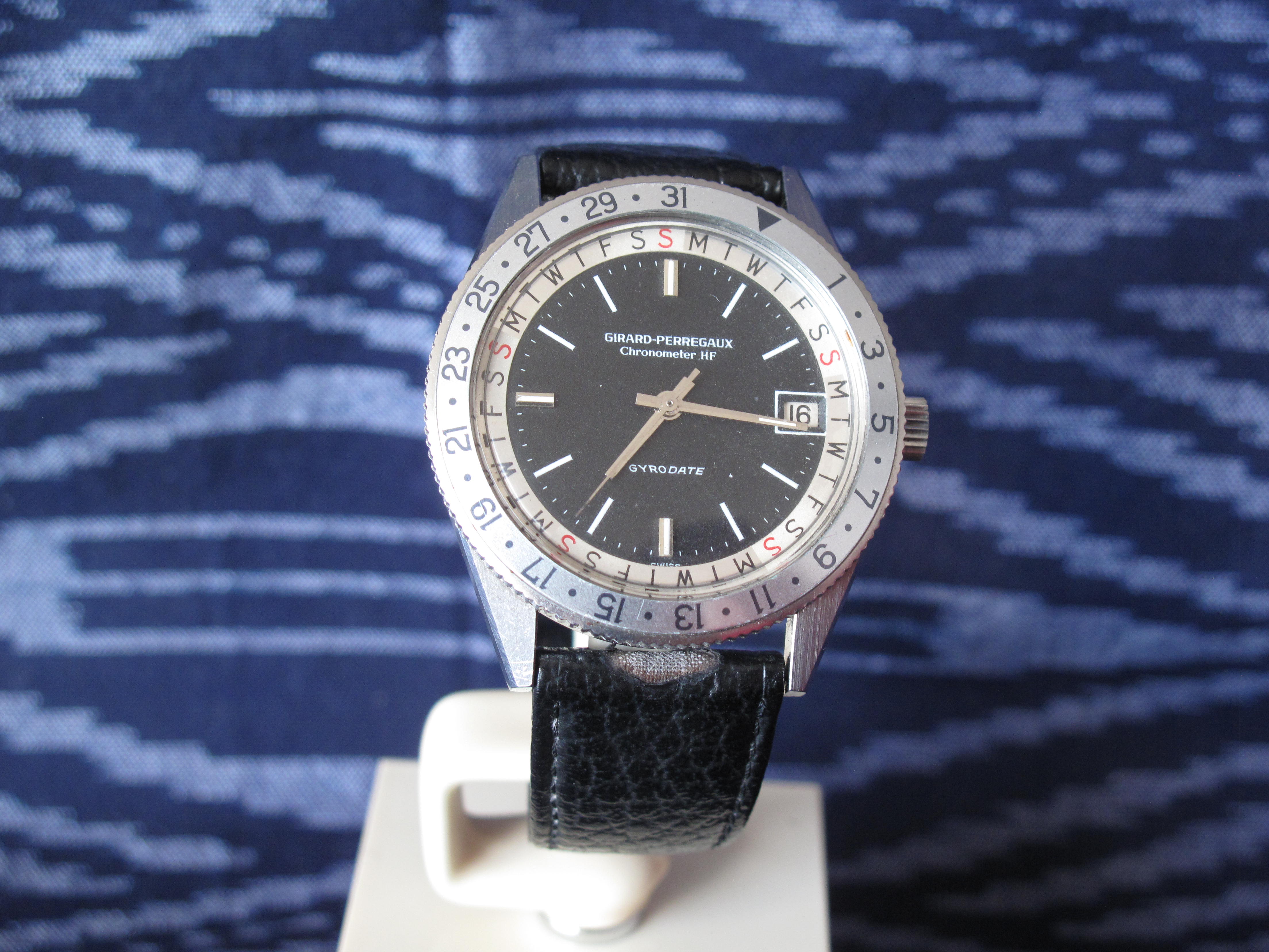

No C cases, but a Ref 9000 and blue tuxedo racing dial (kind of in between the Observatory cases and a C):

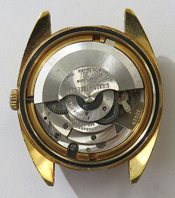

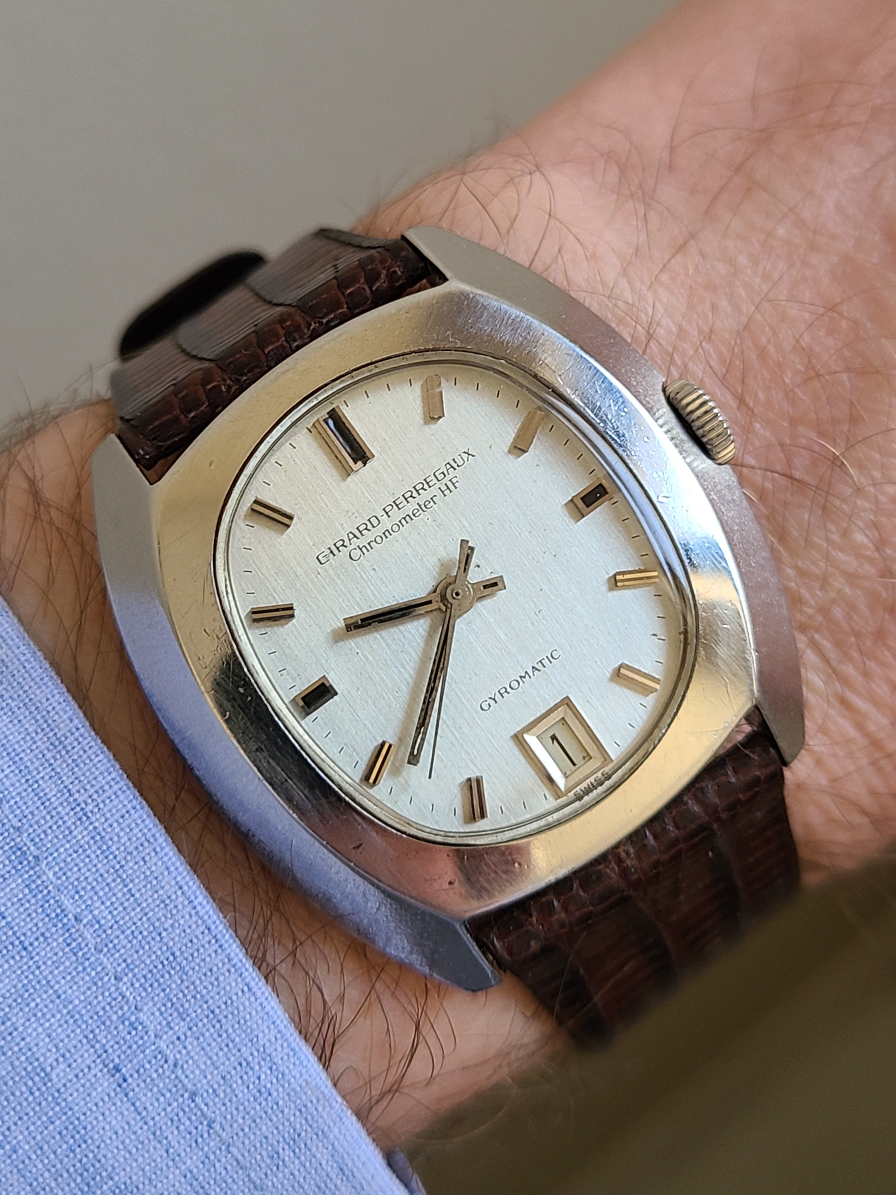

Here’s my sparkle dial 9086, still on it’s original GP strap with sun buckle.
The GP museum provided this info:
“The GP 41 movement, based on an AS 1843 ebauche, has been produced in 1968. The other number on the main plate is individual. It was needed to pass the Observatory tests. The ref. is 9086 FA. There were several versions (steel, gold plated and 18k gold). In steel like yours, 500 pieces were made, with different dials. Its retail price here in Switzerland was CHF 380”.
I'm curious about the blue dial day-date. From some research, these watches used a different movement series from the other GP 36,000 bp watches. The 32A, 42.1 etc. were based on the AS 1687/1688, while your watch has the GP 440 movement (based on the AS 1920).
The day-date option wasn't available on the 32A series. In the 32A however, the date changes instantly at midnight, Rolex fashion. I'm curious whether the 440 day-date retains the instant change or whether it changes gradually over an hour or so (like the Omega 751). If it has an instant change, it would be one of very few day-date watches that have instant change for both day and date at midnight.

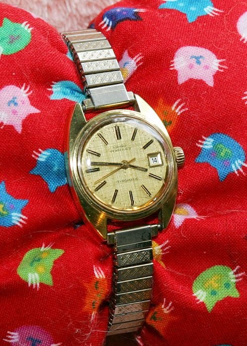

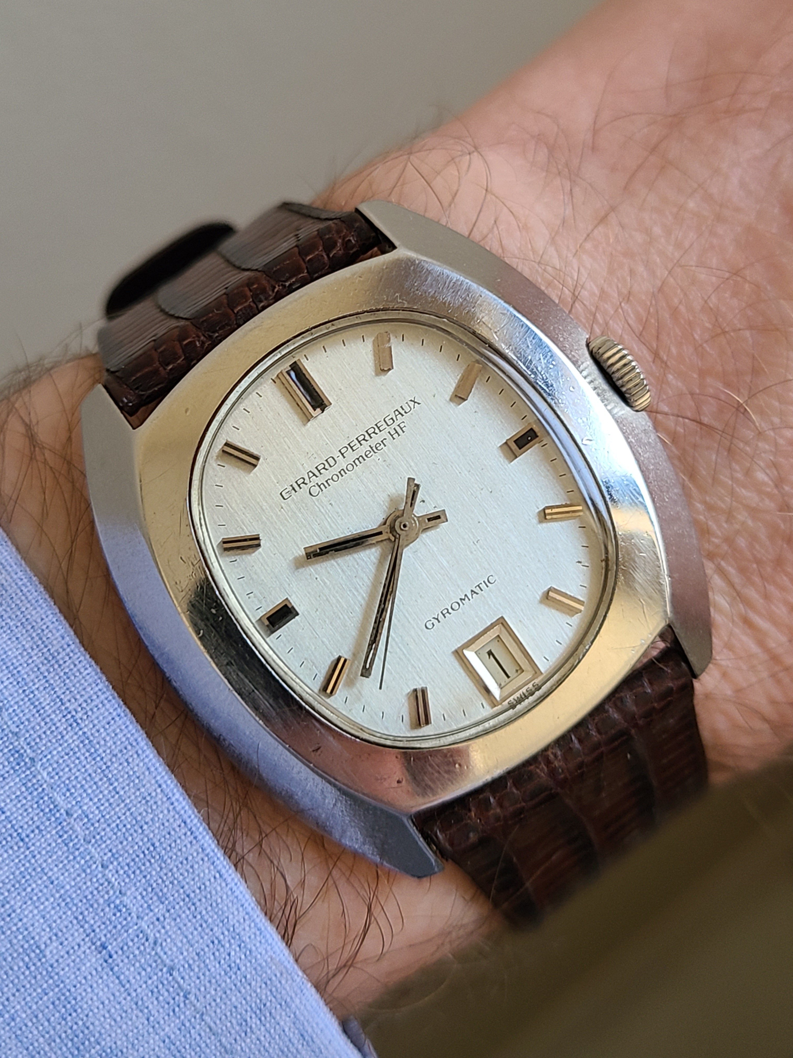

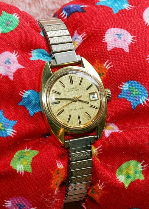

Not a chronometer, but definitely a C-cased gyromatic. In this case, my diddy ladies' version. The linen dial really pops in sunlight.
