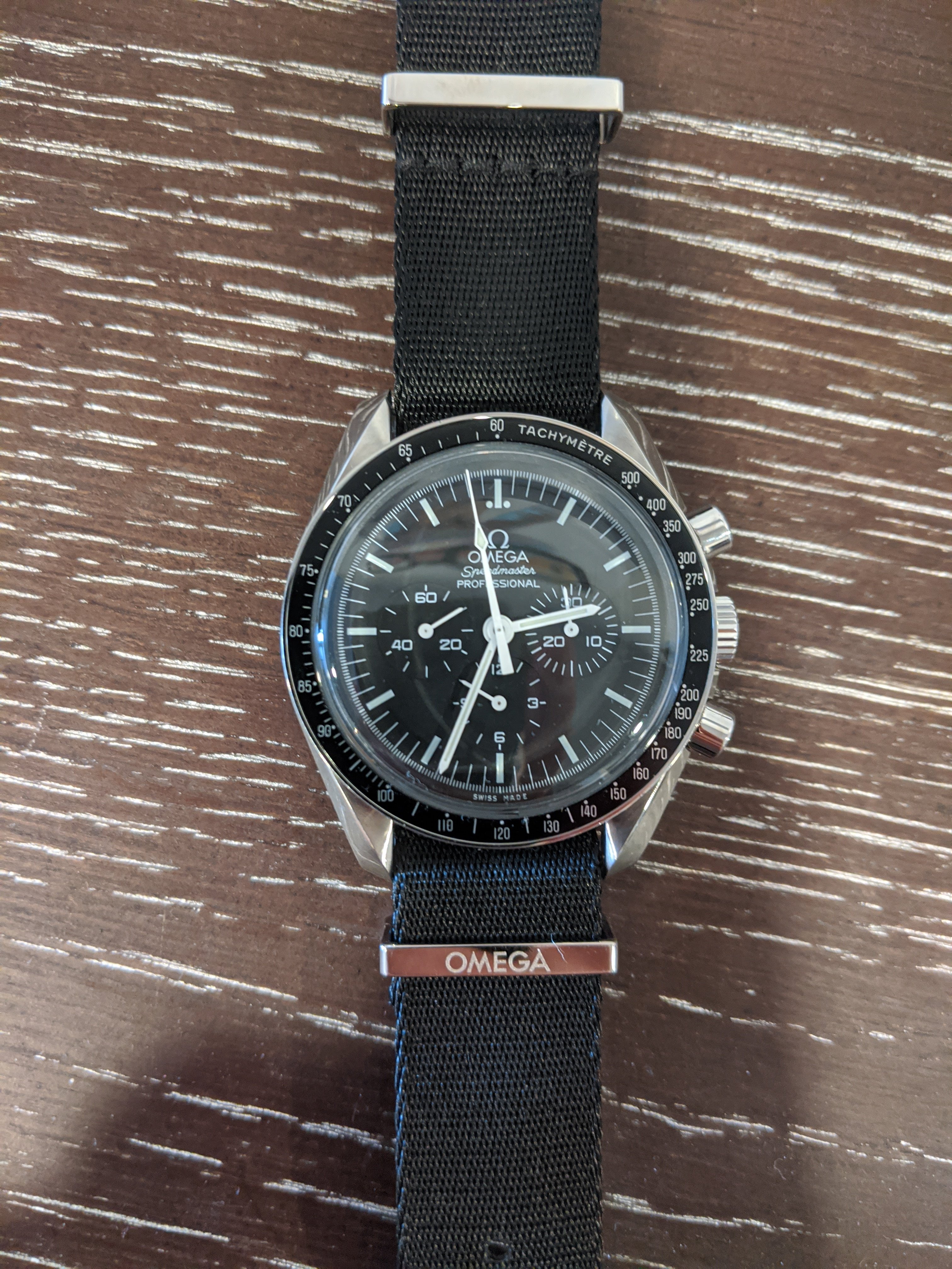

Now just switch the chronograph off, and see how much longer it runs...
Clicked the chronograph start/stop, it ran for an additional 16 hours and 34 minutes. Total charge of 50 hours and 34 minutes.
30,293
78,220
Omega states that the watch will run 48 hours on a full wind - you have 50.5 hours, which is usually what I see in these watches when I am done servicing them. Based on this, your watch will run for the full reserve, so nothing wrong there.
I asked you previously to replicate the same conditions that you experienced when the watch stopped before, and you ran it down with the chronograph on, so does this mean you run the watch with the chronograph on all or most of the time? I believe you previously stated that it has never stopped on you when the chronograph wasn't on.
Your original complaint was this:
"I wore the watch for a couple months, but in the fall the watch stopped a couple times randomly while there was definitely still energy stored in the spring."
The watch will stop when the torque being supplied by the mainspring is insufficient to keep the watch running. When you turn the chronograph on, it adds load to the wheel train of the watch, and the watch requires more torque to stay running. So as the torque from the mainspring drops, the watch will stop sooner then when there is less load on it - that's why it continued to run for 16+ hours after you turned the chronograph on, and you have stated you could always get it started again by pressing the button to stop the chronograph. It will typically stop at peak load, which is when the finger on the chronograph wheel contacts another wheel, which in turn flips the minute counter - this is exactly where your watch stopped after the first test.
Now there isn't a specified time that the watch should run with the chronograph running, so there's no way to say that running for 34 hours is normal or not, but based on my own testing it's not all that unusual. It's possible that the spring on the minute counter jumper that has to be overcome to flip the minute counter is maybe set a big heavy, but to me this is not a concern.
Based on all the numbers here you have given, I don't see anything wrong with your watch. I know many want to say you should demand a replacement right away and such things, but in all honesty your watch appears to be running just as it should. You have said you wind it fully every day, but sometimes people forget - I know I do, and my gut feel would be that if you are running the chronograph all the time, you have mon occasion forgotten to wind the watch, and it's stopped.

Interesting problem. First, nobody but you knows for sure if you're winding it fully and at the set intervals you say, but I'd wager you're remembering things correctly. All I can say is I think (obviously) there's something unusual wrong with the watch that's messing with the power reserve. I think the best thing would be to send it in again, making sure they know the weird nature of your problem. I think something unusual is happening in the movement that only a full overhaul can fix. But Archer is a Master, I am several stages below in the cringing vermin class of watch knowledge. He knows his stuff. In any event, best of luck. If you keep the watch for a long time, this odd problem will vanish into the past.

Archer,
Really appreciate your input on this! I have been paying extra attention to ensuring my watch is wound each morning, hoping you are right in thinking I just forget every once in a while.
Unfortunately I just woke up to find the watch stopped again. When I wound the watch again it took far fewer turns than normal, indicating to me that it had not only stopped prior to a full day, but it had actually only run for approximately 10 hours and 30 minutes before stopping. I didn't check to see if it was still running after taking it off right after work, so I can't confirm it wasn't 22 hours and 30 minutes. Either way, I still think there's something wrong with the watch.
The chonograph was running, as it seems is the case every time the watch stops. And your point regarding the minute counter jumper holds true, in fact in every picture I've taken of the watch stopping the chronograph hand is at ~58 seconds. Another thing I've noticed is that when the watch stops I am able to get it going again by clicking the start/stop on the chronograph twice. Next time it stops early I will see how long I am able to run it with the chronograph still running.
