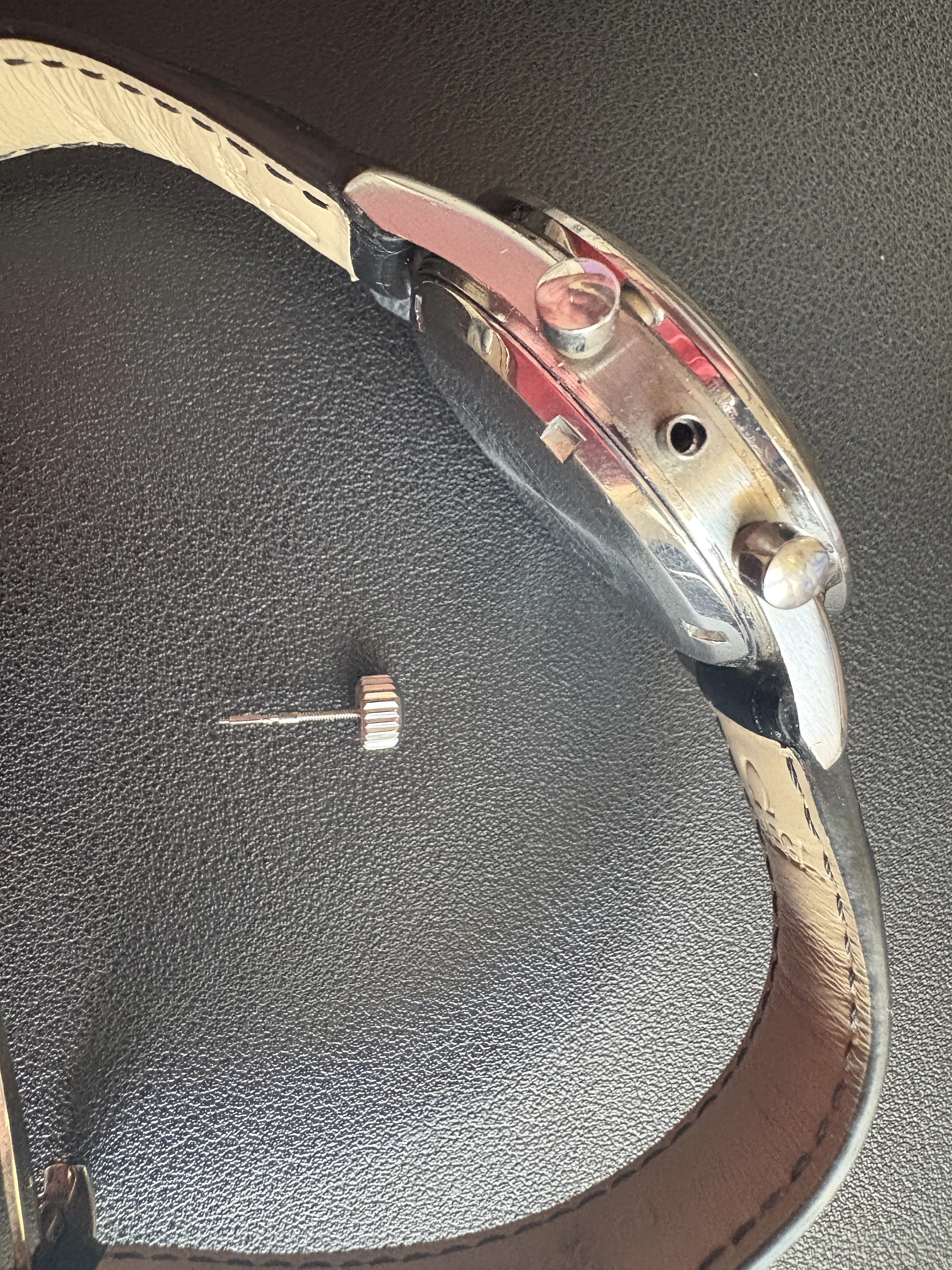

I have a 1967 Speedmaster 105.003. The crown and stem have recently become detached from the watch movement, (see photos).
My question is if this is a simple repair that could be done locally be a decent watchmaker ... or is this something that is best left to Speedmaster/Omega/321 specialists? The watch was my Dad's so has huge sentimental value. I don't want to skimp on the repair but would rather not be sending it away for months on end if I don't need to.

Short answer; depends on what they find when they open it up.
There is a good chance, IMO, that it is the set screw that holds the stem in place got loose and the crown & stem needs to be reinstalled and that screw tightened. Any competent watchmaker can handle this.
If however that screw was loosened too much you have a bigger issue that requires a lot more disassembly. In that case you may want to go to a vintage specialist.
I’m just a hobbyist, a real watchmaker will most likely chime in with a better response.

i (also i am no watchmaker) think, what "140dave" wrote is correct - if the screw (angle screw) was loosend
(and that should be the reason) it is possible, that the angle spring lever is/will be shifted by for example
pressing the crown in, but
every watchmaker can try to fix the screw, so that the winding stem is fixed and in a few minutes
everything will be ok (with a bid of luck)
otherwise (if the spring lever is shifted) for reason, that it is a chrono-movement, there will be necessary
a partial movement dismantling and that should do someone who knows what to do

Set screw loose…set screw broken…setting lever damaged. In any of those instances, it’s an easy fix for a competent watchmaker.
