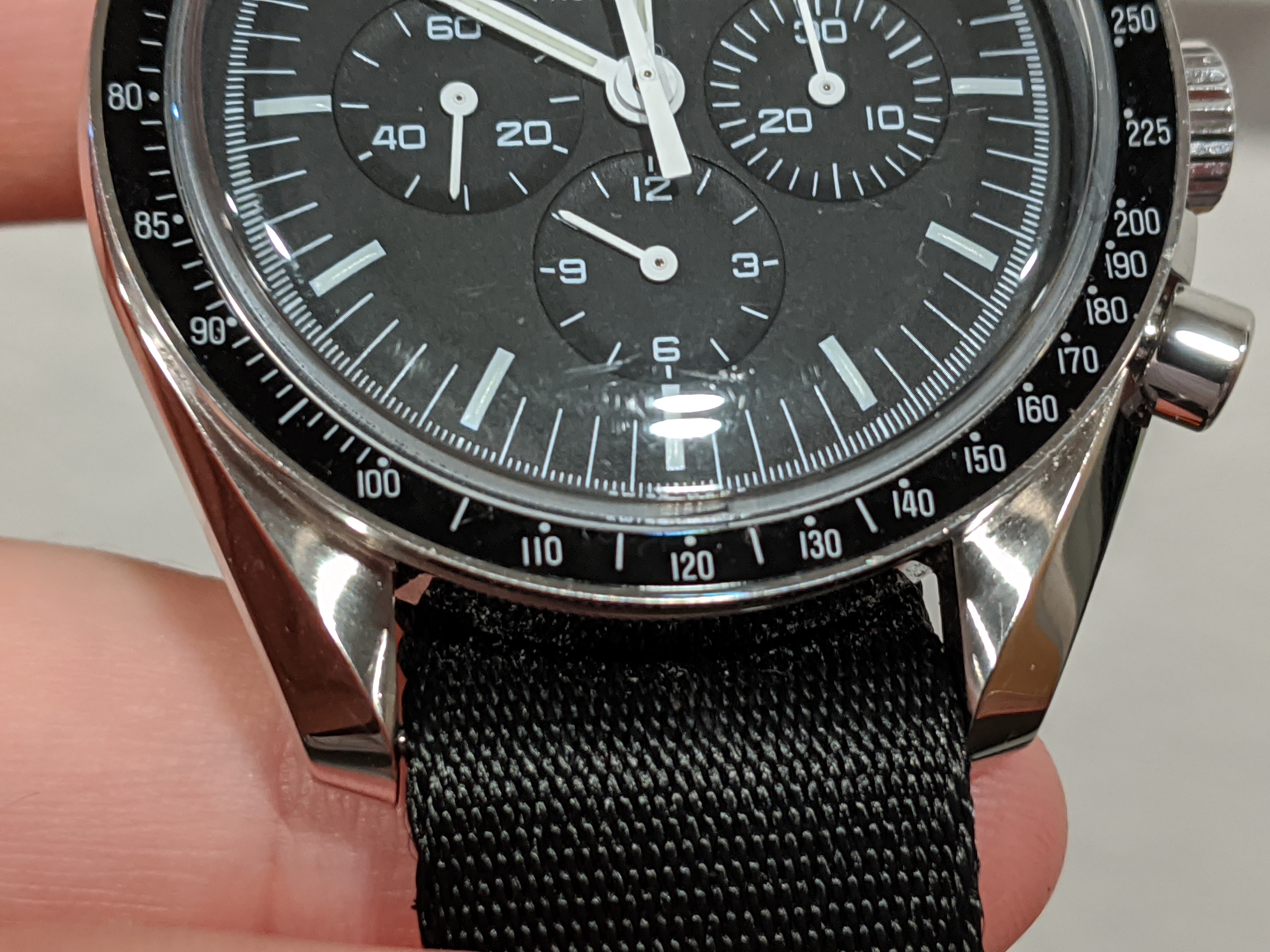

My Omega ownership experience has not been ideal, and I would greatly appreciate some input. I purchased my speedy (311.30.42.30.01.005) this past May 2019 from an Omega location. After wearing the watch for a few days I noted the crystal was slightly warped (to the point of being slightly concave in the center) and after posting about it here decided to bring it in to an Omega location in NYC. The watch was sent back to me in Denver, where I now live (no Omega locations here), crystal looked great but there was a fiber underneath it in the bottom-most edge. No big deal.

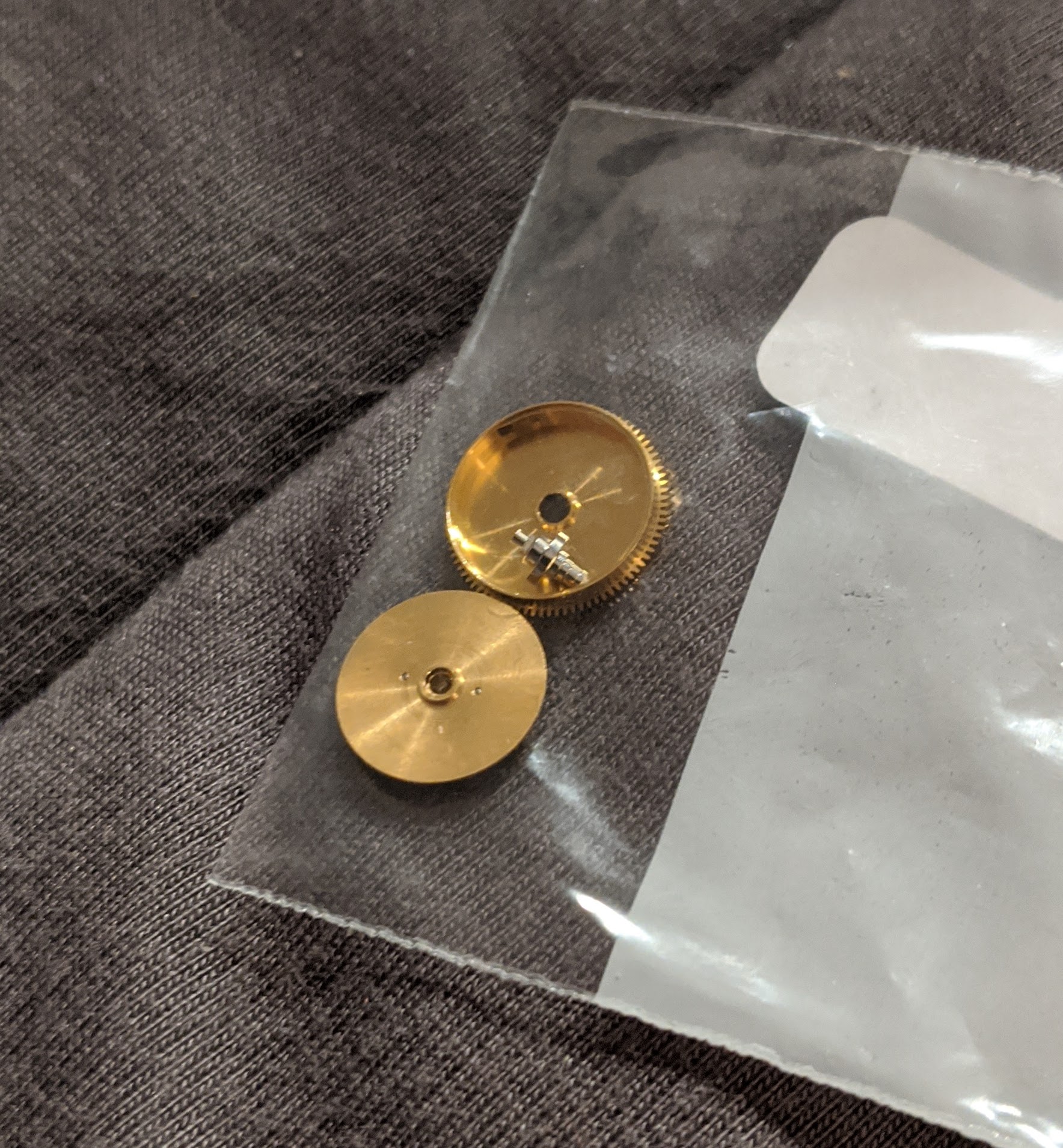

I wore the watch for a couple months, but in the fall the watch stopped a couple times randomly while there was definitely still energy stored in the spring. I called Omega and sent it back in, mailing it to the Swatch repair facility in Culver City, CA, citing the fiber under the crystal and the random stoppages. Watch was returned to me just before Christmas. Fiber was still under the dial. Annoying but I'd rather live with it than send it back in and part with it for another month. No specifics of the repair performed were revealed to me via the Swatch Group Customer Information System Website or the documentation returned with the watch. Included with the watch was a bag with parts in it, which I assume were replaced (see attached image). This morning, the watch was stopped again when I woke up.

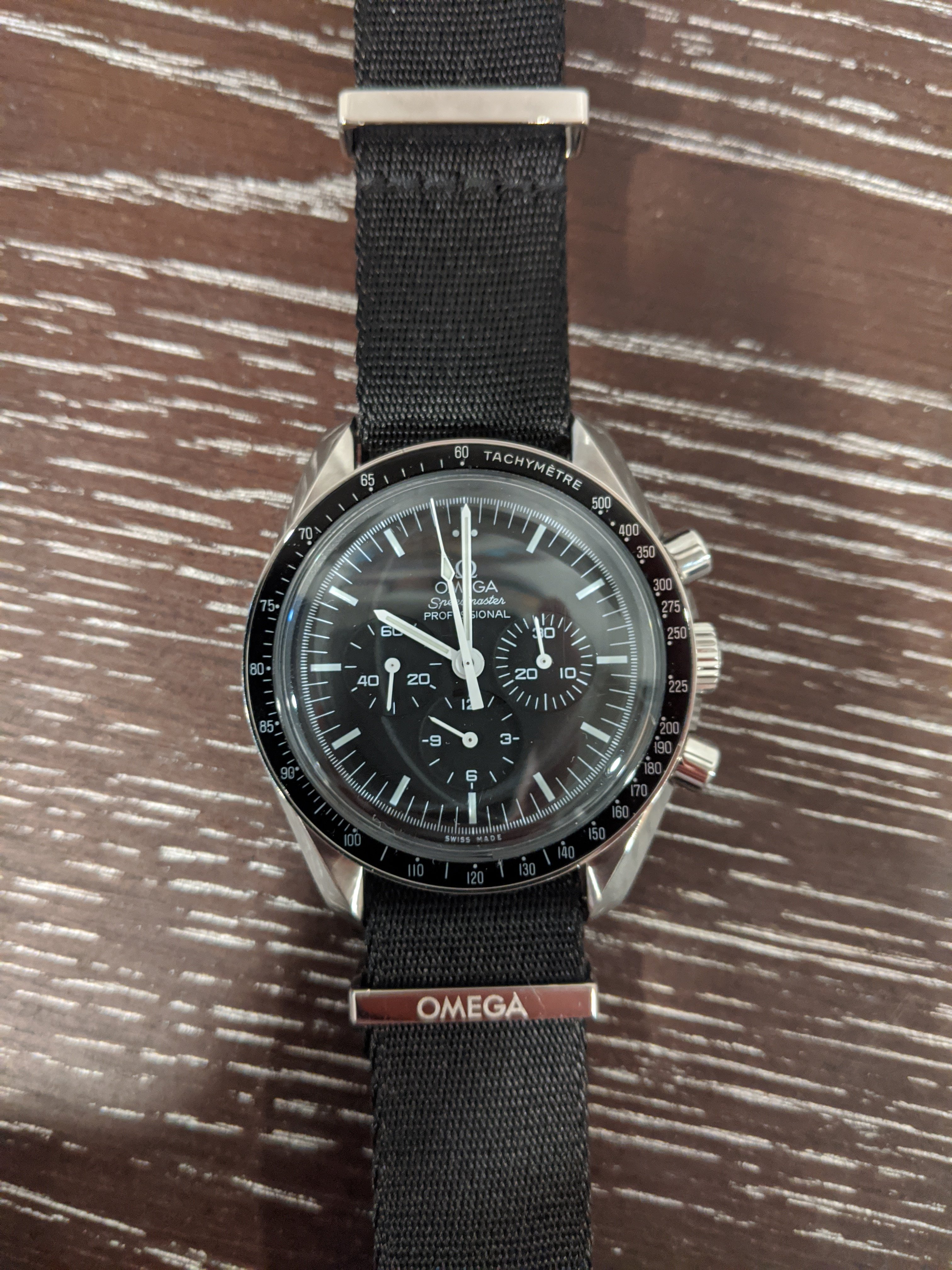

If it does stop, say before reaching 48 hours, take out your phone and post a photo showing the positions of the hands. Looking for hand interference, in particular with the central hour hand being on top of one of the 3 sub-dial hands.
11
Should I run the chronograph as well? And is there a time I should set it to to start?
30,293
78,220
Replicate whatever conditions are present when the watch randomly stops. If you were running the chronograph at that time, run it. If you were not, then don't.

Watch stopped after almost exactly 34 hours (started with hands at noon). Doesn't look like an interference is possible given the current orientation of all the hands. Additional photo added to show aforementioned fiber. Leaving it stopped in case you have any additional tests you'd like me to run.
30,293
78,220
Now just switch the chronograph off, and see how much longer it runs...
