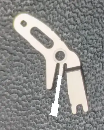

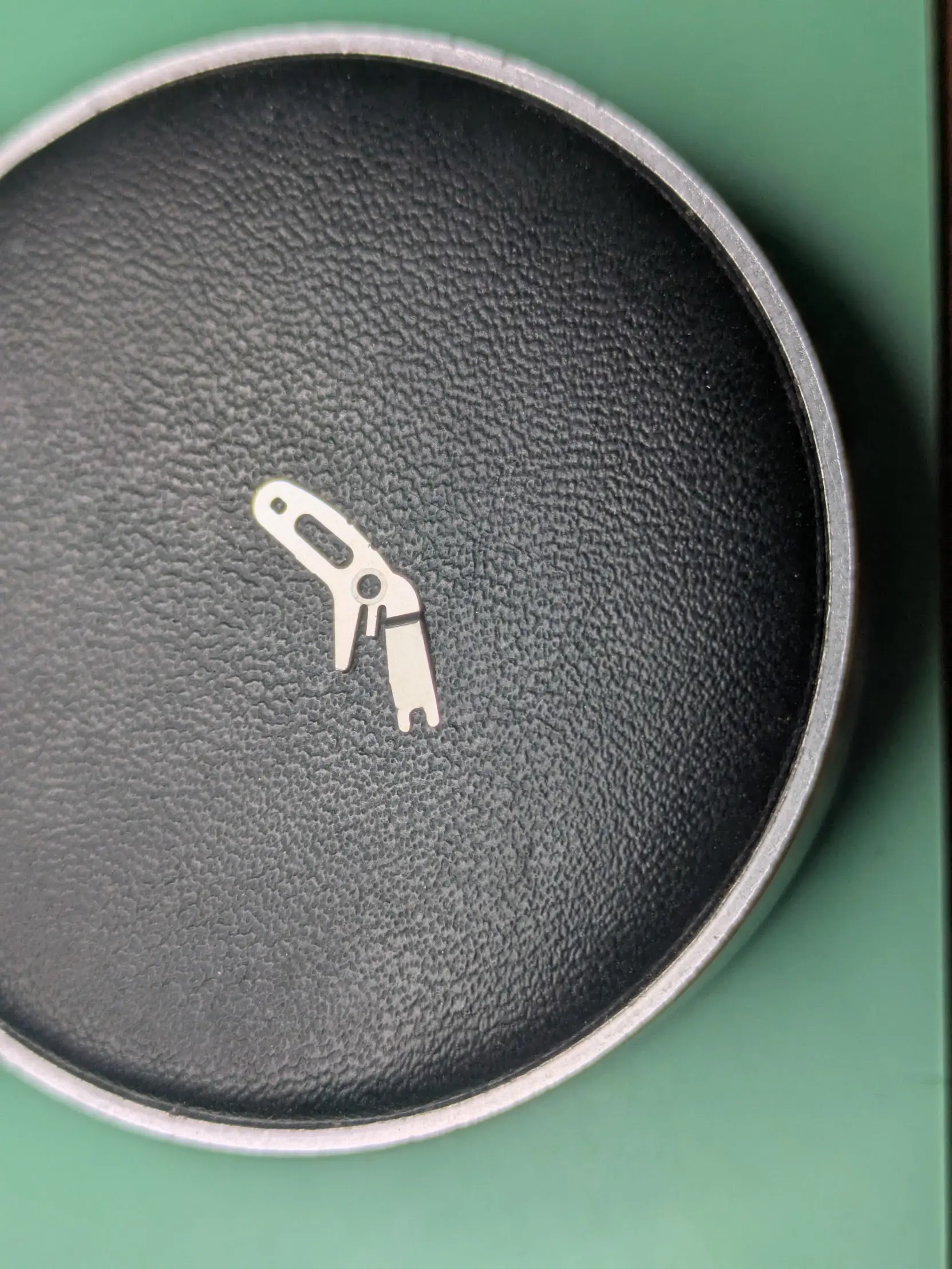

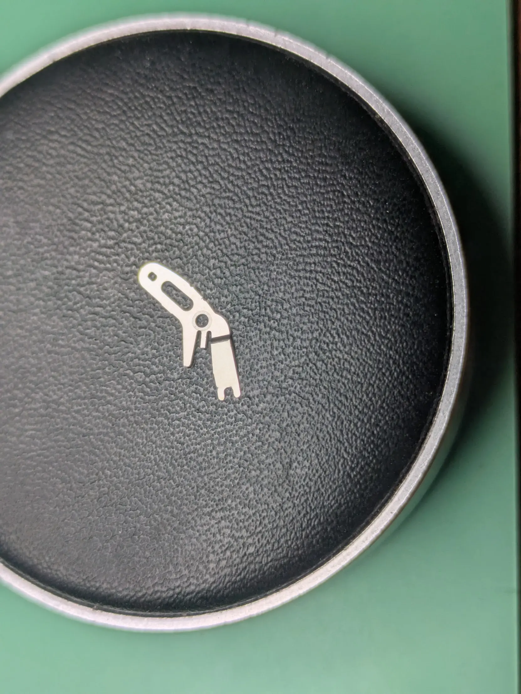

I posted in a few places, hoping someone can come to my rescue, but I'm guessing not. My only picture is of the broken piece missing part of it, but here's my picture. There aren't even service manuals available for these unfortunately. I doubt I'll find the part @Dan S but I can hope 😀

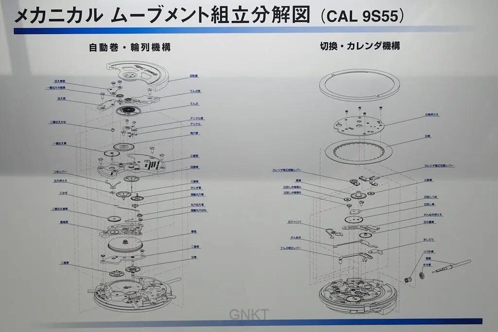

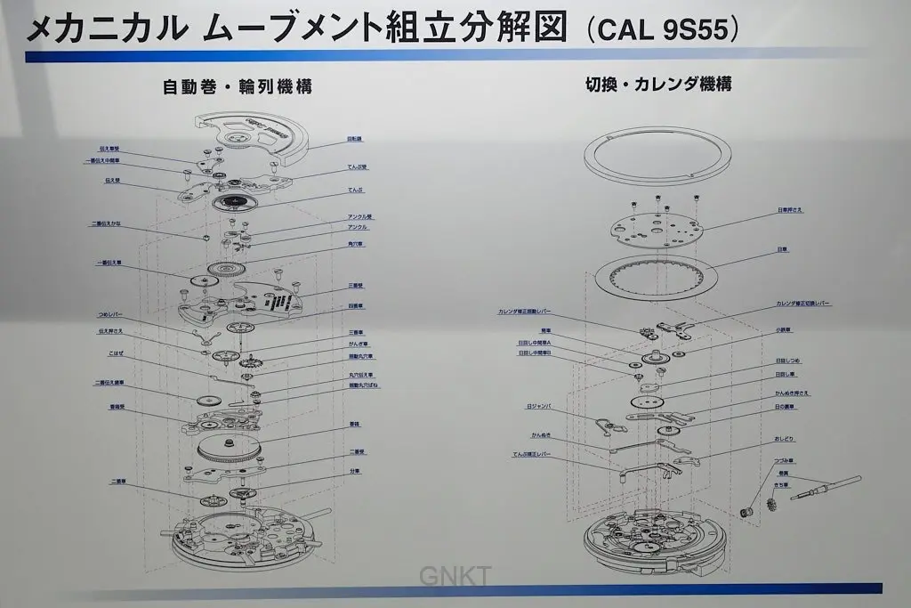

Found this, FWIW. Probably no help at all, just the Japanese translation for setting lever spring.

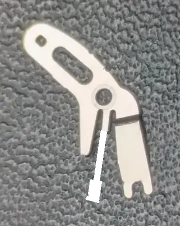

I don't want to poke too much fun at this but I've gone through the trouble to get you a better pic of the part you are looking for. <insert small winky>
Seriously though, if you find a list of movements that share this part, I'm sure there are plenty of people here ready to scour the boxes of spare parts movements. Since it's from a GS, I doubt if regular Seikos would share this part.

I don't see any photos of the setting lever spring, but I believe I'd gotten that suggestion in the past and the setting lever I found for it was different.
