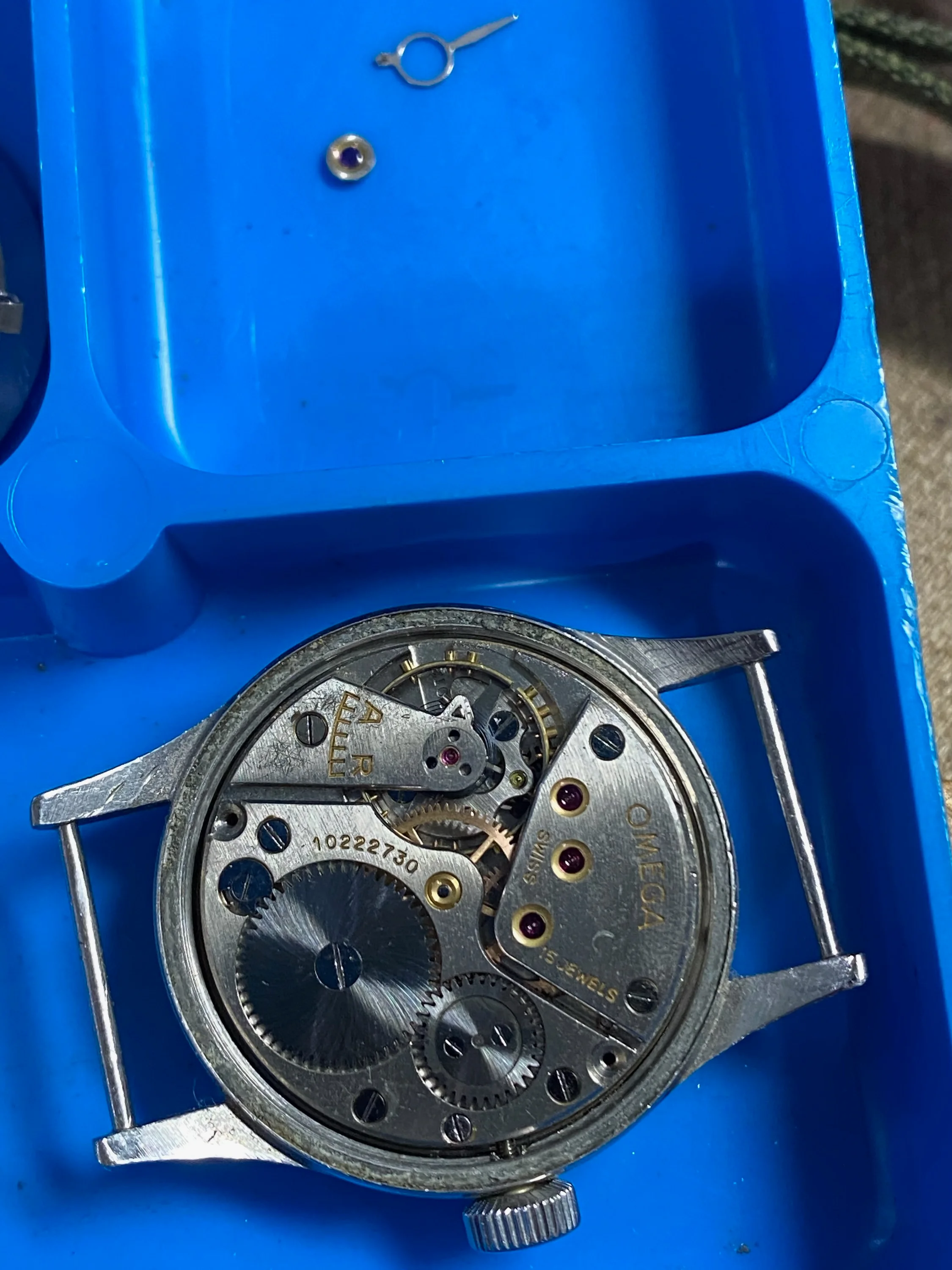

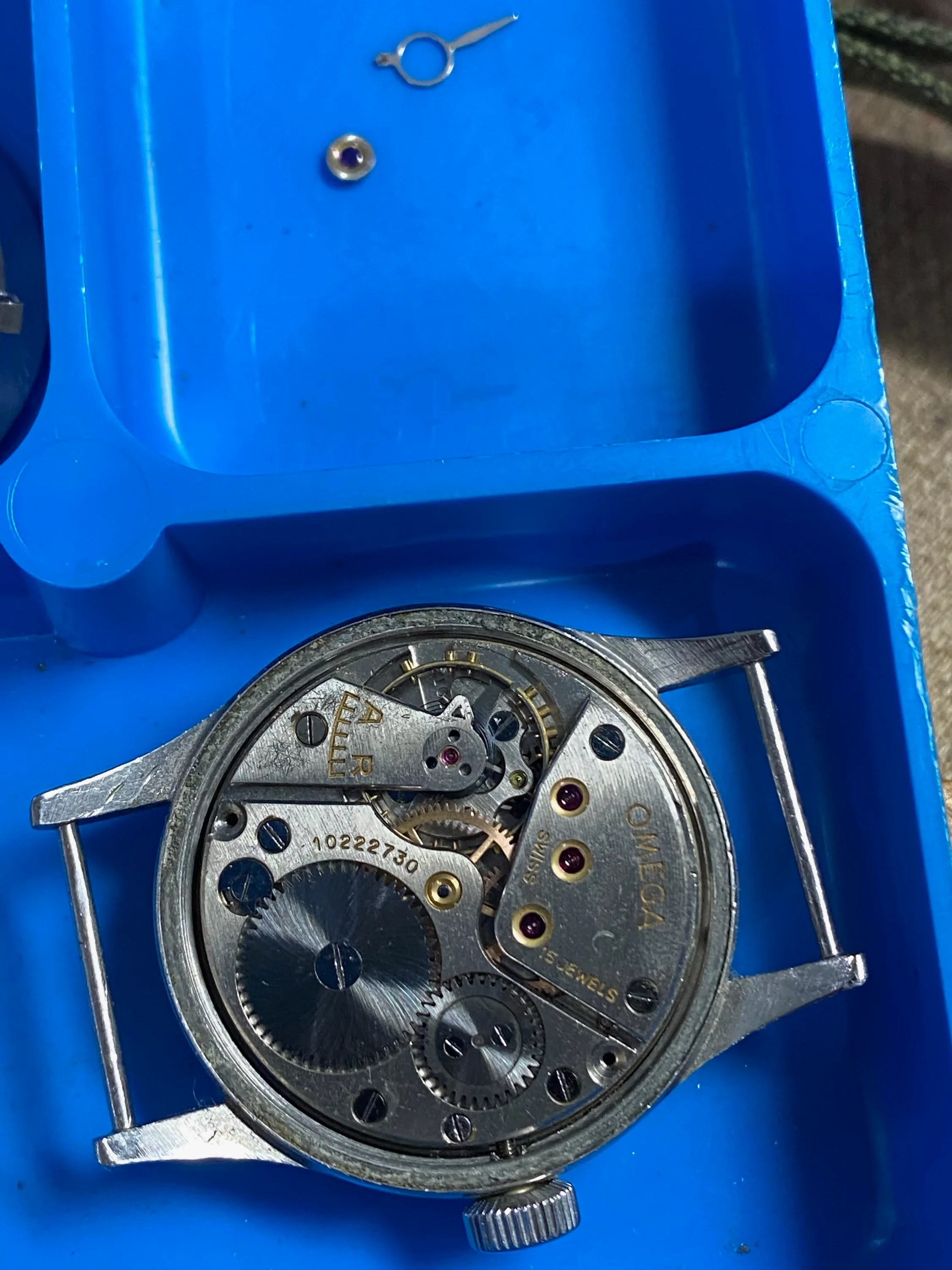

I am fortunate that my daughter and her spouse share my love of vintage watches. I have one of their watches, an Omega WWW, in Rik Dietel 's capable hands for repair. It needs a balance and balance bridge, and he's not found what is needed. I'm attaching a photo he sent. Id appreciate any advice or suggestions that would enable us to bring this watch back to life. Thanks.

That's an experienced watchmaker, so I assume he has exhausted his contacts that sell parts. If so, then you should probably be looking for an appropriate parts watch or complete movement with the same 30T2 variant. With some effort and patience and negotiating skills, you might land a movement for $200 or so.

The posted photo does show a balance and bridge. What seem to be missing is the cap jewel spring clip what locks in the three studs. I have a T17 missing this clip. Never seen one in three years looking.

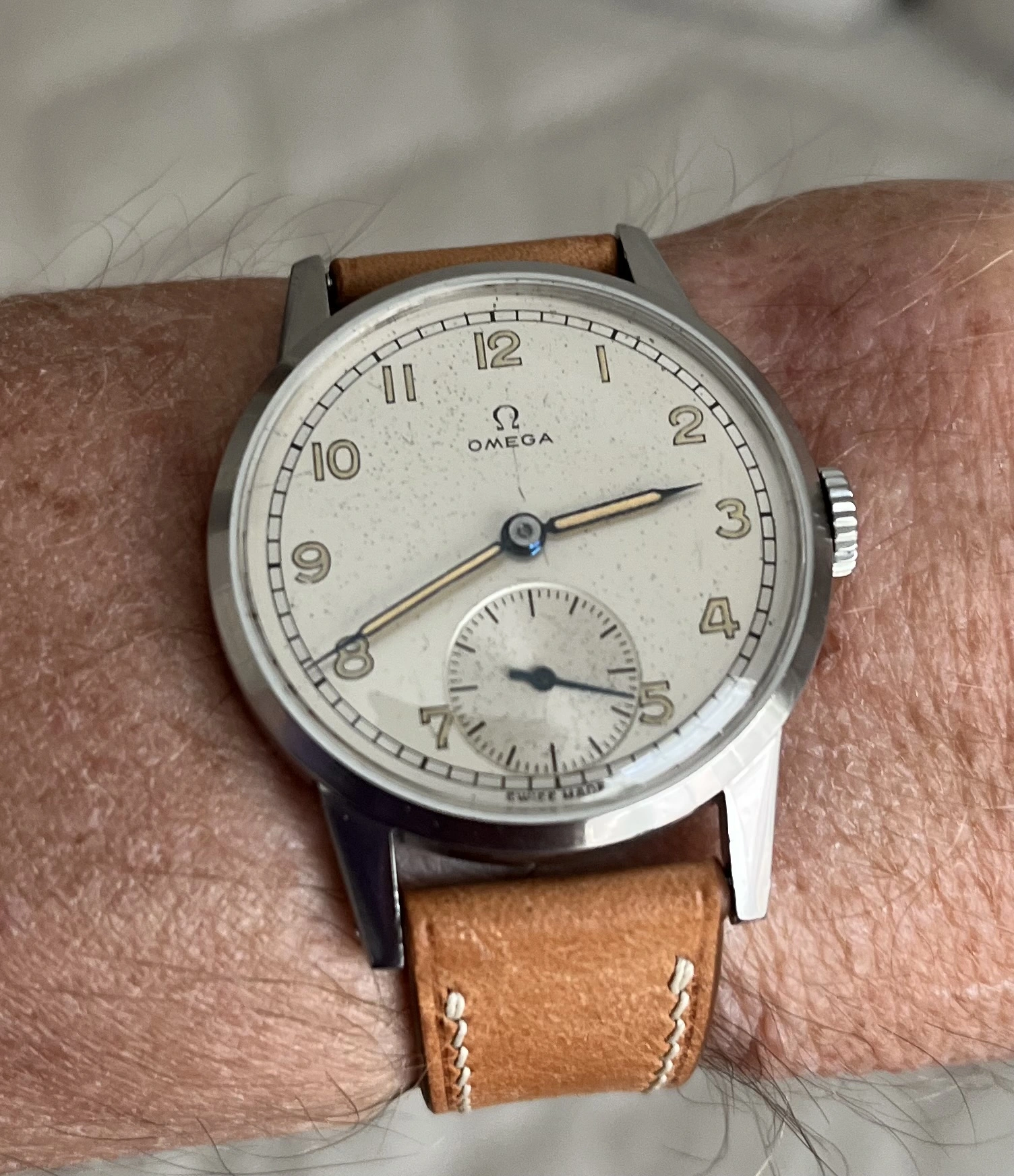

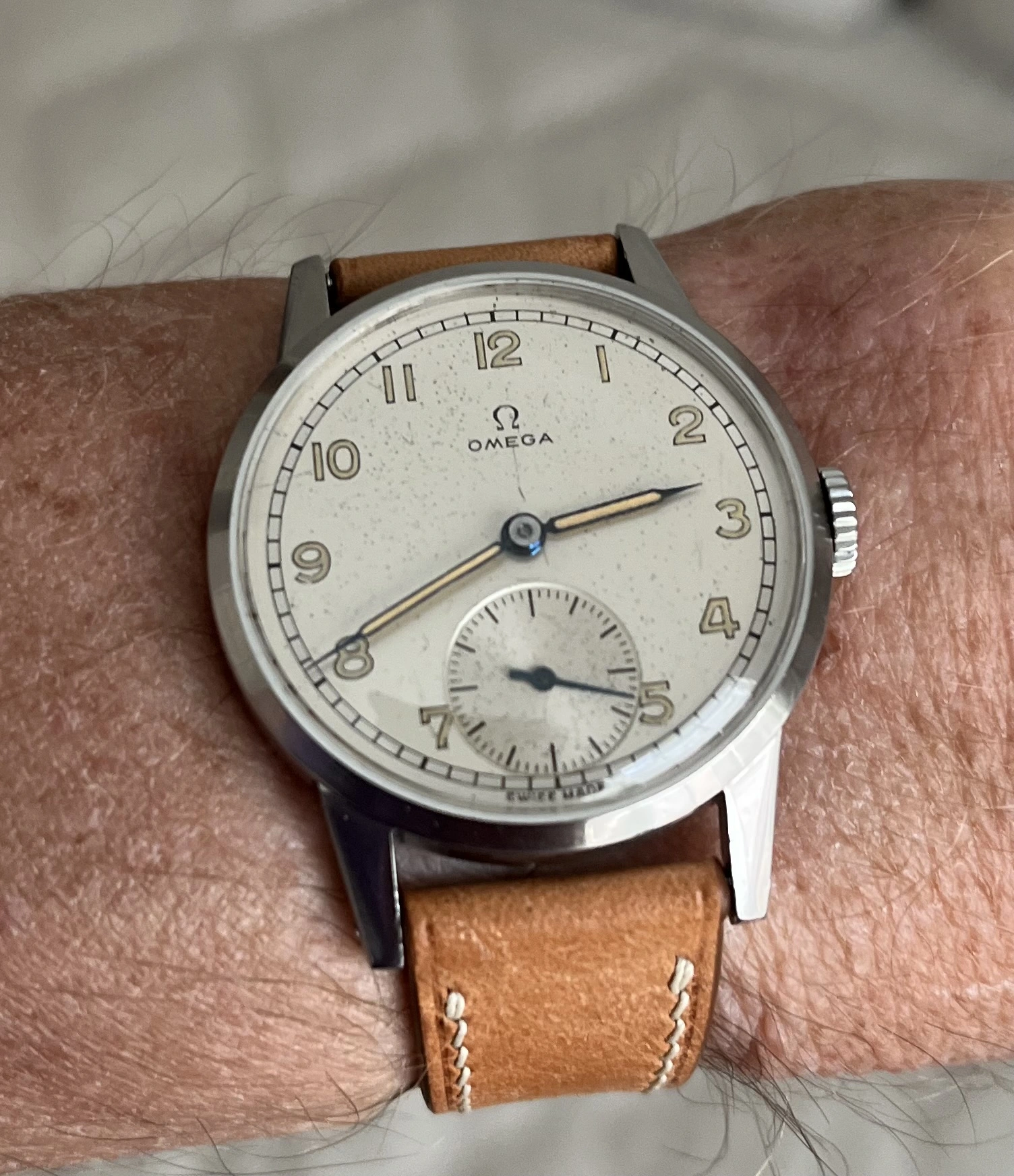

I picked up the watch yesterday. It was the balance staff that needed replacement, not the entire balance. The watchmaker was able to get a replacement directly from Omega through their parts account.
Also, an update seems like a reasonable excuse to share a photo.
