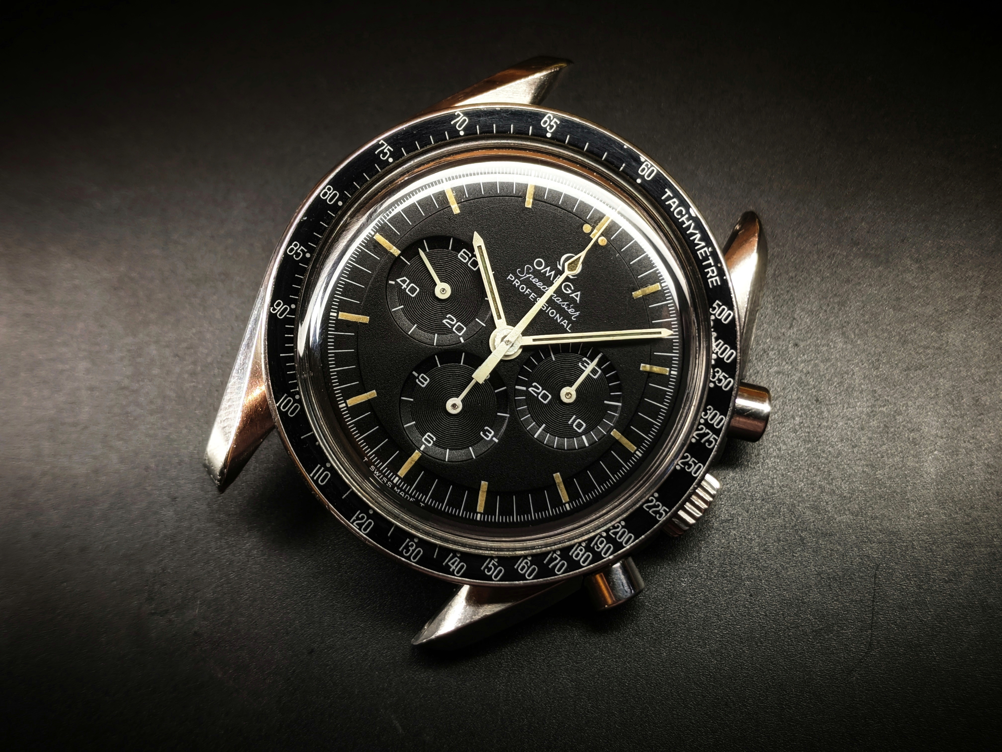

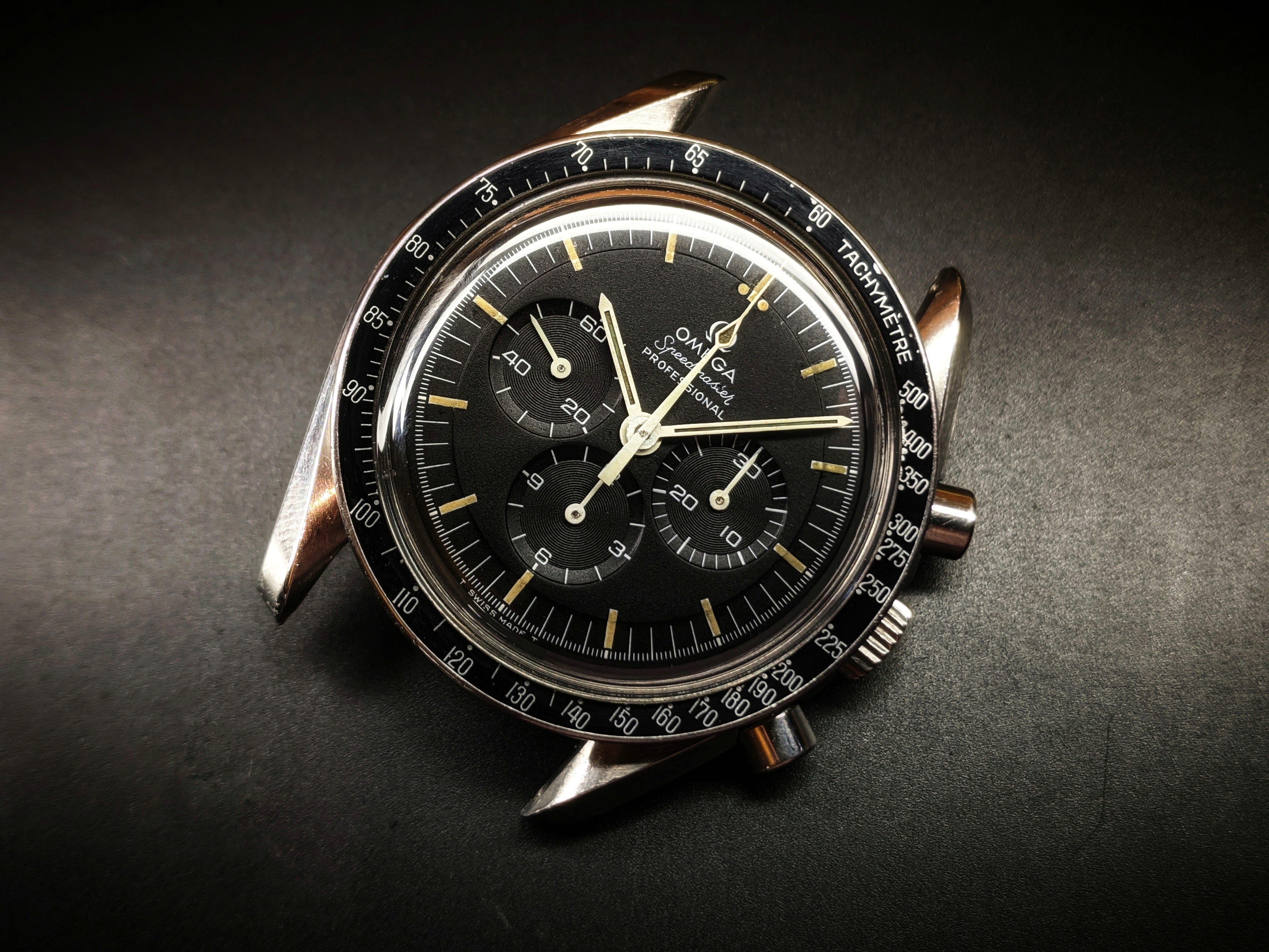

The watch has been serviced by Simon Freese and is on its way back to me now. He took some flattering photos of it for my approval.
The movement has been serviced, the luminous material in the hour and minute hands has been stabilized and the white paint around the centers of the hands has been delicately retouched.
(He forgot to reset the chrono hand before taking the picture of the dial).

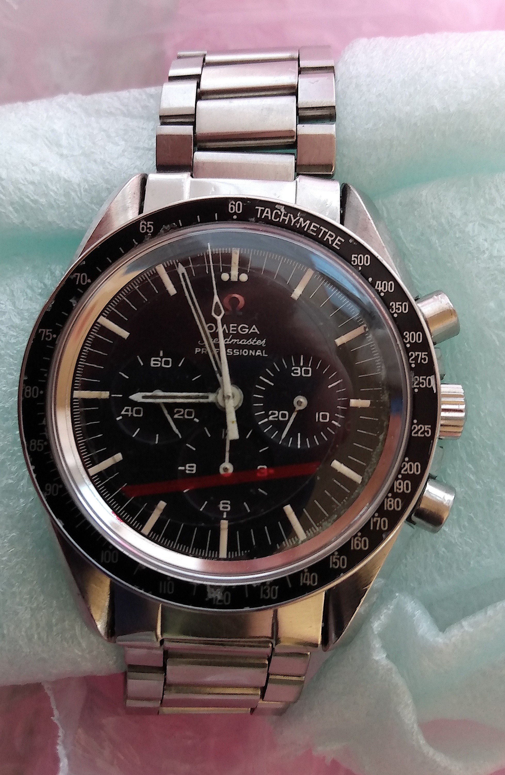

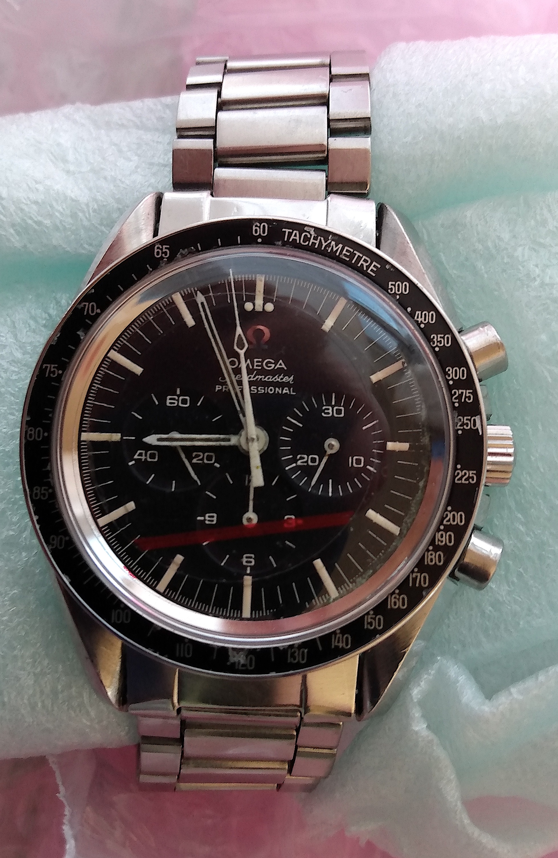

Hi Folks, me again 😀 I need some advice on servicing my Omega Speedmaster. I have been living over in Thailand for several years and while here, I left the watch with my sister in the States for safekeeping.
She kept it in her safe deposit box, and I didn't realize how important it was to periodically wind the watch...so it has sat in storage for several years now without being wound.
When I asked her to get the watch out of the bank and wind it up and check how it's keeping time, she said that the chronometer sweep second hand (the large hand) goes around once or twice and then stops. Otherwise, it resets back to the top precisely and the watch keep perfect time.
I am thinking perhaps the lubrication may have dried out?? She is winding it daily now and trying the chronometer function each time. I am hoping maybe the large "seconds" hand will eventually unstick itself...otherwise I may need to get servicing.
I guess I could have her send to Omega for servicing but I wonder if anyone might be able to suggest a well qualified independent service person as an alternative?
Richard Luts was the person who restored the watch for me, and was highly recommended here on this forum back in 2017, but I'm having trouble reaching him since he moved from Florida and I have no idea where to.
Anyway, any suggestions for a qualified independent service person would certainly be appreciated...or if you happen to know where Rick Luts is now located, that would be great to know😀
BTW, I had not seen the watch since it overhauled back in 2017 and sent directly to my sister. She sent me a picture of it after taking it out of the safe deposit box and it looks a lot nicer than my previous pictures so I thought I'd show it off here. It has a new replacement crystal (genuine Omega with the symbol in center...the red bar is from the protective film over the crystal. The old crystal and all the old parts were included but were so heavily scratched or damaged they seems worthless):

Hi Folks, me again 😀 I need some advice on servicing my Omega Speedmaster. I am over in Thailand but I have left the watch with my sister in Maine while over here. She tells me that when she pushes the top button to start the chronometer, the sweep second hand only goes around the dial once or twice and then stops. I think the watch may need to be re-lubricated.
I gave it to her to store in her safe deposit box while I was overseas, and so for the last 3 years it has not been wound at all, so I think the lubrication may have dried out.
BTW, I had not seen the watch since it overhauled back in 2017. She sent me a picture of it after taking it out of thed safe deposit box and it looks a lot nicer than my previous pictures so I thought I'd show it off here:
I guess I could have her send to Omega for servicing but I wonder if there is anyone independant horologist that somebody might be able to recommend in the US.
You really should start a new thread, since people are going to be confused with the highjacking. My thought about your watch is that if it was really overhauled in 2017, it's probably still fine, the oils don't completely dry out that quickly. That fact that it was not running is largely irrelevant, it's not a car engine. Perhaps your sister isn't winding the watch completely. Does she know that she needs to wind the crown until it completely stops? On a Speedmaster, that could be 40 turns. If you really want to have it serviced again, I'd suggest running a search on the forum to find watchmakers. This question is asked daily, and the same people are recommended over and over again.
Thanks for the thoughtful reply. As it turns you, you are correct. I talked with her on the phone, and indeed, she had not wound it enough. She was afraid to over-wind it. When she did wind it sufficiently, the sweep second hand acted normally and seems to be running fine.
Thank you for clarifying about the lubrication probably not being an issue. Reassuring to know that.
