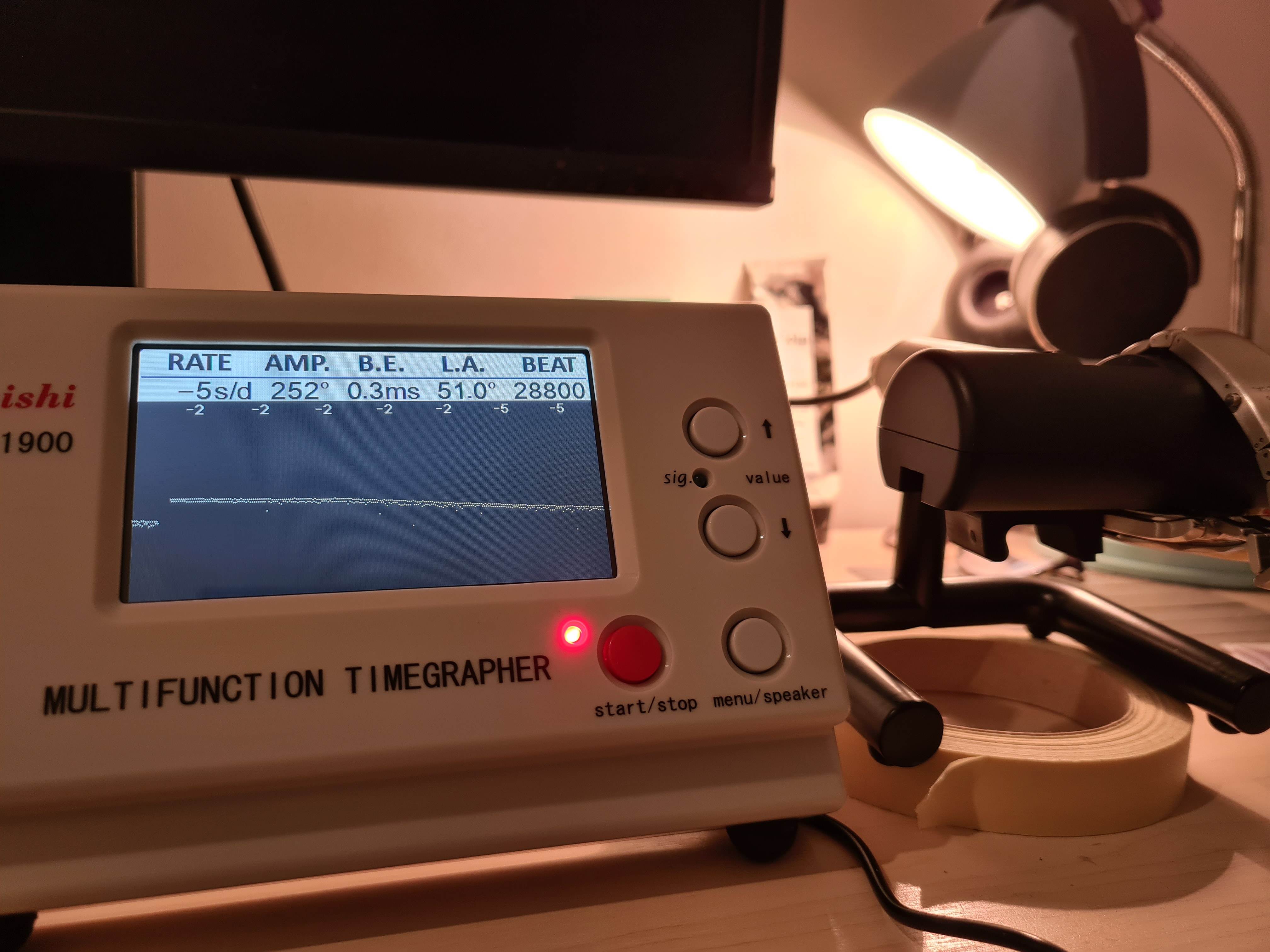

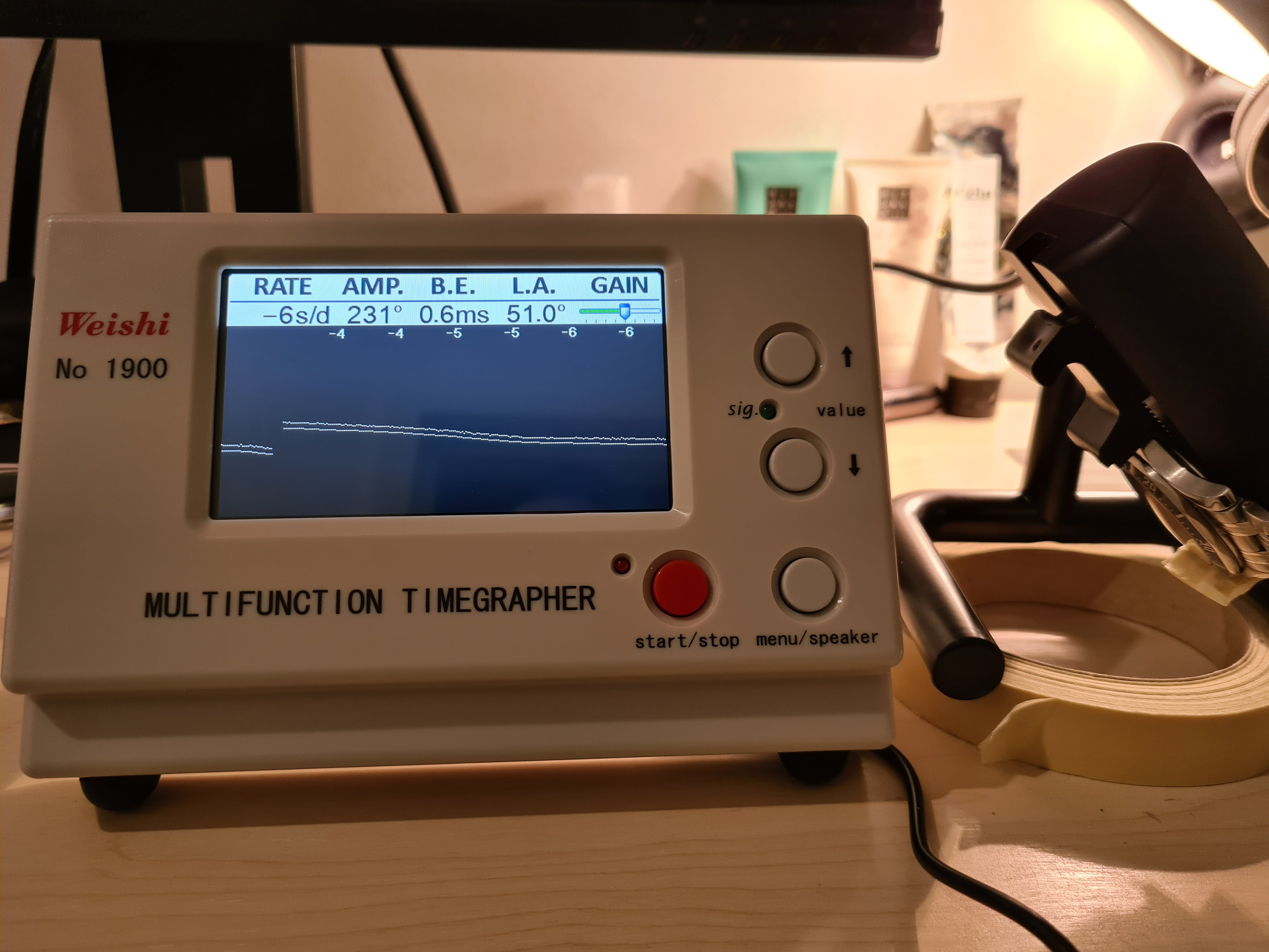

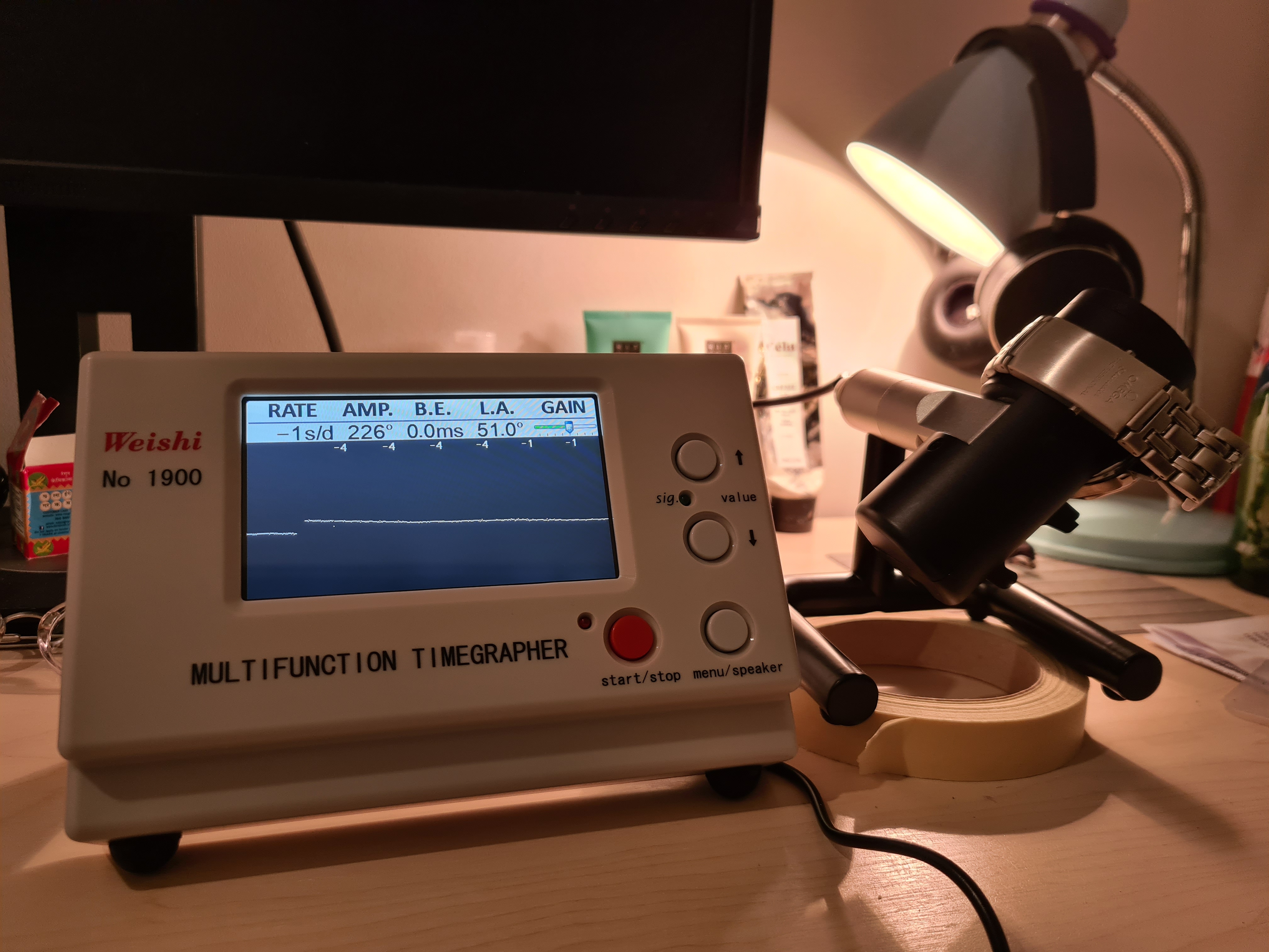

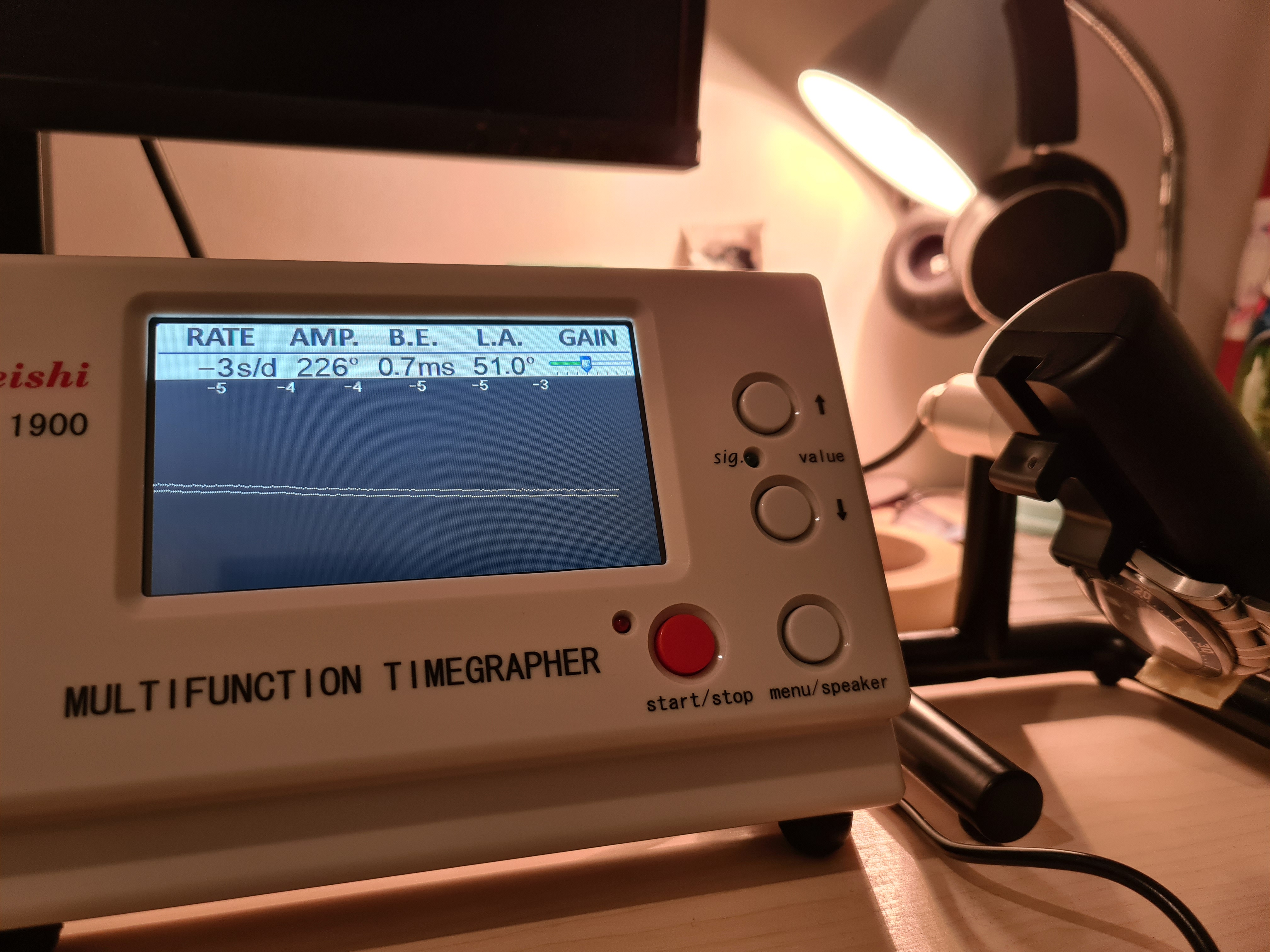

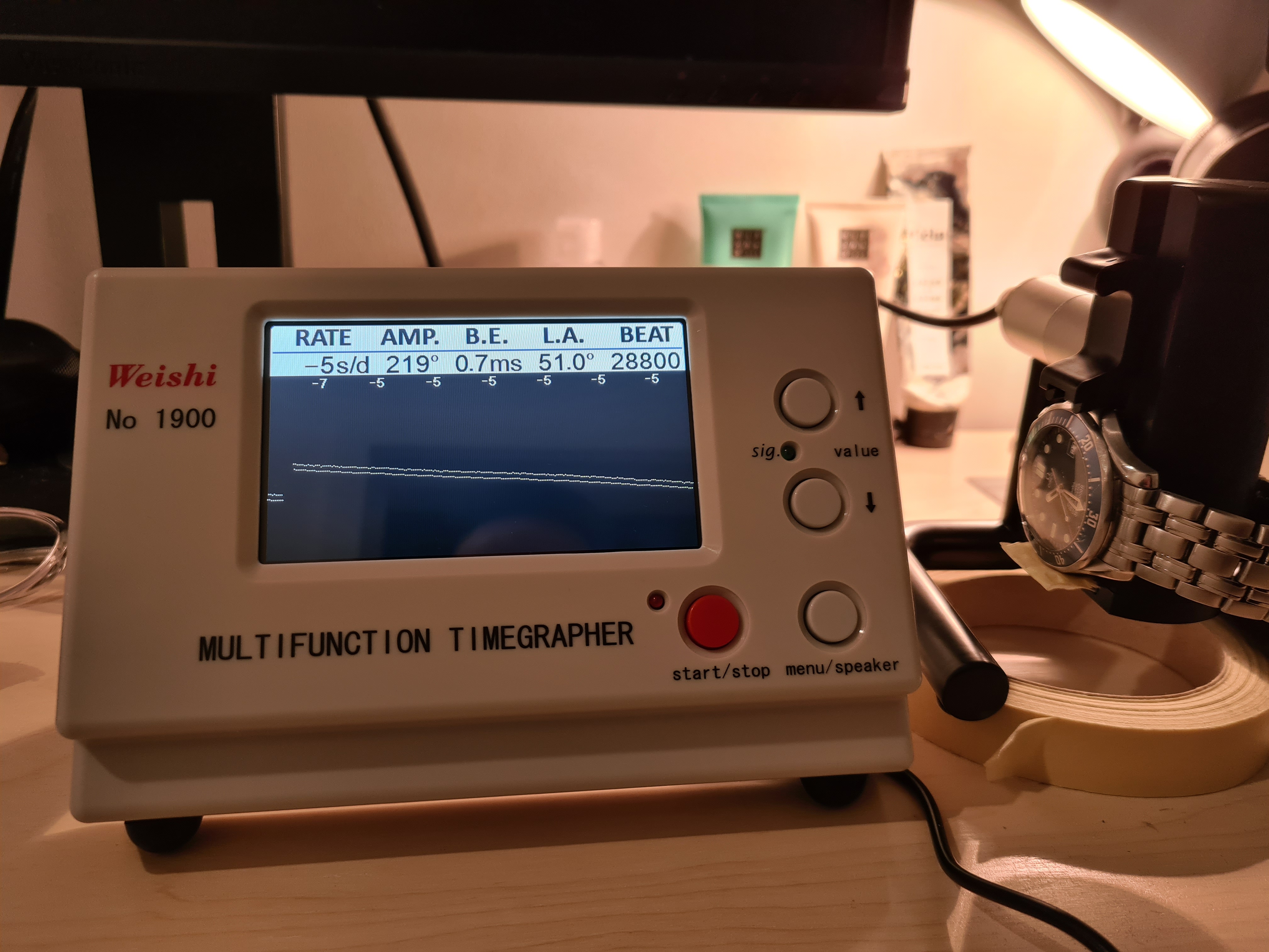

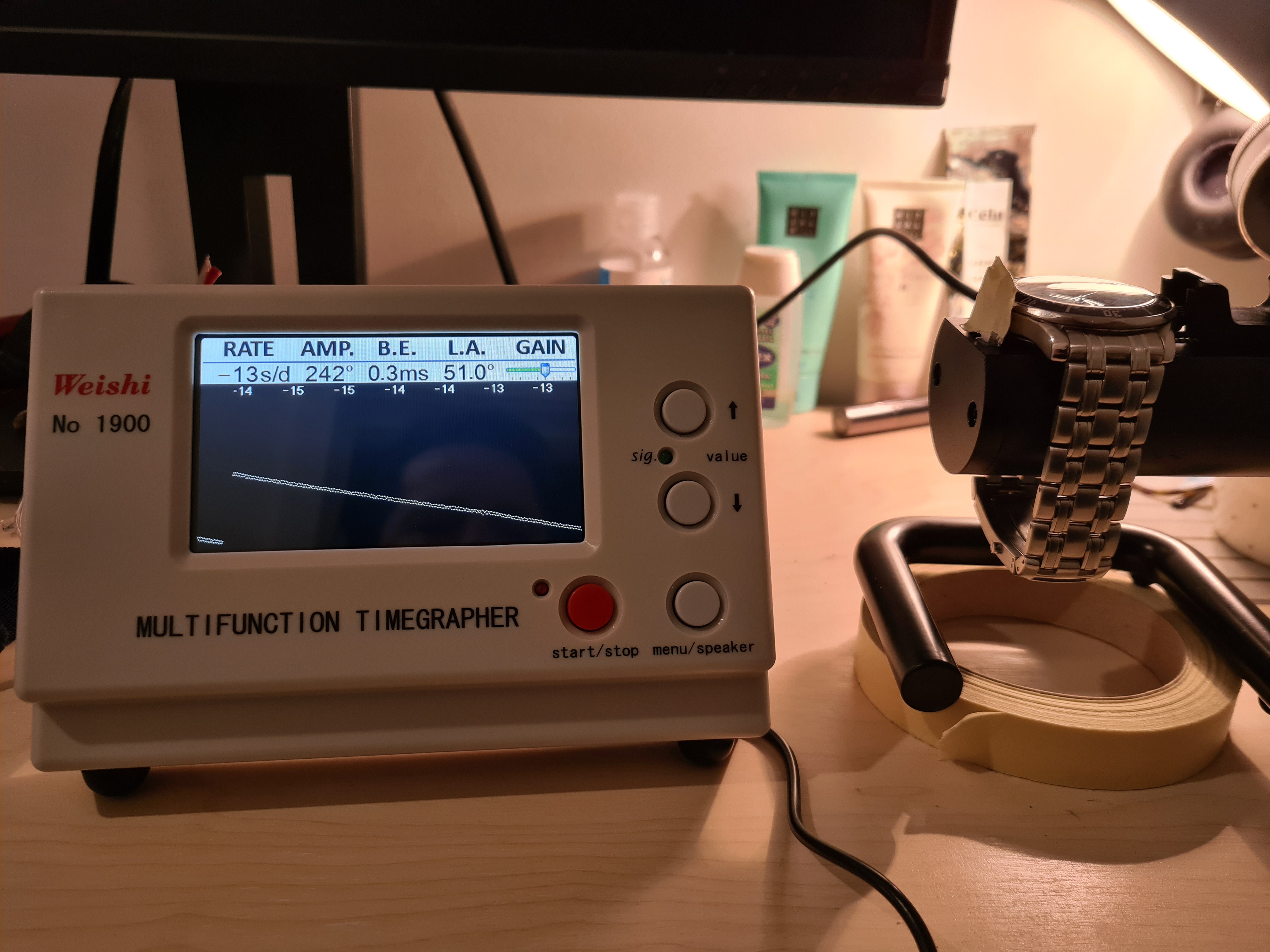

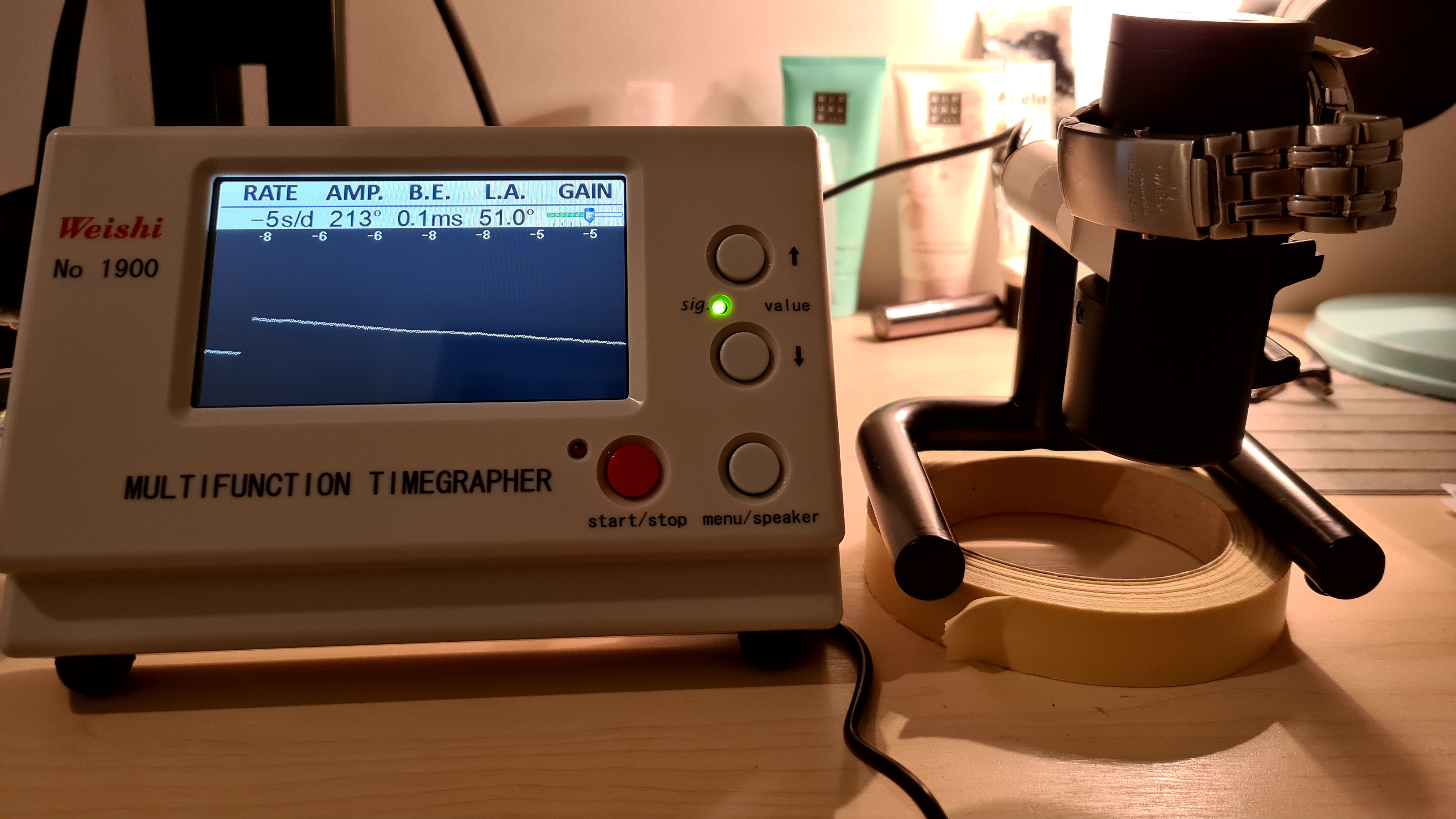

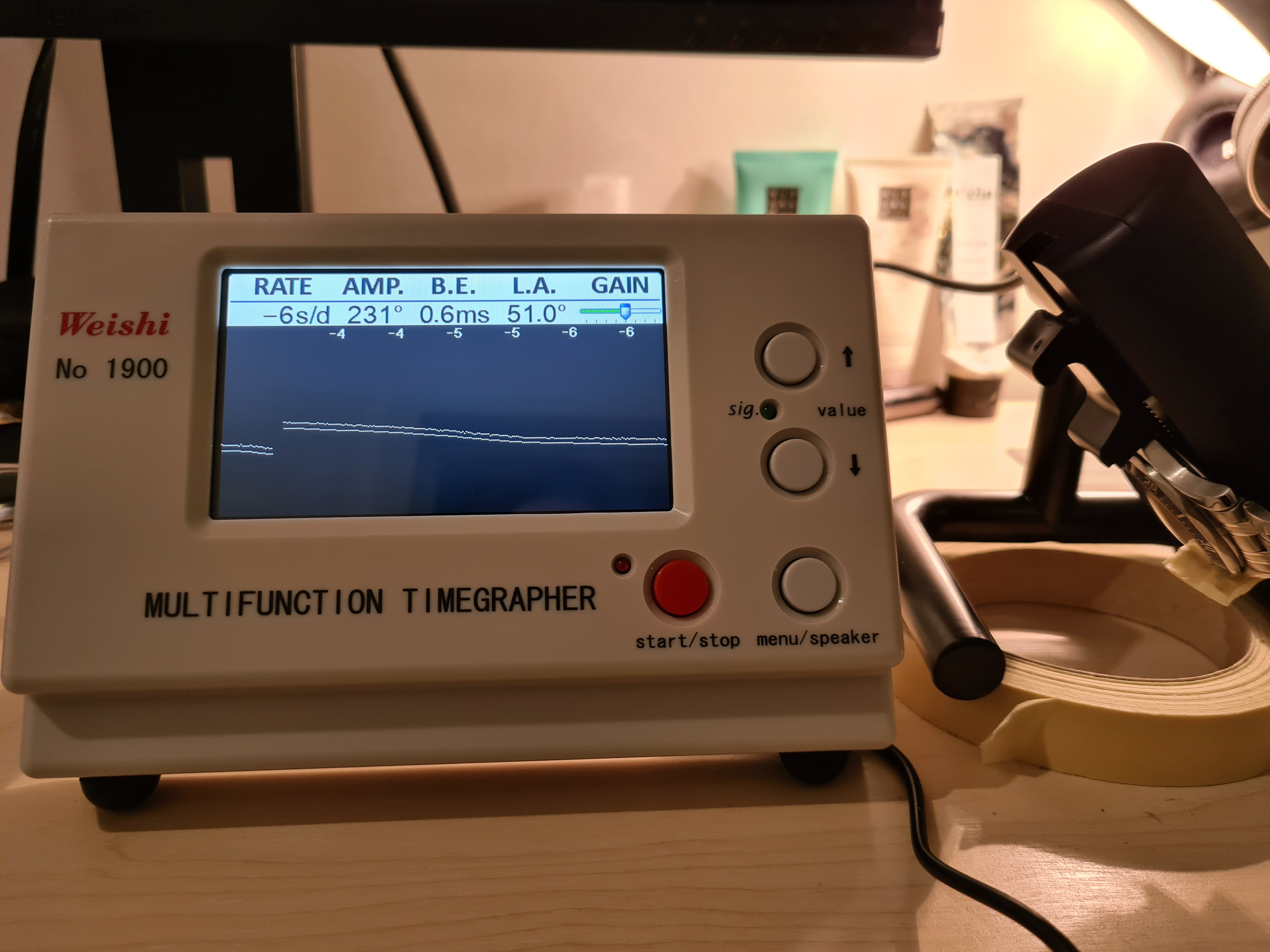

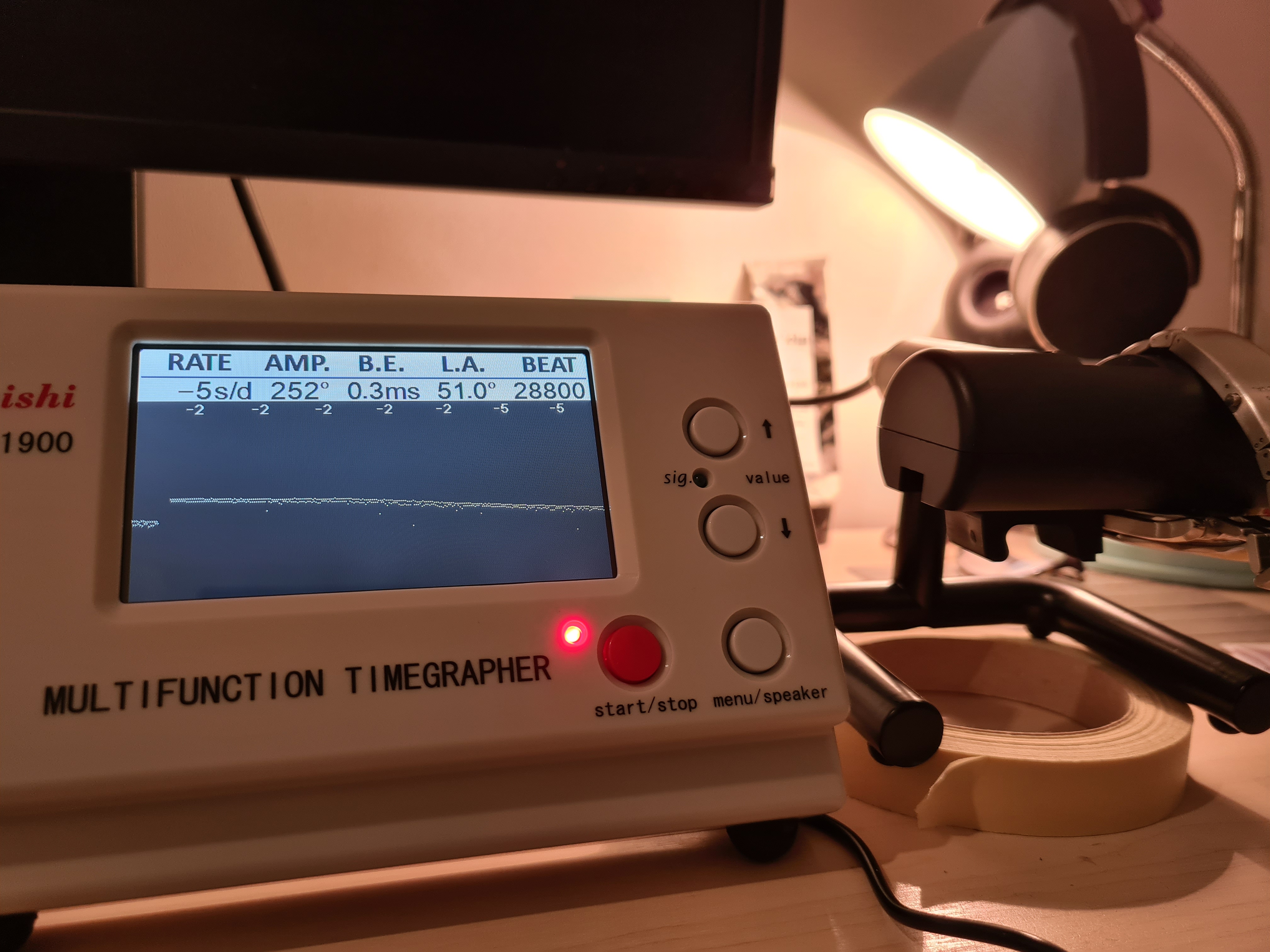

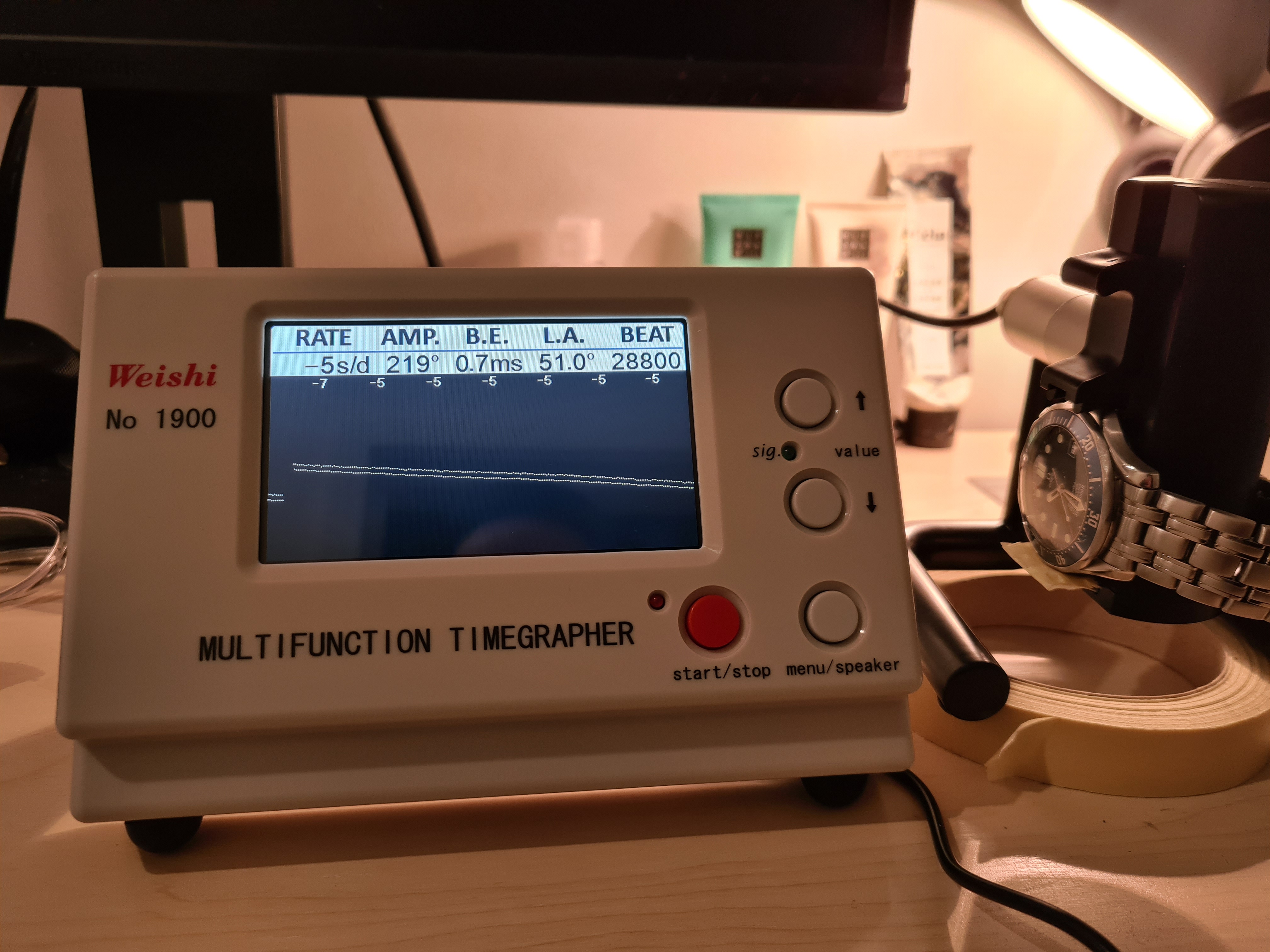

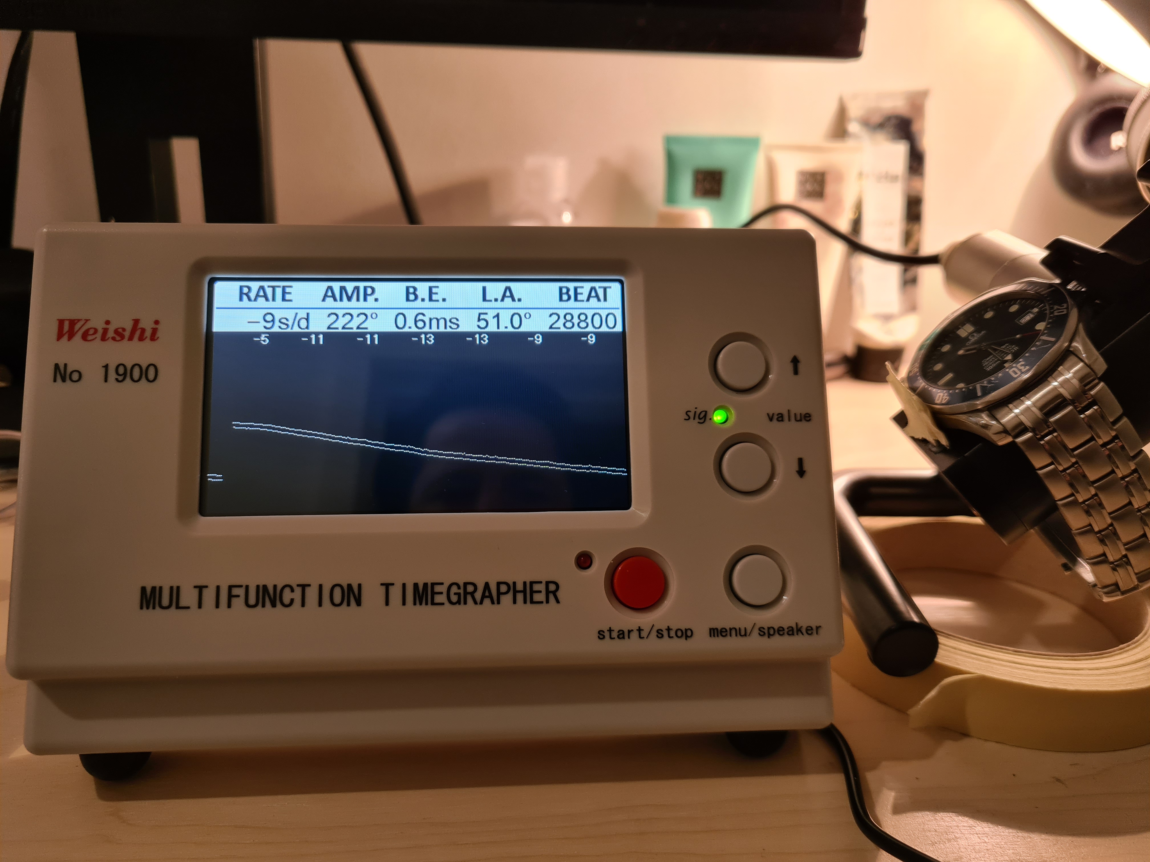

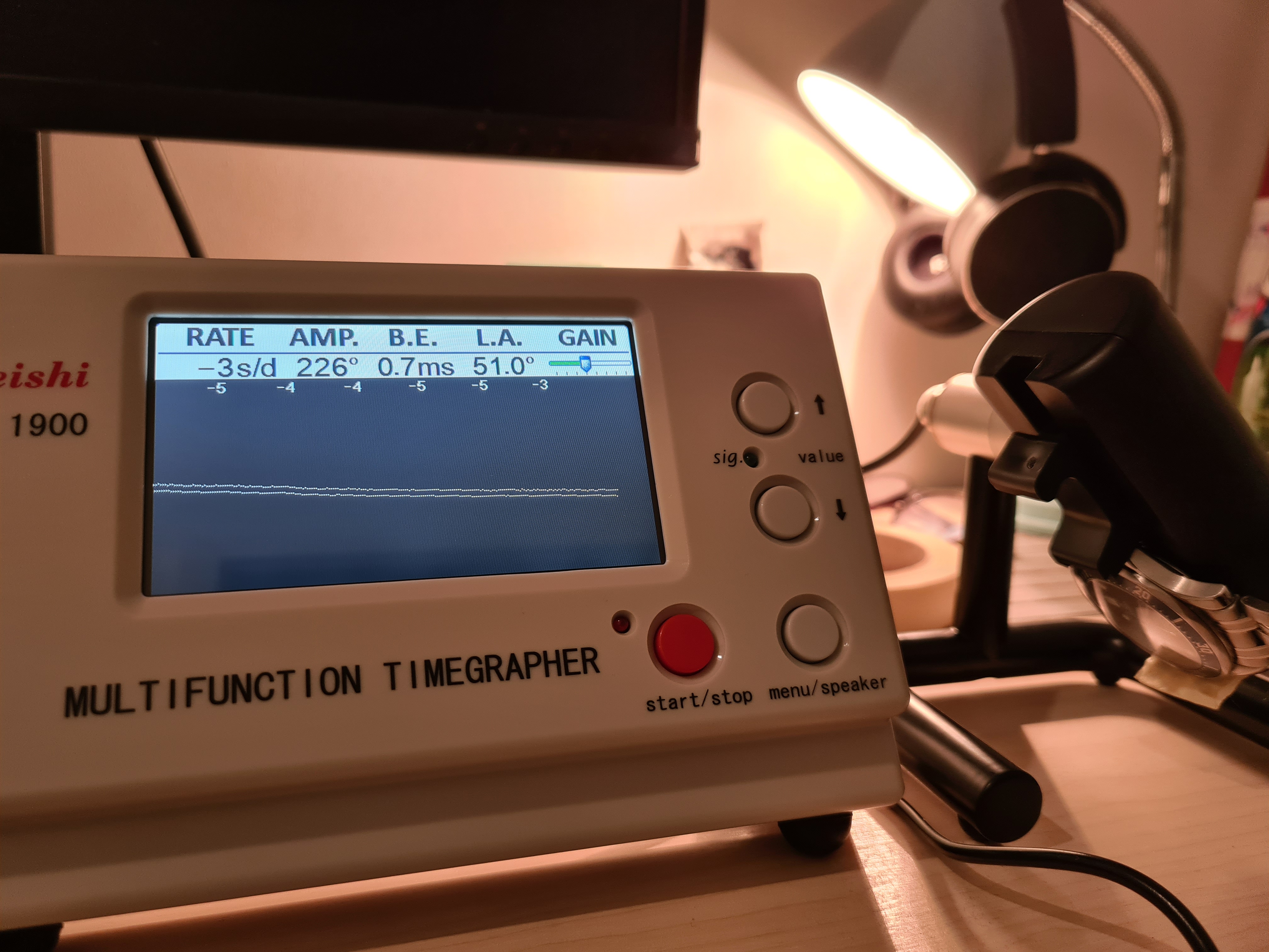

Hello all, I have recently acquired an smp 300 with cal 1120, just wondering based on your experiences if the watch is in need of a service?
Pictures attached and thanks in advance.

I think you have already had a learned opinion on this question in your other thread. Yes both the amplitude and beat error are poor and I would say based on that pic that it does need a service. A healthy 1120 would have an amp nearer 300 in most orientations.

Maybe you should buy a new timegraper first 😉
I don't know if that affects the results...
TBH even this results I would wear the watch without service especially if you have a 'watch rotation'

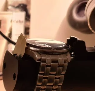

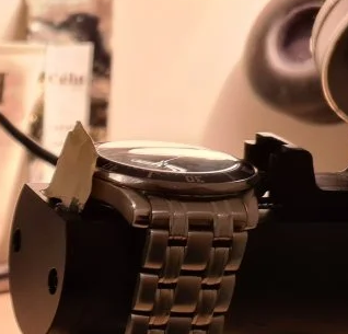

I have that model and it is a good idea to put tape over the metal clamp on one side otherwise it can scratch cases. No it shouldn't affect the results IMO.
As far as I can see the clamp is gone 😀
20
The timgrapher is new, I put the tape not to scratch the watch 😀

282
456

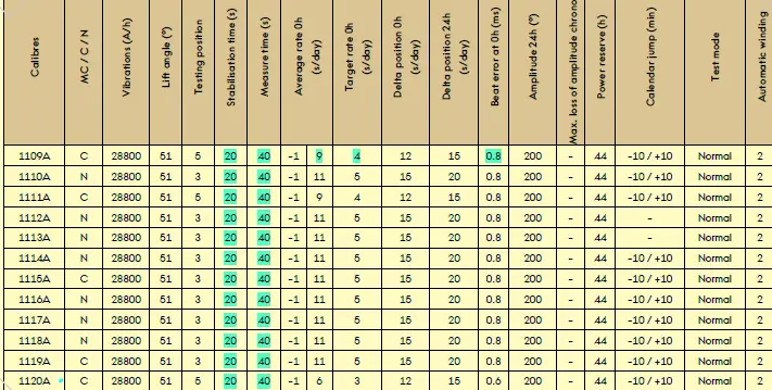

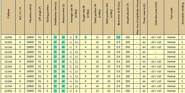

This is from the Omega Working Instructions.

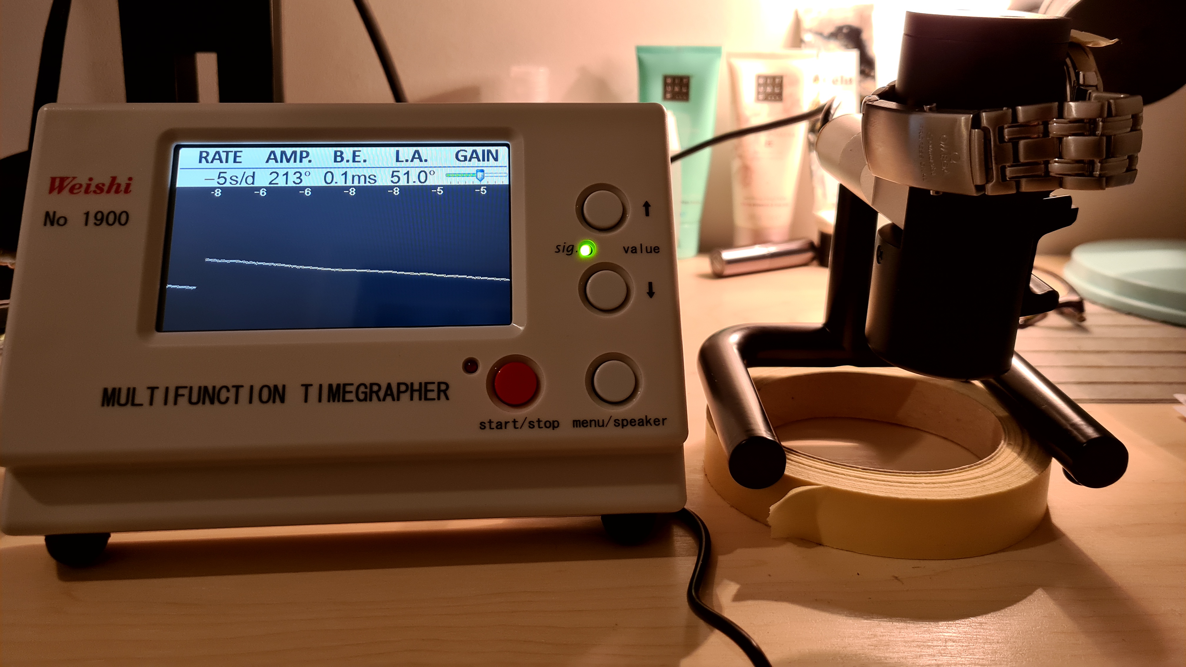

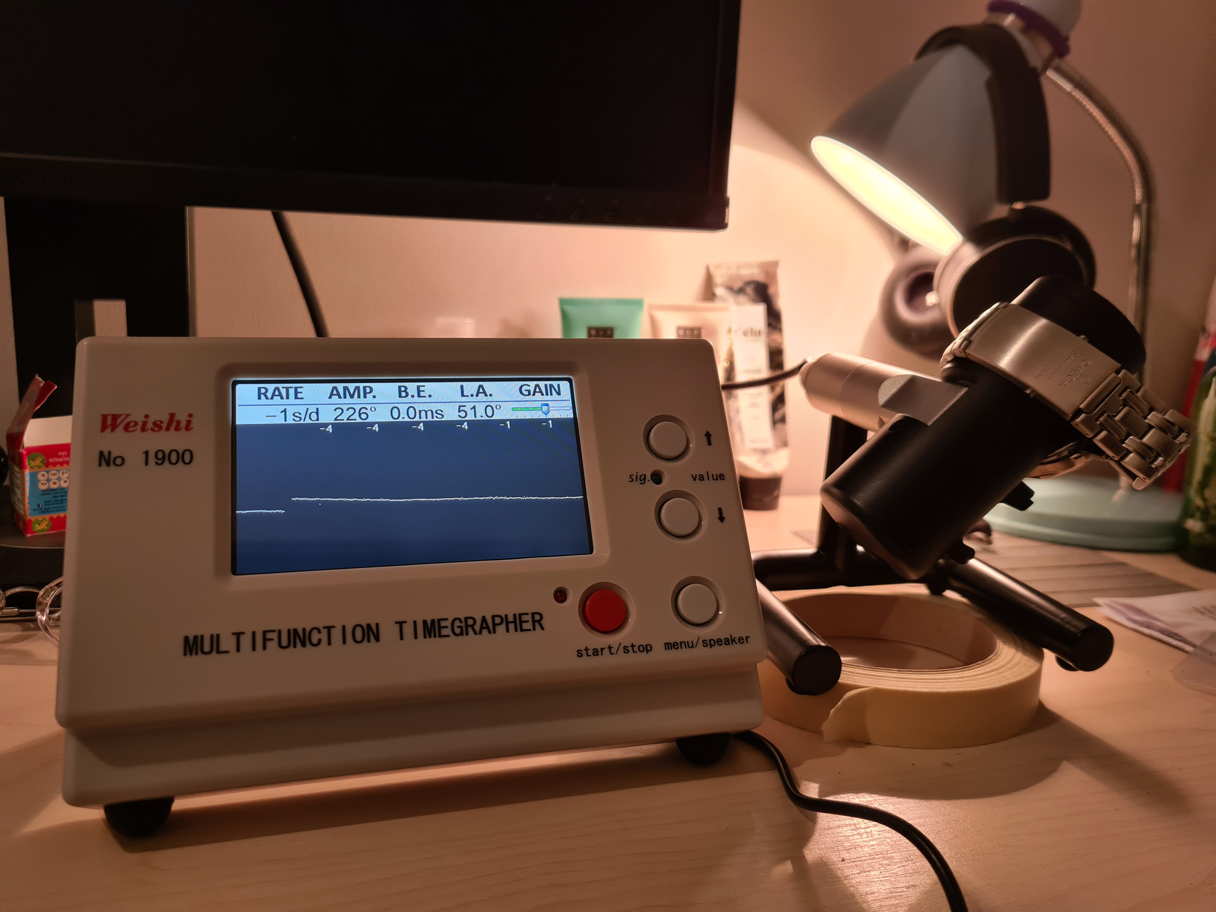

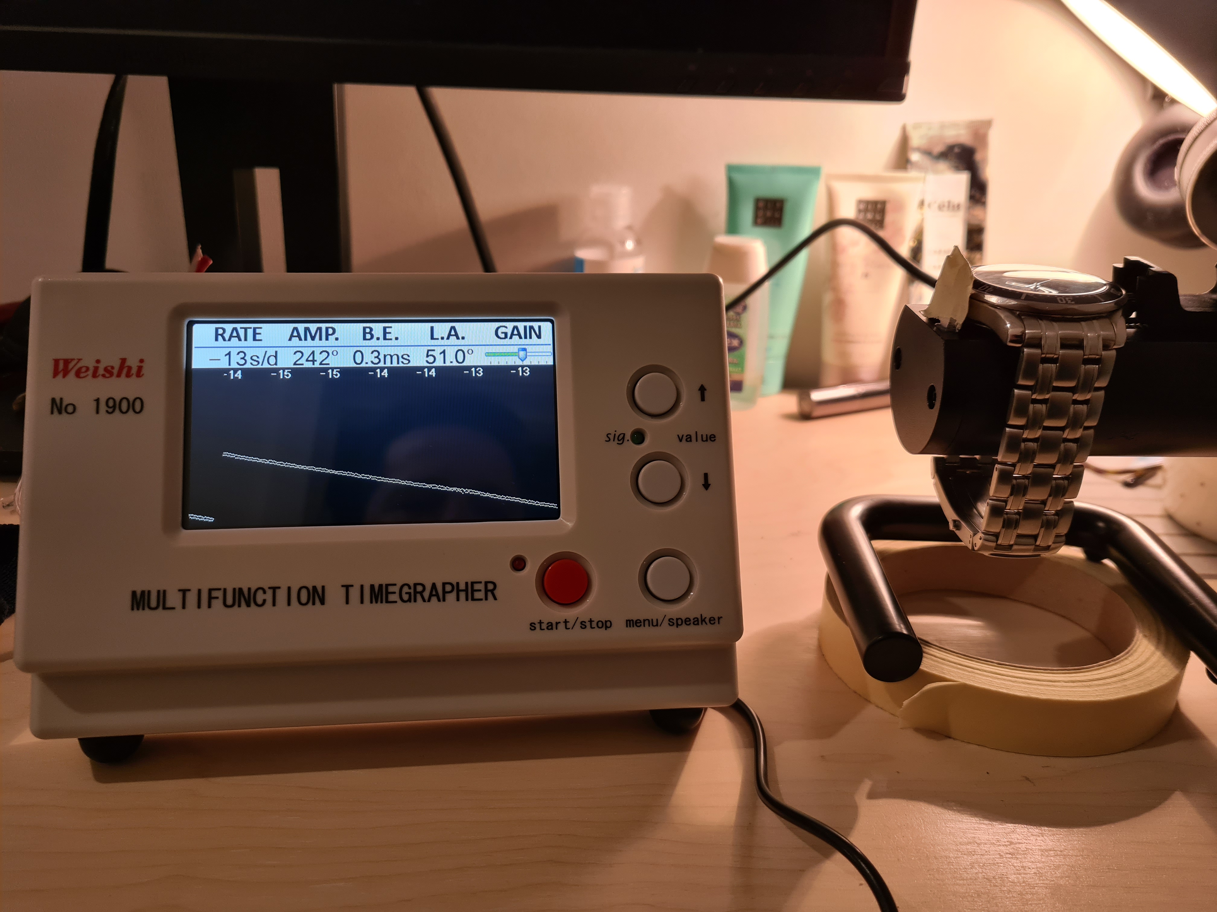

So what you can see wrt amplitude is that it should be above 200 in all positions 24h after full wind. If the above pictures were taken at full wind, you probably won't make 200 after 24h.
Beat error is a little high in 1-2 positions.
The rate can be adjusted easily, of course, and your delta (max variation in rate between positions) isn't too bad.
Likely time for a service.
