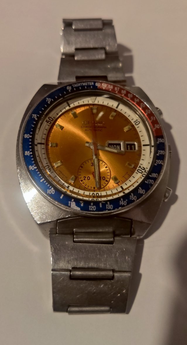

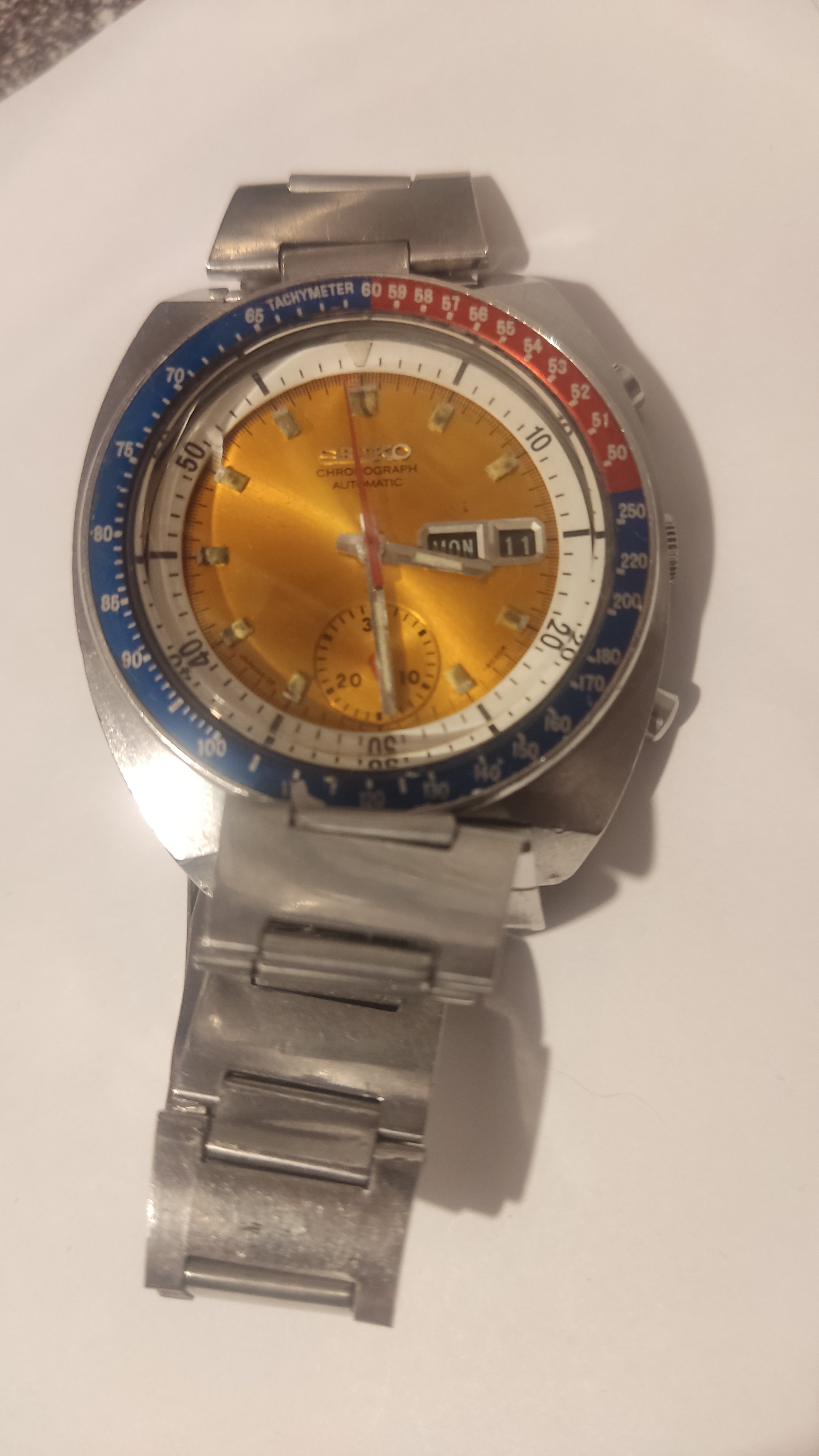

I recently bought a working Pogue 6139-6001 on impulse(and with bad photos from the seller). It's fully working(chronograph, the rotating inner bezel, date change and so on).
The dial looks really nice, but there are some scratches on the bezel.
I am thinking of selling it(focusing more on KS/GS), but I want to be sure that the dial/chain/bezel is genuine. The seller told me it was, but I am not an expert.
Btw it looks better in real life, I will try making better photos with normal lighting.
1,544
3,578
Well it certainly had a hard life.
I'm not an expert but, as far as I remember, a white inner bezel can either mean it's a heavily faded original yellow one (these should have silver lettering) or in case of black lettering then an after market replacement.
Unless it's just the angle of the photo, the outer bezel "60" doesn't align with the 12oc marker which indicate, at the very least, it's been taken off at some point so read into that what you will.
The quality of the photos are not good enough for me to make any comments on the dial

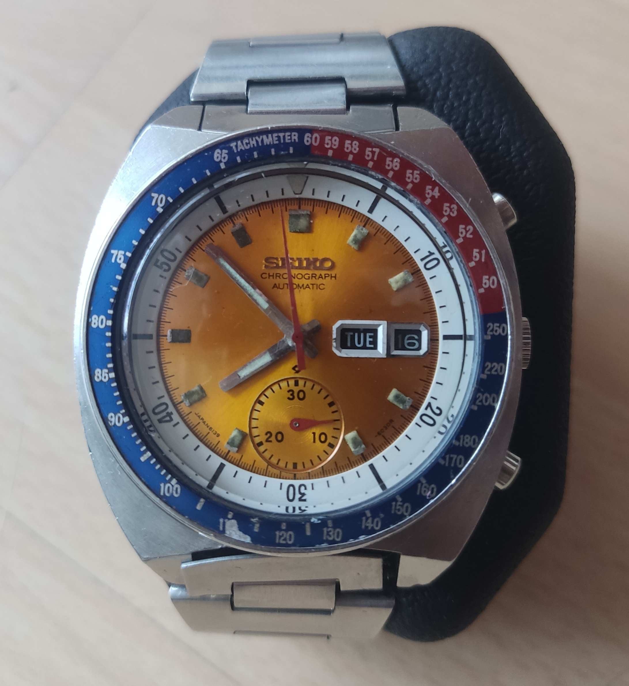

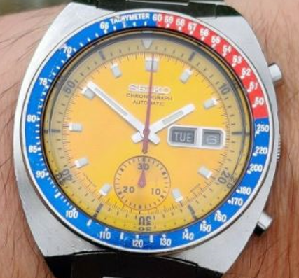

Here is a picture in daylight. Artificial lighting pics were bad.

From that photo my vote is the dial is genuine but the lume plots are degraded and unattractive. My original comments regarding the bezels stand. Case looks ok and the bracelet looks genuine but these were poorly made anyway hence the reason the end link is not sitting properly after all this time

You didn't show a caseback photo... The 6139-6001 was a short lived transition between 6139-6000 and 6139-6002, and is unlikely to be any later than early 1971. The dial is genuine and is from a late 1972 or later watch... This is a mismatch, so either caseback or dial have been changed at some time.
Even as it is, it's worth more than £350.

I will try taking a good photo of the back and post later. It does say 6001.

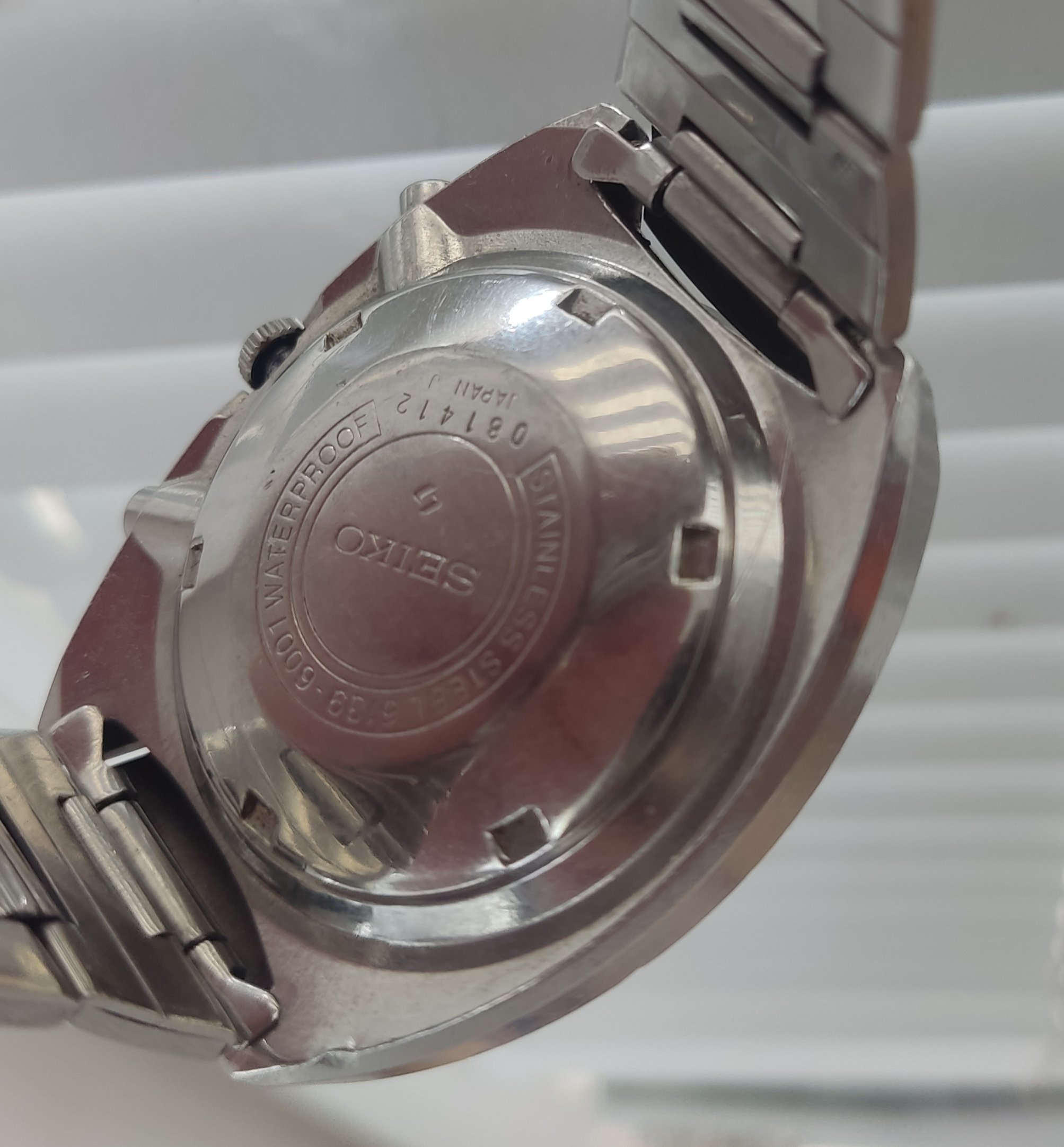

Sorry for the delay. Here it is. Please share your thoughts: IMG_20240620_152016.jpg
Seiko decoder says:
The watch was made in August 1970,1980
69
229
Very nice 6139-6001 Proof caseback doesn't match the later 'R' dial.
Is it likely that the caseback was changed or is it more likely a replaced dial?
69
229
'Could be either, no way of knowing for sure.
Every watch has a history. Over 50 years anything can happen.

Yellow Pogues are easy to sell, and this is a nice one. You could advertise it in the sales section on this forum. Or put it on eBay auction with staring price £99 and let the auction run to the end (That's when all the snipes come in). I reckon you should get over £400 for it.
