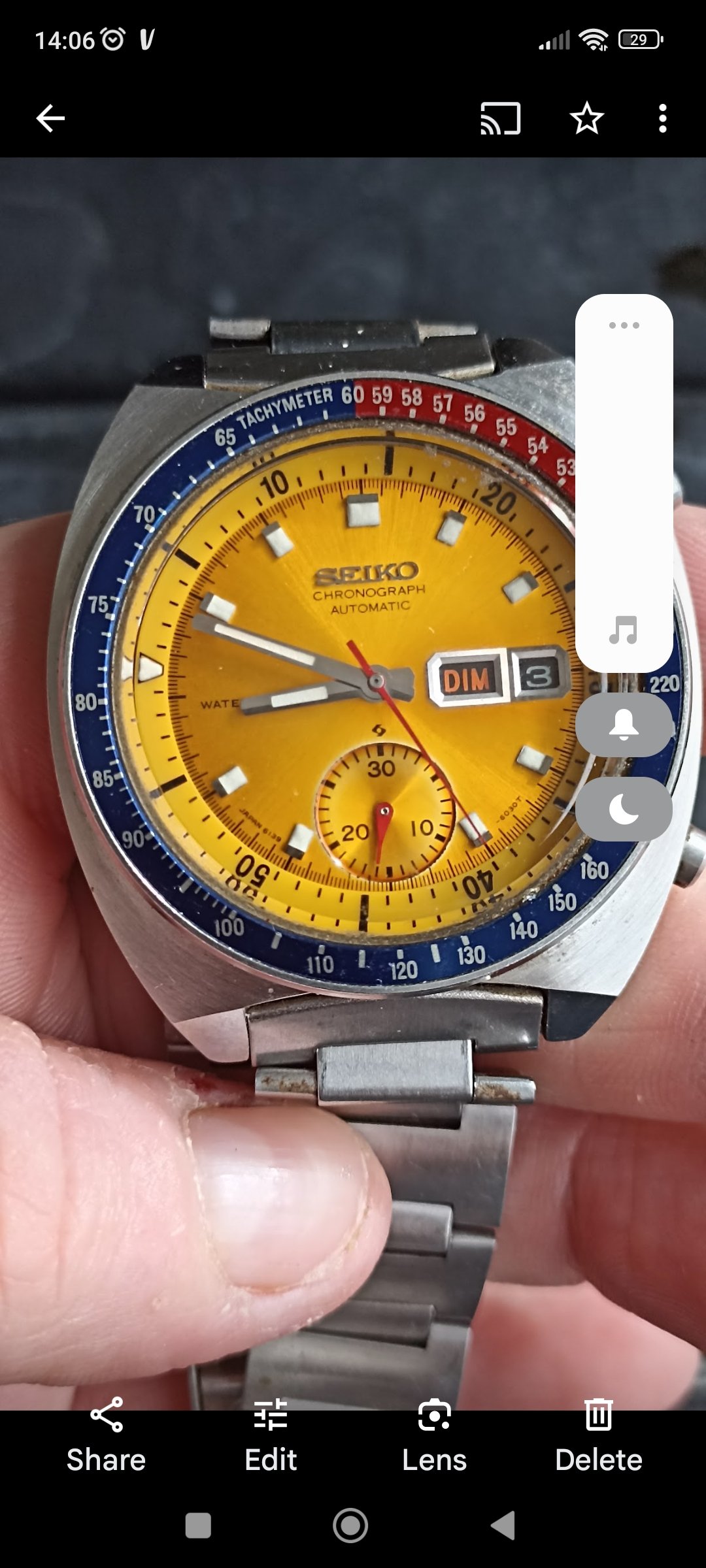

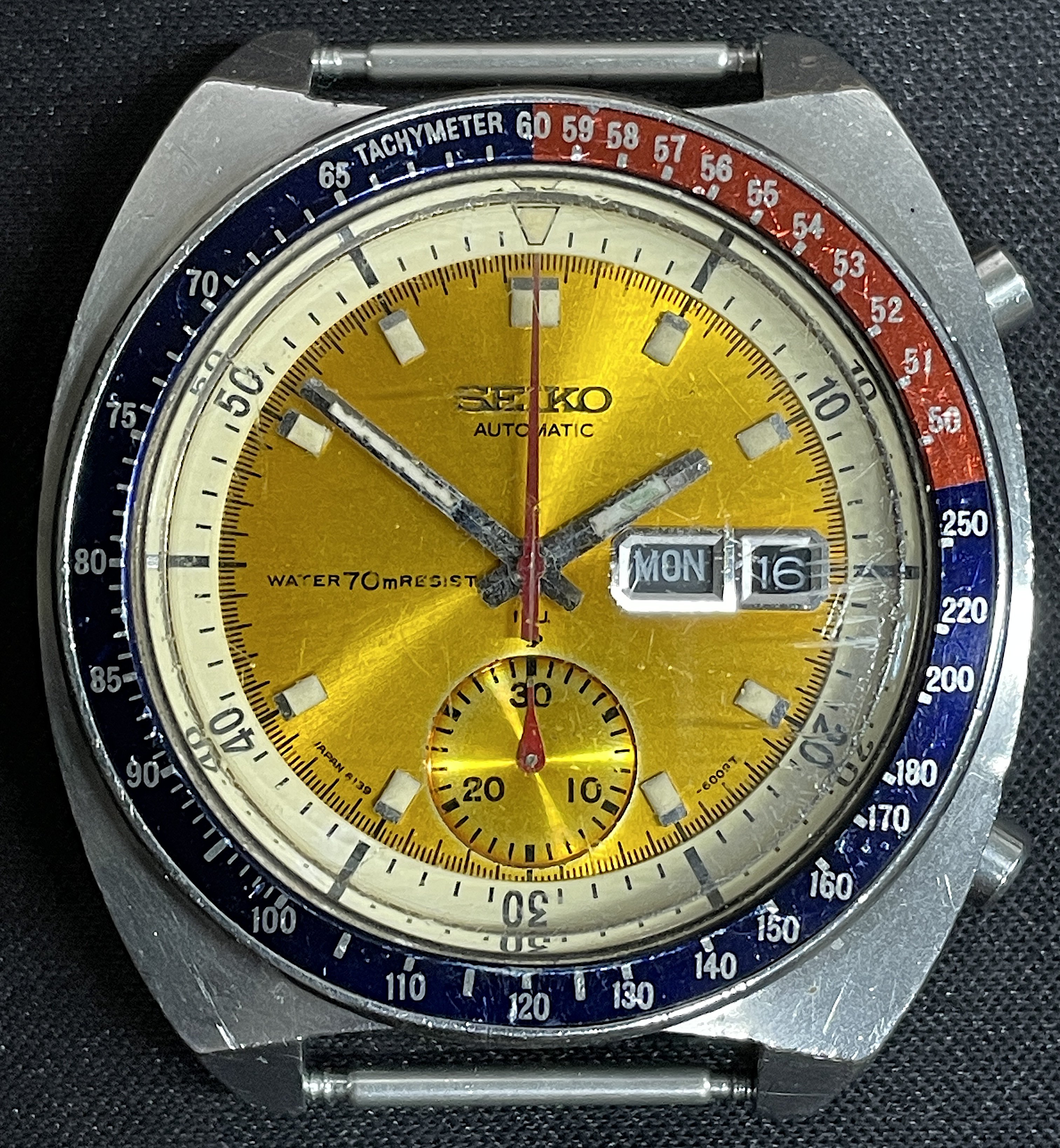

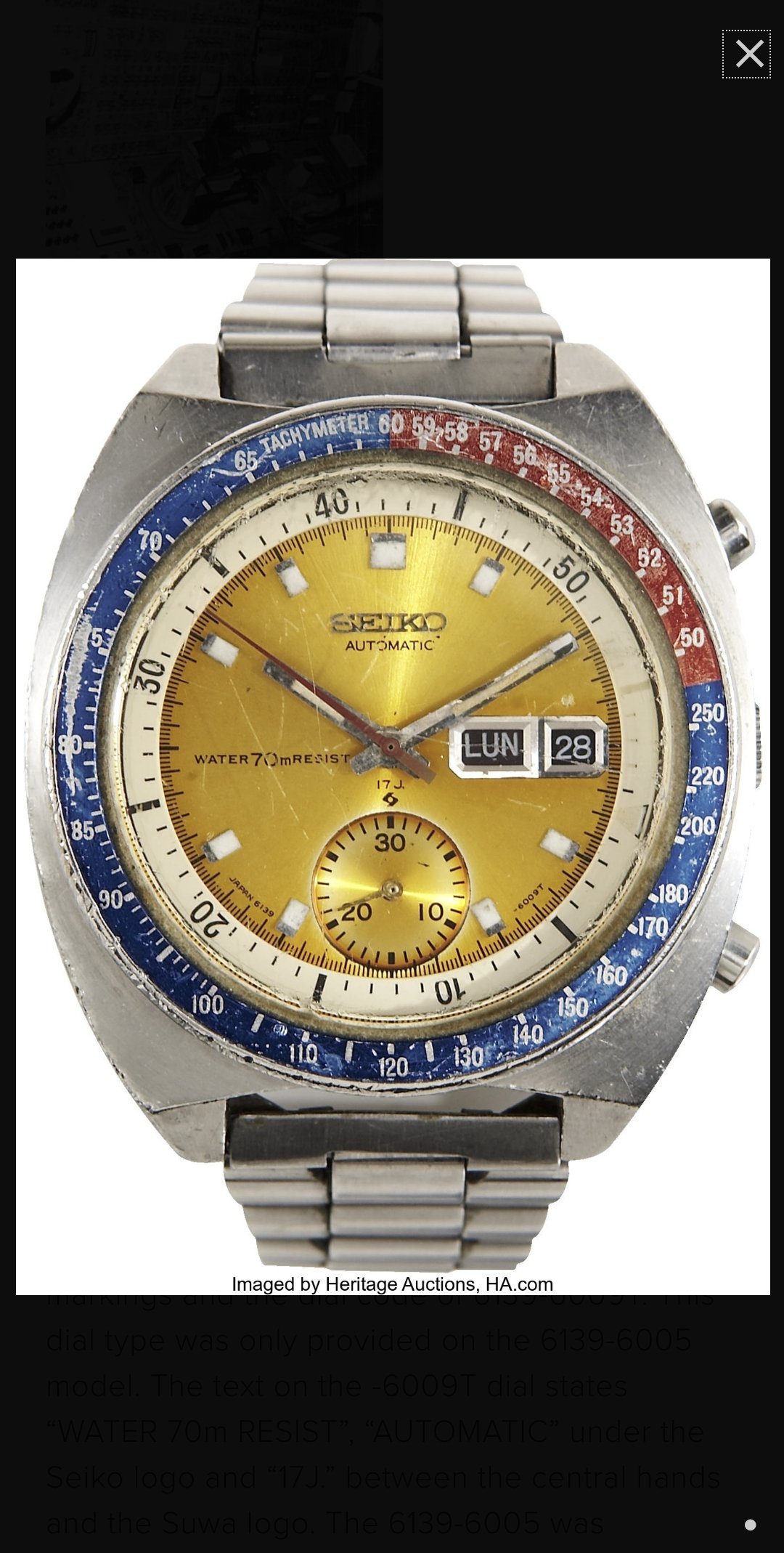

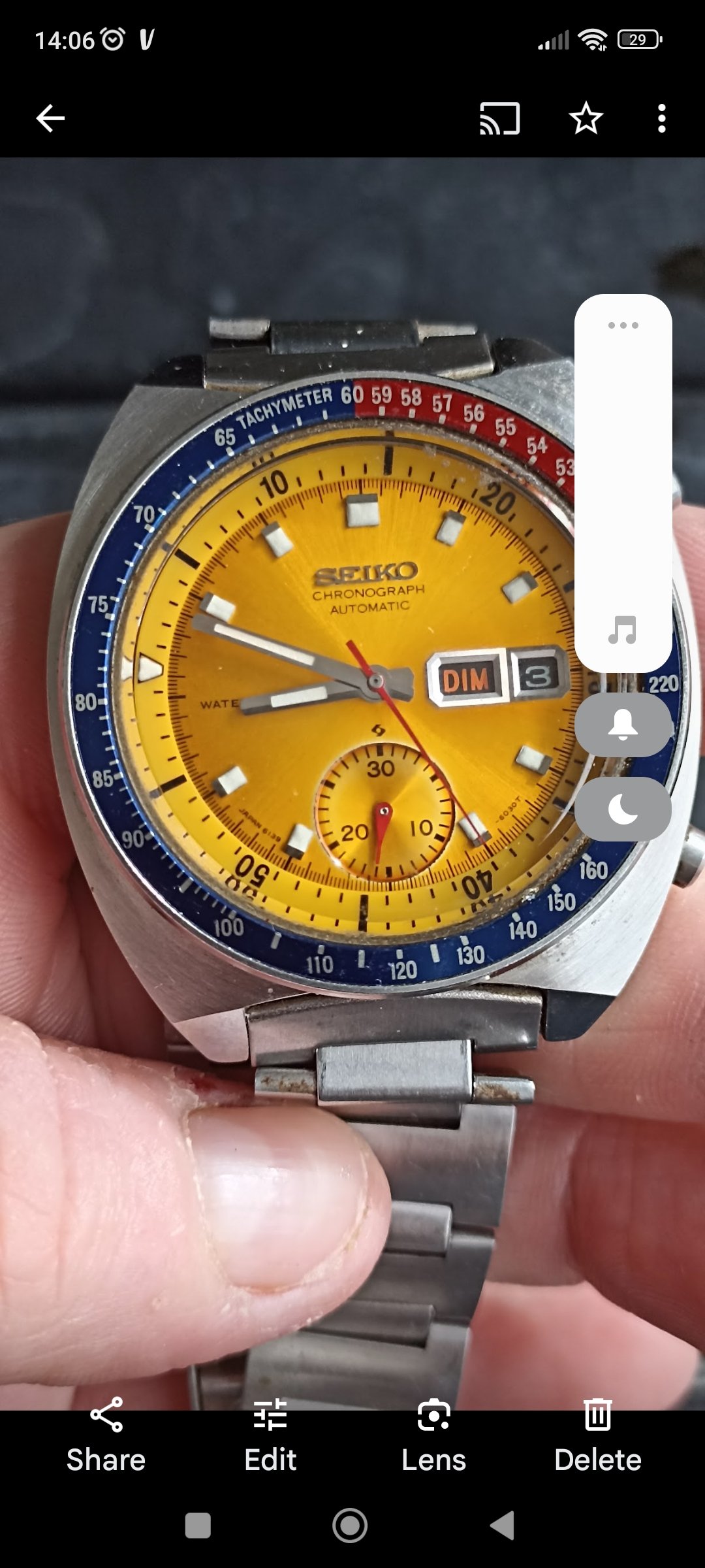

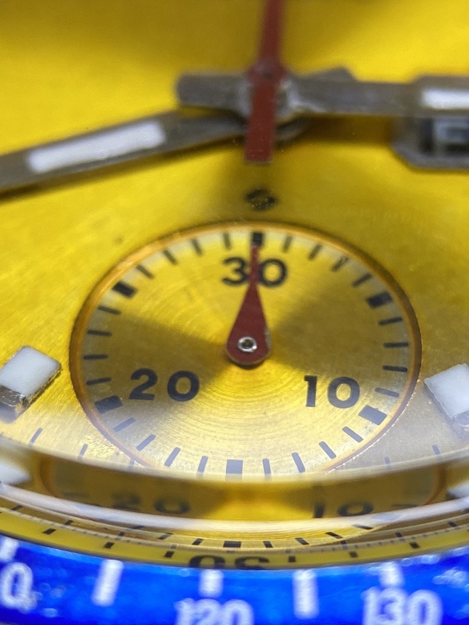

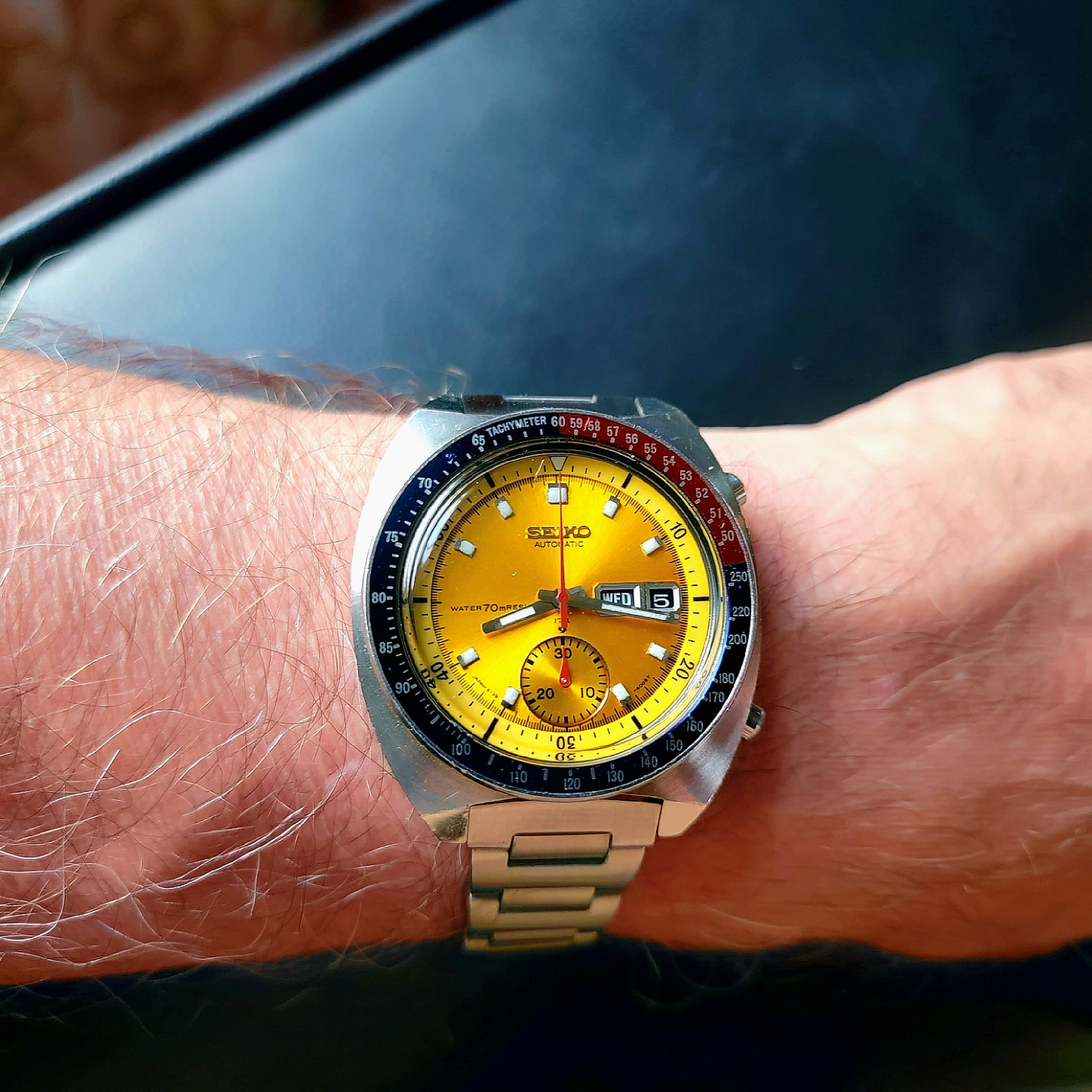

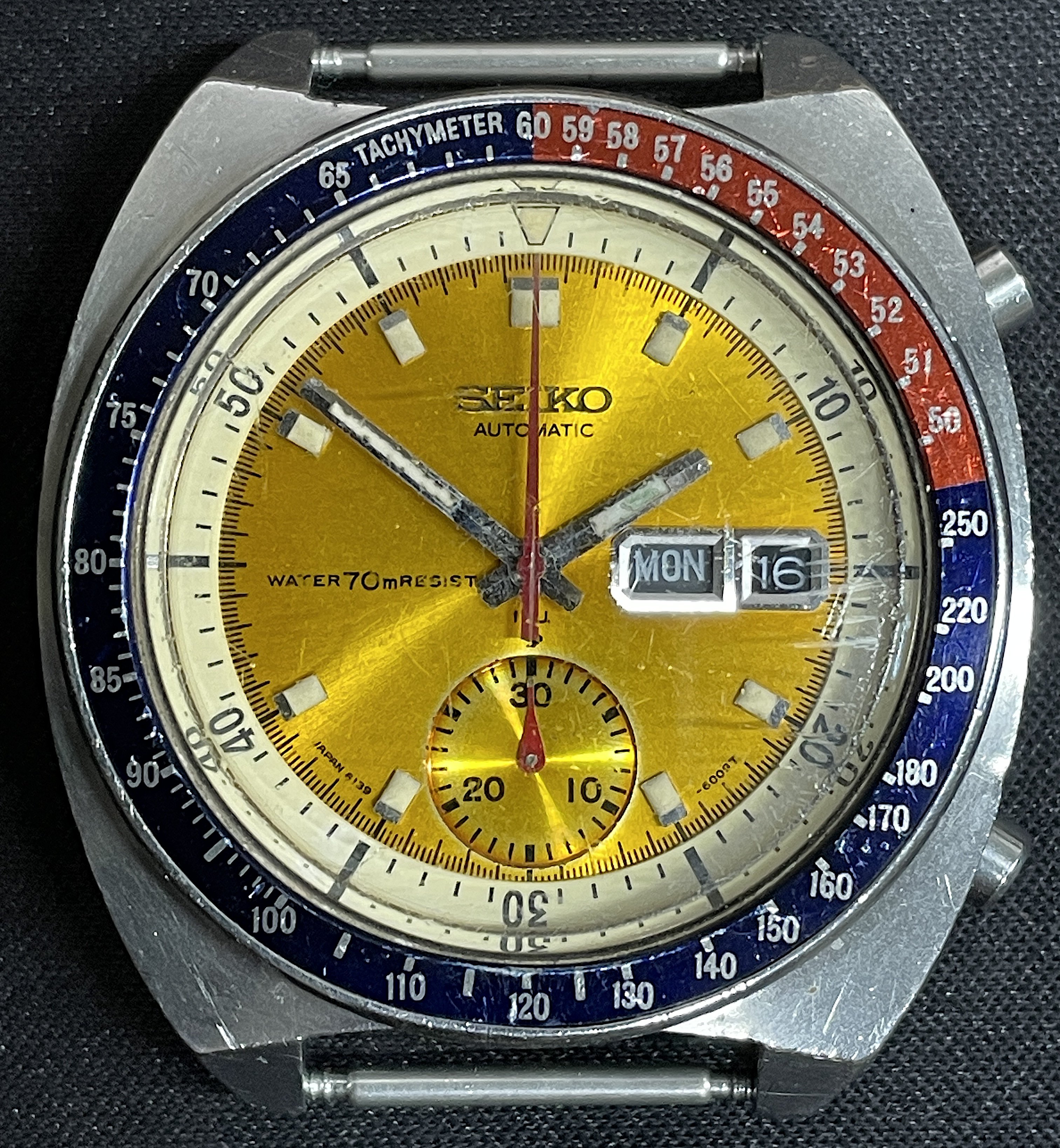

On the subject of Pogues, how correct does this 6005 dial look?
(I re-lumed the hands Bergeon bone white and fitted a new crystal after this pic)
6,497
22,078
I don't claim to be an expert but I don't see anything incorrect.
It only has Seiko and Automatic
It has 17j
The minute subregister is tight against the edge
The A in Japan has a flat top
The space between Japan and 6139 is at 37 min
It's 6009T
The dash in 6009 starts at 24min
The date and day surround is rounded
There may be others.
Your minute counter hand is correct. I think Pogue's was replaced at service.
Pogue's pogue

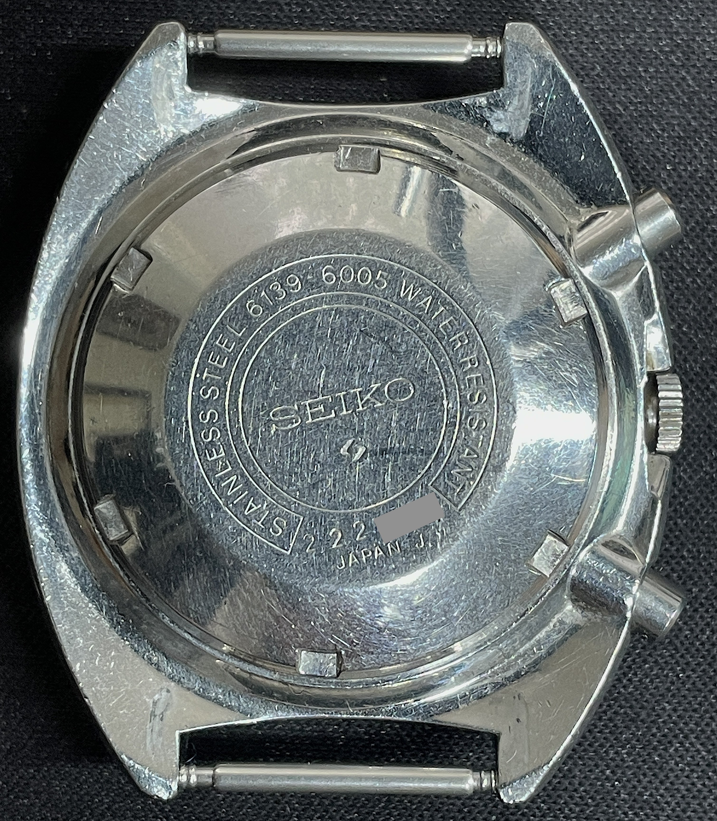

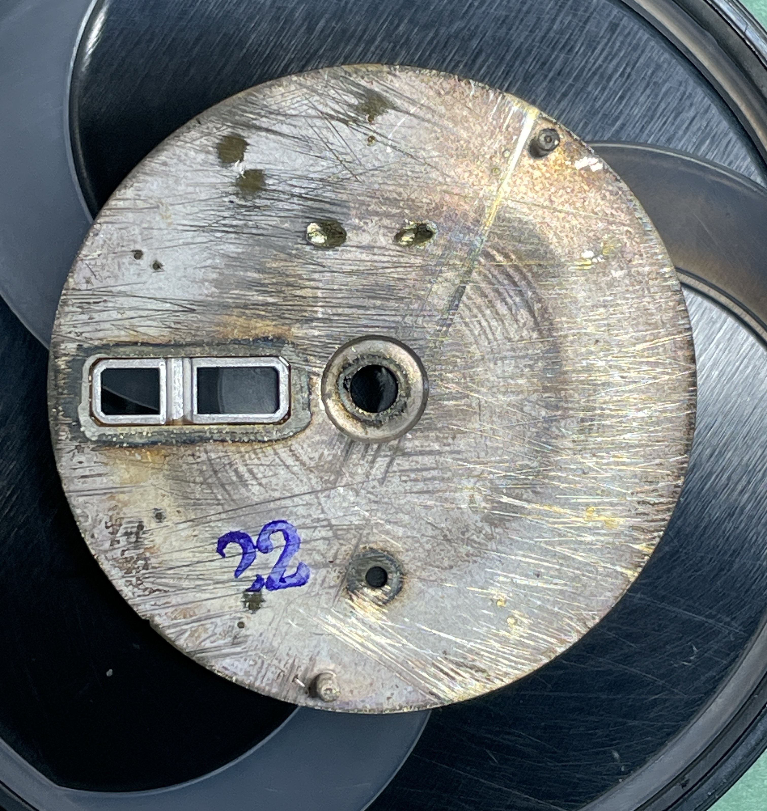

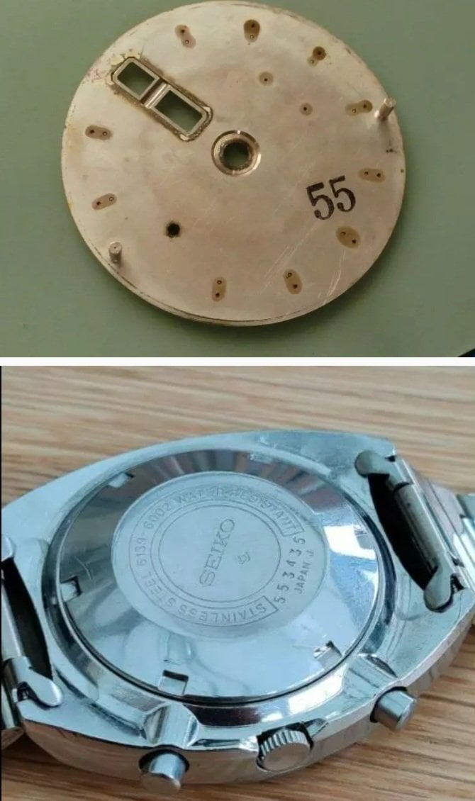

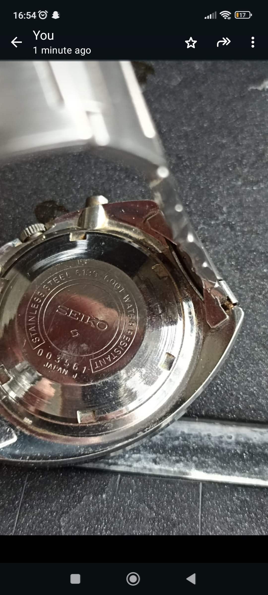

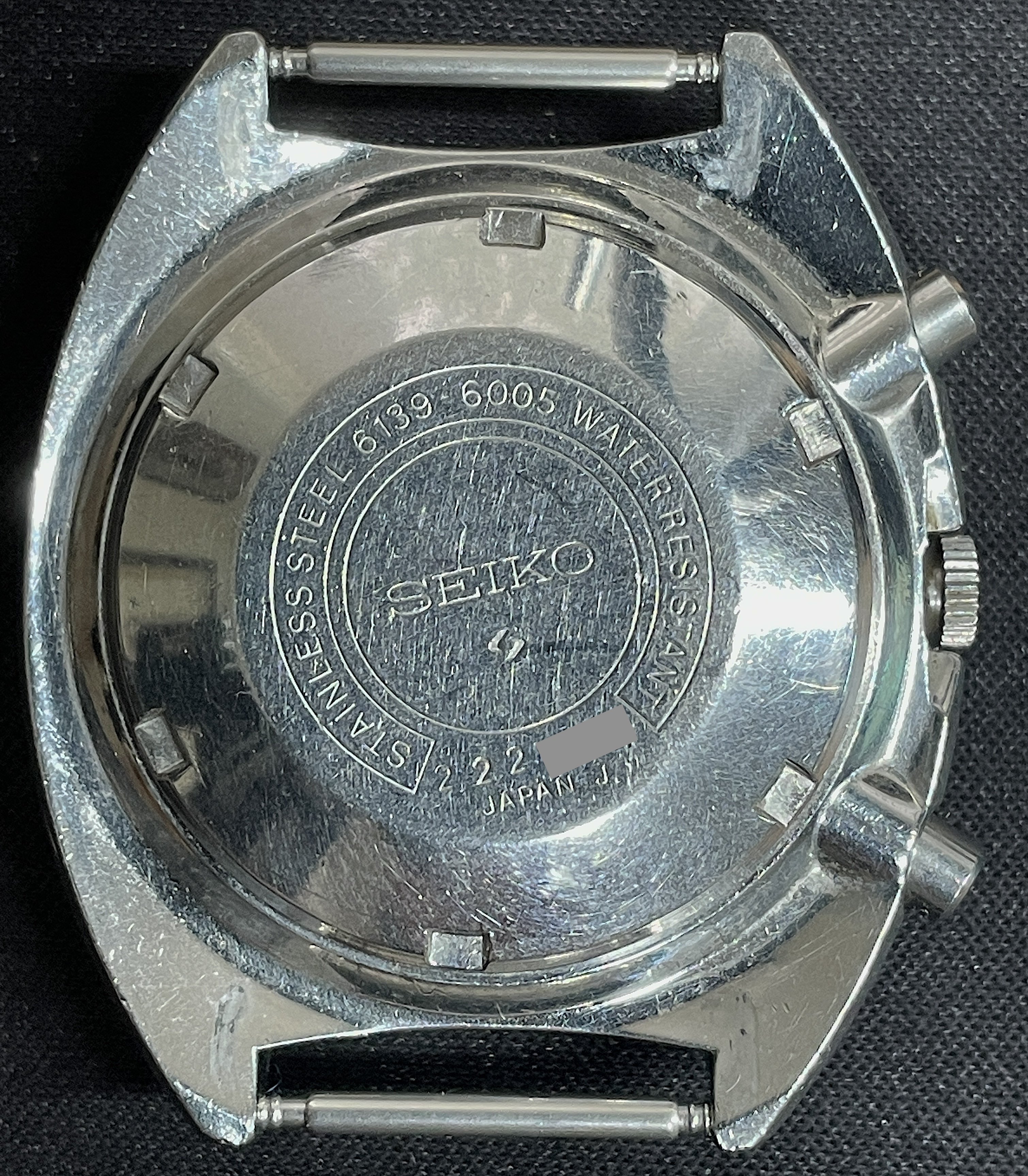

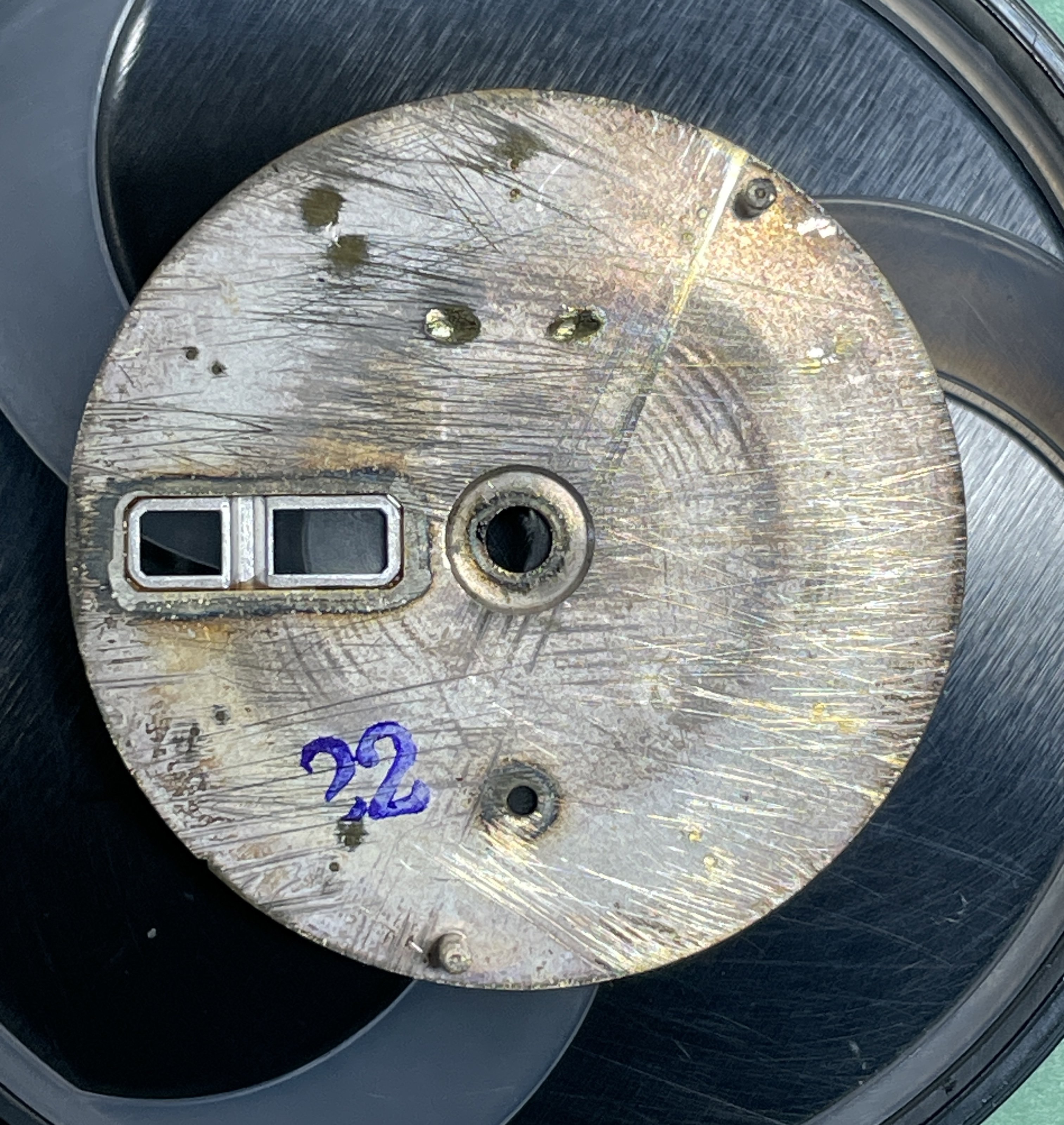

Hi Jim,
Did you remove the dial at all during your resuming works? In my experience the dials are date stamped on the reverse and this corresponds to the date stamp on the case back (first 2 numbers). A good indicator if the dial is genuine or at the very least contemporary with the case back
18,776
39,021
Hi Jim,
Yep. it was a full service.
Caseback shot (blurred number as it's a client's watch).
Reverse of dial has 22 date stamp, so ties in farily well.
1,561
3,672
In that case I should say it is a very high probability that the dial at least is absolutely genuine

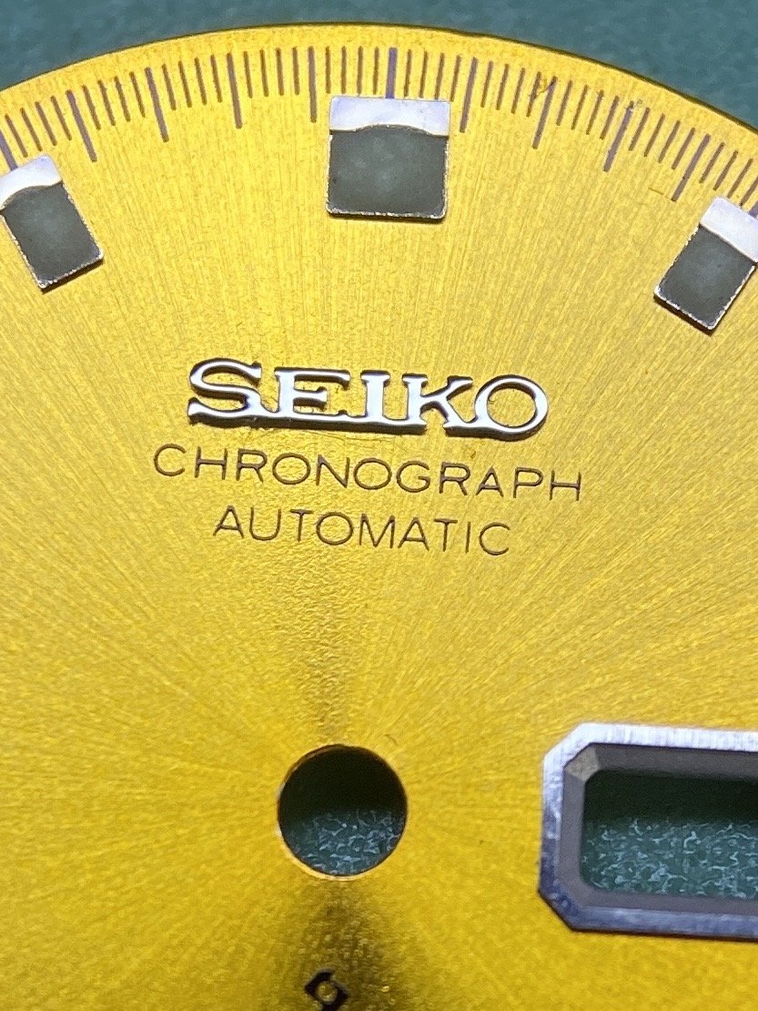

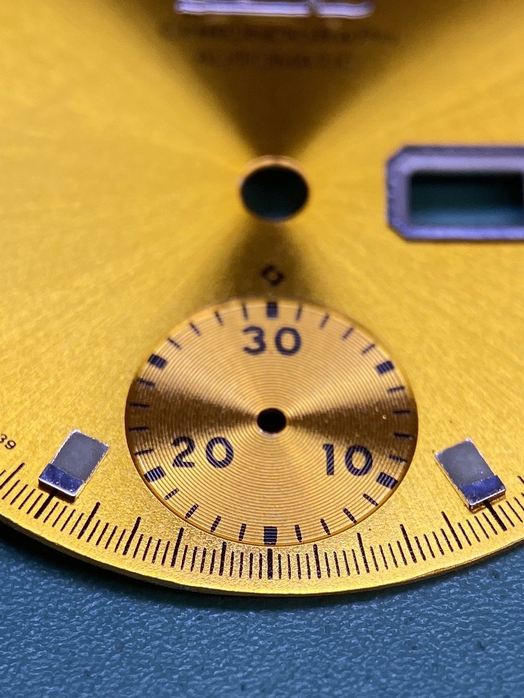

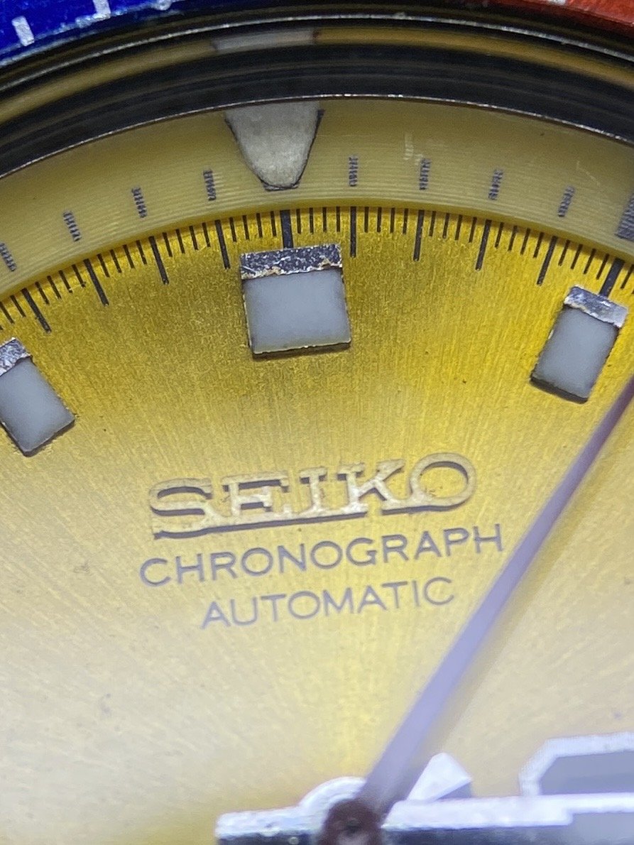

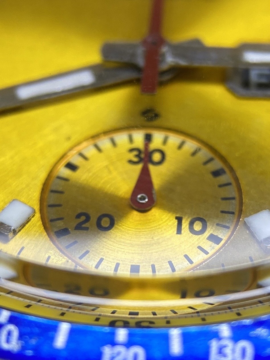

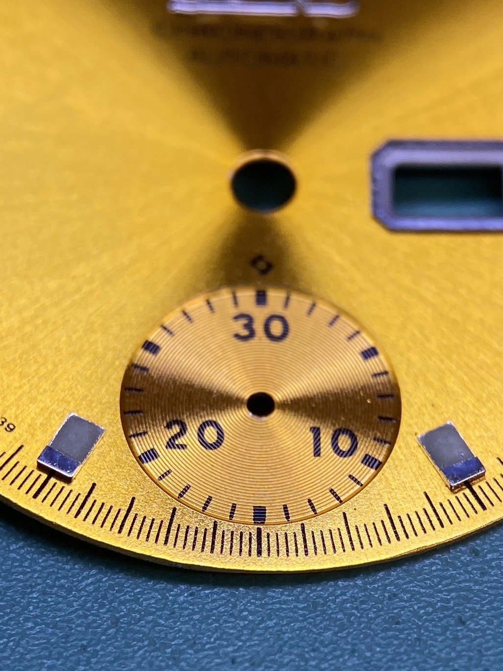

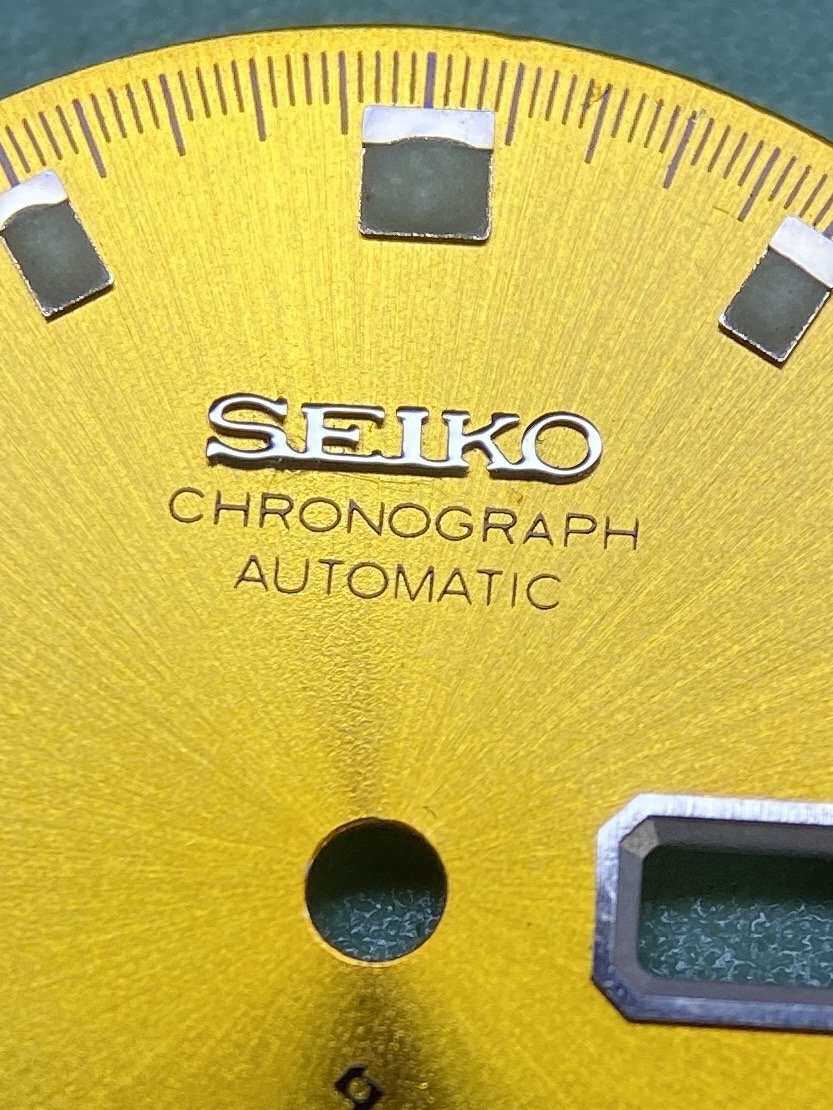

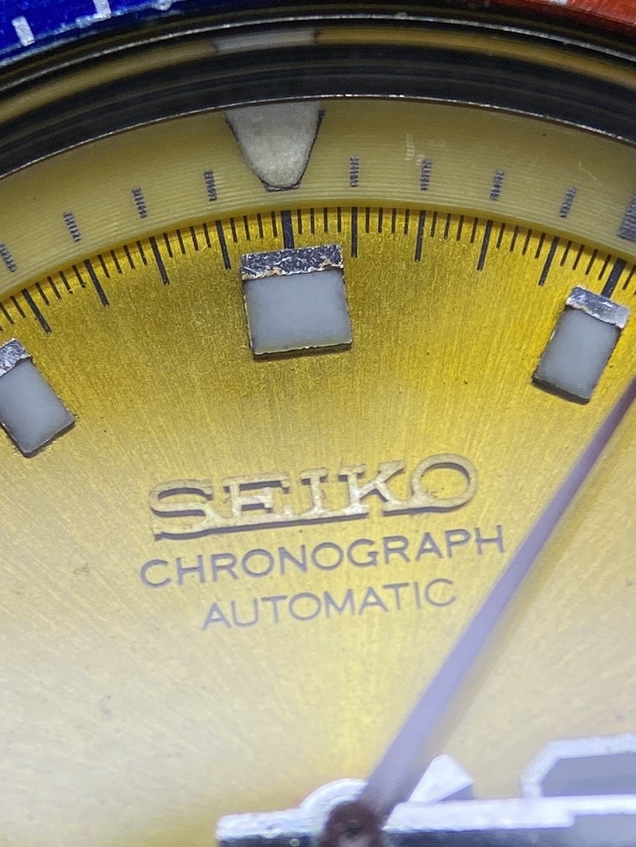

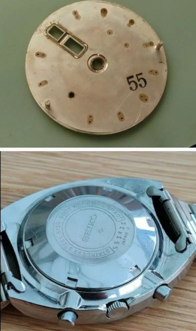

@pdxleaf did a great job listing the differences, and I'll add to that here. When it comes to the aftermarket dials, the lume plots are often a good giveaway as often they appear very shiny. Sometimes the lume plots will have been re-lumed, which is the case on he aftermarket dial below, so watch out for that. The colour can be a giveaway too. Usually, the sub dial of the aftermarket dial will have a heavy, grooved pattern. The originals don’t have grooves but more of a brushed sandpaper style concentric look. The applied SEIKO logo on the OG versions will be sharp, with crisp edges. The aftermarket’s are usually quite soft and rounded. Lastly, I have never seen an aftermarket dial with a date code printed. Pics below (I apologize, I couldn't be bothered taking the crystal of the OG and have no other yellow dial's apart right now).
Aftermarket version - note the sot edges on the logo.
Nice, crisp lines. No rounding.
Aftermarket - heavy concentric grooves.
OG - Brushed, 'sandpaper' style finish

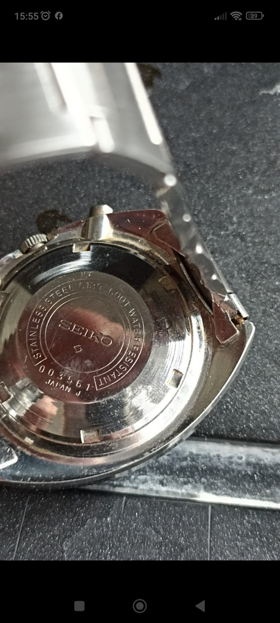

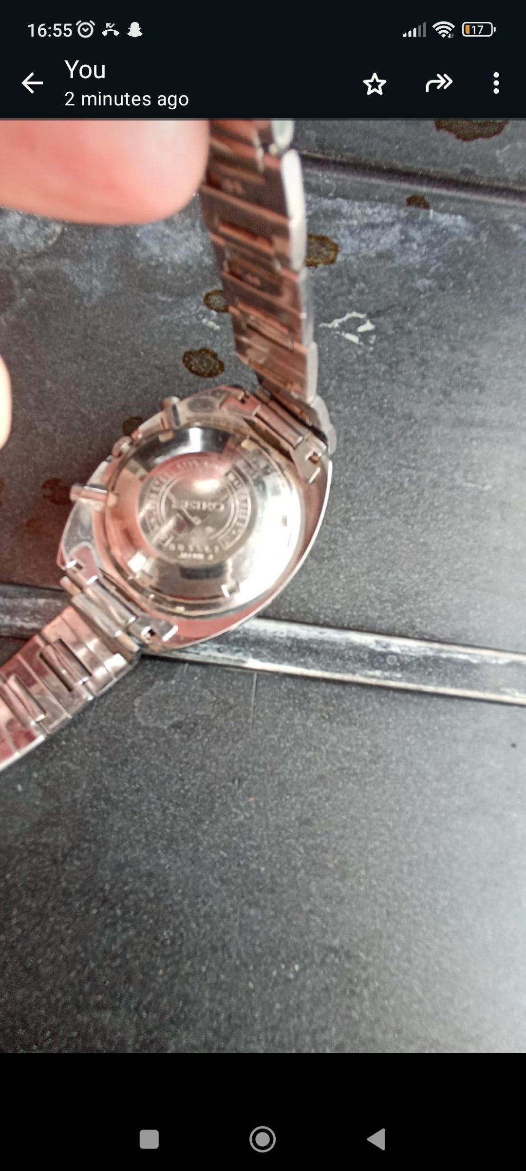

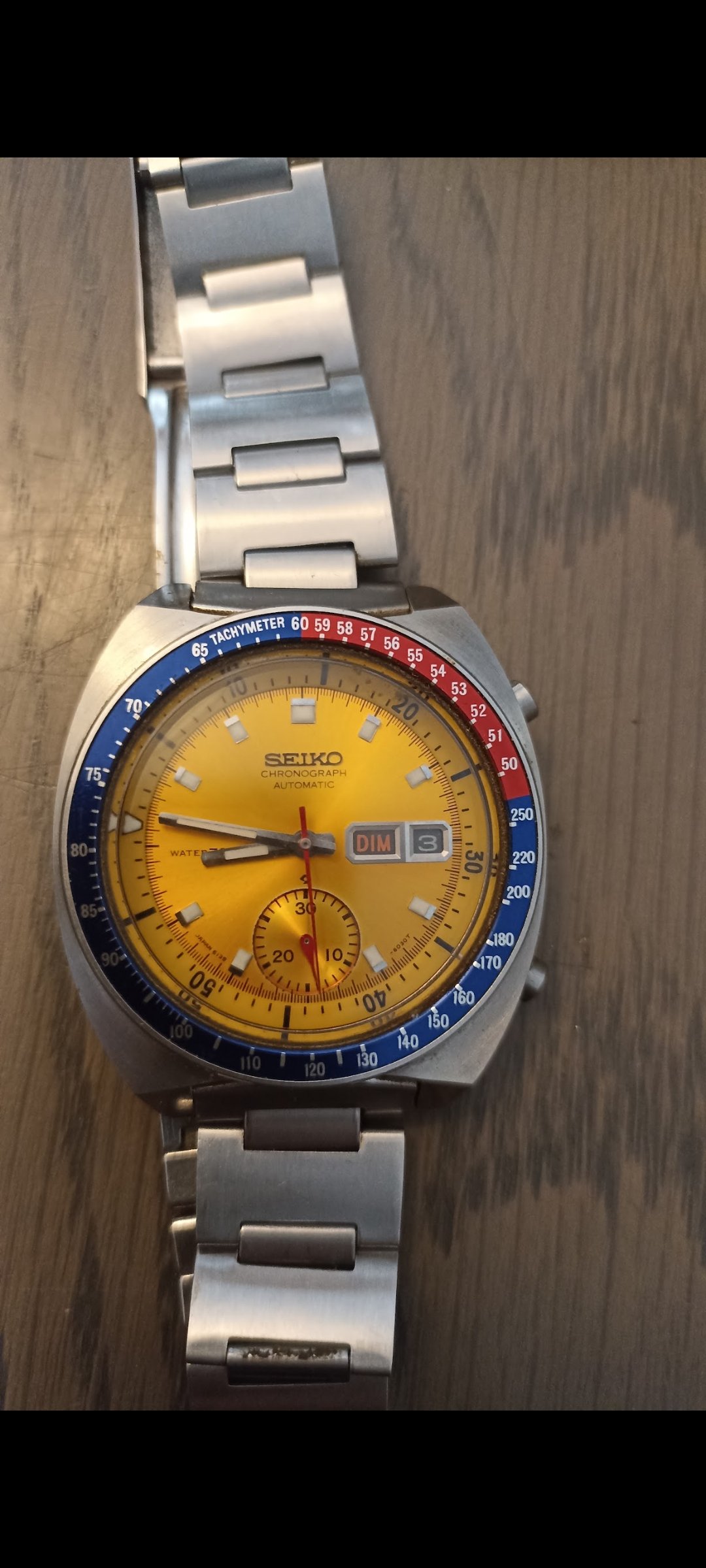

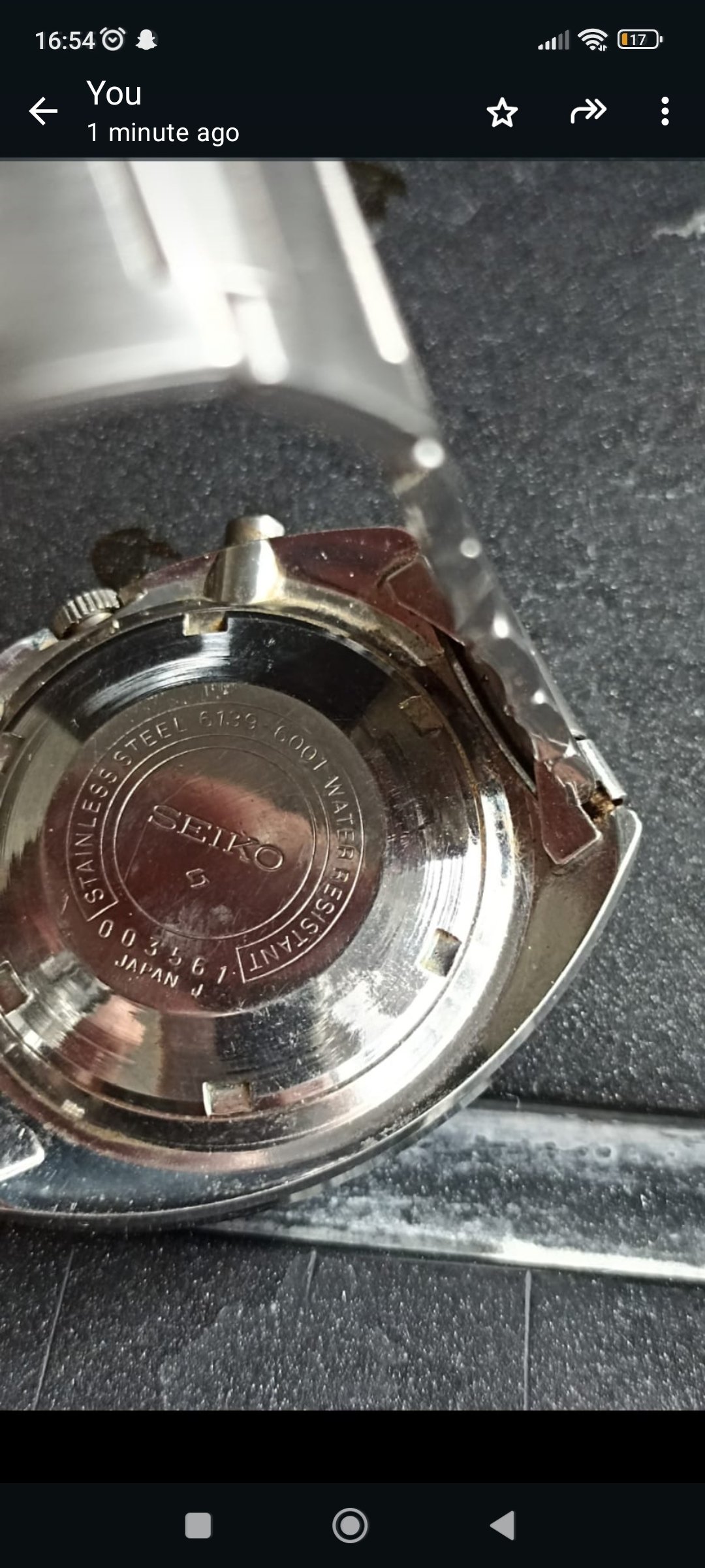

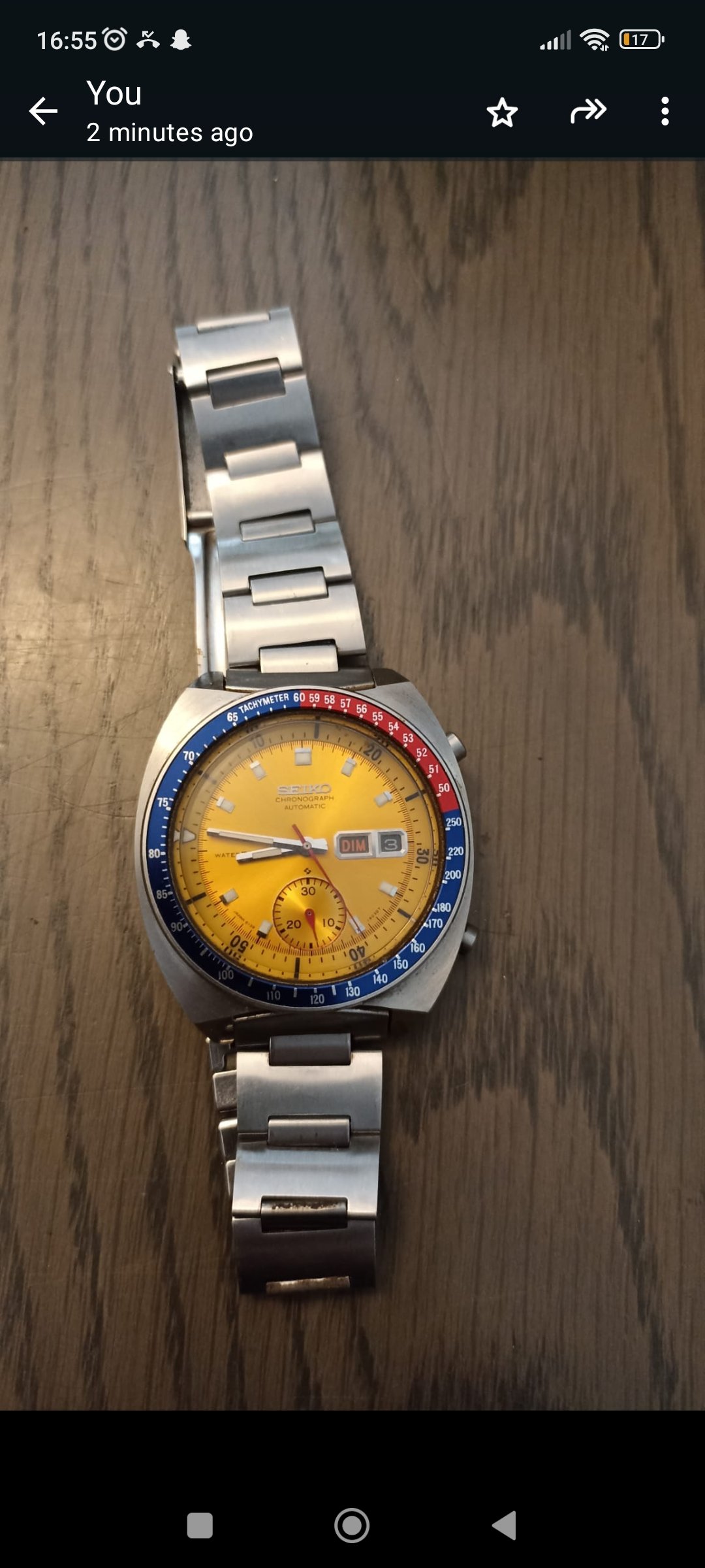

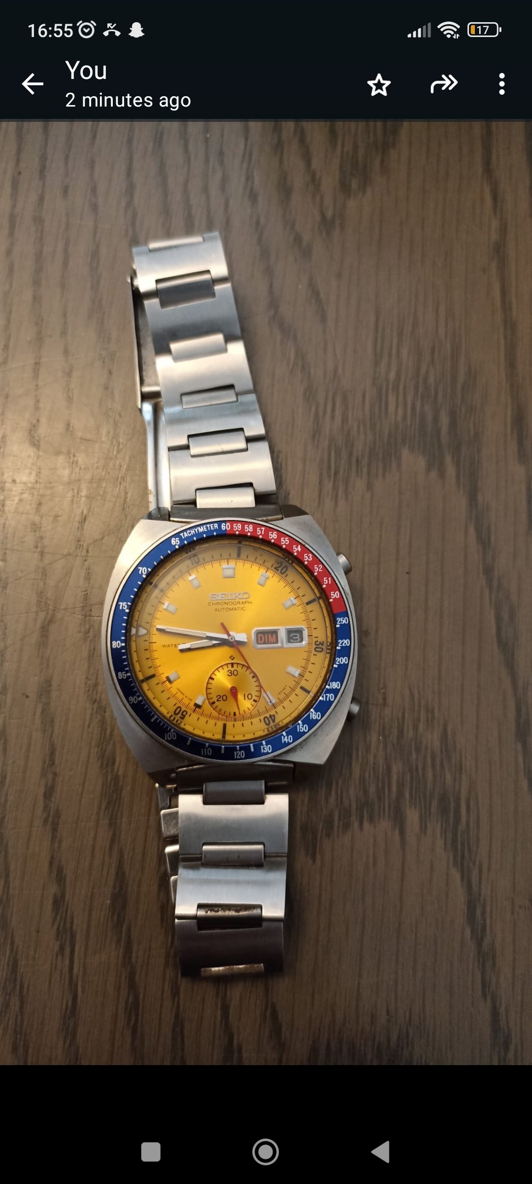

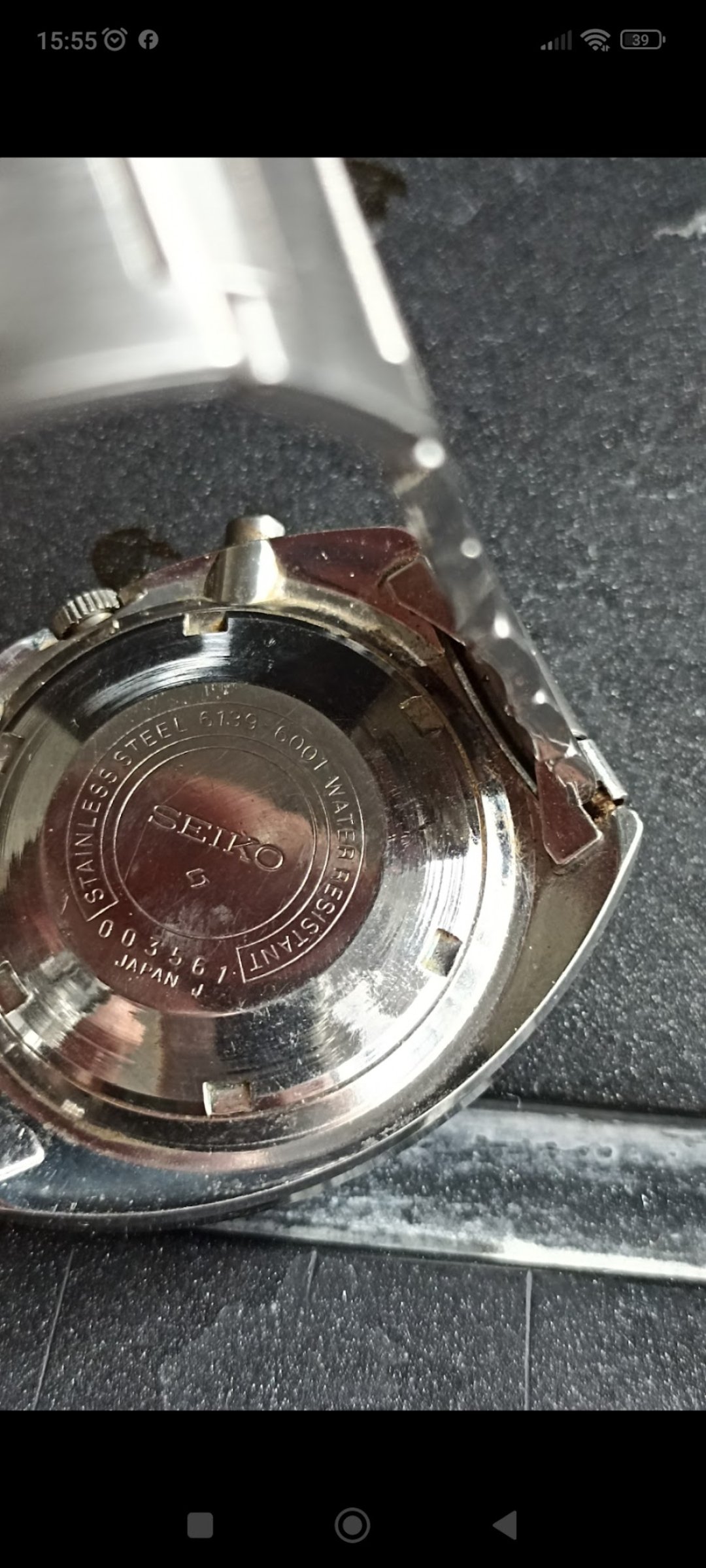

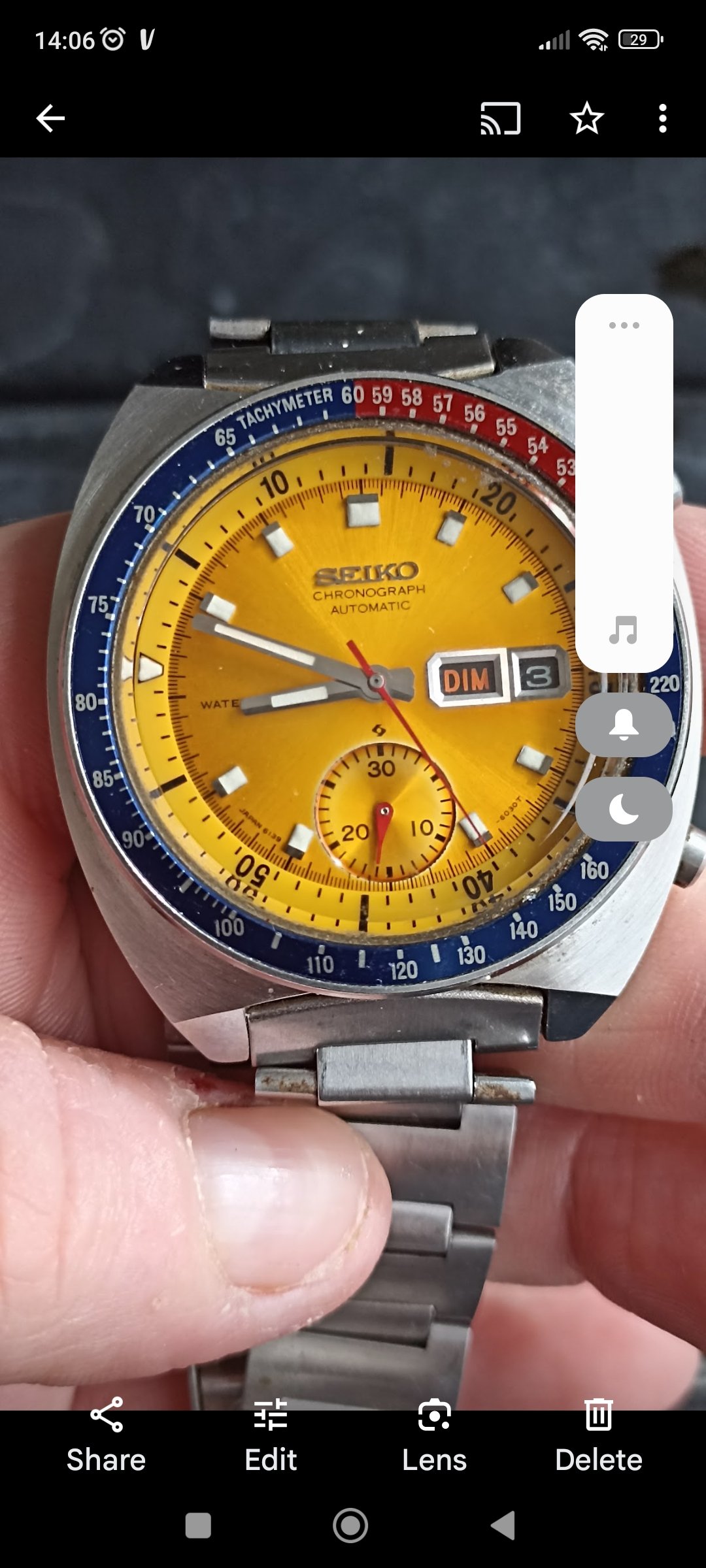

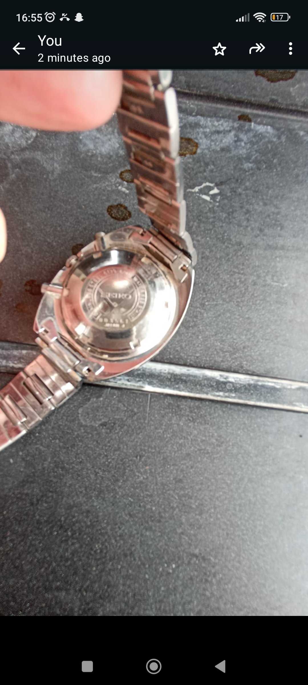

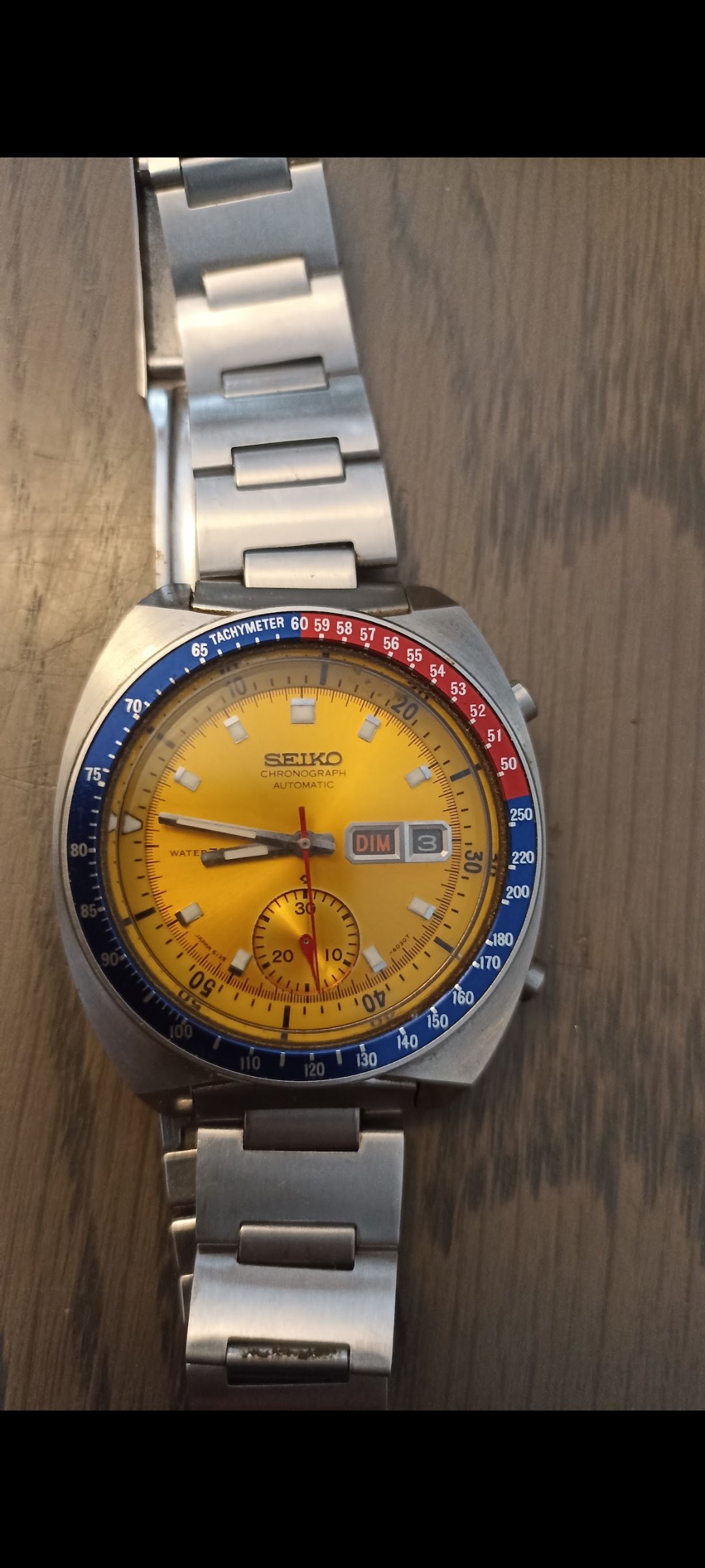

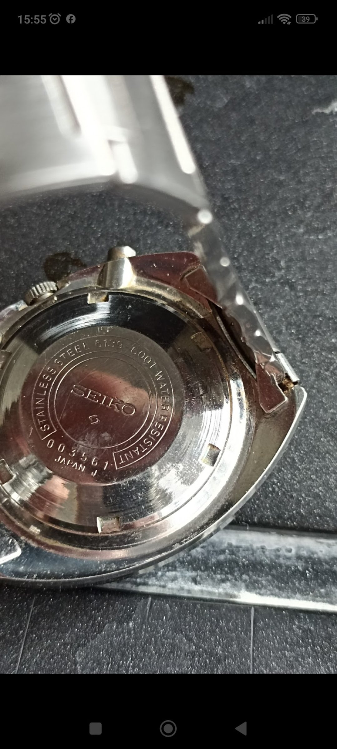

I have found a Seiko pogue watch 6139-6001 serial number 003561 it's in really good condition doesn't look worn hardly photos don't do it justice . I've approached a dealer who said it's worth £250 , unless it's been serviced . It seems to work fine but if someone could maybe shed more light on the watch and lower serial number /value
6,497
22,078
The photos are not clear enough for me to determine authenticity. As it is, it appears authentic and in very good condition. It's not the American market 6139 like a true "Pogue", but that only matters for some collectors. It's a great price for what appears to be a great condition watch, even more so of that is an original Seiko bracelet.
There's a lot of info on the web. What are you thinking?

Hi thanks for replying we are thinking of putting it on eBay or an auction site but are trying to gage the starting price and where the low serial number and condition would count in its favour for price but if it's only a couple of hundred we'd just keep it . I added another couple of photos if it helps to identify.
