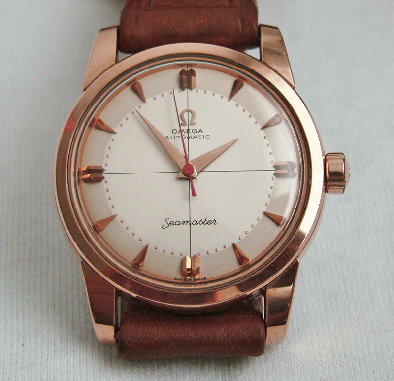

What concerns me is not the dipping "r" - that was normal on 50's Seamasters. The alignment of SWISS MADE is a problem in my eyes. The space between the words is dead on the 6:00 marker. Usually, the space is pushed a little to the 5:00 side because Omega aligned the whole phrase to the bottom of the dial, not the two separate words to the bottom marker.
That is going to keep me from bidding. It may turn out to be trivial, but I've NEVER seen a dial that I know to be original have that issue.
That is a really good observation--never made that connection before--and also the actual font of the SWISS MADE looks a bit strange/sloppy, especially when compared to the other analogous dials in this thread. Could be crystal distortion and maybe you guys have seen that font before, albeit later?
I will say that I think it would be pretty tough to do that lovely circular finish and contrasting outer ring ex-factory.
Really beautiful watch, whatever the niggles. And to give the seller the benefit of the doubt re: movement info/pix, sometimes those snap backs are a nightmare to A) open and B) close again.

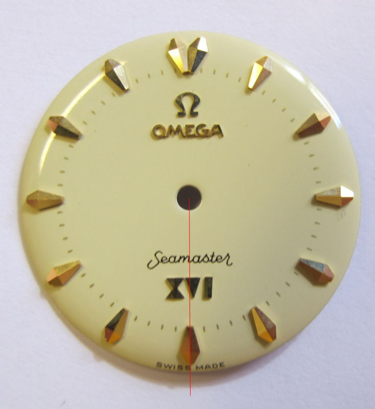

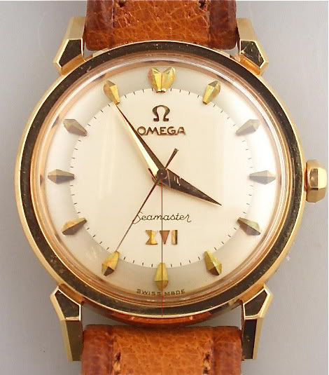

Ran across this shot of an excellent XVI - notice how the SWISS MADE is centered to the bottom of the dial?

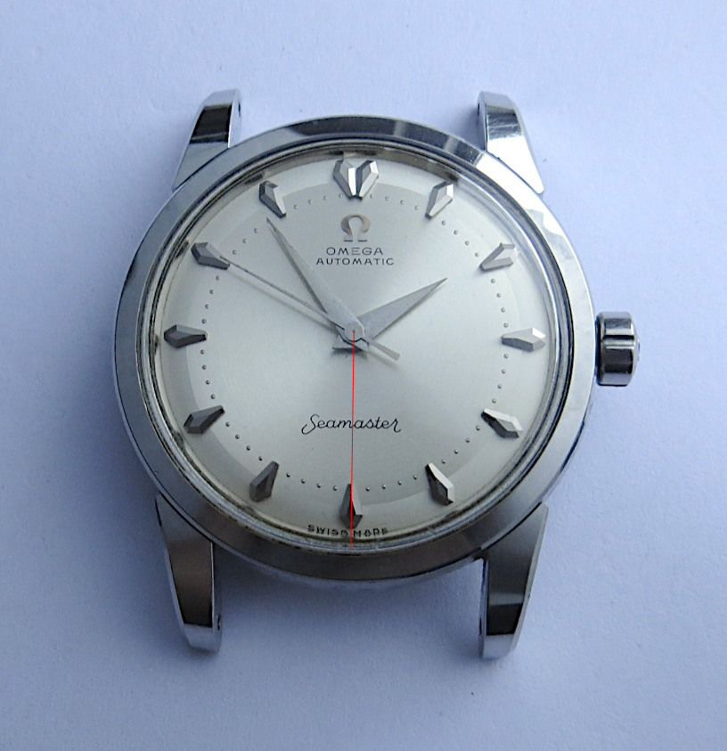

Here's the first picture from the OP:
Centering looks the same to me, although the marker shape is slightly different.

25,980
27,647
Nice graphic John. 👍
(marking it for future reference: ecclesiastical)

besides the Swiss Made alignment,
no "m" touch on Seamaster vertical plane
on the eBay watch in discussion

I'm not sure that all the dials are comparable in that way. Find me another two-tone coffin marker dial like that and we can talk.
I'm still voting original Omega, but possibly a service replacement.
Not even Hoi's Vietnam connection is that good.
But he's real close! 😉

why would they set the coffin different from other 2 tones with pearl minute marks?
not coherent
