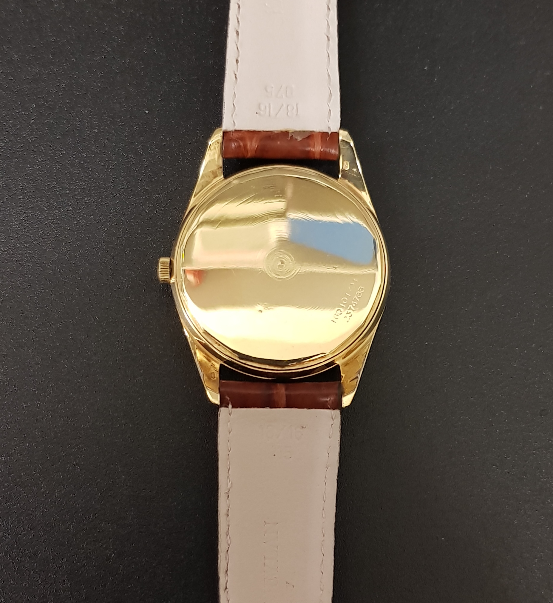

Here's another 169101/01 caseback. Very polished but what I believe to be the original circular polished finish is still visible. I believe that allays the particular concern regarding the inscription being on top of the circular polished finish.
Yes, good research. It does appear that the finish was likely original. But again, you have no answer for the most problematic issues:
- How could such a heavily used watch feature a 55 year-old engraving that shows virtually no wear?
- How could a watch given to a senior staff member at UG feature the SAS logo, yet no reference to Polerouter on the dial, the very model line that defined the partnership?

I don't envisage ever being able to fully resolve those queries but here are my thoughts:
- The inscription viewed in person looks anything but fresh. The back also feels quite smooth - you would barely know that the back had an inscription by touch alone. I sometimes think that I bring problems upon myself by sharing such high resolution images.
- What is it that makes you think that the watch has been heavily used? We know that it has not suffered much, if any, polishing because the original case back finish is still present. The fact that the inscription is still quite visible does not therefore seem surprising. The depth of the original inscription also has a part to play in how visible it would be today. I agree that the inscription is more visible than the UG numbers but those numbers are actually more visible than on most UG case backs I have seen. The UG numbers are also intentionally subtle whereas the inscription would have been created with the opposite intention.

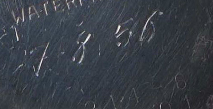

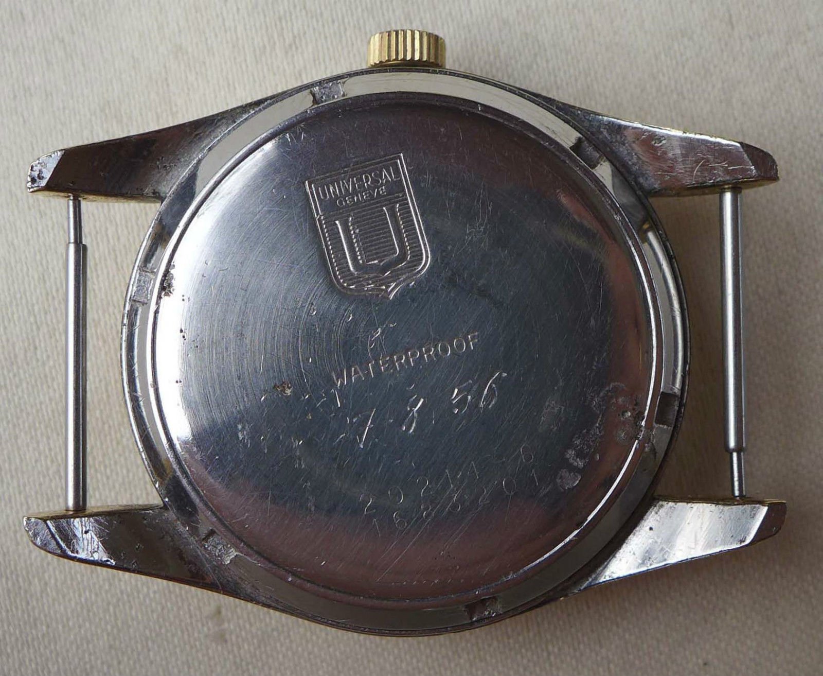

@Tony C. Not sure about what you said about the inscription
Here is a oic of the case back of my Polarouter going back to 1956.
Of course it is bad executed but much more visible than the serial number

That looks like it was chiseled out. However, it looks correct as it seems to have marks and wear that are consistent with rest of markings and no burs indicting a recent chiselling ...
It is true that some engravings - typically the more crude ones - are deep. But yours show none of the odd ridges that appear on the OP's watch.
