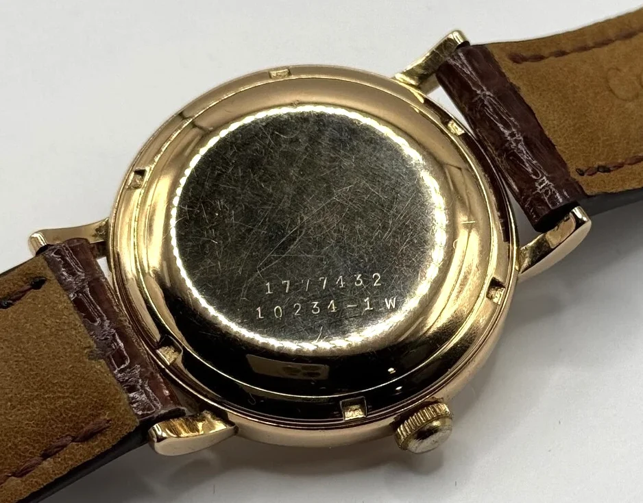

I recently acquired a Polerouter DeLuxe, Ref. 10234-1W. Case has been polished, but I really don't care, as the price was right around melt value.
A nice watch to wear and keeps great time also. Rose gold is a bonus.
OK, here are the questions -- Does anyone know what the "1W" means? Does it mean rose (really closer to red) gold? Are the central dials also 18K?
According to The Polerouter Reference Website, there are several second tier sub references to the 10234-1. There is the "TL", which generally refers to the Saudi presentation watches. I found one or two TL's that did not have the King's portrait engraved, but all of them had a UG signed caseback, which seems to be unique to this sub-sub reference. I also found a rose gold portrait watch marked B10234-2TL. The SAS Polarouters were also 10234-1, but no "W" added there. So those are all different animals.
I was able to find another -1W out there, but it is one of the enameled dial examples. Serial number would be close, but the auction description seems to be missing the 1 million digit and there are no pictures of the case back either. It is also described as "pink" gold, so there's that.
Any help that the collective can provide will be greatly appreciated. Thanks in advance.

Great question. I have a working theory but didn't have time to fully research it, so it's not included in the Polerouter book.
I think there are at least 3 different manufacturers of this case for the 10234 reference.

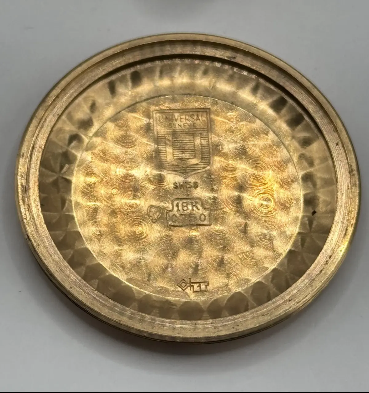

The OP's is a 10234-1W. I think this case will have been made by Wenger (W for Wenger). If true, the inside of the case back will include the Key of Geneva mark with a 1 inside.
There are other watches with a B, often a prefix to the reference. I think these cases will have been made by Baumgartner and will therefore have the Key of Geneva mark with a 2 inside.
The vast majority, potentially all, of the other cases were made by Jung. These don't have any letter associated with the reference. They are identified by a hammer head mark with 128 inside.
You are correct!
Here is an example with the “B” prefix. It has the key with 2 inside.

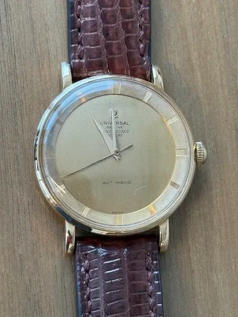

@Mazoue, do you know if the gold dials are actually solid gold? My guess is no, since the black dials do not seem to be gold underneath. Did the SAS and Saudi engraved dials get upgraded?
Many thanks,
gatorcpa
1,211
3,071
Many thanks,
gatorcpa
I don't honestly know.
The dials are often described as being solid gold and I have no reason to doubt that, although there have been no hallmarks on the reverse of any dials that I've ever seen and that includes the SAS and Saudi dials.
