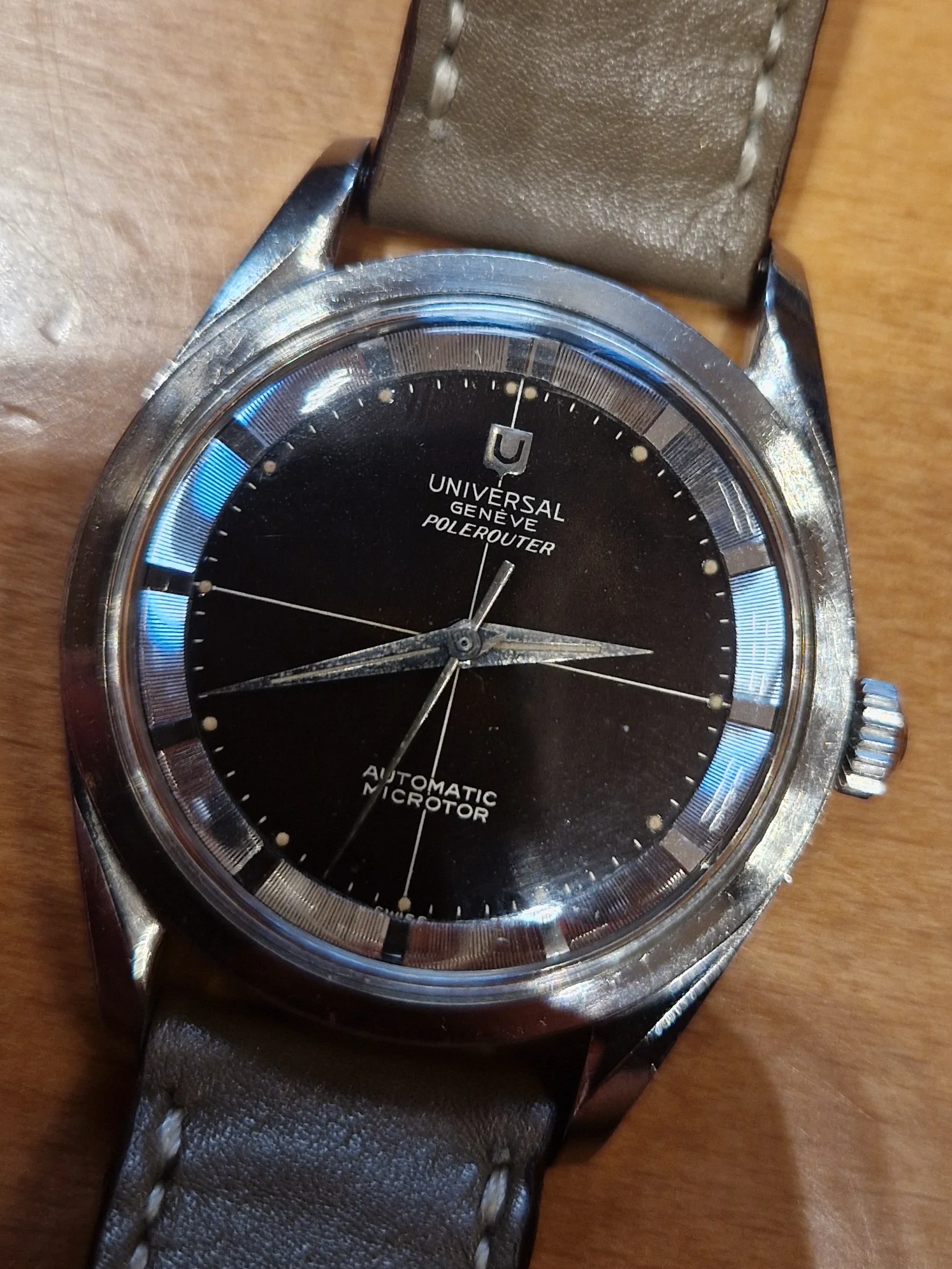

Hi everyone,

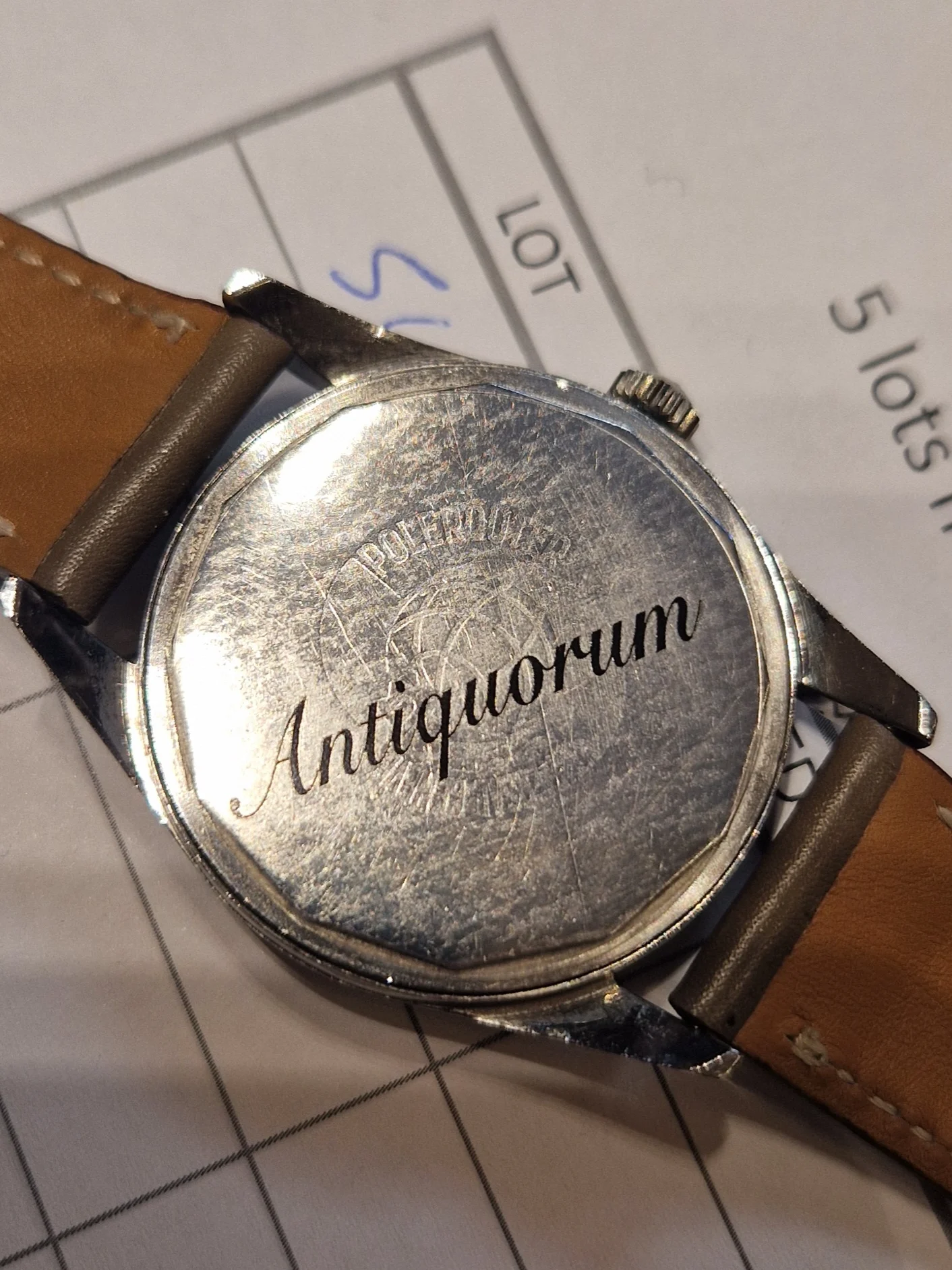

I went to the Antiquorum auction preview today. A Polerouter had caught my eye.
I'm not super experienced in judging their authenticity, but looked at the resources on this website (dial print thread) and online.
Antiquorum doesn't give the reference number and I wasn't allowed to open the watch, but they say it's cal 215.

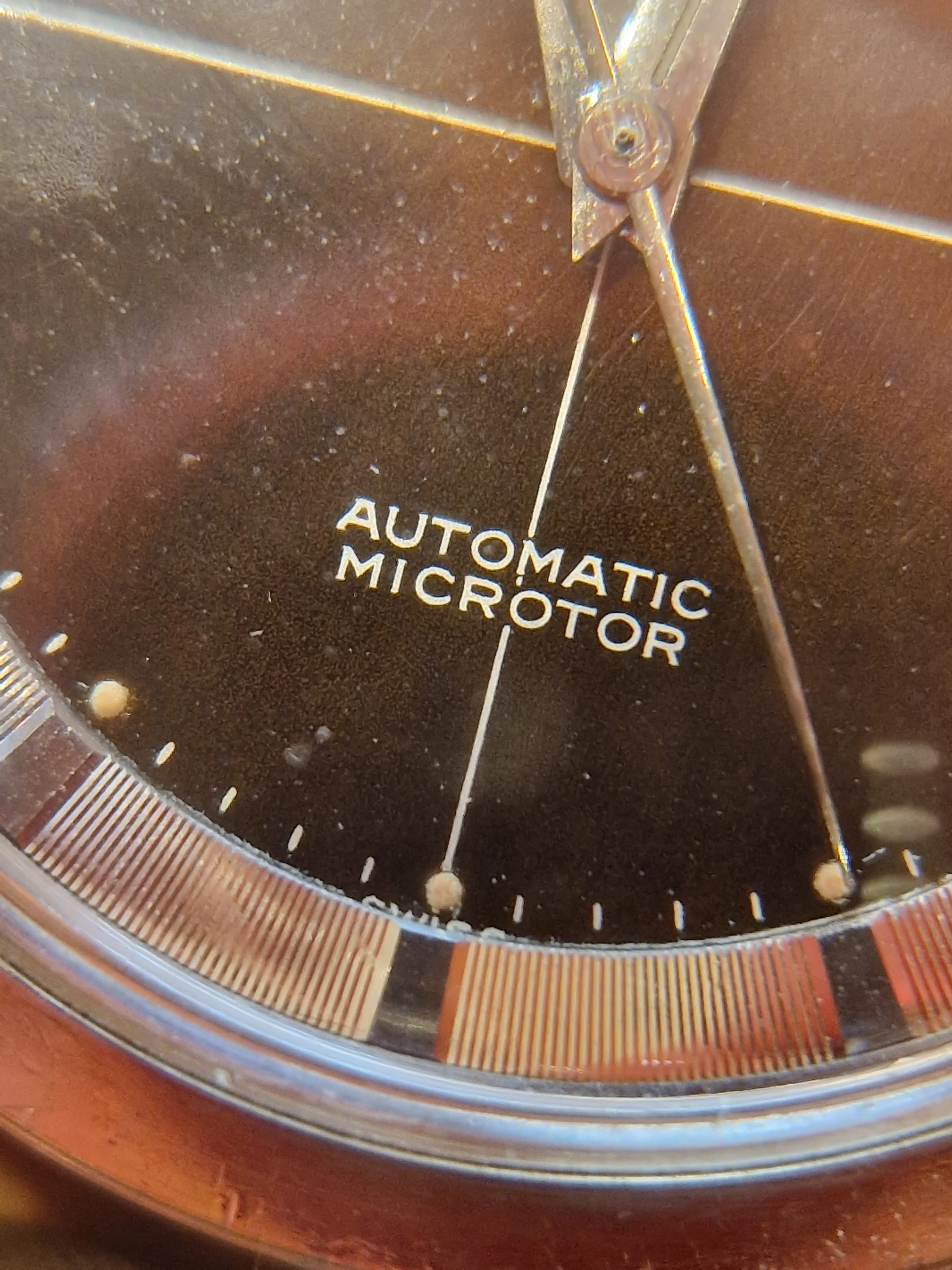

From what I've read, cal 215 with print "Microtor" should NOT have the "Swiss" print. This one does. To make it worse, the Swiss is actually half-covered by the inside bezel. See photos. Clear case of a Franken?

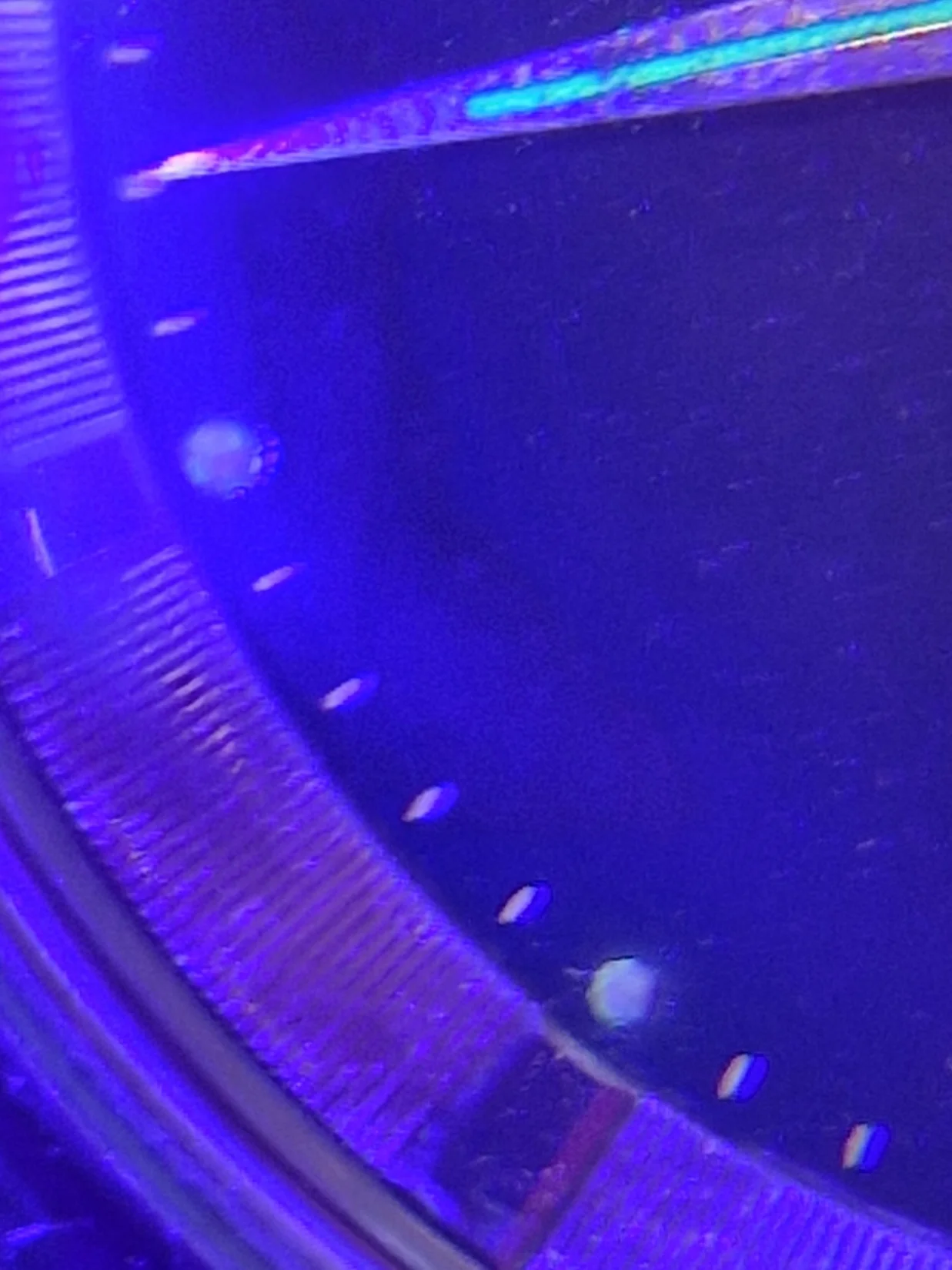

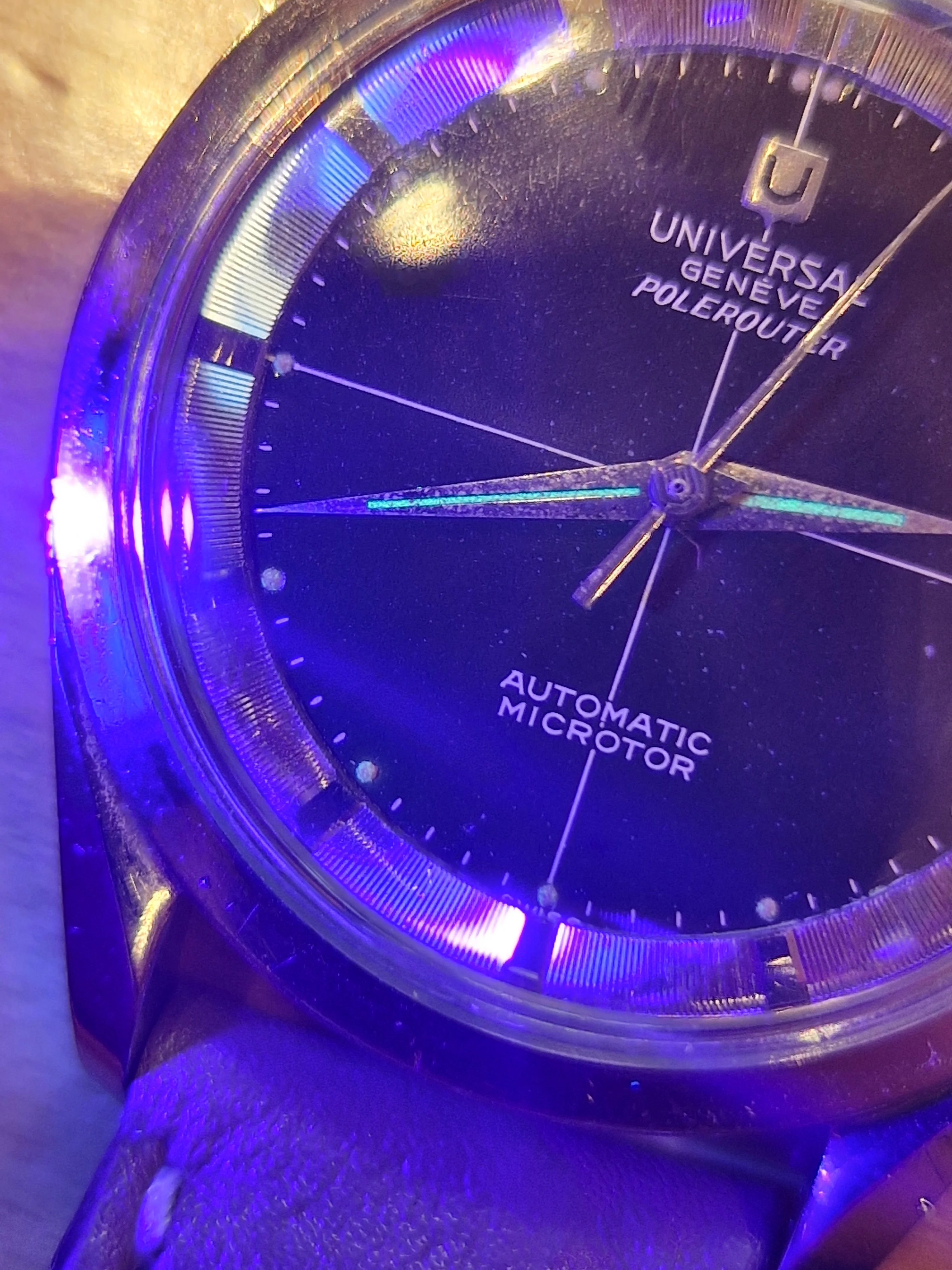

Regarding lume, the hands react strongly to my UV lamp while it's on. No discernable after-glows. The hour marker dots show a VERY faint reaction. Barely visible.
Here are some photos.
I'd be happy to hear some other expert opinions!

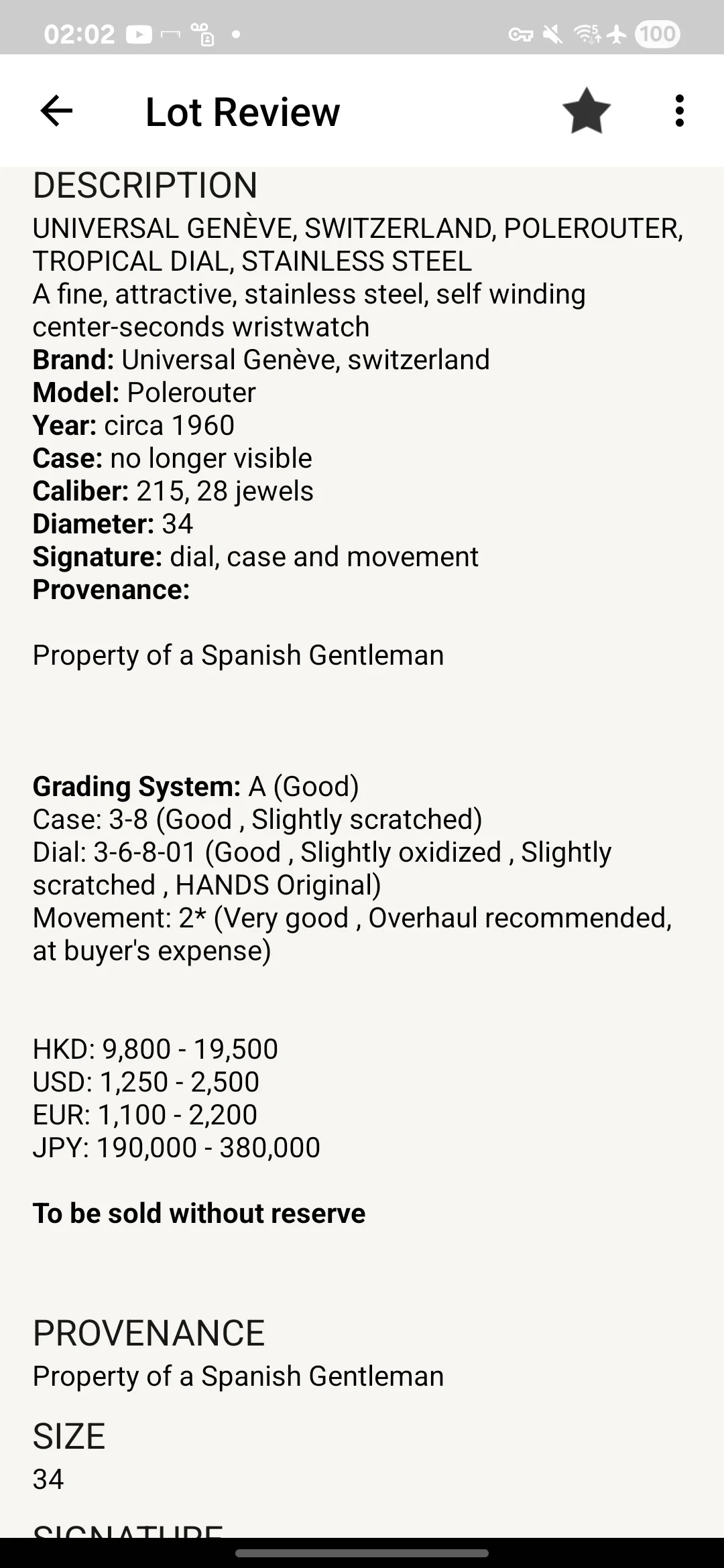

To add, here's the auction house's description:

The title of your post seems a bit unfair to me.
The hands do look to have been relumed but otherwise I can't see anything wrong with it.
I would recommend looking at the galleries on the Polerouter reference website
https://universalgenevepolerouter.com
Or even better, buy a copy of the Polerouter book 😀
https://www.thepolerouter.com

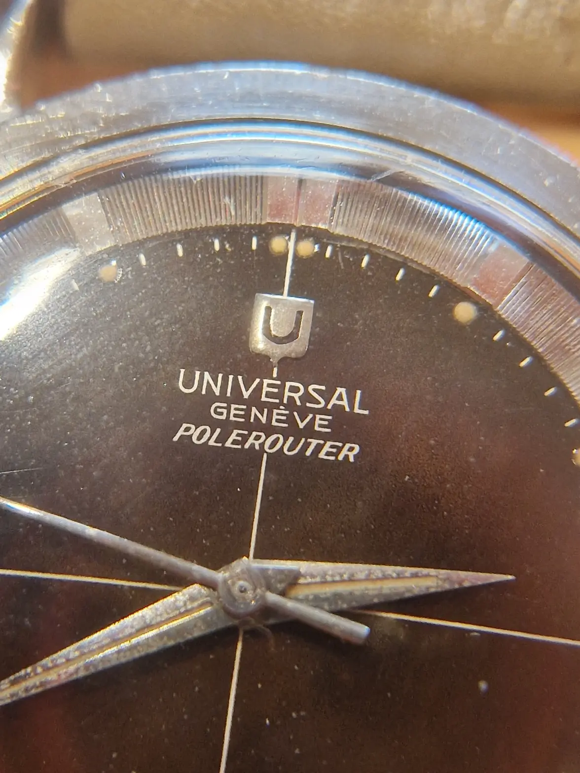

But my Franken-hypothsis is based on this:
And this particular photo:
Nothing wrong with that?
1,202
3,050
Not to my eye.

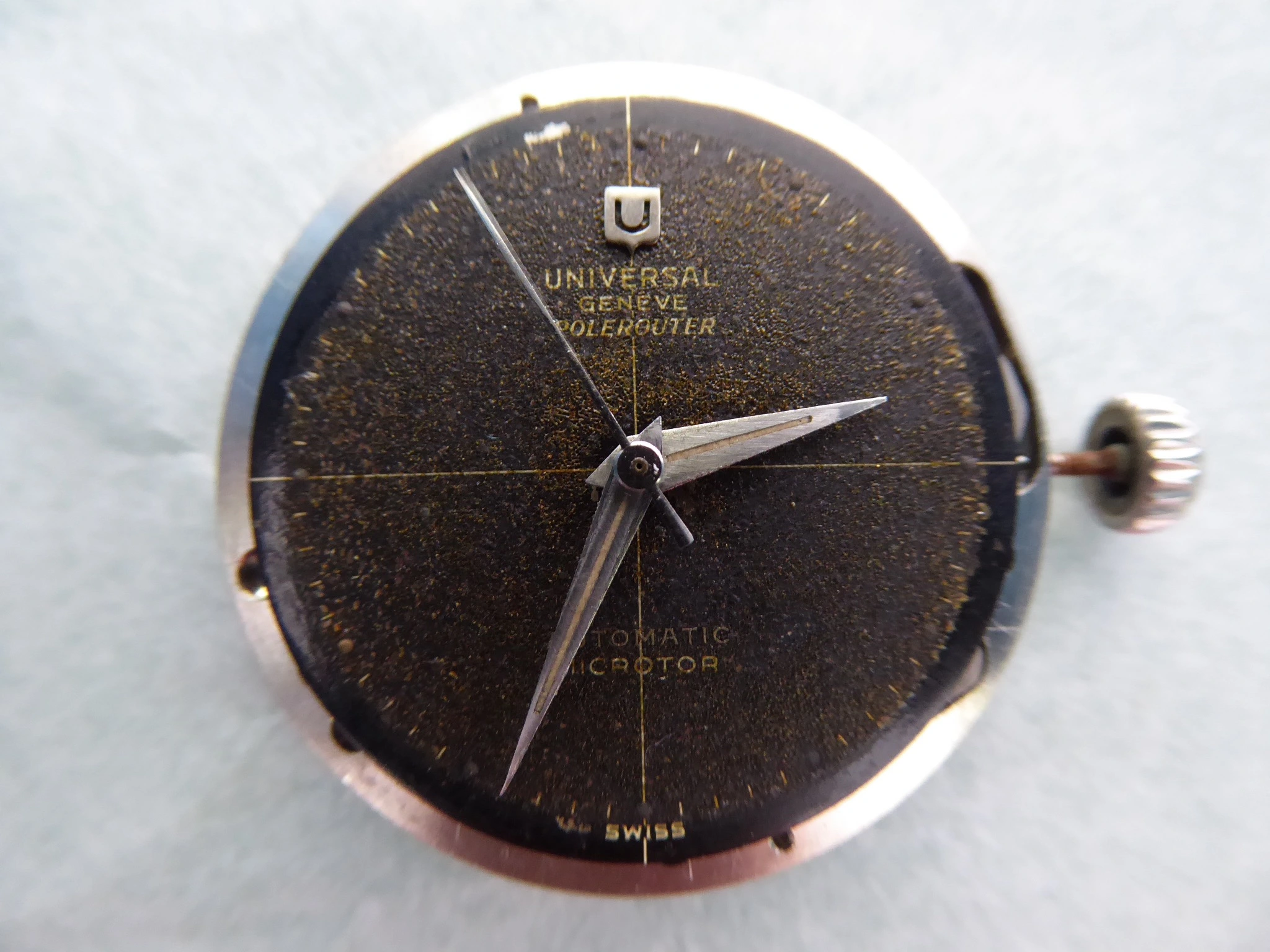

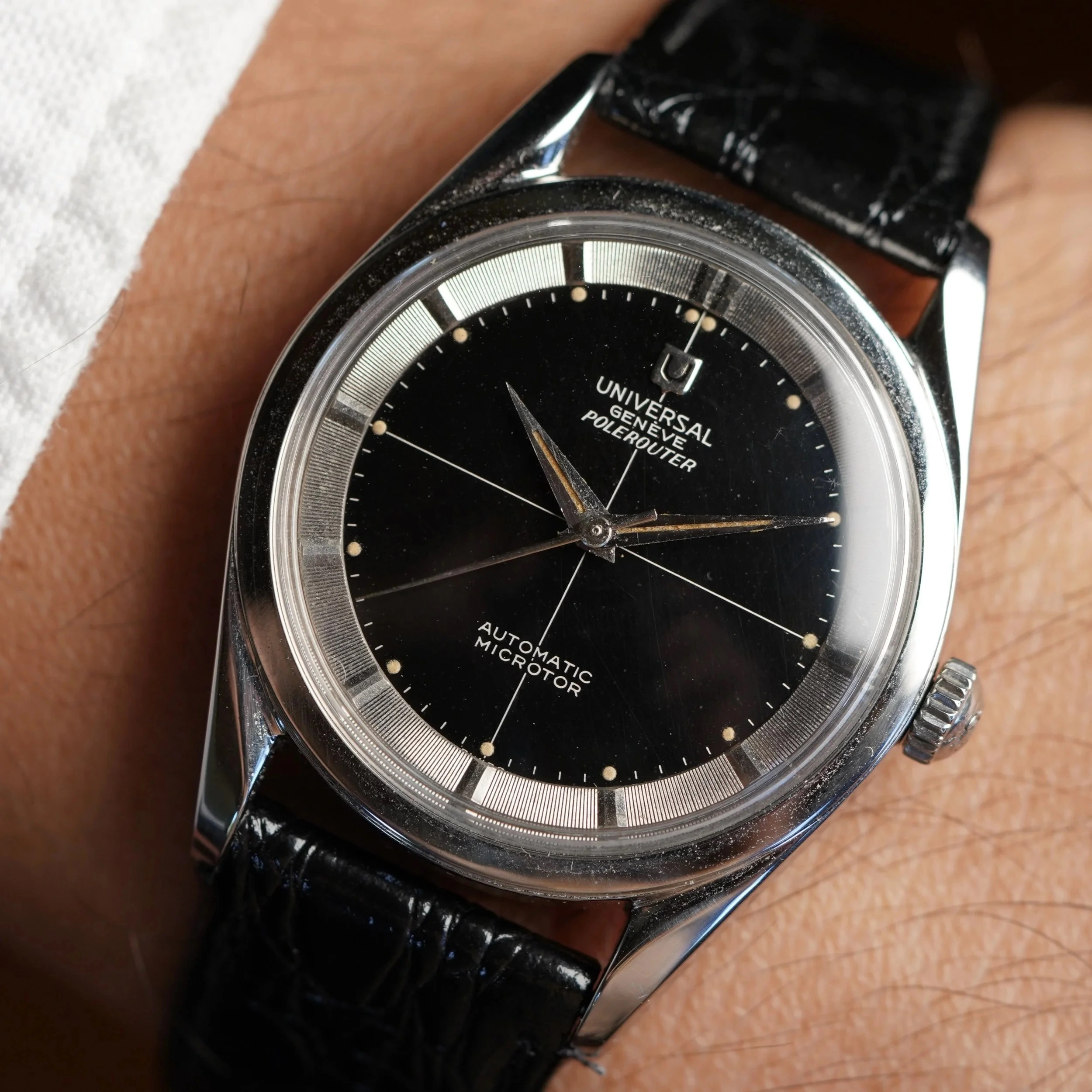

It looks like a 20357/1 reference. An internet search should show other similar dials with partially obscured 'Swiss' text. I've included an example below.
https://www.windvintage.com/universal-genve-polerouter-black-dial-20357-1
Obviously the angle at which the photo is taken impacts how much of the text you can see. I suspect there is also some variation as to exactly where the dial sits relative to the marker ring. As far as I am aware, the text is present on all dials, it's just that in some cases it is completely obscured by the ring.
I have included a link to a service record below for what appears to the same reference (not my watch). You can see that the text is obscured by the ring but that actually it is present on the dial.
https://watchguy.co.uk/cgi-bin/library?action=show_photos&wat_id=2474
I have no connection with either the auction house or the seller.

Thank you VERY much for your elaborate response ! I really appreciate it.
Very interesting.
I also just checked with the auction house who were so kind to put the watch on a Geiger counter and it gives a strong reaction. So radium dial - as it should.
I stand corrected and I'll try to adjust the topic title.

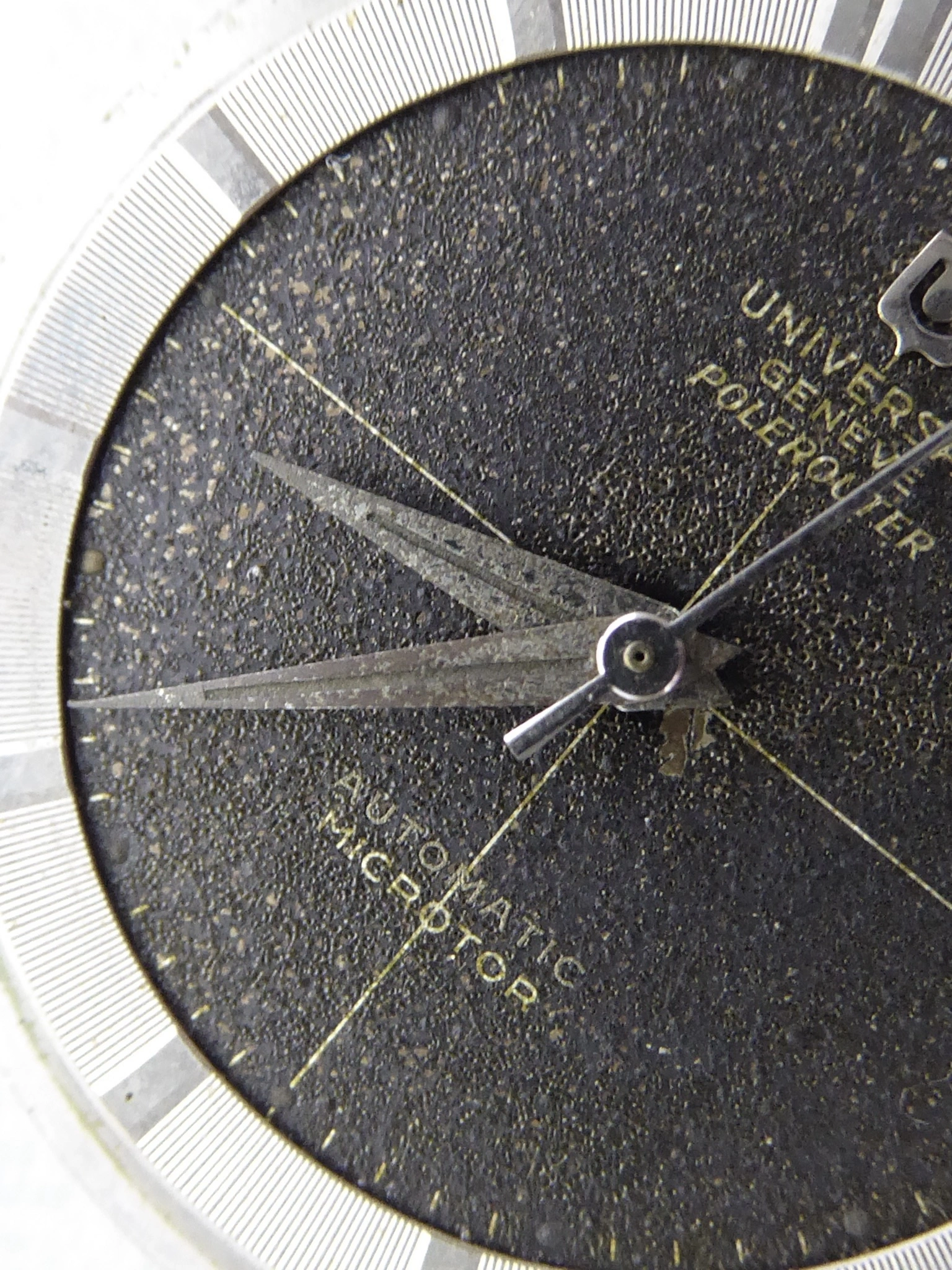

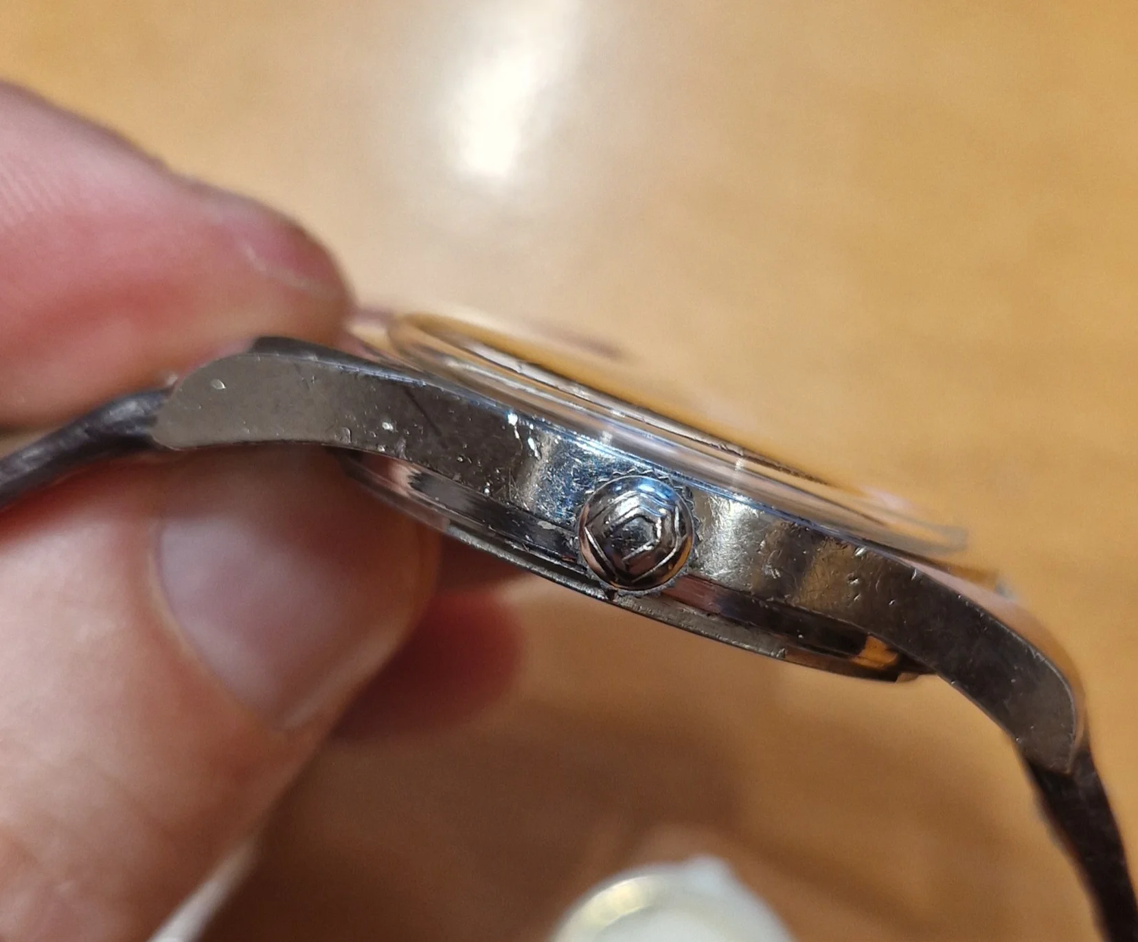

Interesting, I bought this watch from Wind Vintage. The watch reference is not on the caseback. I believe it is on the case between the lugs.
