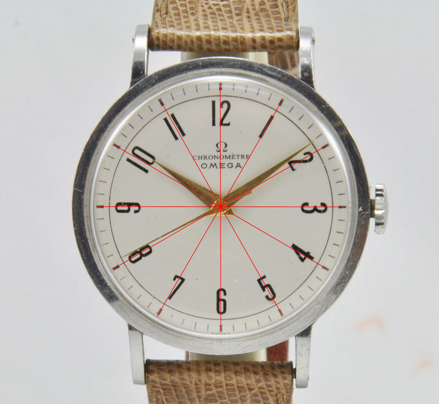

Here is this Ref. 2367 chronometer on which I passed because I was convinced that it had a re-done dial although the description said "original dial"

What do you experts think - have I been right with my assumption that it had a re-done dial?
Please let me know your thoughts.

I don't like the proportions of the Ω symbol.

Hope this might help
Lines were drawn from an hour marker to the
opposite hour marker without break. Not from the
center out to the marker. Lines seem to intersect with
center pinion perfectly. Omega symbol off center,
but could it be photgraphic distortion? I don't know.
Typeface nicely balanced between 11 and 1 radii

The font on the word "Chronometre" is a modern typeface. This is a rather recent redial. This dial is too white to be vintage. In the 1940's Omega used a natural lacquer that almost always yellows with age.
Sometimes, over-aggressive sellers will hide behind the fact that the dial metal is "original". Not a single serious collector would consider that to be correct.
They are trying to take advantage of noobies, and it sucks.

I think it is a redial too. But mac_omega (Erich) is one of the top authorities on manual wind omega chronometres so if he thinks it's a redial, that's good enough for me. 👍
