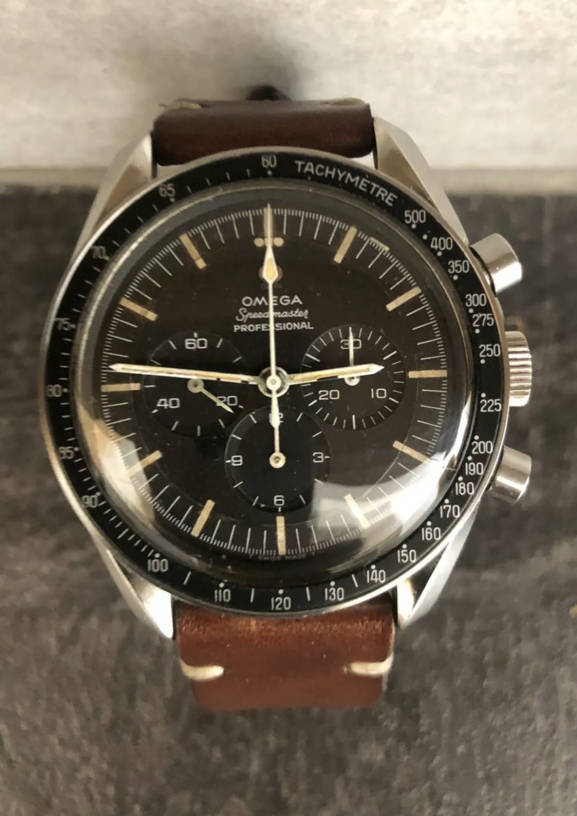

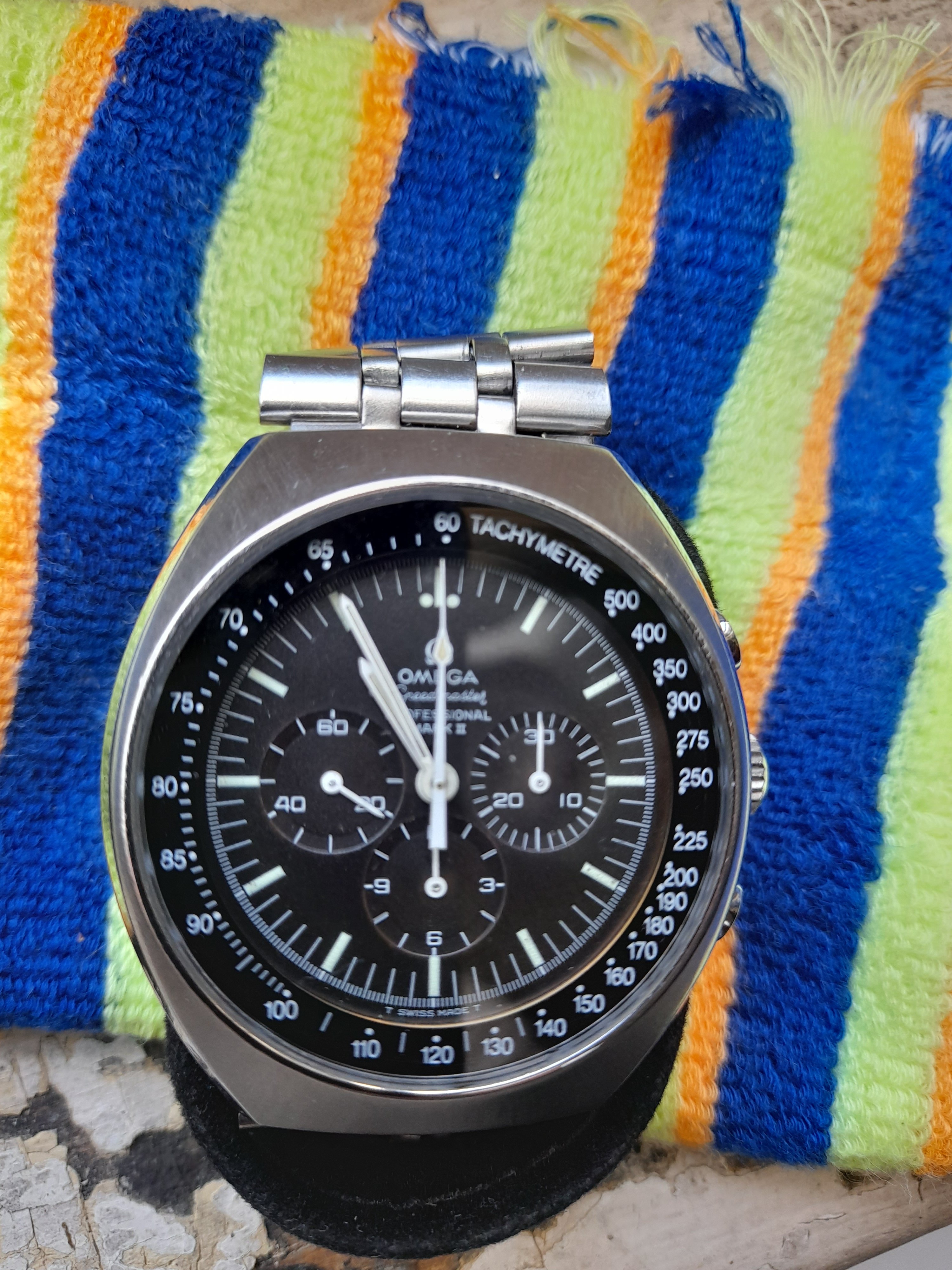

And now for something completely different.....
Comments on this one please legends. Circa 69. This is doing my head in!!

Hi @Speedking, the bezel on Mark II isn't the same as bezel on the original speedy, so not really a comparison.

.... but, but it has also numbers and dots and is on a kind of speedy

Yeah but, no but, yeah....more worried about the position of the 250 number and dot on the bez. Mint with papers.

The correct etiquette would be to create your own thread asking for advice. This is a thread about reproduction DON bezels, that becomes a resource for future collectors of Moonwatches. You are polluting it with non-related content. Thanks for understanding

Also, FYI, the "bezel" on the Mark II is actually a "sticker" on the underside of the crystal, if I'm not mistaken. I don't know that anyone has invested much time in exhaustive research on these references as they're fairly inexpensive compared to (most) vintage Speedies.

You are relatively new to the forum, so it’s all good 👍 As oddboy said, totally different ballgame. DON bezels alone are worth multiples of whole MkII Speedmasters (ie 2-5k just for a bezel). Hence the counterfeiting and value in this particular thread. MkII Speedmaster crystals have the bezel stuck on underneath, and are worth maybe 250. It’s highly unlikely there will be fakes of these. I’m certain you will find creating a thread asking for help (and sharing first what you have found) will yield the result you are after. Thats how I first entered the forum. It works, I promise!

I'm fairly sure there are aftermarket crystals for the MKii Speedmaster as indeed there are for the Moonwatch too. Early MKiis had a slightly different bezel printing to later models, but I've never noticed any premium or interest.

there are variations on the MKII crystal with applied bezel, but you could buy 2 or 3 complete MKII's for the price of a "Good" DON bezel, so generally, I don't think the fakers would invest much in MKII crystals at this point.
