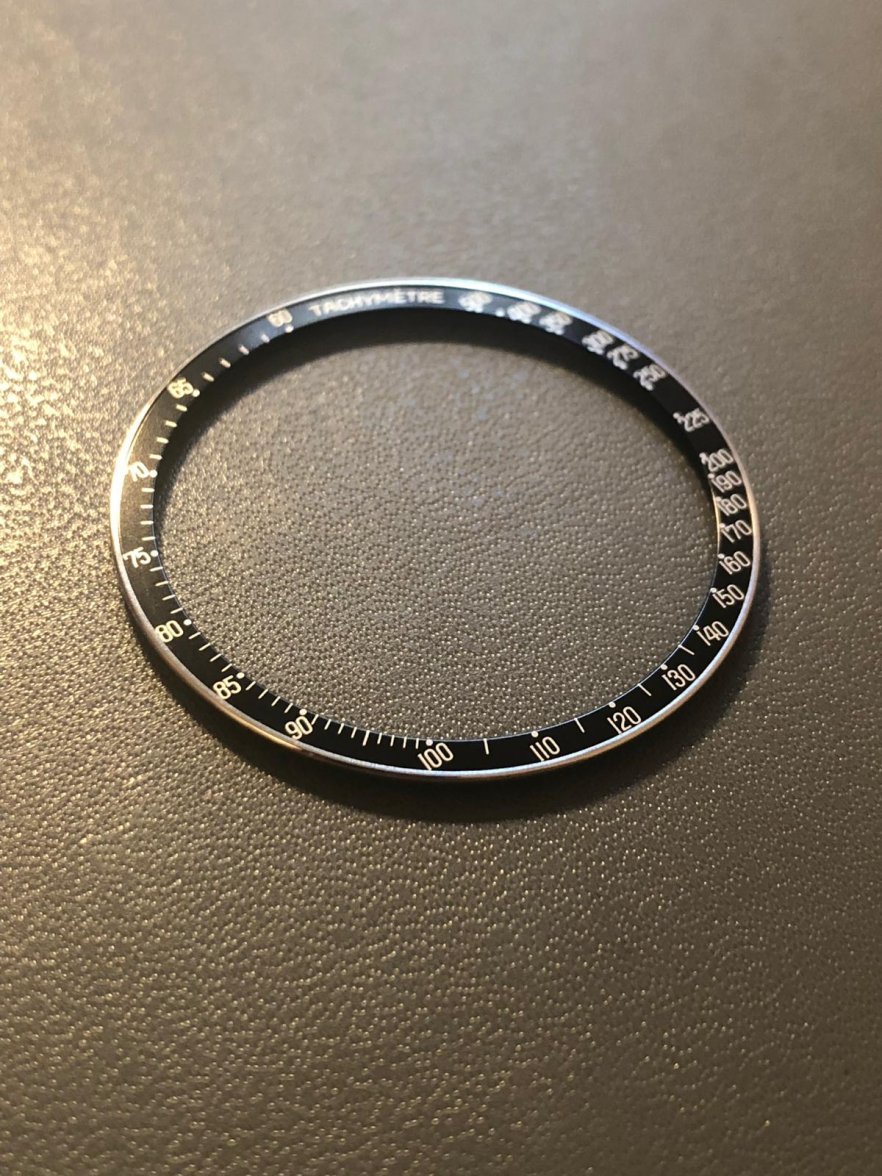

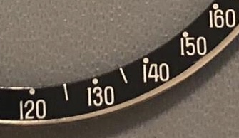

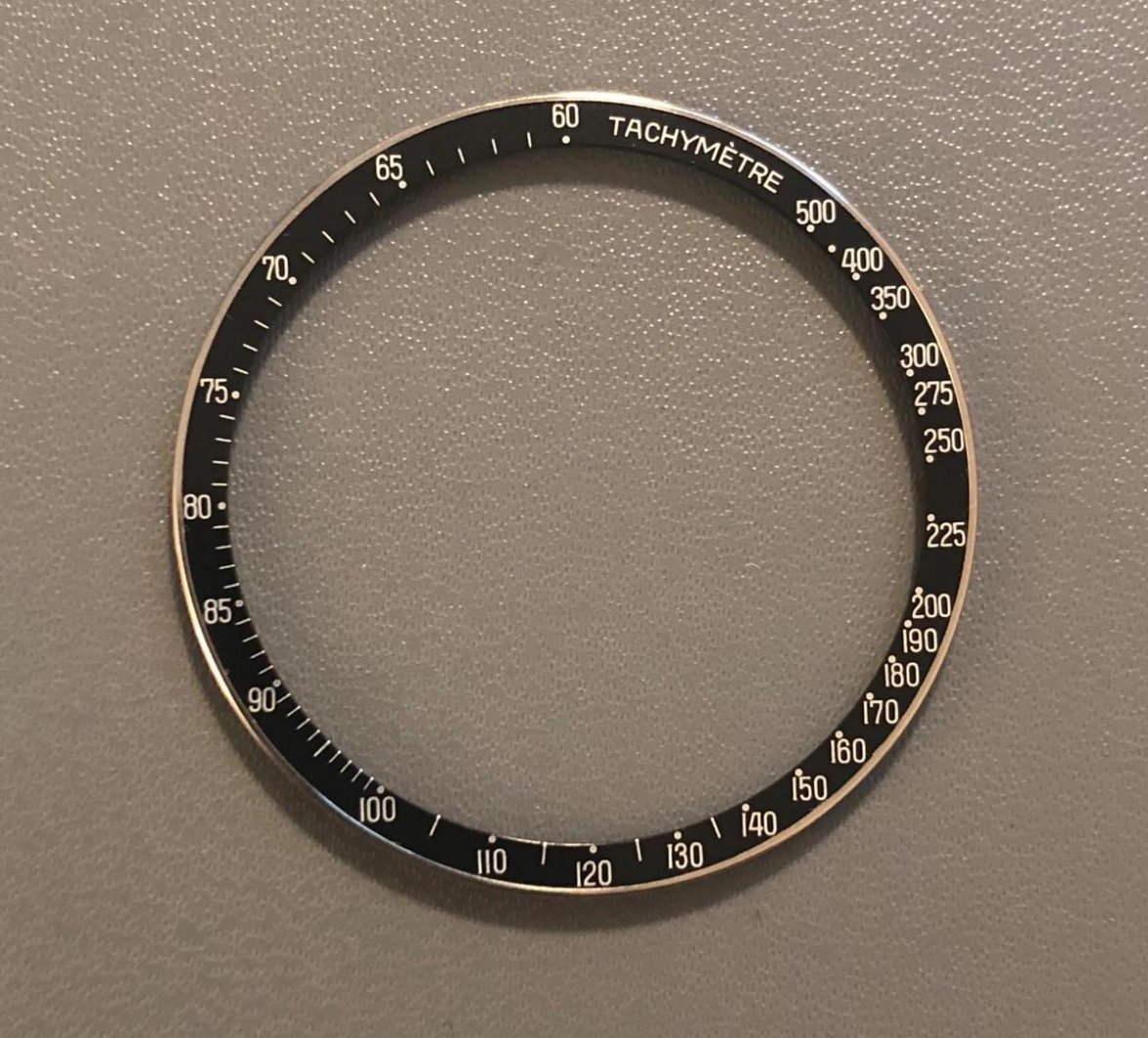

    Here is a DON bezel in perfect condition. I thought it was good until I saw the dot above the 1 of "140" It looks closer to the 1 than on every other example I've compared it to. Here it is:
    Trusted DON from Moonwatch Only:
    Is this the best reproduction we've seen yet?
    keepsonticking, kaplan, KLXN and 3 others like this.
  2. rcs914 Dec 5, 2018
    2,502
    3,593
    The "7" in 70 is goofy too.

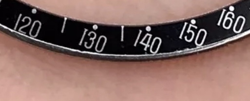

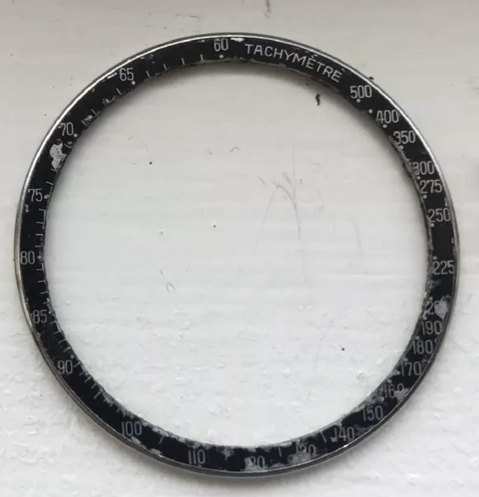

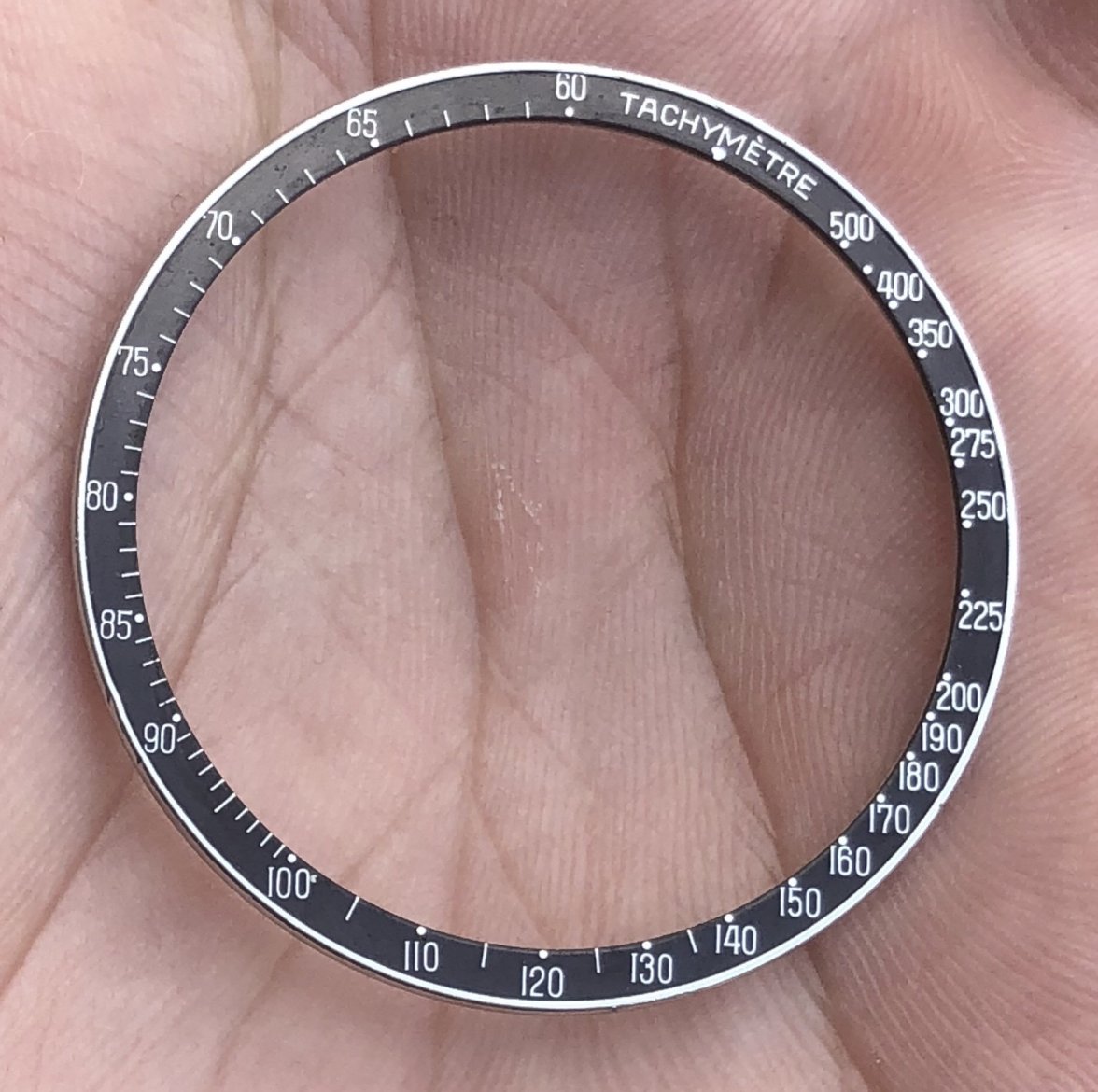

  3. airansun In the shuffling madness Dec 5, 2018
    2,520
    17,674
    Now you’ve done it.
    Here are some that have been through my hands, so we all can compare together.
    32018F9C-2BA0-40D2-8D59-D5CFC686BF2F.jpeg B828C70A-52A9-453E-8A21-70541602E765.jpeg 9845681F-C9A0-44C6-91E3-925AC6F79263.jpeg 5F9EDD1A-249F-451C-A55A-398A36F1DB7B.jpeg 3D668035-A5EE-4DCF-A9A4-B34B5A47A38C.jpeg
    I do see subtle differences that would make me question OP’s bezel, but @djmusicman : please post a higher resolution photo if you can.
    Edited Dec 5, 2018
    Jorisvp, queriver, Mad Dog and 2 others like this.
  4. djmusicman Dec 5, 2018
    634
    1,397
    It's not mine, it was listed for sale by a dealer called Horare in Paris here is the only other photo in his advert.
    Edited Oct 19, 2019
  5. rcs914 Dec 5, 2018
    2,502
    3,593
    Now we need to make sure that we are getting DONDOF bezels
    Mad Dog and djmusicman like this.

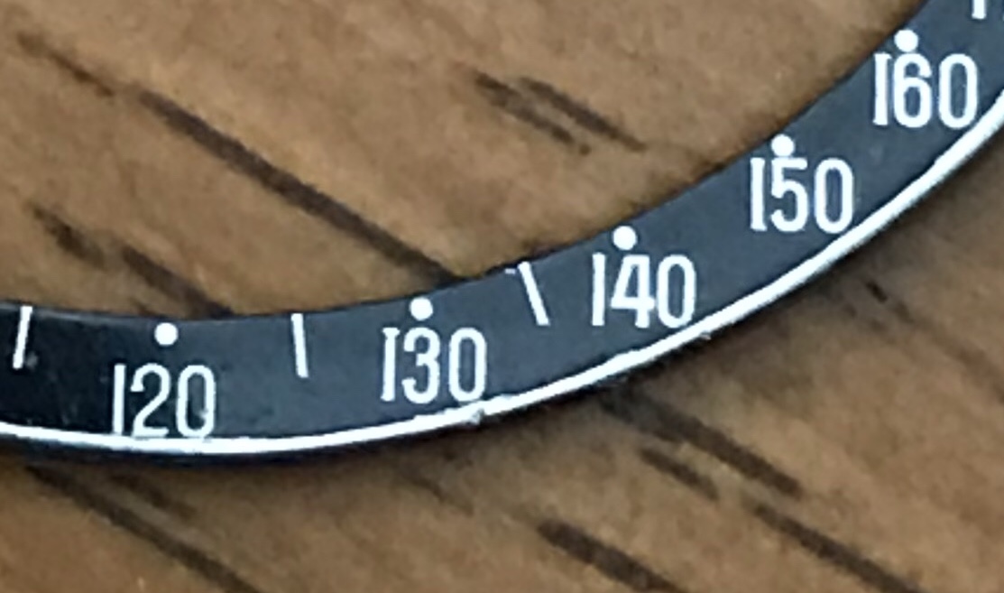

  6. airansun In the shuffling madness Dec 5, 2018
    2,520
    17,674
    Take a look at the shades of these numbers
    D211E2C6-4AE2-4E1F-9A9A-3A1D43334322.jpeg A668F269-E8A3-4998-AA23-10009E325768.jpeg AA2E3C86-FF1C-49EA-BDFB-995771BEB574.jpeg 8A63A536-69F4-4F34-A423-5732F522E511.jpeg
    And then, yours:
    It’s a damn good reproduction, if it is one.
    Edited Dec 5, 2018
  7. gdupree Dec 5, 2018
    902
    1,560
    Damn... I don't know. Interested in what others have to say about this. So many details look right, but there are several very confusing things about it. 4000 euros seems pretty steep even if it is legit, though... but I guess perfection would be expected to come with a cost.
  8. queriver Dec 5, 2018
    1,300
    2,425
    If fake it is very good. The dot over 200 looks like it touches the top edge of the 2 unlike the other examples shown. How disheartening that doing the right thing by alerting honest people about a potential fake has the side effect of helping the fakers. :mad:
  9. djmusicman Dec 5, 2018
    634
    1,397
    Maybe but all a faker has to do is to copy the original precisely, that's still the case. The dots are slightly misaligned between 200 and 130, it's easiest to spot on the 150 and 140.
  10. Caliber561 Dec 5, 2018
    1,474
    2,512
    Every single picture of a DON which has seen some wear and tear has the dot over the 4 for the 140 mark.
    I'm convinced that it's a fake.
  11. watchyouwant ΩF Clairvoyant Dec 5, 2018
    5,157
    8,675
    They have been around for nearly a year now. the only problem in outing them on a public Forum is the chance, that the next batch will have these quirks fixed. we are approaching high value territory and it looks like we go the Rolex way in getting high grade reproductions . these are easy to design and print. take care out there ! kind regards. achim
    PerJ, Spacefruit, kaplan and 12 others like this.
  12. wsfarrell Dec 5, 2018
    2,441
    4,133
    If these are easy to design and print, why aren't they perfect? I don't know a lot about bezel printing, but I assume one would start with a genuine bezel and take a high-resolution digital image of it. Things could change as one manipulated the photo to get it the right size and such, but we wouldn't see the dot over 4 in 140 migrate over to the 1.
    JwRosenthal, blubarb, marco and 3 others like this.

  15. rcs914 Dec 5, 2018
    2,502
    3,593
    Could be that they didn't use a perfect one to build from in the first place and instead had to do some manipulation before printing to clean it up. This could explain why some details are pretty much perfect and others aren't - if they had to recreate the dot over 140 because there was a ding on their original that could explain it.
    This may not be a popular opinion, but my biggest issue with this is what they are charging, not that it's being replicated. At this point it seems to be made to defraud, which is not ok. I don't really see a lot of difference with having an almost perfect aftermarket bezel insert like this available, and having a bakelite bezel getting the Aldo treatment. But also I am saying this from the perspective of not having any watches that a DON would go on and not having to consider how this could gut the market for original DON bezels - which for a lot of people is a not inconsiderable amount of value.
    JimJupiter, Cad290 and wsfarrell like this.

  20. BenBagbag Dec 5, 2018
    2,820
    8,983
    considering the guy literally only sells bezels in NOS condition, and the comments above about inconsistencies, I'd say it's pretty clearly a fake.
