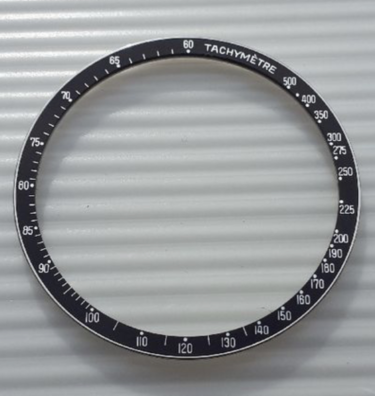

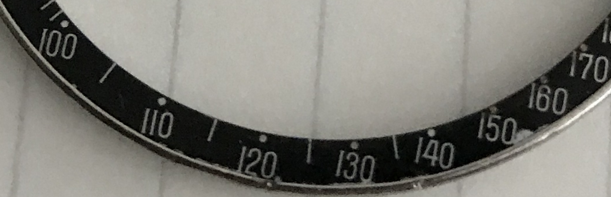

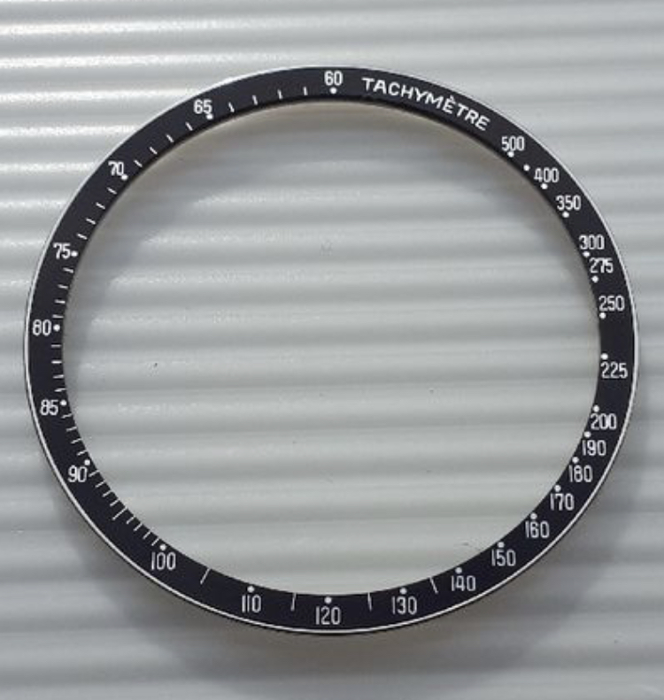

Reproduction DON bezel
6,732
80,350

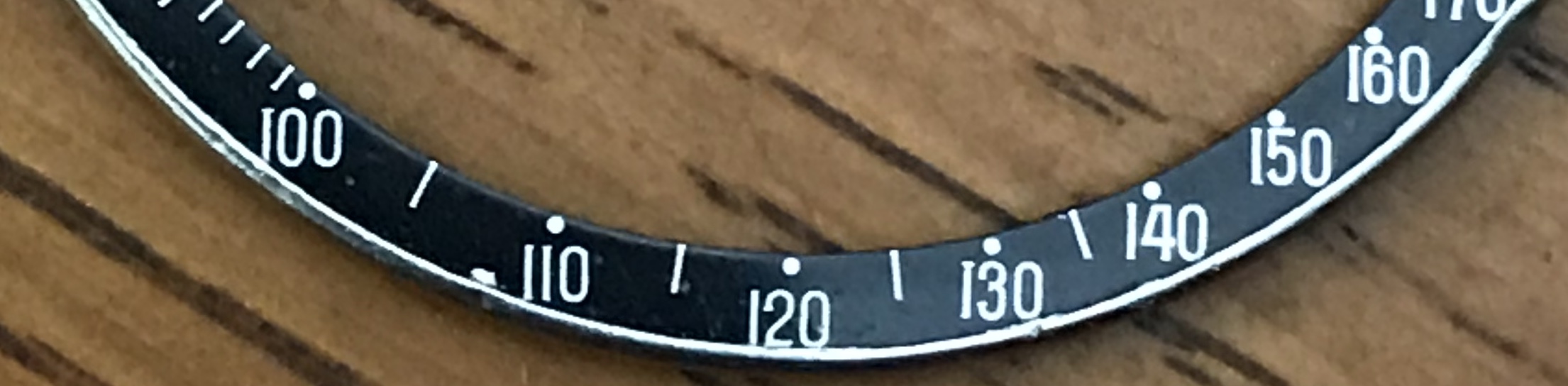

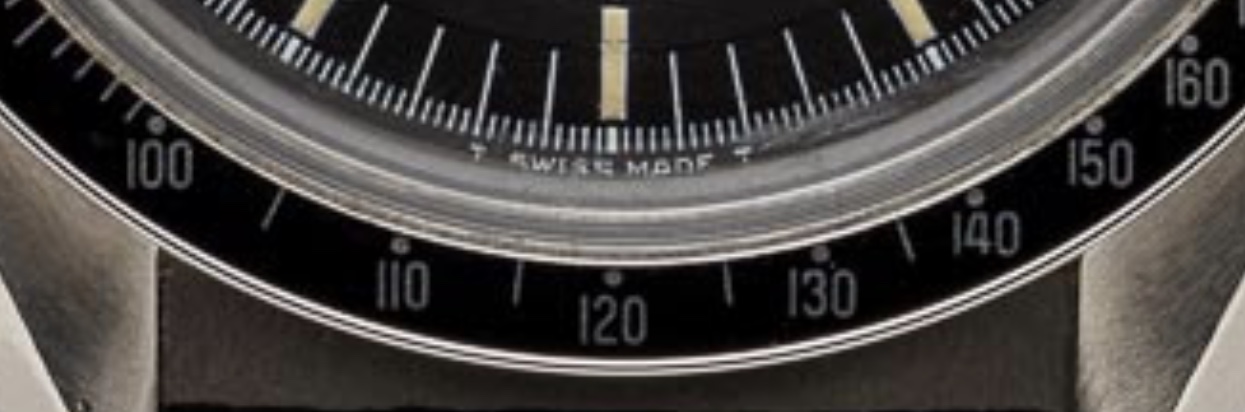

When the printing looks sketchy, I always look at the dots over 140 and 150 these days.
The bezel IS in mint condition BTW ... just totally fake.

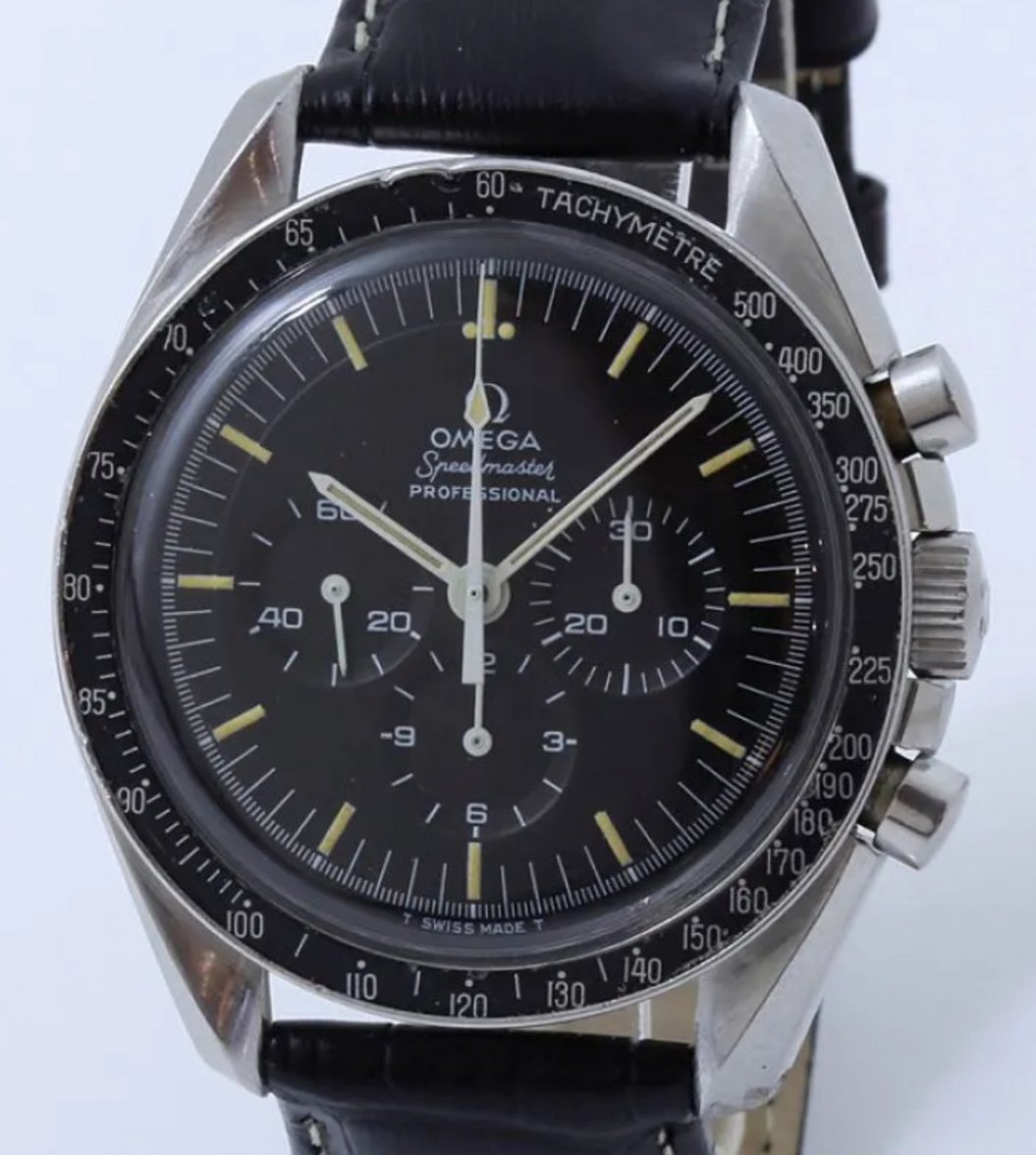

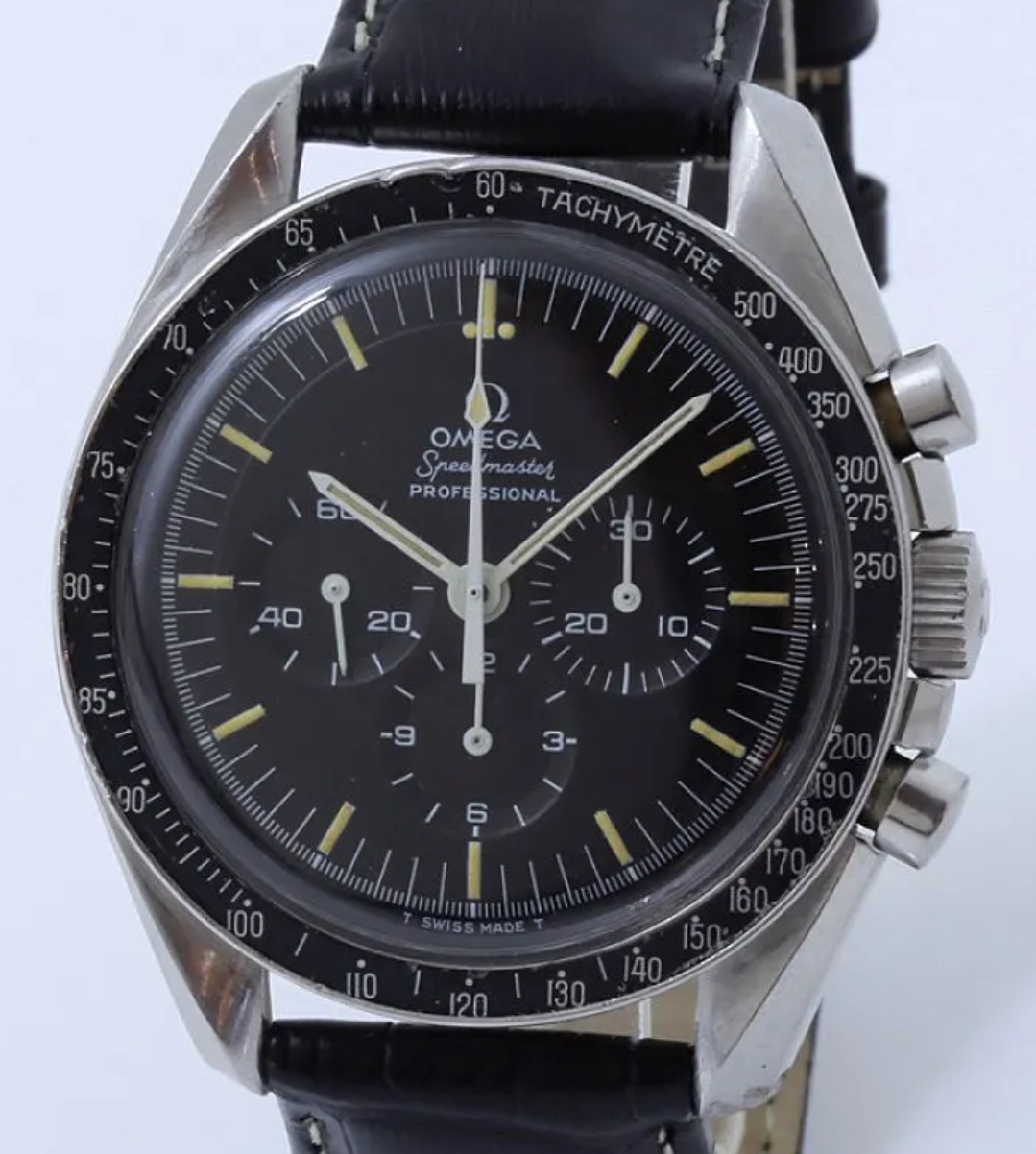

Here is another one...with fake wear...and bidders.
13,555
23,503
The 'aging' on that looks so unnatural as to be ridiculous

Late to the party.
The font jumped out at me right away.

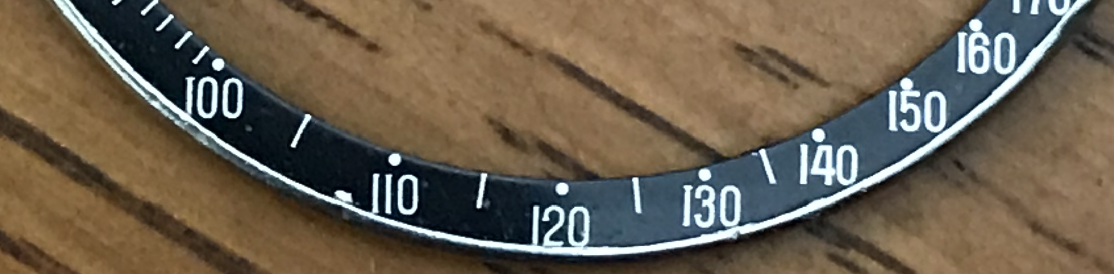

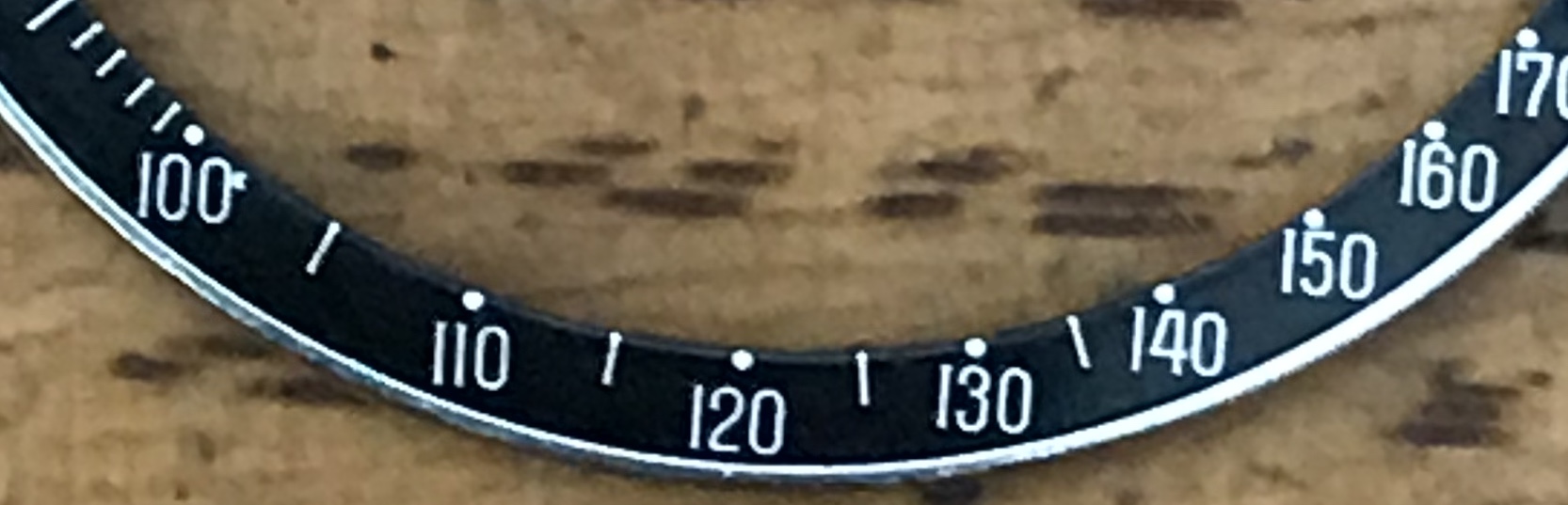

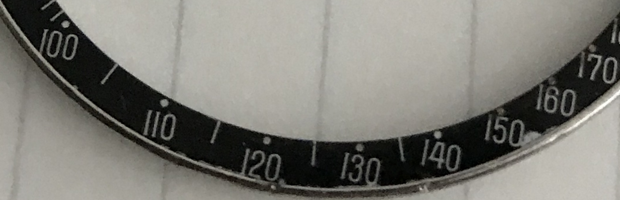

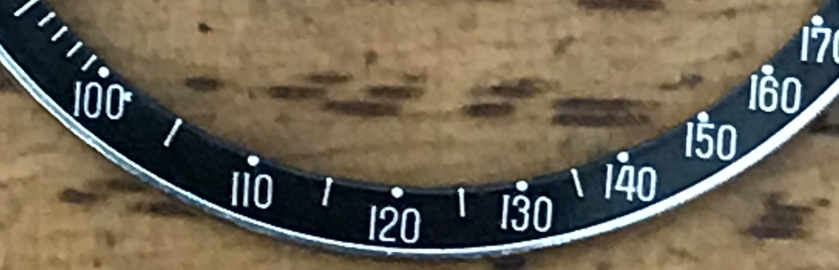

Here’s the comparison:
Top is the fake.
21
71

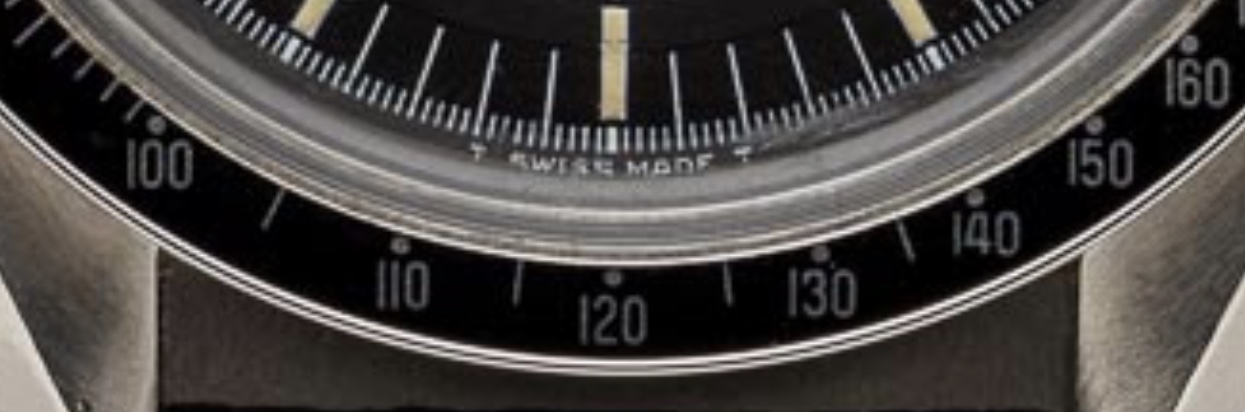

Font looks very odd to me (although the picture is poor).
What are your thoughts on it?
Not only the font. Look at the position of the dot above the 130. That is one of the most obvious tells.

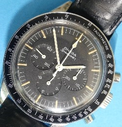

Hello,
The watch that i would like to buy, the bezel seems to be good.
Thoughts?
Thanks
