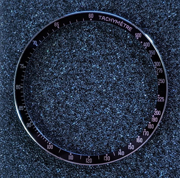

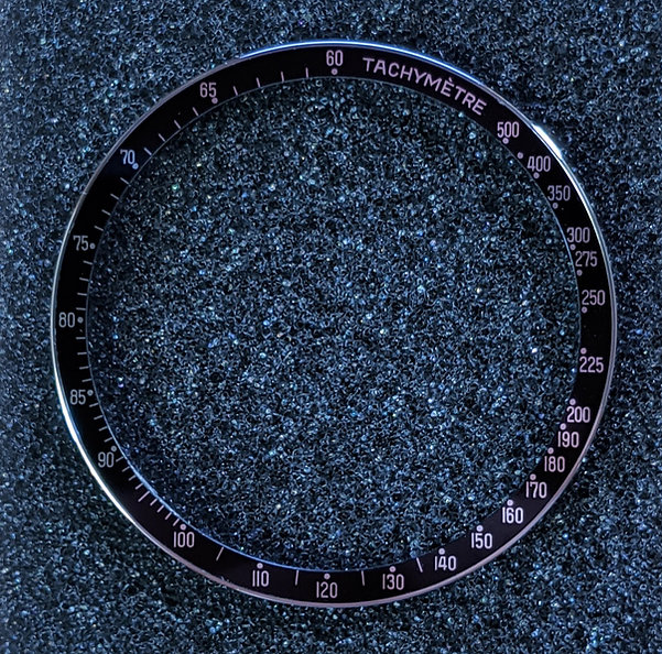

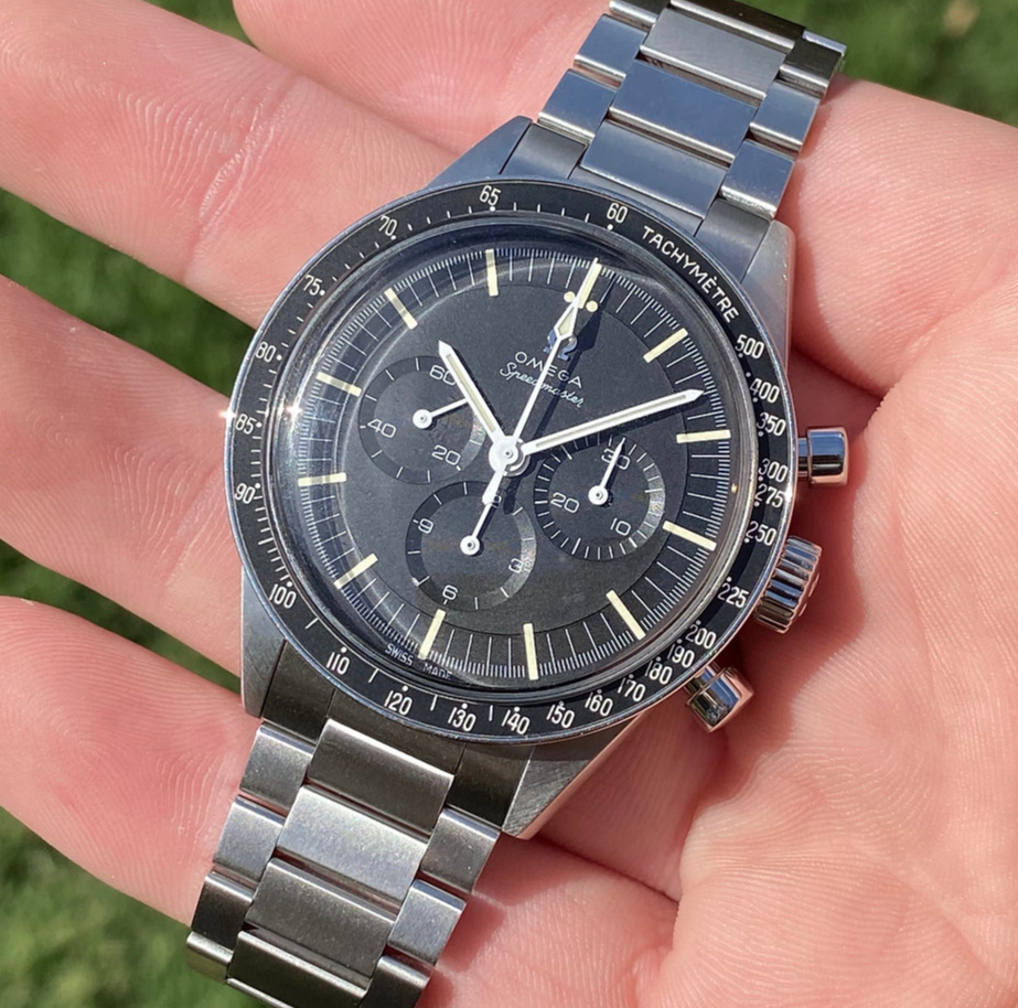

what is the opinion for this reproduction bezel?
agree this is a clear repro

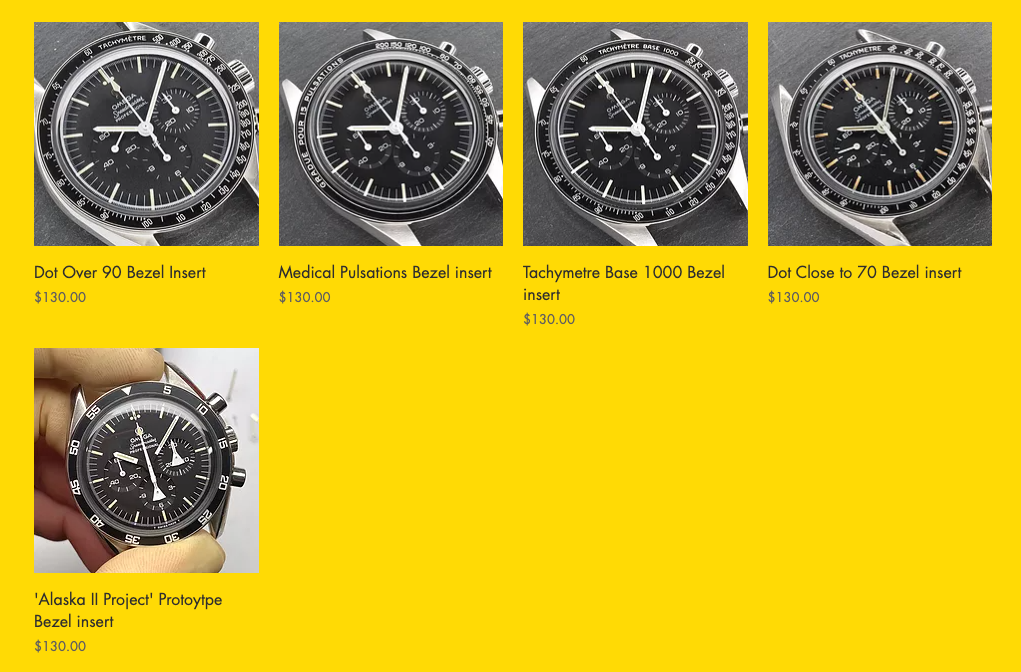

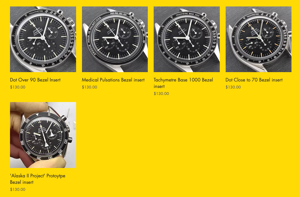

Would love to hear opinions on these. I doubt a perfect DON will sell for 5k anymore... Remember those days? 🥰

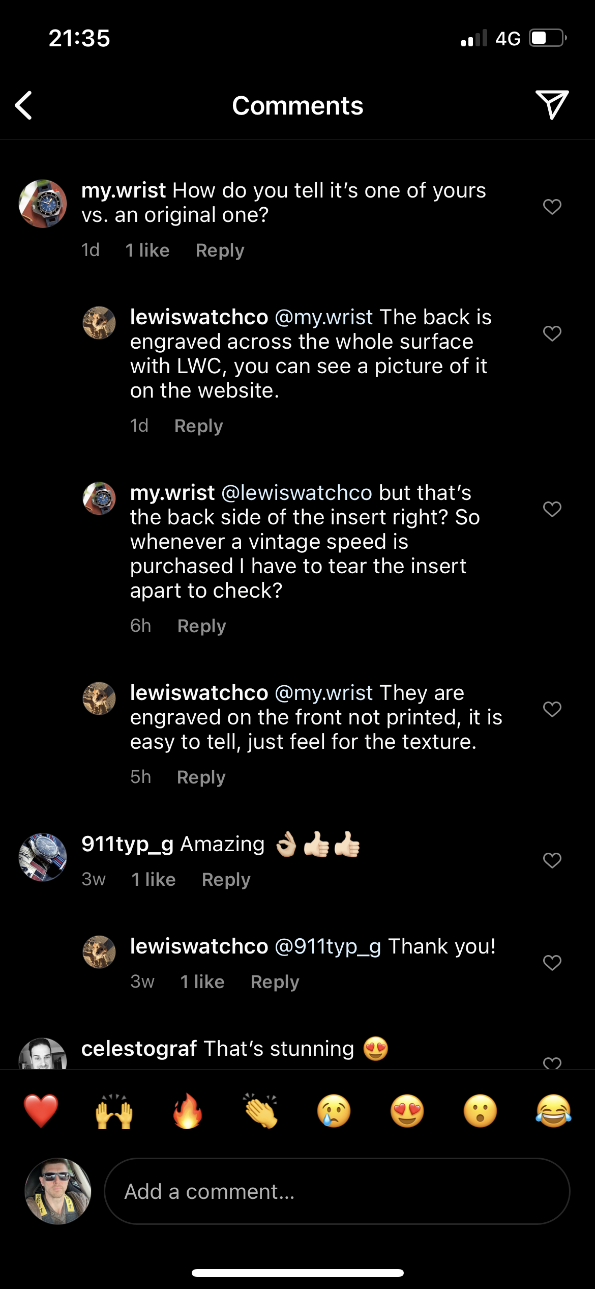

Pretty glad I got my 5k perfect DON for free now (switcherooed it a few years ago)..... But these Lewis watch co ones look good to me. A few people complained that I was pointing out the errors in the reprodutions and helping the counterfeiters, but some of those inserts set out to decieve people. Most looked like crap anyway.
This one (only looked at the DON so far) offers a good solution to people with damaged original inserts to improve the look of their vintage watches and is engraved LWC so won't be used to fool anyone. 6x the resitance of standard grade anodised alumimium, very cool 😀.
1,993
9,508
....and is engraved LWC so won't be used to fool anyone....
I like it in theory but its only on the back, what reseller will actually take it out of the bezel to check before listing it on ebay? I really wish they would do something subtle to ID from the front as well. Back in the 1980's when pocket watches were still going strong there was a guy making really good reproductions of early Montgomery Dials. He changed the color of one single minute marker dot from red to blue to make his product instantly recognizable from the original. That is integrity and watching out for the hobby as a whole, IMO.

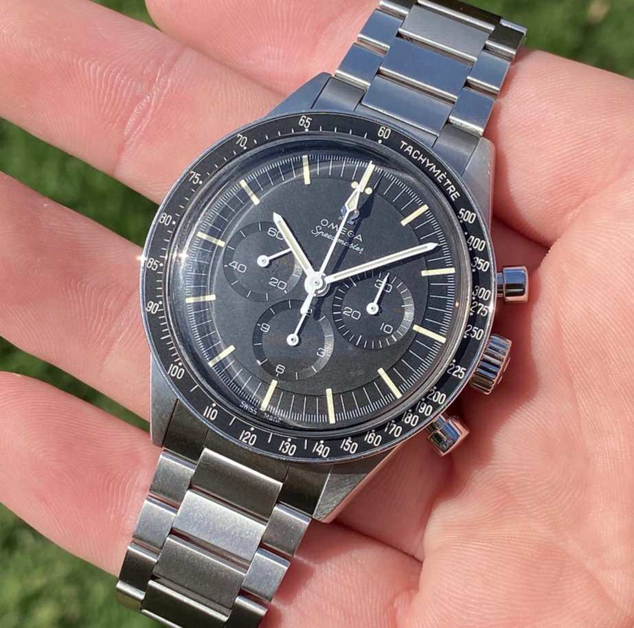

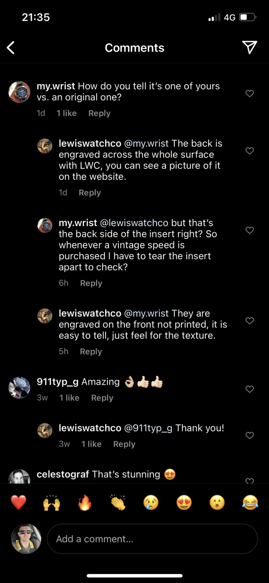

Found this reply on comments under Lewis’s Instagram post.

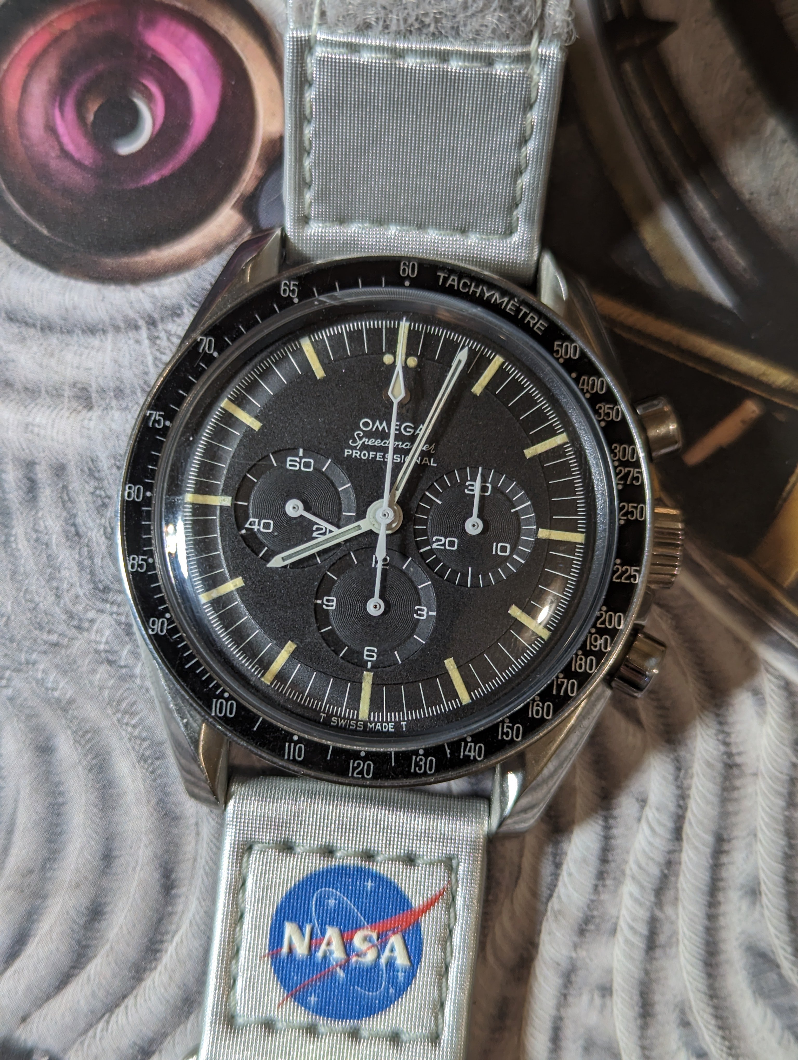

153
75
Every single picture of a DON which has seen some wear and tear has the dot over the 4 for the 140 mark.
I'm convinced that it's a fake.
Agree

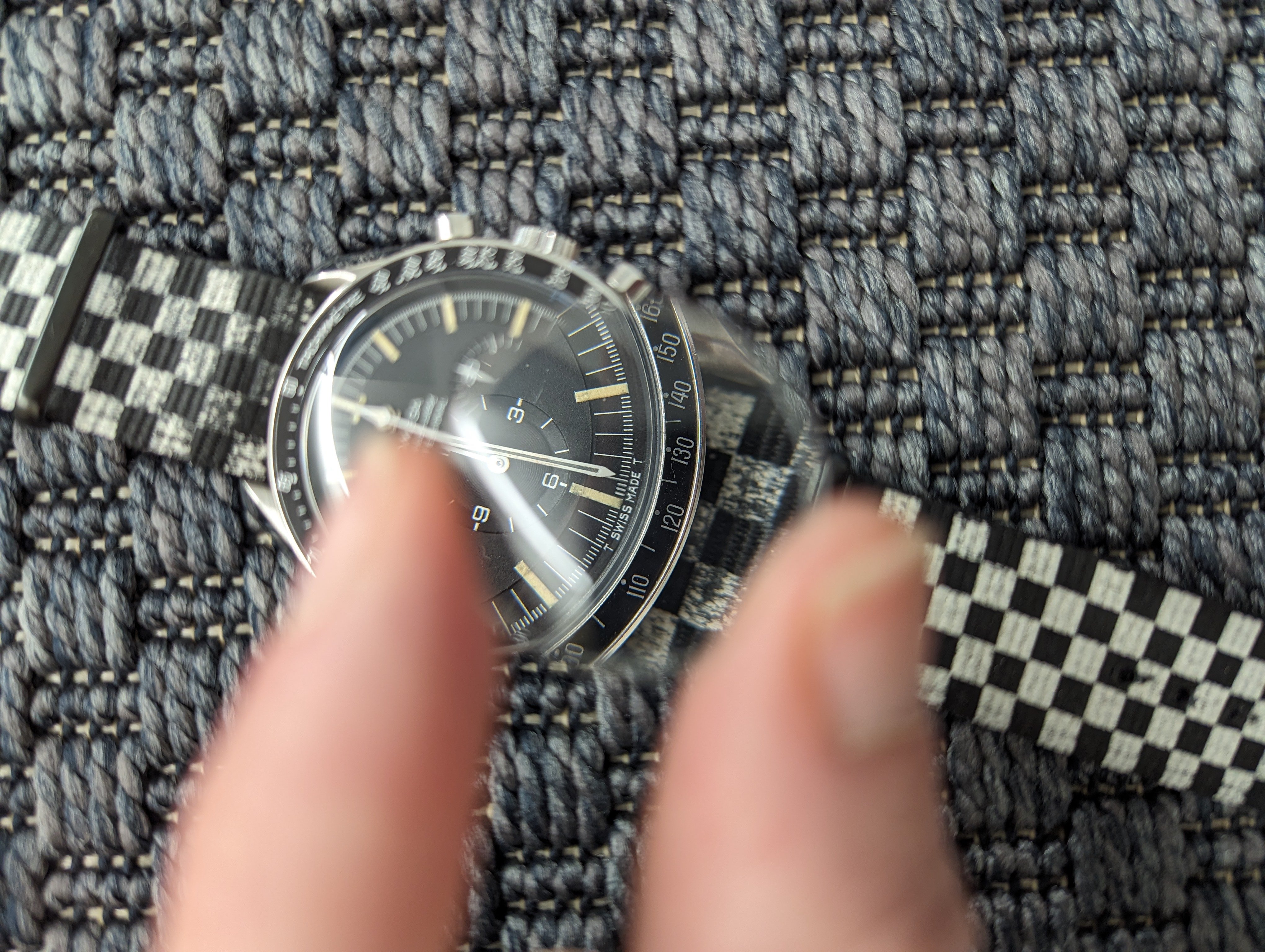

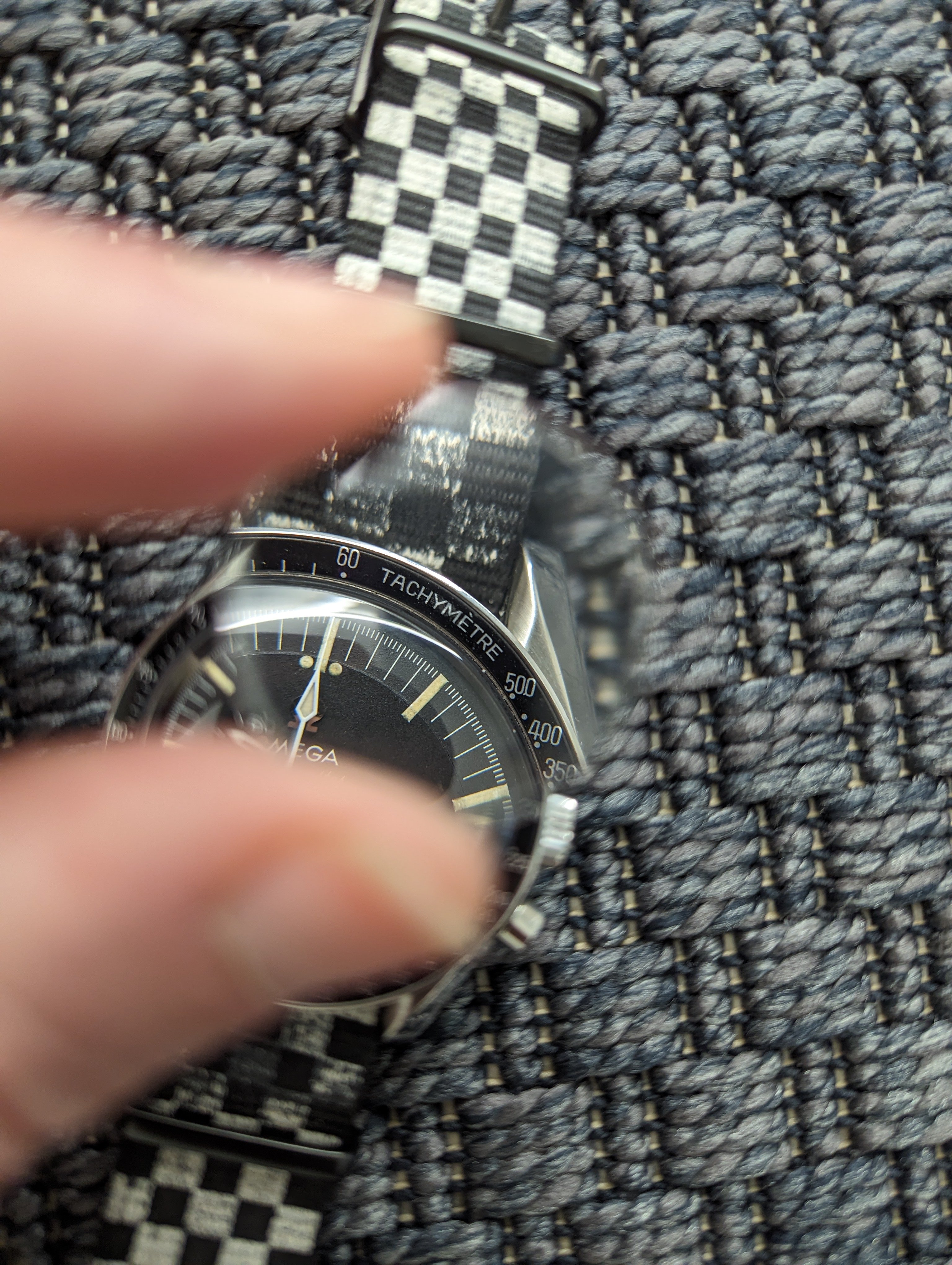

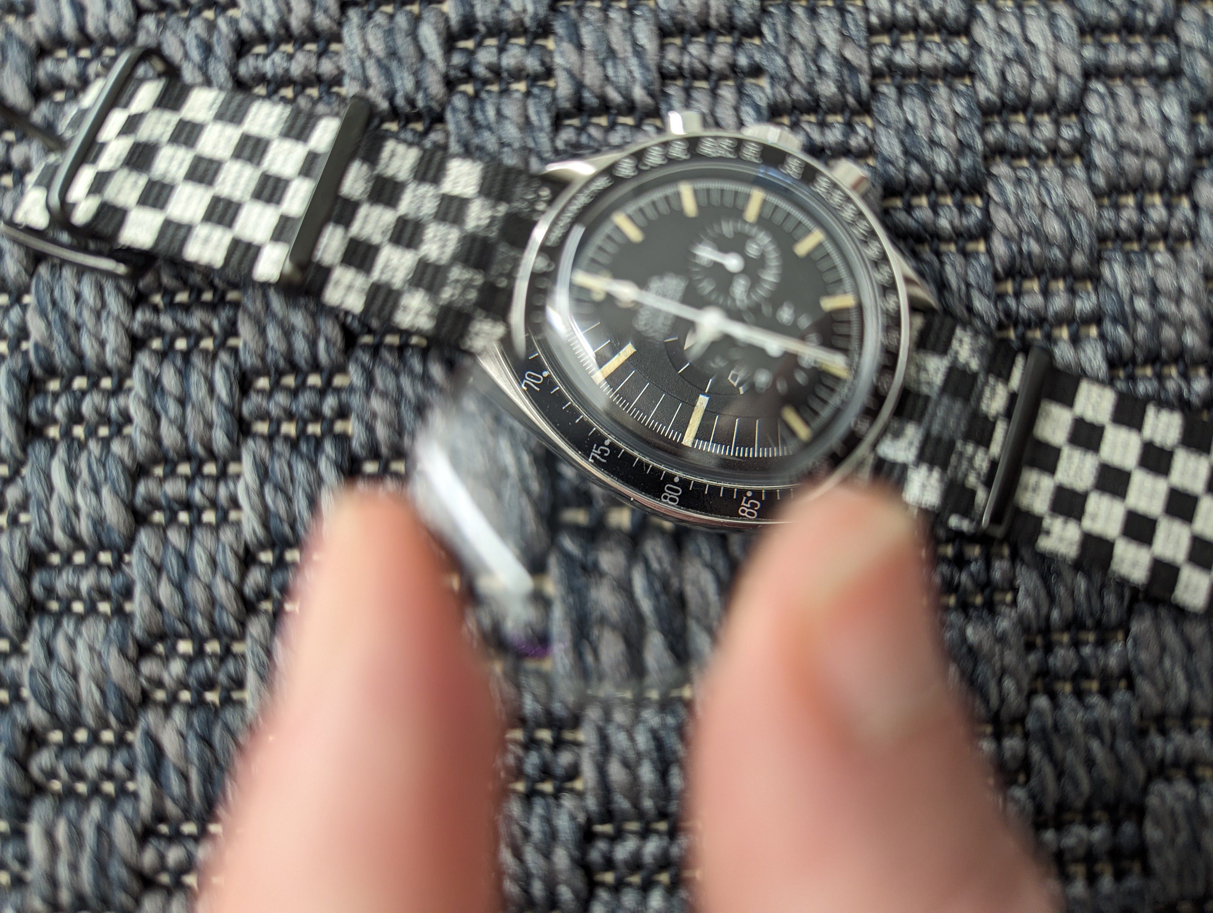

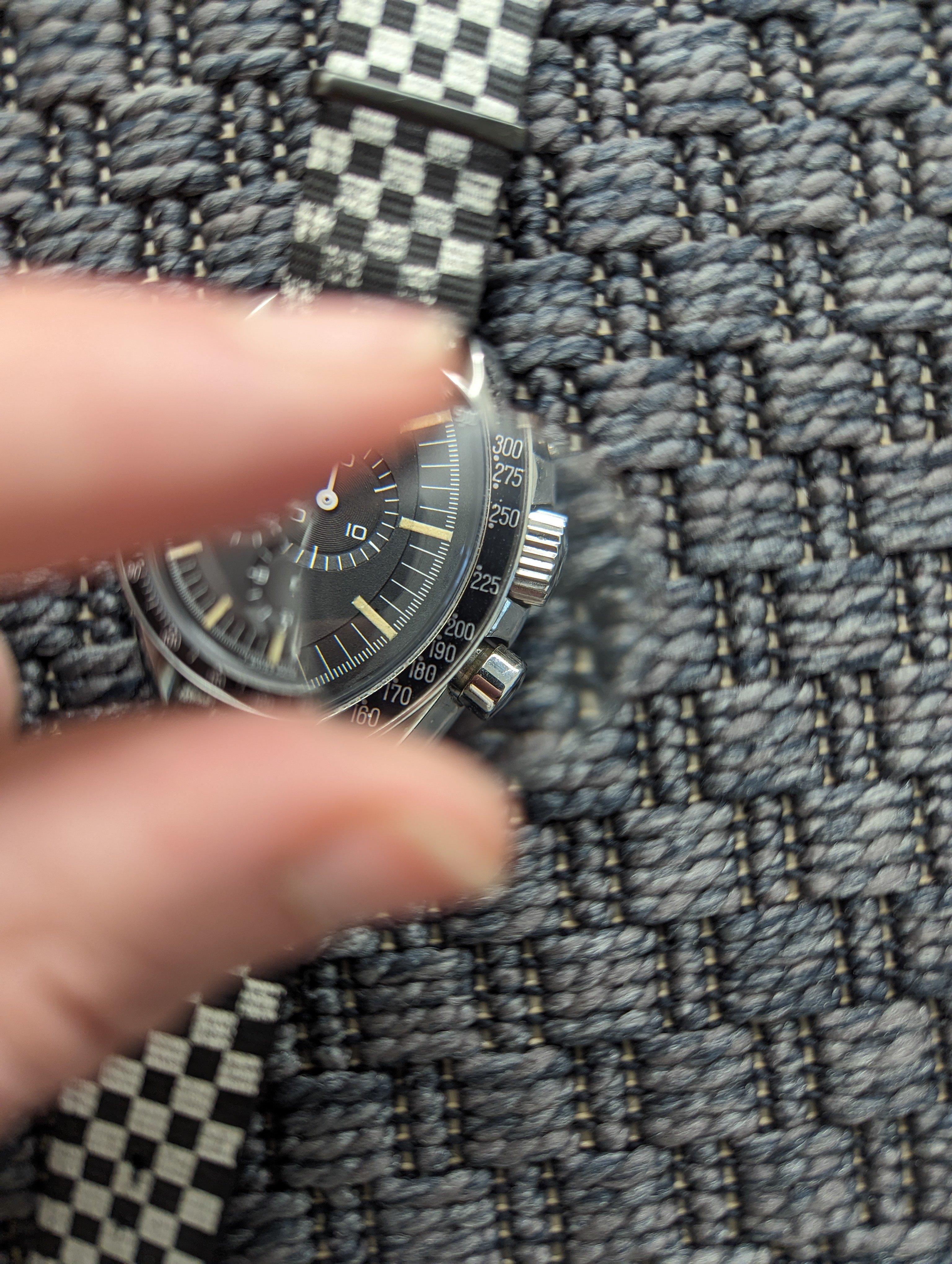

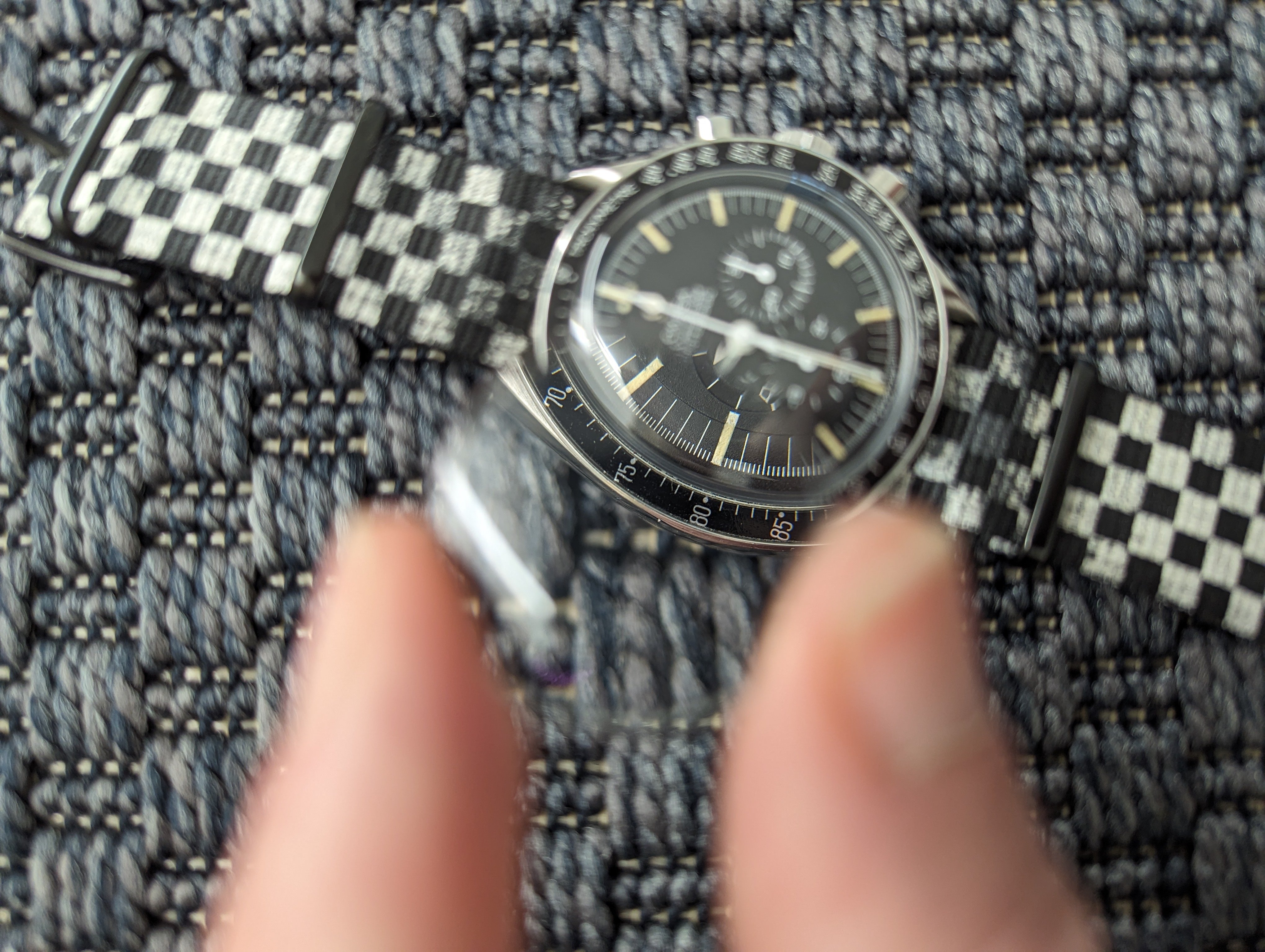

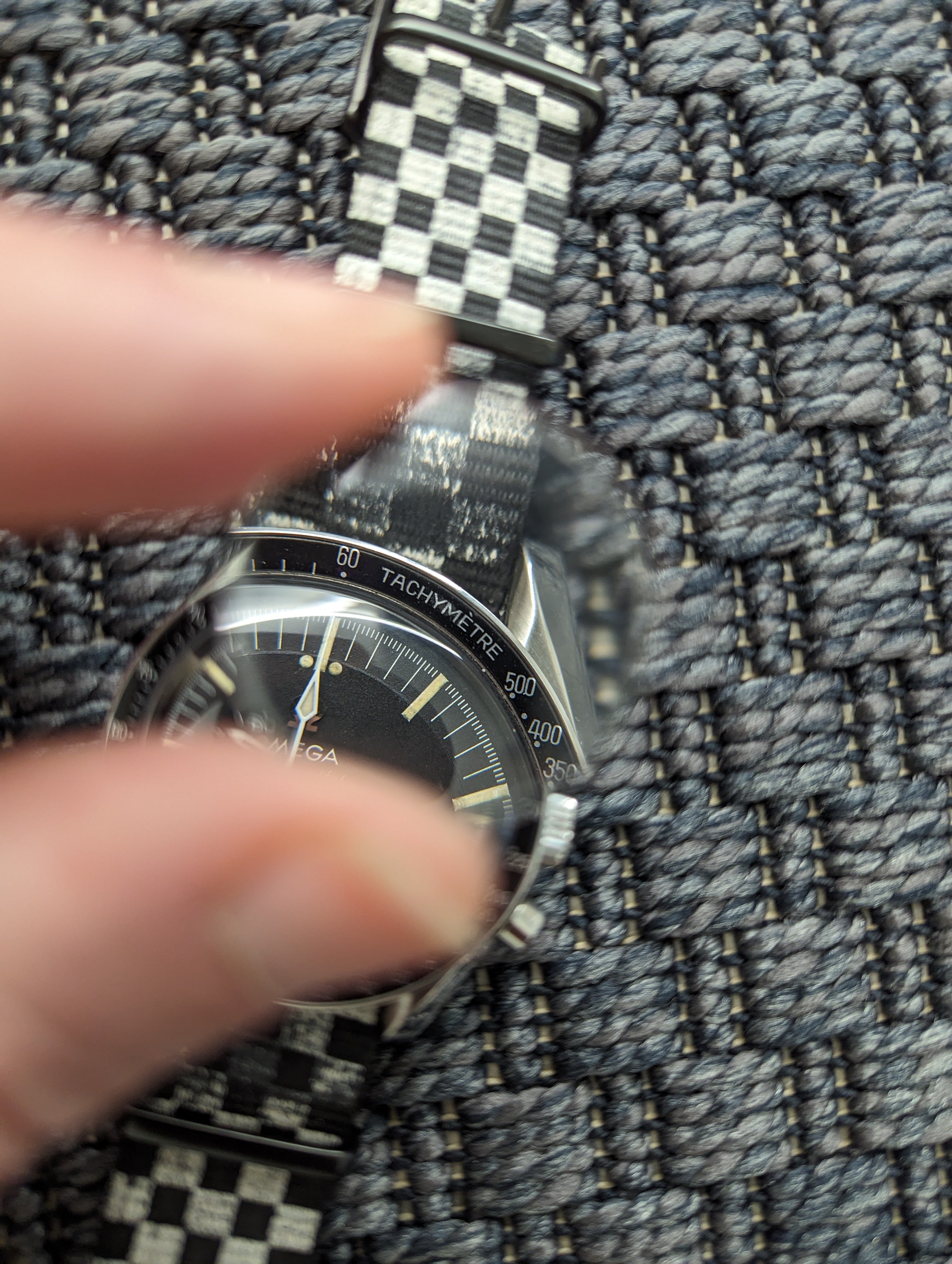

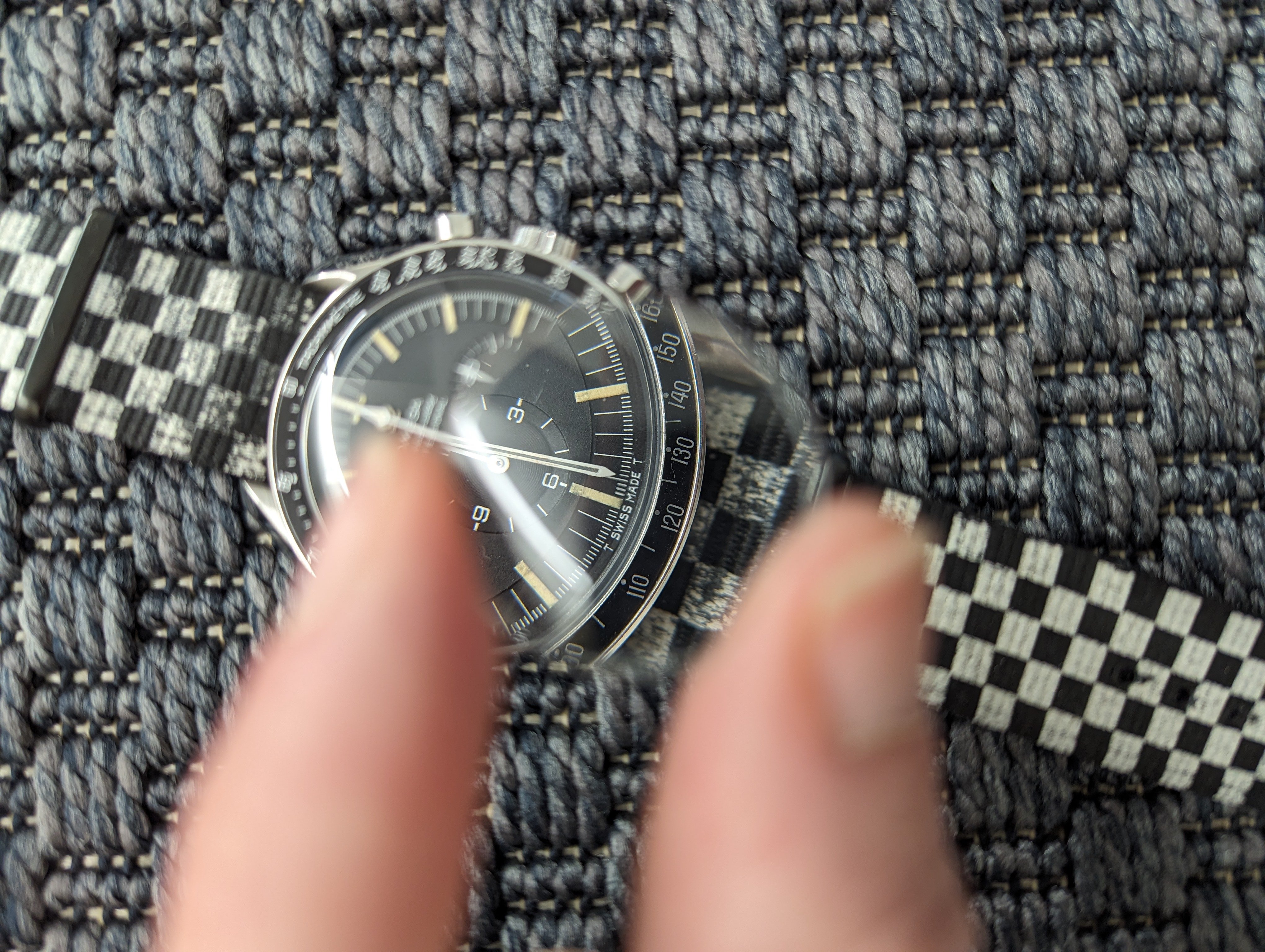

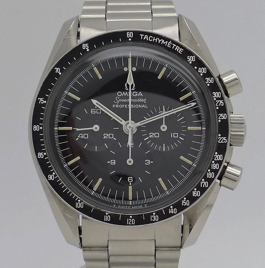

Hi all
I tried to get evidence if this is a genuine one... It still looks to good to me... but i did not find a tell yet... maybe you can help:
316
278

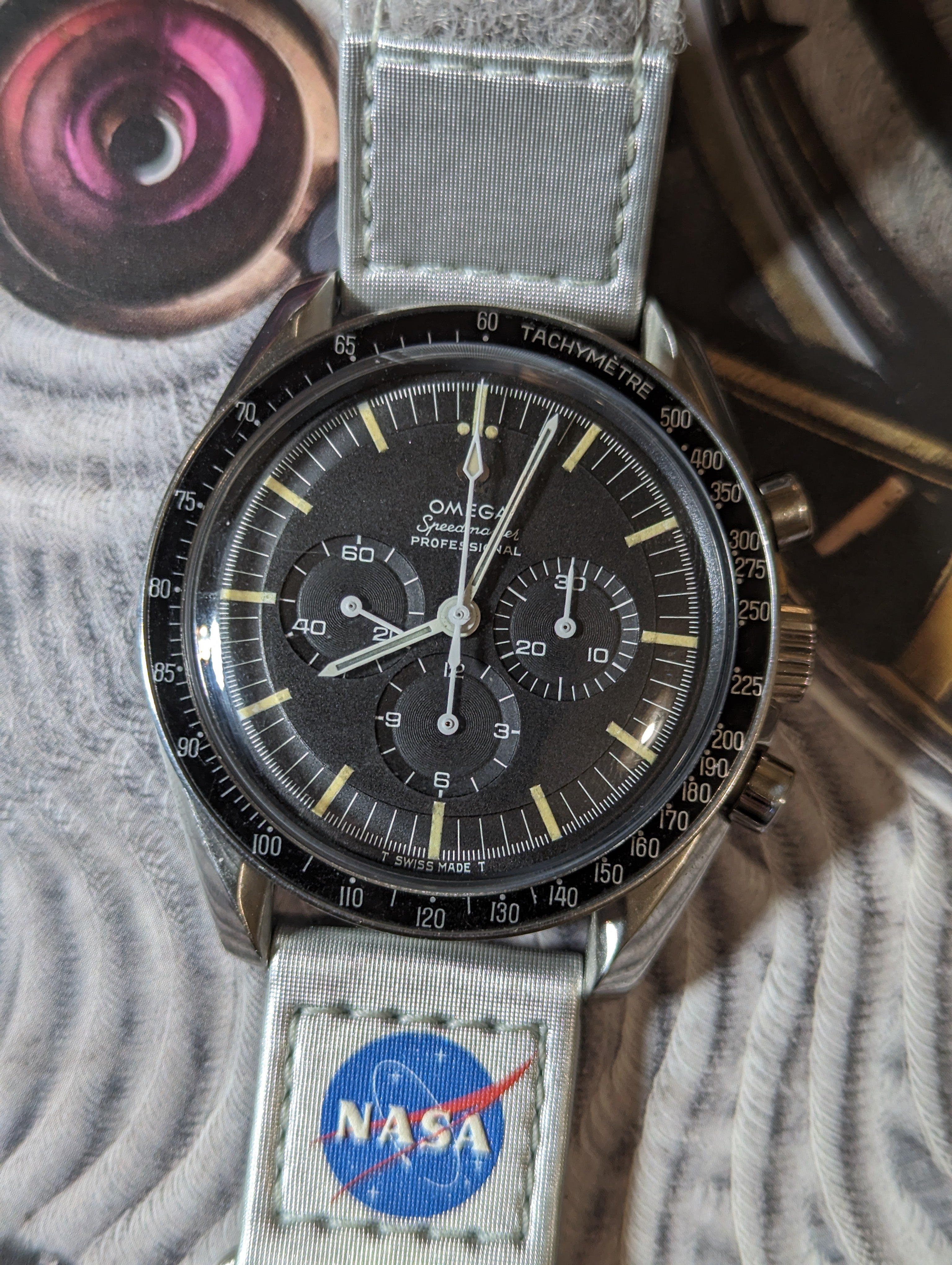

Hi all
A bit blurry image but the bezel to me looks fine.
19
23

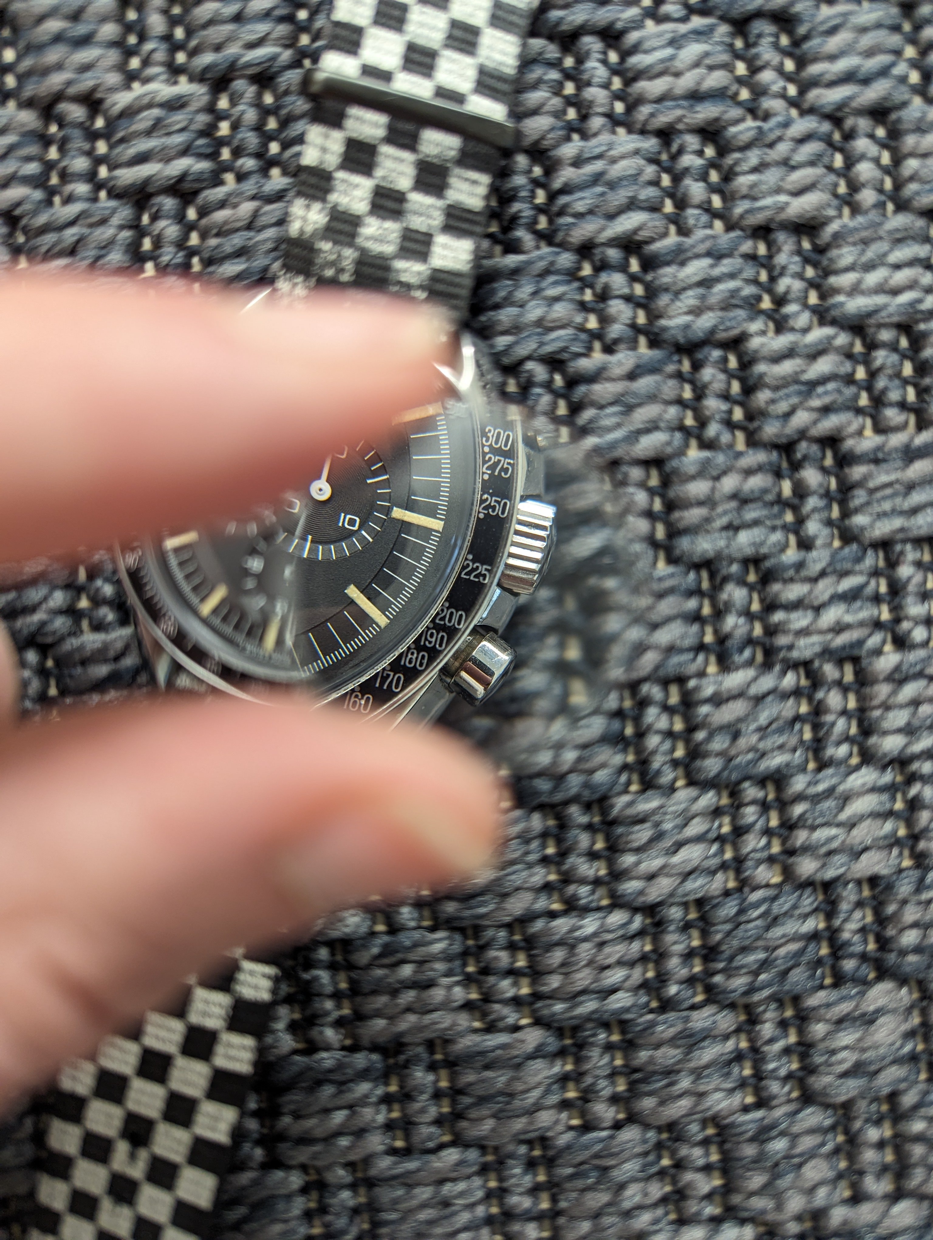

thanks for your help...
i haven't a hight reso picture at hand... i triy this evening....
19
23
my cellphone camera is not able to make better makro photos... i tried with a lens...
