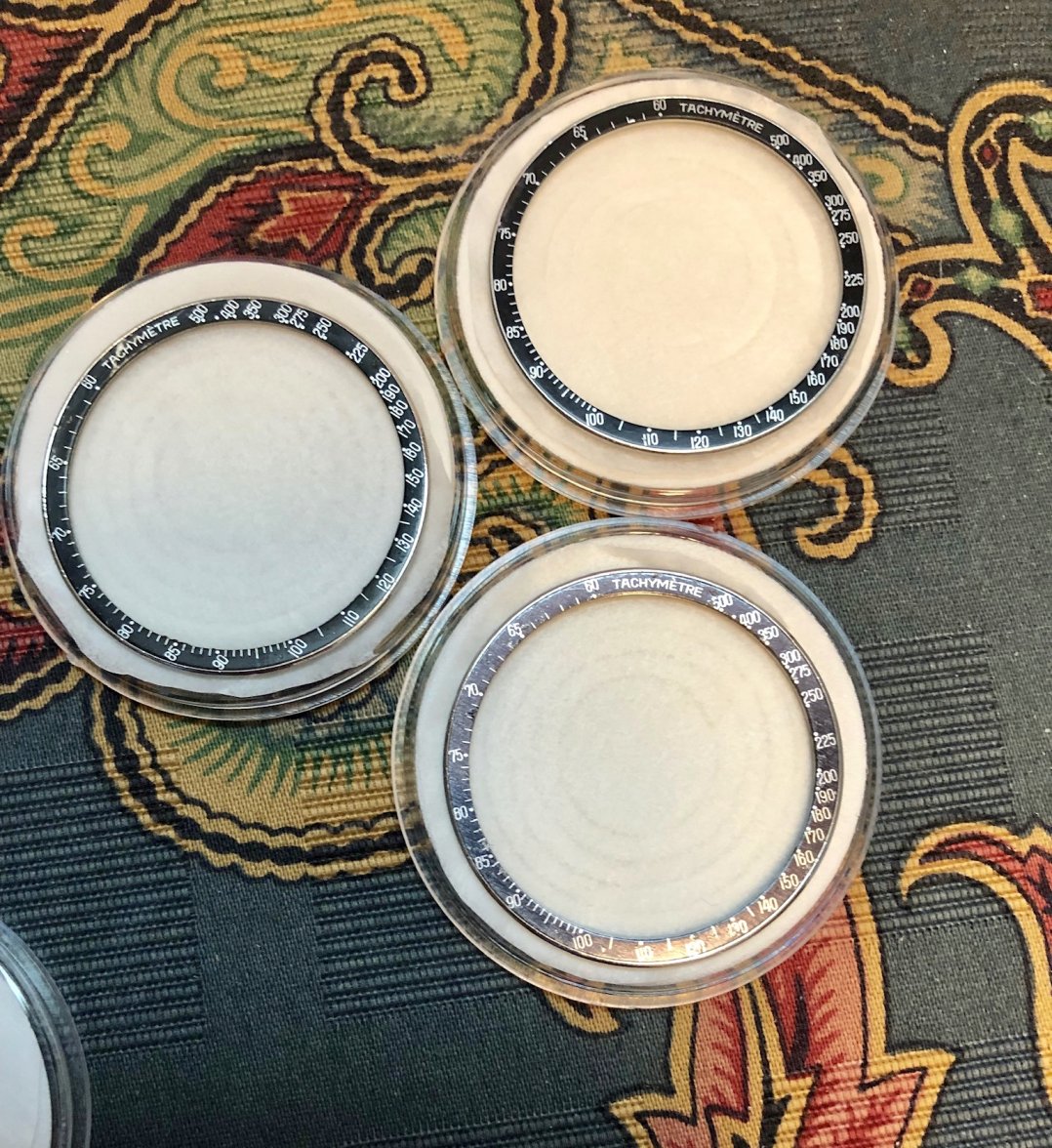

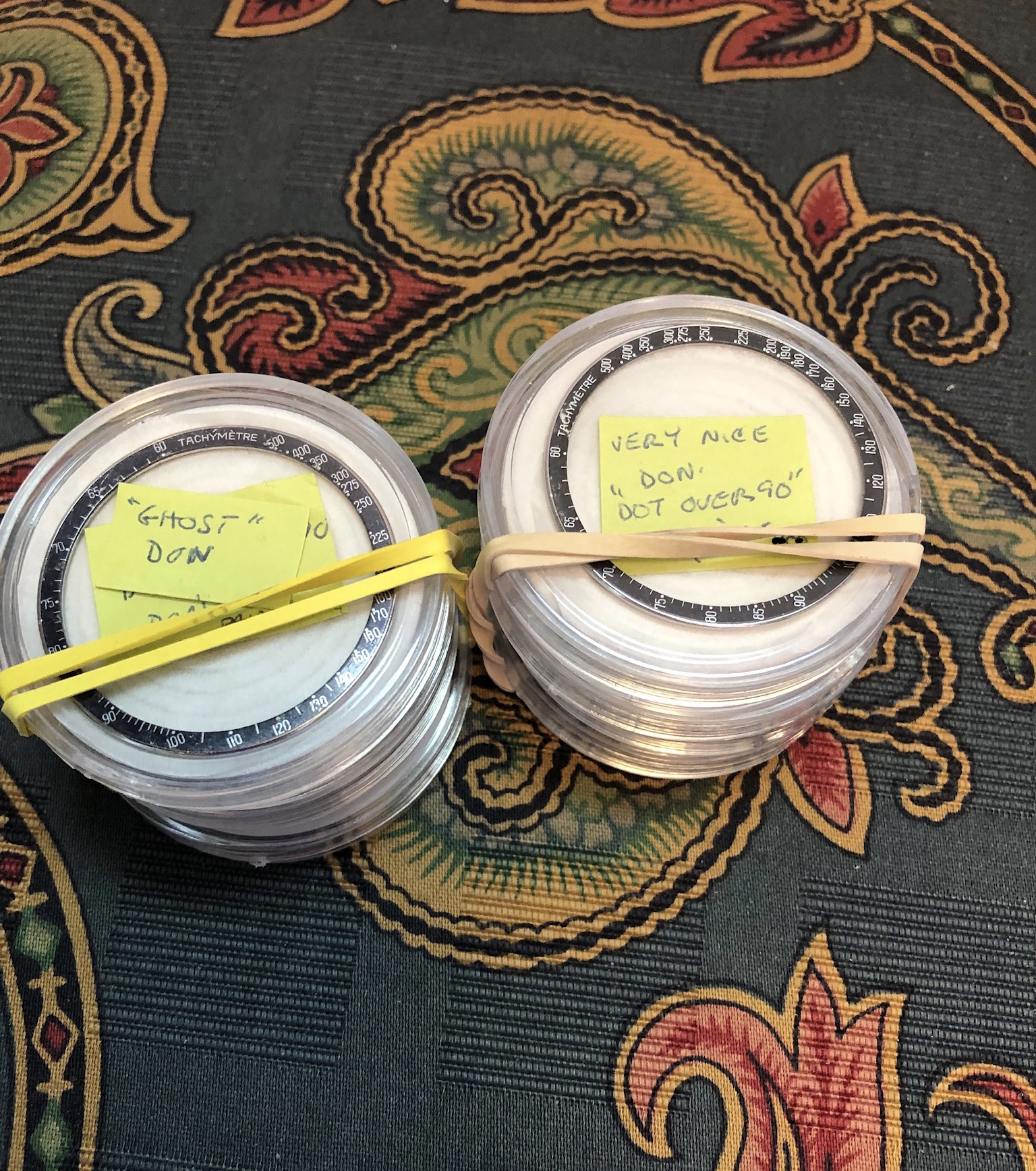

While I admit to hoarding more than my fair share in past days, I’m sure there are more egregious offenders among the OF community. And anyway, I may soon be a reformer,

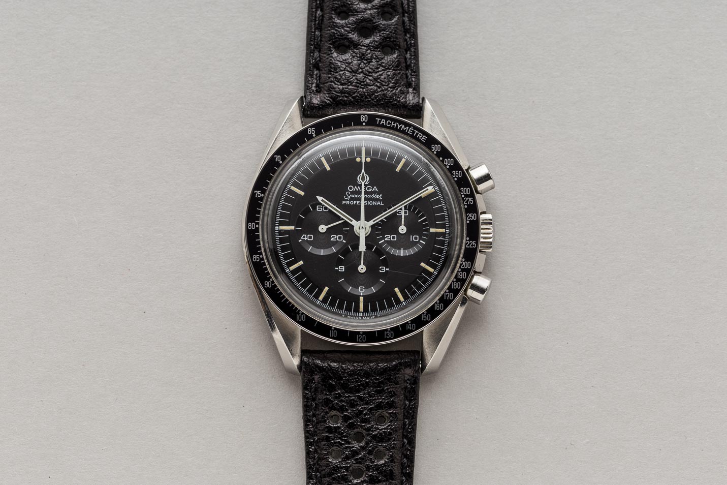

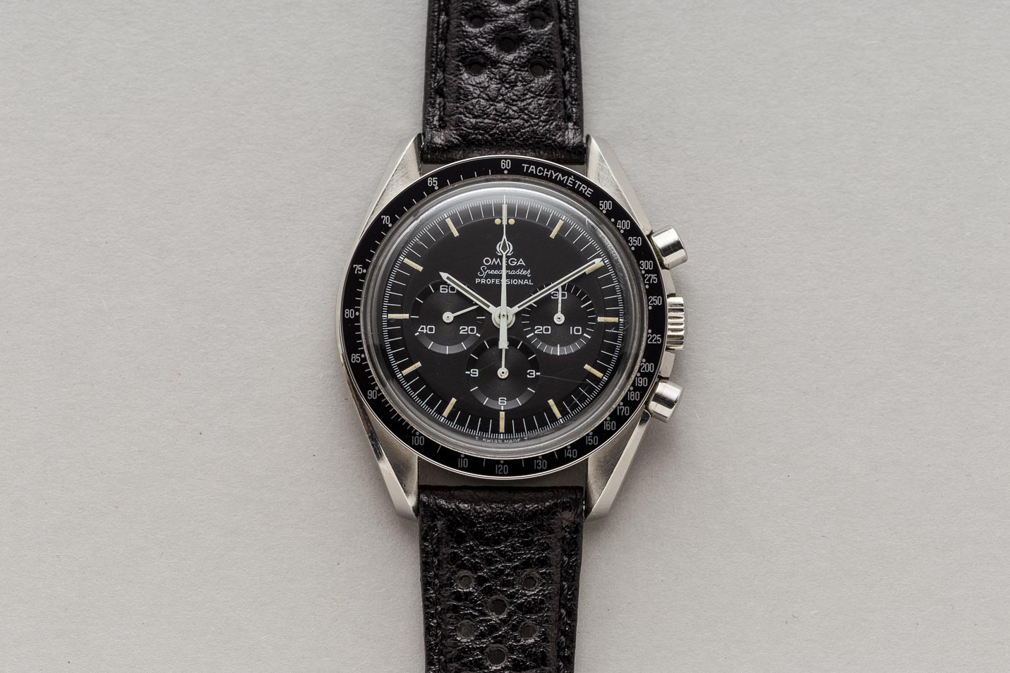

Here is a new one for me. The watch has just posted for sale by a German dealer. "The DO90 bezel is in mint condition. The watch was acquired from a collector in Belgium. The watch/set is more than in investment grade quality"
Mmm who can spot the tell?
5,161
15,992
without even looking at relative spacing of dots to text, or the fonts, I would say on first whim the text size is wrong.
Saw the offer yesterday, had a feeling about the bezel...
I really would be interested to know if it's genuine, keep it coming!
761
1,738
The fonts are too small which caught my eye, once you find the mistake you can be sure. By the way I told the dealer that it was fake & even kindly told him the tell and his reply was "if you dont like it dont buy it". "Shuck the Oyster" in Berlin.
So to be clear, a well know dealer, 'Shuck the Oyster' has been informed the bezel on this is likely fake and without doing any further checks is happy to sell it as genuine?
When the printing looks sketchy, I always look at the dots over 140 and 150 these days.
The bezel IS in mint condition BTW ... just totally fake.
