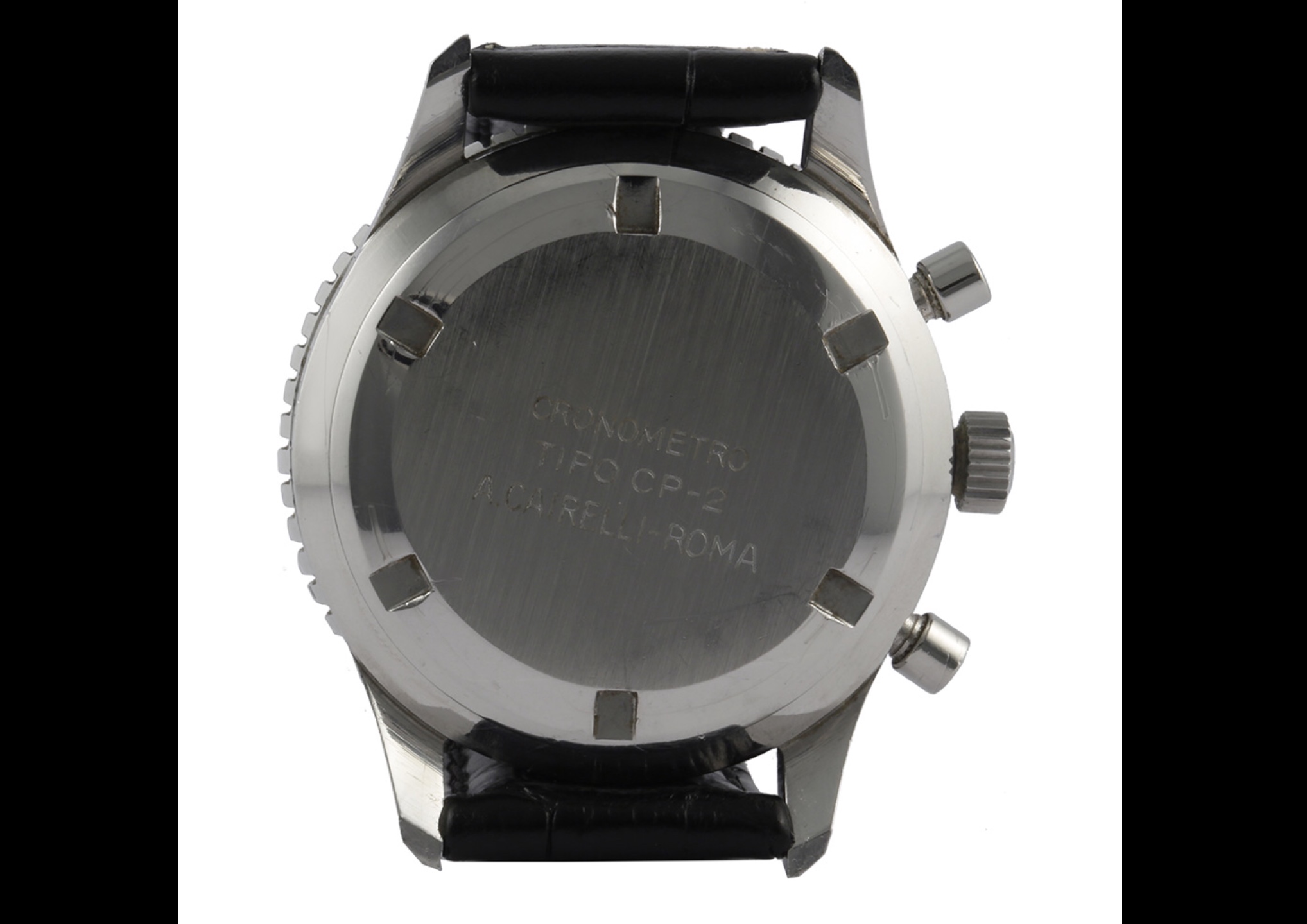

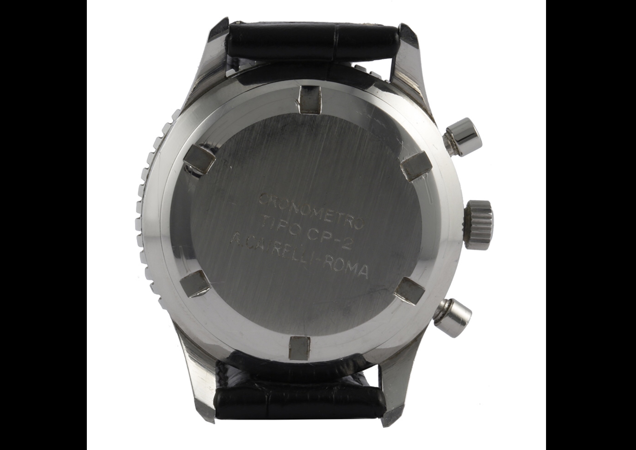

This is incorrect!:whipped: The DP and HP movements include several upgrades like flat coil and shock proofing but are not chronometer movements.
You are right and I wrote a foolishness
It would be better to say that 146DP and 146HP have chronometric features and that with this calibers zenith had ambitions of chronometer like we can see on the backside of Cairelli (146DP). But they are not chronometers
