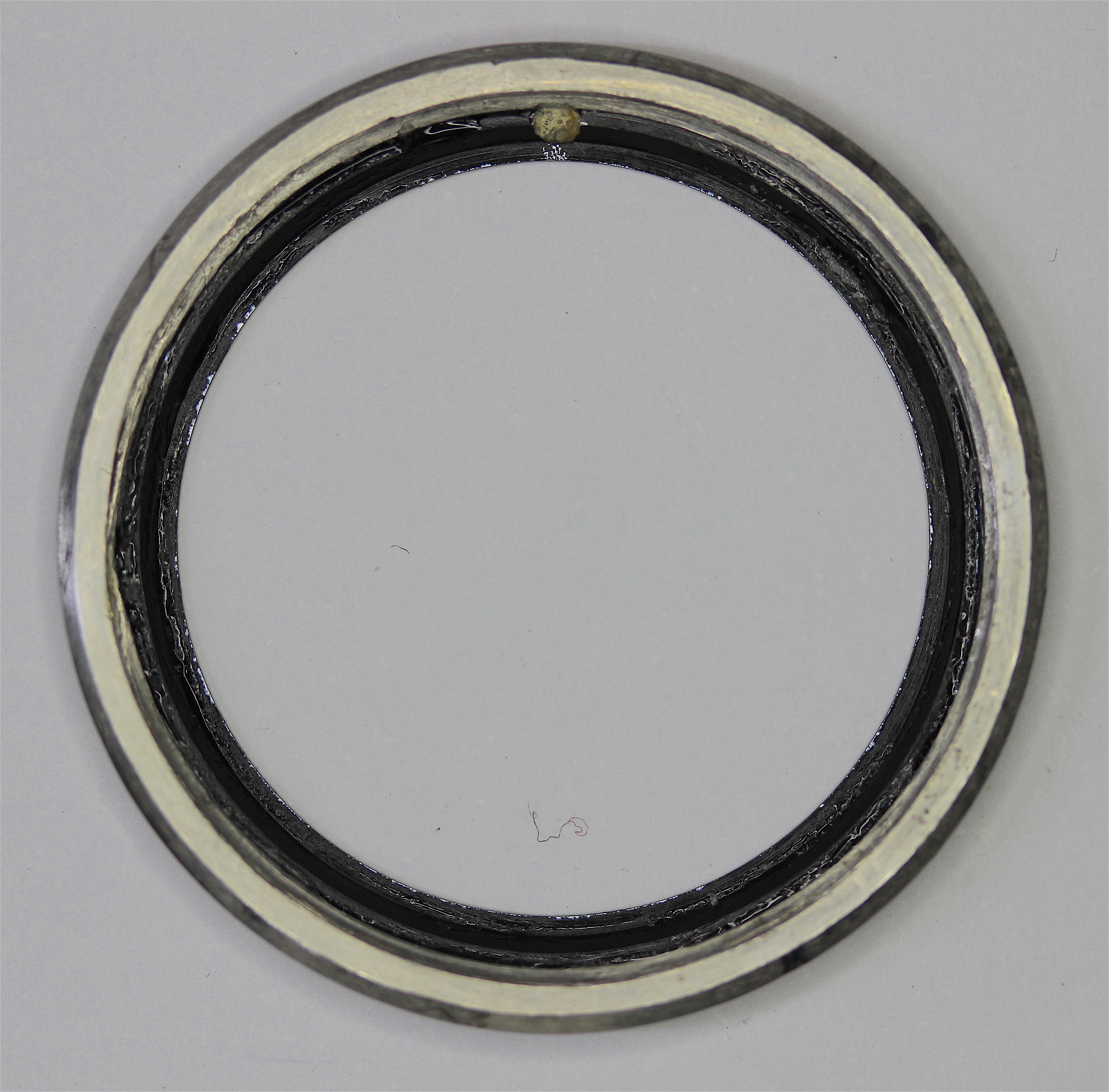

While waiting for parts to make their way from the USA to Australia, I had time to check some of the other parts, so I got the bezel off the case.
Removing the Tudor/Rolex bezels is fairly easy, they're only held on by a circular spring and using a bezel remover had it off in seconds.

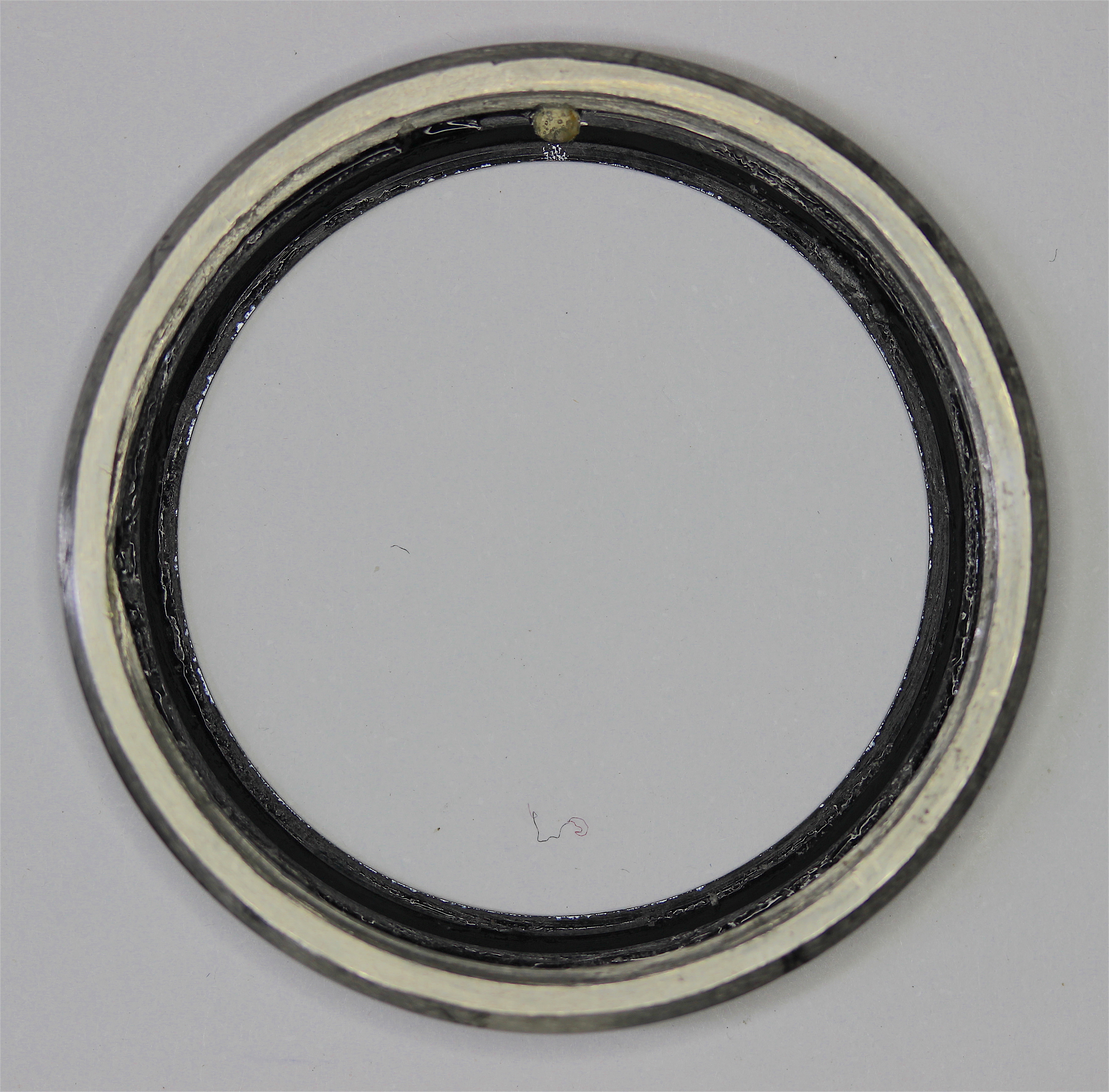

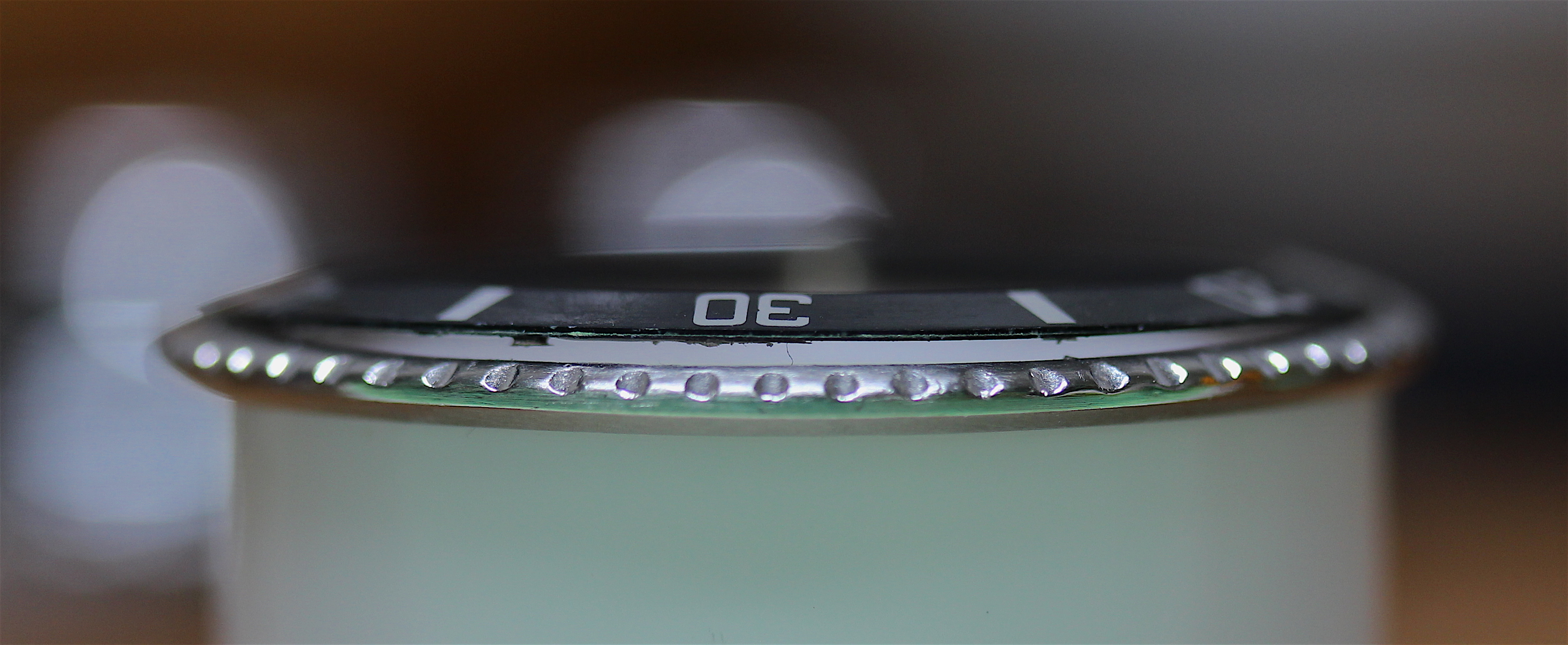

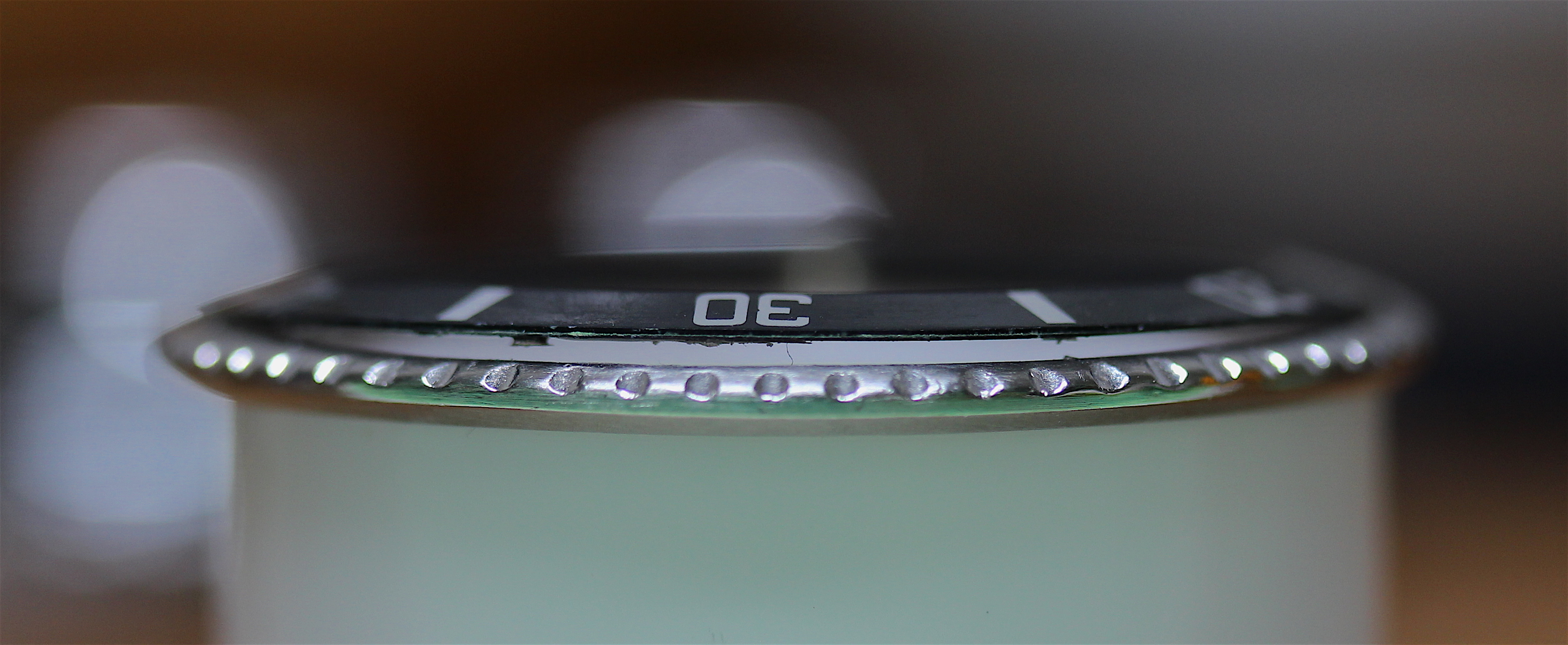

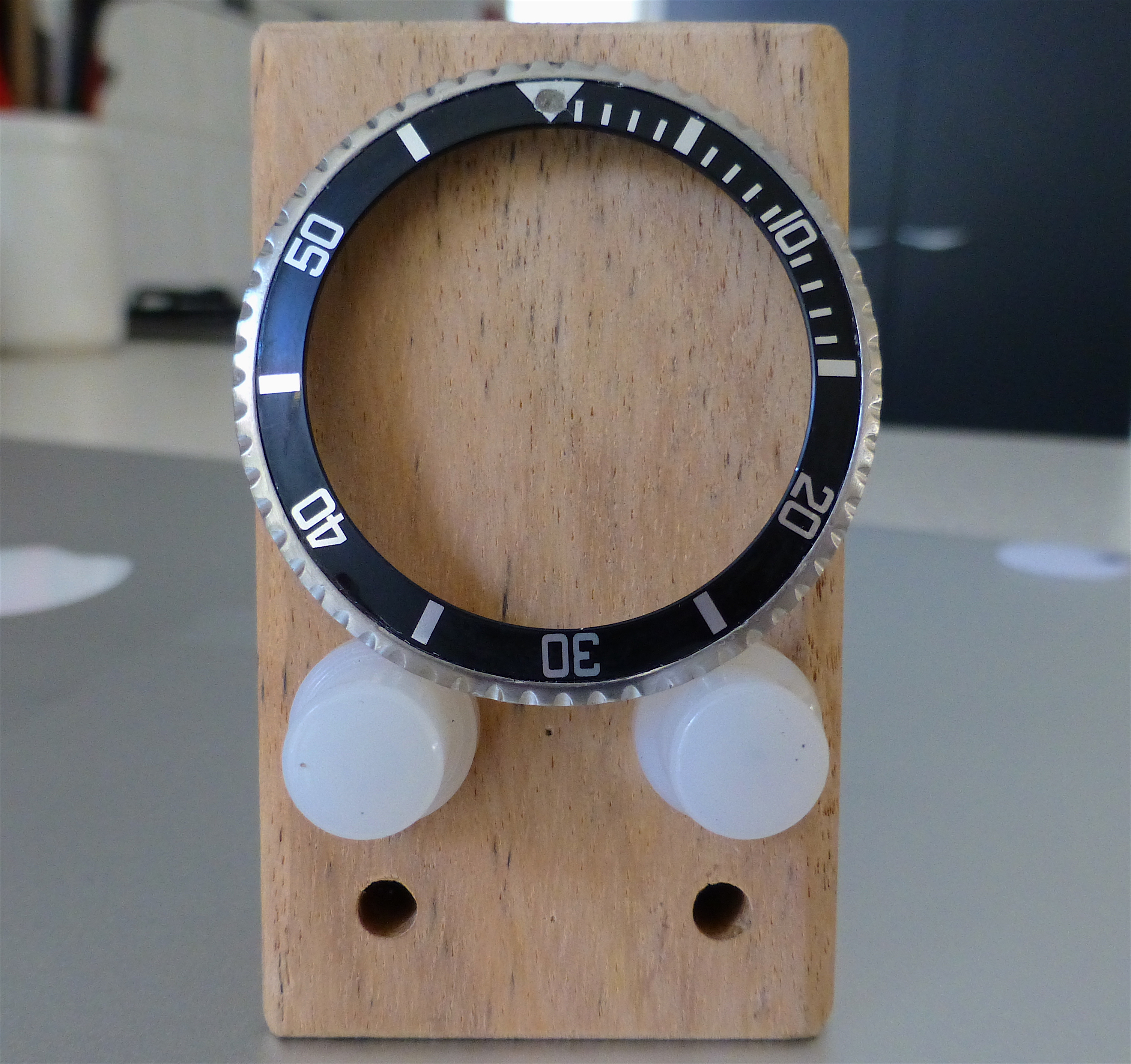

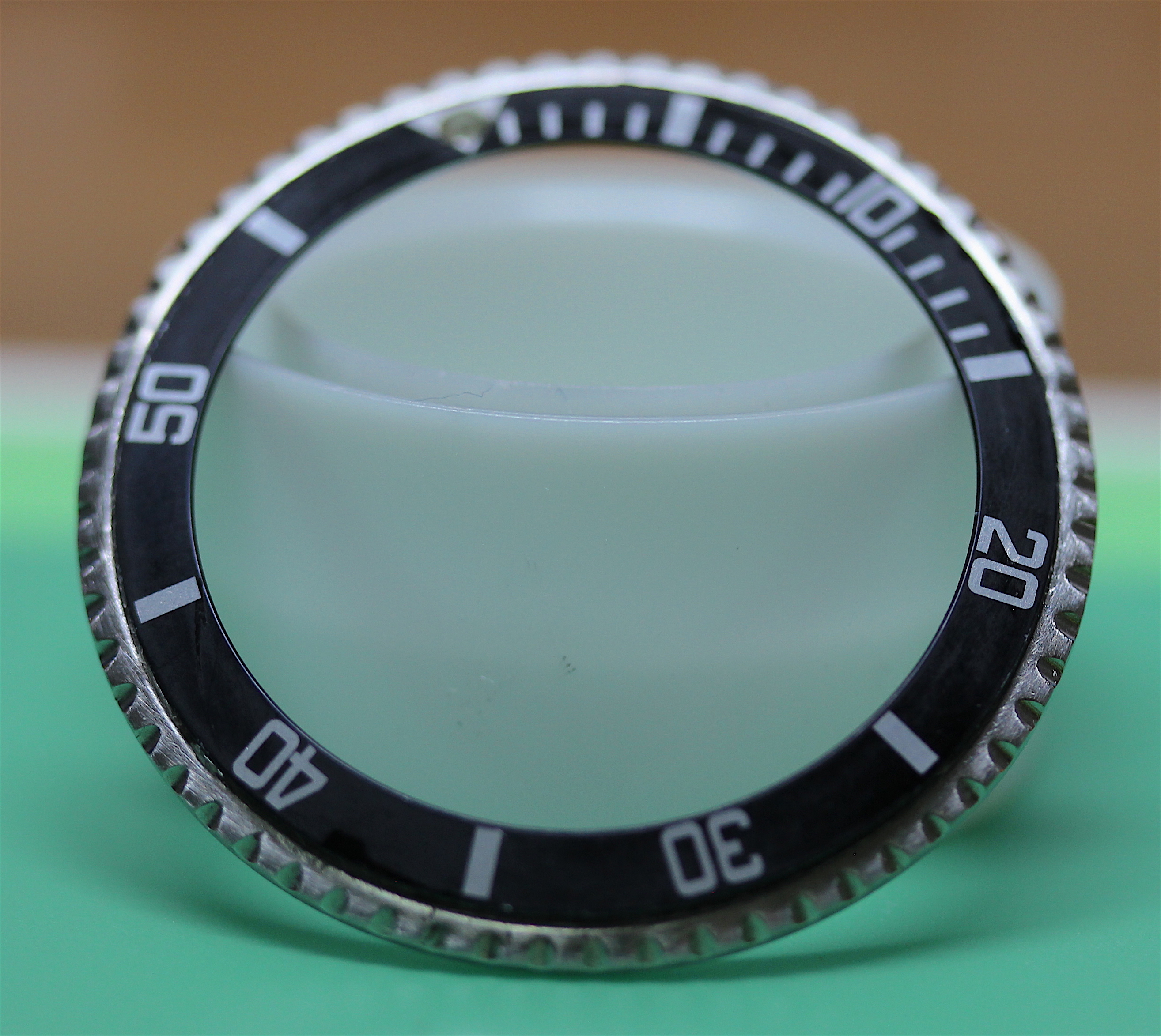

Close examination showed that the insert was lifting in the lower half, mainly around the 30.
A gentle touch from below revealed a bigger problem! The insert was only just holding on.
Looking at the underside we can see the bezel has had a hard life. Keep the original or try and save this one?
The vote was "save it!".

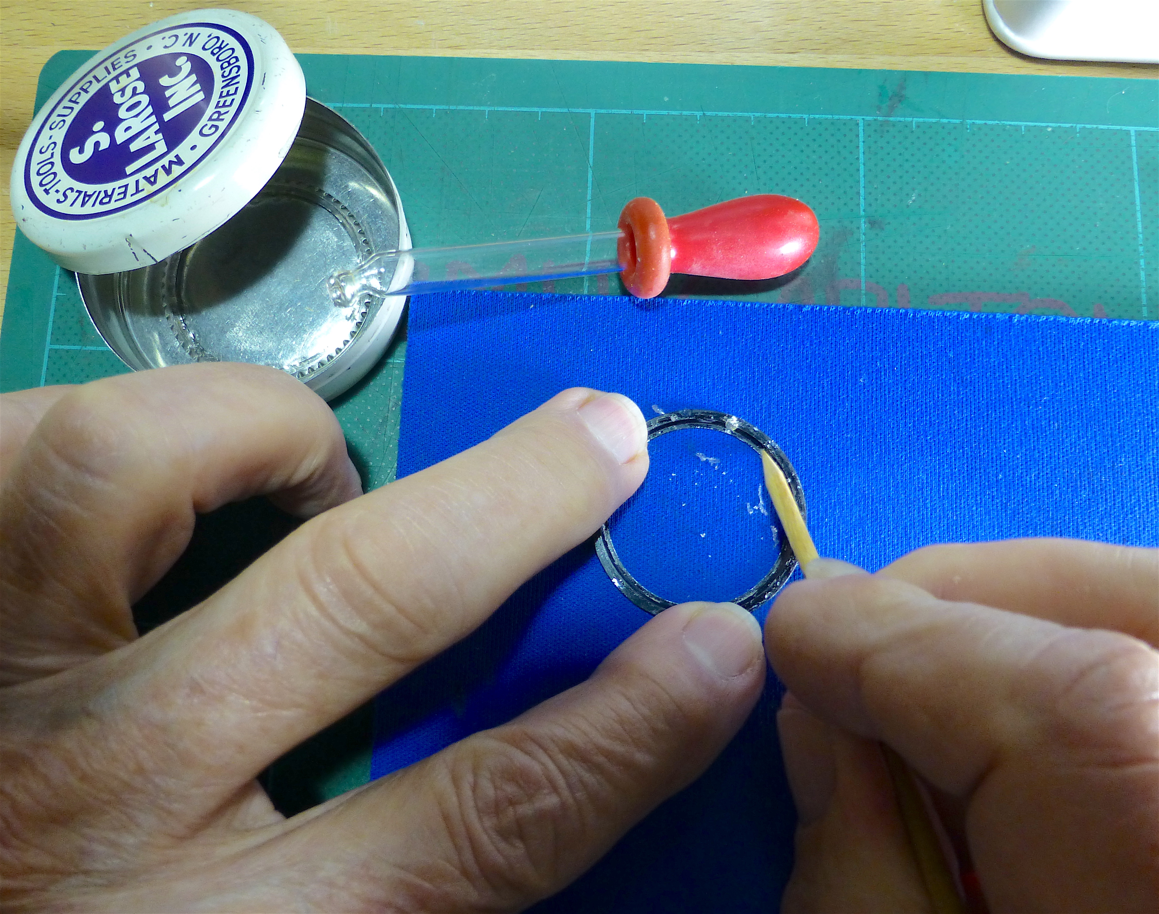

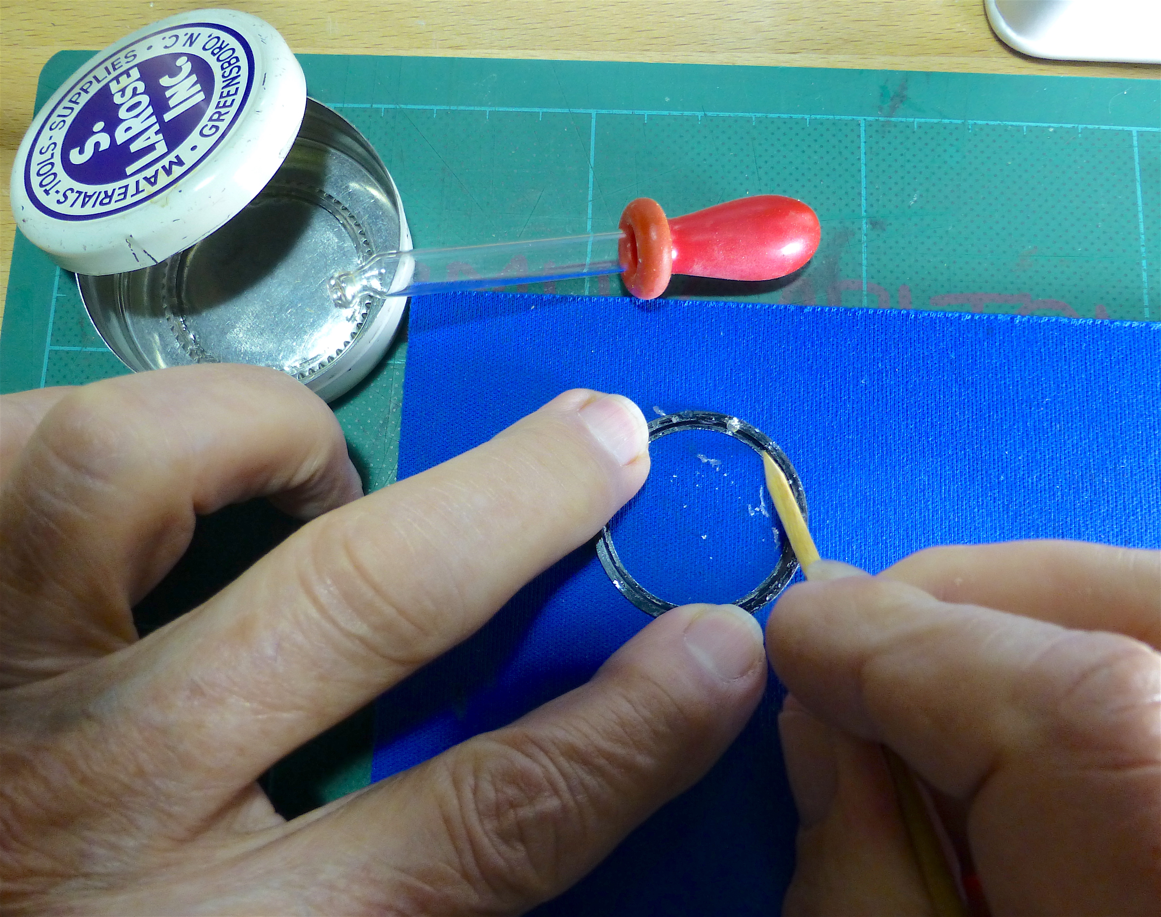

Therefore, the first step was to let the bezel soak in acetone for a few hours. The insert, being anodised aluminium wouldn't be affected and the acetone would soften the glue.

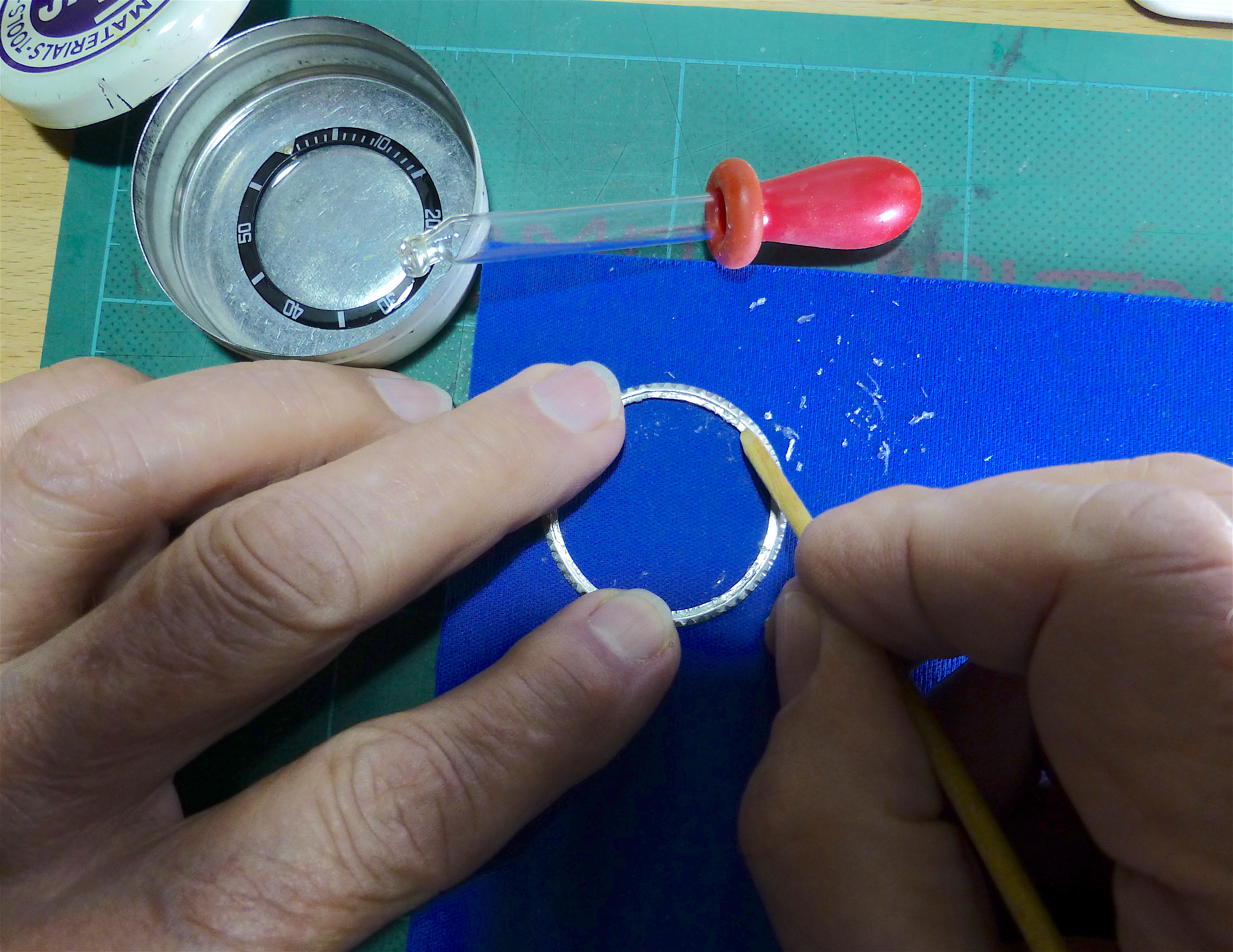

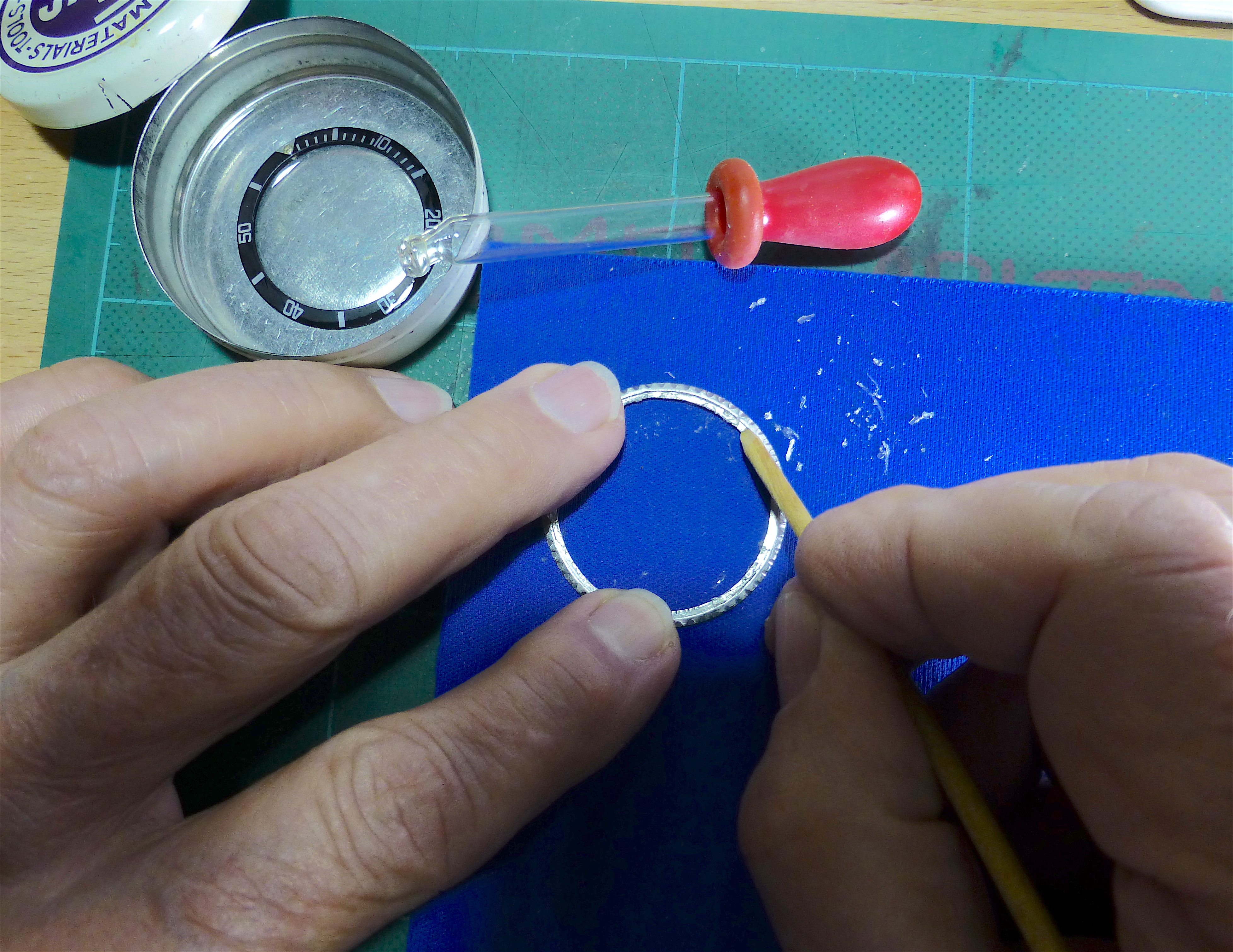

With the glue soft enough to remove the insert it was popped off and the removal of gunk began. First off was remove the glue from the insert with a pegwood stick while the bezel soaked a bit longer.
Then it was time to get all of the crud out of the bezel ring doing the same thing.
With two nicely cleaned components I was able to remove dings and gouges and clean out the spring groove. Then it was into the ultrasonic for the bezel to remove any last traces of glue/metal. The insert was cleaned by hand with a soft cloth.

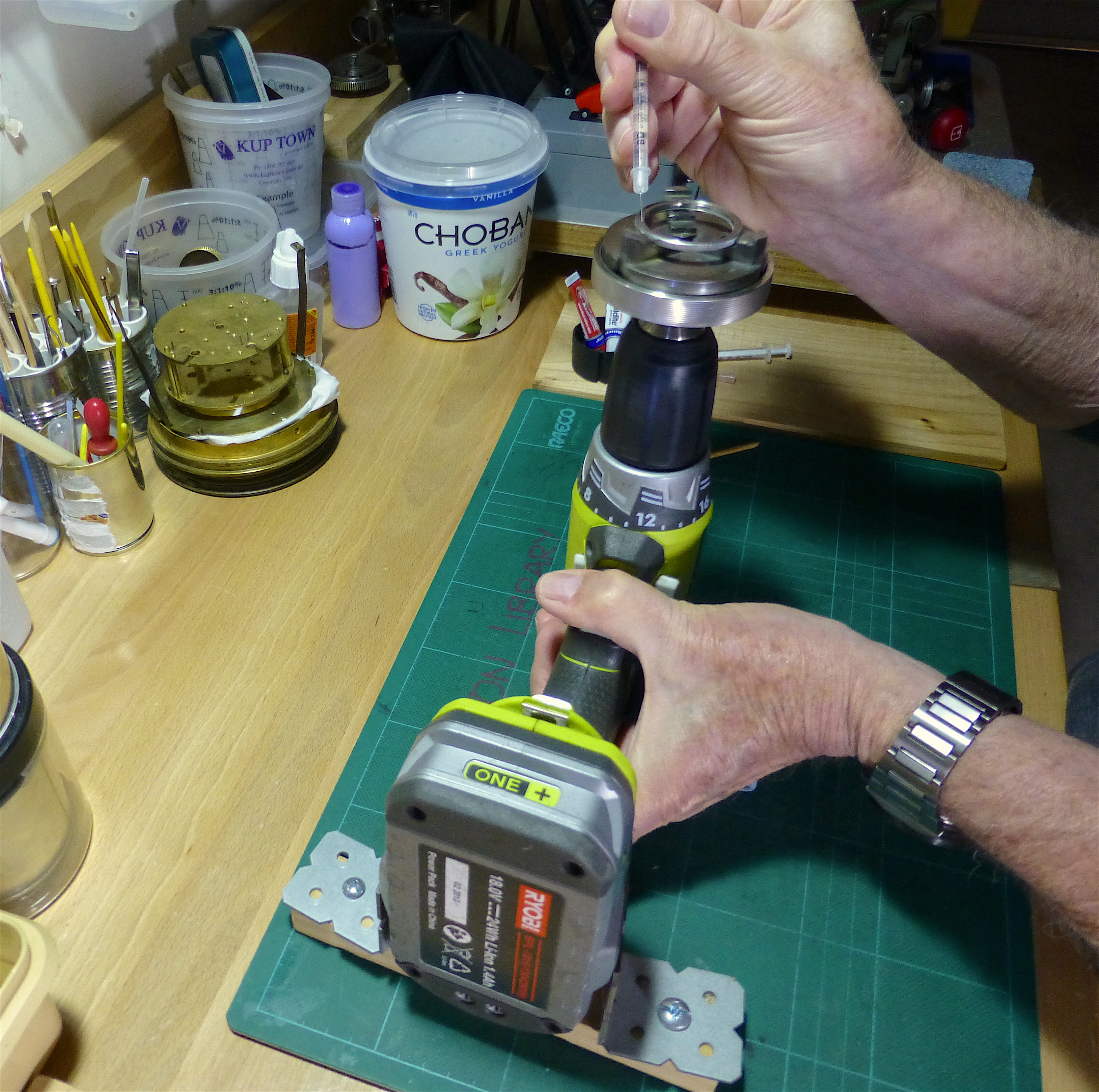

Now it was ready to be put back together. Seeing that both parts were no longer perfectly circular due to their hard life, my only option was to glue the insert into place.

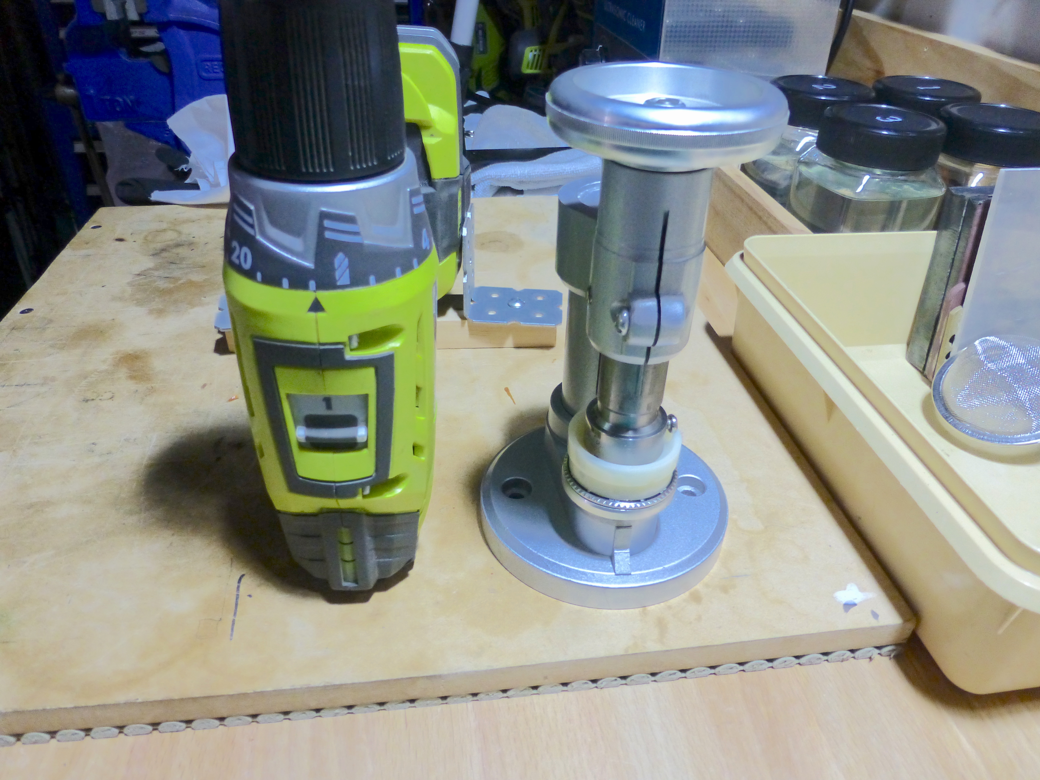

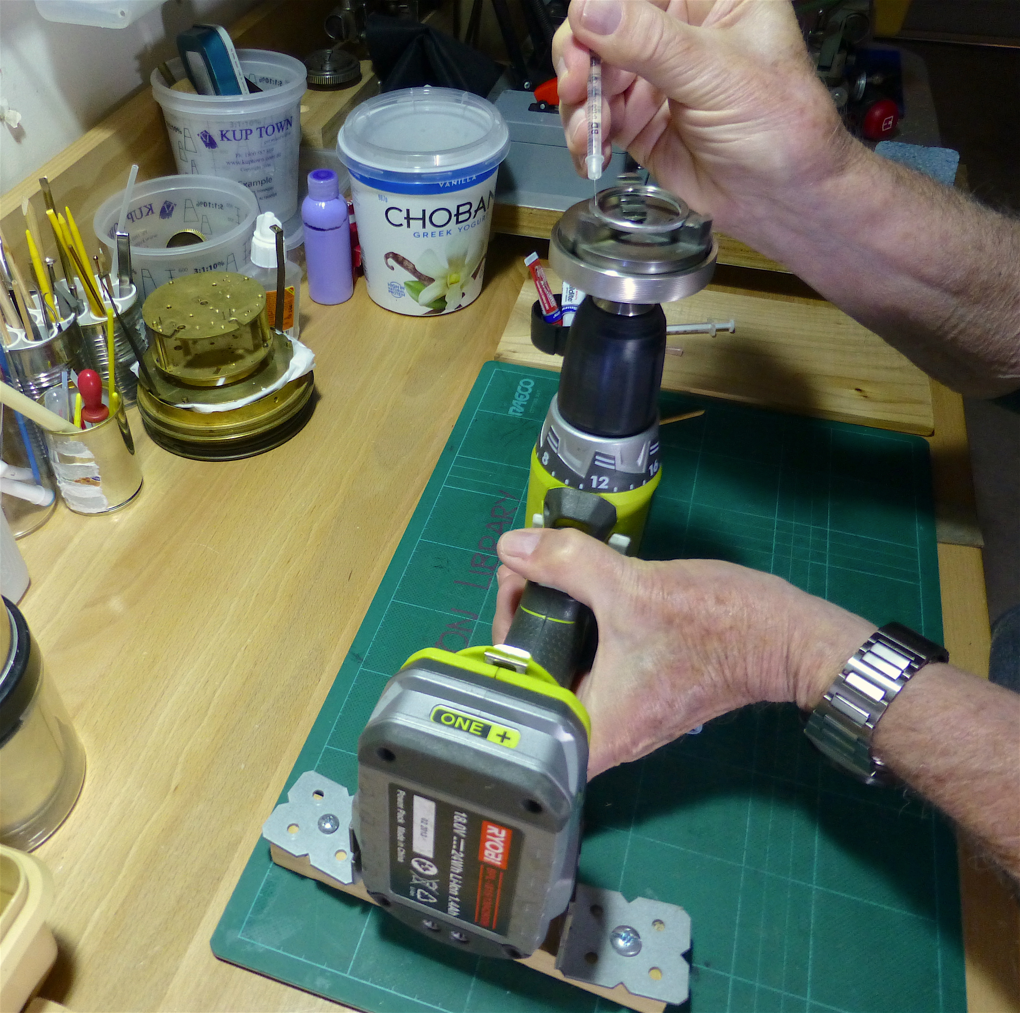

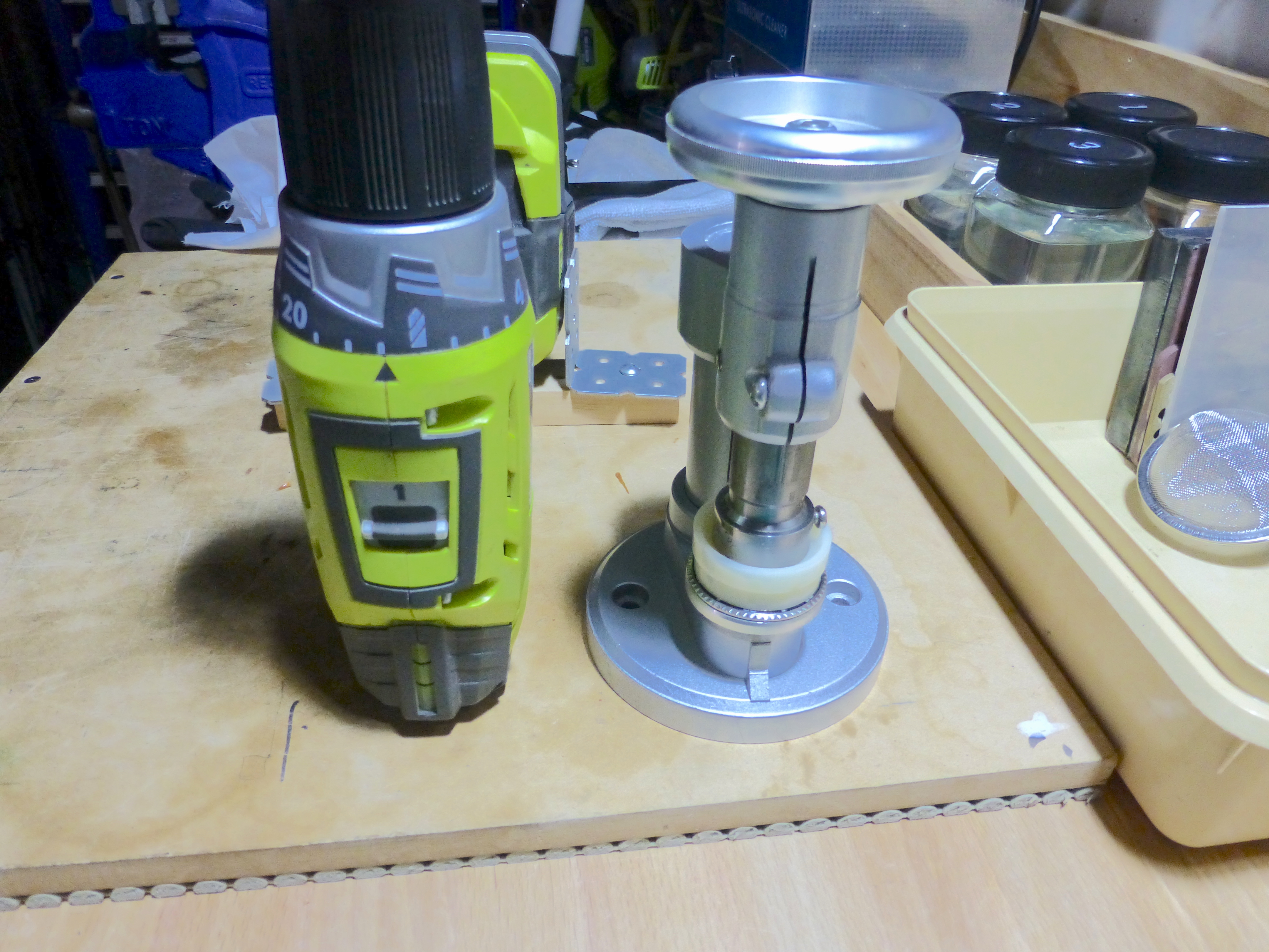

Out came my trusty "vertical lathe" 😁 so that I could apply a fine even bead of glue around the bezel. Using a fine hypo allowed me to apply glue in a controlled manner thus avoiding lumps and big drops that would possibly squeeze out and get all over places I didn't want it.
Applying the glue.
The insert was then aligned to a mark on the bezel that I'd found gave the "best fit option", it was gently put in place (avoiding smearing any glue) and then put into a press to clamp both parts together for 24 hours.
After a long wait, and resisting the temptation to have "just a tiny peek", I took the now complete bezel assembly out of the press and gave it a good "touch test". Thankfully it held up even under reasonably hard finger pressure.
So while it's probably not perfect, I think it will suit the look of the watch.

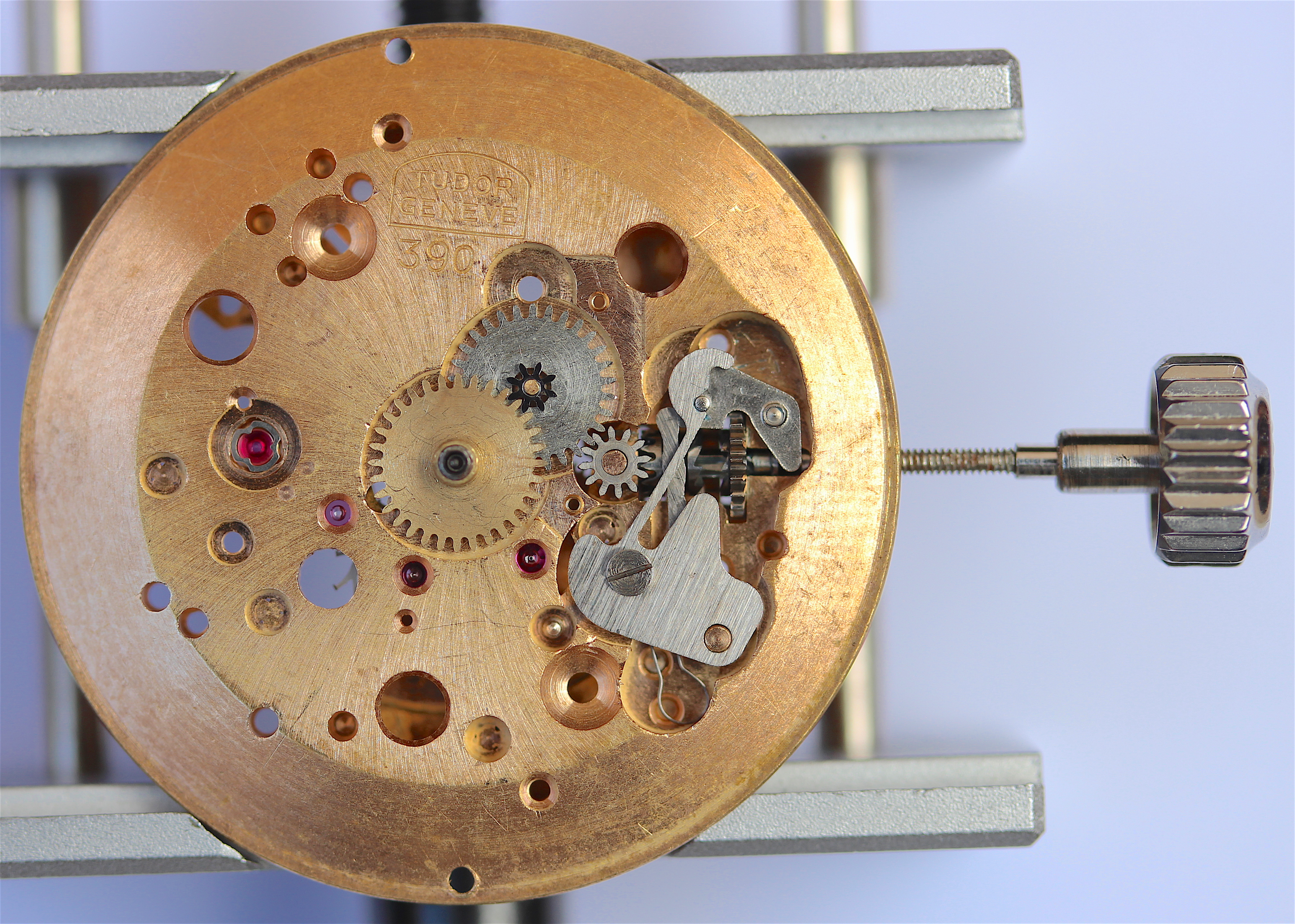

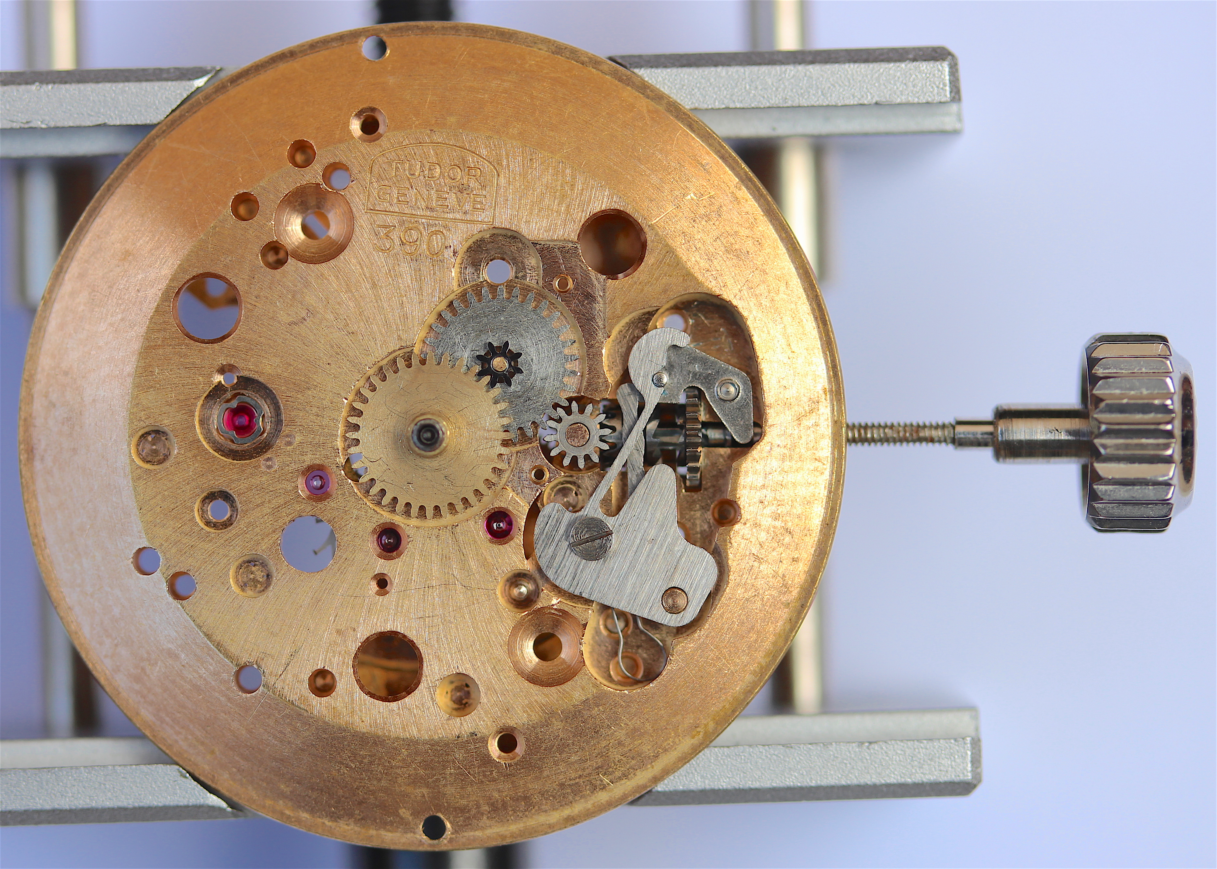

Without the mainspring I can't go much further, but I decided to finish off the front side/setting works as that won't affect the other side when the mainspring arrives. So here it is, all cleaned, lubricated, re-assembled and checked for correct operation.

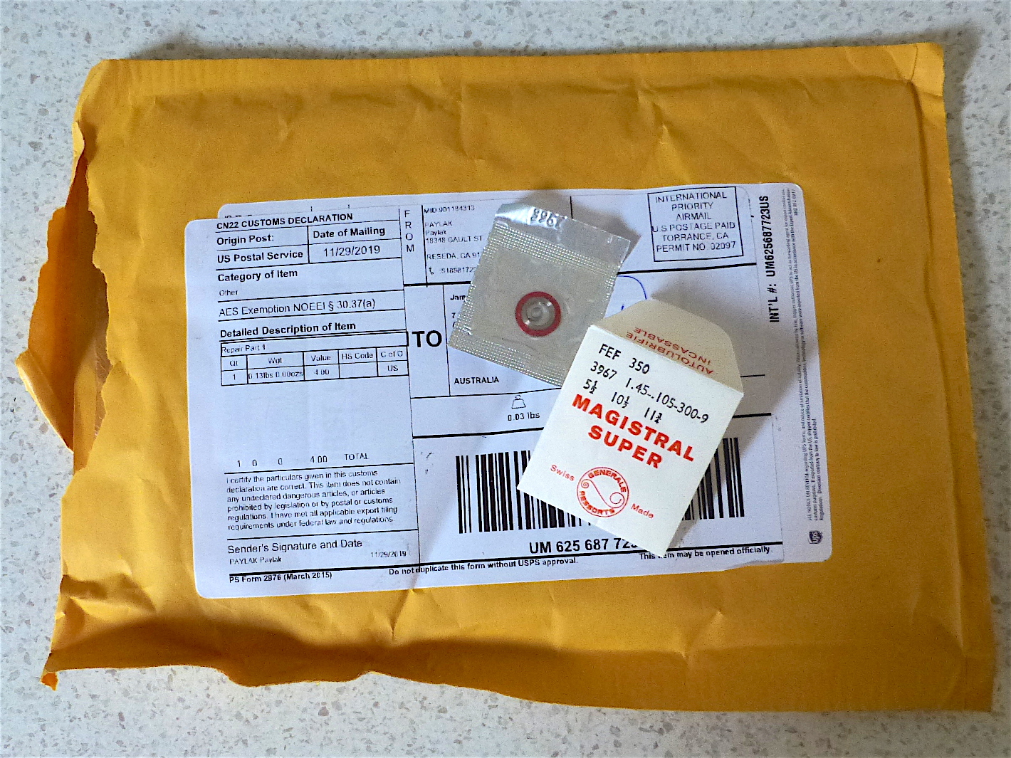

About time, mainspring has finally arrived.
But! I won't be able to get to it straight away as I have a mission to conduct tomorrow on behalf of an ΩF member 😗.
I noticed it doesn't have the slipping bridle so I'm glad I kept the original.
Hi Jim,
I see you have bought the Fleurier 350 manual winding spring. Before you install it, please measure the old spring you removed, as I think you may have the wrong spring.
Looking in by Bestfit book, the FEF 350 calls for a slightly different spring than the spring you have. Your is a 5 1/2 X 10 1/2 X 11 3/4 Dennison, while Bestfit calls for a 5 X 10 X 12 1/2. Those differences aside, the FEF 390 calls for a different spring completely - a 4 1/2 X 11 X 10.
In case you need it, this is a Dennision (a US measurement system) to metric conversion chart...
Just want to be sure you have the right spring before you try to install it, because once you do there's no chance of sending it back.
Cheers, Al
