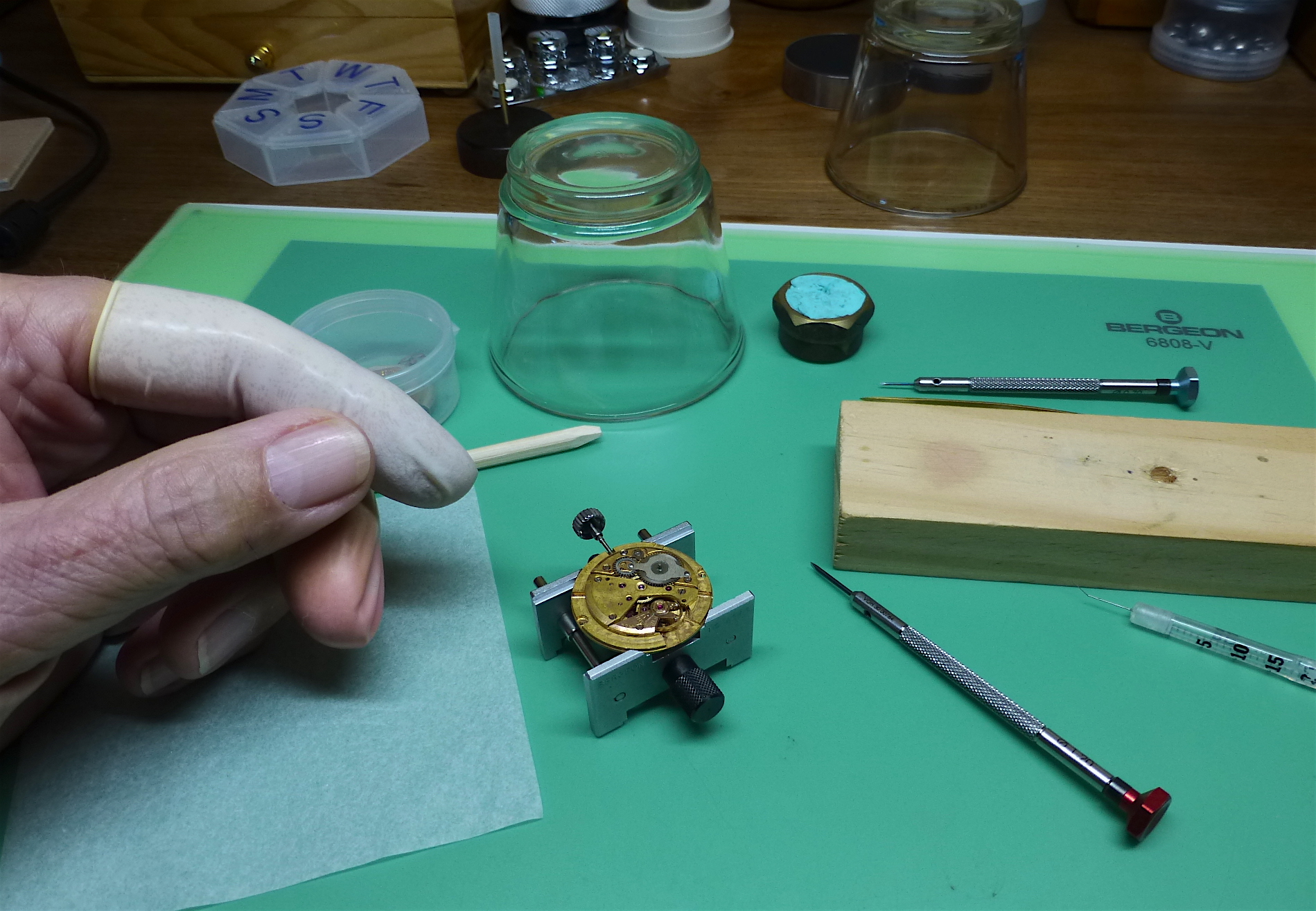

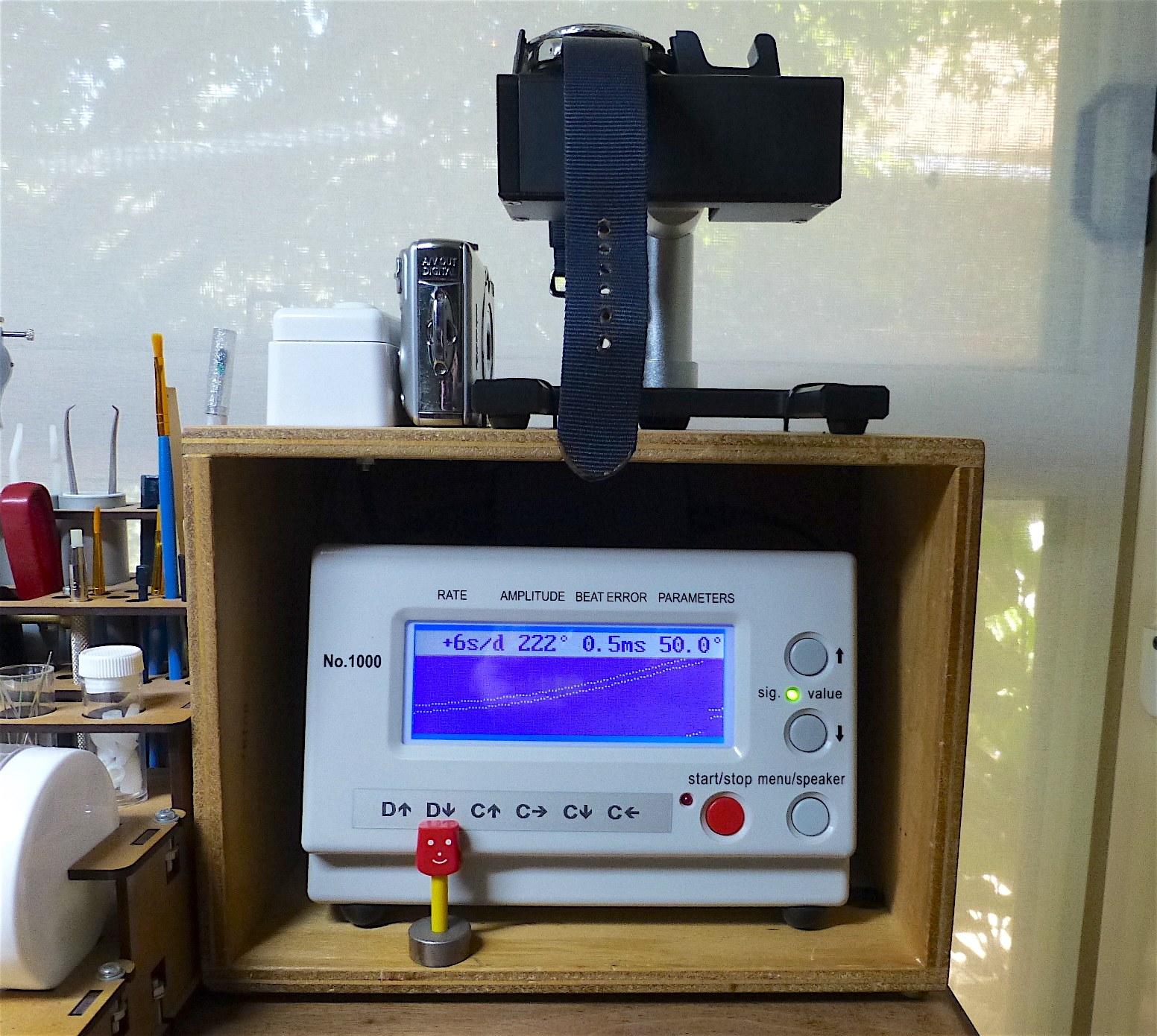

I'm almost able to do this in my sleep now.
How many times have I had the balance off to chase down the beat error?
Four?
Five?
Something like that, with a good day and a half wait between to get the power down.
Now I hope I'm getting closer, balance back in and running nicely. Amplitude isn't huge (around 200º) but I expected that due to age, mainspring etc.
Next step, onto the Timegrapher to see the result.
18,803
39,062

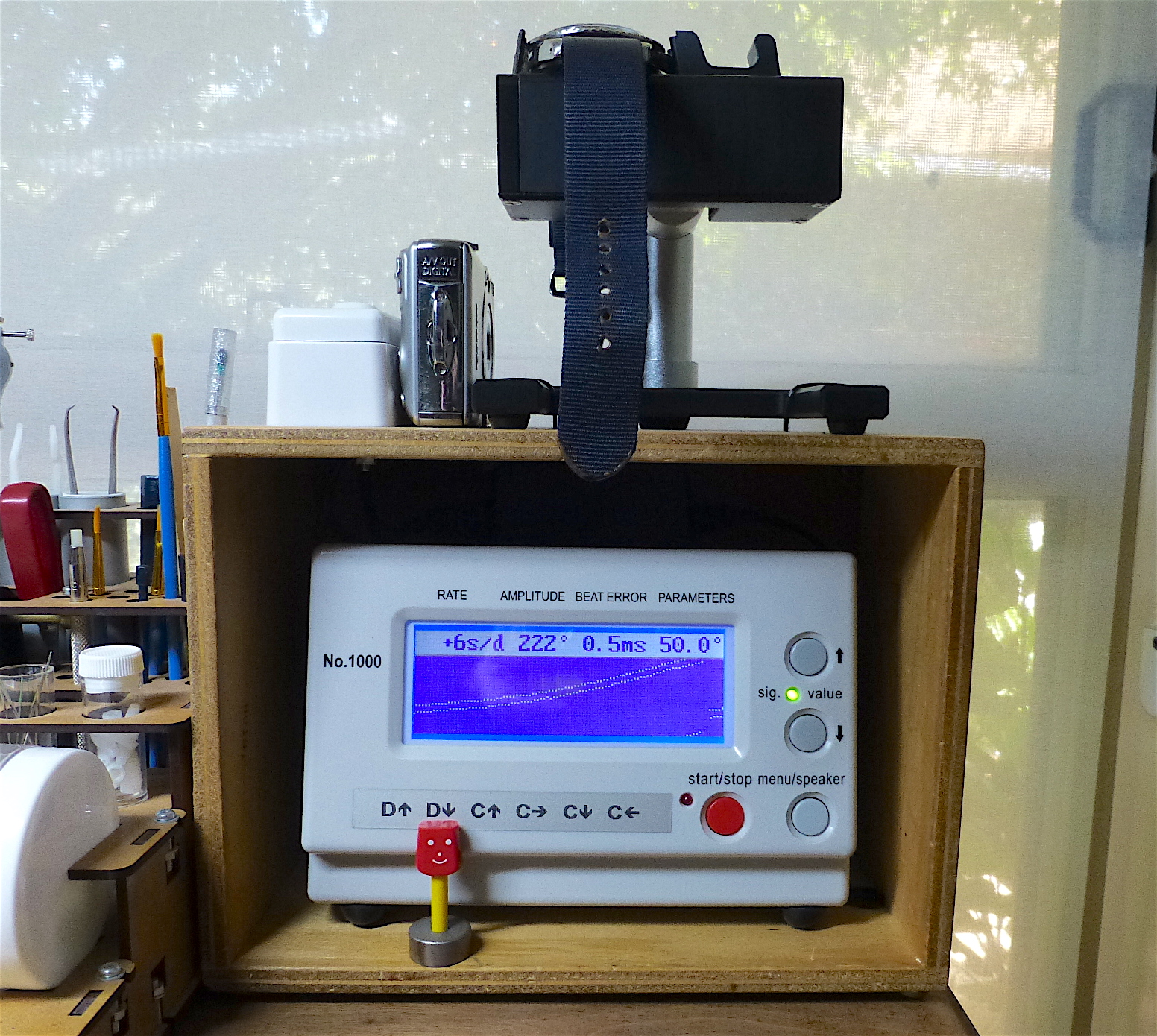

Well the last check looked "OK" considering the age/condition of the movement and I think if I keep chasing for a perfect beat error I introduce the risk of doing something wrong every time I pull the balance apart.
It's not perfect, and an experienced watchmaker could probably get it a bit better with some hairspring manipulation but as I'm not skilled in this delicate area, it's going to be what it is. If it was my watch, or even if it was something like a Seiko 7S26 I'd probably persist, it would be much easier to find a new/used hairspring for one but my chances of sourcing one for this movement are slim to say the least.
A wise man knows when to step back from the edge (should have done that 7 pages ago 😉).
A final Timegrapher check shows some gain, rather even traces and a beat error of 0.5ms.

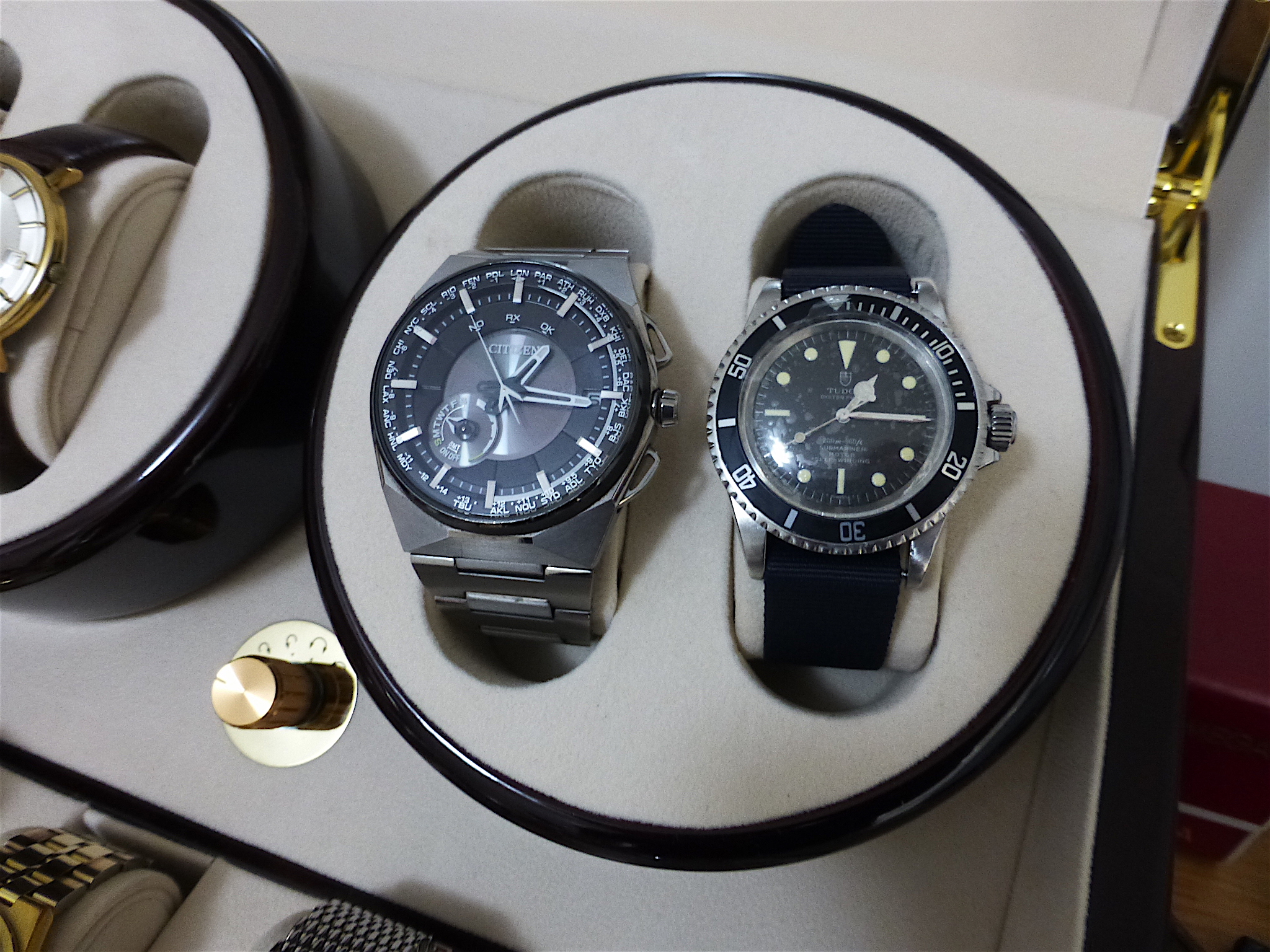

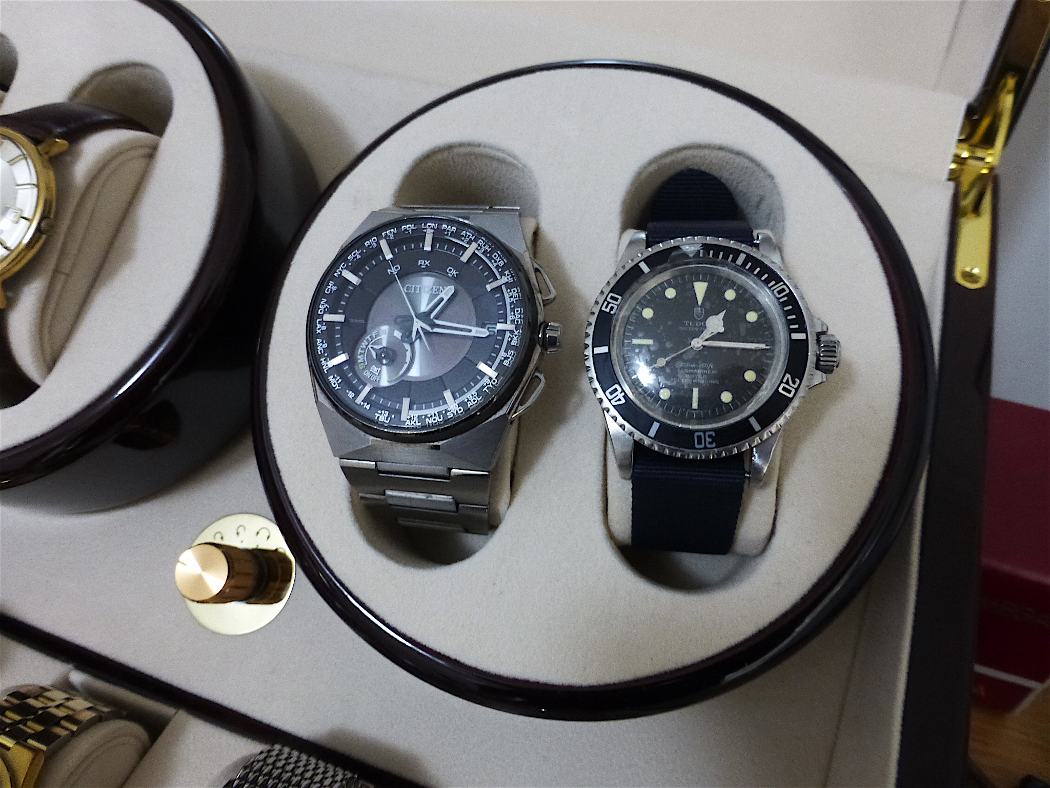

Now it's on to the winder for a few days to ensure it keeps time and the autowinder is working properly.

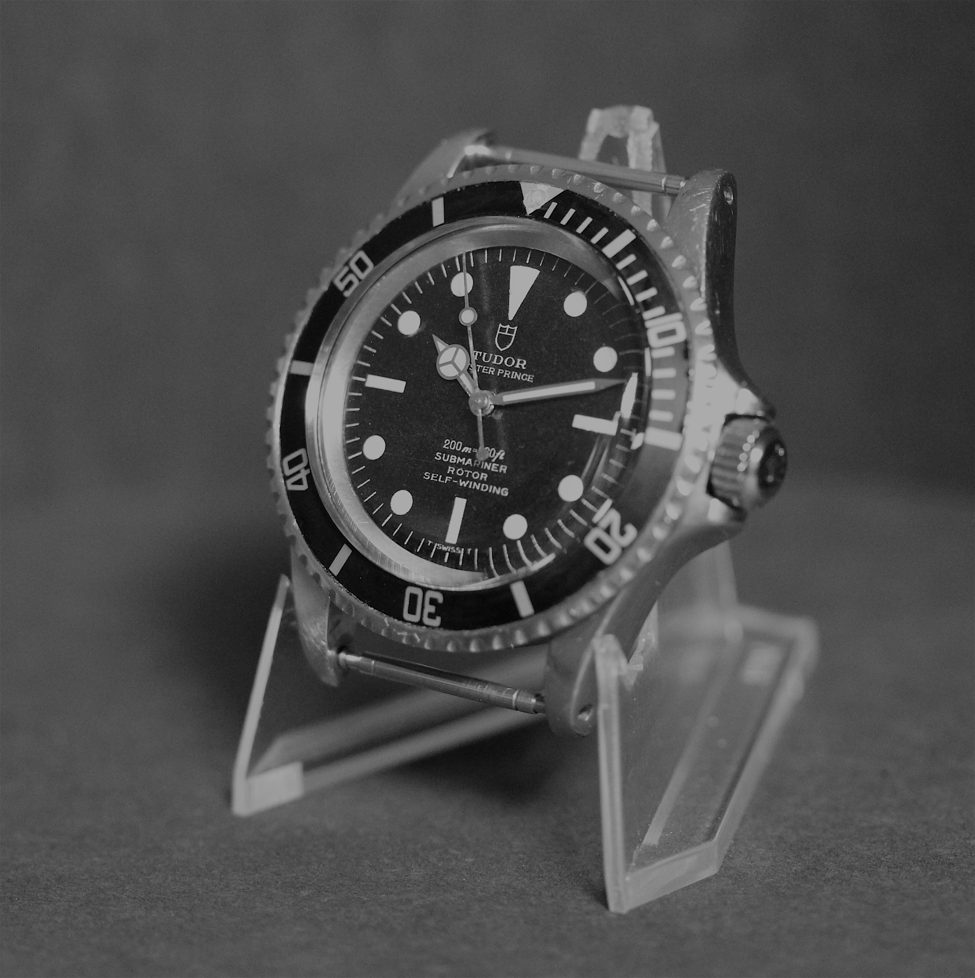

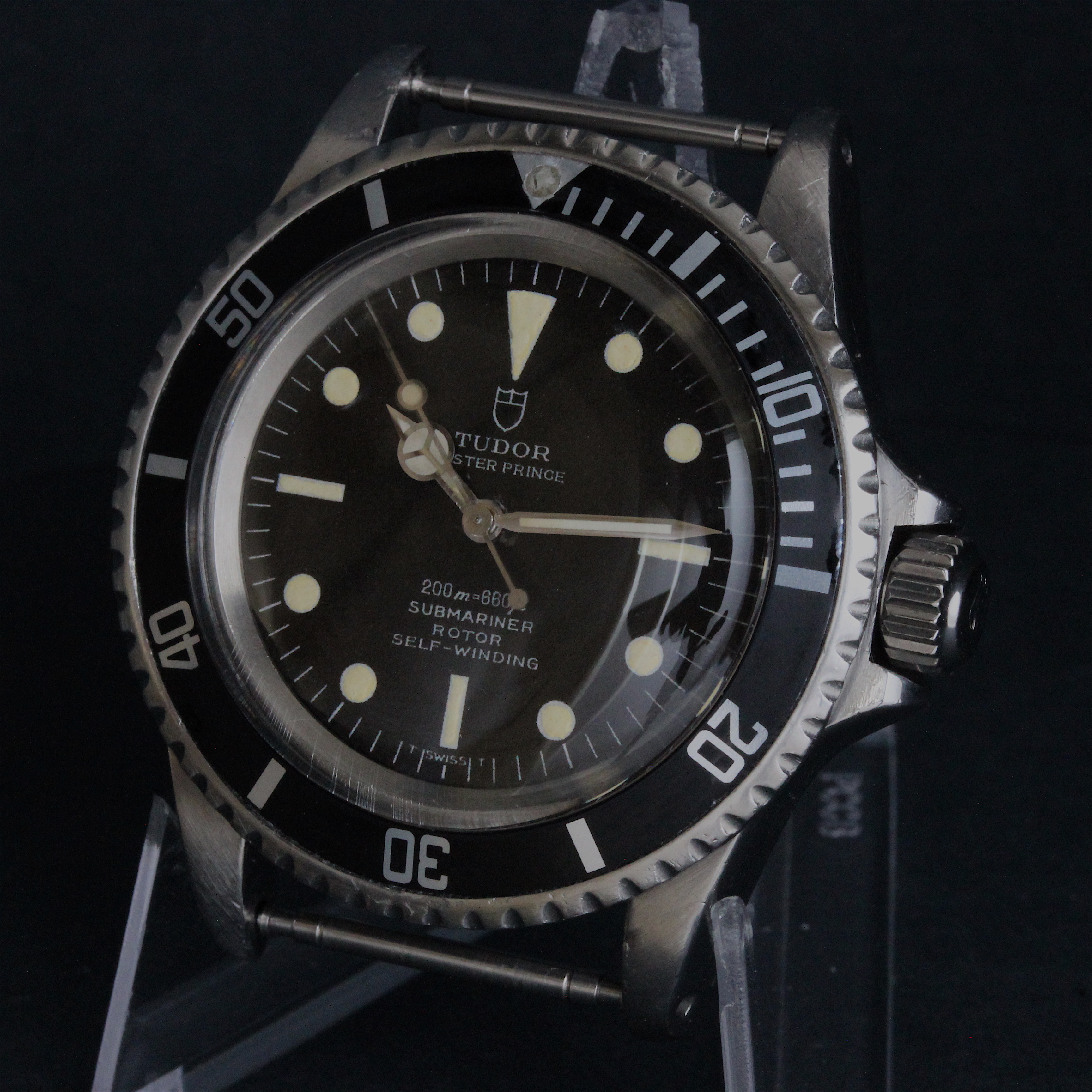

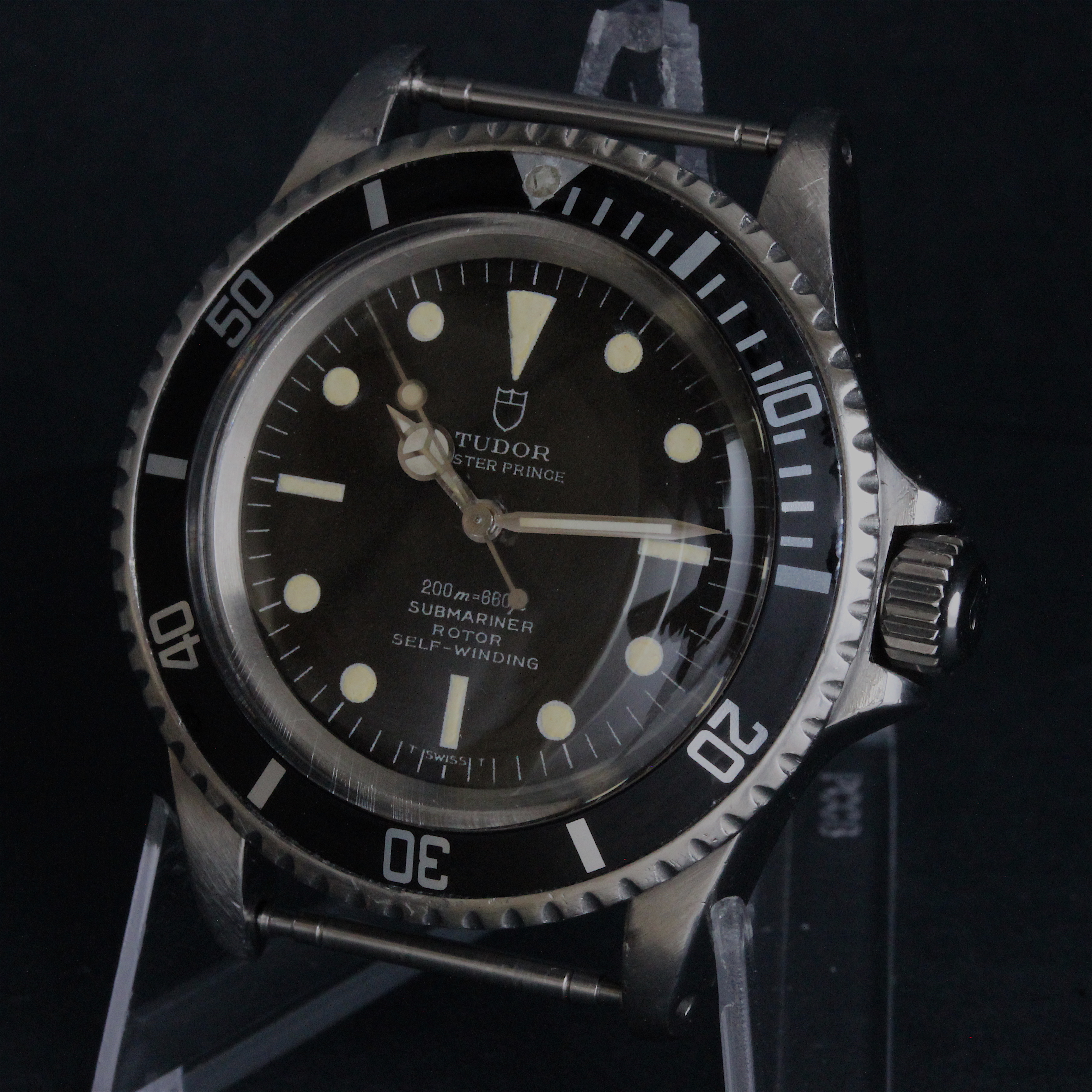

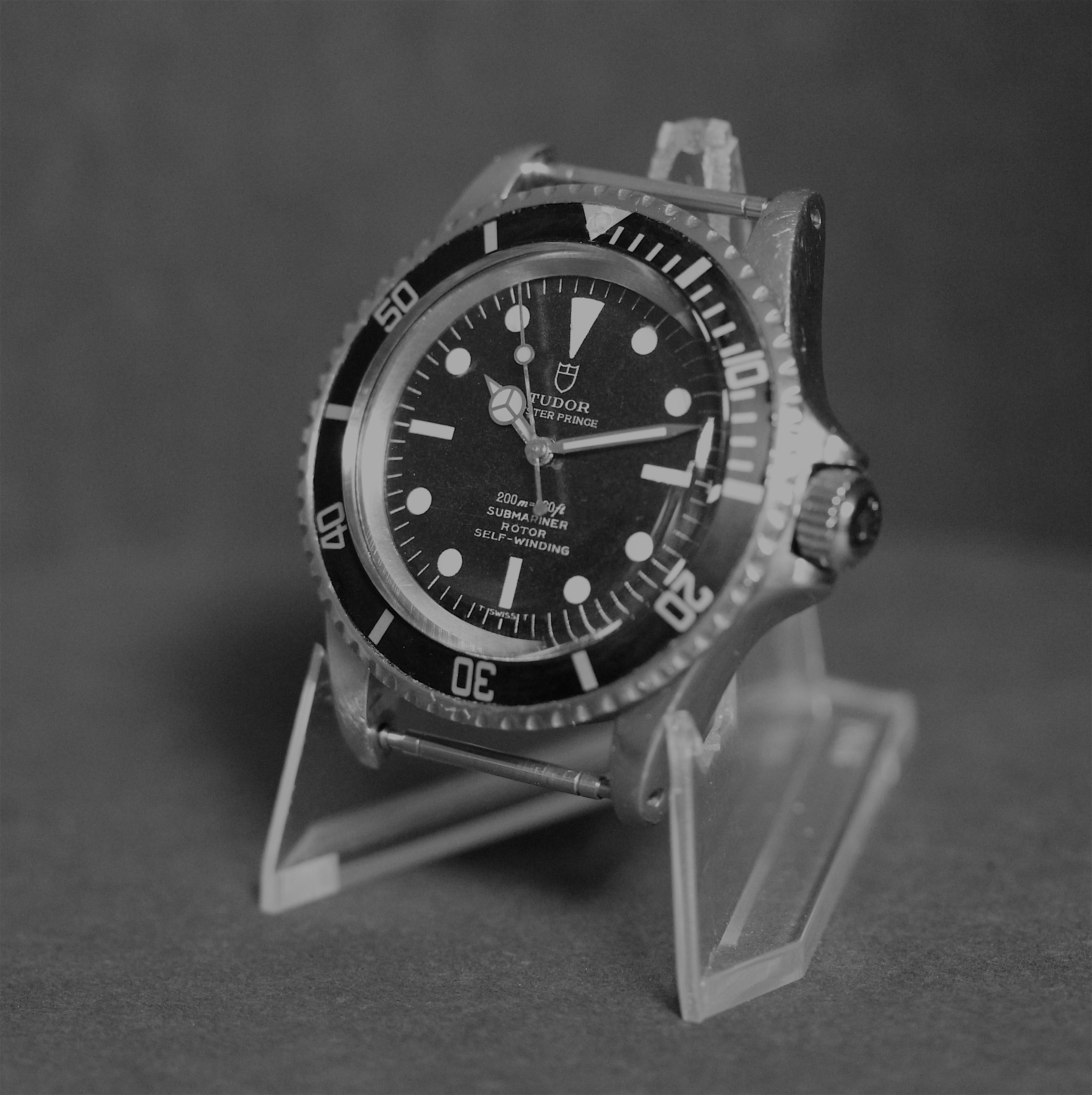

The time has come. All finished and ready to go home.
Darn, still got glare/reflections 😡.
Back to photo school for me.
18,803
39,062
Looks good Jim, very moody
Errr, ummmmmm.............................. oh yeah!
That's the look I was going for!
