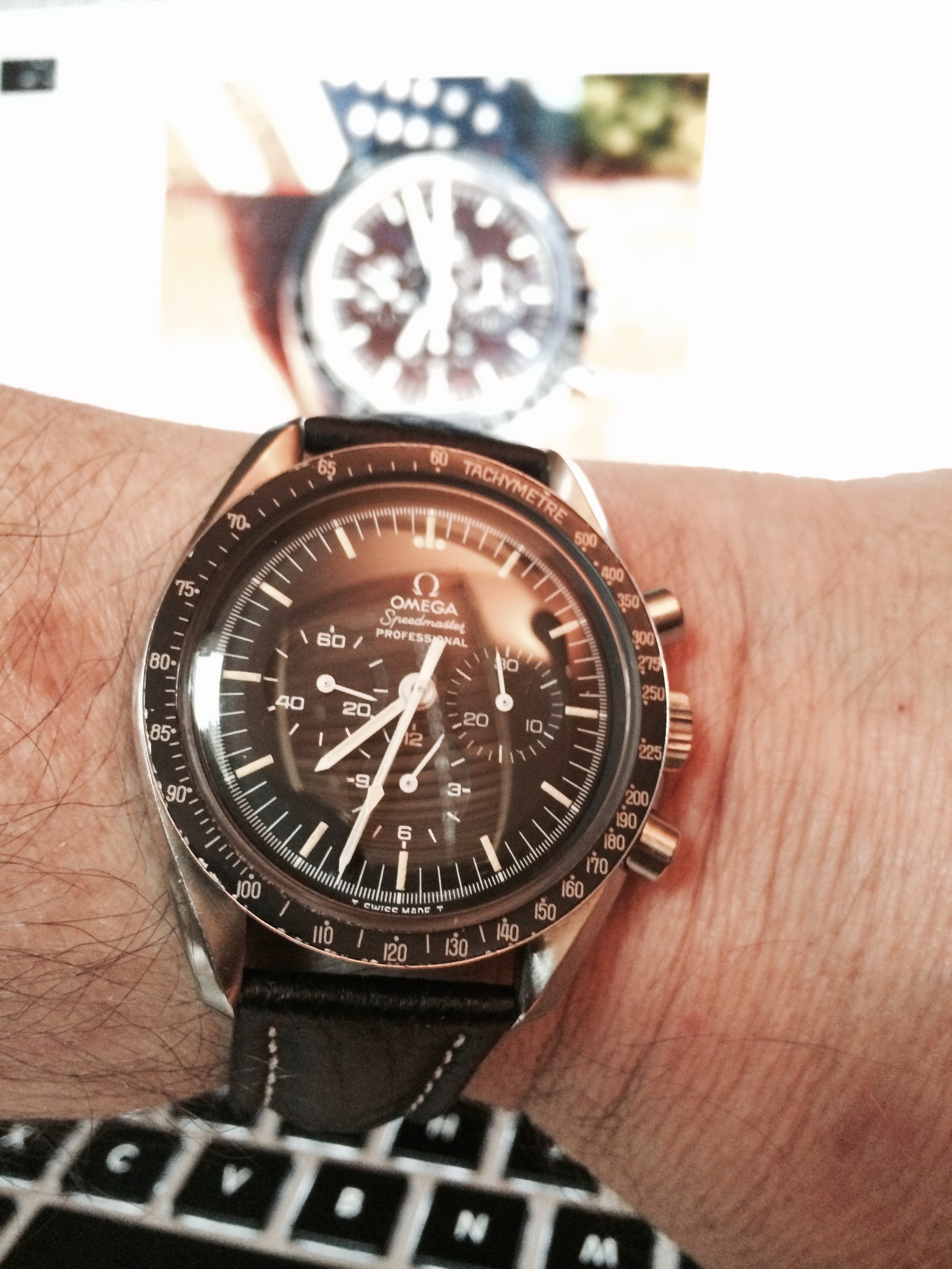

I'm about to request one for my recently acquired 145.022-68. Can I request for it to include exactly what bracelet it was delivered?
There seems to be various bracelets that could have possibly come from Bienne with this model.
It would be nice to know if mine is original to my particular later serial number, 277xxxxx
I'm well aware that these may have come with various different bracelets, all of which were correct.
Sometimes, if the watch was paired with a bracelet on delivery from the factory to the retailer, a note would have been made on the production sheet about it and it will appear in the Extract. Most Speedmasters seem to have been paired with bracelets at the retailer though, upon delivery to the customer, so this information wouldn't be available in an Extract. So - best of luck to you, but don't be disappointed if you don't receive that information!

All -74s had the small-S C2 dial, and earlier -76s did as well. There aren't any tall & open S -74s from the factory
Yup, just checking as I was not aware that -74 went up to 39m also. I was curious to see if the watch was all original.
2,808
8,339
Thanks more proof that mine was sold in 76.
I assume you have the small S dial then. The S does not drop as far as the tail on the p.
Yes
