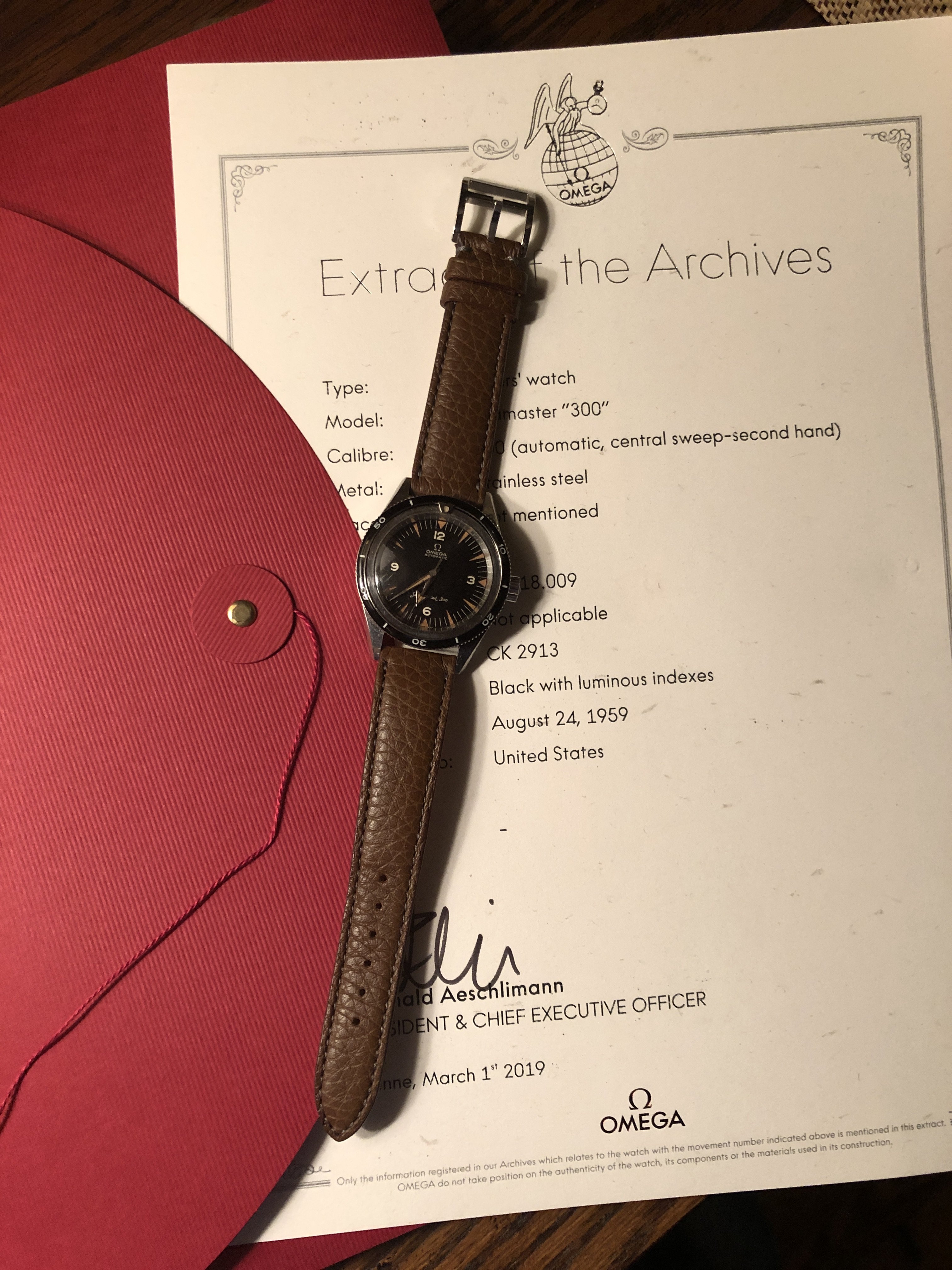

Wow, literally just received the Archive today (Apr 15) after having ordered it around Christmas. An interesting aspect is that it was signed 1Mar2019, so it took another six weeks to make it from the President's desk to my door. Must have been mailed across the Atlantic via an actual hippocampus!! 😉
2,680
9,840
Ha, mine was in the same batch. Arrived today, took nearly 3 months (ordered 2/1/19). I think they sign these on a regular schedule so they are done in batches...which would explain why some arrive fast and others slow. Depends on the signing date and if yours just missed the last one, or arrived just prior.
and no more wax seals 😀

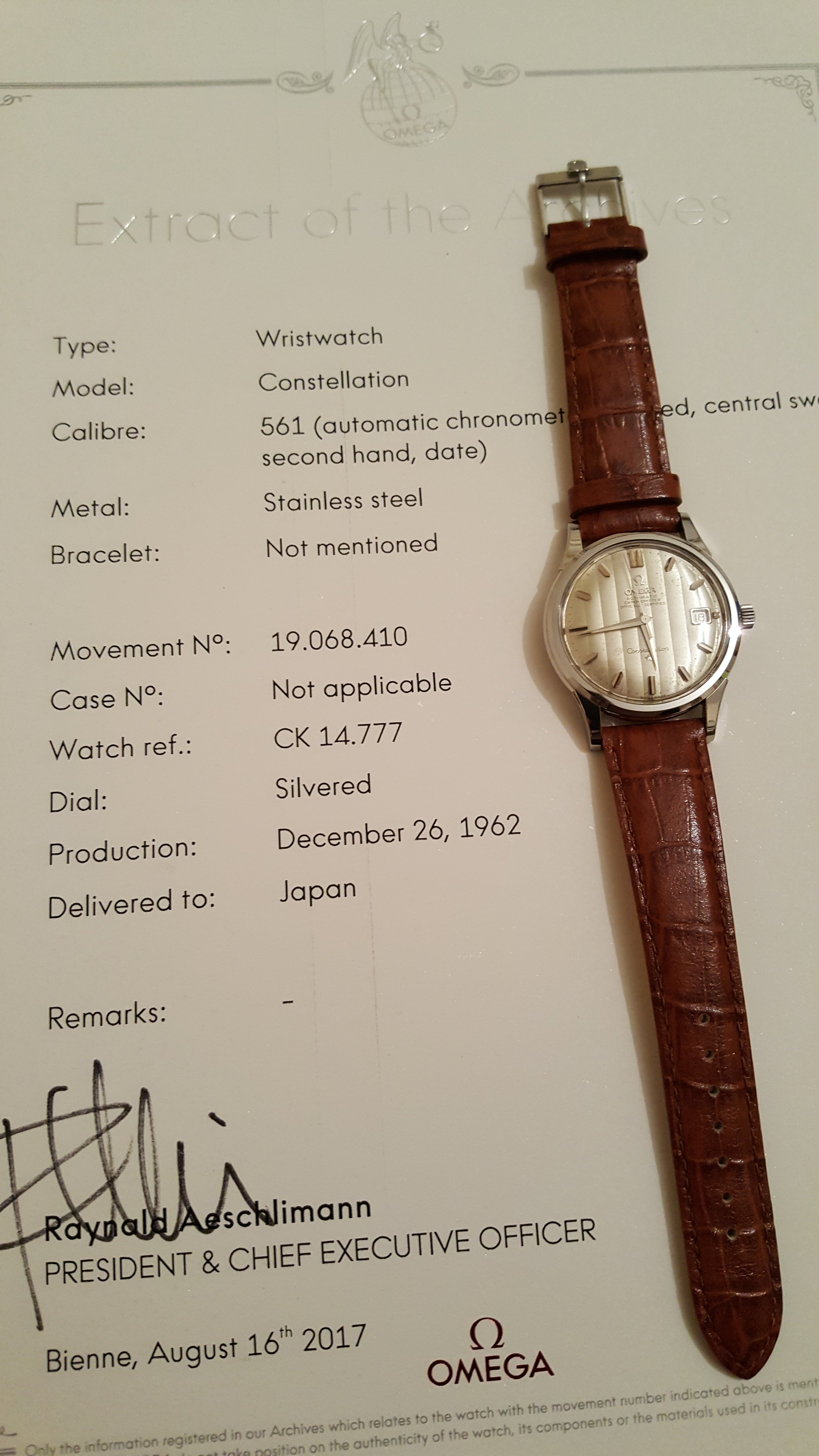

2,808
8,339
I only include movement number in my extract requests and have always got an extract. I like to do this so I get confirmation that the moment left the factory in that reference case. Just sent another request for my latest 14777 👍
Ahhh, there's my birth year Omega in your hands.
