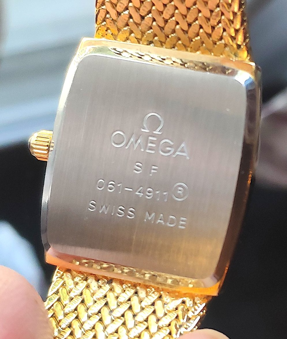

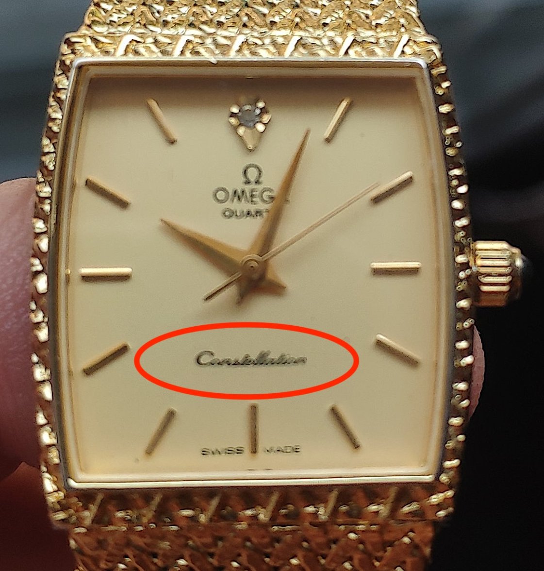

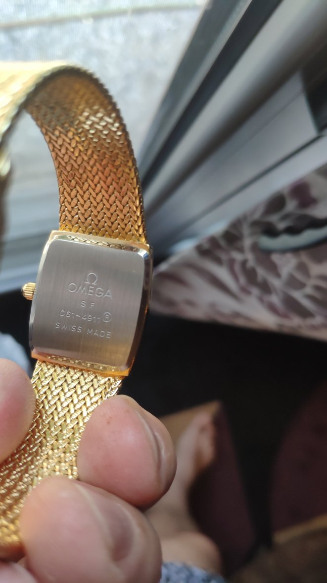

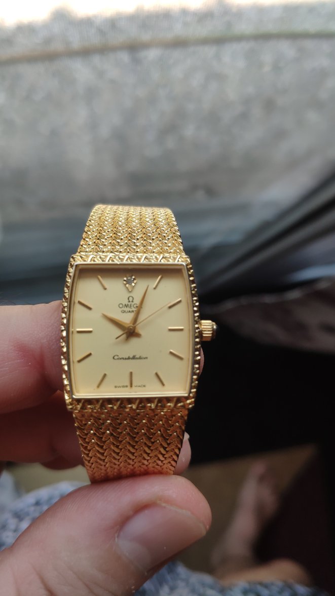

Hi guys, I just bought an omega consellation but I dont know its value,I bought it for 100$ because is at a mint condition. Can you help me please, thank you.

Its value to you was $100, unfortunately I think its value to most here would be somewhere between $0 and $10 as I fear it is a fake.

99.9999988887777% sure it is a fake
either fake or real its' worth about $2USD

The thing is even has a sapphire on the winder.

First, I would recommend that you do not trust immediately any listing or seller using the word "Rare" or something similar. Lots of sellers like to put that everywhere just to get eyes and searches on the product.
That watch looks like a fake to me too. The Constellation font is like anything I have seen, and a reverse image search shows me a lot of similar-shaped examples, but miles ahead in terms of the quality of the dials. You can open it and show the movement to see what is in there, but I wouldn't expect much.

It is without doubt a fake or more correctly, a counterfeit.
First indicator of a counterfeit are the markings and case reference on the outside of the caseback.
Omega hardly ever did that, and never for Constellations that I've seen.
When we decipher the case reference 061.4911 as per "Omega Codes for 7-Digit References" we find:
0 - Not found.
6 - Self-winding without seconds
1 - Non-water-resistant
4911 - Spurious case number
In addition, the Constellation font on the dial has never been used by Omega.

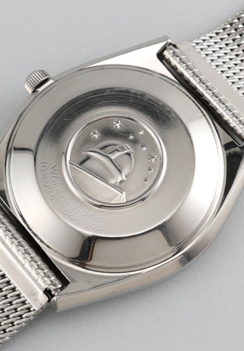

Case Ref. 168.(0)015 and -25 both had the case reference on the outside for the convenience of watchmakers needing to know which Omega tool was required to open the case.
Of course, the OP’s watch is certainly not one of these.
gatorcpa
Thanks for that. I'm aware of many of the Unishell/Unicoc cases with external markings. Wasn't aware until now that Connies were too.
