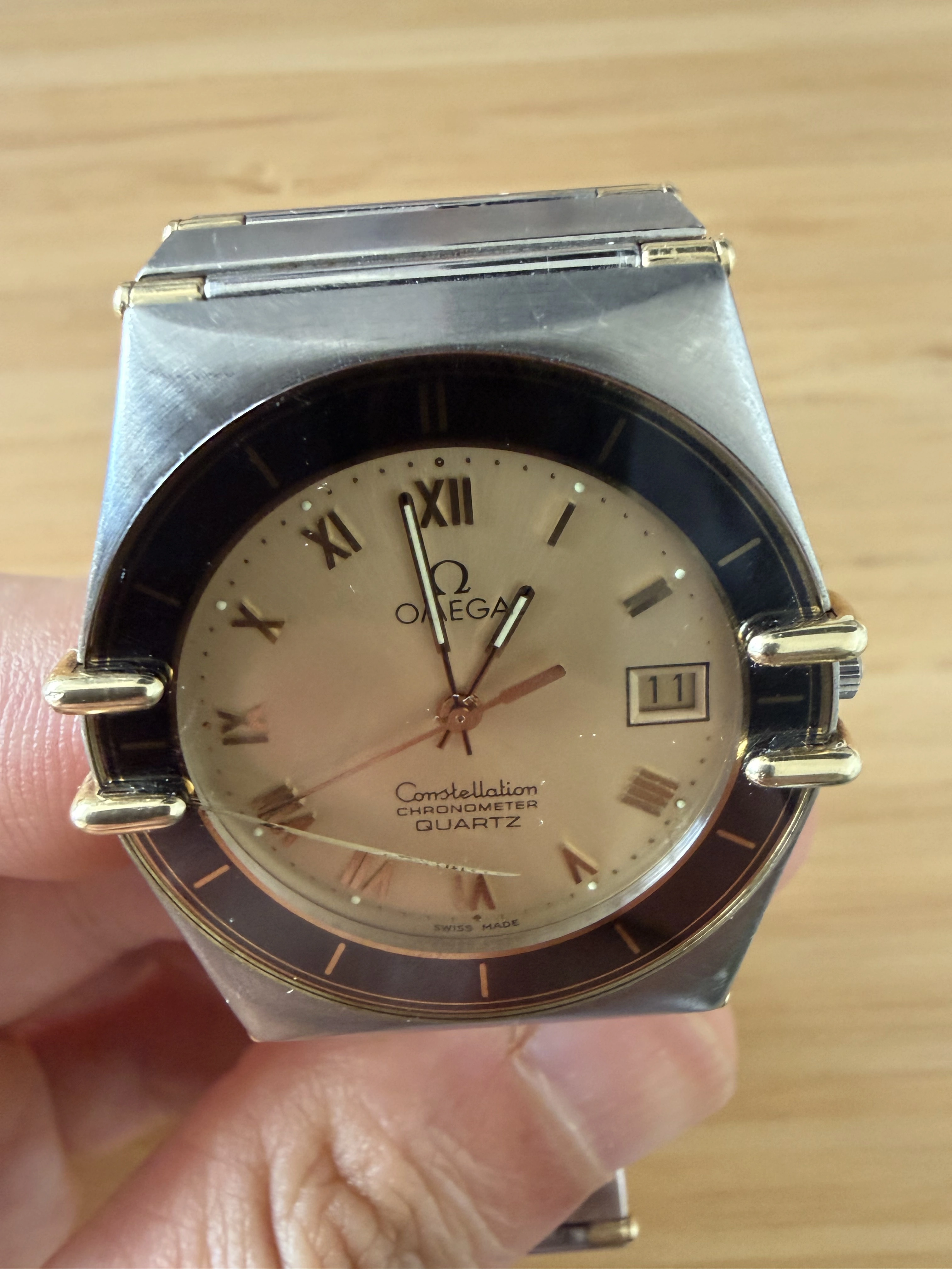

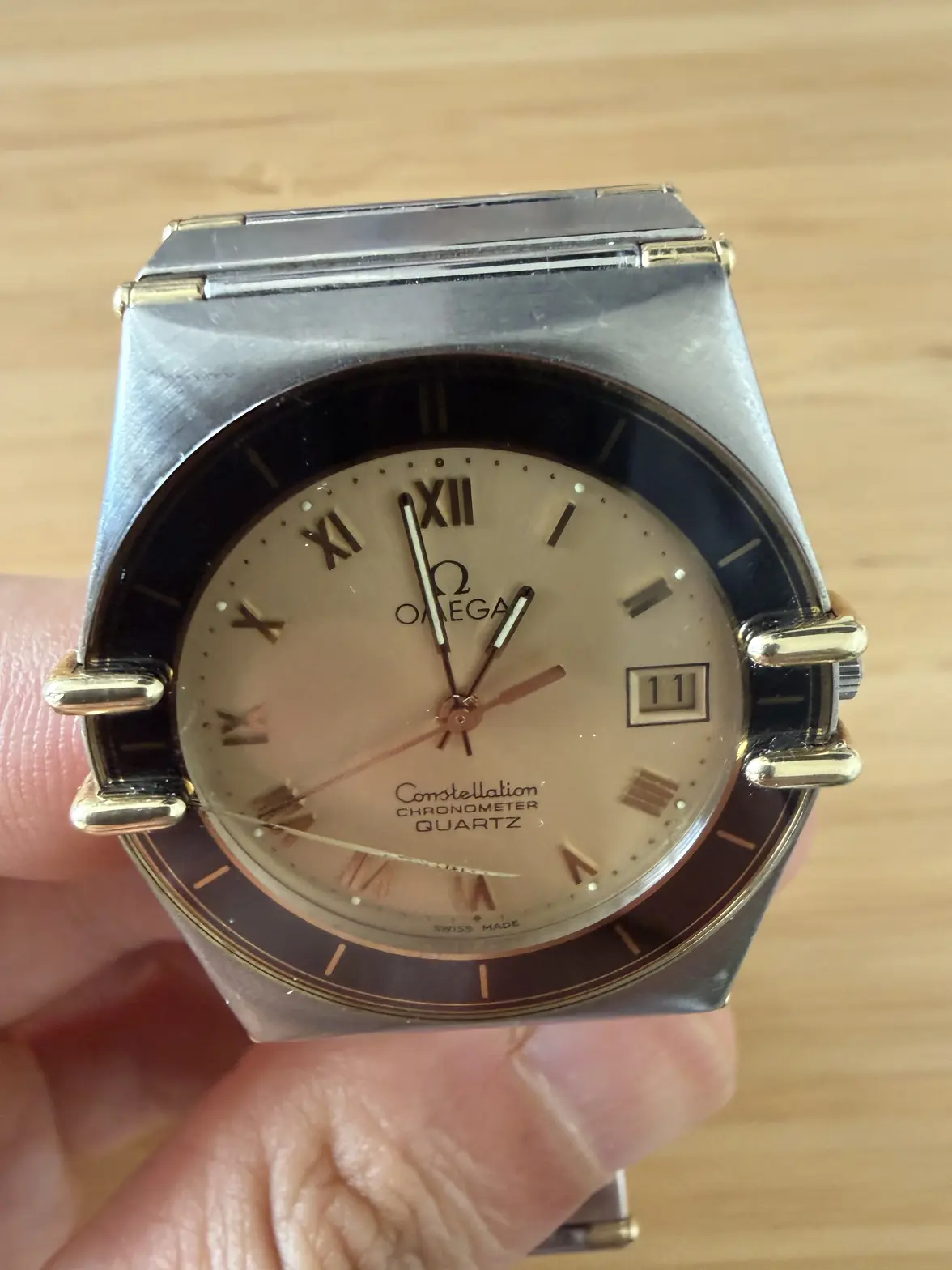

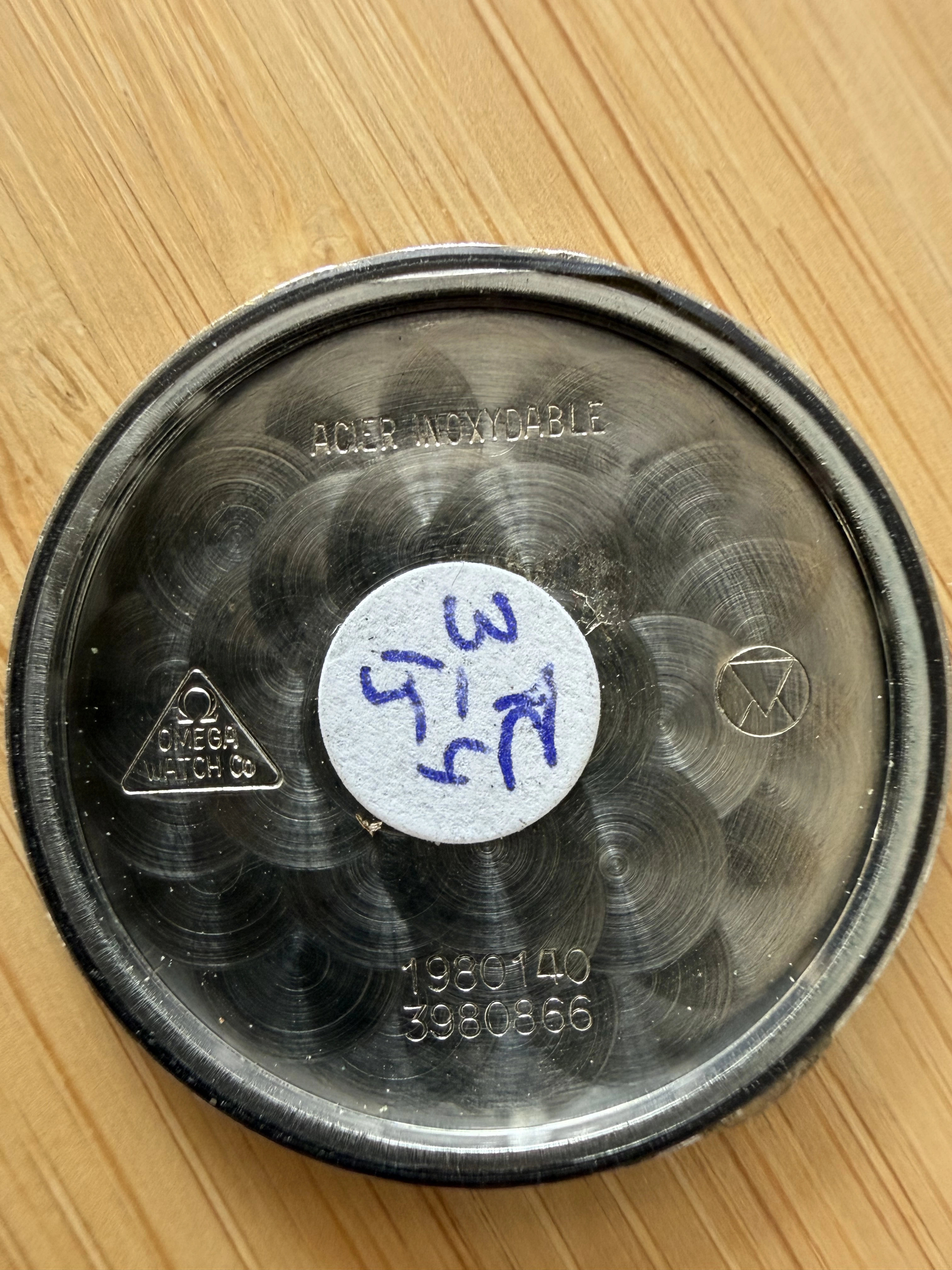

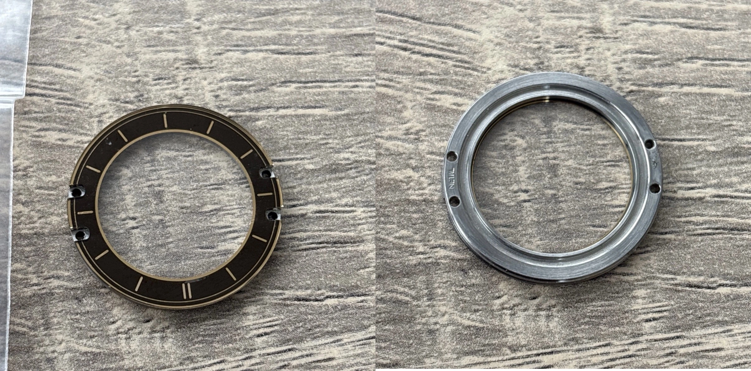

Hello,
The crystal on my Omega Constellation Manhattan Ref 198.0140 / 398.0866 (bi-tone) has cracked.

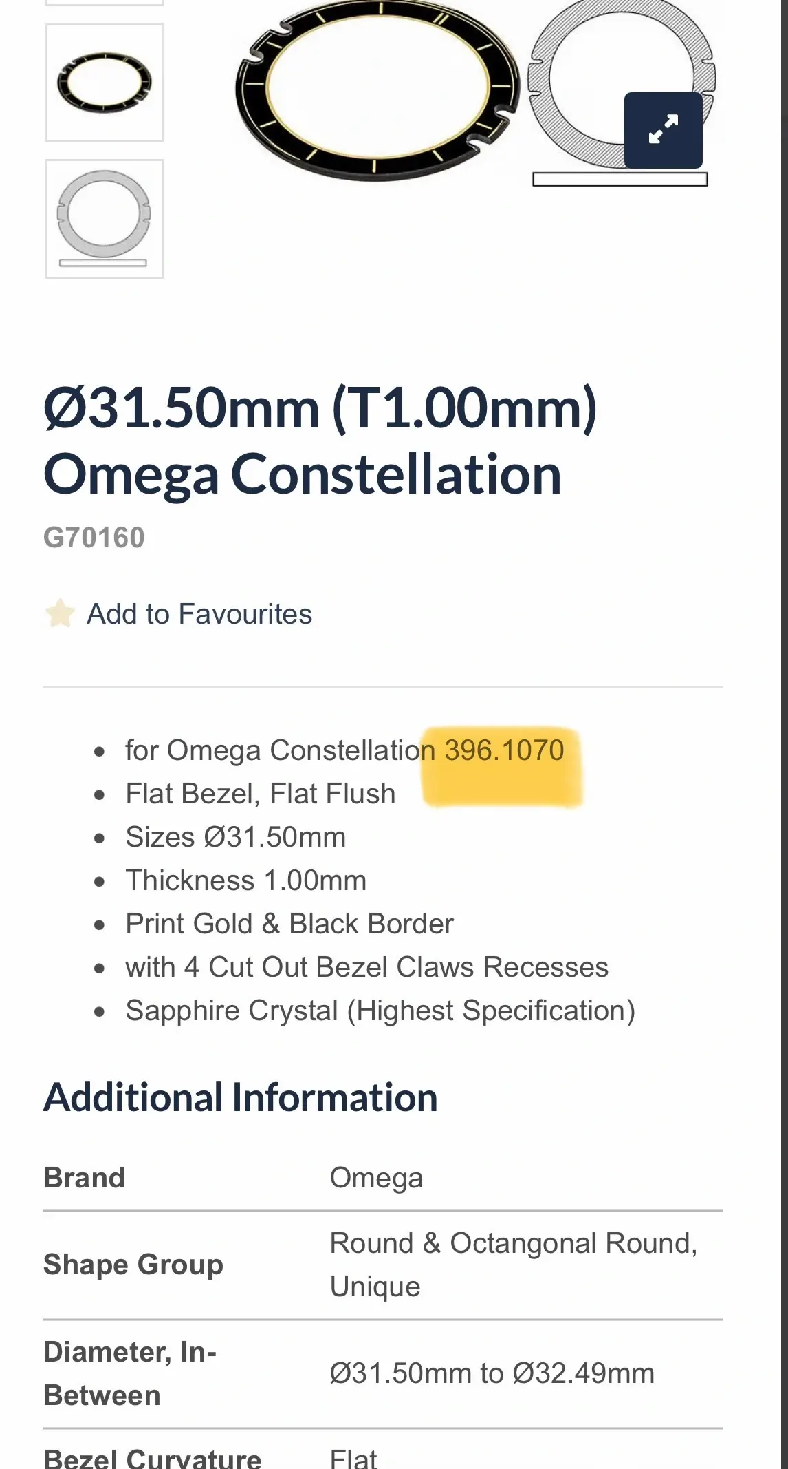

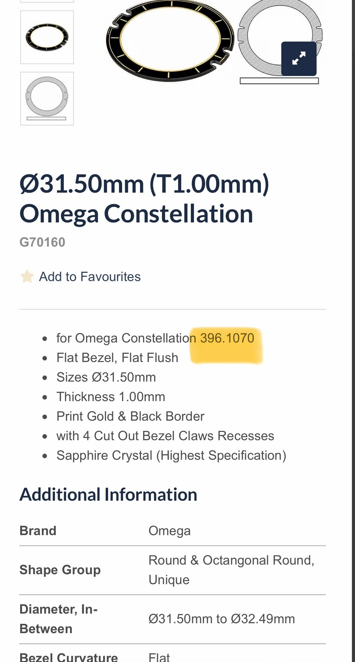

I found a replacement that is for 396.1070 which seems exactly the same part (G70160).
I’ve measured my crystal with the calliper (as it sits slightly proud above the case) and it’s exactly 31.5mm.
Would someone be able to confirm this is indeed a good replacement?
One other thing - will it require a gasket change? If yes, would someone be able to help with the part number for this?
I really appreciate your help.
Thank you

Hello,
Firstly, thank you so much @ErichKeane and @Archer for replying. I am really grateful for your effort.
I’m a bit confused about the actual part, as my watch has a crystal that has a bezel printed on it (crystal with embedded bezel) exactly like the one I’ve attached in my first post, while the one mentioned (062SN0556) is a bare crystal that seems to be on Constellation Manhattans that have the metallic bezel.
What I am getting wrong here?
I read the other post mentioning two crystals but couldn’t understand exactly how that actually works on this particular watch.
Thank you

For further reference, this is the same type of crystal (plus metal on the back) but in 25mm (the smaller version of the same watch):

Looking at the Omega Extranet, when I look at the bill of materials for the case number you have given, it gives 2 different configurations. One with the metal bezel, and the other with the bezel printed on the crystal. I've never seen them do that before, so initially it was a bit confusing.
So the number I gave above is for the metal bezel version - sorry my mistake.
The crystal with the printing is 062SZ0556002.
12
Thanks! Does it show whether this configuration also comes with a gasket that will have to be changed with the crystal?
30,211
78,001
From hat I can see it appears there is just and O-ring that goes under the crystal - 088NS0804
