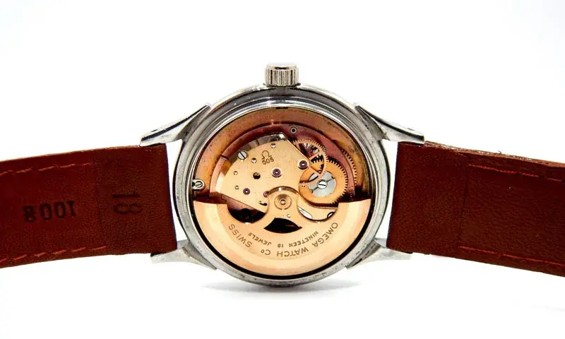

First of all, thank you Trev and others for welcoming me to this forum. As for the brand, I'm a relative newby although I've been collecting for approx 30 years and to date I own 2 Omegas; SMP 2254 and a Globemaster. It was the latter that drew me to checking out the vintage "pie-pan" Constellations and yesterday I pulled the trigger on one without performing due diligence. Thankfully a fellow member and local enthusiast from Calgary expressed some concerns about my purchase.

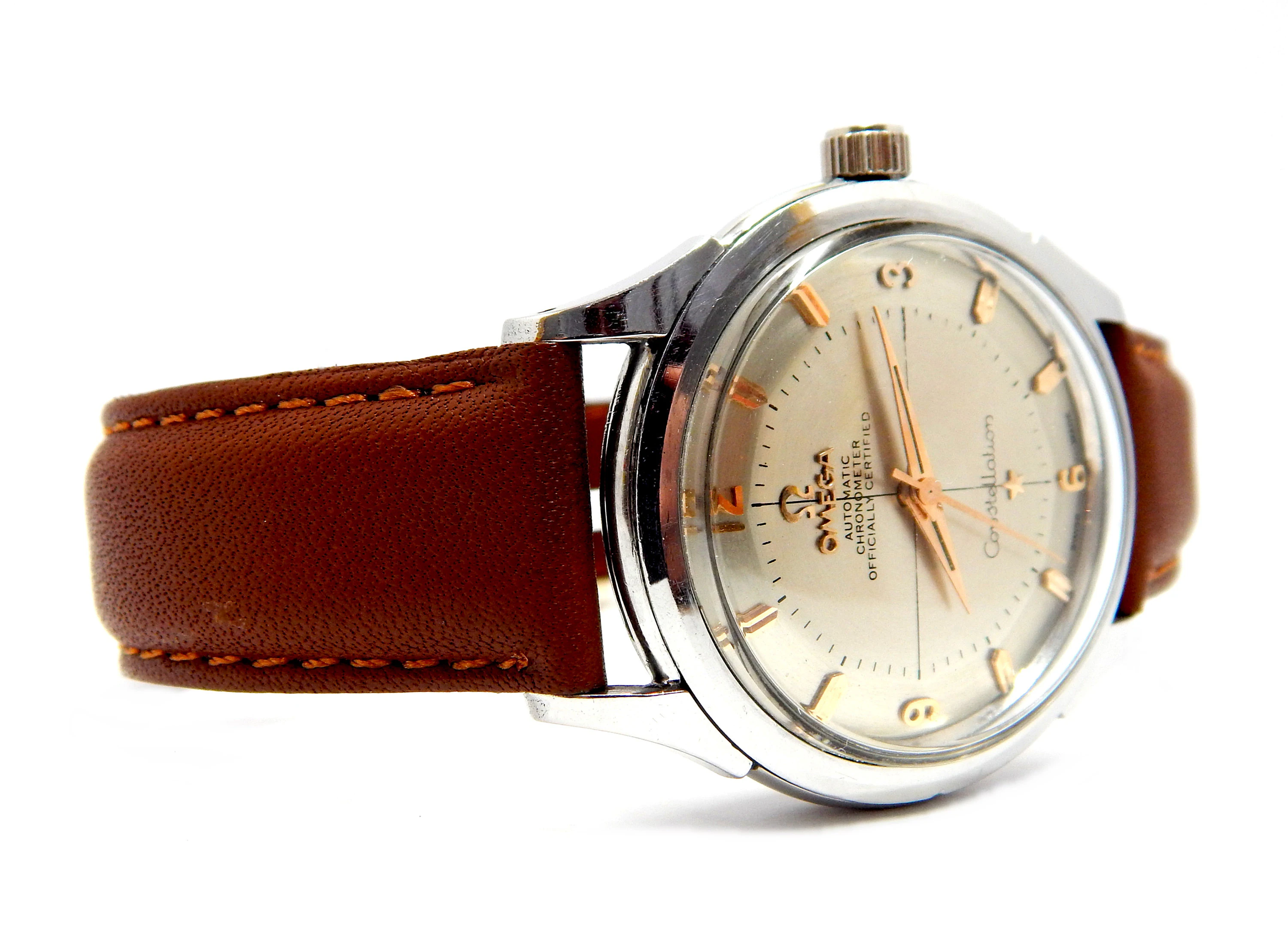

Now I am not accusing the seller of anything nefarious but there were some incongruities I missed because I had my blinders on when I ordered. After addressing my friend's concerns and doing some research I learned that the 505 caliber is a 24 jewel movement and upon closer inspection of the seller's photos I noted the rotor was stamped 19 jewels and the description referenced 505 caliber - 19 jewels. Perhaps at best the watch is a bit of a Franken and I'm more interested in pursuing something genuine. Thankfully the seller has agreed to cancel my order so I can knuckle down and so some proper research. Most certainly the expertise in this forum will be invaluable.
Ok, enough blabber, here are some of the seller's photos;

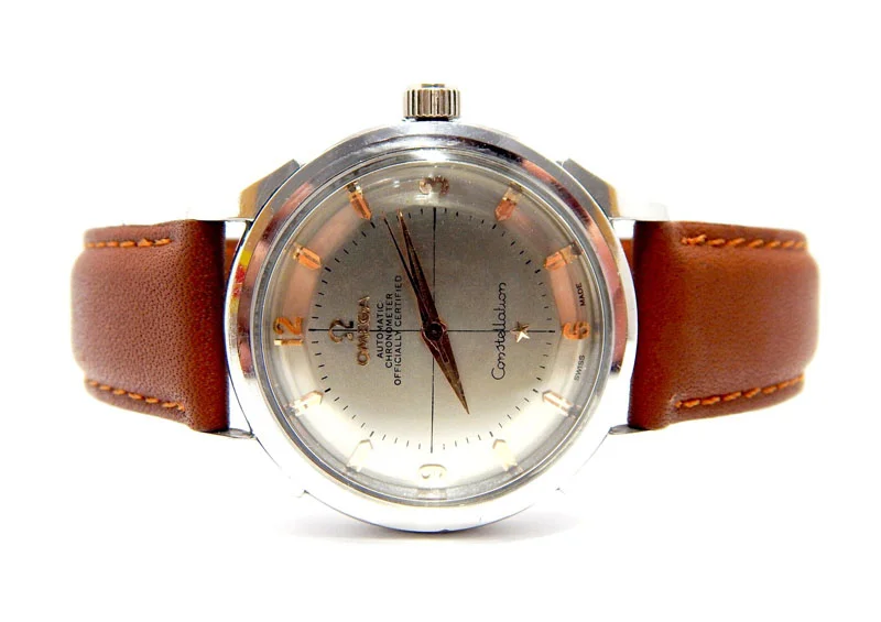

The dial looks a bit suspicious, do you got a straight on picture?

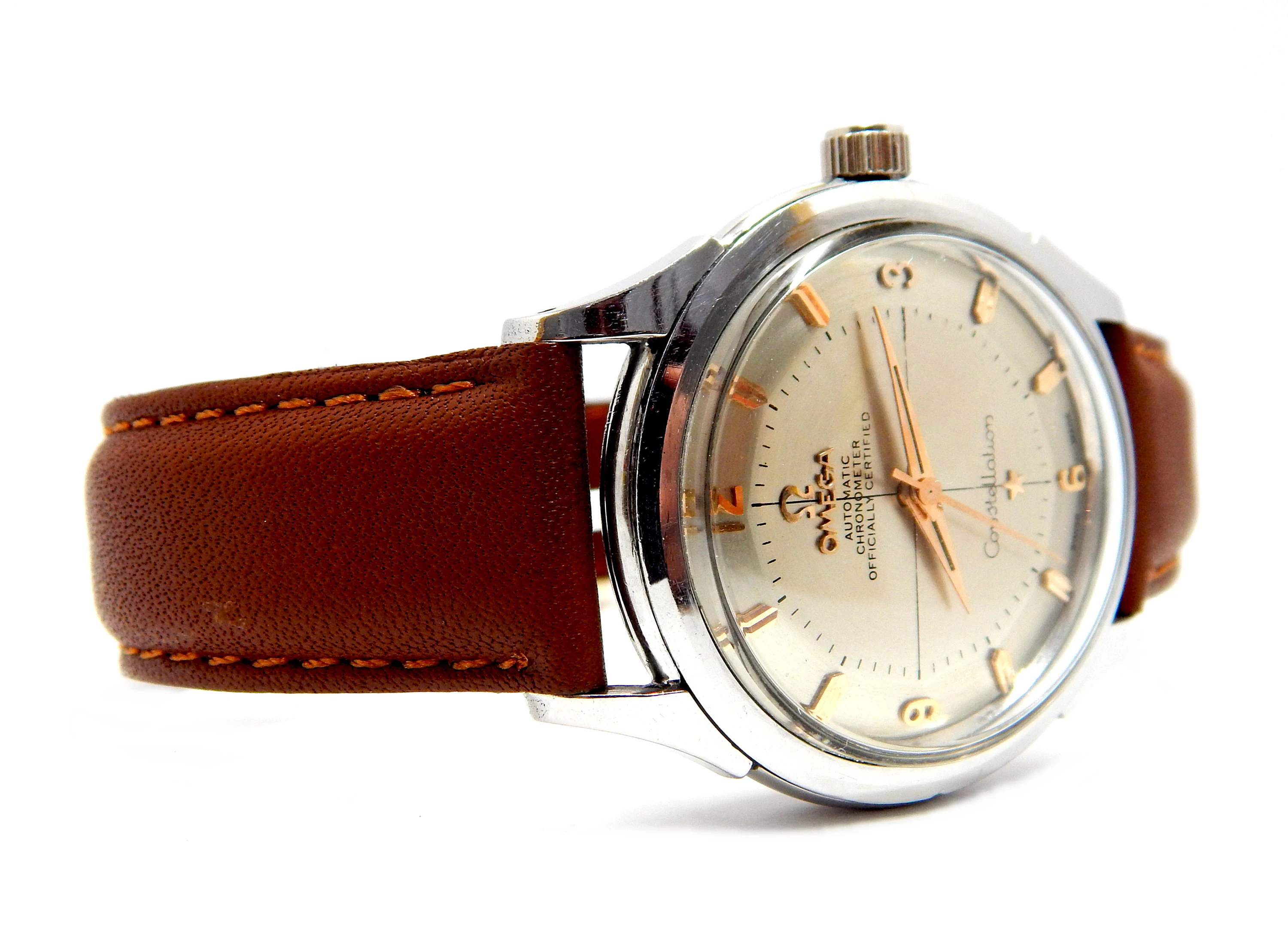

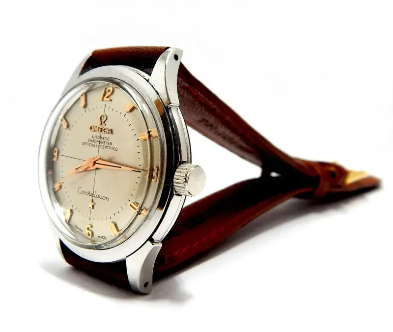

Most likely, the rotor was swapped from a (compatible) 491 or 501 movement. Not the end of the world, but yes, not perfect...and very visibly incoherent with the 505.
Besides, while it's very difficult to see (intentional?) from the side angle, I don't see the proper pie-pan "edge" on the dial. Probably redone.

is it this one from ETSY?
Clear redial IMO
It is the one from Etsy. Glad you were able to provide more feedback for Russ.

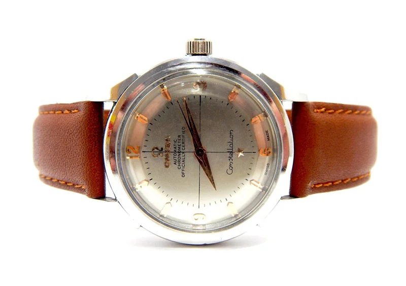

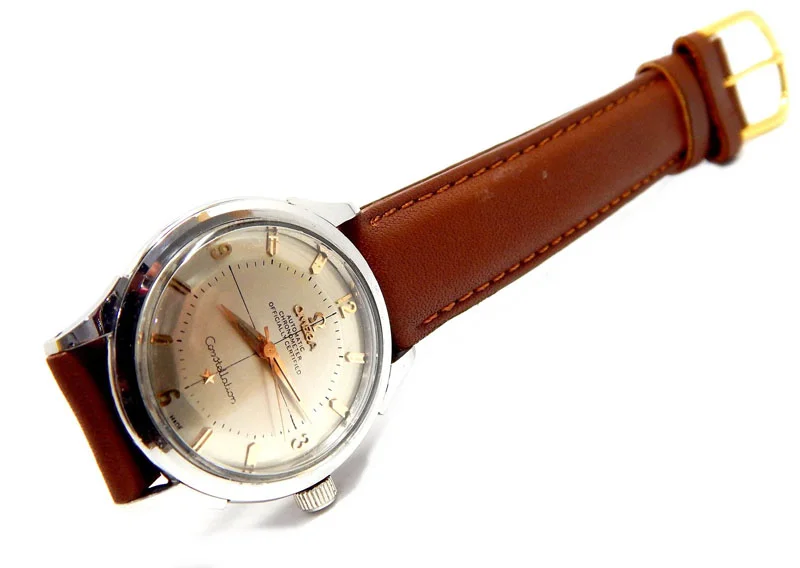

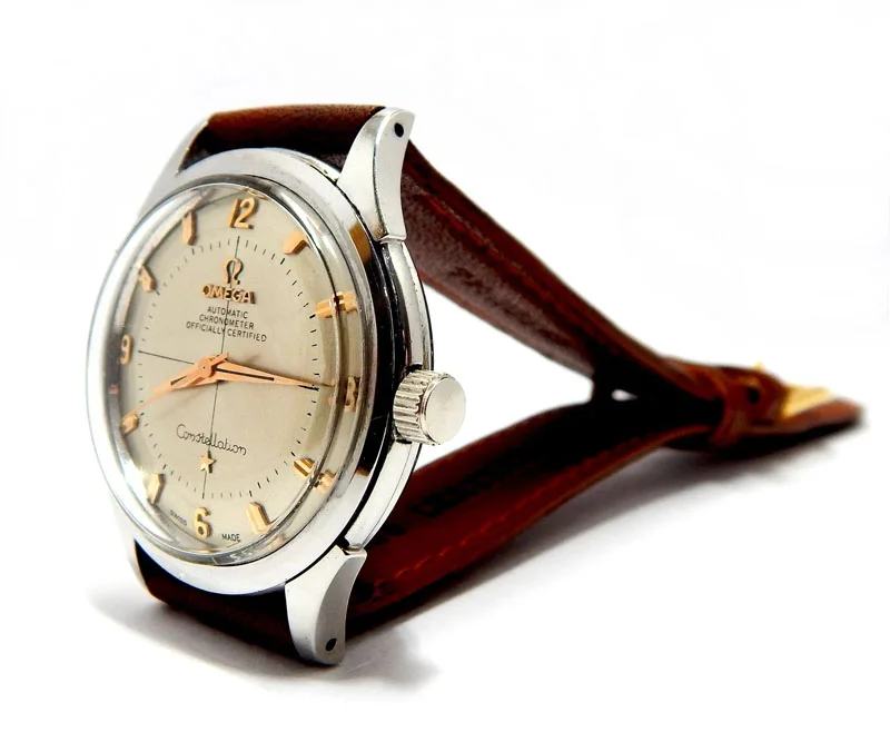

Here's a couple
As said before this dial is redone IMO
Just post the next one on the forum before you waste your money 😉
I would agree it's not the end of the world because some "Frankens" actually do the trick for the owner. The fact I don't know current market prices for genuine vintage pieces was also a mitigating factor. I did do some comparables though and the price "seemed" reasonable. Can't really comment on the edge component of the "pie-pan" aesthetic on this one but it seems more defined than say the edge on my Globemaster 😉
Will do but I'm going to take my time!

The dial is a bigger issue than the rotor, IMO.

Agreed.
@Russ Murray dodged a bullet by noticing the lesser problem
