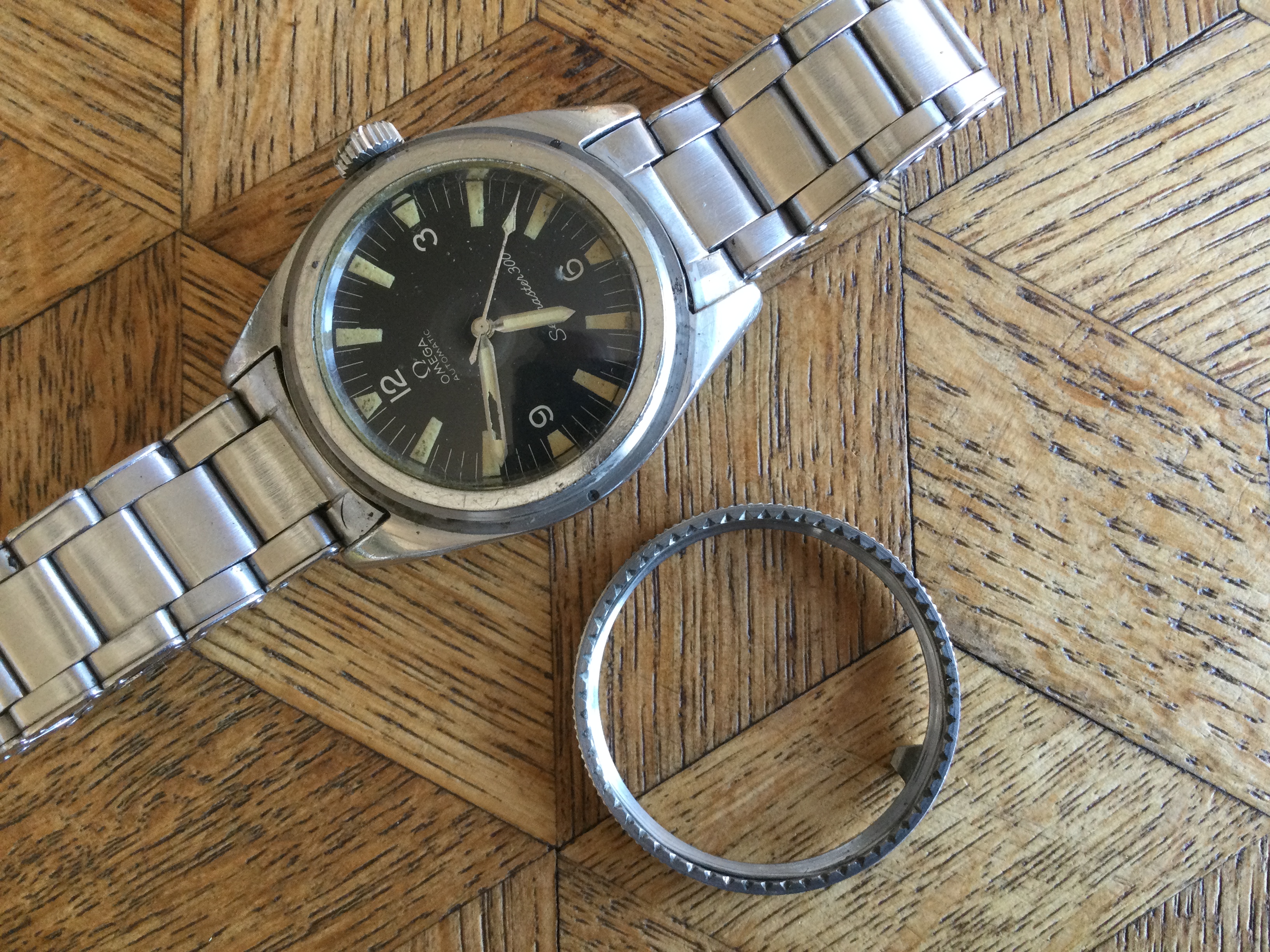

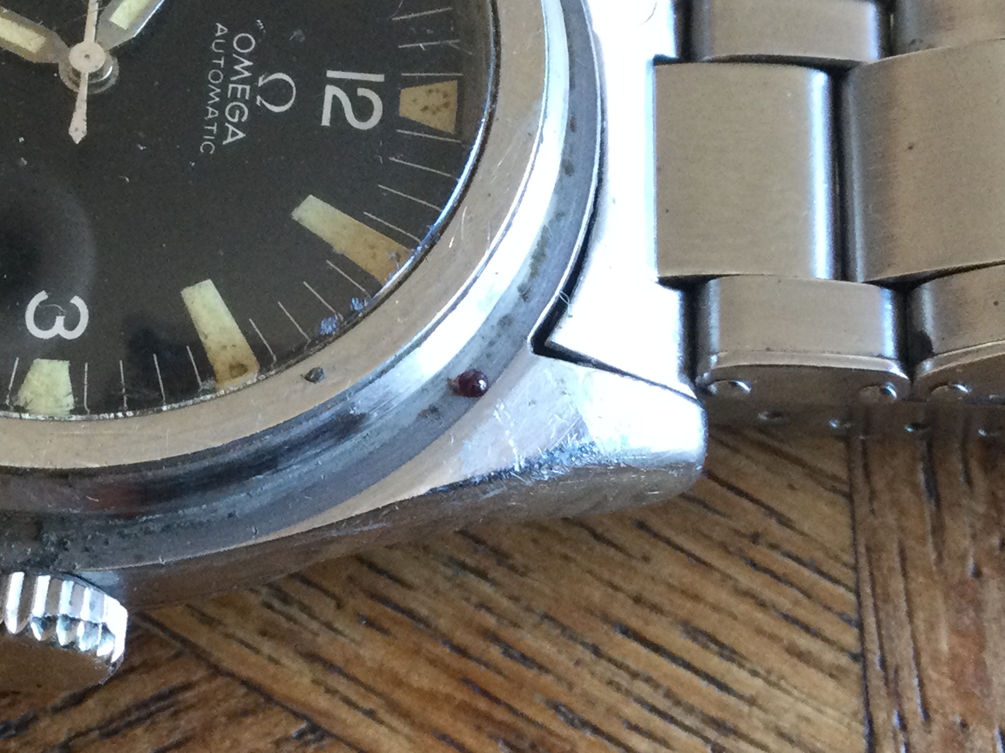

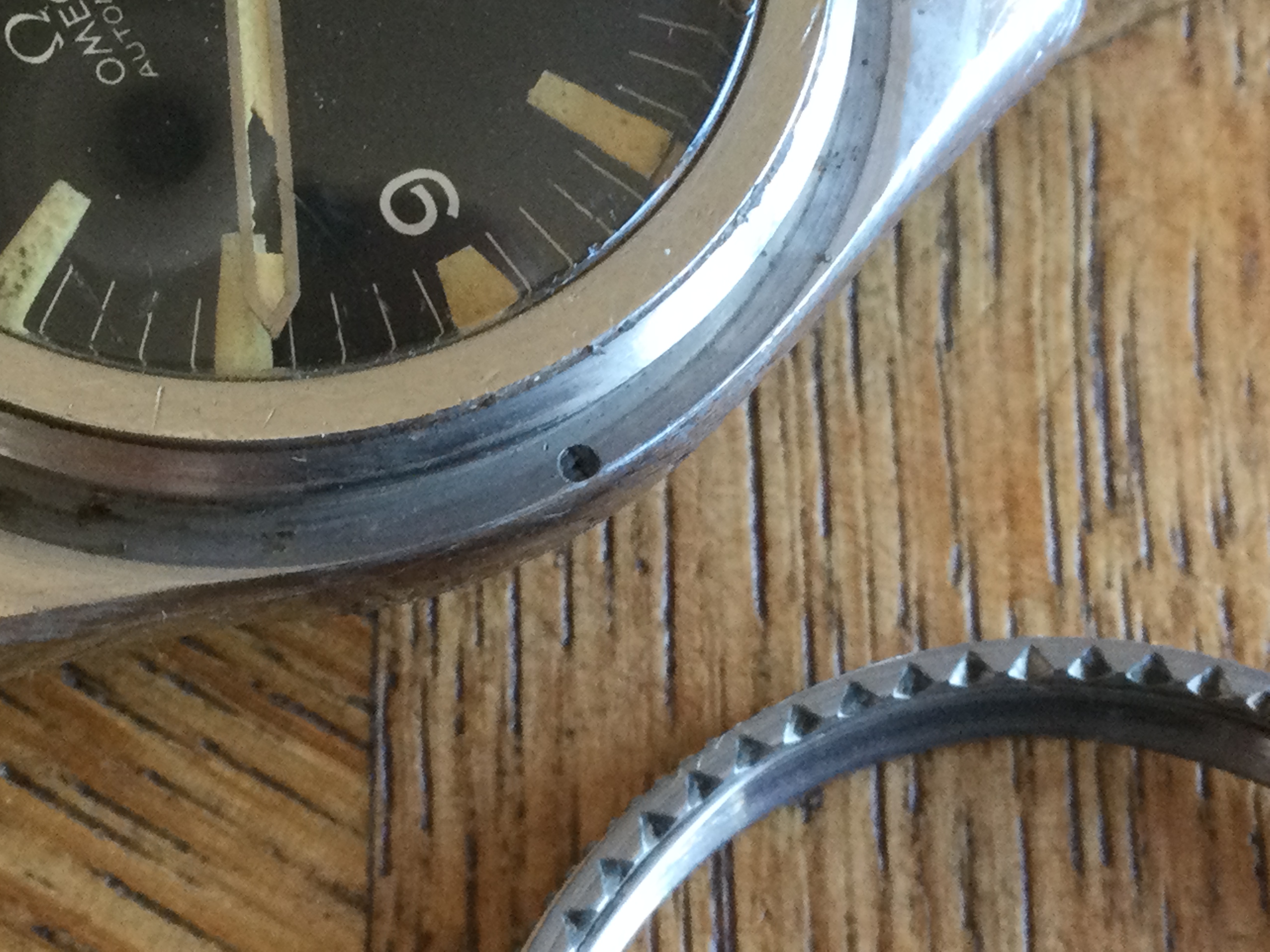

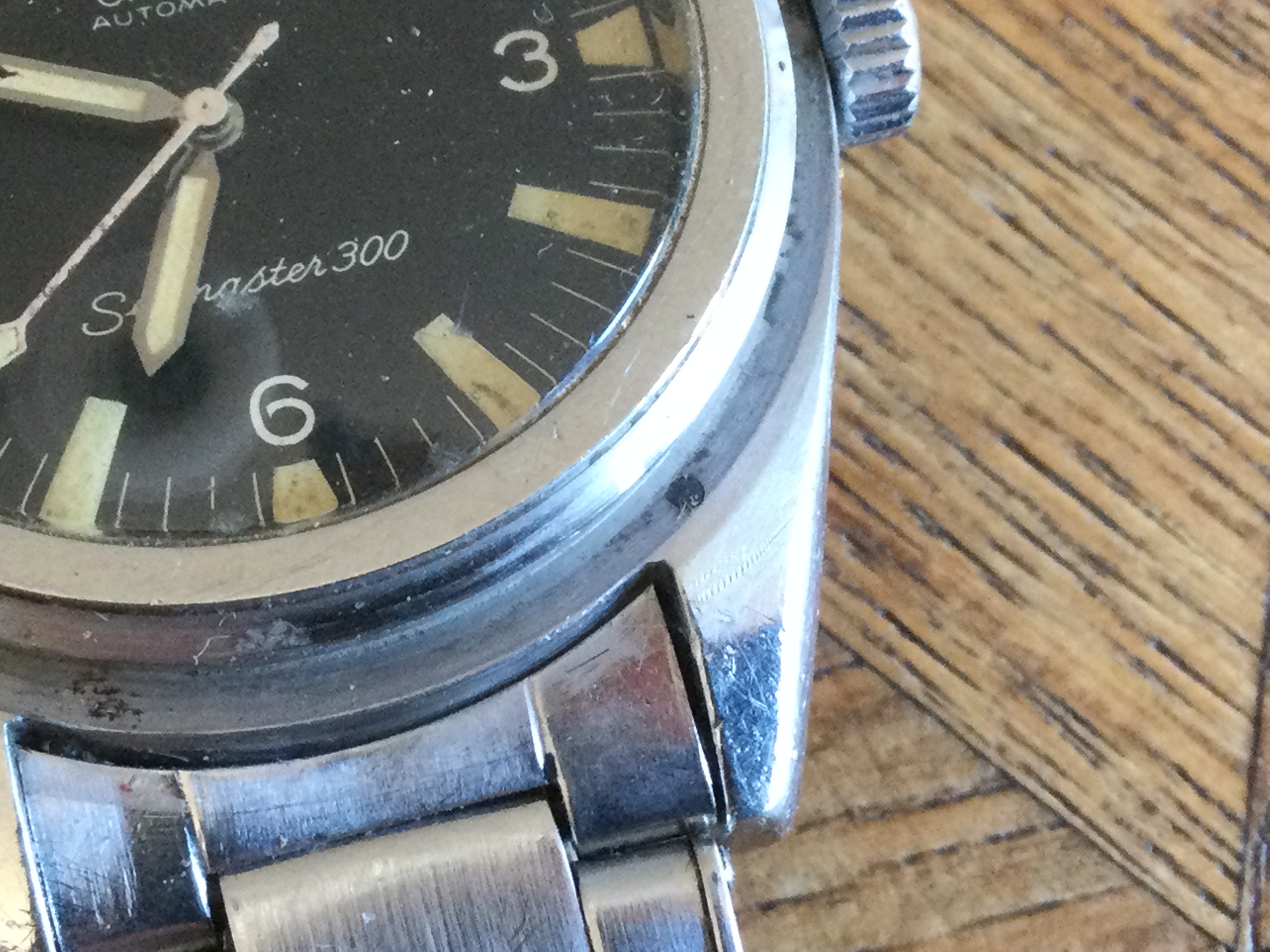

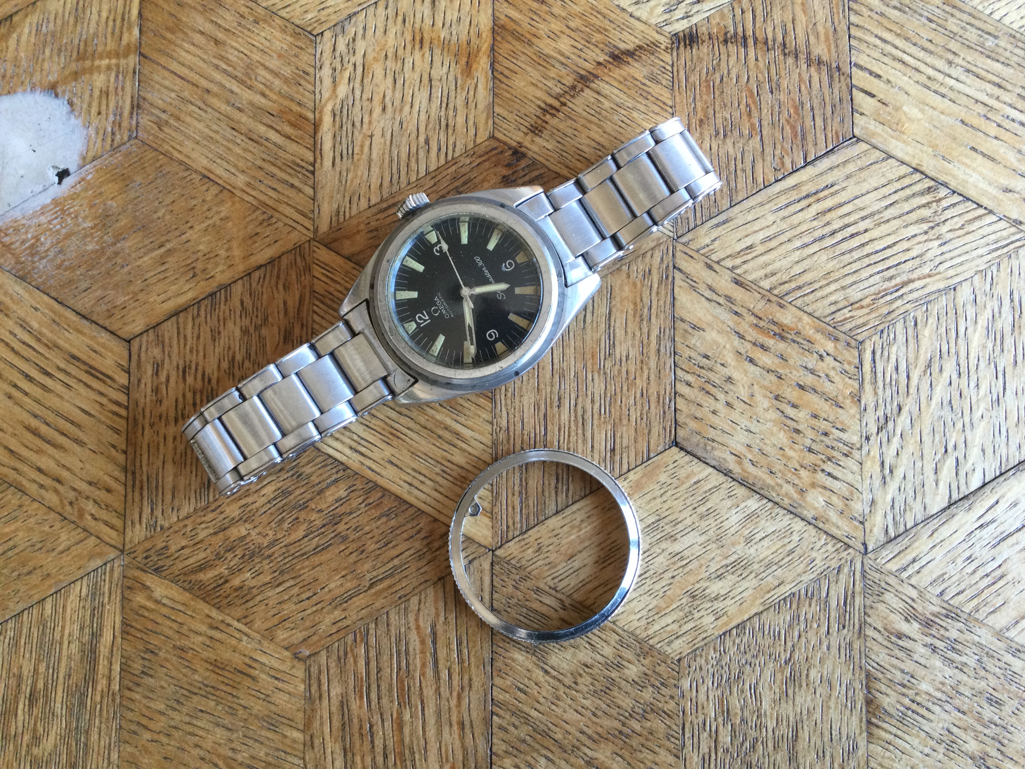

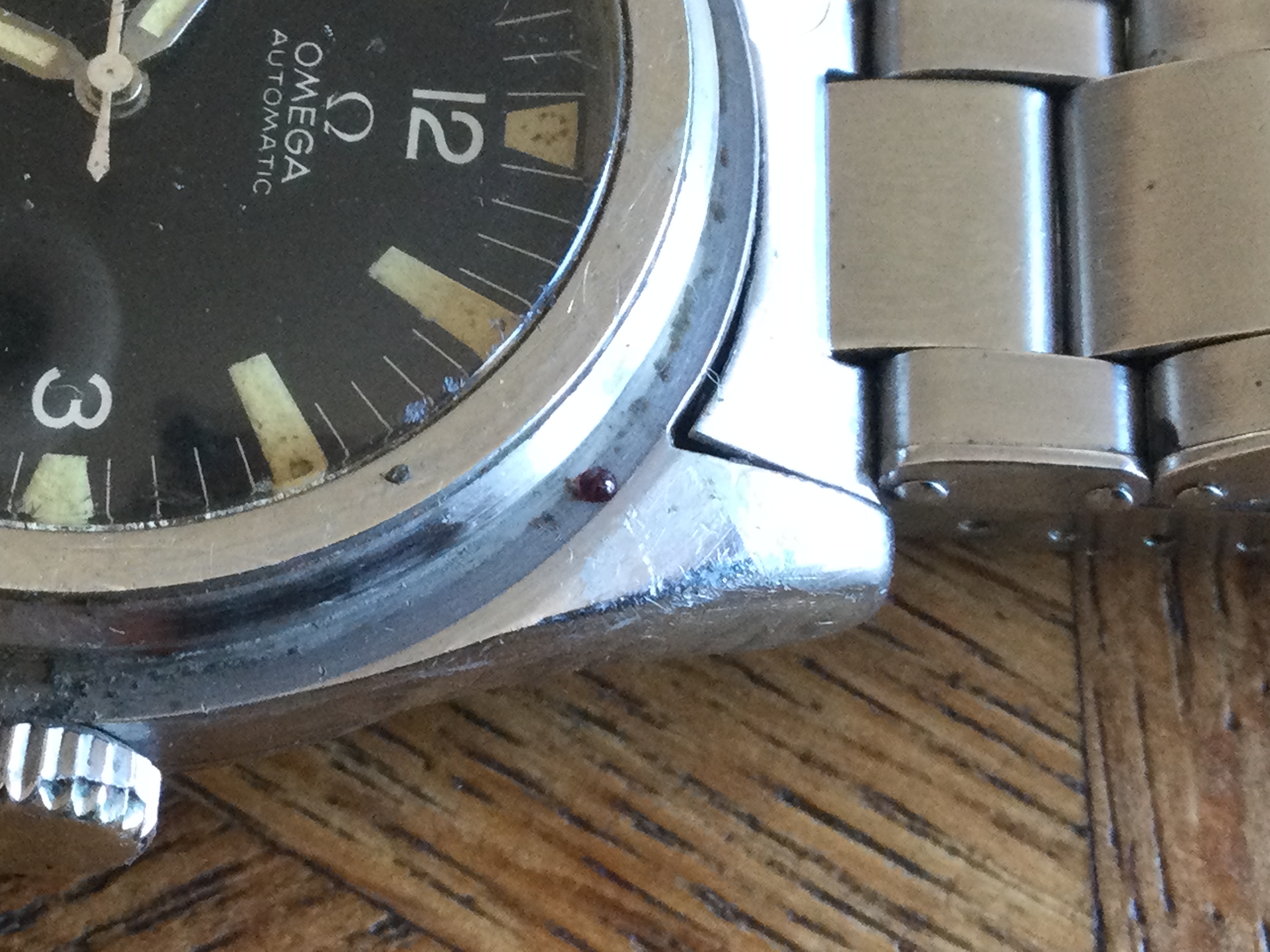

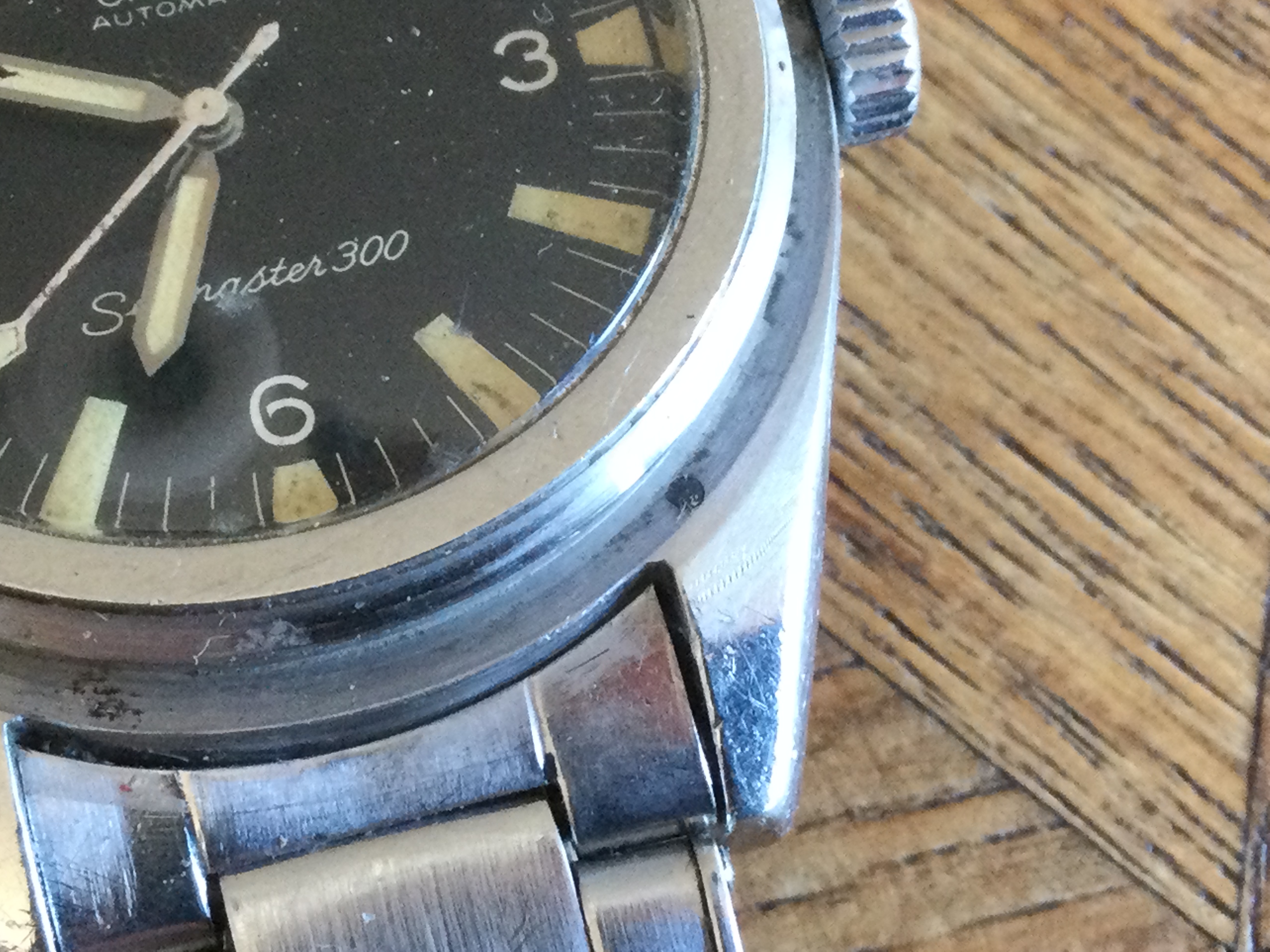

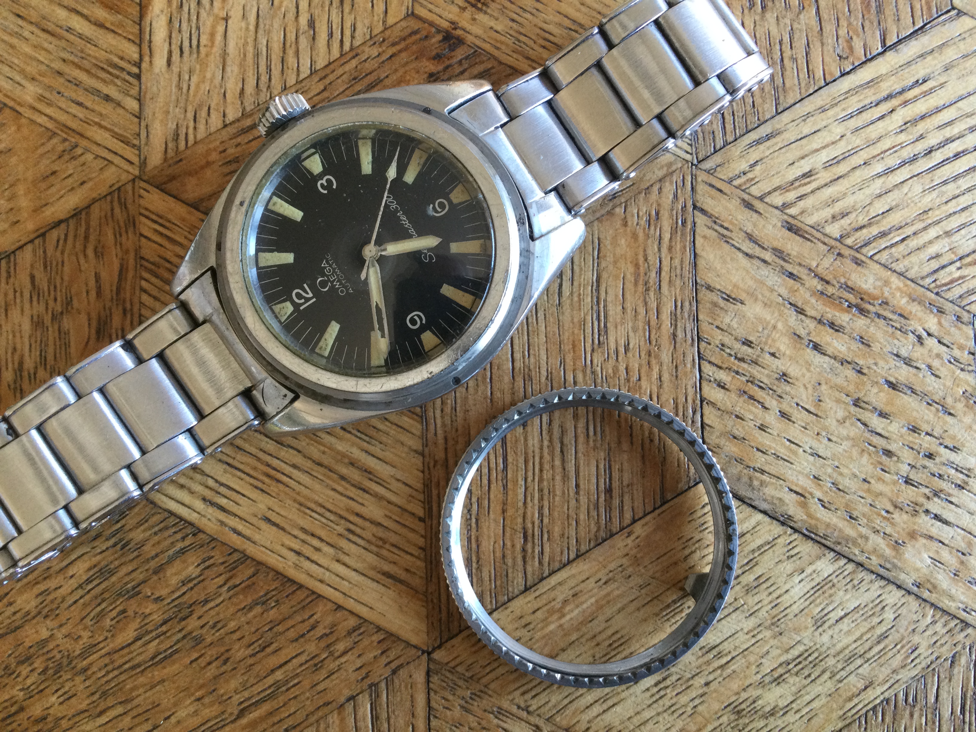

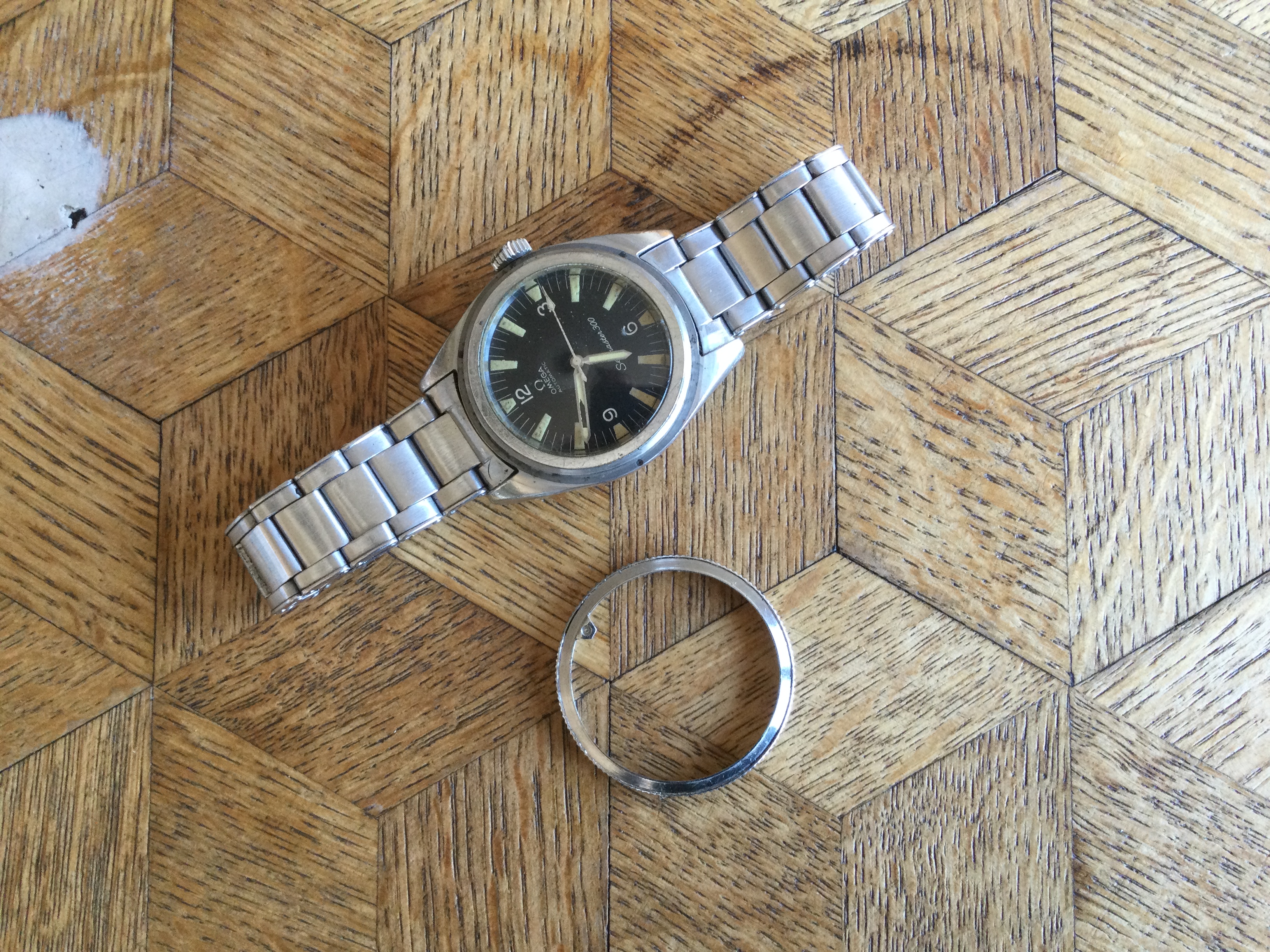

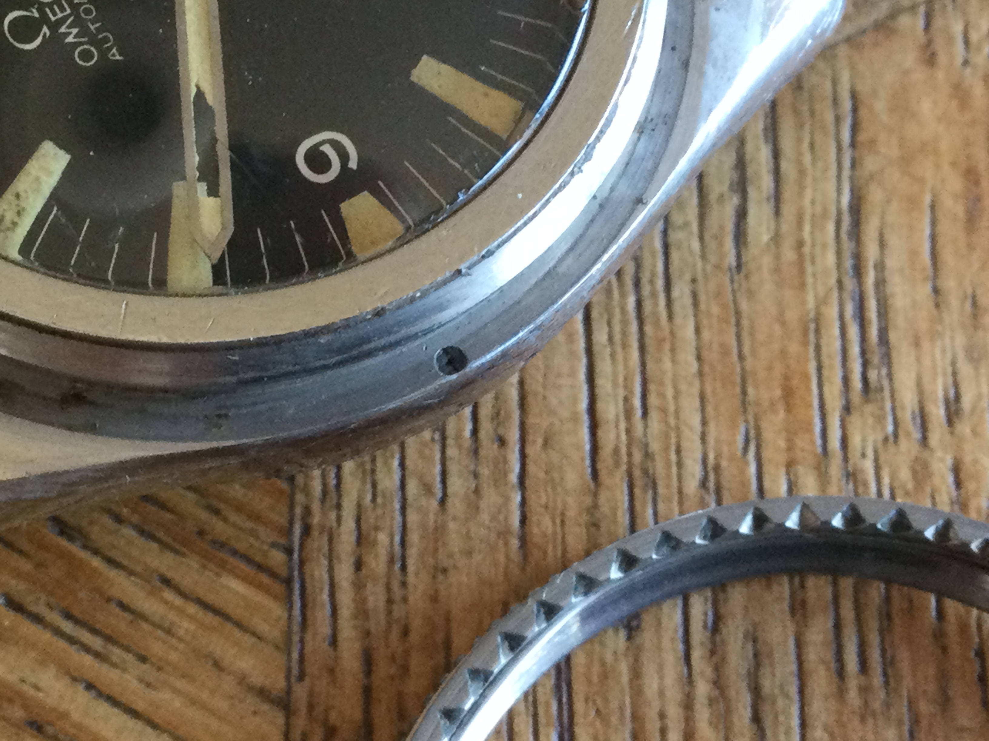

Dear members, I just snapped the bezel off my SM 300 to ship it to Roger AKA @mcgyver.
There are two balls missing on the case and the one left looks like it is made of translucid plastic.
Can those balls be replaced ? Is it worth or should I leave it like that ?
Kind regards from Belgium.
Mounir

These are small spheres made of ruby. Each one has a spring under it (or should have).
Spring is 085ST0030.
Sphere is 099ST0029.

Replace them they are only cheap or it was when I had mine replaced

if you want a quick solution, buy the cheapest ball pen replacement refills . with a fine tip plier press the metal tip of the refills above the ball and squeeze gently until the ball comes out. a bit messy because of the ink.... clean them in a solution ands voila! they fit the hole on your sea 300. very often the spring are still in the holes. if not , wiggle your bezel as straight as possible on top of the balls and snap it in. most of the times one will come out again , but 2 stay and the ratchet function is restored. if not satisfied, repeat. if you want it properly, Archer gave you the numbers. good luck ! kind regards. Achim

Actually I am not in a hurry since I just shipped the bezel to @mcgyver for a restoration. A member here kindly offered me to sell me two ruby balls. I will then have the watch serviced. It has been sitting in my drawer for years.

Thats how I do it for years. Just take one of your old ball pens (often free merchandise) and disassemble it like Achim said. Super cheap and working all the time (also for Seiko Divers).

Well, my time is worth more than the $11 these ruby spheres cost, so if you want to muck around disassembling pens, be my guest, but I'll just use the proper parts. 😉

Haha, I get the point, but its a nice DoItYourself hack that anyone can do...especially when you disassembled the bezel and lost the sphere. No comparison to your work of course.
