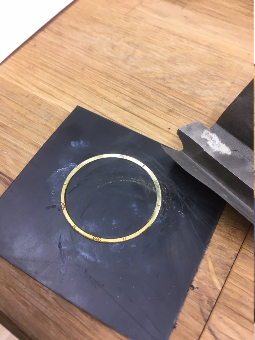

First test using 0.2mm brass to check fonts and see how deep I have to engrave to get the lume to stick.
Version two is on the way using black anodized aluminium. Oxidizing the brass black did work - but results not to my liking => trying aluminium instead.

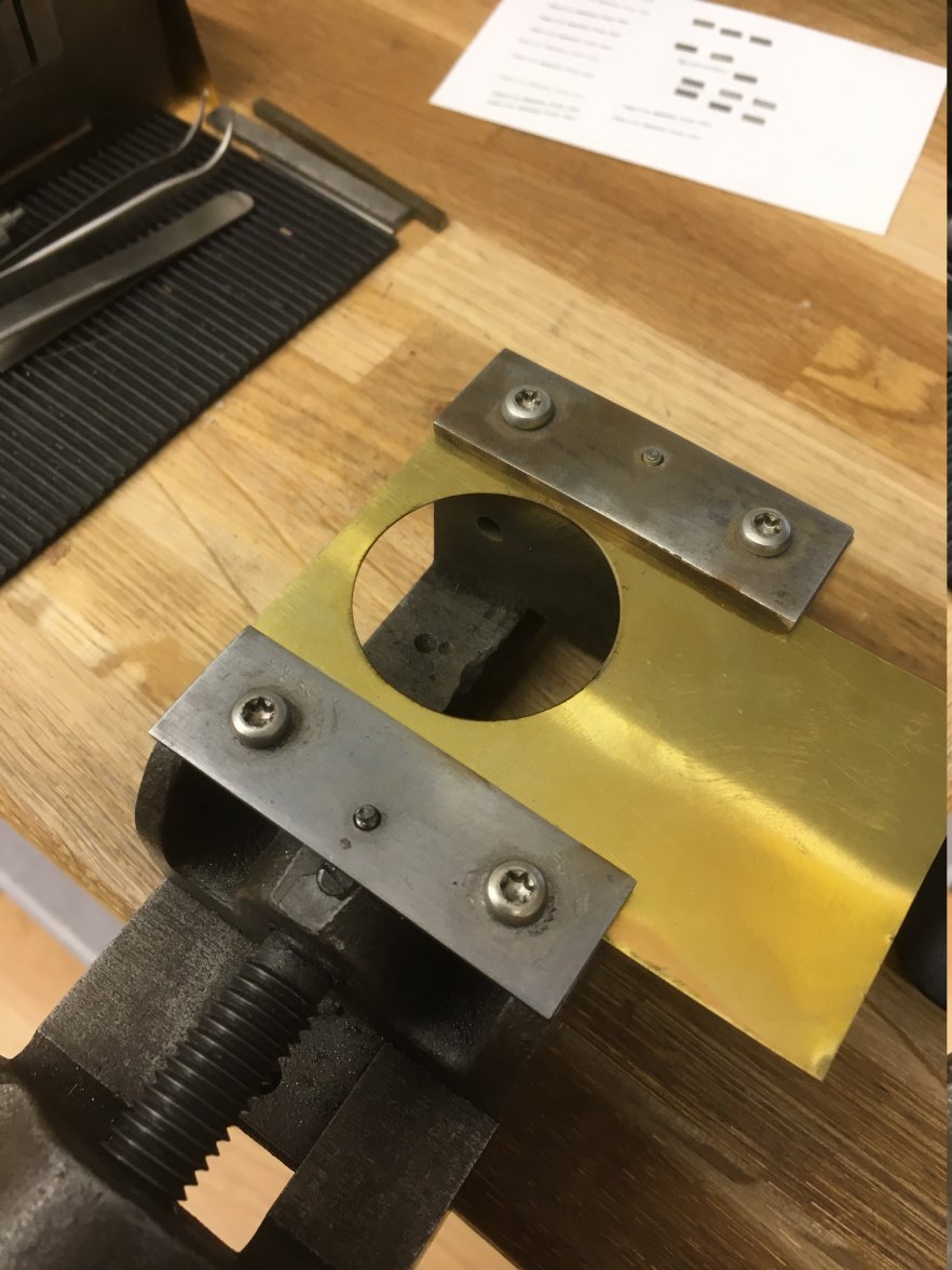

Still trying to find the best method!
Brass works great engraving and cutting, BUT I'm having some problems getting it etched black - it does not stick as well as I would like.
Anodized aluminium works good - but hard to find thinner than 0.5mm. Experimenting etching it down in thickness.
Latest try is making a mold and casting in epoxi resin etc ......

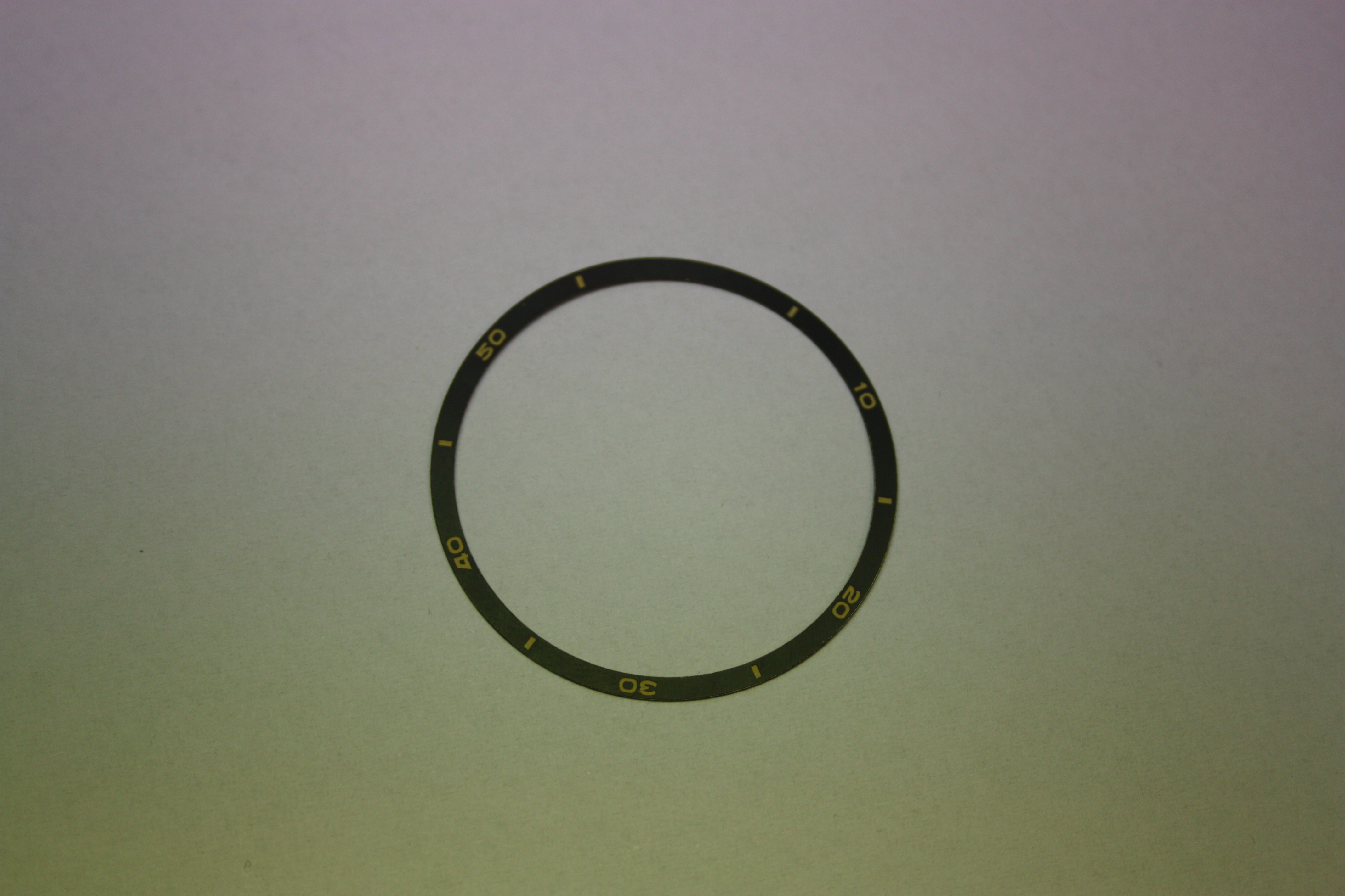

Ongoing experiments.....feels promising...
0.13mm thick aluminium, engraved and filled with paint/lume

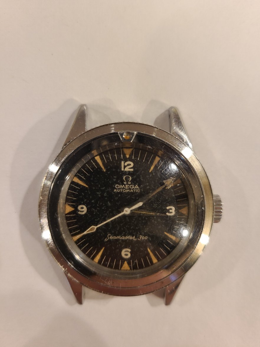

I agree. I am in the market for a bezel restoration for a 1962 Seamaster 300, Cal 550 165.014-62.
If the bezel insert can be shipped to you directly, that right there is a bonus! It would also be great if the Bezel insert can be pressed in and can be able to be taken out without damaging the bezel. Which I think could be done?
So, if the watch was sold (or not) it can go back to the original condition. It can also be left in bezel with a statement Example - “Bezel insert by Mcgyver”. Like they do for artist like Aldo, Lukas and Rene bezel recreation/restoration is stated when these watches are sold or traded.

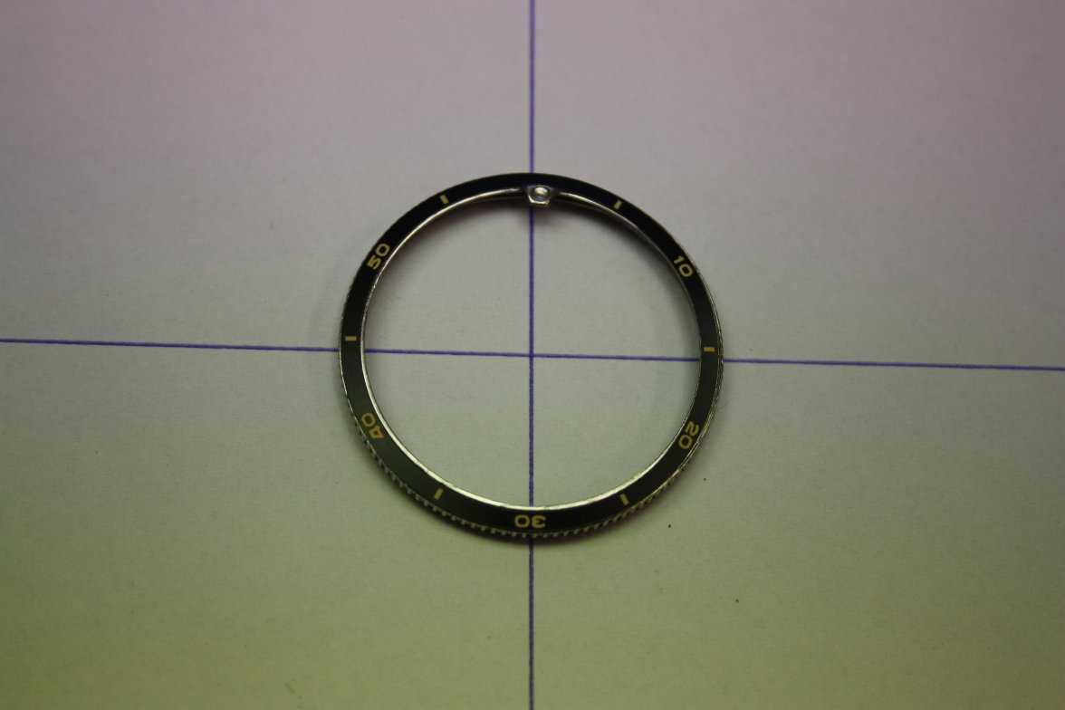

Just got a better bezel in the mail from a member! 😀
I adjusted the inner diameter to 34.2mm and it's now a good fit in the new bezel with an intact groove.
Did some minor adjustments to the fonts - have two 0.14mm aluminum inserts on the bench waiting for the paint/lume to dry.
The idea with the aluminum version is it can be used glued "as is" - or over fill with epoxy/acrylic to get a "baked" version - by the owner so no need to ship the bezel and risk it getting lost in the mail.

102
811
0.14mm black aluminium, etched numbers/lines, filled with paint and lume, edge black oxidized.....
Glued in place - next step "baking" in marine grade epoxy. Curing right now so will take a day or two before I can do the final finishing.
Edit: [Looking at the pictures - the bezel is now taking a bath to remove the epoxy - the numbers need more tweeking!]
