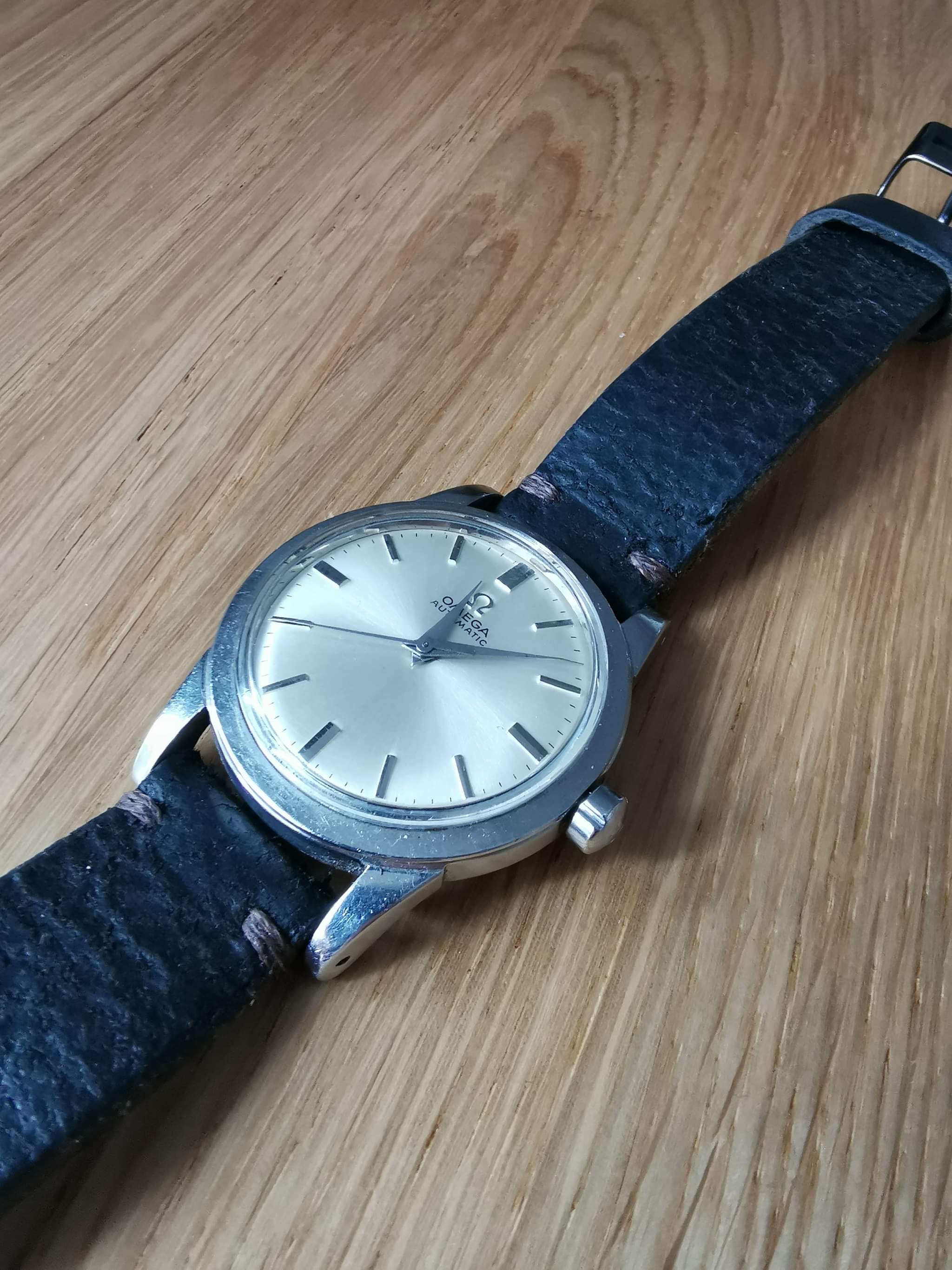

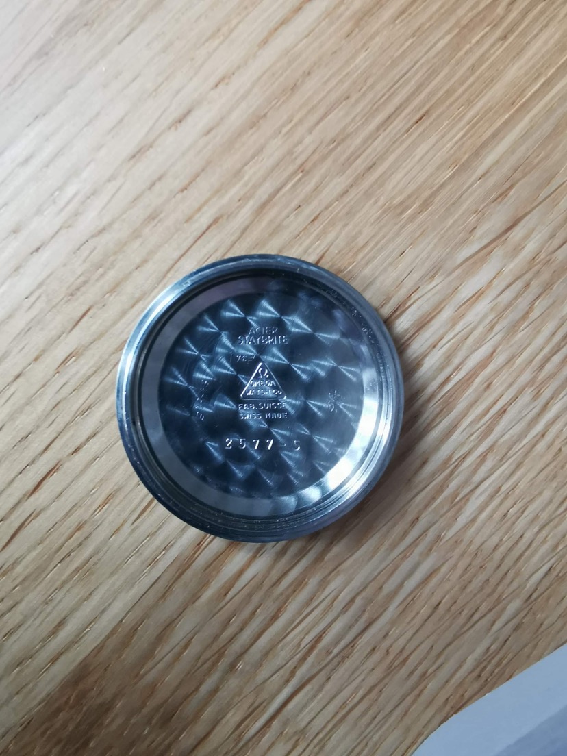

Hi guys, i was looking for a seamaster for myself and came upon this example. What do you think, is it all original? Im new to omega watches so anything will help.

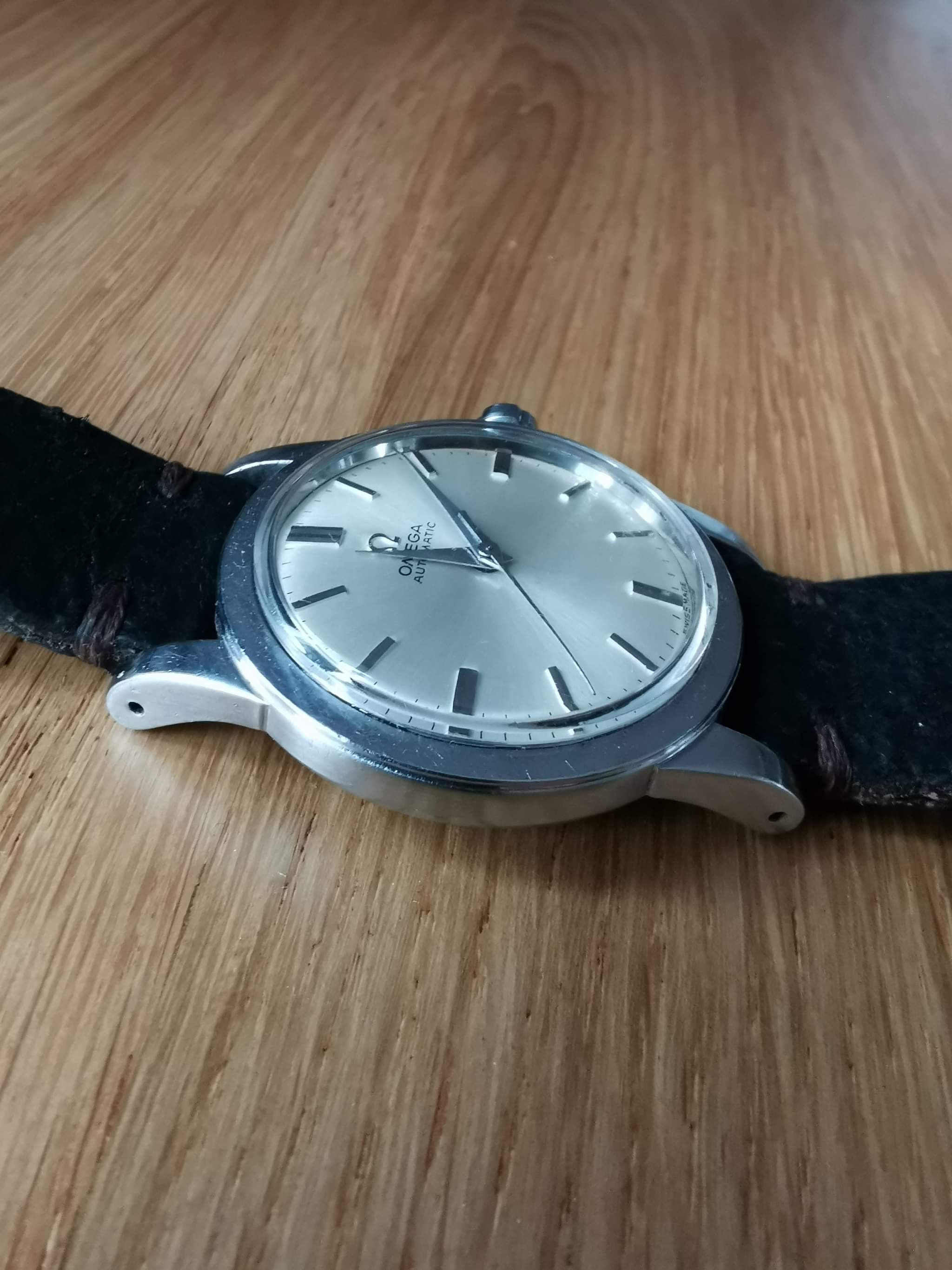

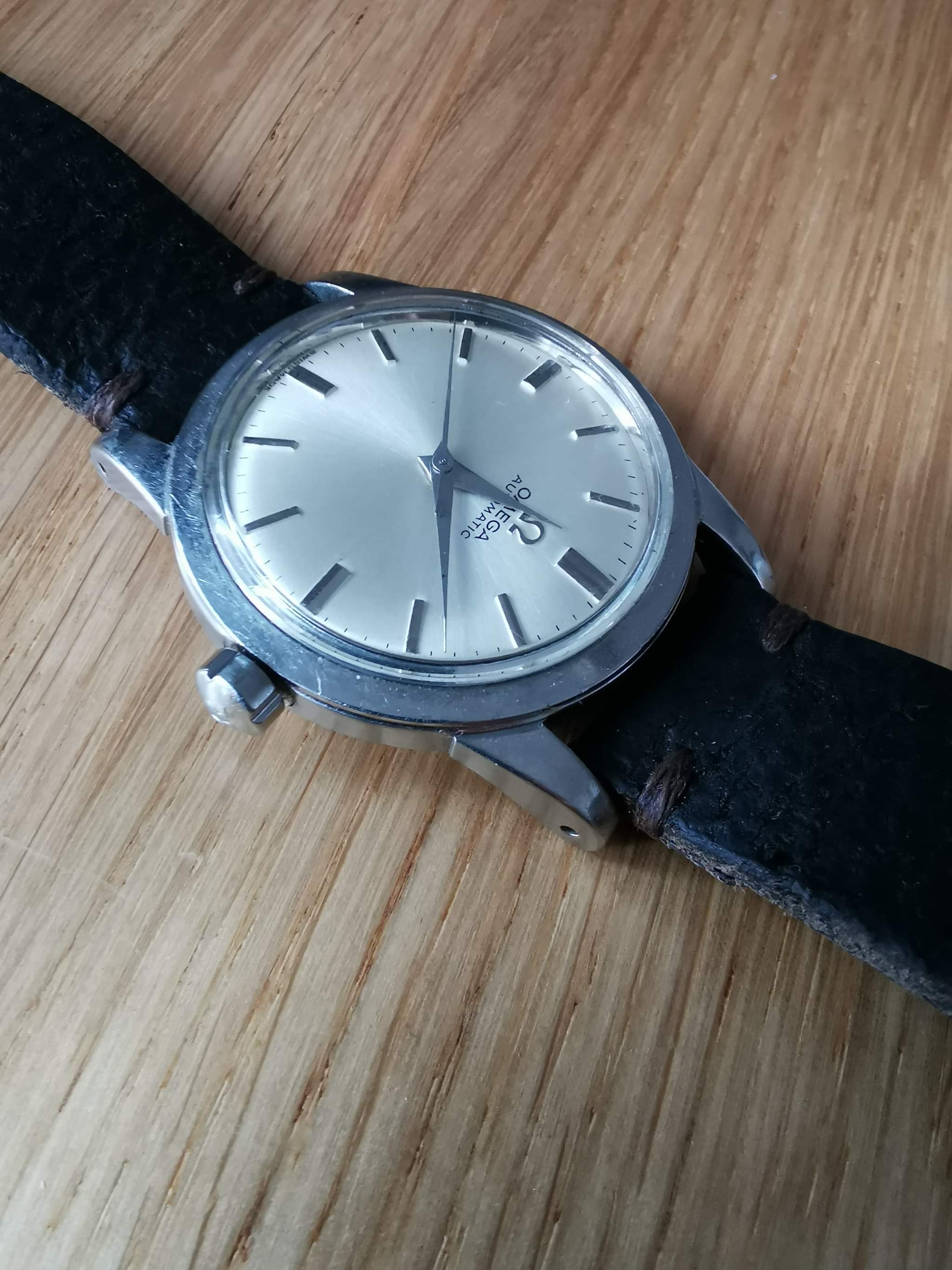

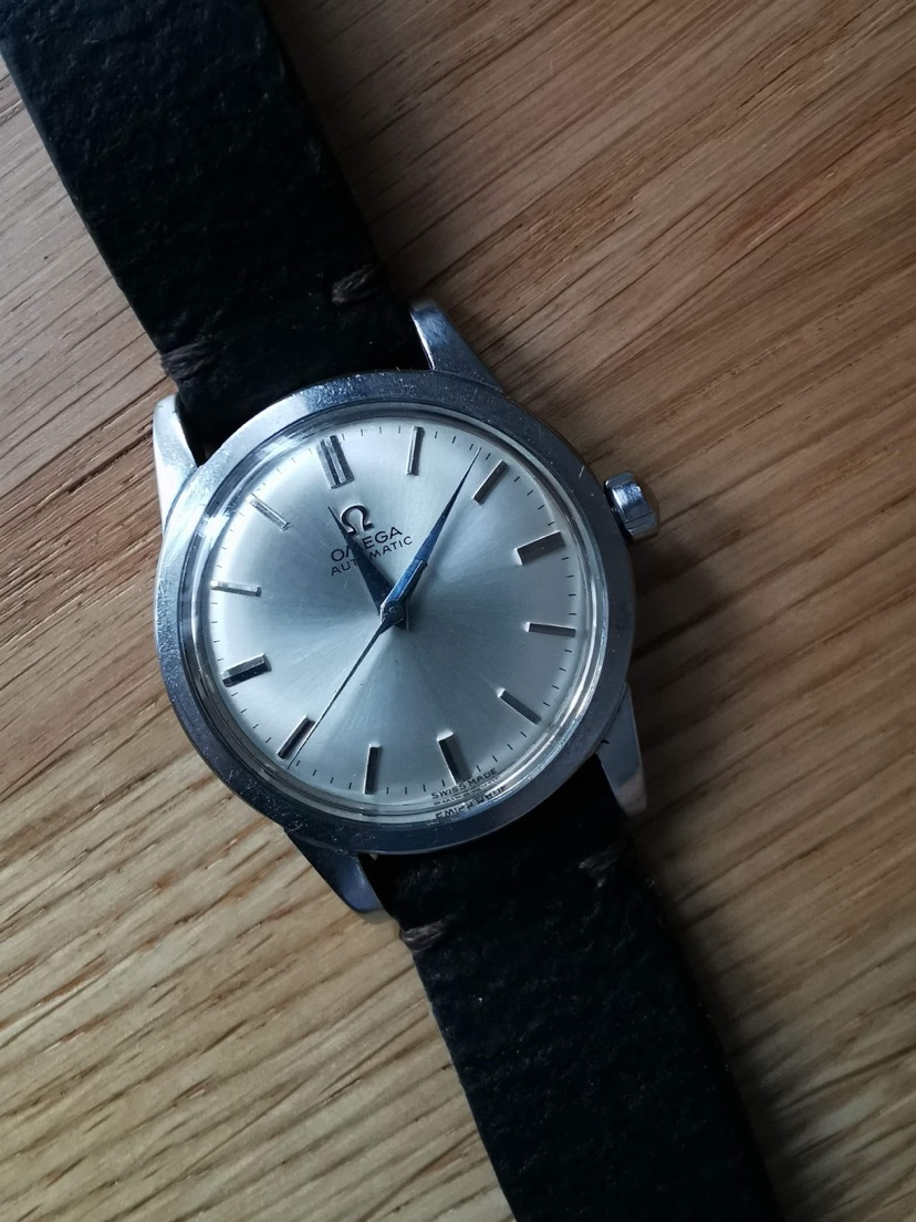

It isn’t, I’m afraid. This shouldn’t have a sunburst finish to the dial as it’s a ref that was produced in the late 40s / fifties (the pictures are a bit blurry but if I read the serial correctly that should date the watch to ~1949).
18,840
39,182

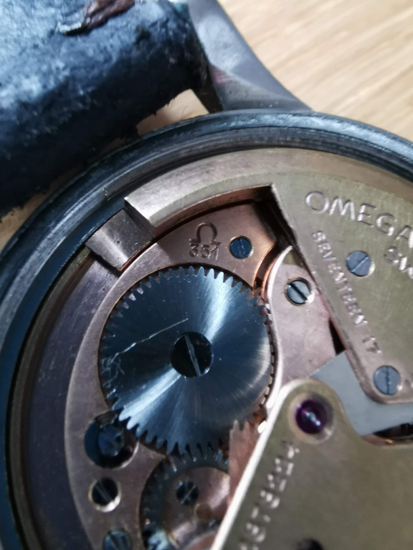

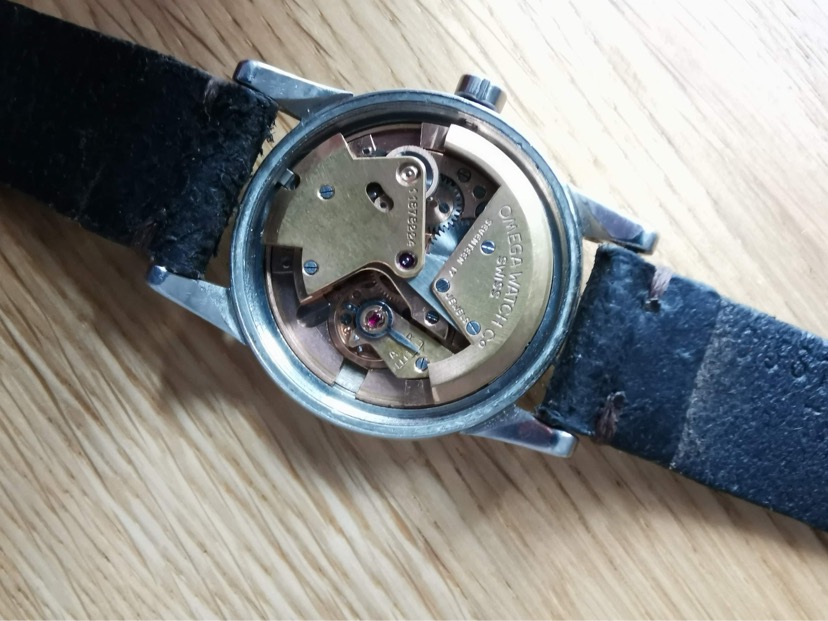

Movement looks a bit tired, but at its age that's excusable.The dial has been re painted and the hands are incorrect, but otherwise it would be a reasonable daily watch.
5,631
5,815
I don’t believe it’s been refinished, it looks like a service dial. Not the Seamaster dial it came with, though.
9
Thats what i thought, in my eyes it doesn't look refinished...
