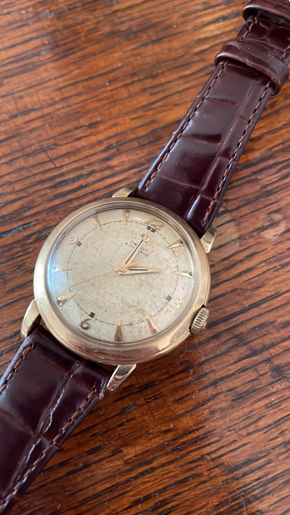

Hey all, my mom had my grandpa’s omega bumper restored. I haven’t removed the back of the case to check anything else, but any help on ID’ing this?

Can we at least see the back too? Maybe a side shot?
You're not giving us much to go on here.

With only the single scan to go on, I’d guess 28.10 or 30.10 SC bumper auto.

Looks like the case is from star watch case co
