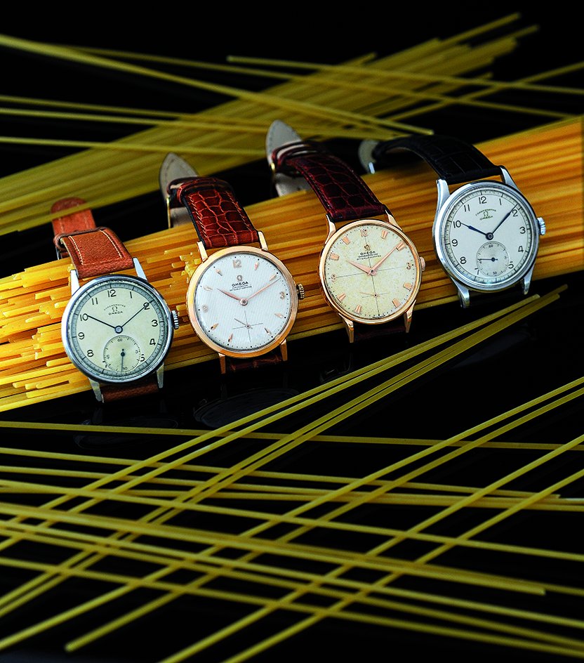

You live in Italy?
This would perfectly make sense because ref 14352 was one of the models specifically sold in Italy... Bingo!
In the photo below you can see the 4 "Italian references".
The second watch from the right is the model from which the dial derives.

You live in Italy?
