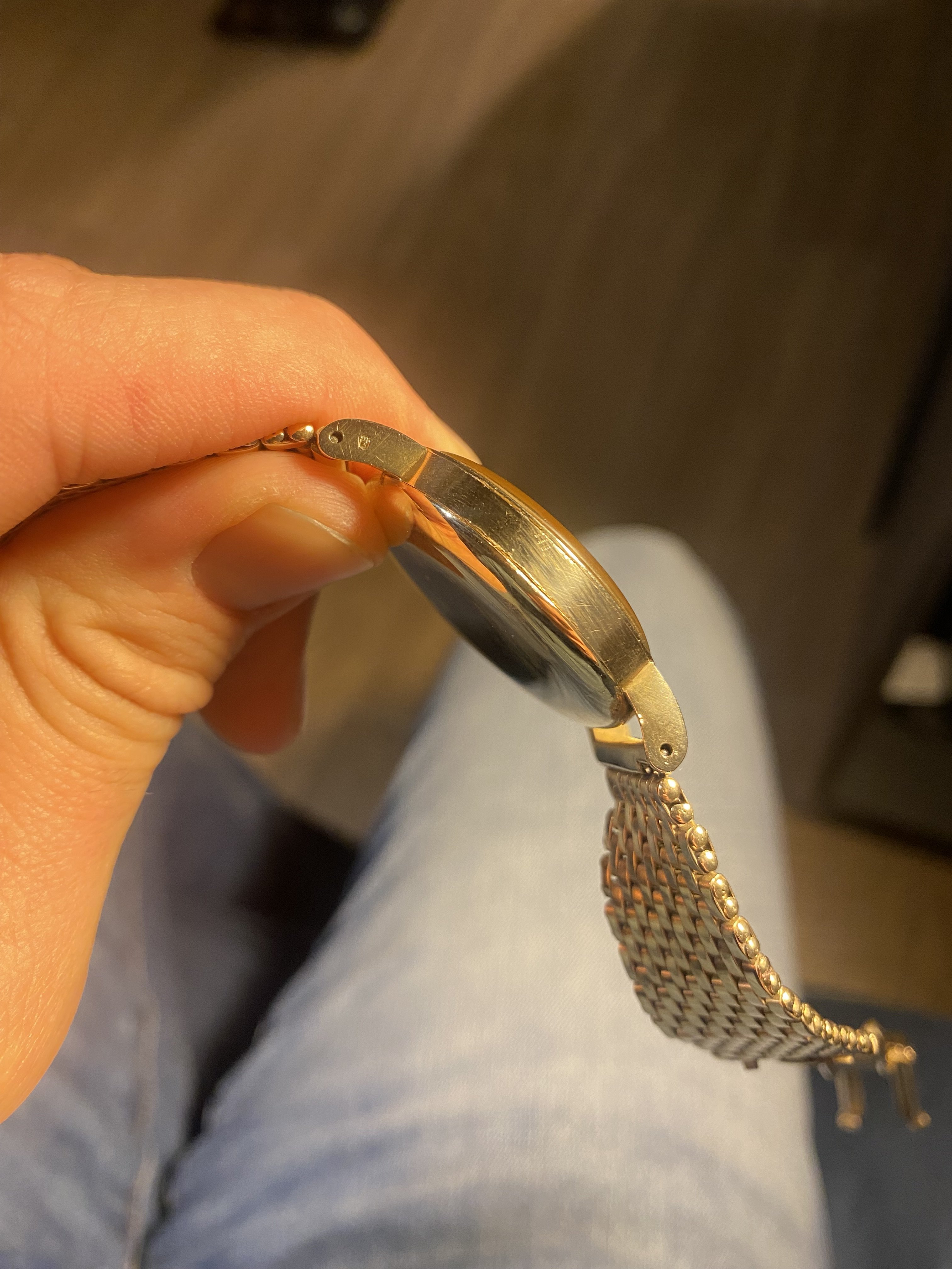

I have this vintage Omega in gold that I believe to be an 30t2 rg movement
Would like any info you could provide as well as an advice of where to have it repaired. Also will appreciate an estimate value to see how much should I invest on the repair

That watch is worth the value of the gold plus a little extra for the movement (depending on the condition of the movement, which may be pretty bad given the apparent water damage). The dial is totally trashed, and I wouldn't invest another dime until acquiring a satisfactory replacement dial.

I would think is a ref. 2367, diam. 35.5 mm. Inside should have a 30T2SCRg (check).
The bracelet does not belong, the dial I am afraid is very damaged. The case is very polished, profile of the crown seems correct.
At any rate, value is not just that of the gold.

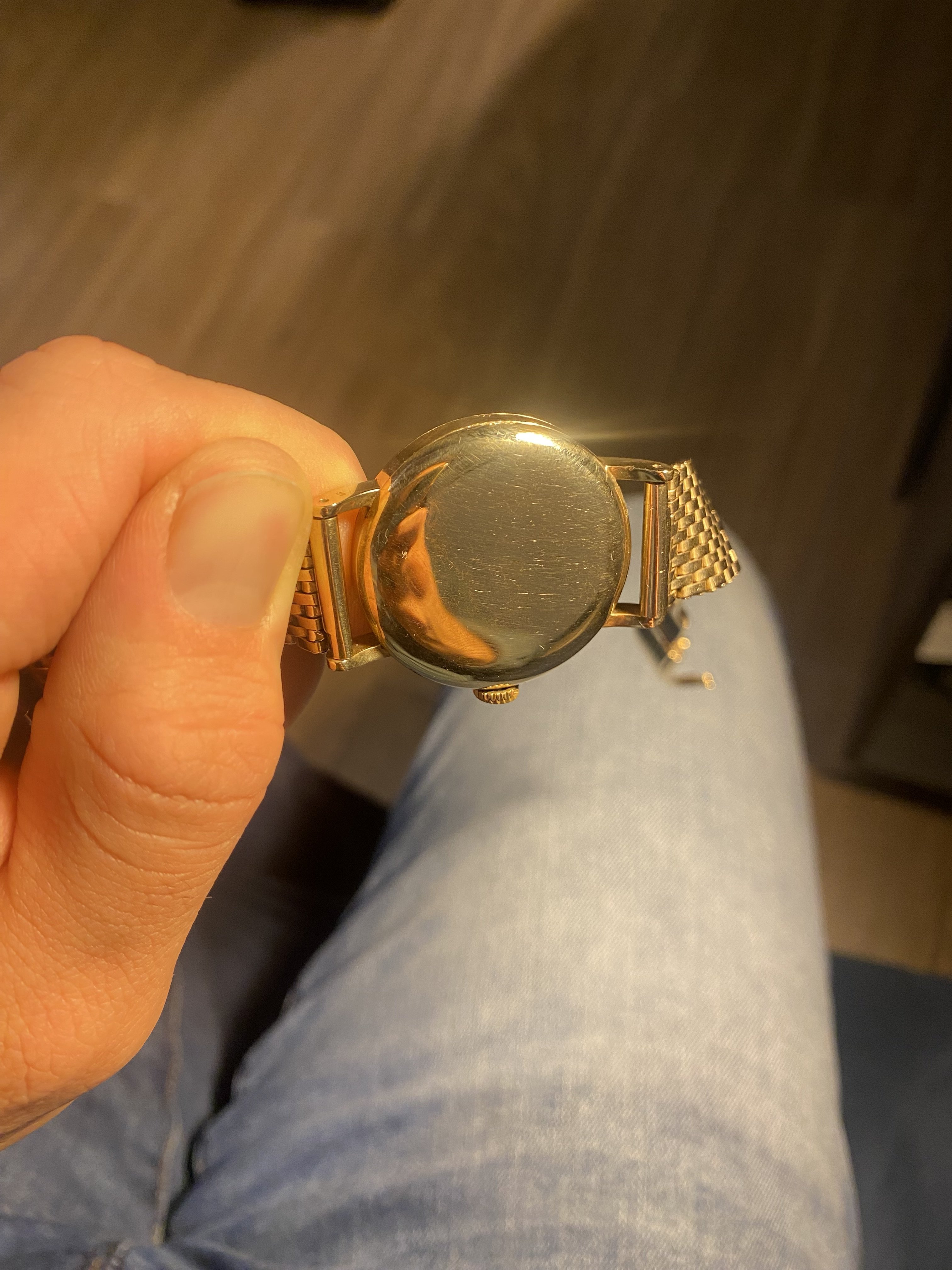

Have not opened the case I am guessing is front load and haven't found a watchmaker in my town for this kind of job
But the movement is in running condition and seems to be working smoothly

It may just be a press-on case-back, which you can open with a case knife. If you show more photos from other angle, we may be able to help you.

these are 3 piece cases. Bezel top, center section and case back.
if you look at the back edge. You might be able to see an area about 1/4” long that’s slightly raised. That’s where you insert a case opening blade or knife edge and sort of pop the back off.
some can do it. Some not so much. Depending on the movement condition. That will determine whether is worth repairing or not or selling for parts

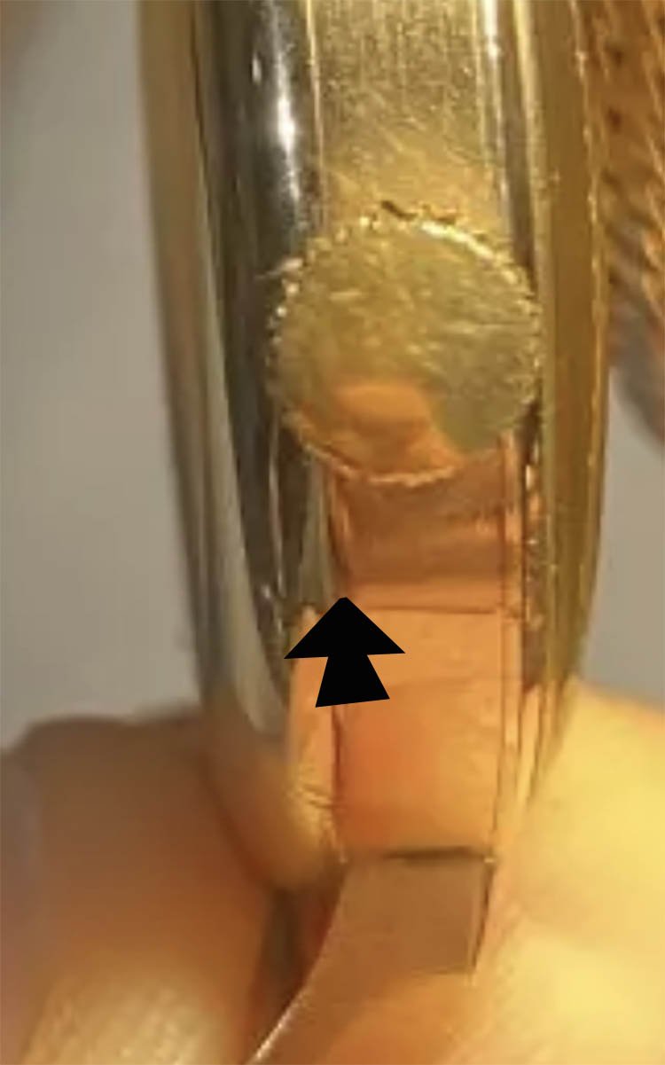

Yes, that case-back certainly look like it can pop off. It looks like there may be an opening for a case knife on the 9 o'clock area. You want to use a sharp knife and just insert it.

I confirm the case is a 2367, and the crown is original and age-correct.
The Kreisler bracelet has nothing to do with the watch.
To open , this is the place to pry with a blade.
