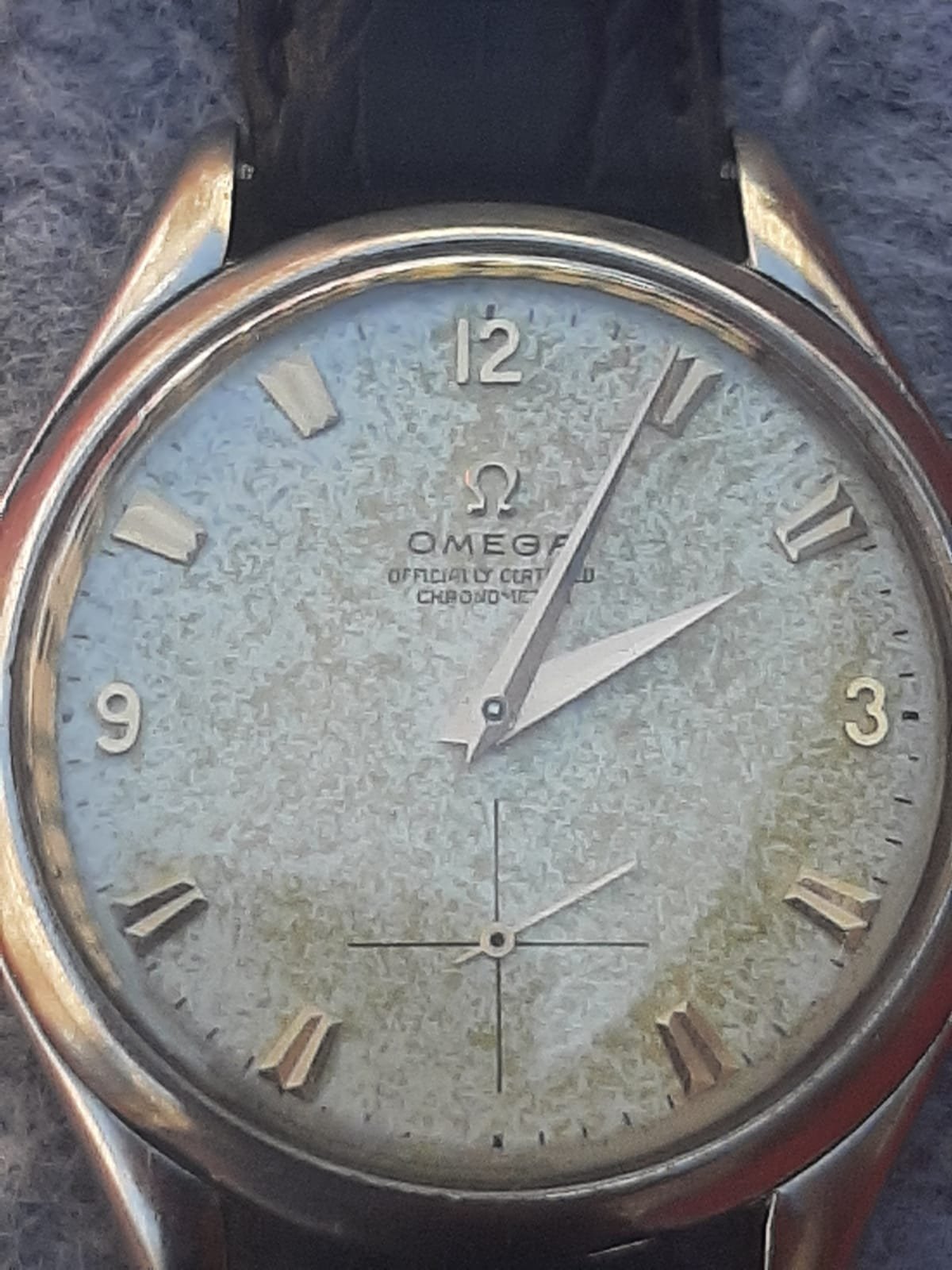

I have never seen a ref. 2505 with 30T2Rg or 30T2SCRg movements. The were first introduced in 1946 - so in theory there isa temporal overlap with the 30Rgs production. Should they exist, they would have a dedicated Chronometre dial, because of the large diameter of the 2505, possibly 33-34 mm diameter - much larger than those of the 2367-66-65-64.
Any image from the front? The dial could have been recased with the movement, but then it should be visible a gap between the border of the dial (29.5 to 31.5 mm diameter according to the reference) and the edge of the plexy. Because the 2505 is nearly 3 mm larger than the 2366 and about 5 mm larger than the 2364.
A better hi-res image of the front - in the case - could help.
PS: the 2505-10 - the tenth series - I have seen are from the early 50s, most of the 30Rg production is before that.

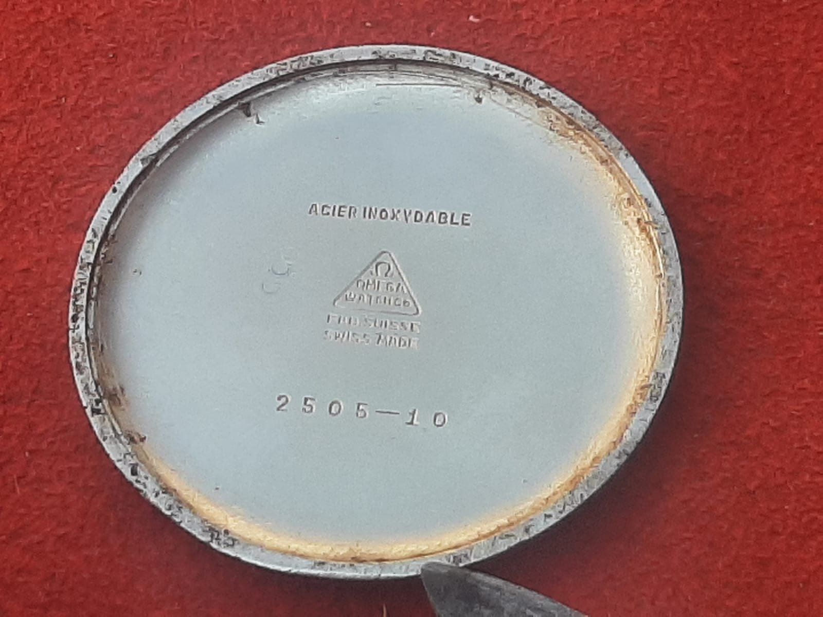

Thanks all...I was working on forwarding the photos that I have...quality not good, frankly...but I will be seeing the watch this weekend...
Photos attached...(I hope)

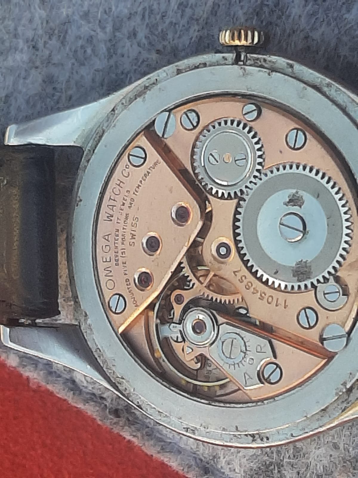

Thanks...the serial number is : 11054857

I know what I'm looking at when buying Omegas...but this one has intrigued me...the dial looks OK...from the font style and it fits the larger case...but, instinct told me to walk away, which was my intention...but...what if it's a rare beast...thats why I've thrown it over to the forum...
I will be seeing the watch on Friday evening and will take some more detailed photos...unless 'chronometer' is spelt like this...and there are other obvious discrepancies.

Sorry, but it appears to be a redial, and in any case not a dial associated with 30T2Rg chronometres. And as @mac_omega has confirmed that the case reference never housed chronometers, it means that it is a misrepresented "frankenwatch", assembled from parts that would not have left the factory in that combination. If you have the option to return it to the seller, you would be well-advised to do so.

Hi John,
absolutely impossible this is an original watch.
This dial most likely comes from a gold chronometre ref. OT 14352 from around 1952 the case of which had been melted down.
The orphaned movement has been re-cased in a case of the well known ref. 2505 which is a non-chronometre model. The gold crown should have allerted you, it comes from the original gold watch and does not match ref. 2505 !
Furthermore the dial has been reprinted. The correct inscription for the dial would be: "OMEGA, CHRONOMETRE, OFFICIALLY CERTIFIED" in this order written in 3 lines. And it should have "cross hairs".
The dial is repainted, and not particularly well, IMO. As you keep looking, you will more easily notice the obvious signs of redials and be able to quickly eliminate watches like this from consideration.

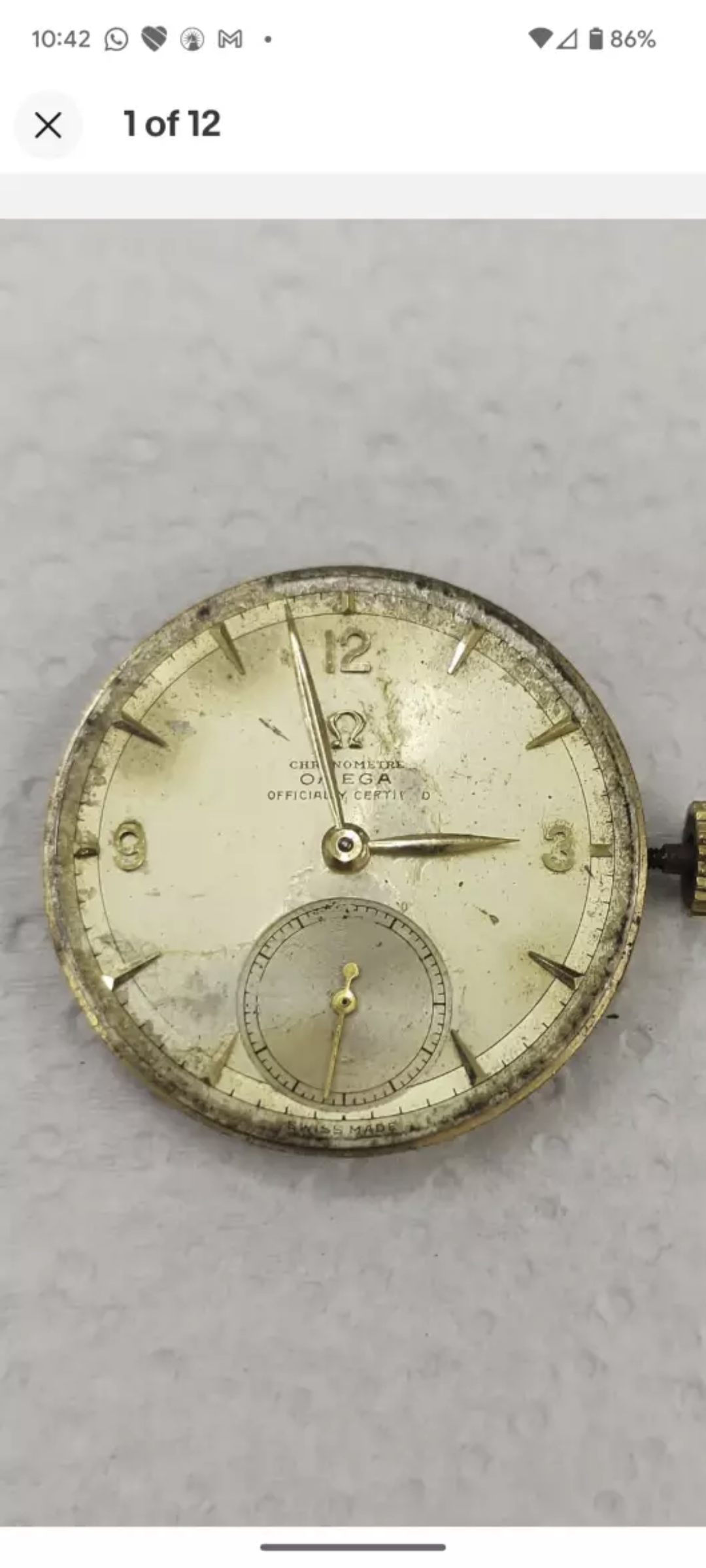

available in Italy
You live in Italy?
This would perfectly make sense because ref 14352 was one of the models specifically sold in Italy... Bingo!
In the photo below you can see the 4 "Italian references".
The second watch from the right is the model from which the dial derives.
